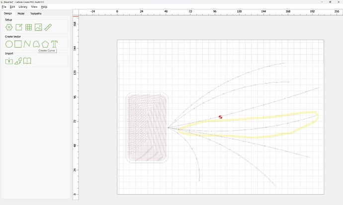

How do I create curved lines like these?
Import the Reference:
“Load Image”
(and adjust settings as needed)
“Done”
There are two possible ways to draw:
  • Directly draw using the Curve tool
  • Draw using the Polyline or Curve, or other tool, then Node Edit after the fact
We will show both here:
The Curve tool is the more complicated option, making available all the capabilities of both the Polyline tool, and the Node Editor.

There are two-options for the Curve tool in Carbide Create (and most other vector drawing tools):
  • click-release — this mimics the Polyline tool and makes straight-lines creating the begin and end points
  • click-drag-release — this creates two nodes, the click creates an on-curve point, the drag-release creates an off-curve point which describes the shape of the curve — note that curves in Carbide Create are initially symmetric (unless otherwise changed/instantiated), so the second pair of point/node will influence the shape of the next portion of the curve when it is created (though it may be later edited)
So, click-drag-release:
Then move to the end point and click:
then drag-release:
Done

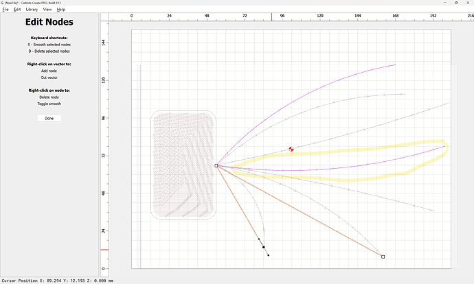

If the curve doesn’t line up perfectly, it will be necessary to go into Node Edit mode and adjust:

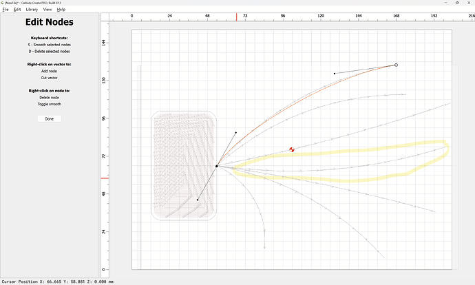

Select a Node:
and drag the off-curve node to re-shape the curve:
if need be, adjust the other end:
Done

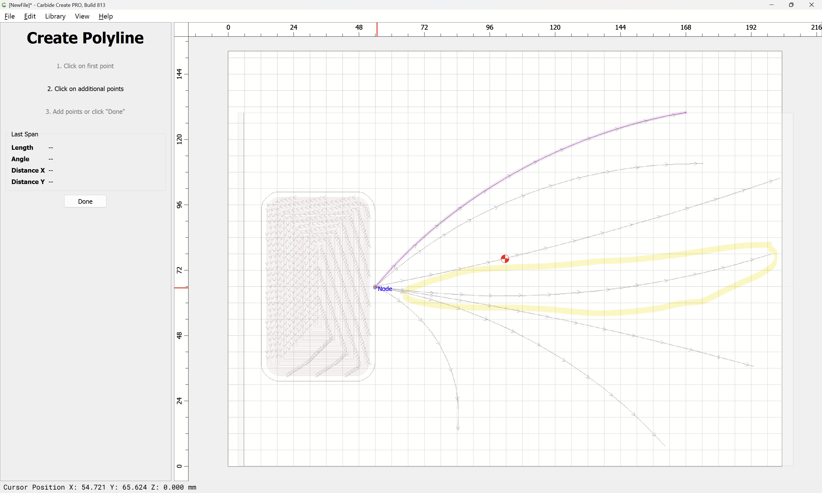

If initially drawing with the Polyline tool it is much the same:
click to place the begin point:
move to the end position:
click to place the end point:
Done
Go into Node Edit mode:
Select a node:
right-clicking on it will show the possible options:
and their keyboard Shortcuts:
  • Delete Node (D)
  • Toggle Smooth (S)
  • Cut Vector
Note that there are two sorts of on-curve nodes:
  • Sharp (indicated by a Square, hollow normally, solid black when selected)
  • Smooth (indicated by a circle, hollow normally, solid black when selected) — further note that for a Circle node there are two associated off-curve nodes
Although this is a “Smooth” node (which is what we want) the off-curve nodes are not visible to be worked with, since when a straight line is described they are coincident with the on-curve node. Tap s to “Toggle Smooth” (note that the shortcuts are not case-sensitive)
which toggles to a “Sharp” node.
Repeat
which instantiates the off-curve nodes where they can be worked with. Drag to adjust:
Repeat this at the other end:
Done
The final thing to know about off-curve nodes in Carbide Create is that sharp points may be made by alt-dragging — if we wanted one line to represent two curves, this could be done by drawing with the Polyline tool:
Done
and repeat this process:
Select
Toggle Smooth
Toggle Smooth again
Drag to re-shape:
Select
Toggle Smooth
Drag to reshape:
Select:
Toggle Smooth
The final feature only properly applies to on-curve nodes which are not a begin or end point. Rather than just dragging, use the alt/option modifier key when dragging to create a “Sharp” node:
Once a node has been made “Sharp” it is no longer necessary to hold the alt key:
