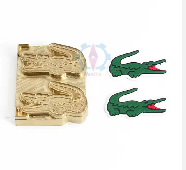

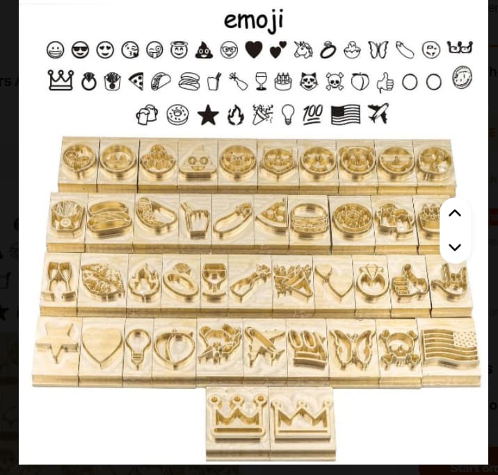

I need to make Brass mold text SKECHOR width 65mm height 15mm it will be used to press on High Frequency machine to cut out TPU material thickness 0.5mm
the text should be raised 2.5-3mm and inside text should have 0.3-0.7 mm depth to shape beveled edge for clean cutting attached some molds just for reference

I want this text to be machined on Brass, the text will be raised 3mm,inside the text depth 0.7mm, should have a wall of 0.5mm that will make beveled edge for cutting
this photo just for reference only.

For a beveled edge, you will either need to use a V tool with a suitable angle (do you have a source for one suited to cutting brass), or you will need to use a 3D CAD/CAM program such as Alibre Atom 3D.
I can use V bits I have all angles
Then set this up as a V carving using the desired V tool entered as shown at:
https://carbide3d.com/hub/courses/create/tool-library/
which is suited to cutting brass as shown at:
https://carbide3d.com/hub/courses/create/toolpaths/
until you arrive at the desired 3D simulation
https://carbide3d.com/hub/courses/create/simulation/
using appropriate feeds and speeds:
