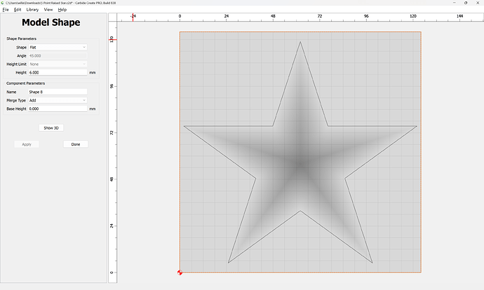

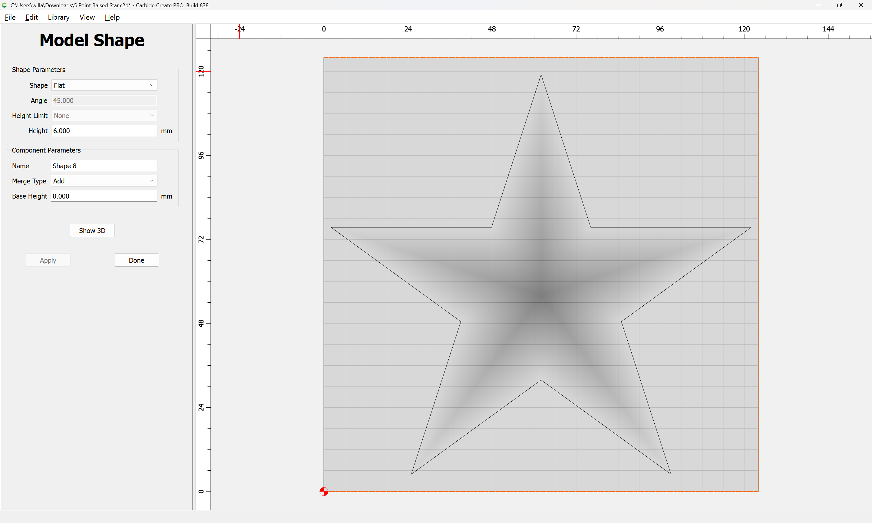

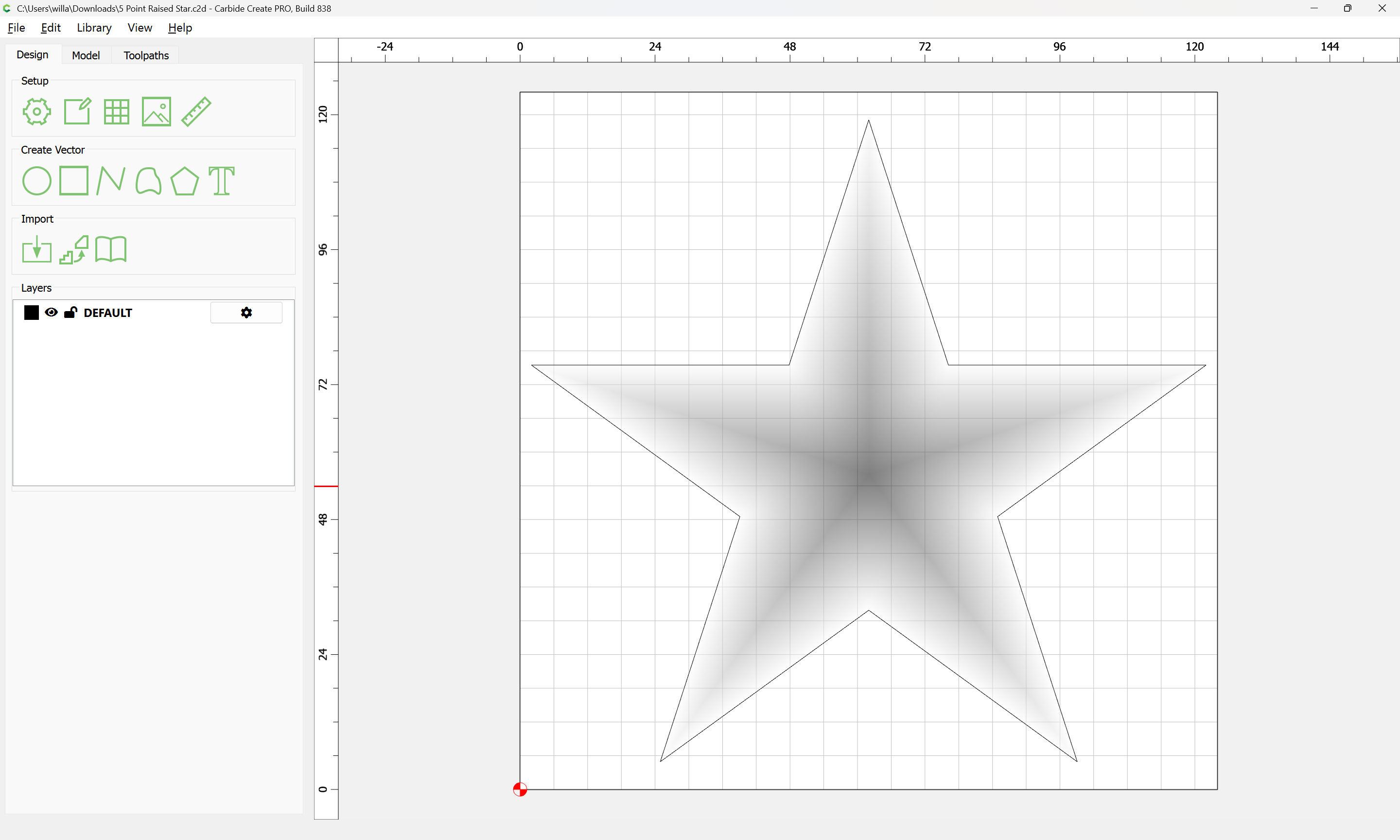

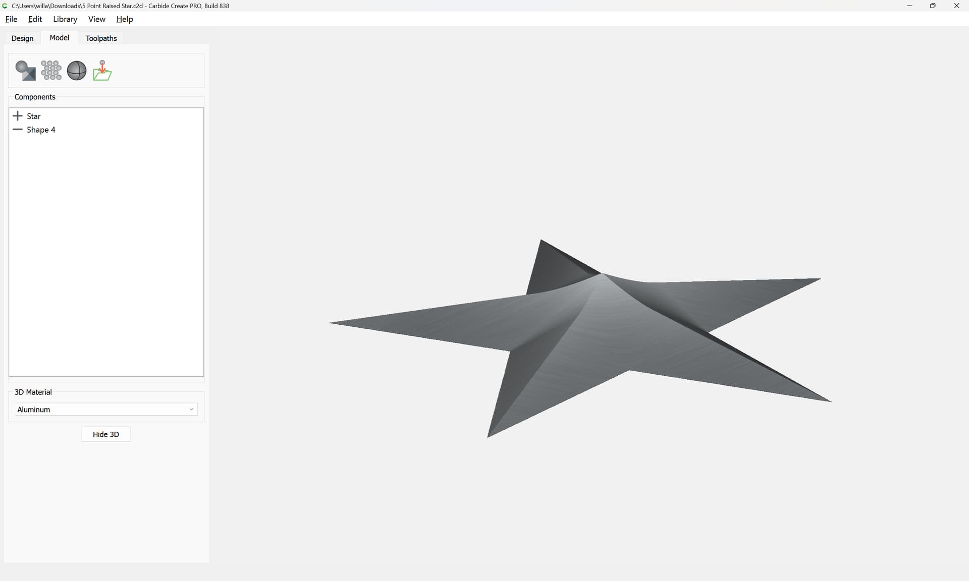

…make a rosette with a raised star in the middle and have attempted this goal, but not to the desired level. I am able to get a raised star, but it does not have the square backing. The star is cut out and modeled to be raised. I want the star to sit on a platform.
The first thing to do is to model the desired “platform”:

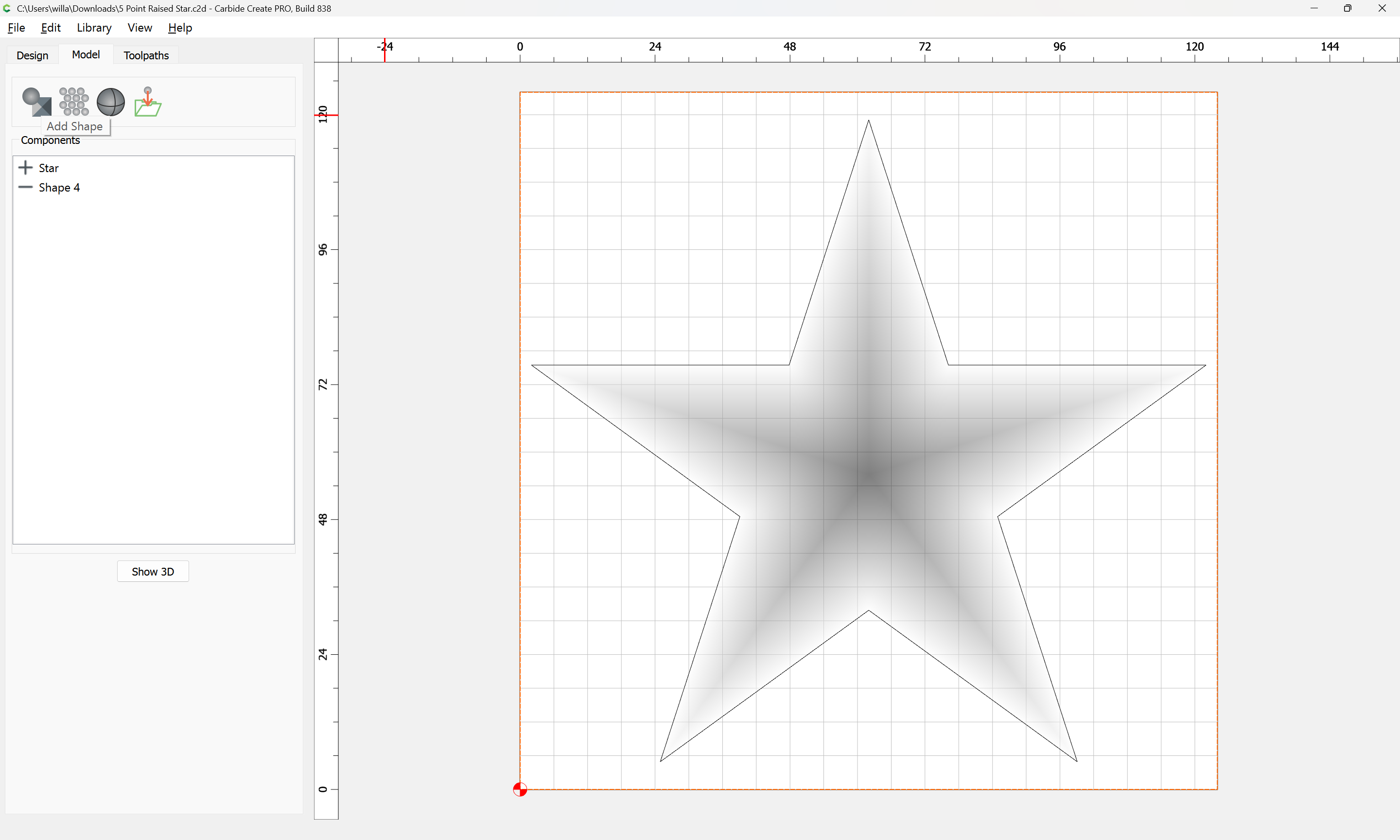

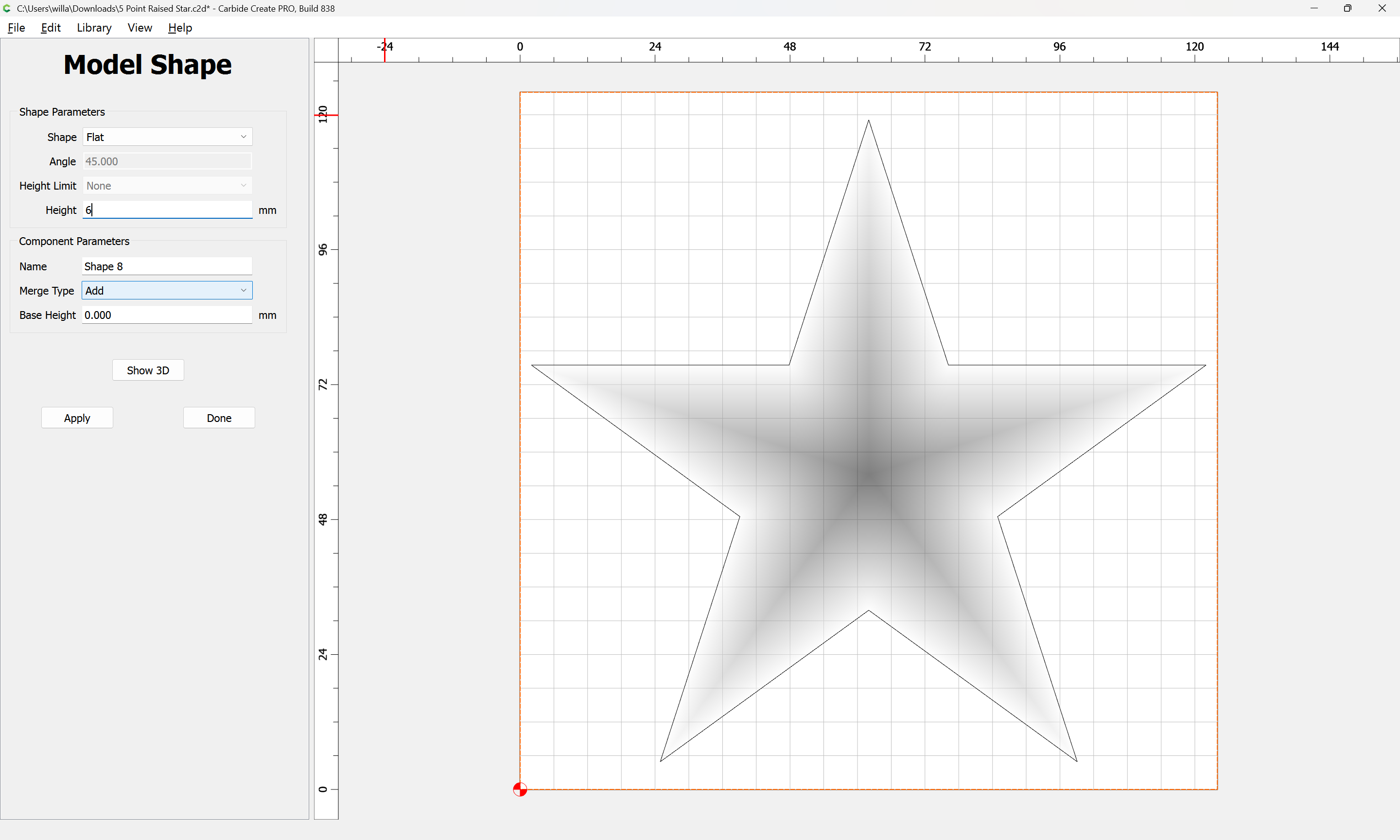

Select the geometry for the platform and “Add Shape”:
Apply

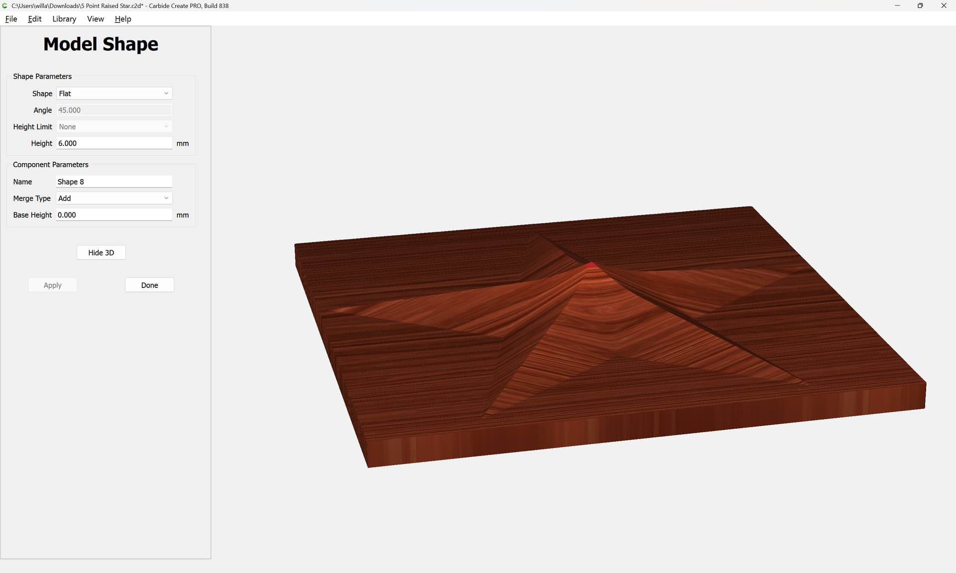

One further issue here is that the star has a raised center point due to how Carbide Create Pro calculates raising at an angle.
c.f.,
