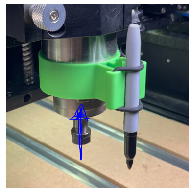

Have you tried pushing the Router/spindle up higher into the spindle/router mount?

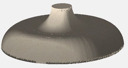

It will be tsomething like this
Even with Riser I still have the problem that the Z Axis is 14 cm max.

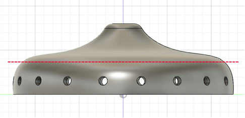

Any idea on how to slice my project?
If you have software to build/edit 3D models, like STL or faceted bodies, build or slice it in 2 pieces.
You can also use the whole model, and use boundaries and stock height to control how deep the tool goes.

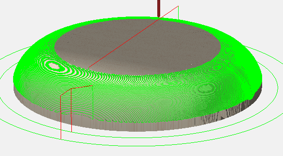

Here’s a similar model I threw together, 20cm tall

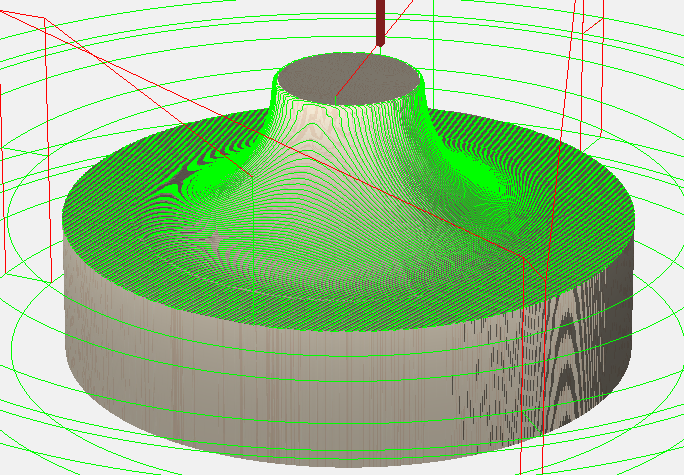

A toolpath that just cuts the top half, using a 20cm stock height
And a toolpath that just cuts the lower half using a 10cm stock height
