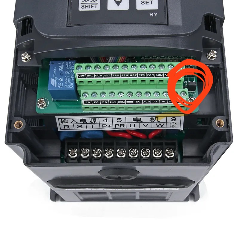

HY VFD recieving 0-5v signal but wont spin the spindle
The first post in this thread breaks just about everything down.
There is also a plastic jumper you have to move on the vfd from one position to the next. Read the manual to make sure as it’s been a while.
