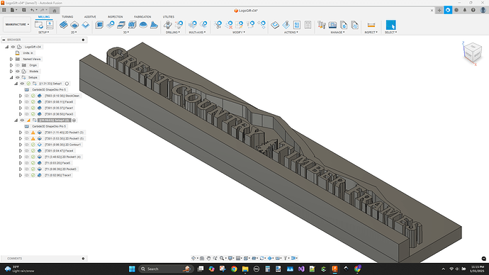

I have a Pro 5 4x2 with the 65 mm VFD spindle for 1.5 years.
I am in the first stages of working with a 7.5 wide x 38 long x 3.75 deep piece of pine.
I am also looking at the 80 mm spindle.
Here is a screenshot of the model in Fusion
The tool #301 is a upcut flat end .25 Extended Jenny from Cadence.
The tool #1 is a downcut flat end .125 Downtown Jenny from Cadence.
The Face operations are to clear material. #301 ( 85 minutes )
The #301 Pocket and Contour paths are somewhat clearing but had to follow a curve and the Tool diameter will effect what it can get to. ( 7 hrs and 20 minutes )
( Note: I could have Face cleared 50% of a Pocket path volume if I had the 80mm spindle )
The #1 Pocket and Face paths are for detail and cleaning up. ( 4 hours ).
So the only component that an 80 mm spindle would directly help on is the Face operations.
If might help in the Pocket and Contour if there is room.
So the easy $ are in the Face operations, but that is a small percentage in this project.
For this project I could get maybe 2 hours back, but a bit more planning/paths.
