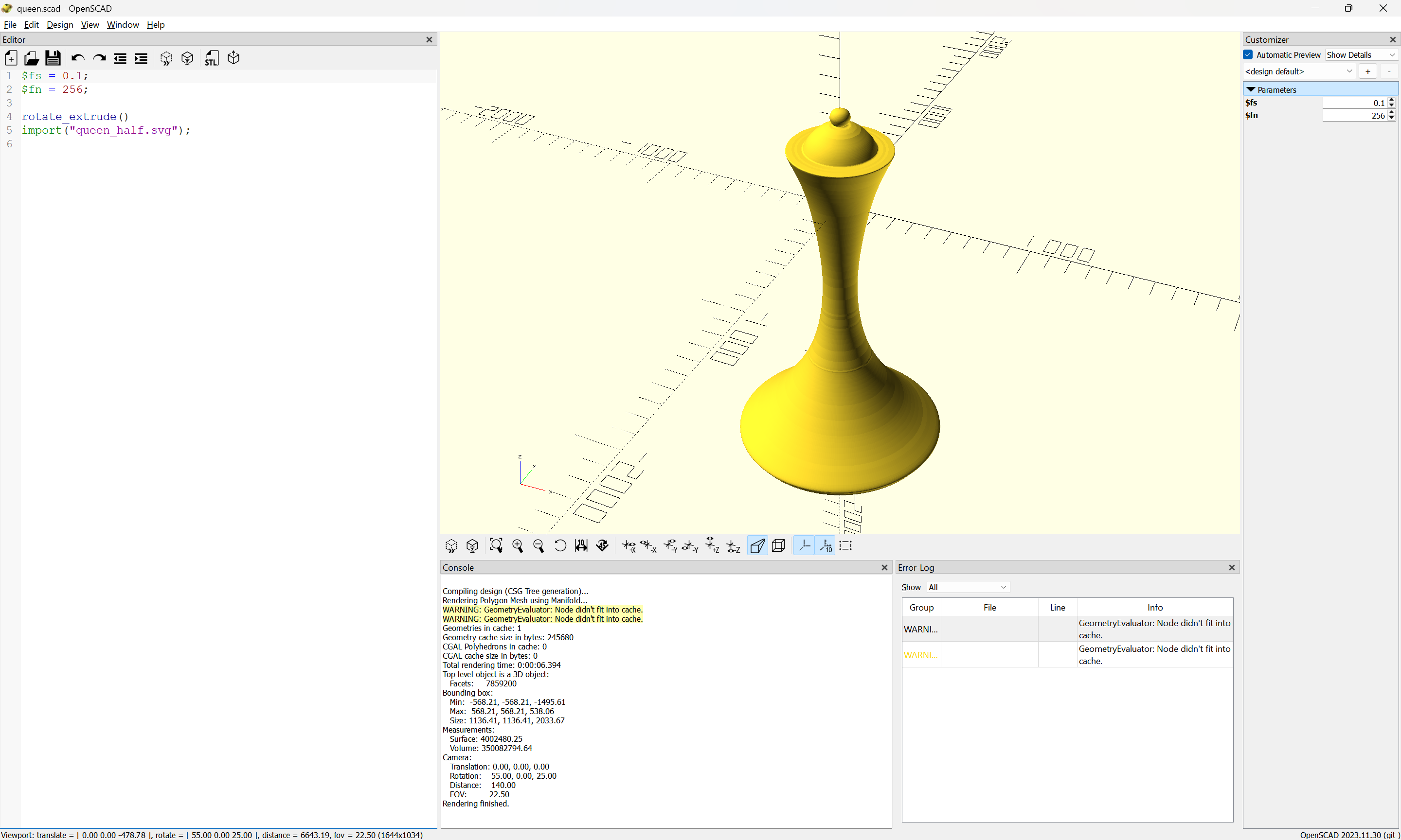

Until features for this are put in place, you will need a 3D CAD tool such as:
or a 3D programming tool such as OpenSCAD, or a great deal of patience using Carbide Create:

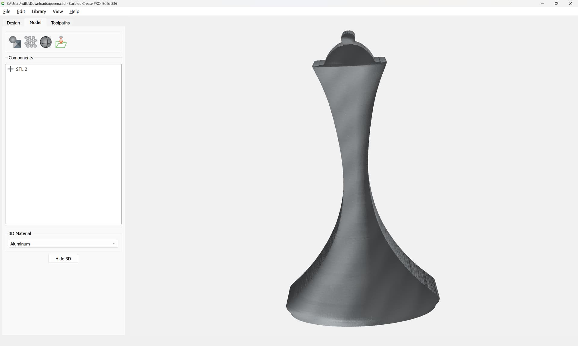

Didn’t we do this already?
In my downloads folder I have:
and:
which it was made from.
