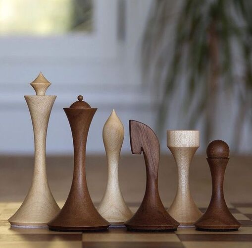

I try to make these

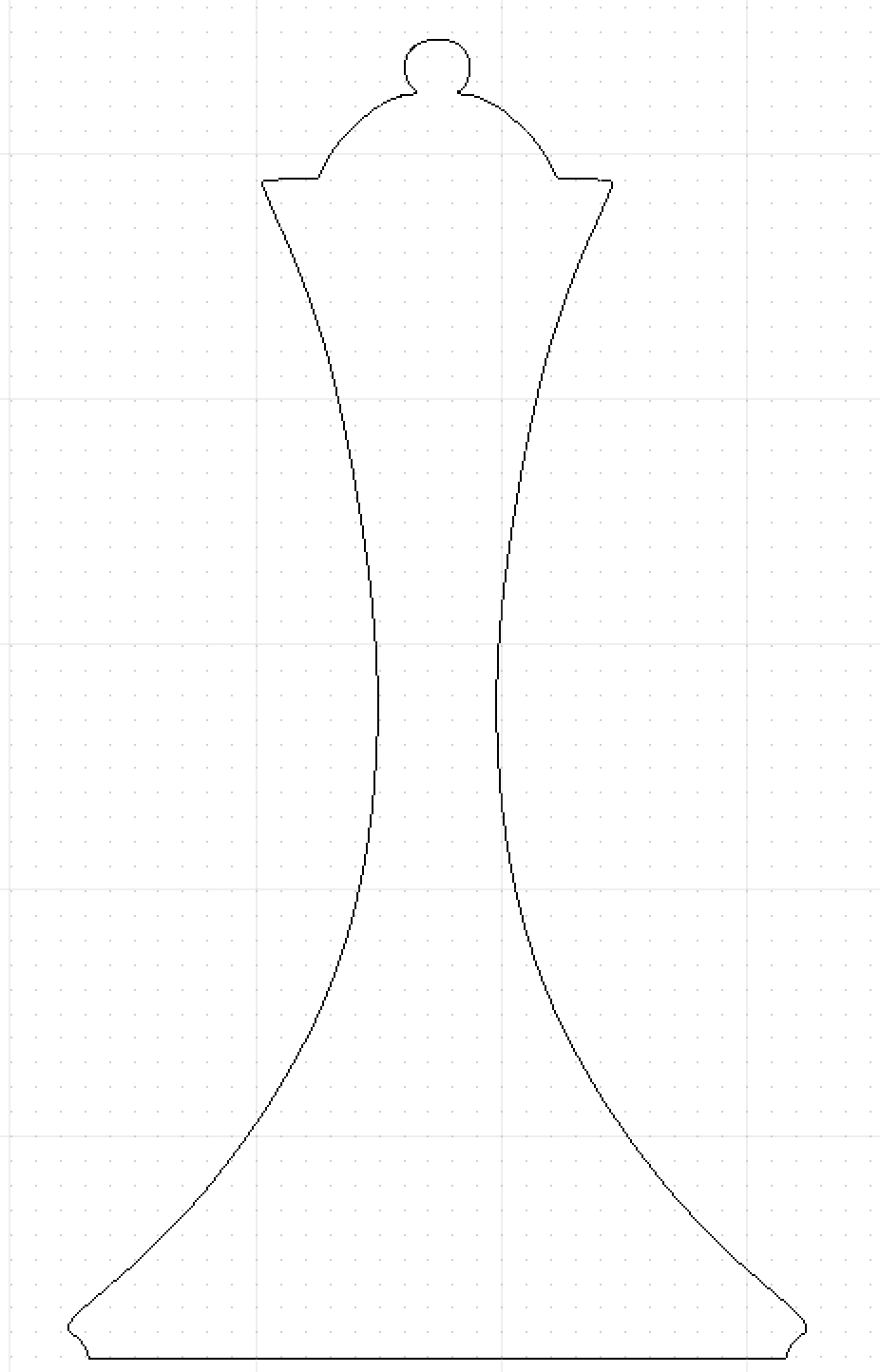

(the designer and maker Paul Joshua Schneider from Munich -he turns them on a lathe- agreed that I can make those on a CNC), so I made a DXF-file after the contour of the queen.
But I fail to get a 3d-file from it.
queen.dxf (114.1 KB)
Could one of you show me for dummies how?

My understanding is it may be that a future version of Carbide Create Pro will be able to do this sort of thing:

Until features for this are put in place, you will need a 3D CAD tool such as:
or a 3D programming tool such as OpenSCAD, or a great deal of patience using Carbide Create:

See:
this project, done in 2d
queen.c2d (60 KB)
[image]
is the first attempt to re-do this set:
[b03ae11e4a13297675e341992941fc08-3534719153]
Need some tutoring how to make a semi 3d project. I think I saw it somewhere, but cannot find it.
(I talked to the artist who designed these pieces, and he gave me allowance to do so, if I succeed I will present him my result, and maybe he agrees to sell the items. Would make me proud, so far it is the nicest set of chess pieces, nicest design, I ever sa…
@Tod1d showed a technique for doing the queen in Carbide Create which was quite clever.

OMG! That far ago already. I probably could have used the search function better. Thank you all anyway!
