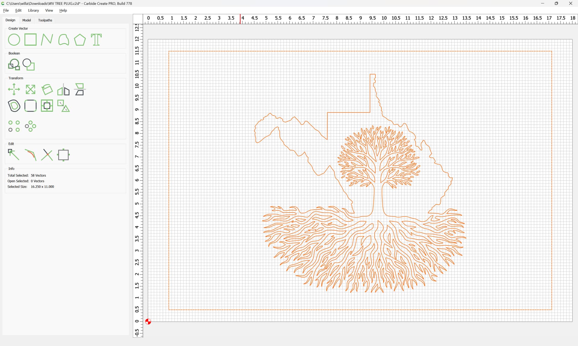

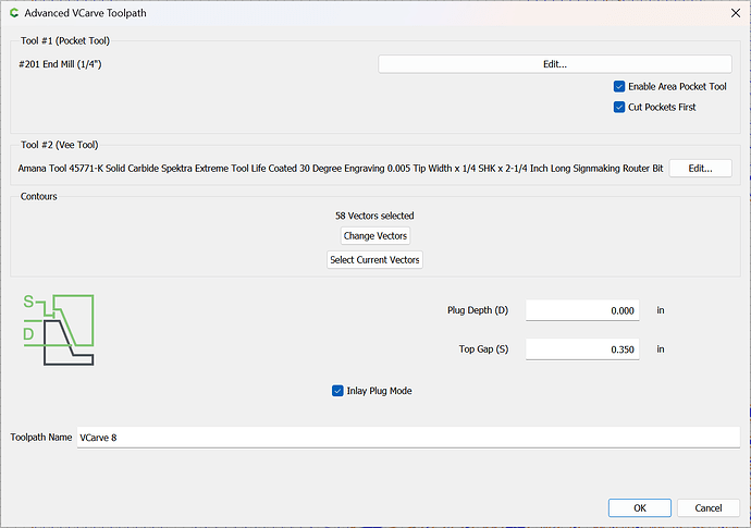

I need help on inlay
for some reason it is not creating the plug for the inlay?
here is my file
WV TREE PLUG.c2d (1.3 MB)
If you add geometry:
and then update things:
do you not get a plug?
in the design I dont see the plug.
I just tried and it did a mirror inlay but no plug
I even did training last night on this and shared screen but I am not getting the results.
the inlay is .35" deep so I am not getting the results and I dont want to mess up another end grain

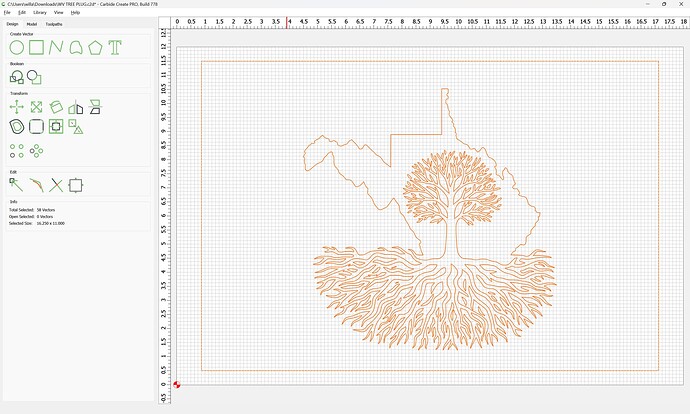

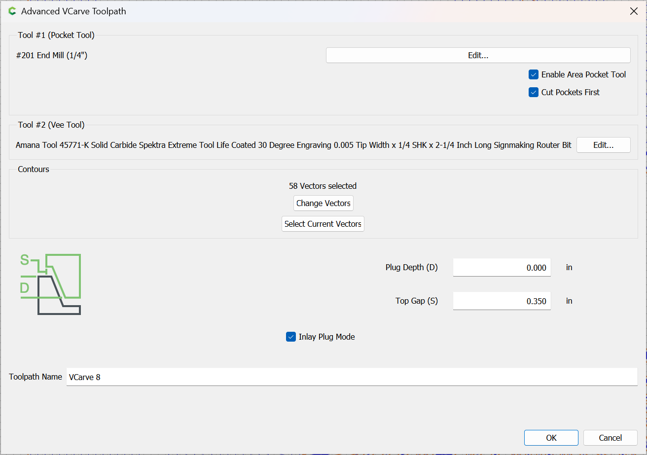

You will need to mirror things as noted at:
I think I have it now not sure just take a look at the file
This shows in simulation and looks right I think
WV TREE PLUG FINAL.c2d (1.5 MB)
Also I am using pro V7 and V8 beta but that was done in V7
