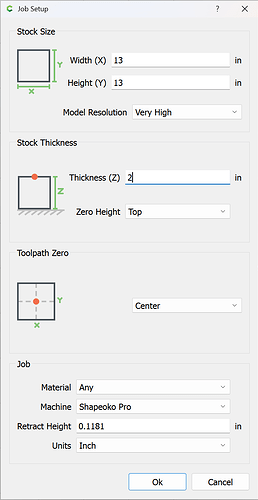

Workpiece size: 12” x 12” x 2” thick

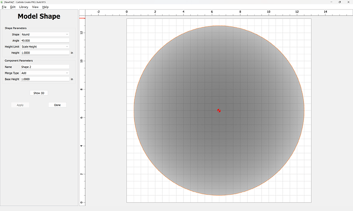

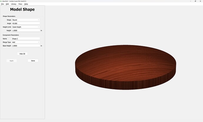

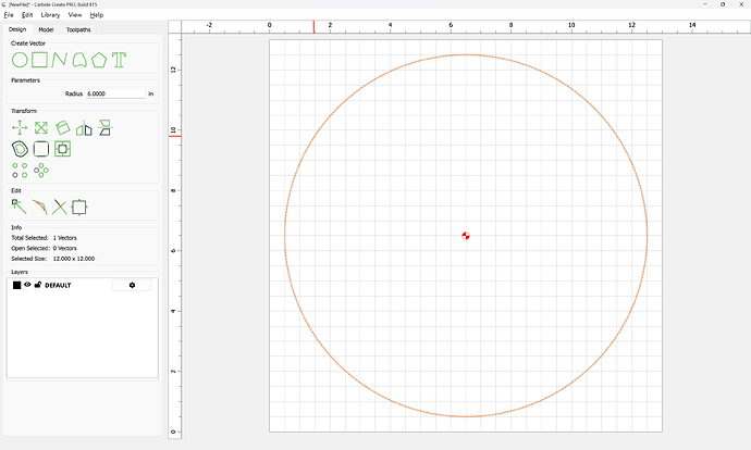

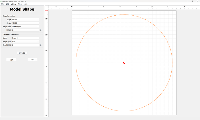

This shape can be easily made in Carbide Create Pro w/o a 3rd party program:
Apply
Show 3D
