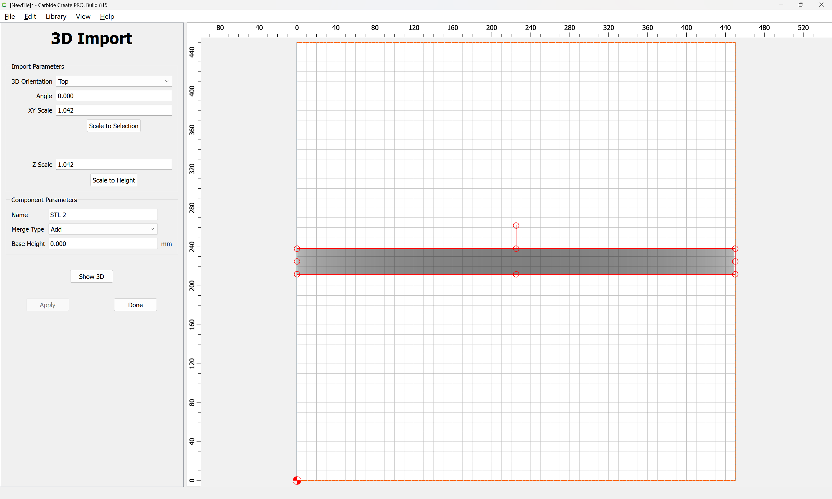

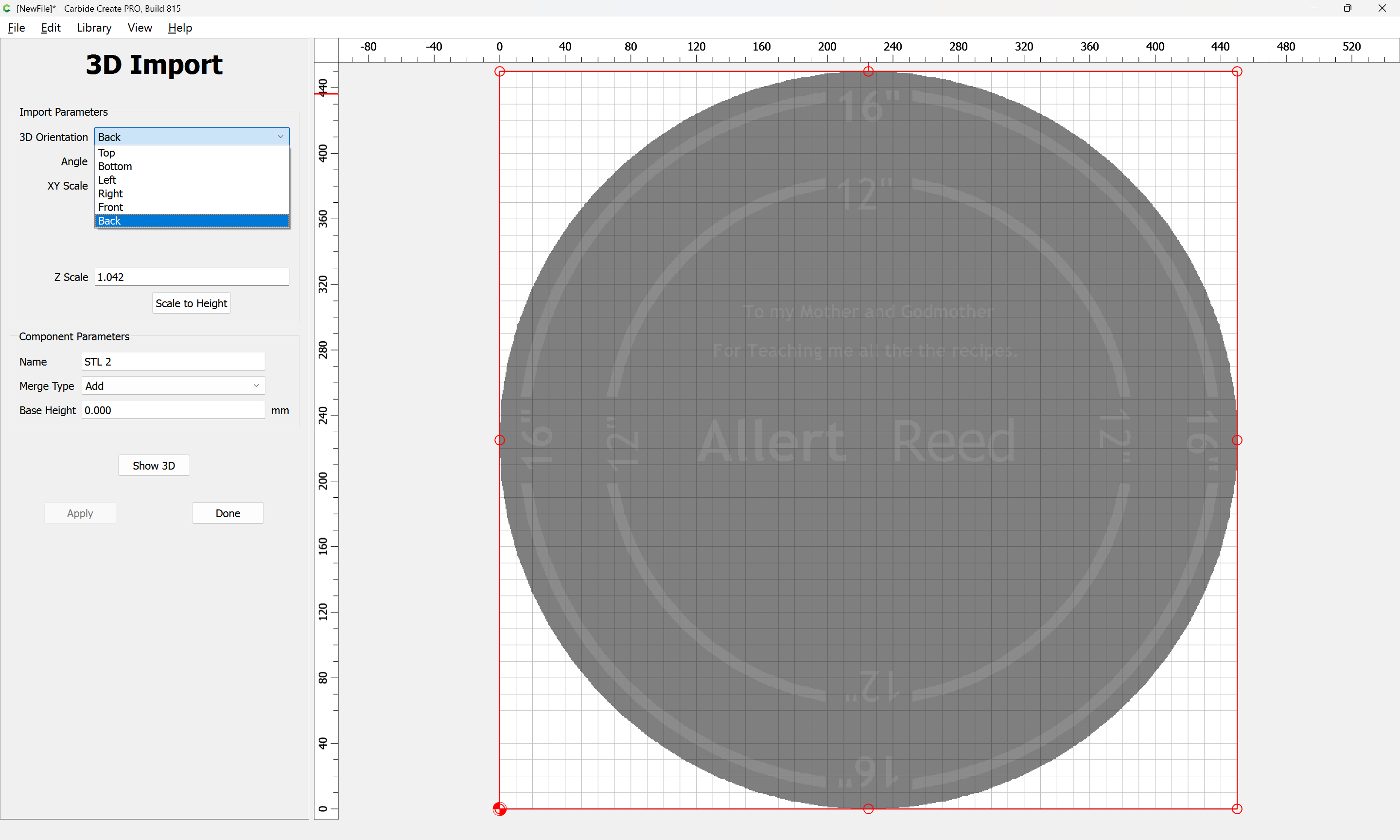

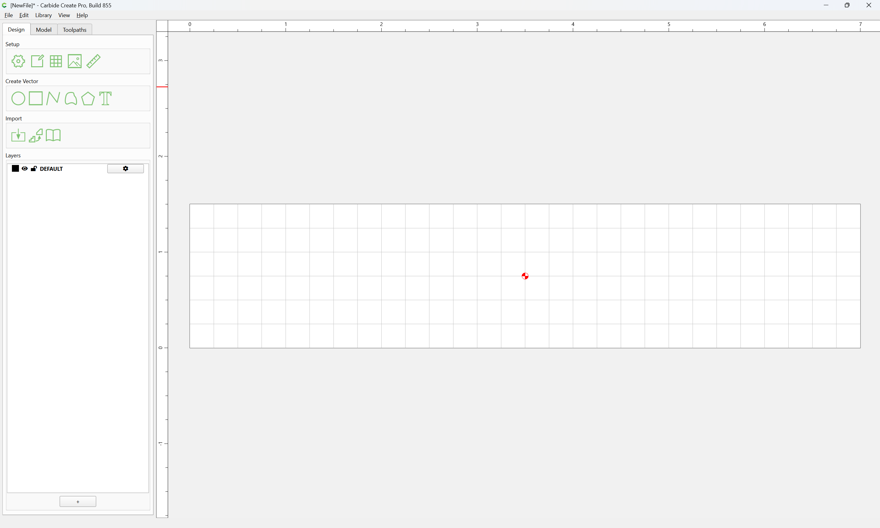

as requested on support…

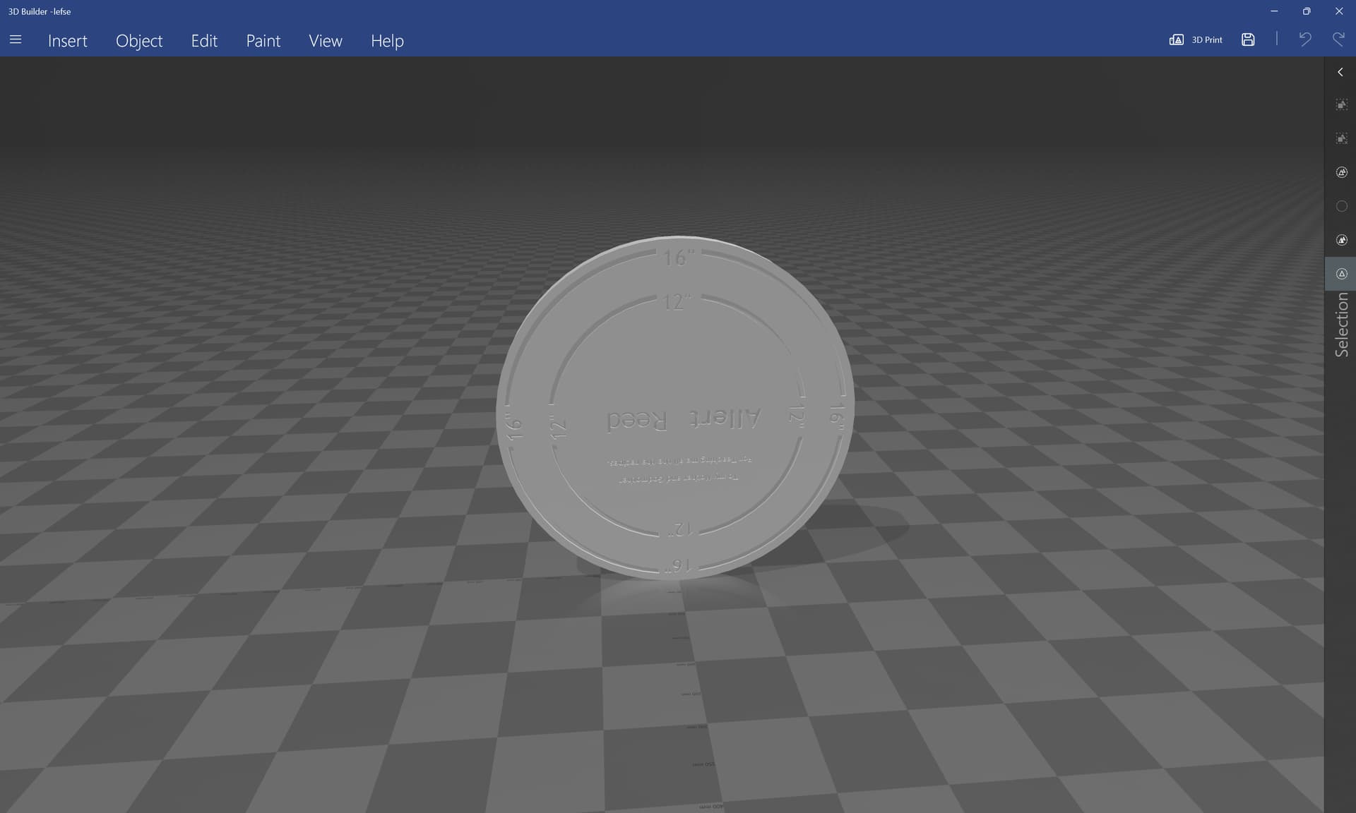

given an STL:

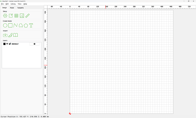

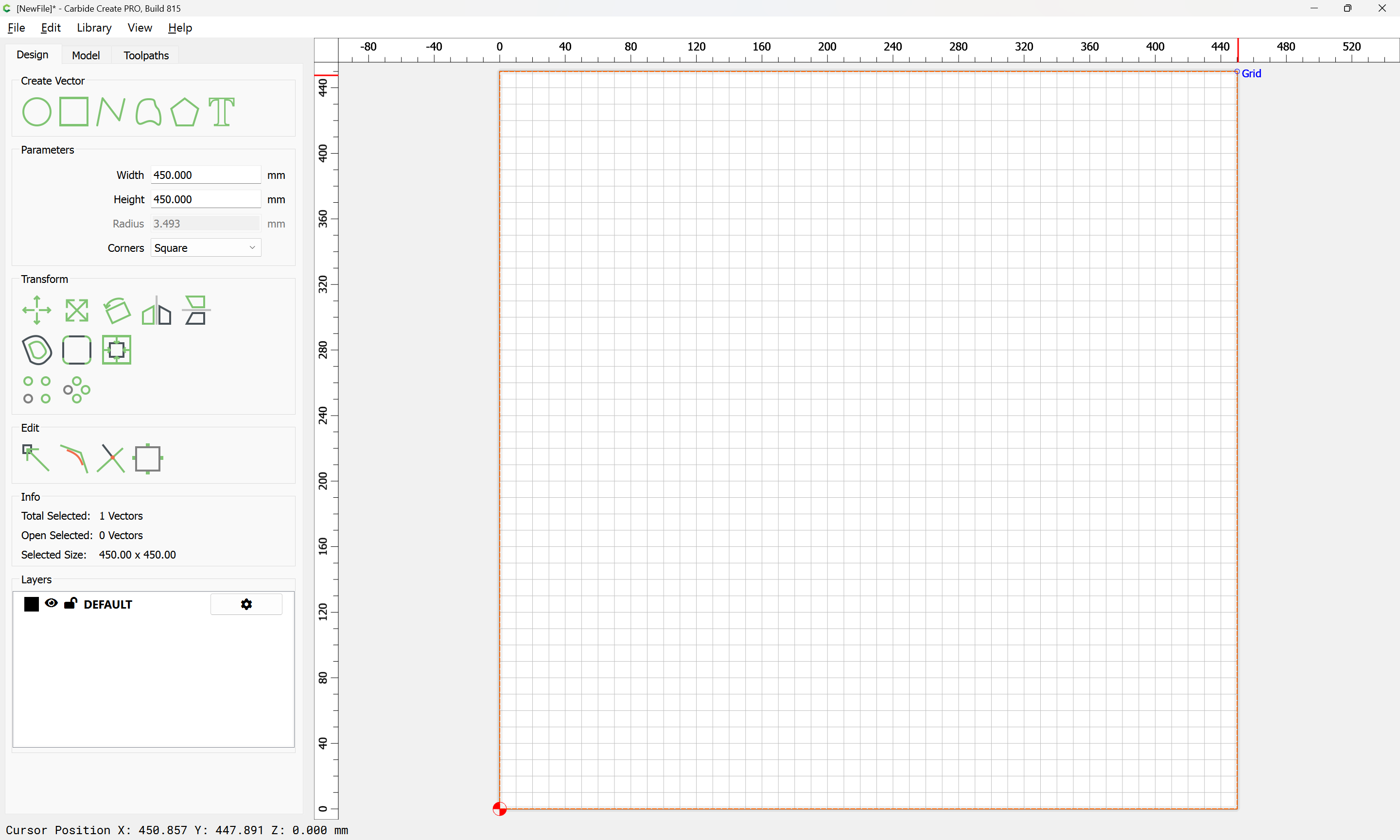

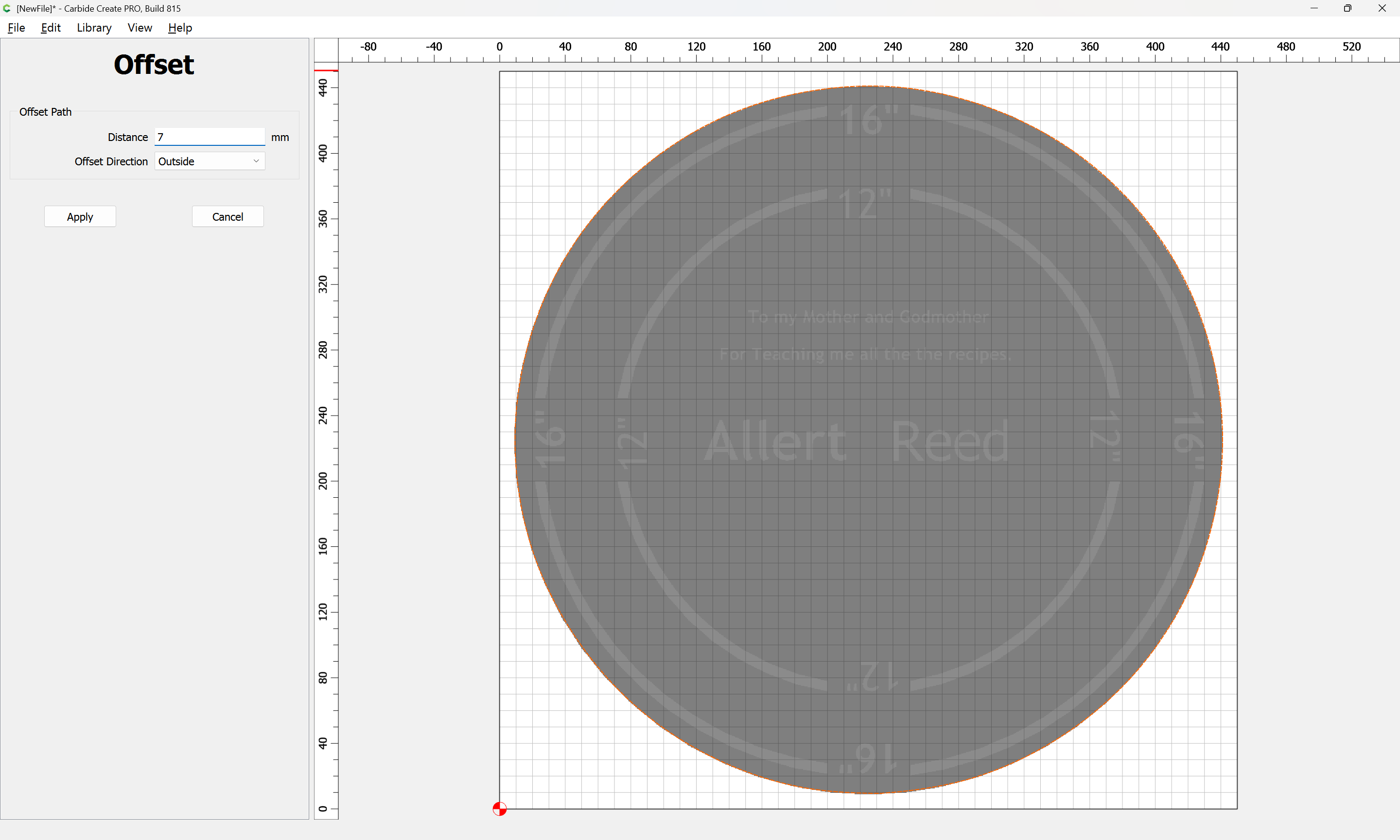

to import this into Carbide Create Pro one would:

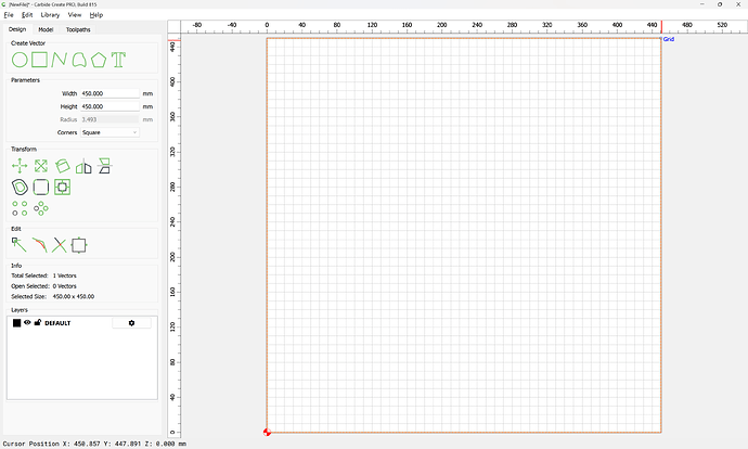

draw geometry to define where the import will be centered:

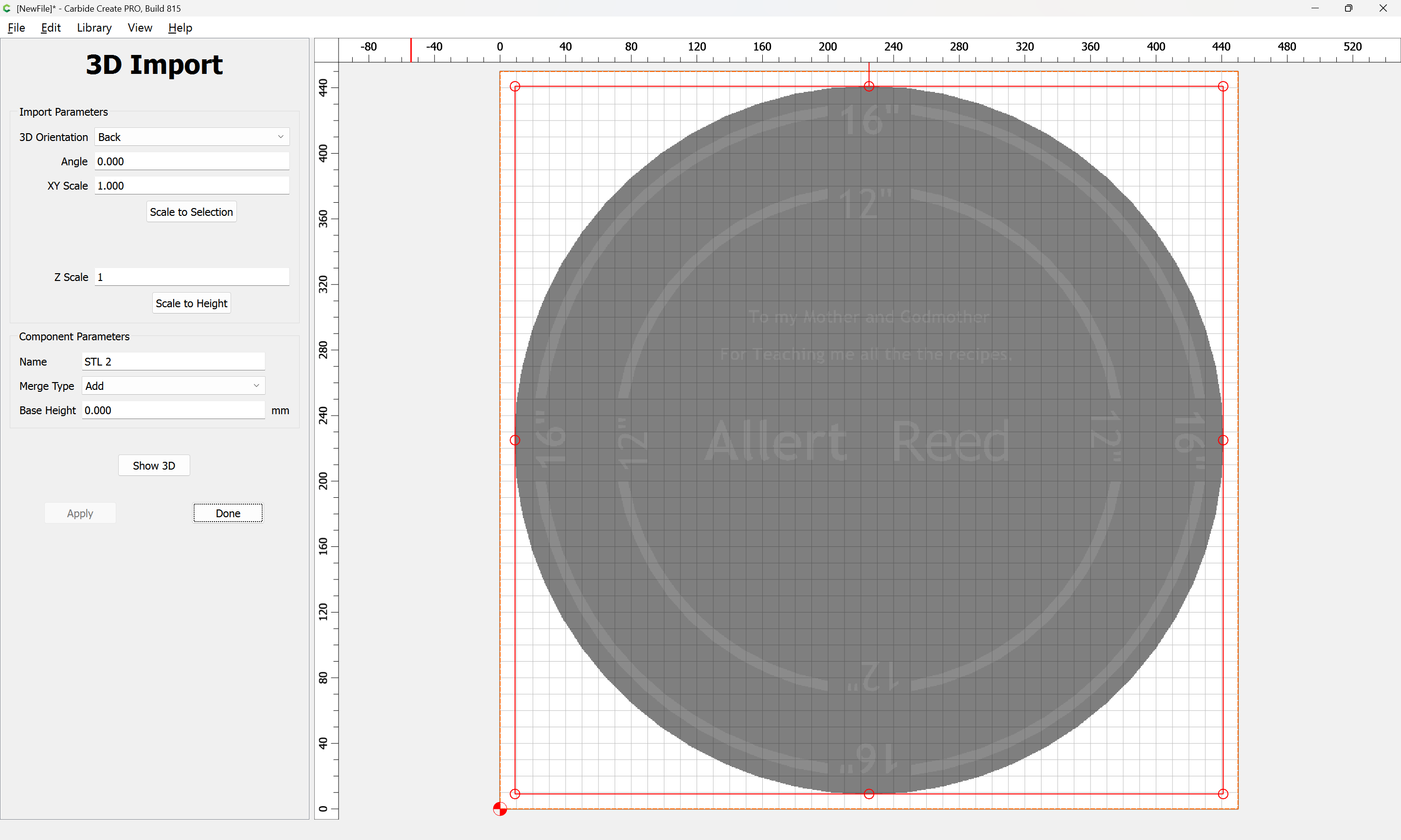

and Import STL: Introduction
selecting the file in question:
and then selecting the desired face:
and setting other options as desired:

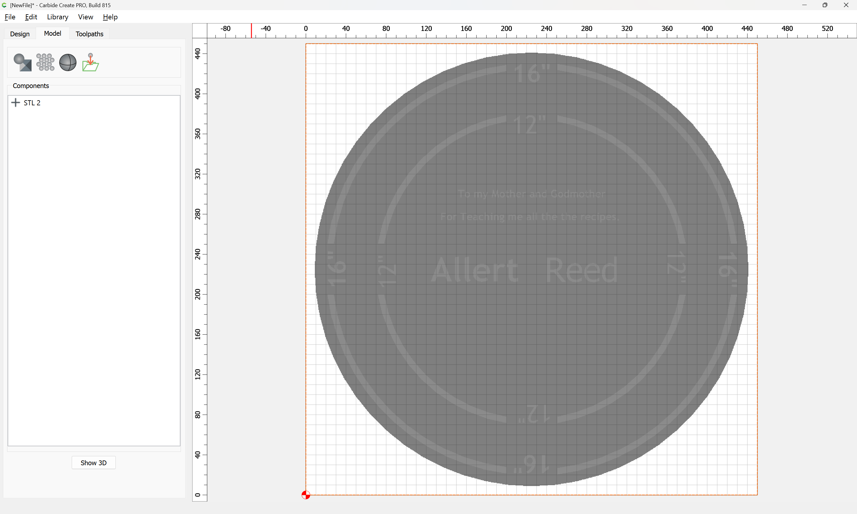

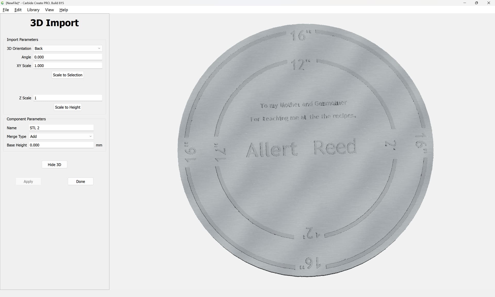

and confirming the 3D preview:
Done

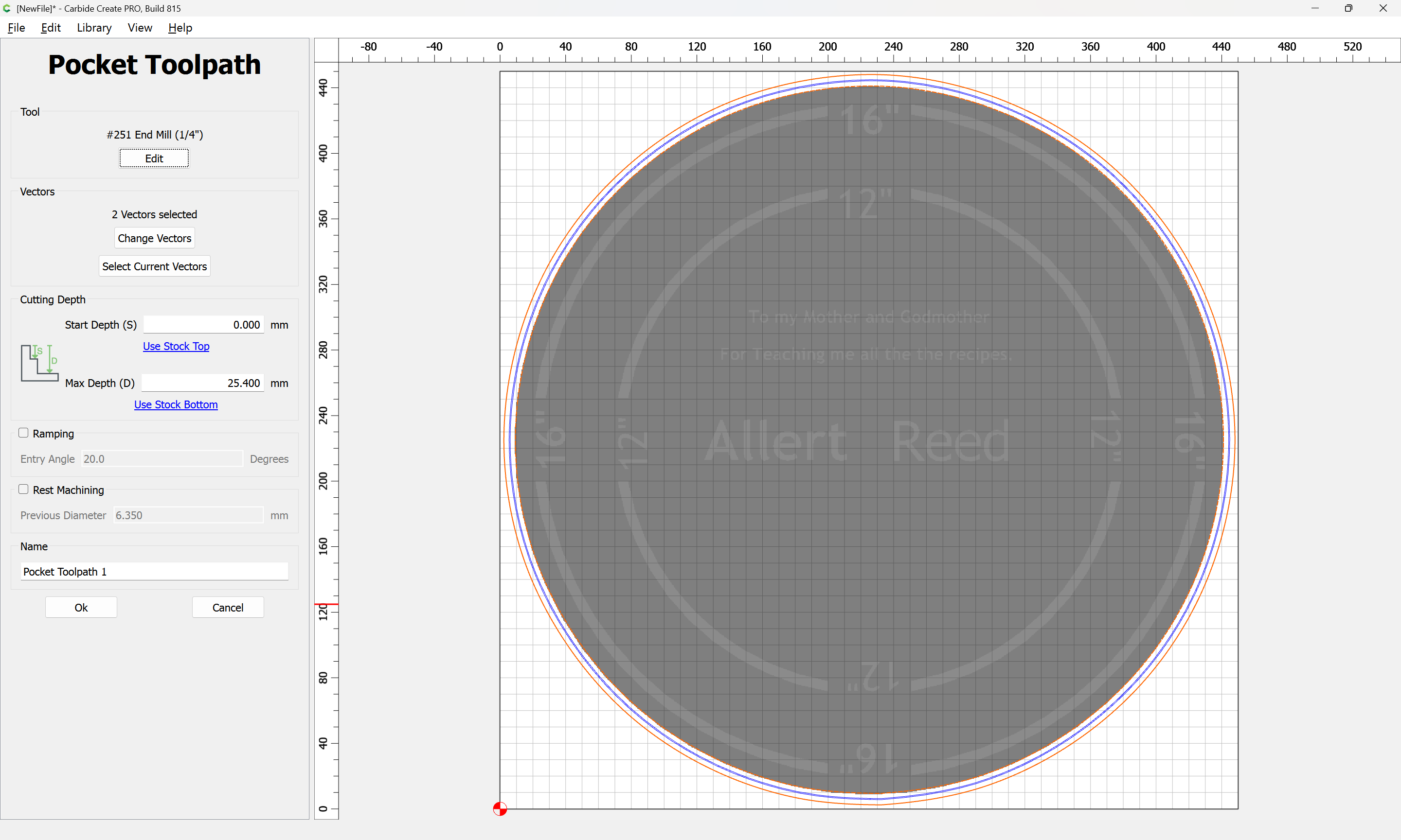

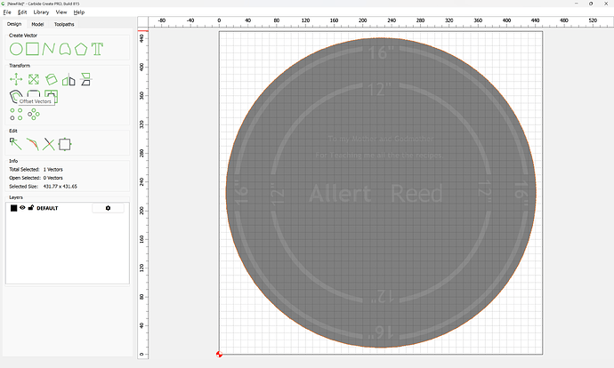

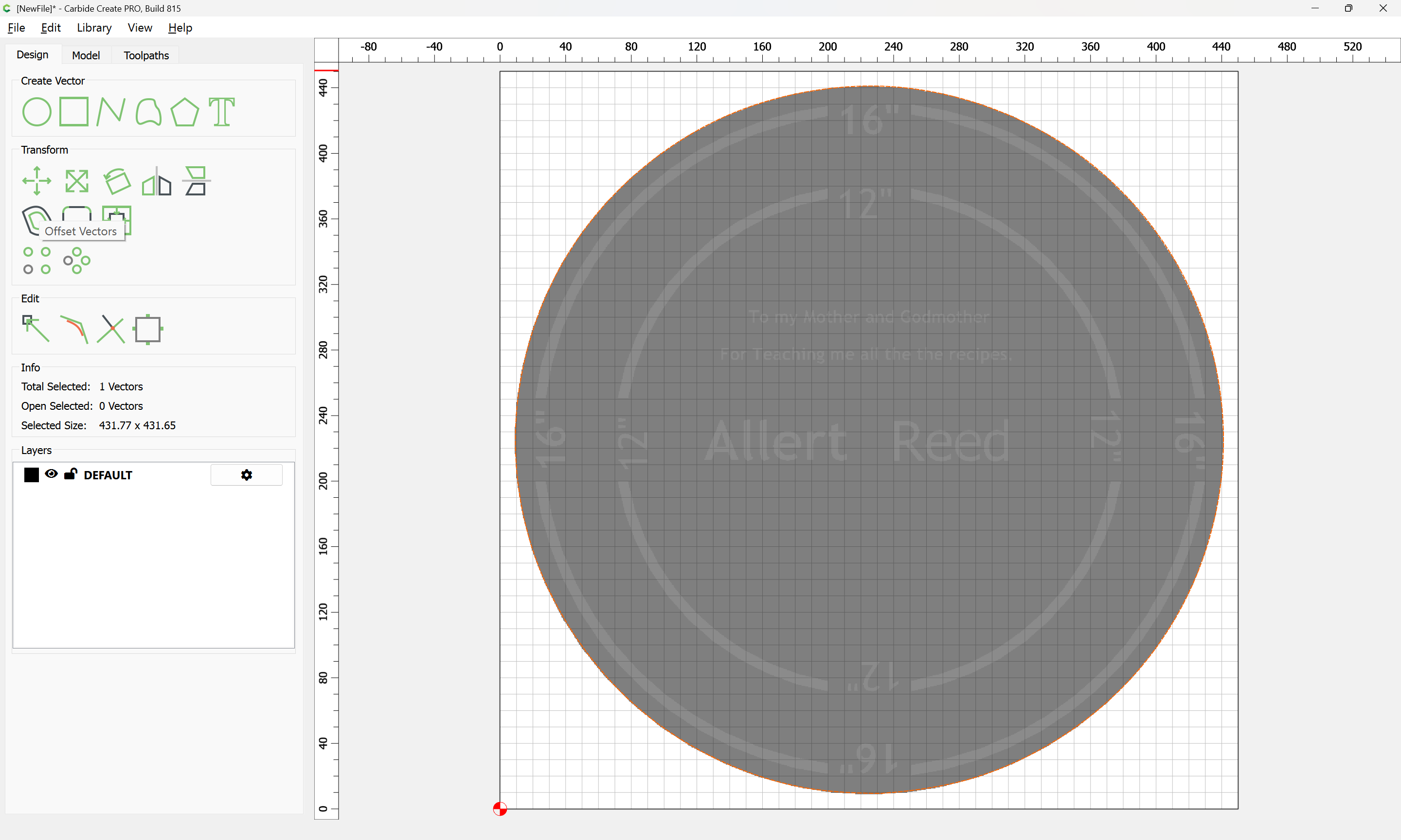

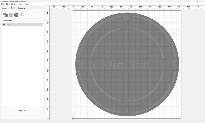

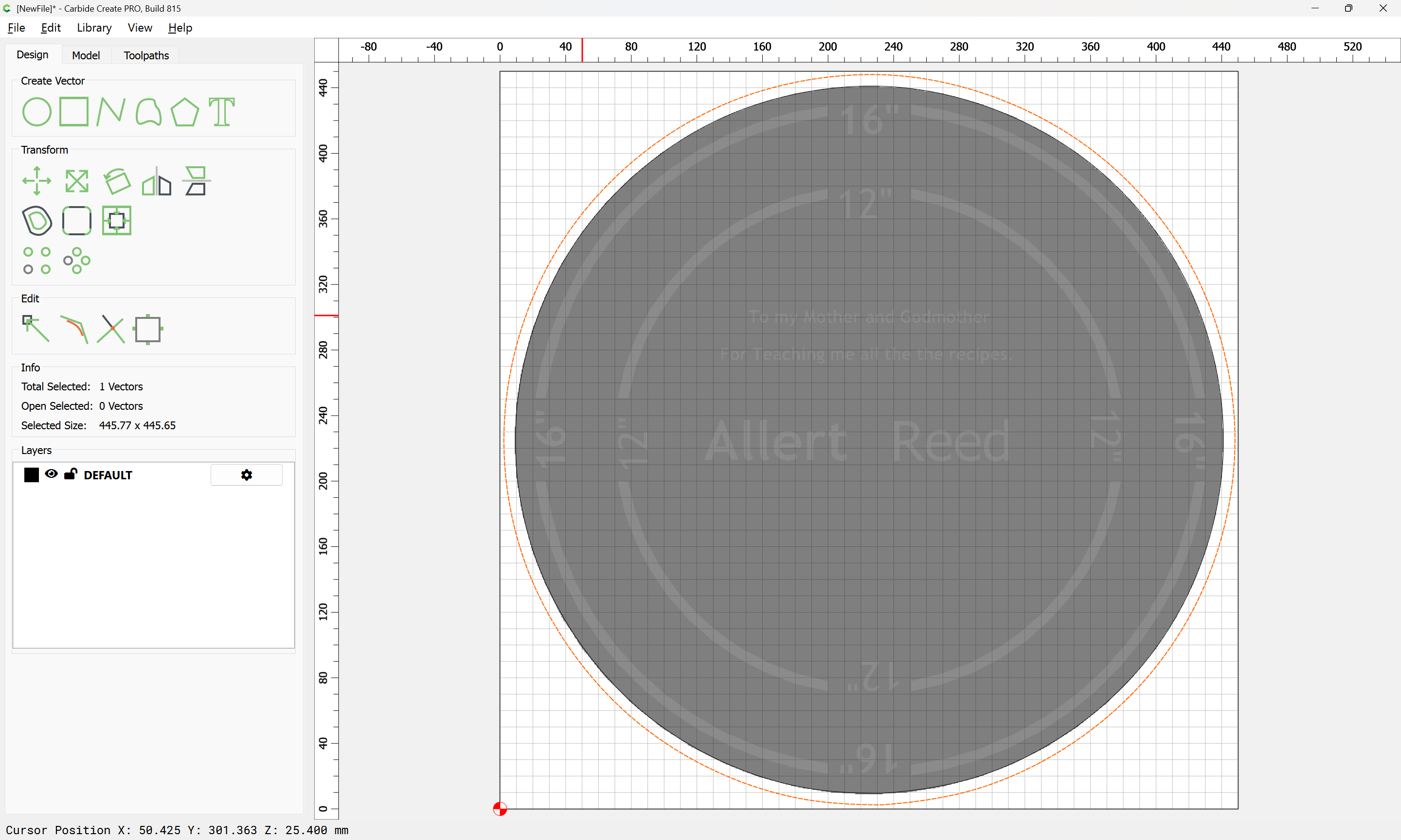

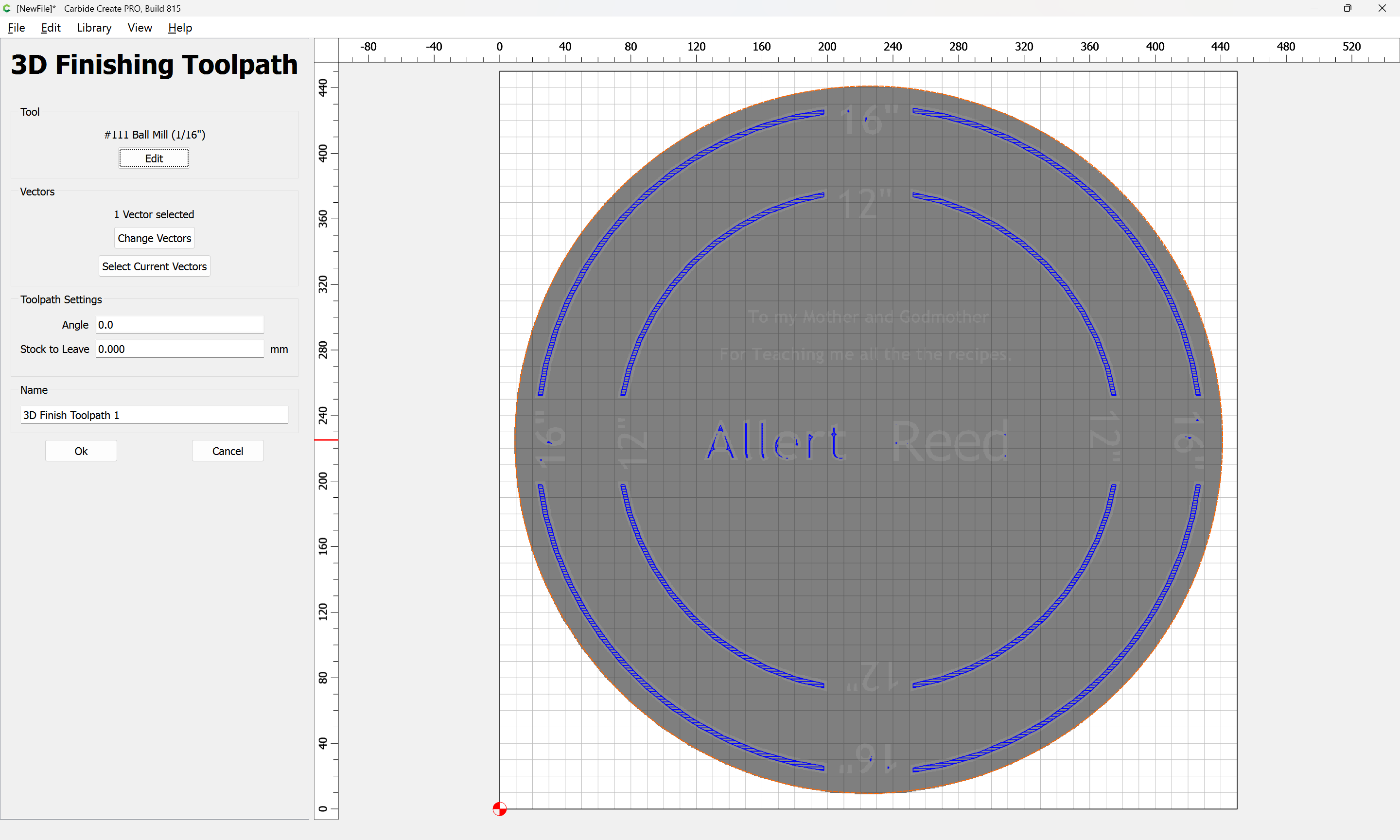

If desired, trace the outline/design:
OK

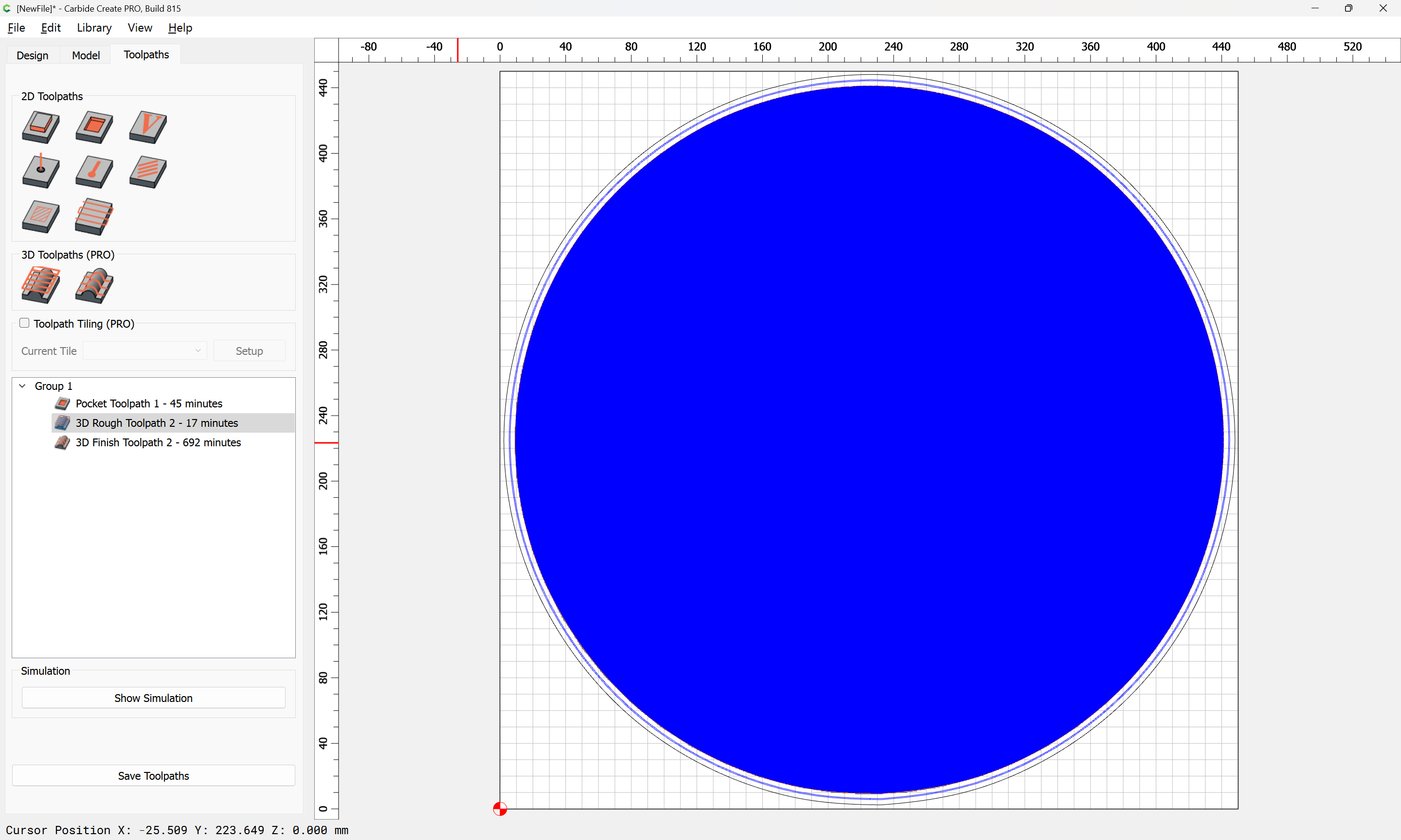

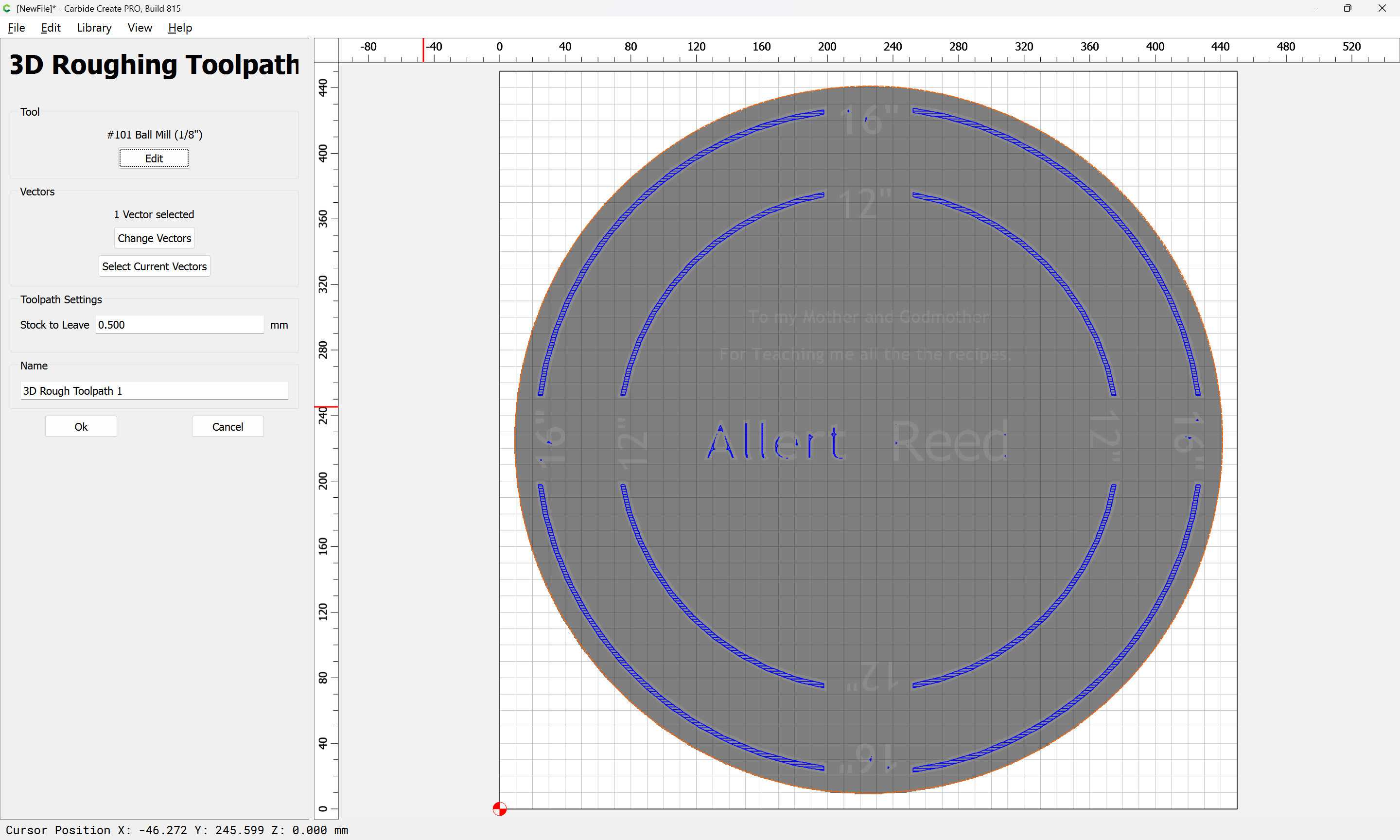

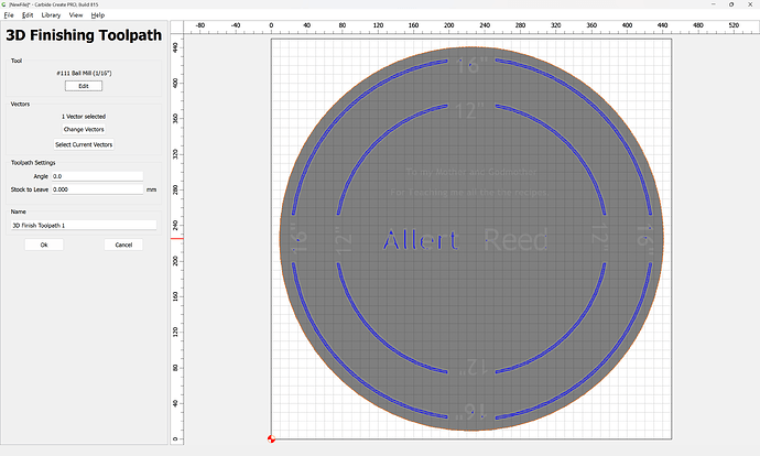

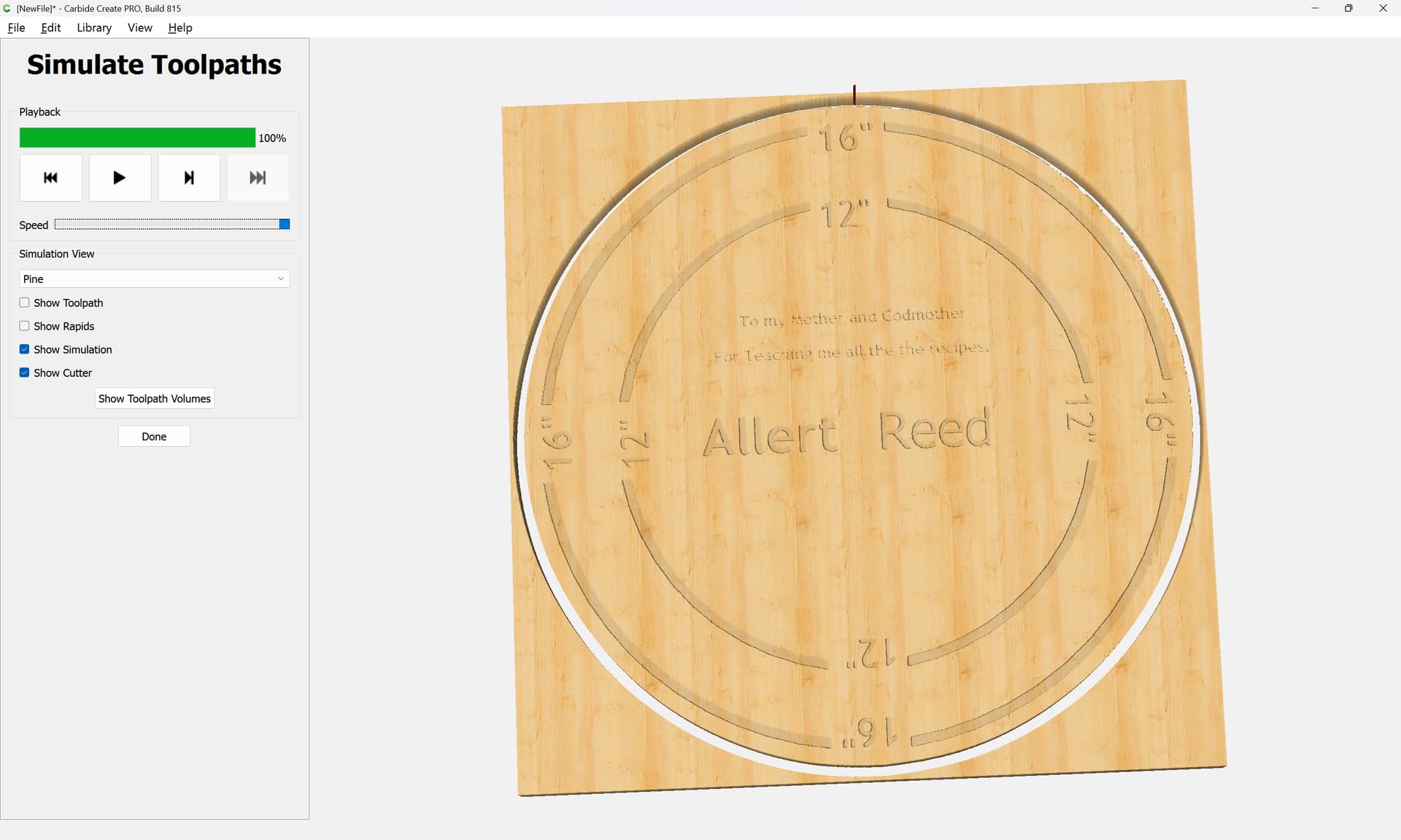

This geometry may then be used to assign 3D toolpaths:

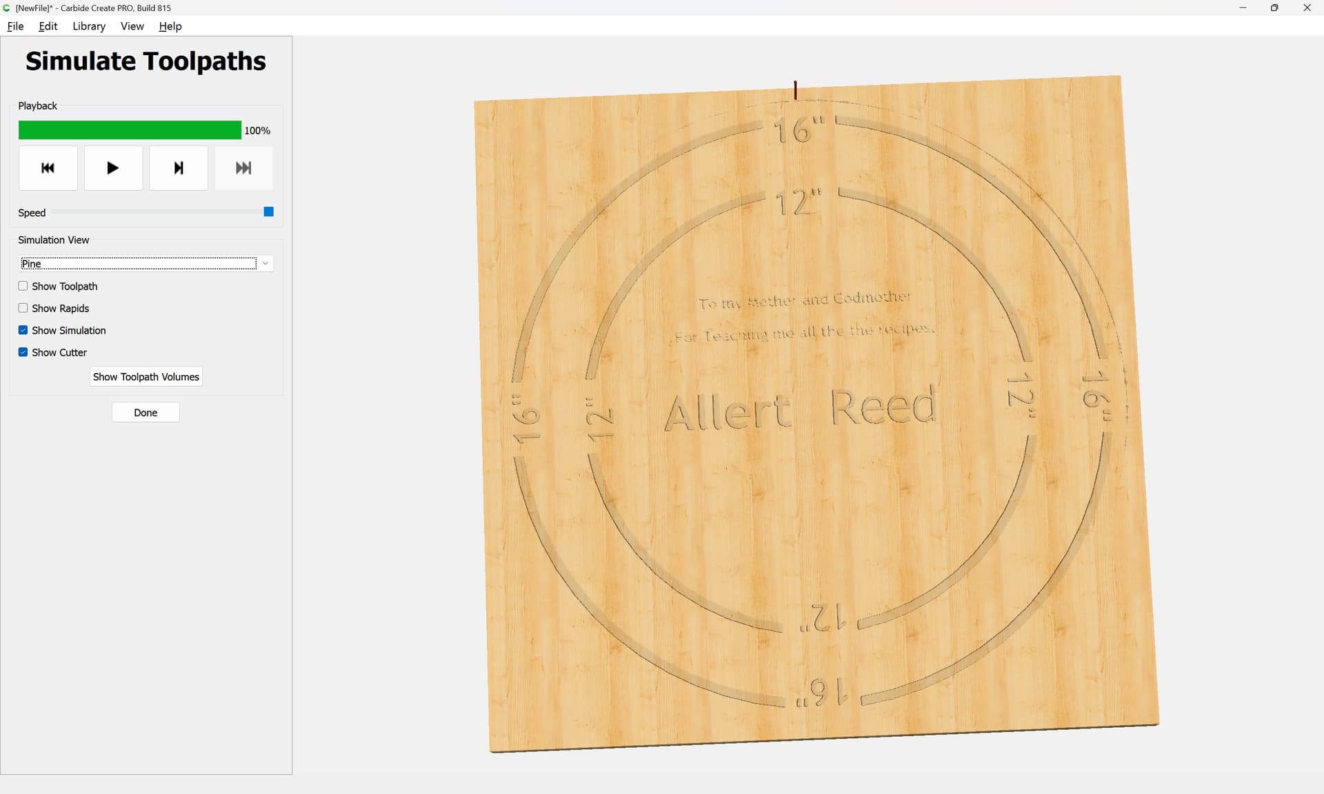

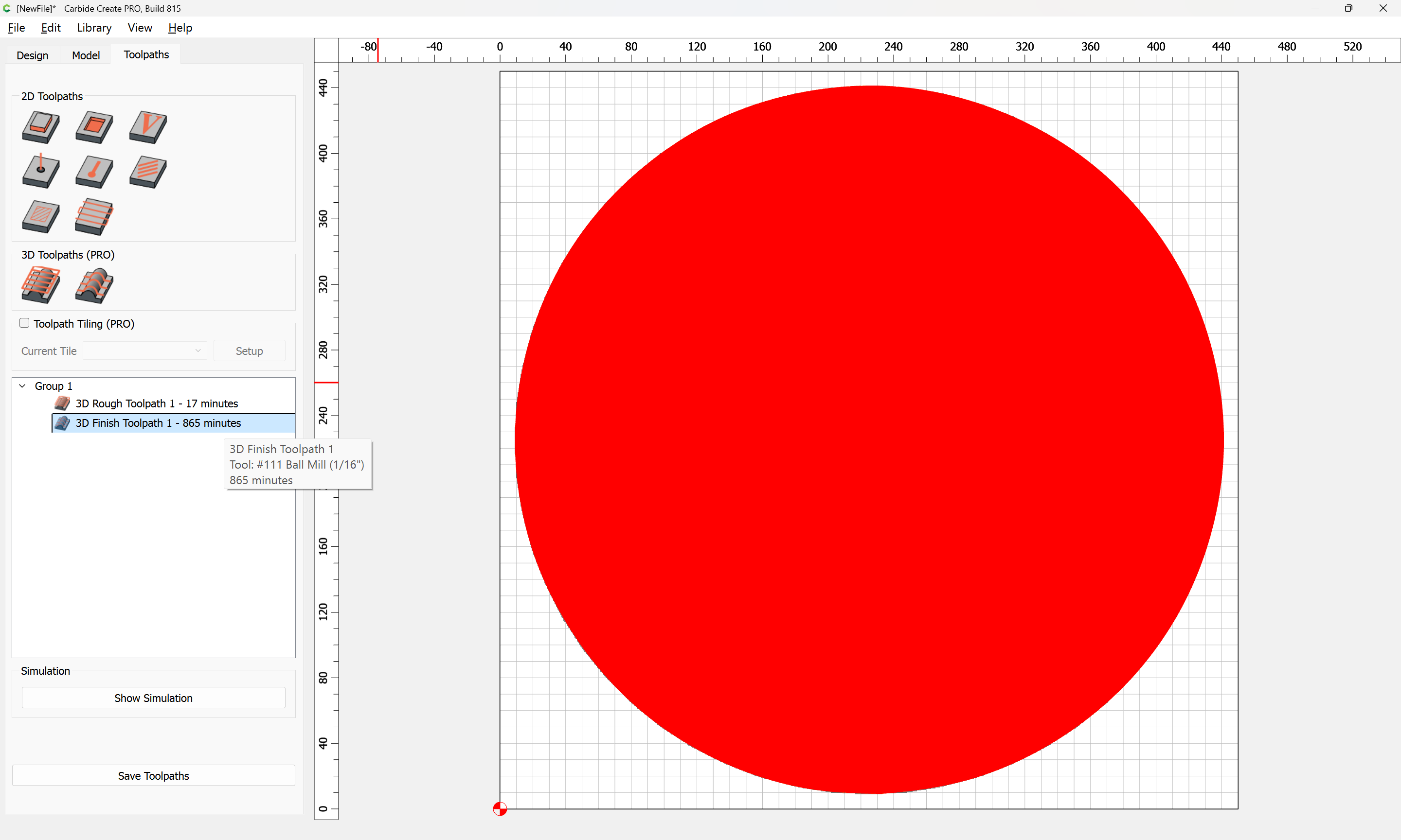

which previews as:

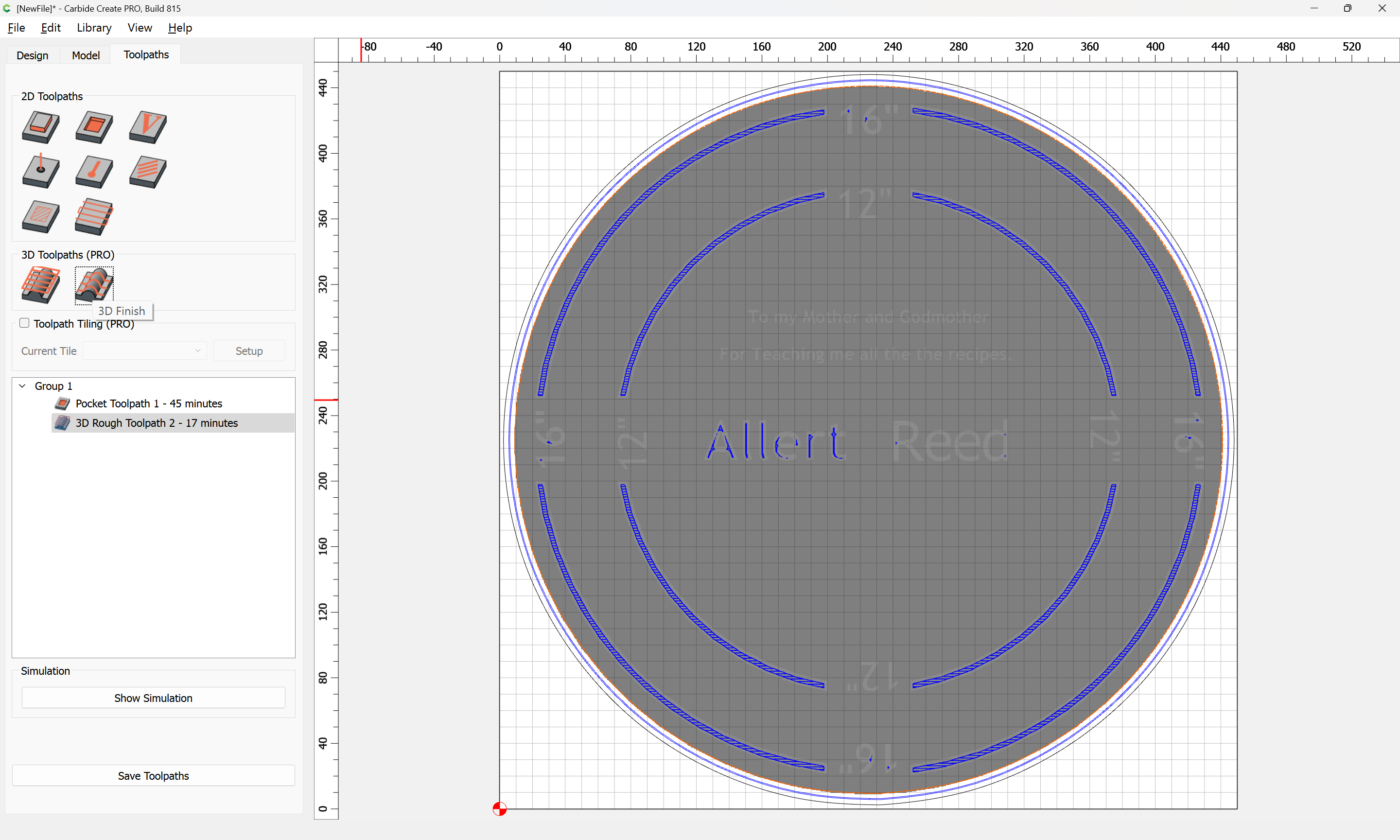

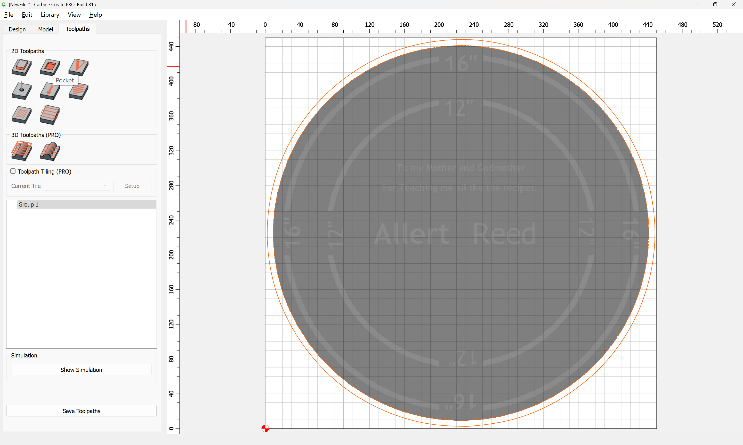

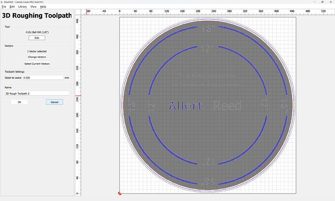

The outline geometry may also be used to cut the design out:
Apply

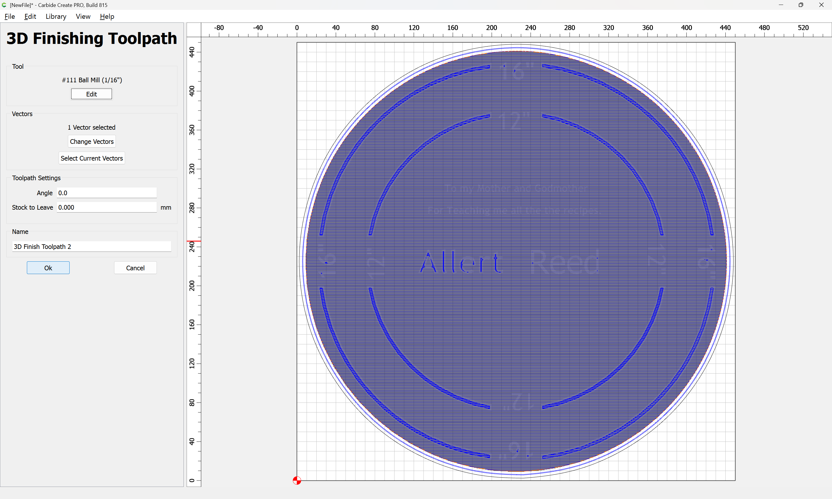

and 3D toolpaths may be used to cut out the design:
That said, it would probably be better to re-create this design and use a V carving.

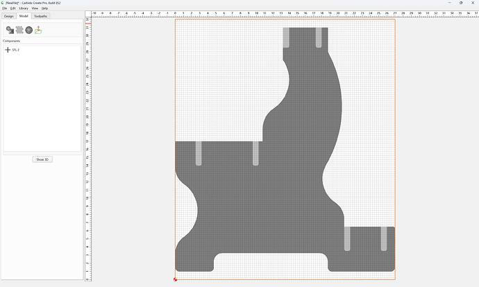

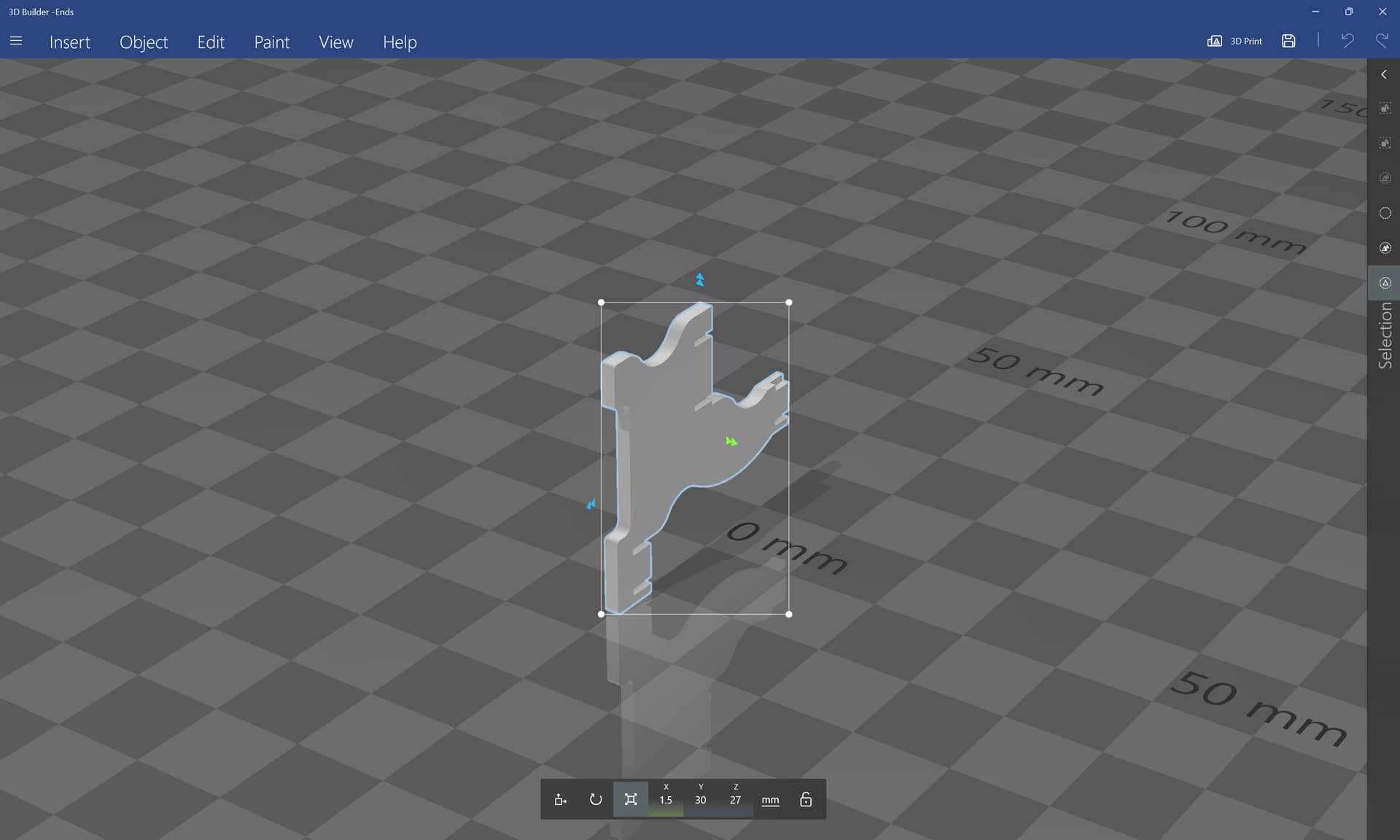

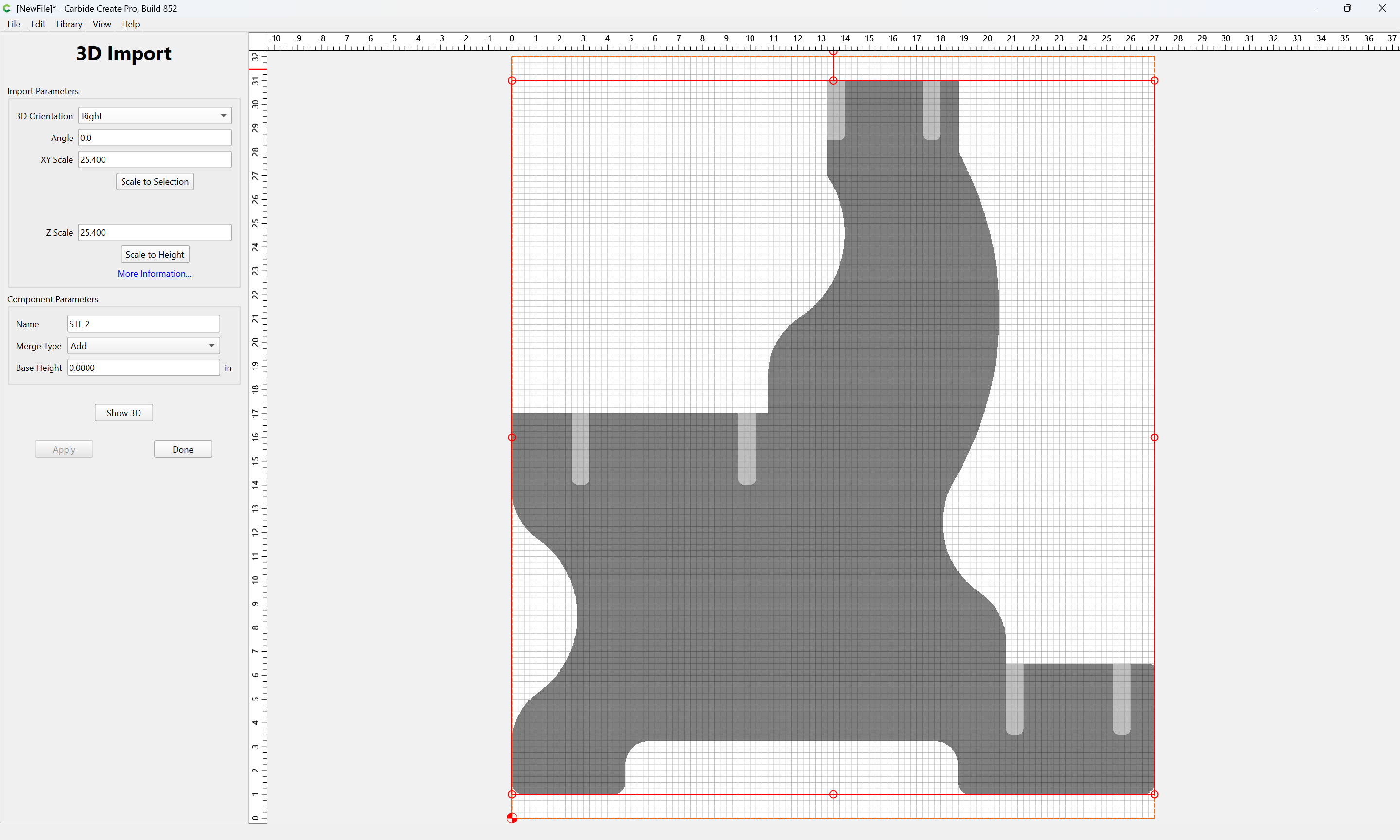

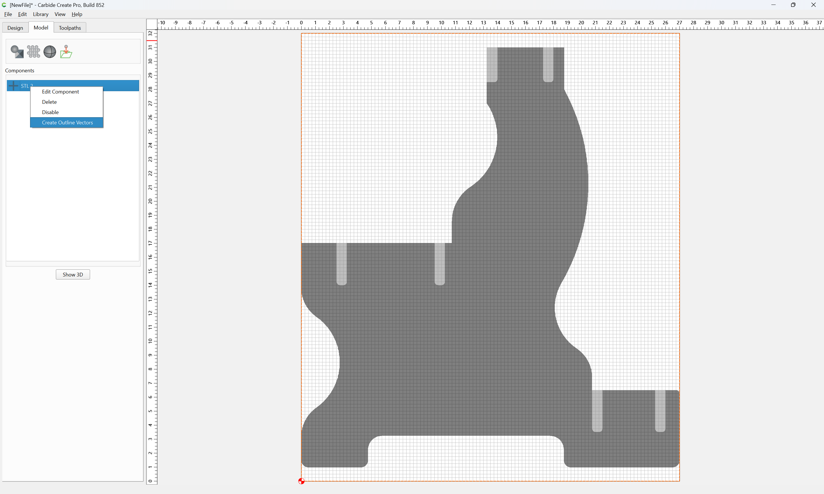

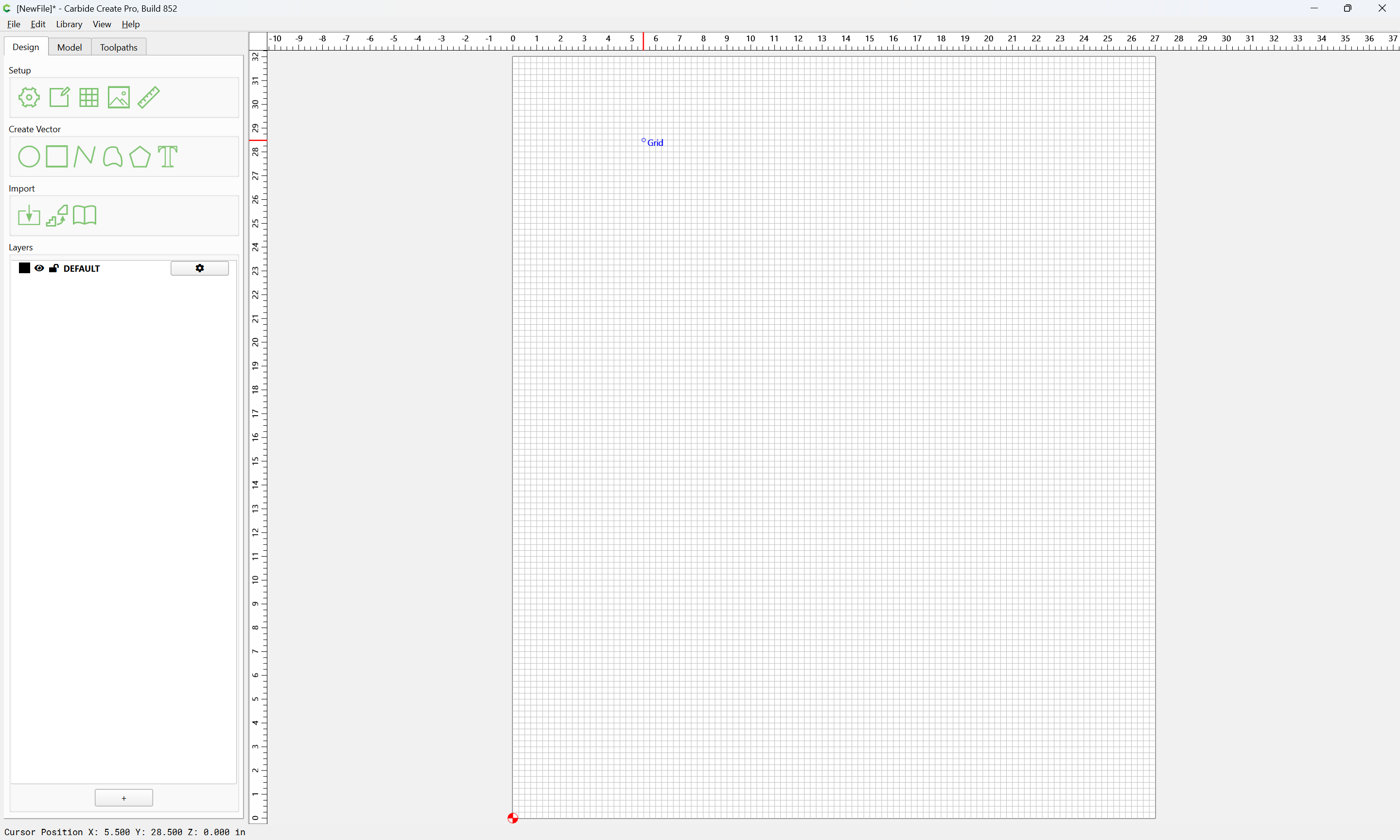

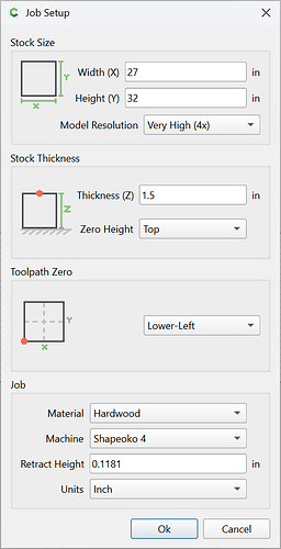

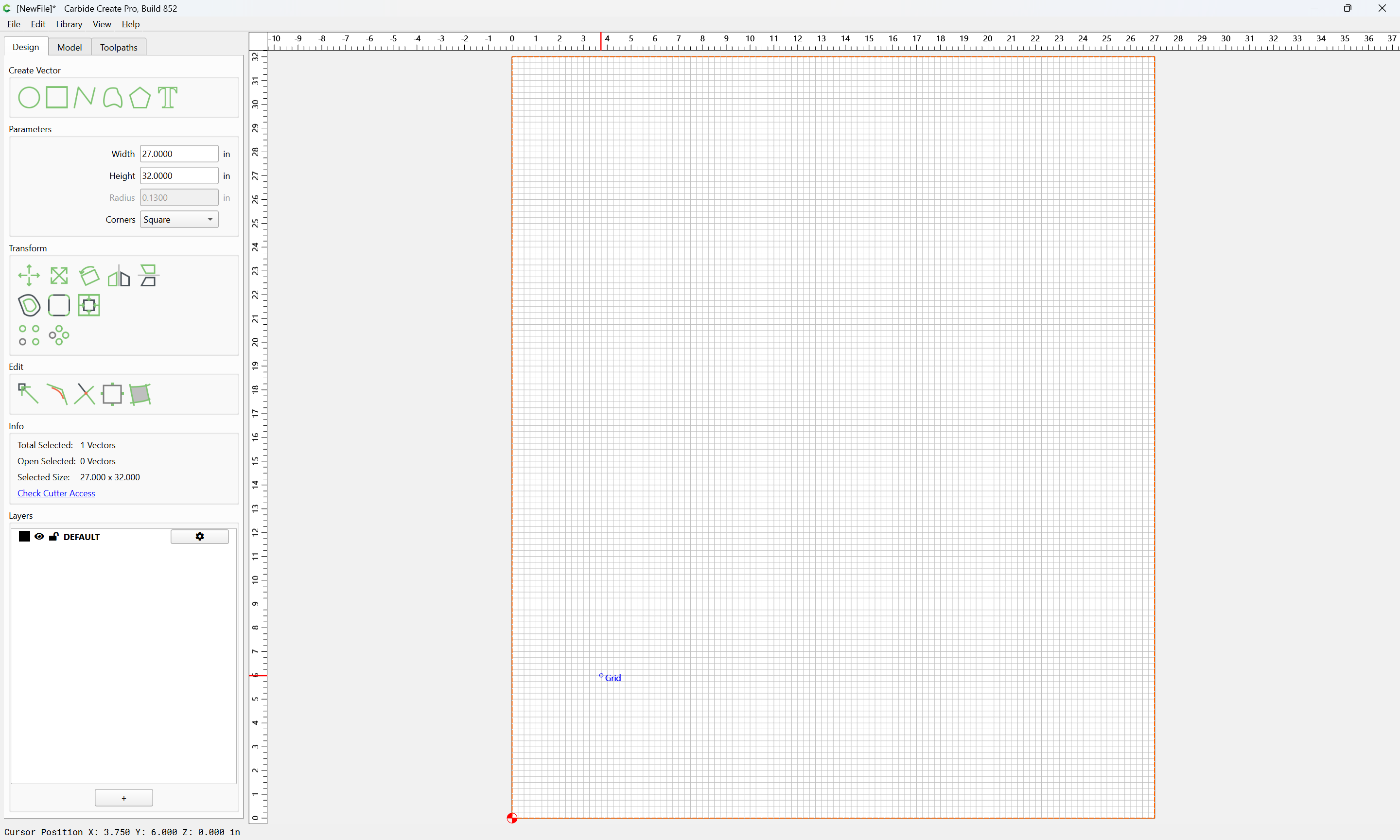

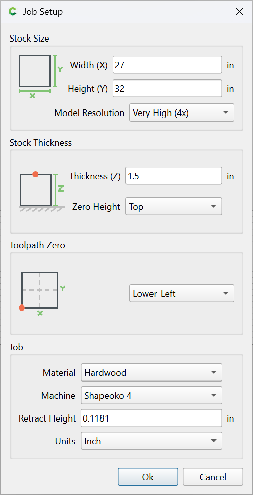

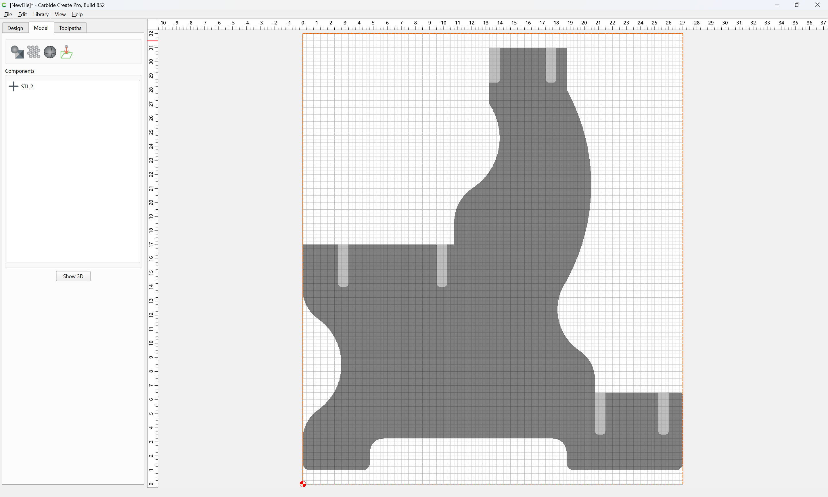

I’m having trouble modeling the attached STL file. It is supposed to be an end of a church pew with mortises to be cut out. The actual dimensions are 1.5 thick, 26" wide, 31.25" high.
where the file is:

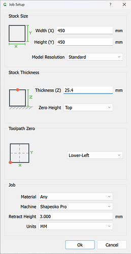

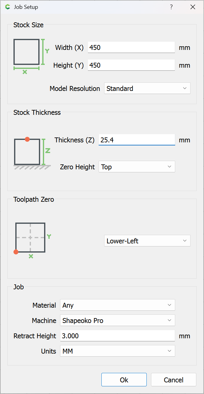

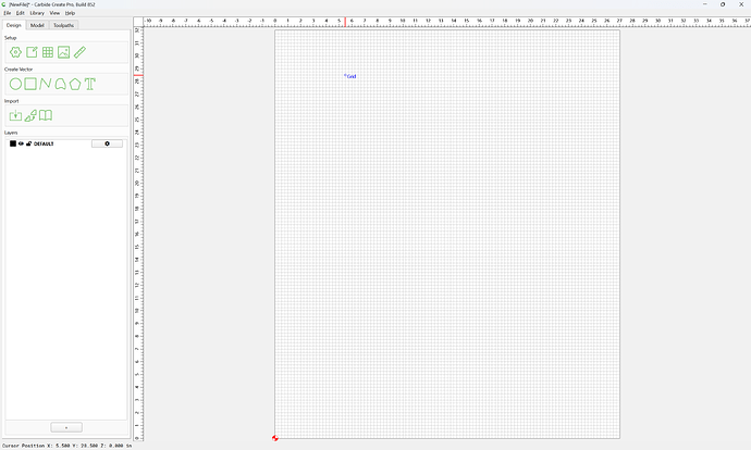

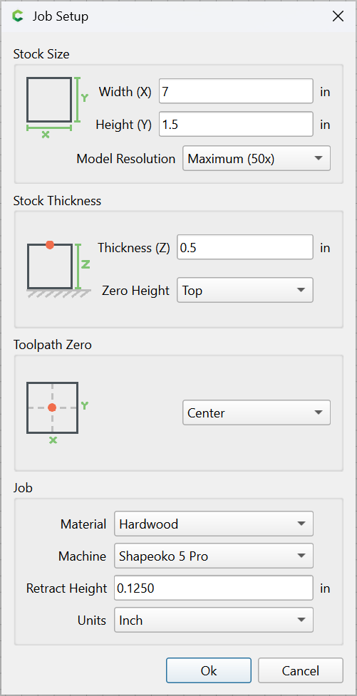

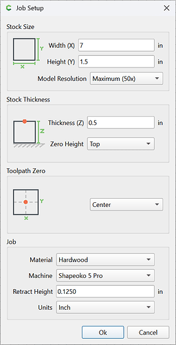

First, Job Setup:
OK

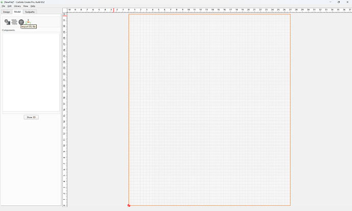

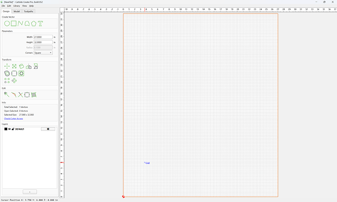

Draw a rectangle for the import:

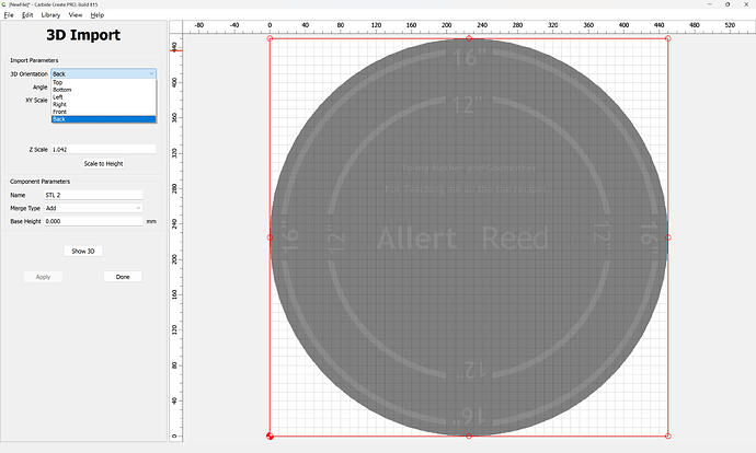

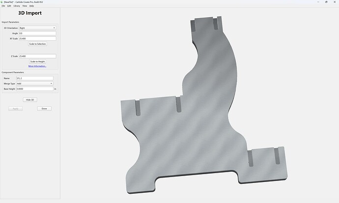

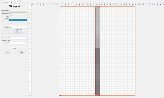

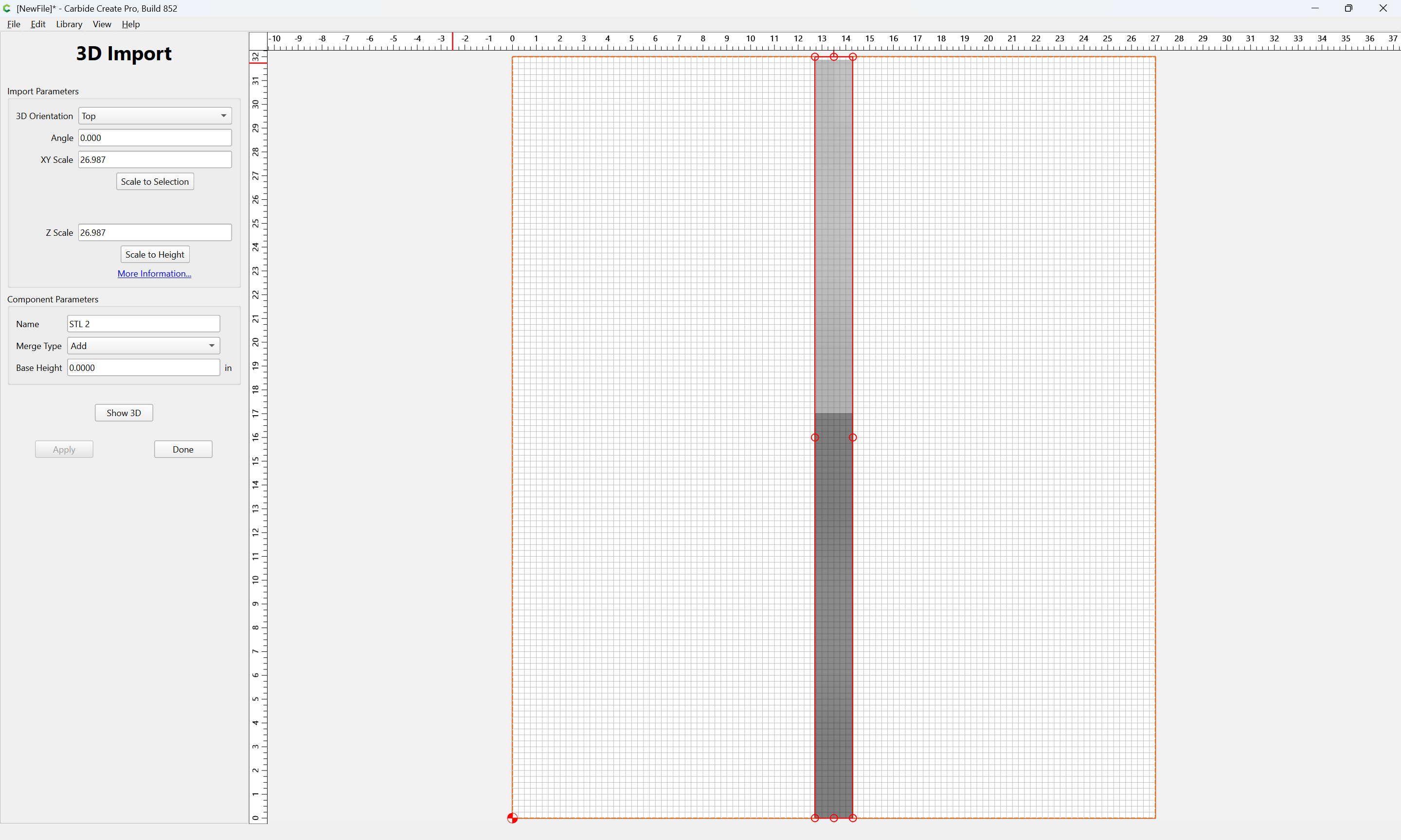

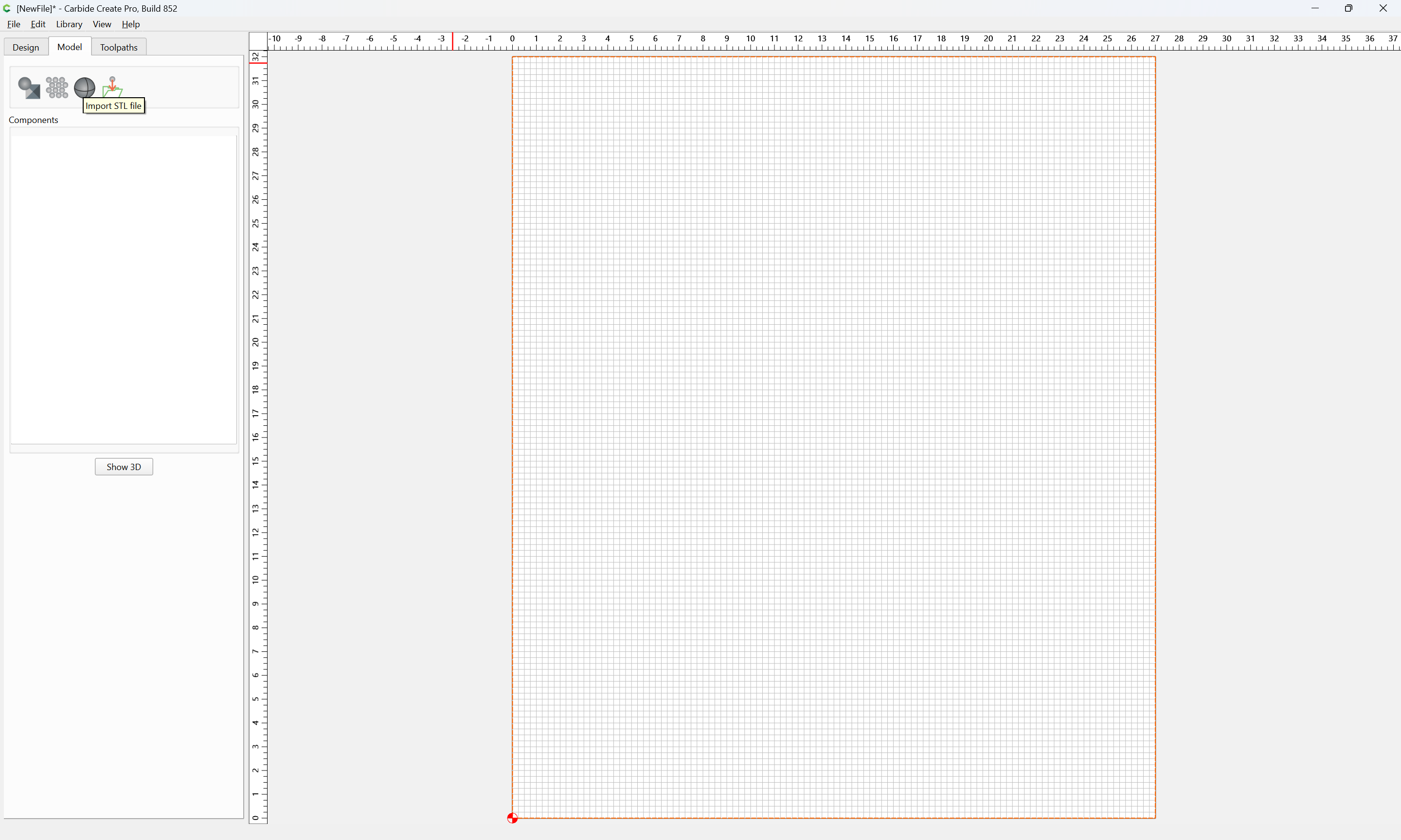

Import STL file

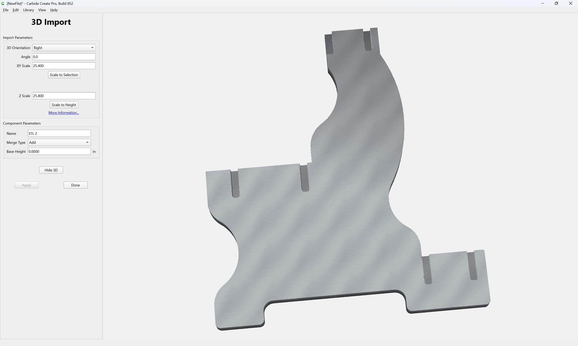

Change the facing using 3D Orientation:
check the 3D view:
Done
Probably a bit more width in Job Setup would be helpful.

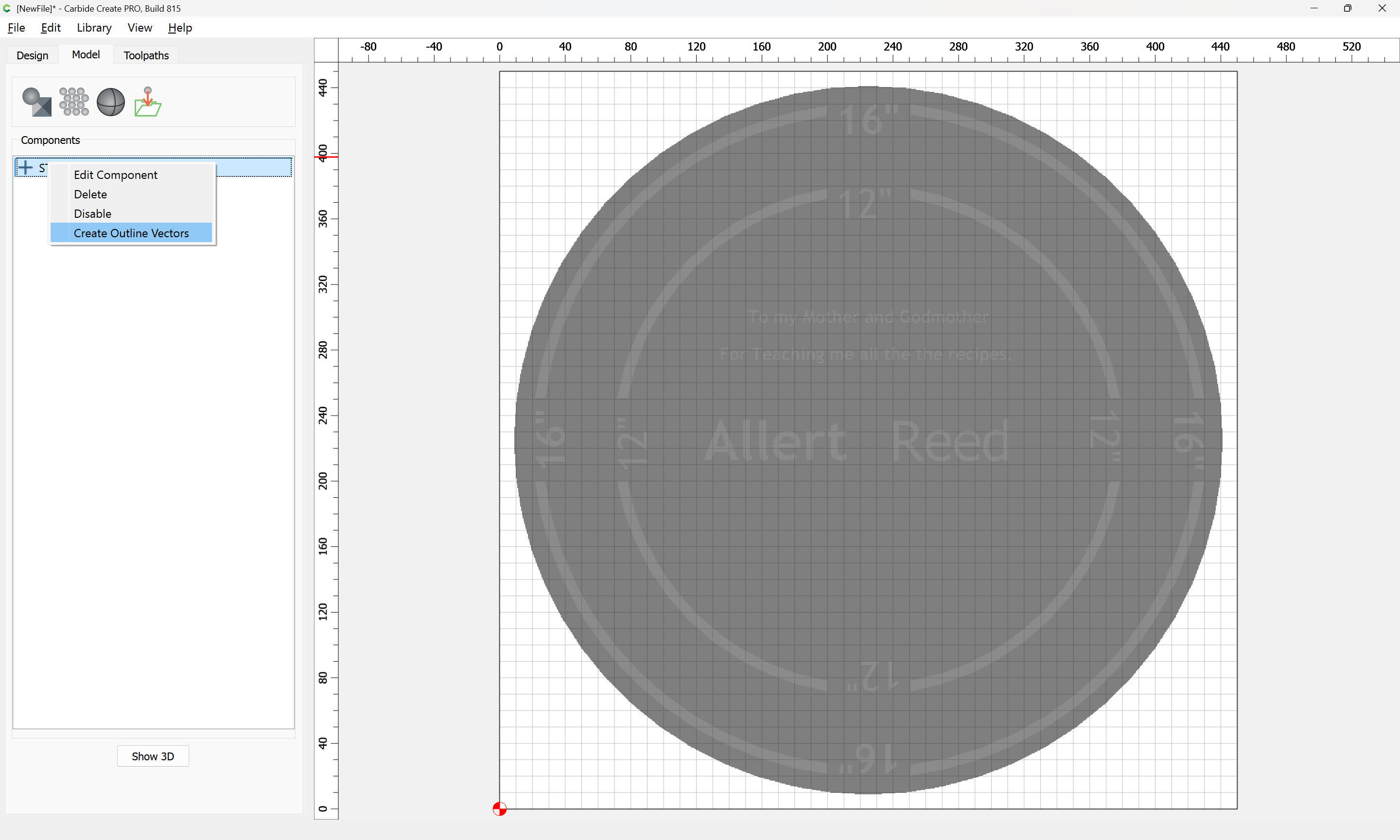

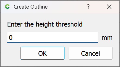

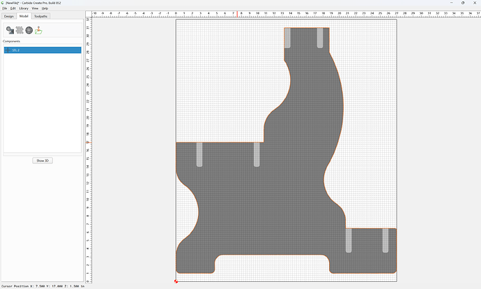

One will also probably want to trace the outline — right-click:
OK

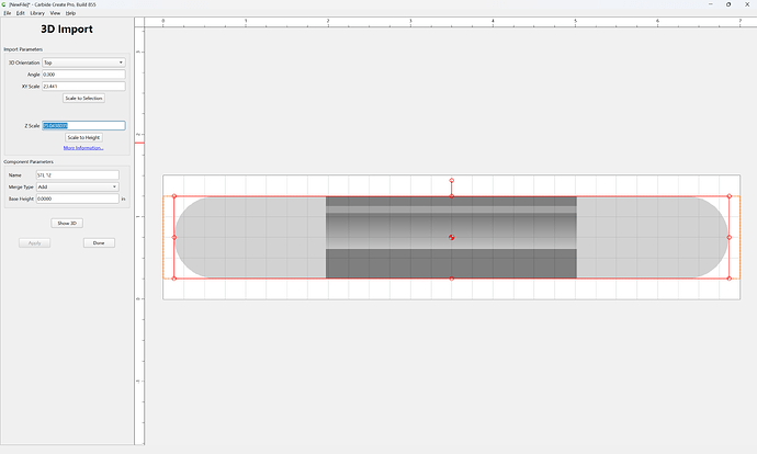

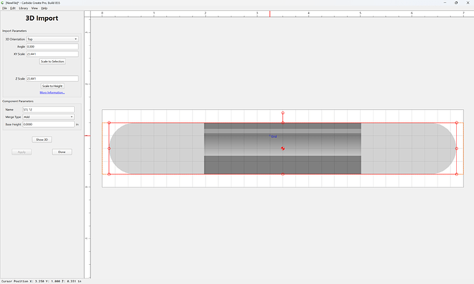

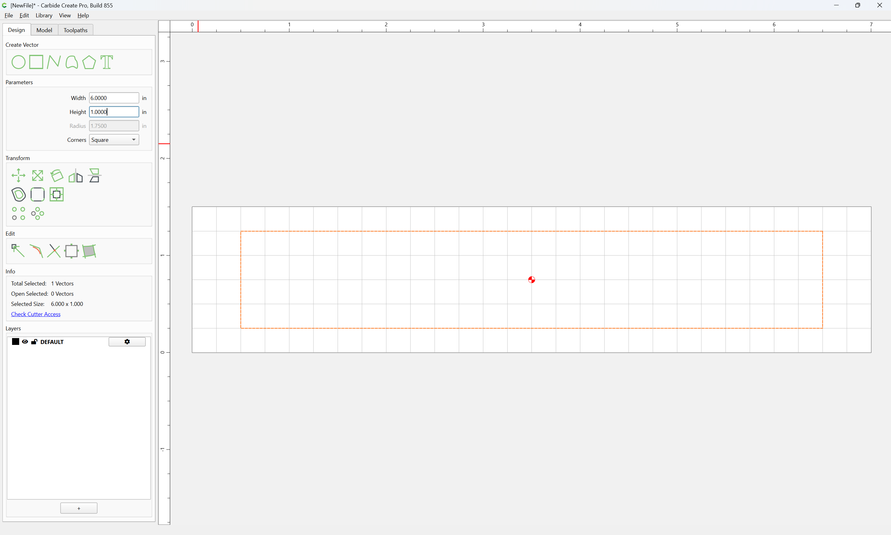

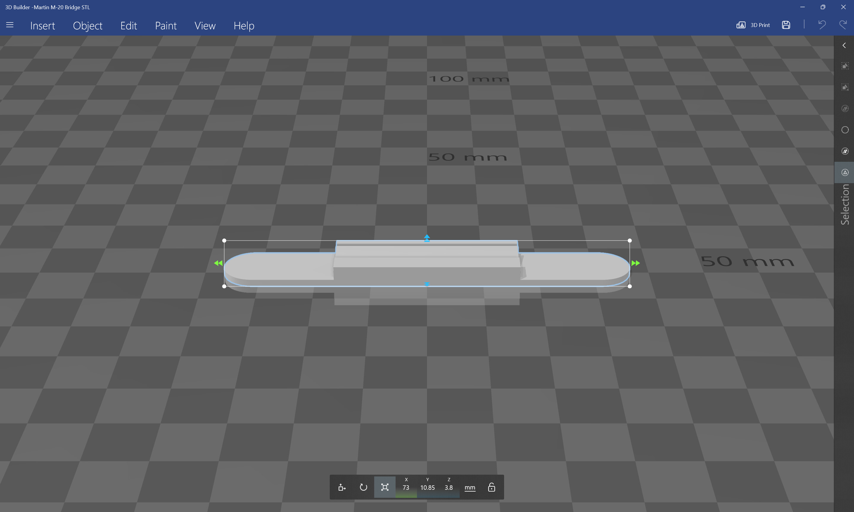

…trying to make a Martin bridge from the STL file listed. The bridge is 6"X1"X .375" thick…
where the STL file has the dimensions:

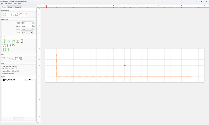

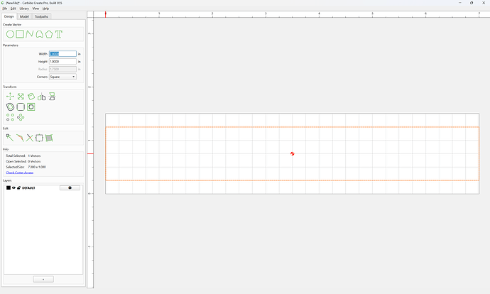

Start by making a Carbide Create file of a bit more than the dimensions in question:
Draw a rectangle which is the desired dimensions in X and Y:

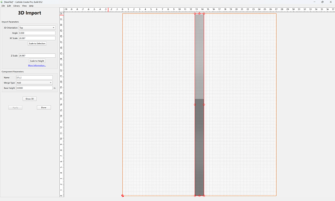

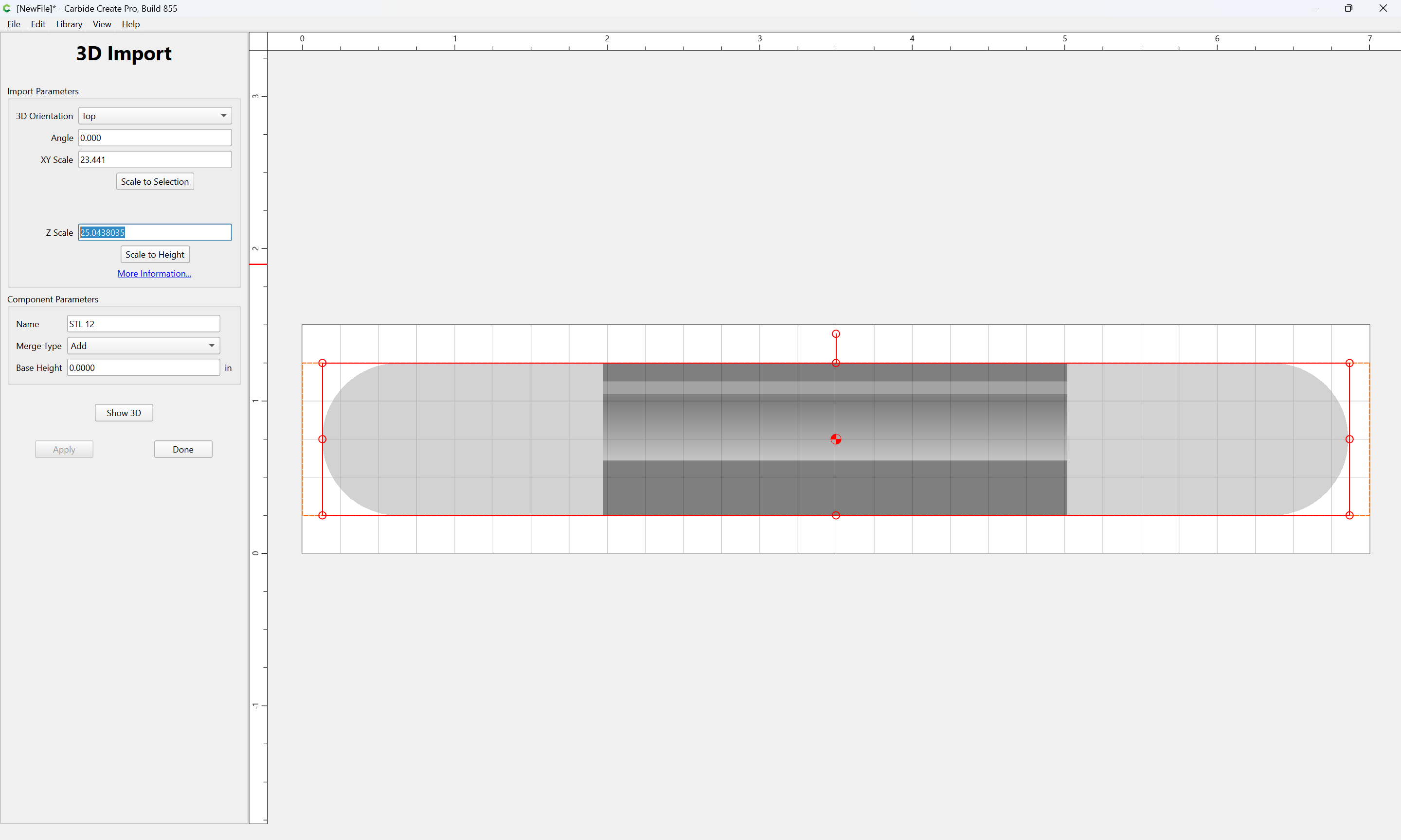

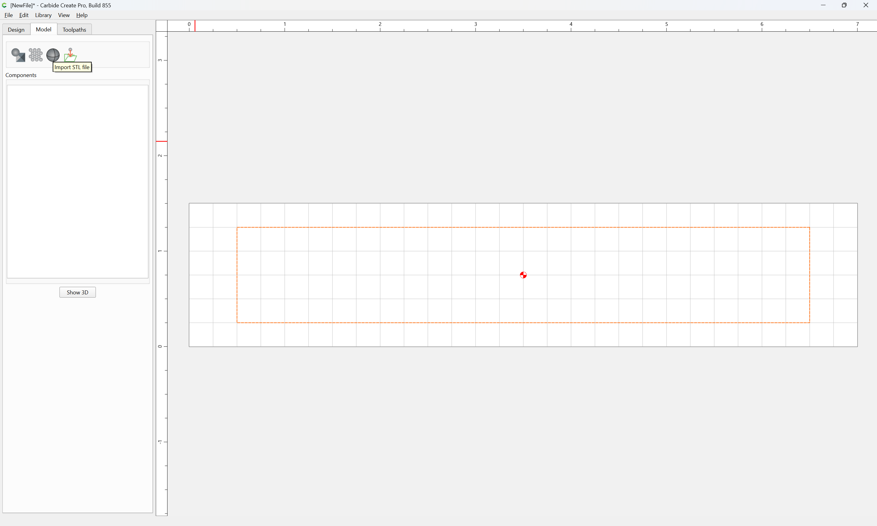

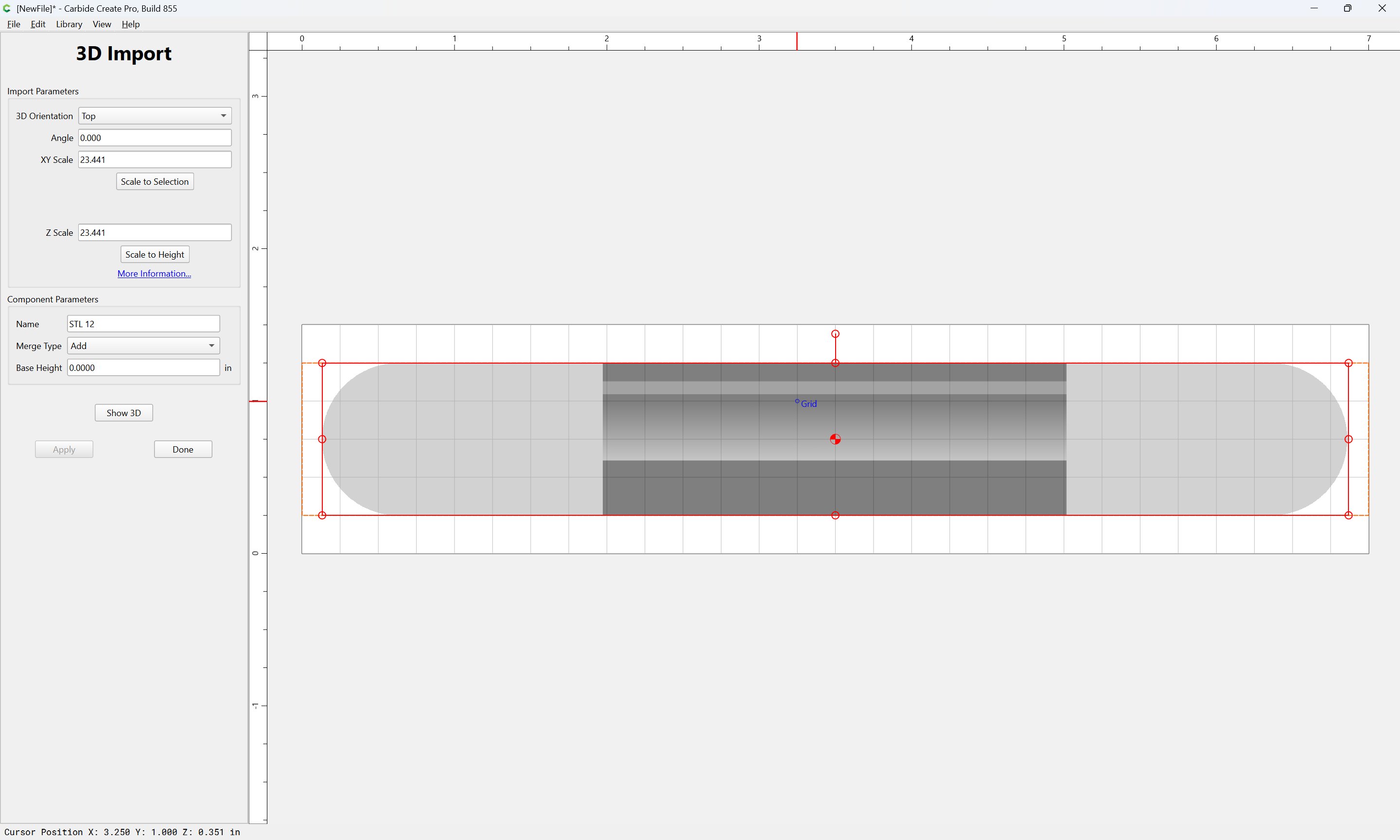

Import the STL:

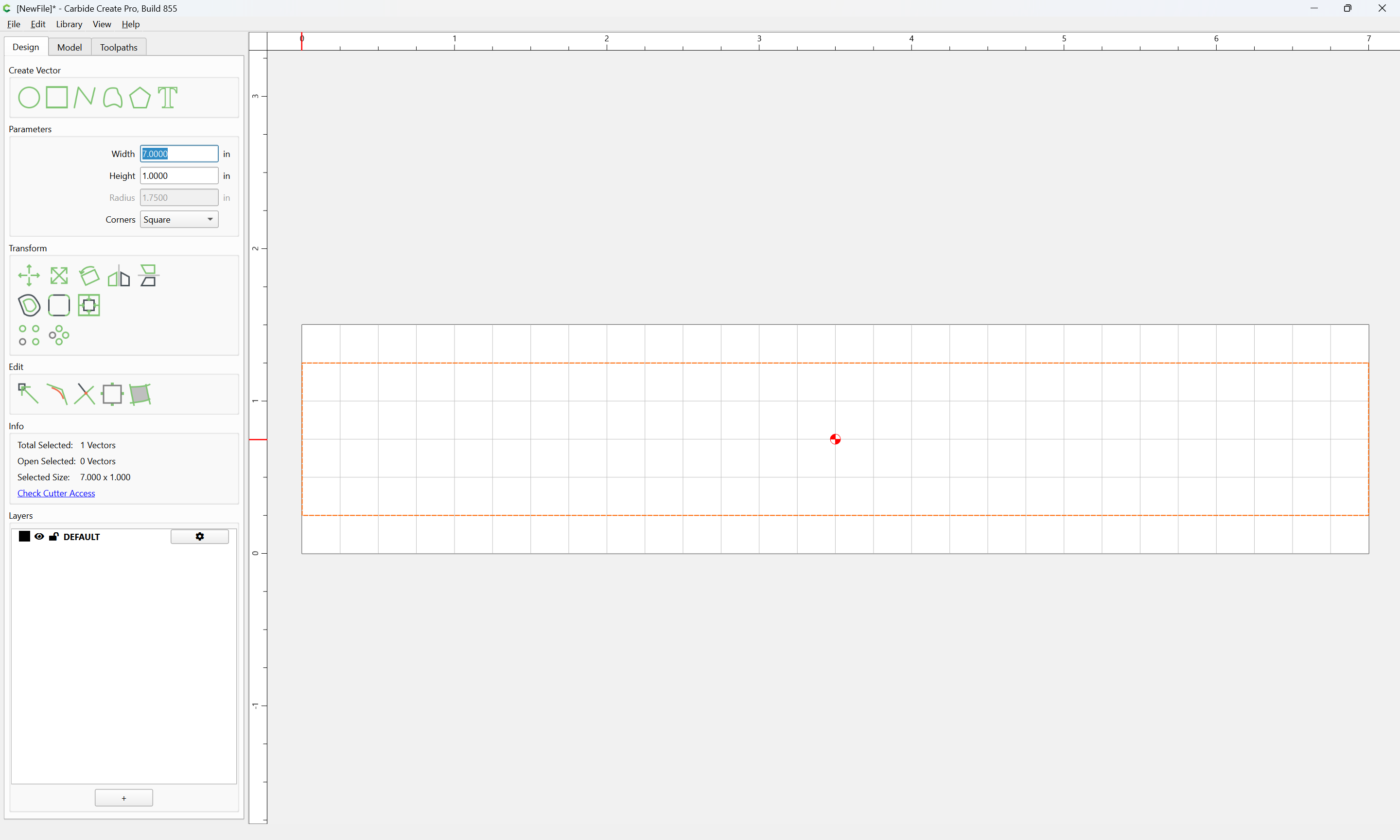

and adjust the values until things match what one wants — presumably the 1.5" dimension is more important than the 6"…
so we adjust the width of the rectangle:
and import again:
(which seems to fall a bit short on Z…)
WillAdams
(William Adams (Carbide 3D))
August 25, 2026, 9:29pm
5
If one wished to scale Z separately, then it would be a matter of doing the math to get from the current scaling factor of 23.441 == 0.351 by calculating:
0.375 / 0.351 == 1.06837607
and then multiplying that by the existing scaling factor:
1.06837607 * 23.441 == 25.0438035
(which is suspiciously close enough to a 25.4 metric to Imperial scaling factor that I suspect that that is what should be used)
