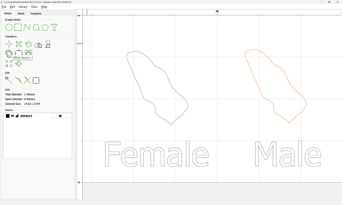

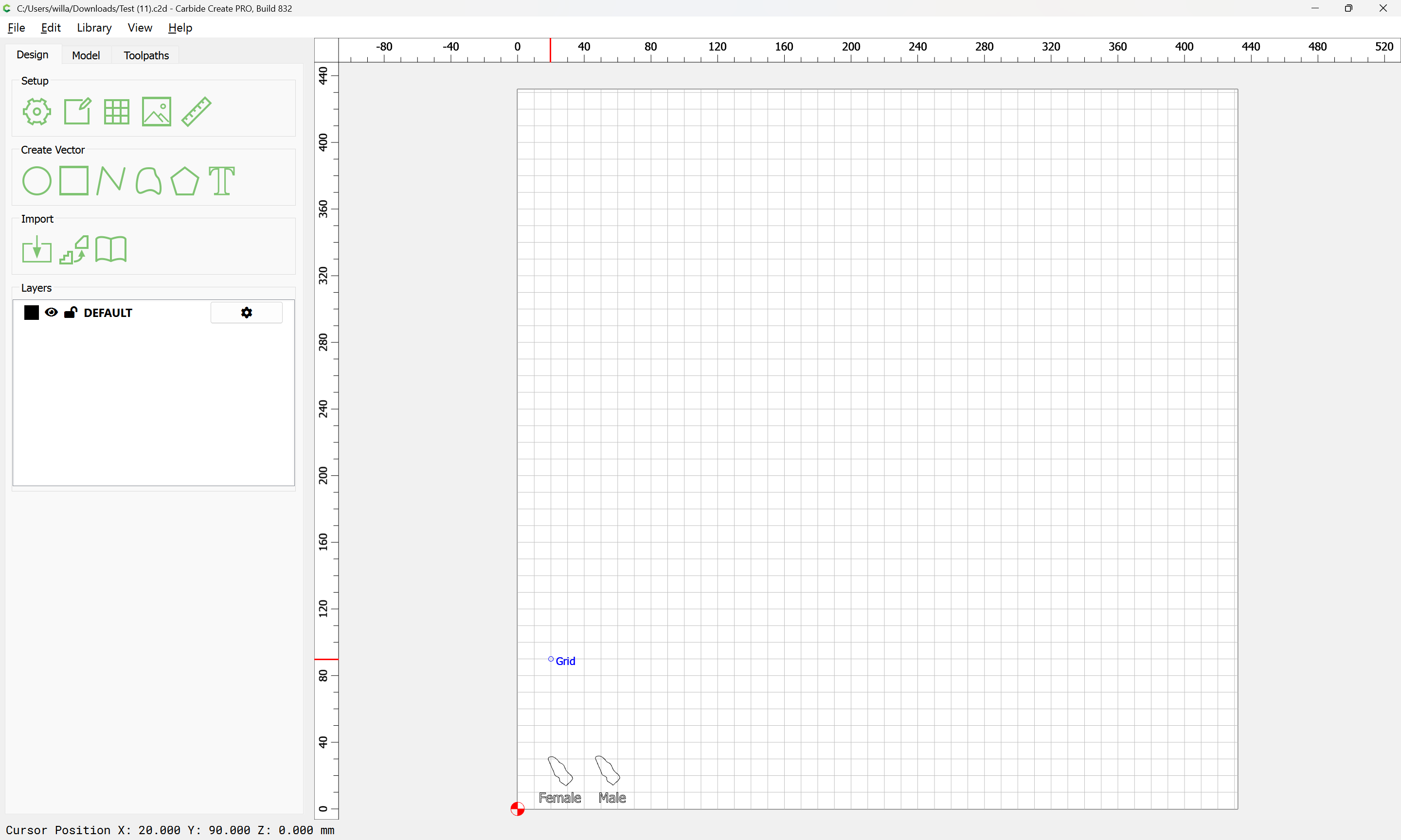

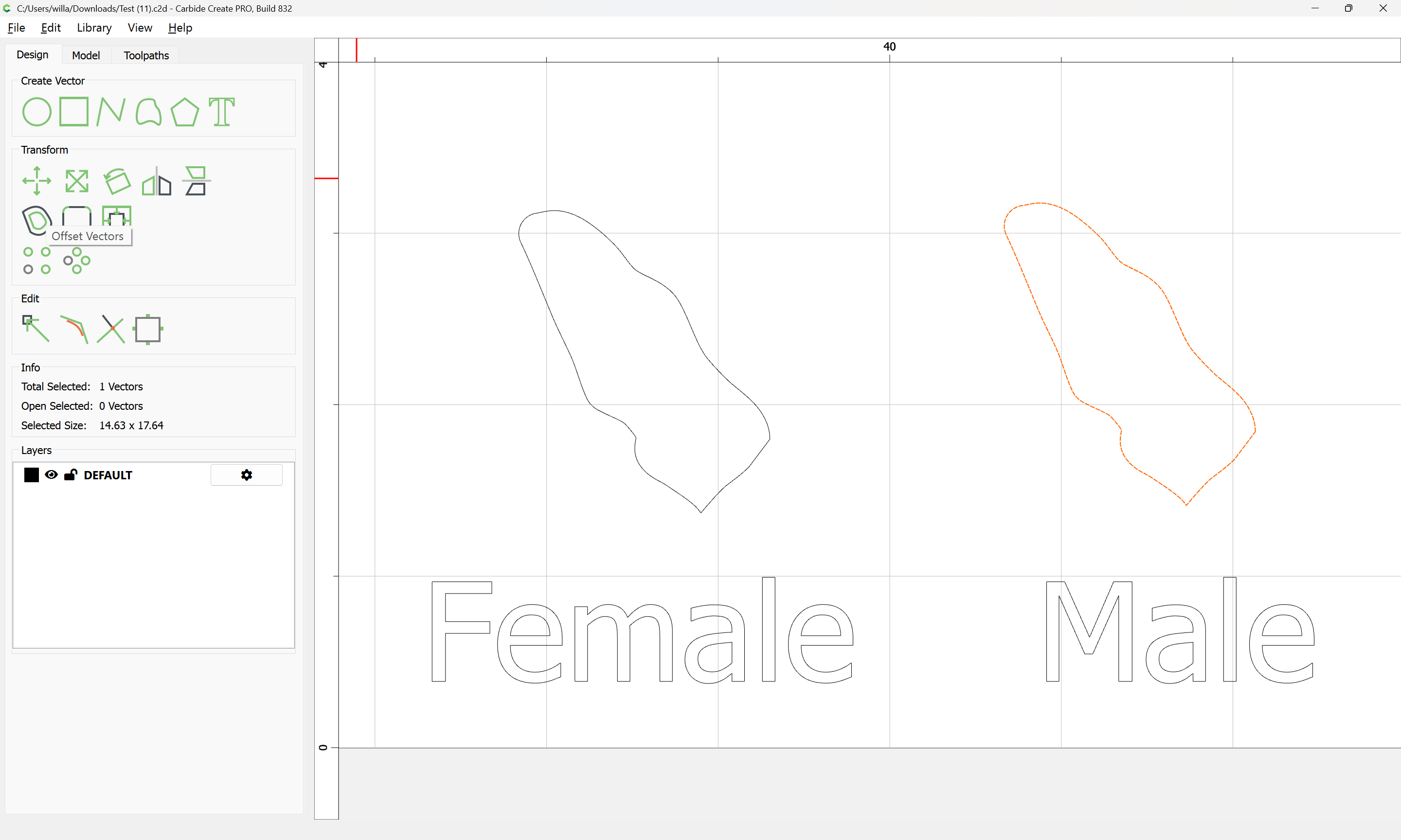

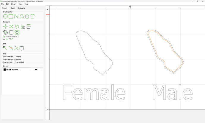

I am having problems with doing an Inlay. The Male /Female do not align correctly. Not really sure if this is the correct way to do an inlay.

Did you forget to mirror the inlay?
Note that for this sort of through inlay, it will be necessary to take tool geometry into account (which is why V inlays are more typical)
For V inlays see:

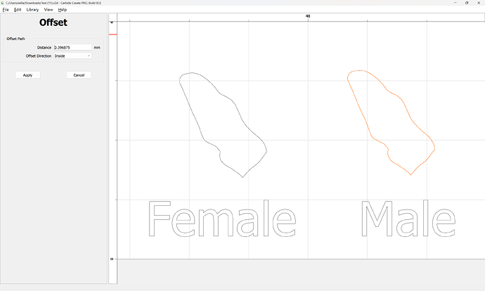

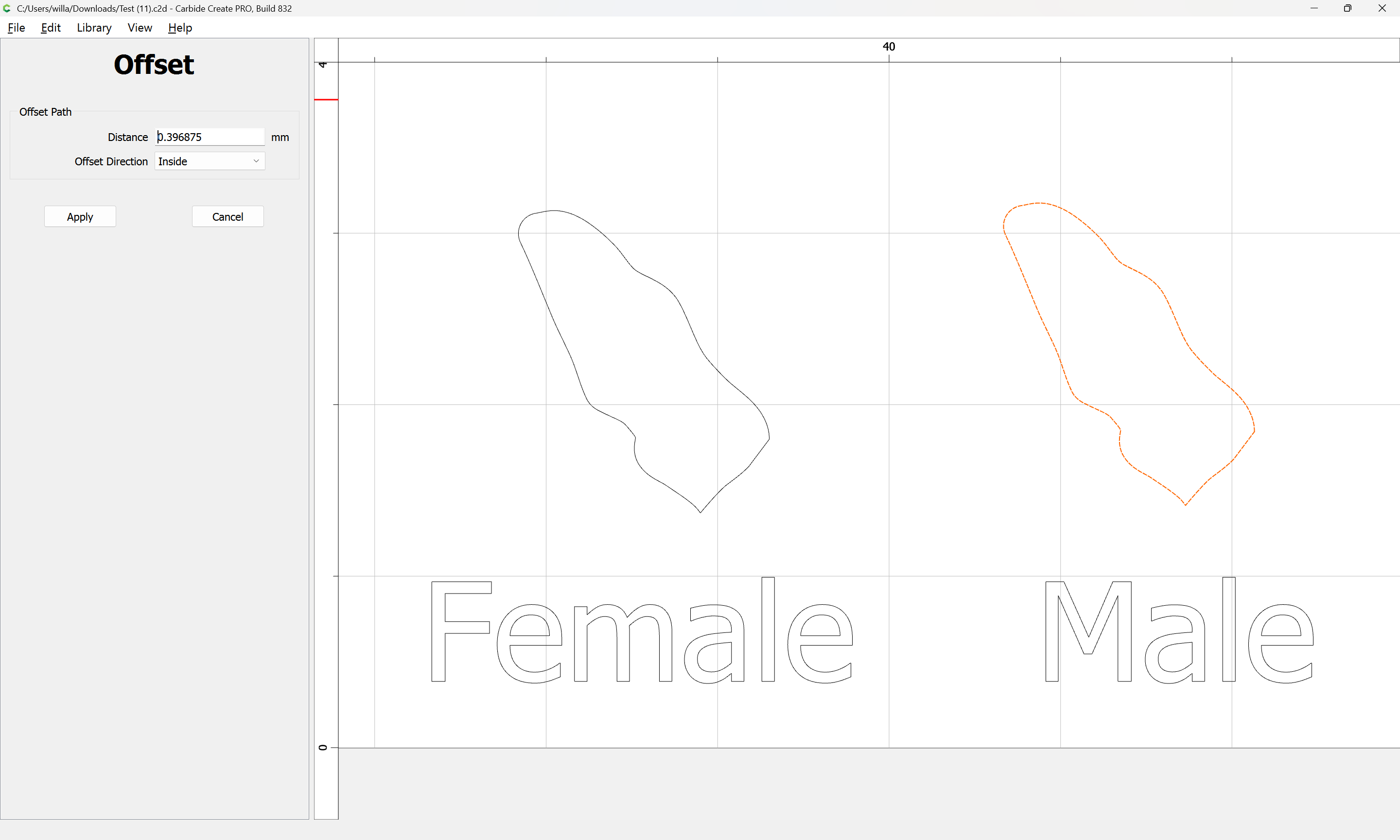

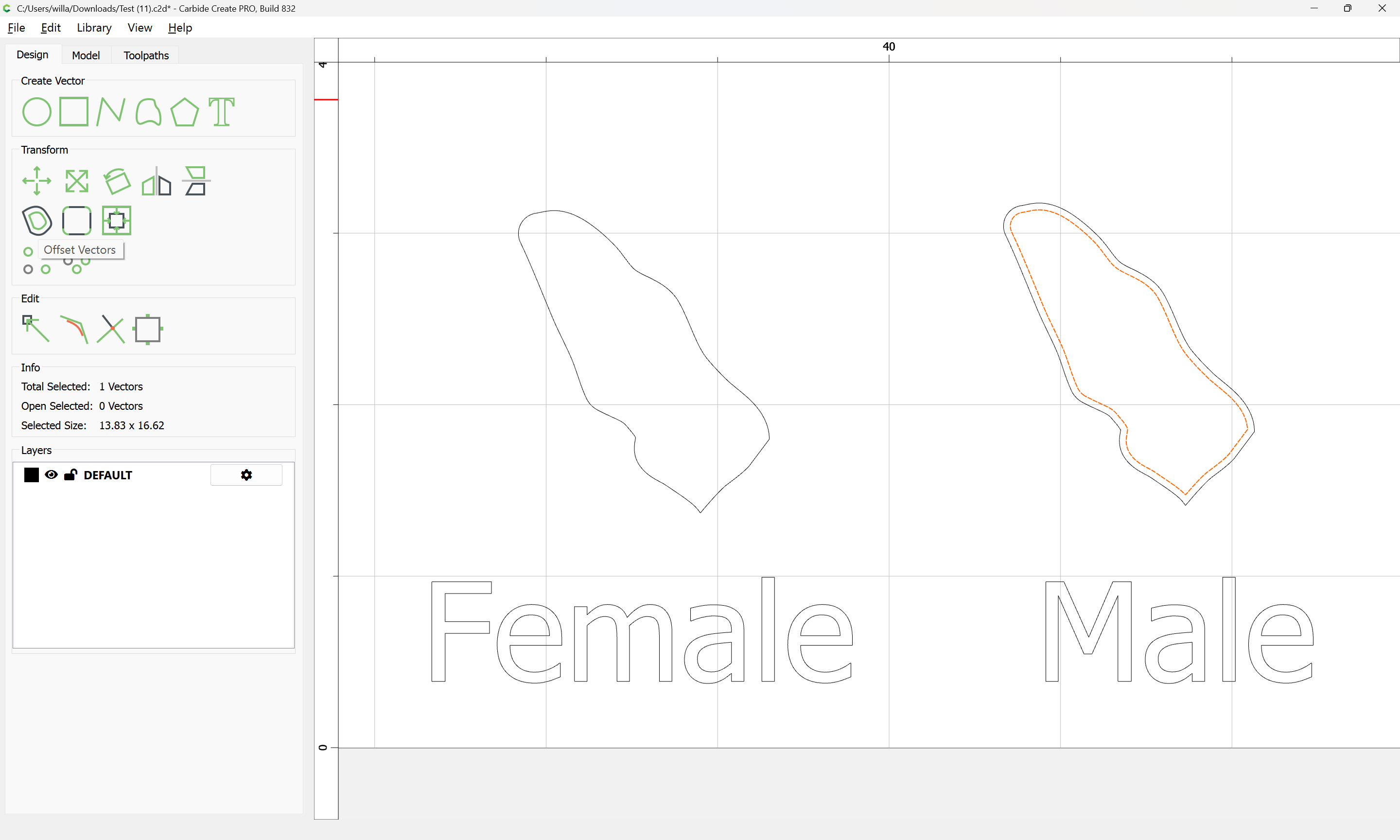

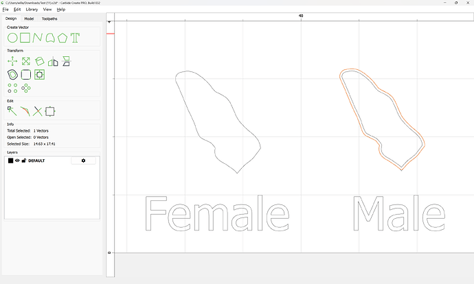

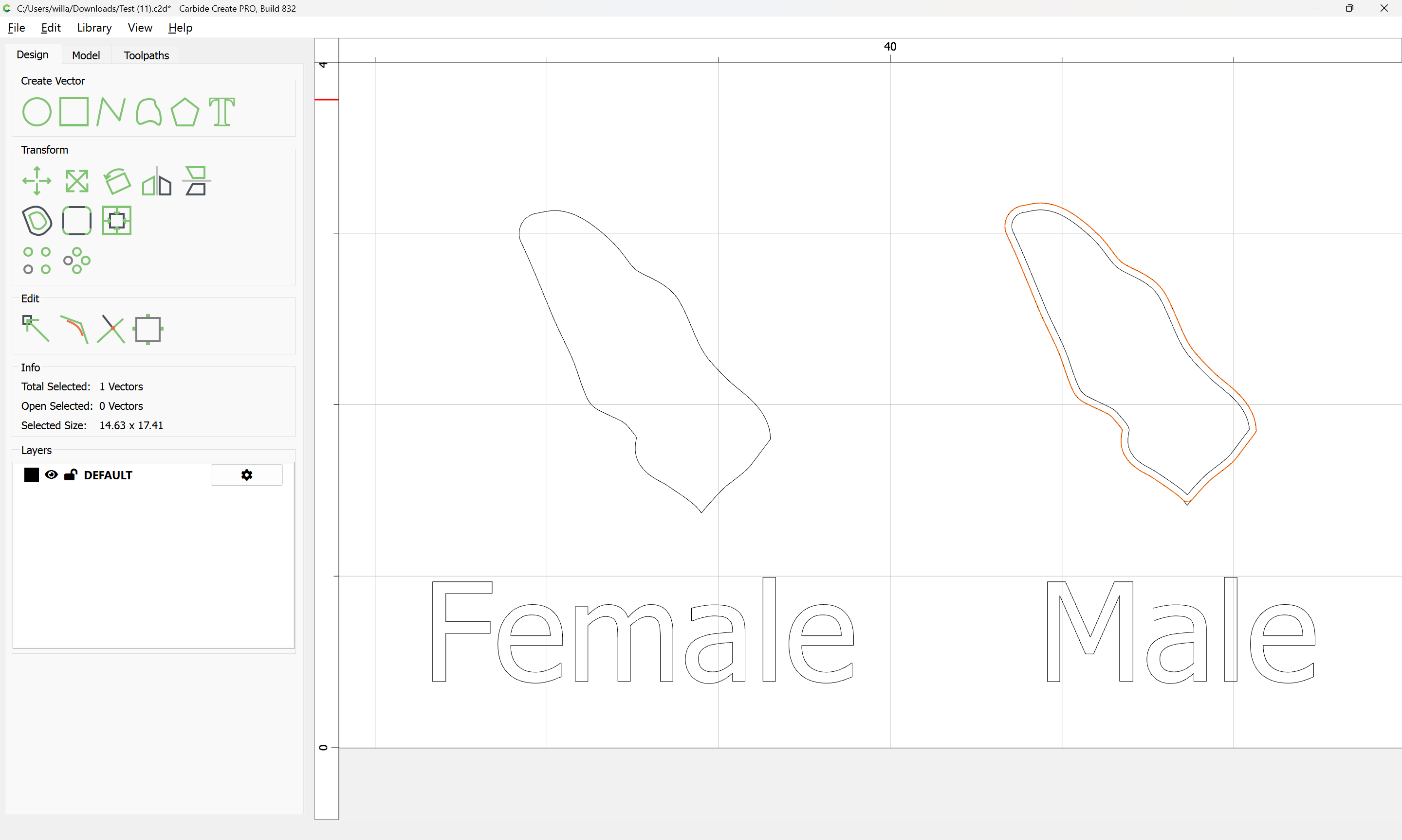

For the sort you are trying to make, you will need to inset by the tool radius:
Apply

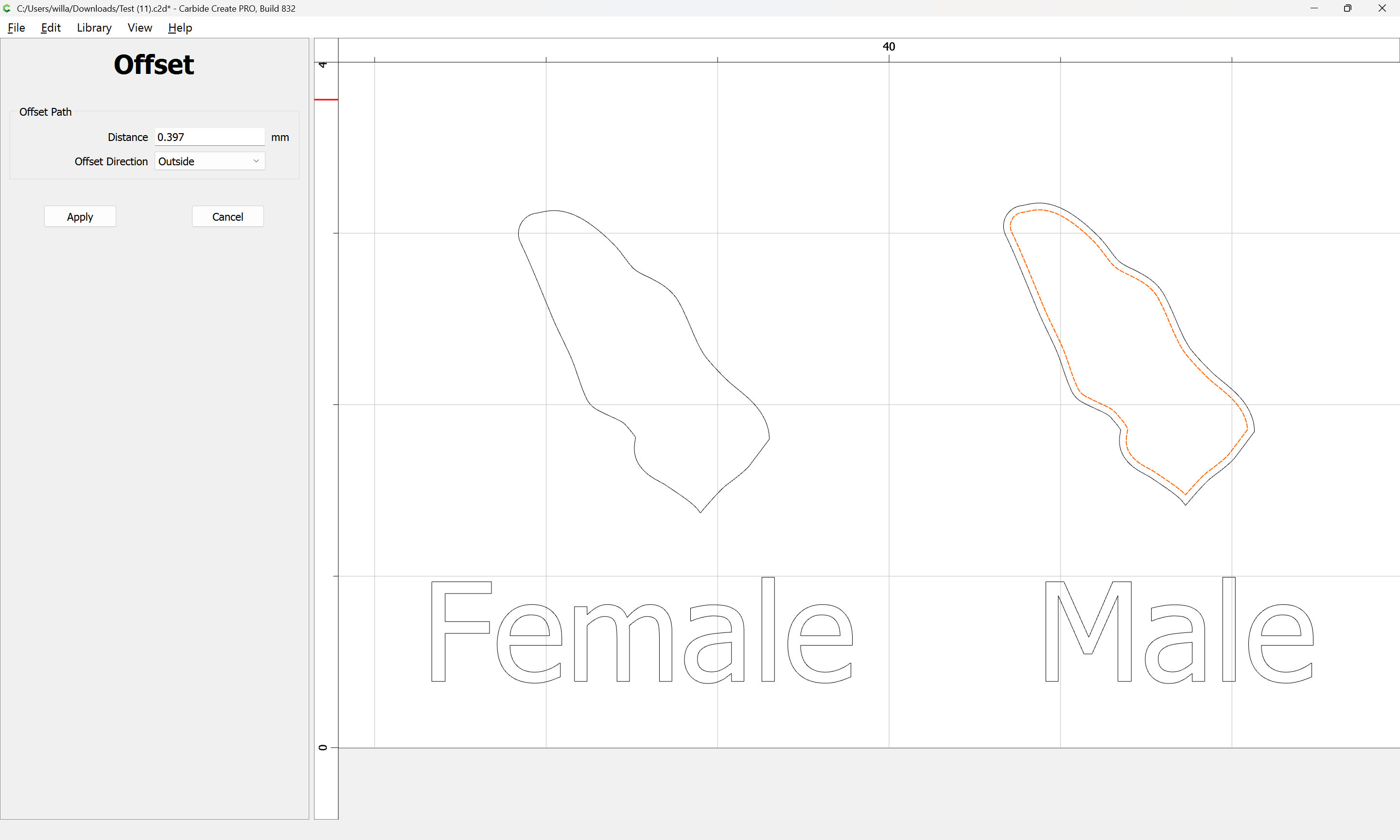

and then offset to the outside by that same distance:
Apply
and use this same geometry for the pocket as well.
As far as the mirroring I did not. Not sure why I needed to do it. As far as the Vcarve I did try it but stopped because it was looking for a Vcarve bit. I was not sure what to do at this point. I am open to either way. If you could take a look to see what I am doing wrong, I would appreciate it.

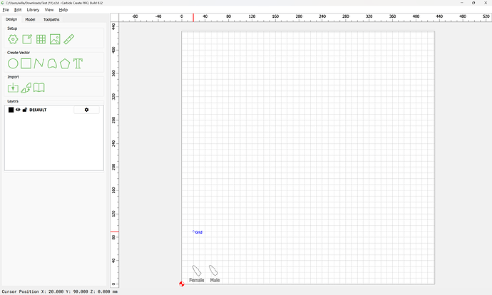

Test.c2d (608 KB)
Why are you using an inside offset for the pocket? I specifically noted that the same geometry had to be used. Copy-paste/duplicate it.
You need to create a shape which has the same appearance when cut on the inside or the outside — we had a lengthy discussion about this a while back:

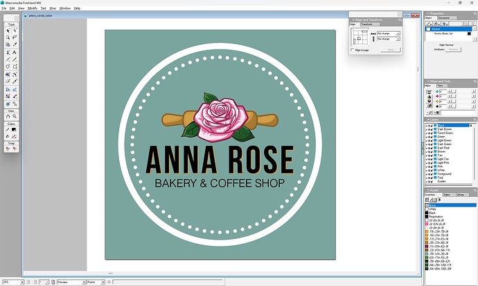

Imagine if we wanted to create a multi-colour inlay for a file such as:
We will assume that we are using a very fine/delicate veneer — the usual approach with such is to stack two sections which will be interacting and cut them at a very slight angle so that the two pieces will fit together:

The mirroring is necessary, since yo take the male part and turn it upside down. Try with a piece of paper, where you print your shape on. You leave one -the female or base part- on the table, and take the other one -the male or inlay, the one that should fit into the female (hence that moniker) part needs to be turned upside down, “mirrored”. Indeed, take some paper, gives you an impression, your sample test file appears as if the male part is not mirrored.
And then the “fun” part begins, fiddeling with the right measures: glue gap etc. If you use cylindrical (endmill) bits the whole thing must be very precise. Now with a 1/32 bit and 12 and 8mm cutting depth that is a challange for the bit: it pulls towards the cutting edge, and therefore will not stay straight. Hence one will experience less precision, and the parts do not fit nicely, or don’t fit in at all. Therefore think of using V-bits. These are more stable per depth due to the shape, and also due to the geometry of the cutting edge rather scrape off wood than really cutting it with a blade, therefore the bit does not pull itself into the wood, but rather pushes itself a little away. However one achieves an angled edge that may fit in better with some pressure with gluing. It fits -up to certain tolreances of course- better the more pressure one uses for gluing.
