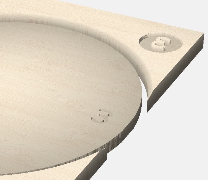

My thoughts were to do a wooden clock face, 12 inches in diameter, with a slight convex shape and to inlay alpha numeric digits using a contrasting wood. The stock thickness would be .750”. The rounded shape would be 10º with a height of .250 and a base of .500.
My thoughts are that I would need to do the inlay portion of the project first, on the flat surface, then apply the rounding model tool paths. But, I’m affair the rounding model tool paths will wipe out the inlays, especially near the edges.
Is there another way to go about this? Is it possible to do the inlay portion on a rounded face?

If you do an inlay on a rounded surface you will need to use a simple pocket to receive the inlay NOT anything with a vbit type of inlay process. I used a 1/8 em and then 1.5mm to get the finer edges. When you create inlay (male) you may need to offset the pieces by .01 in smaller so you don’t have to fight tapping it in. After that then do the convex toolpaths. Hope that makes sense.
I don’t see why you couldn’t use a v-carve inlay. You just have to account for the curvature & the height at the finished surface of the model. I would use a very steep (6°) V-bit
The difference in height across the number is less than 1/16"
FYI, the top arc has a radius of 71.175", and the included angle is about 10°. The angle from the edge is about 5°. :wink:
Thank-you @Tod1d. I was thinking a steep v bit was the answer but for the life of me I could not figure out the radius of the top arc. That’s was the missing link to draw this up in a profile view to see if the carve would come together and not wipe out the inlay.
I frequently draw up a side/section view to work things out. You might have to get creative with the v-carve depths to get a match. I tried to match mine up from -0.125 to -0.250, and ran the female 0.1875 deep (from the -0.125, so 0.3125 total), so there’s a good 0.125 + of stock to glue.
