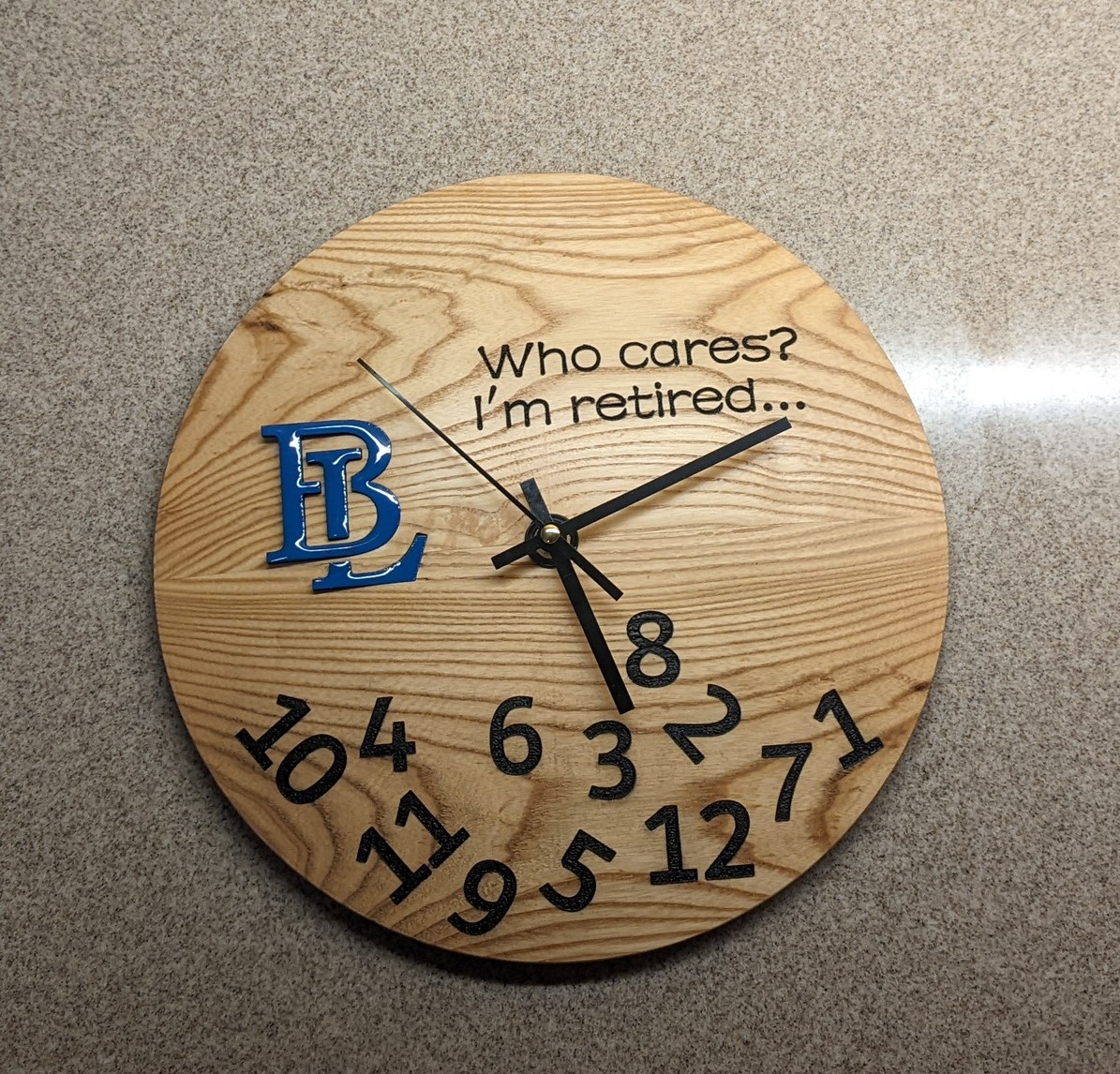

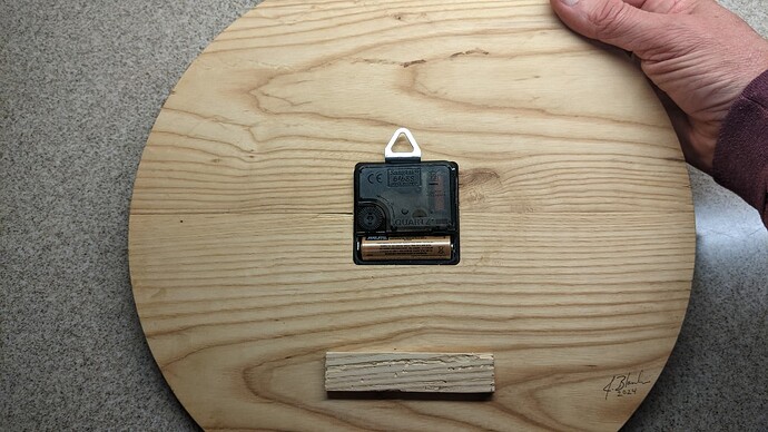

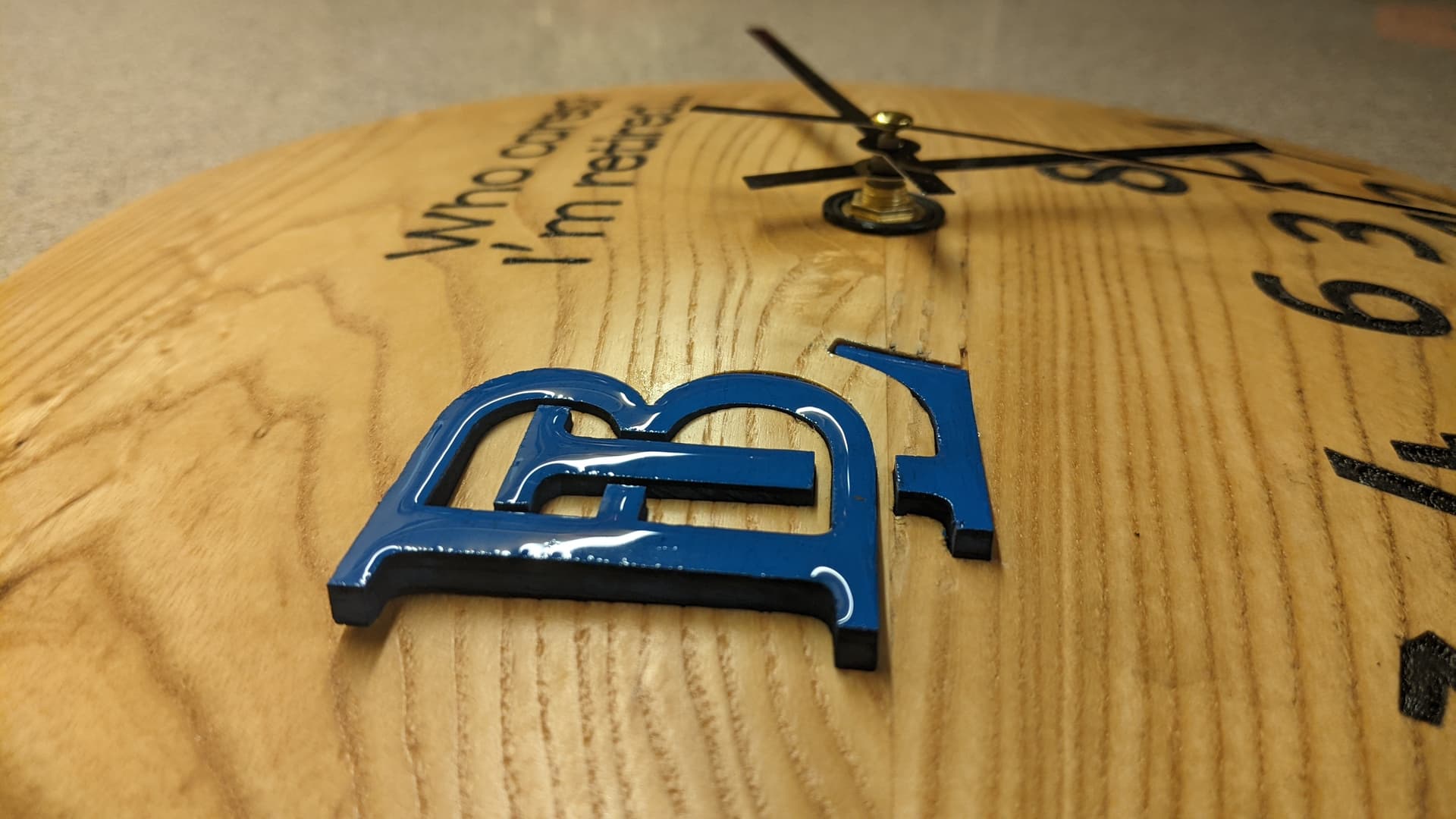

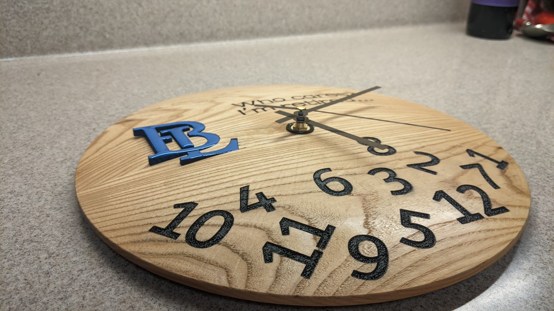

I was commisioned by a coworker to make a retirement clock for our kinder teacher. Wood: ash. This was a double sided project on Vectric on a Shapeoko 5. Used my Jtech laser to do the letters. I also used a black powder coat on the letters and burned in with a second pass with the laser at a smaller power setting. Laser cut BL, painted, glued in, then epoxied.
