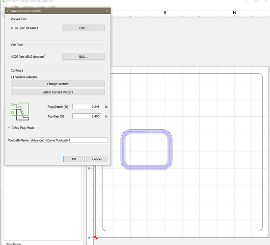

Could you please clarify your design intent? I see a channel with V-walls cut out outside the rectangle when I run a sim. Is this what you were aiming for? I don’t see inlay plug mode checked.
I don’t see any toolpaths for the plug.
I typically start at the surface (0) and would go max depth 0.250".
And take .020 off the plug. If the female is 0.248 and the plug is 0.250, there will be no glue gap.
The plug should be proud of the pocket.

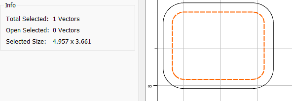

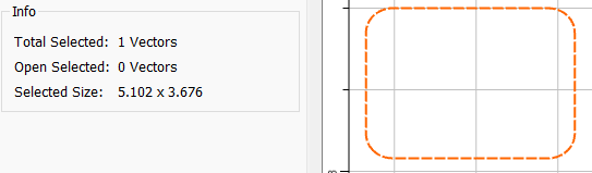

These 2 vectors are not the same size. ???
Is the shape on the right supposed to be the female pocket?
You’re only showing a single AVC path. Where is the female path?

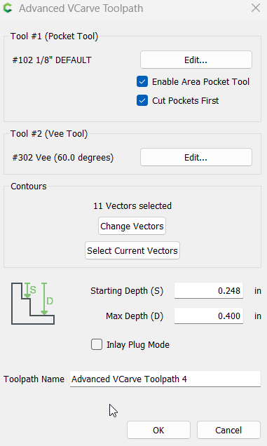

The file you shared does not have Inlay Plug Mode checked.
Start depth 0.248 Max Depth 0.400 means the top gap is 0.152 ??
Your math above, Depth = 0.250 - .02 = (0.230)
Top gap is a “saw gap” so you can turn it sideways & bandsaw the base off the male inlay.
Or just so the base doesn’t contact the female side & allows the male to fully seat in the pocket.
Glue Gap is the female max depth - male start depth. Or with the inlay mode, the female max depth - male plug depth.

Inlay Plug box checked. Well, it wasn’t. The field will retain the values, but they have different meanings if the checkbox is changed.

Create your offset or another vector around the male shape so you can fit the female to the male without removing the male from the machine.
Set the Plug Depth to 0.130", set the Top Gap to 0.120" or greater. Cut the male.
Now fit the female to the male & measure the top gap. It should be 0.120", but it will likely be a little bit off. This could be due to accuracy of the machine, slop or deflection, or a Vee bit without a perfectly sharp point. Either way, adjust the plug depth to get to the actual 0.020" glue gap you want.

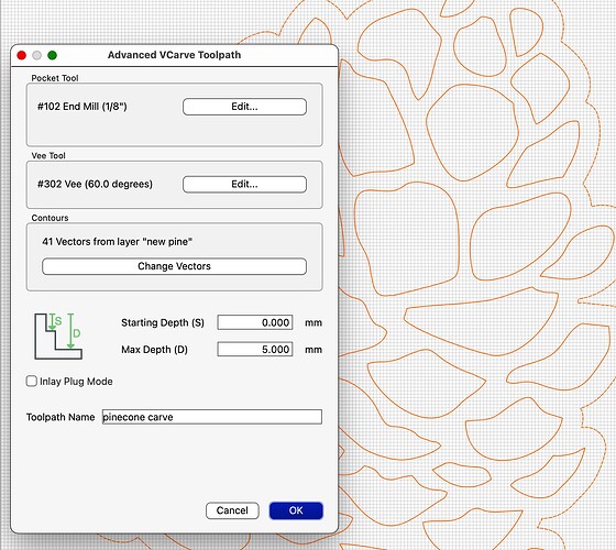

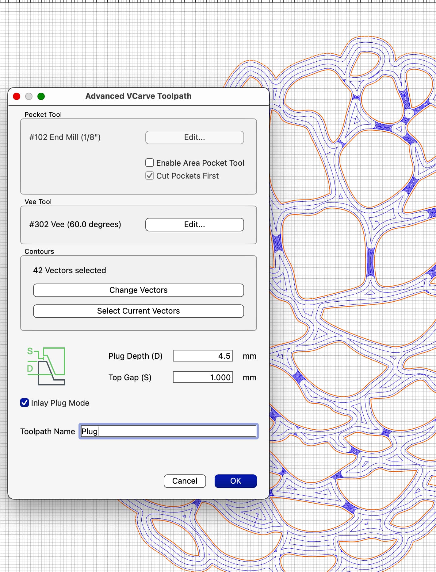

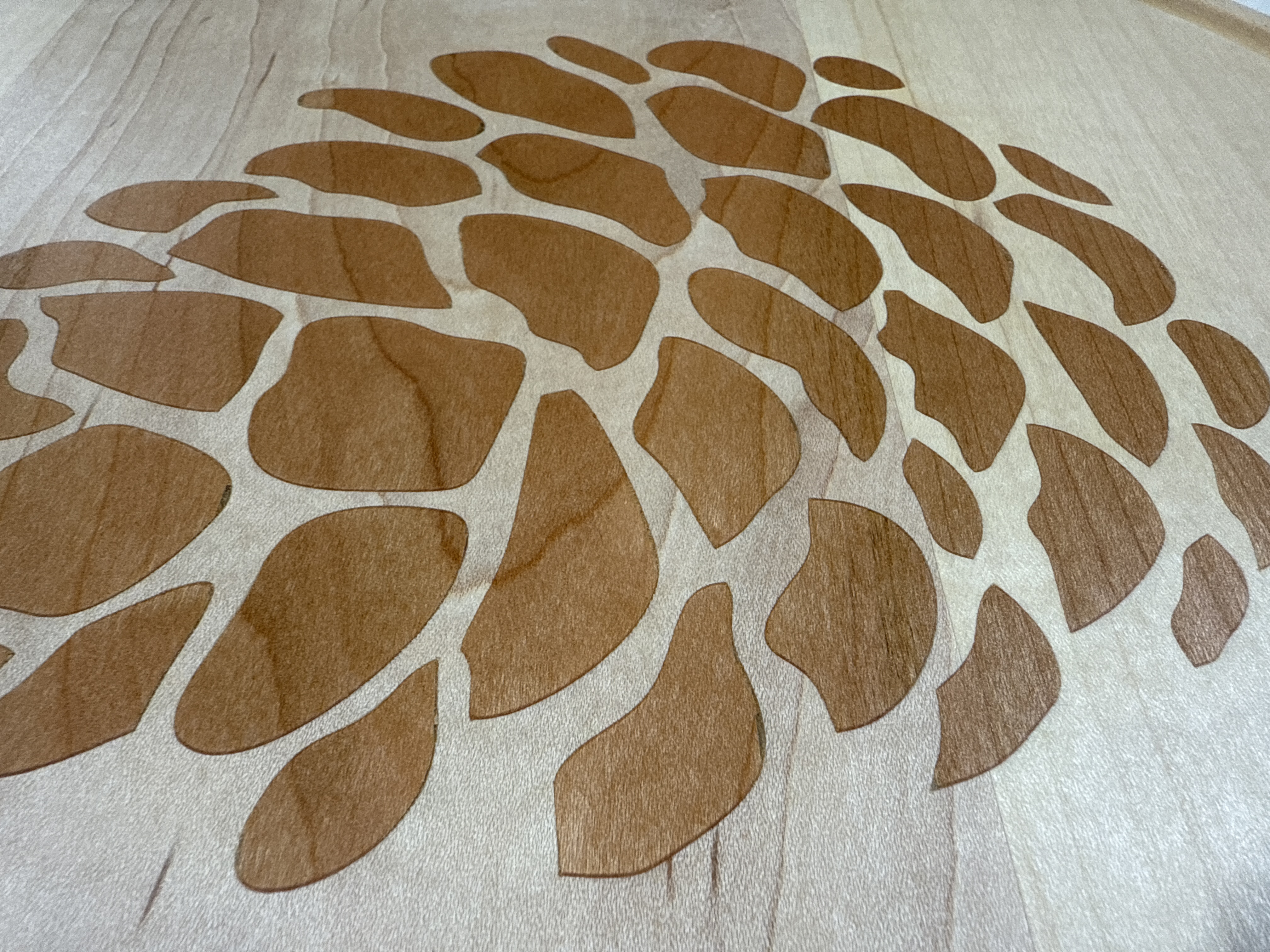

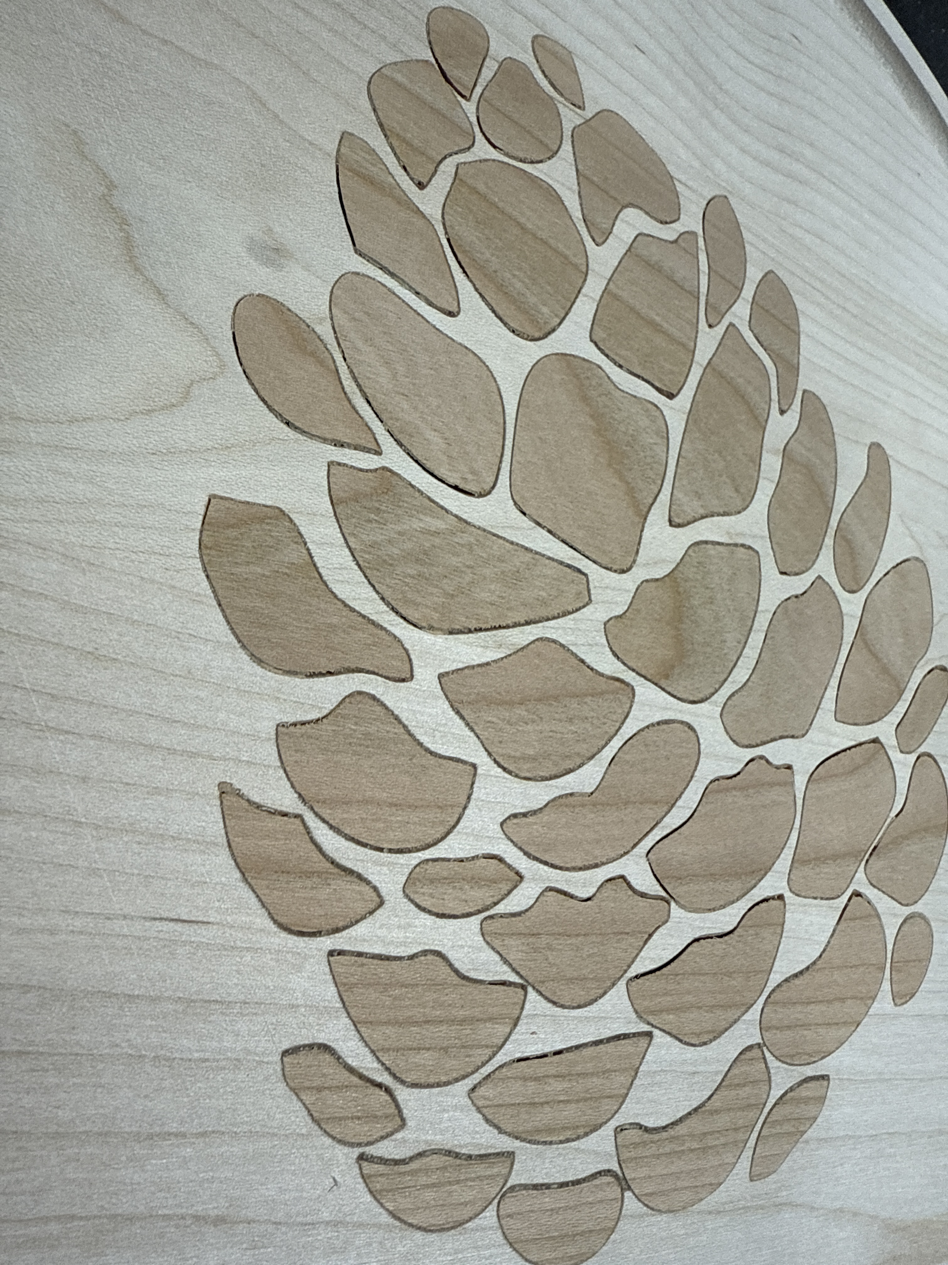

Q: with v8 how to define S and D with inlay mode? Still 1mm/S - 5mm/D and then when making inlay 0.5mm? Had success with your video but now settings changed and I didn’t get the same result.
Upload a file which is not working and a photo showing how a test in scrap turned out?
Hereby
25-03-26-SL-cuttingboard-redo.c2d (900 KB)

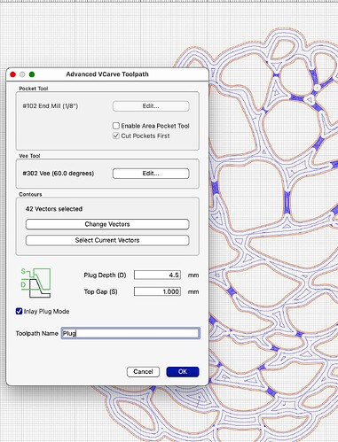

That’s previously with old settings
This is with new settings in CCPro V8. May have been human error when clamping(?) but a small check of file would be appreciated before I cut a new one :eyes:
