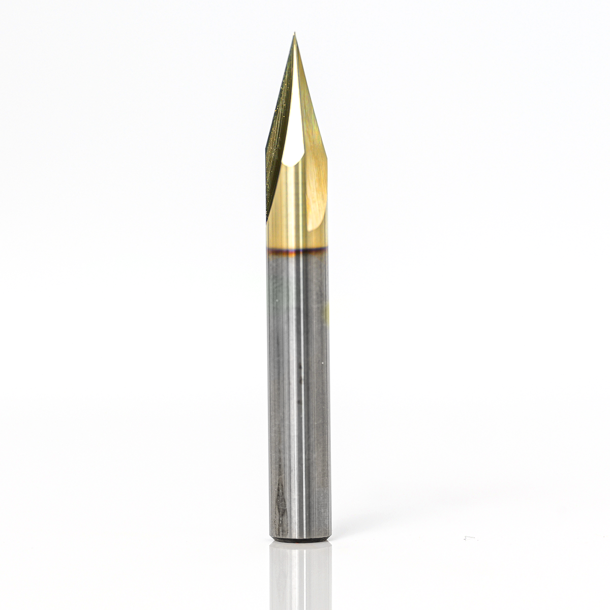

I am having a hard time succeding my inlay with this SPE 30 degree V Bit.
Has anyone succeeded with it or any other 30 degree V-Bit? If it’s the case, how do you configure the bit in CC?
I copied the Carbide create #302 60 degree v-bit and change the “Included Angle” from 60 to 30. Nothing else.

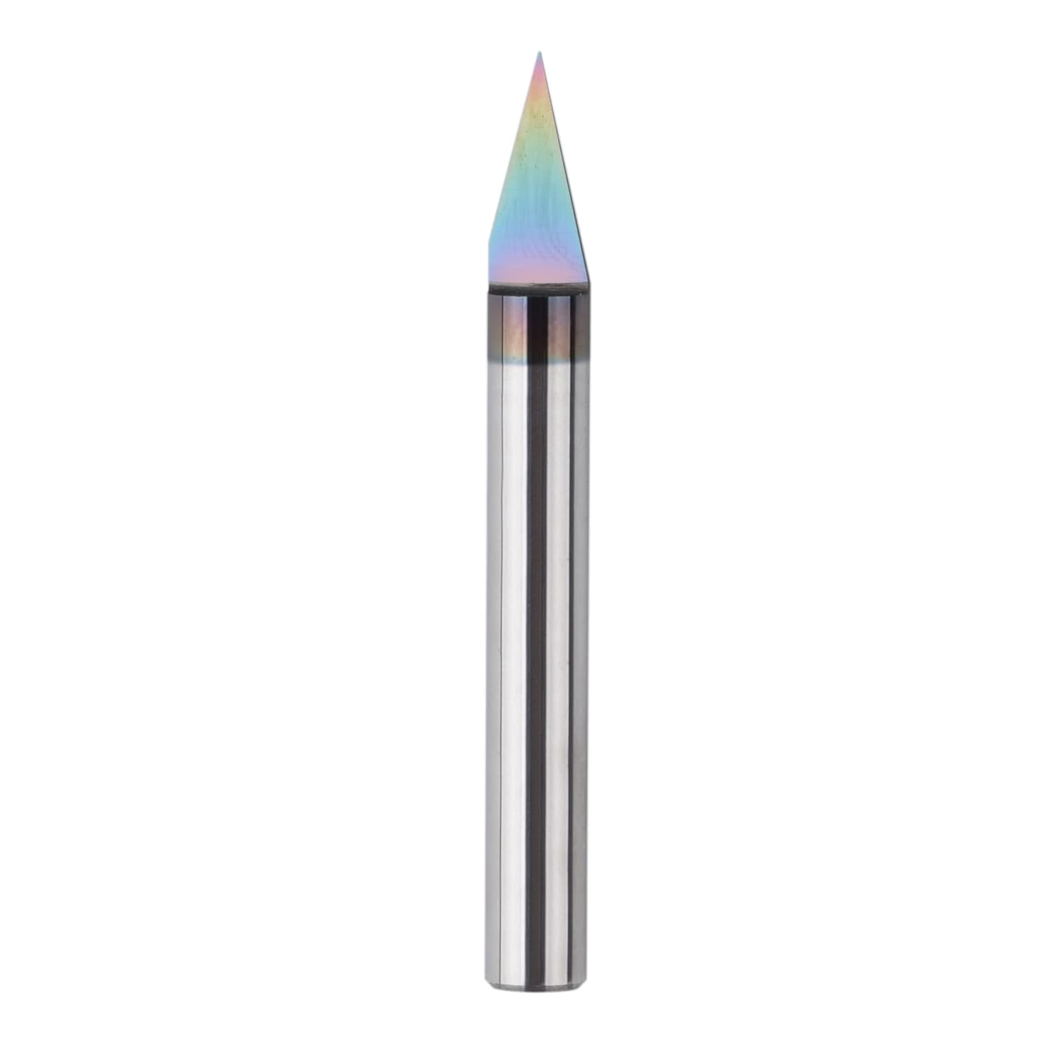

I prefer this bit for Inlay.
SpeTool has a Carbide 3D speeds and feeds spreadsheet on thier website.

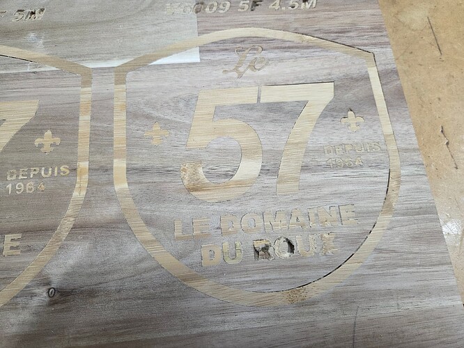

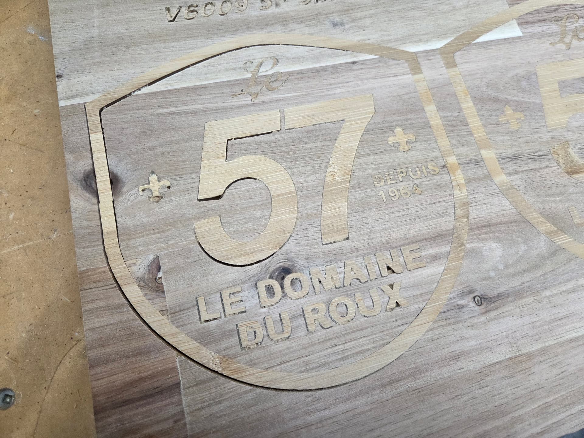

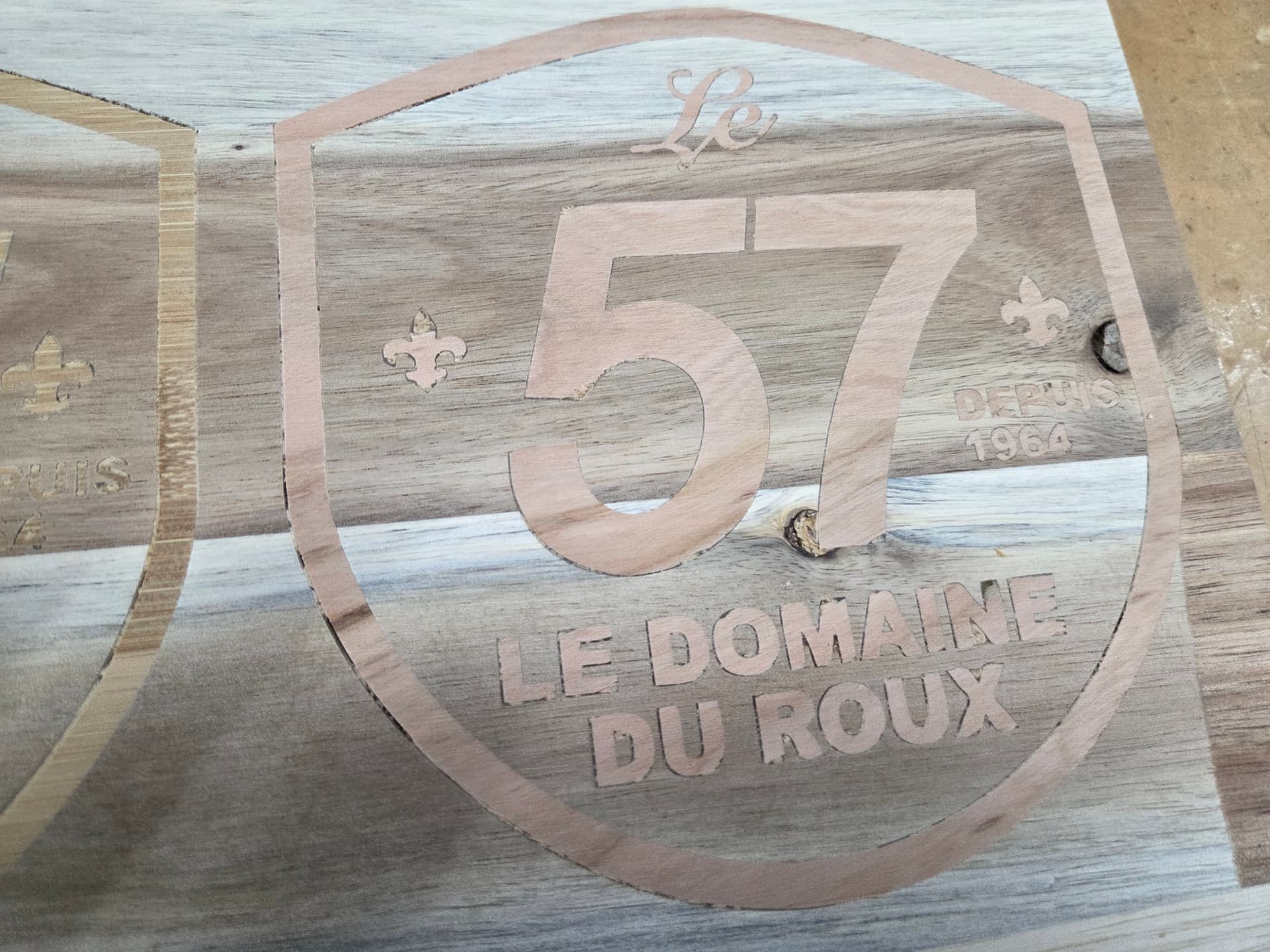

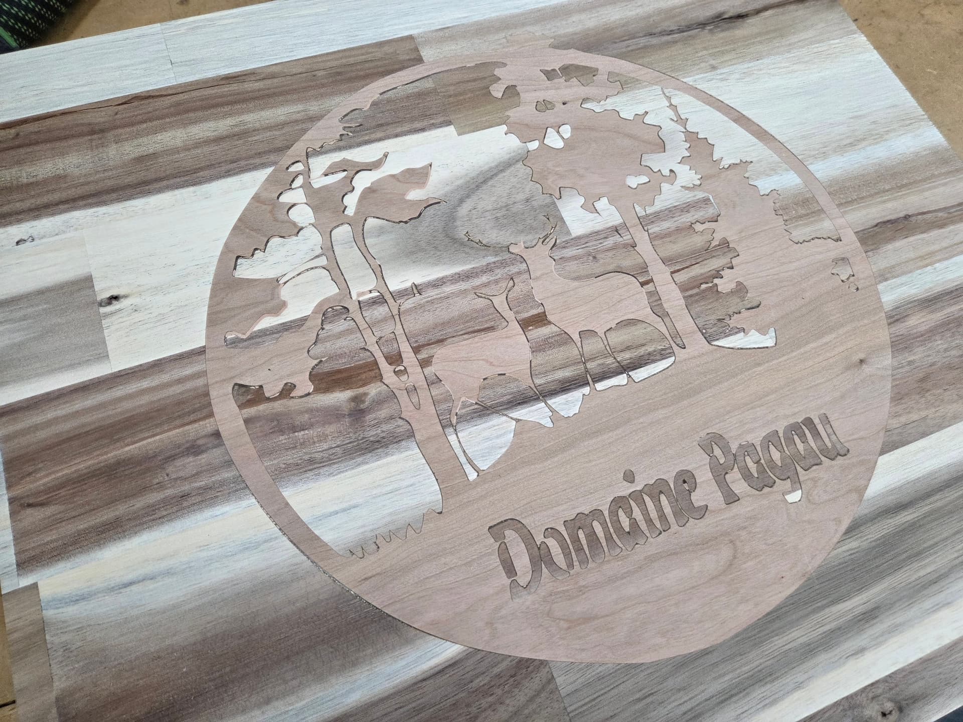

Here are picture of my result. I know I am on edge grain and i have broken grain/part but I just want to test if it fill the layout.
I Just added photo in another reply
I understand that about the grain. But my problem is to fill up the main part of the layont and not the detail.
Martin, appears to be a problem with depths, so that the glue gap might be not deep enough, or mechanical deviation from pulling the bit towards the cutting edge. do you mind copying the project here?

Based on your pictures I assume the male plug start depth is not deep enough.

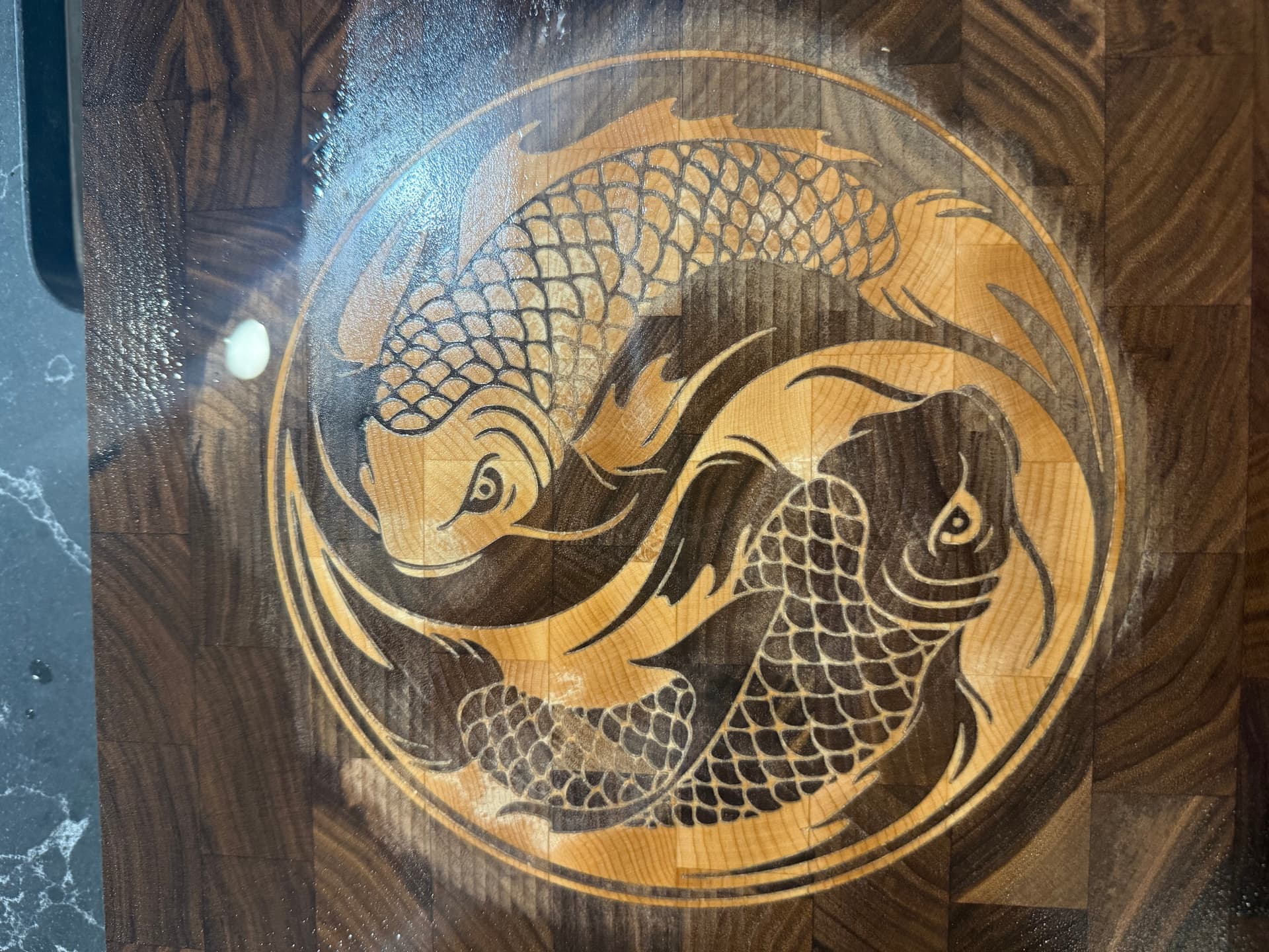

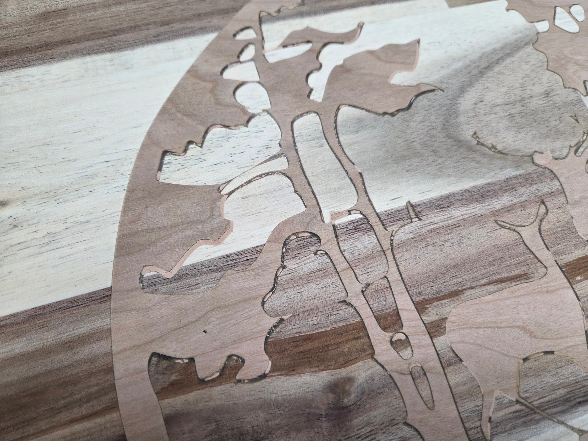

Here’s my latest inlay. It’s not 100% done, but its looking pretty darn good.

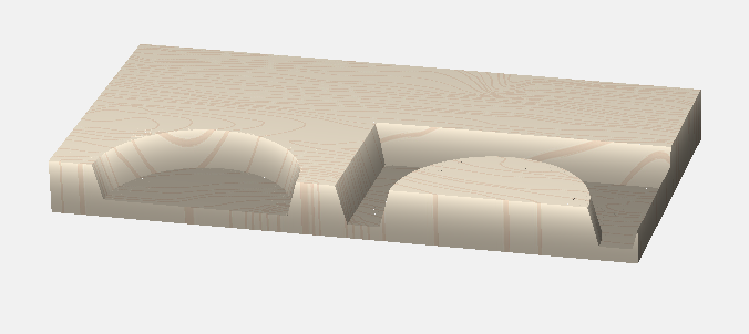

I’d suggest starting with a test. Something simple, like this with the pocket & inlay hanging off the edge of the workpiece so you can see the fit. (Or you can assemble them & band saw them in half.) Start the male with a plug depth of 2.5mm and a Top Gap of 3mm. (Still a total of 5.5) Expect it to fit high & need recutting. Clamp them together and measure the actual plug depth. Now adjust the plug depth & top gap to account for the difference in the programmed value & measured value.

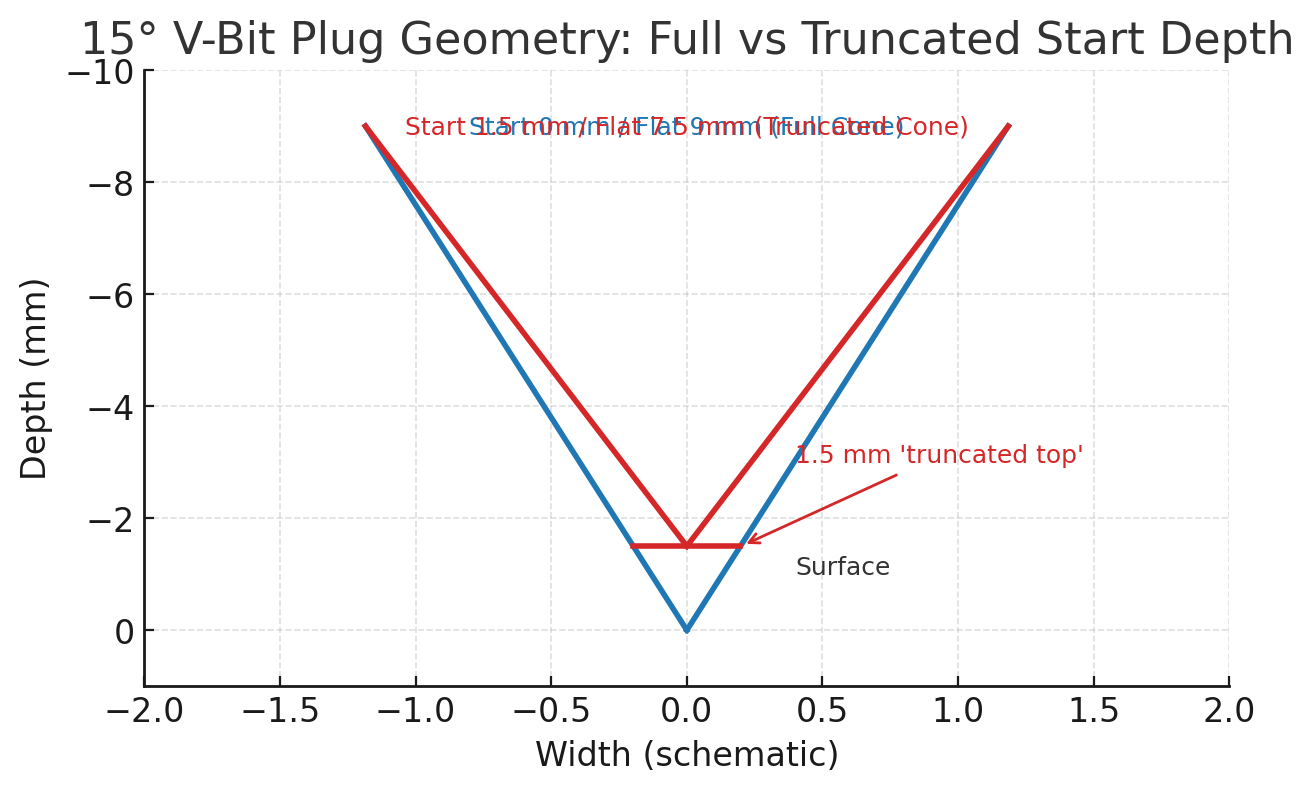

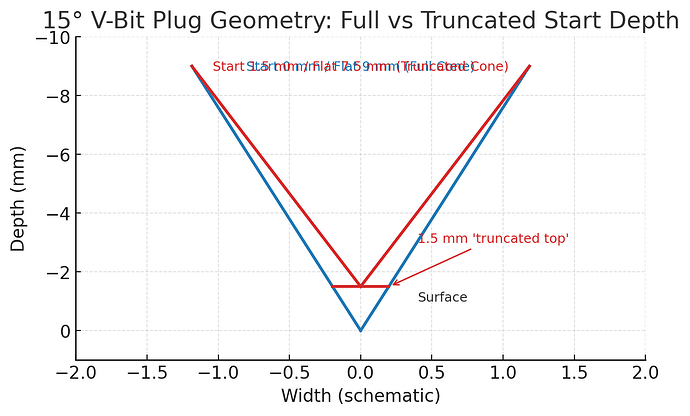

I didn’t use the Depth per pass because it changes the geometry of the carve. I can’t explain the math, but here’s visual. The blue would be a regular advanced V-carve, while the red is the manual 3 step v carve. I asked Chatgpt to explain this to me and this is what she produced, so like I said I can’t explain the math, but this is a representation of the difference.The “truncated top” allows for the bottom glue gap.
You can use whatever method you choose to do your inlays. The numbers I provided are proven numbers and proven toolpaths. I am sure CC has done a lot of homework to made the inlay mode work, but I do see a lot of questions on it. I am a keep it simple stupid type person, if it ain’t broke then why fix it.

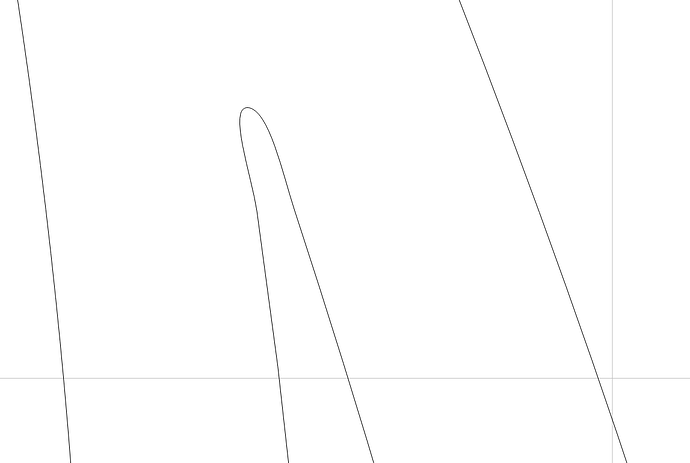

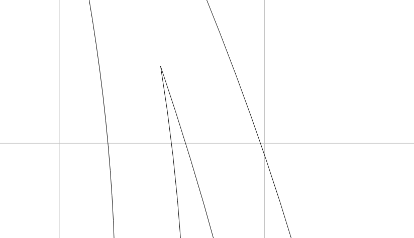

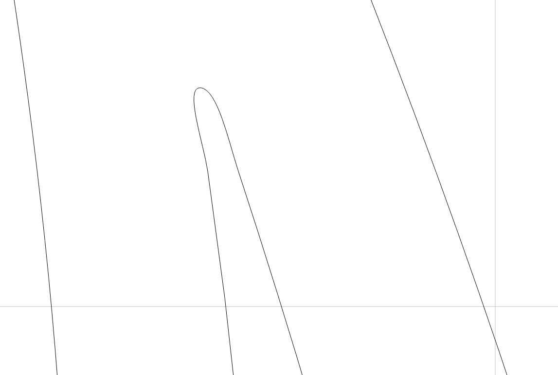

Another Pro-tip, remove any pointed Vectors.
This is a No GO:
I added two nodes and smoothed it out. This point works.
The DOC at the tip of the Sharp point will be too shallow for the plug to penetrate, it will likely break off and or be too easily sanded off, leaving the female carve showing. You can just use some glue and saw dust to fix. I just remove all these really sharp points from the Vector.
