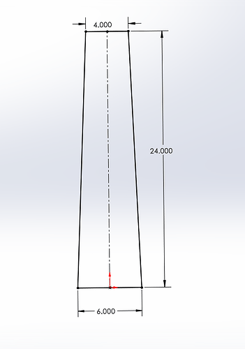

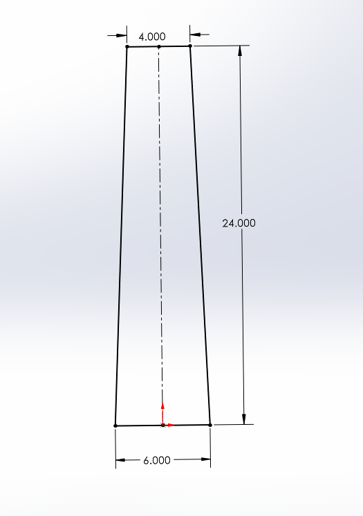

I need to mill a trapezoid shaped board with arcs in XZ and YZ planes (24 inches long, 4 inch wide at one end, 6 inch wide at the other). Each end has a max height of one inch. Half way between the ends, the max height is 2 inches. Cross sections are in the svg below. Is this possible to approximate with 3d in PRO? A mathematical approach relating the final dimensions above to the 3d modeled shape/surfaces dimensions/round angles in CC PRO would be ideal. Any takers? Thanks in advance. Bozo

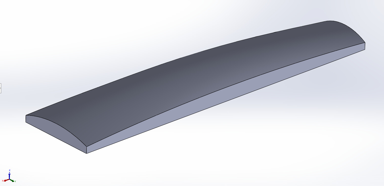

@Bozo, here is an initial try in Alibre.
loft.stl (1.1 MB)
Is it close to what you envision? I am just beginning to learn Atom (I have used SolidWorks since 1997 and though they work alike, the user interfaces are very different…) and I just drew the cross-sections you depict and lofted between them.
HTH

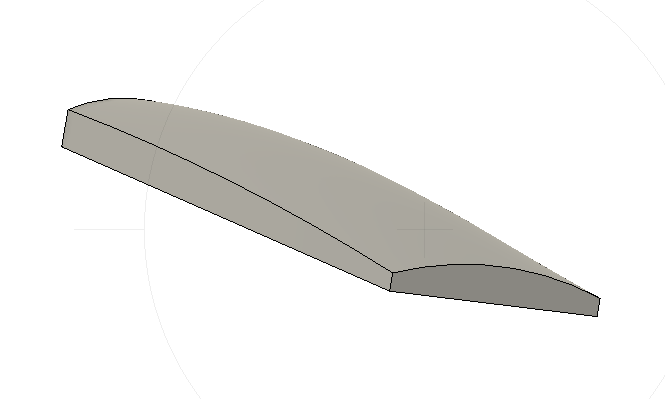

I did this in Fusion 360:
Here’s the file if you want to inspect/modify it:
Lofted.f3d.zip (78.9 KB)
I first created a sketch of the trapazoid, then a separate sketch for each of the cross-sections, located appropriately along the trapazoid, then lofted to each other.
Note the middle is 2" high while the ends are 1" high.
Interestingly, it works out that the base is half the total height. i.e. on the ends the curved portion is 0.5" high, and the base is 0.5" high. Same in the middle, base 1", curved portion 1".

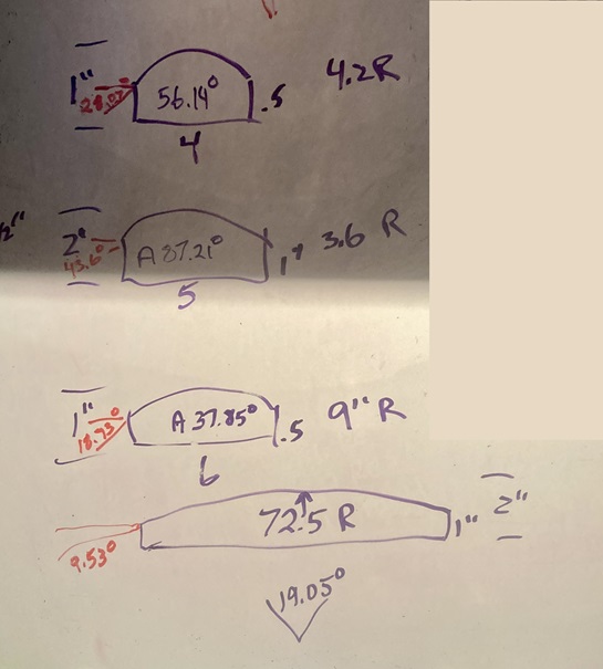

That being said, given the variable radii, and more importantly the variable chord angles, this would be difficult to model in CC. I think it’s possible, but it would require a lot of math. I’m pretty good at math, but I think even I would need a nap after figuring it out. :laughing:
Here’s what I got. the Red angles being the angles you’d need to build the round component.
If someone really wants to figure this out, I will kibitz… Or to quote Sheldon, “Is this rhetorical, or did you want to do the math?” :laughing:
Clearly, I am in the presence of greatness. Many genius IQs here. A huge thank you to all, especially Tod1d who taught me the modeled angle in CC is the angle of the tangent to the chord encompassed by the surface. Now I need some wood in the stove, coffee by my side, and study time to see what I can do with the information (after I plow snow). Cheers to all and thank you much again! Fantastic forum.

I think a close approximation is possible with PRO. The following SVG shows a single keyhole shaped model and the trapezoid to be cut 3d. A round angle of 18.92 degrees and a base of 0.5 inches should give a close approximation with this model. This is all based on the math. Now maybe I can justify a more modern computer and CC PRO to see how close I am.

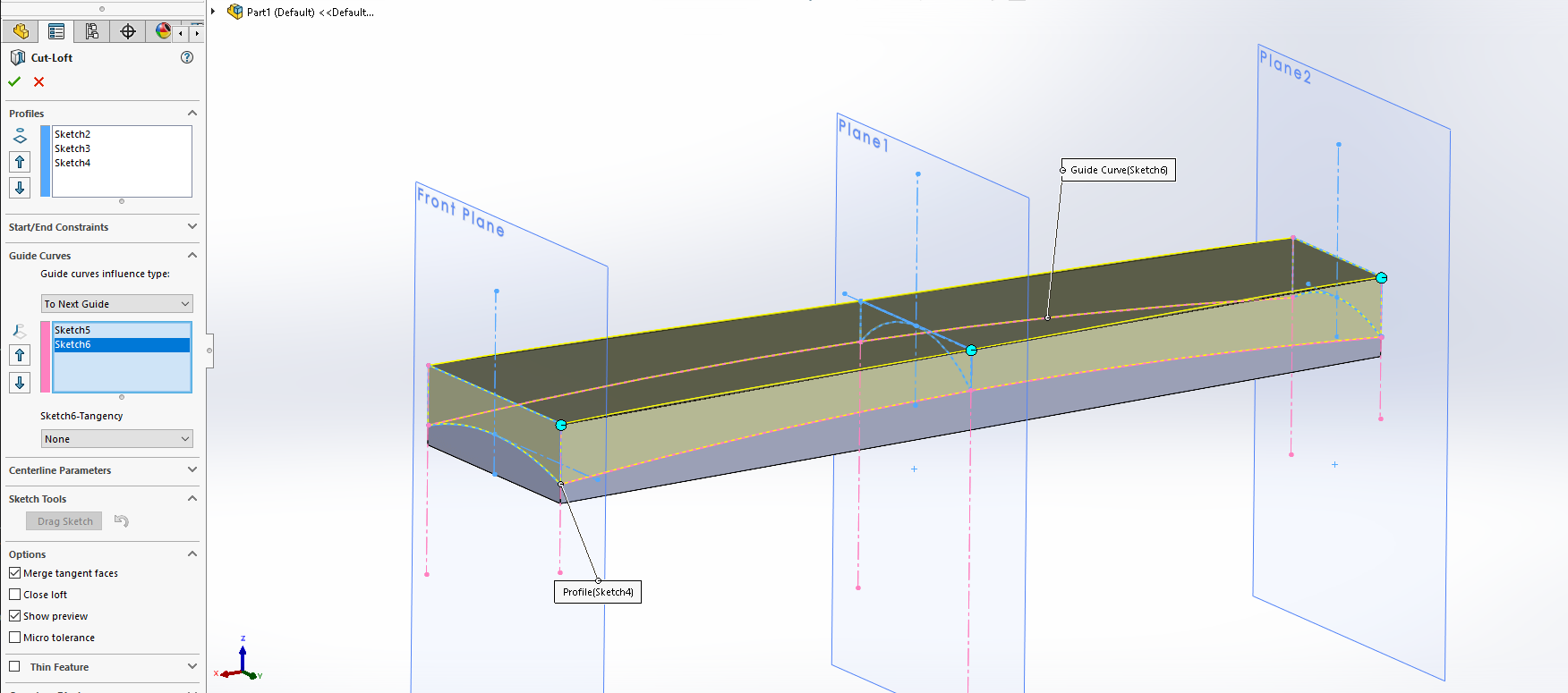

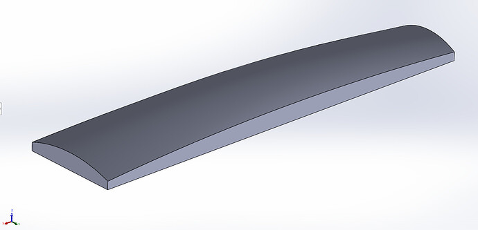

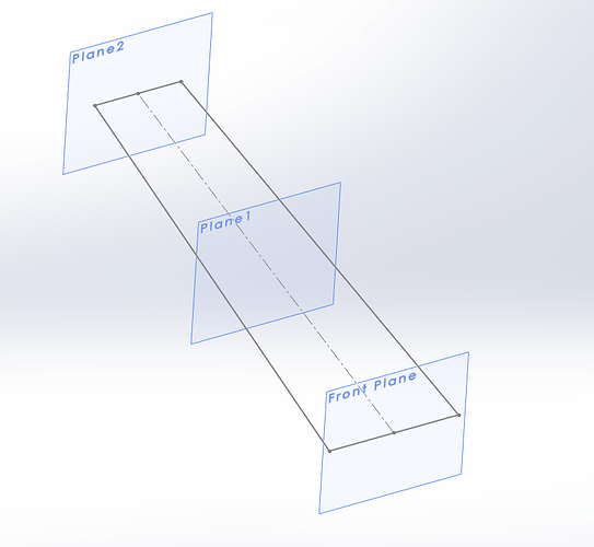

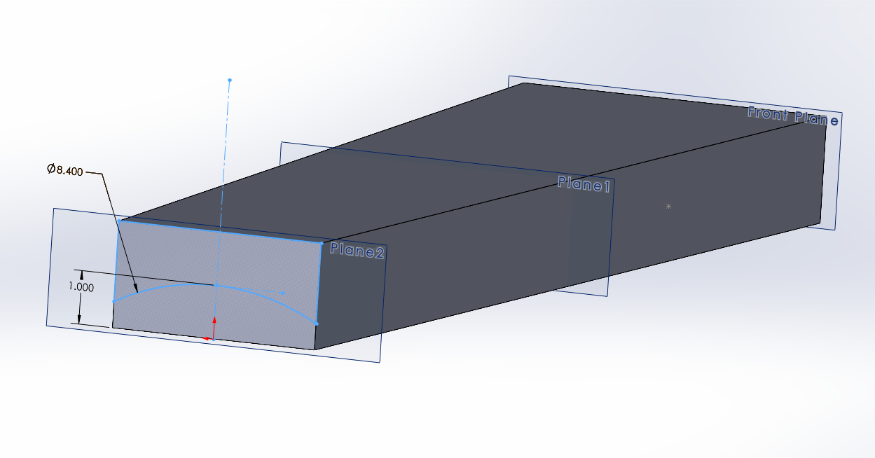

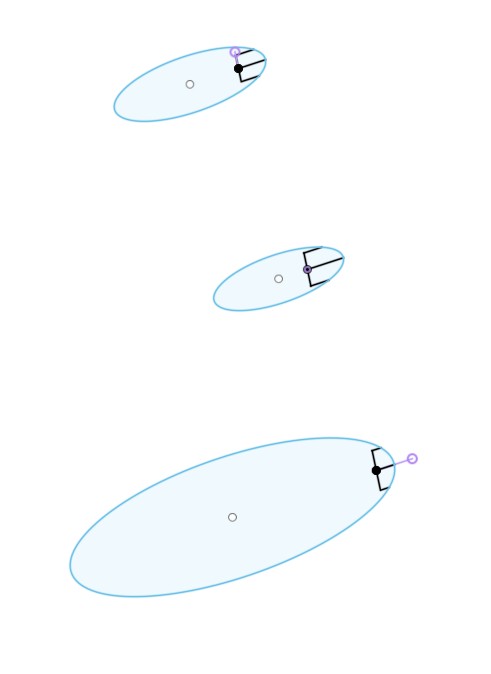

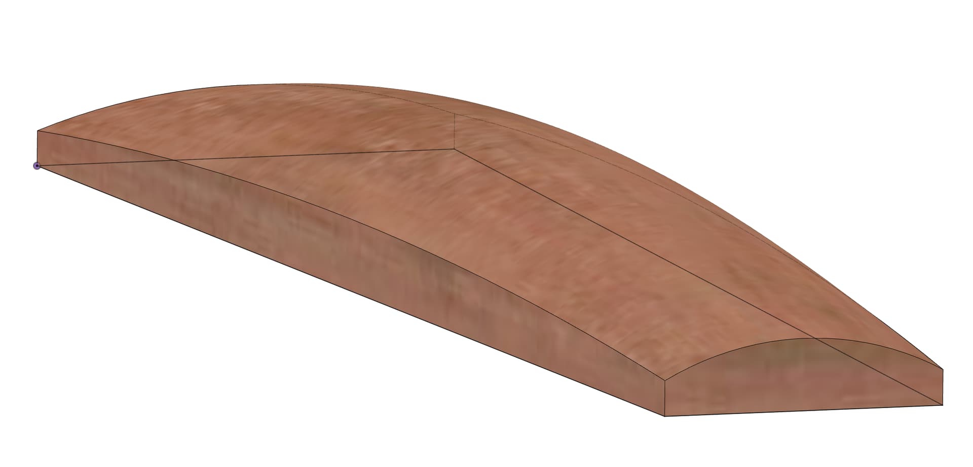

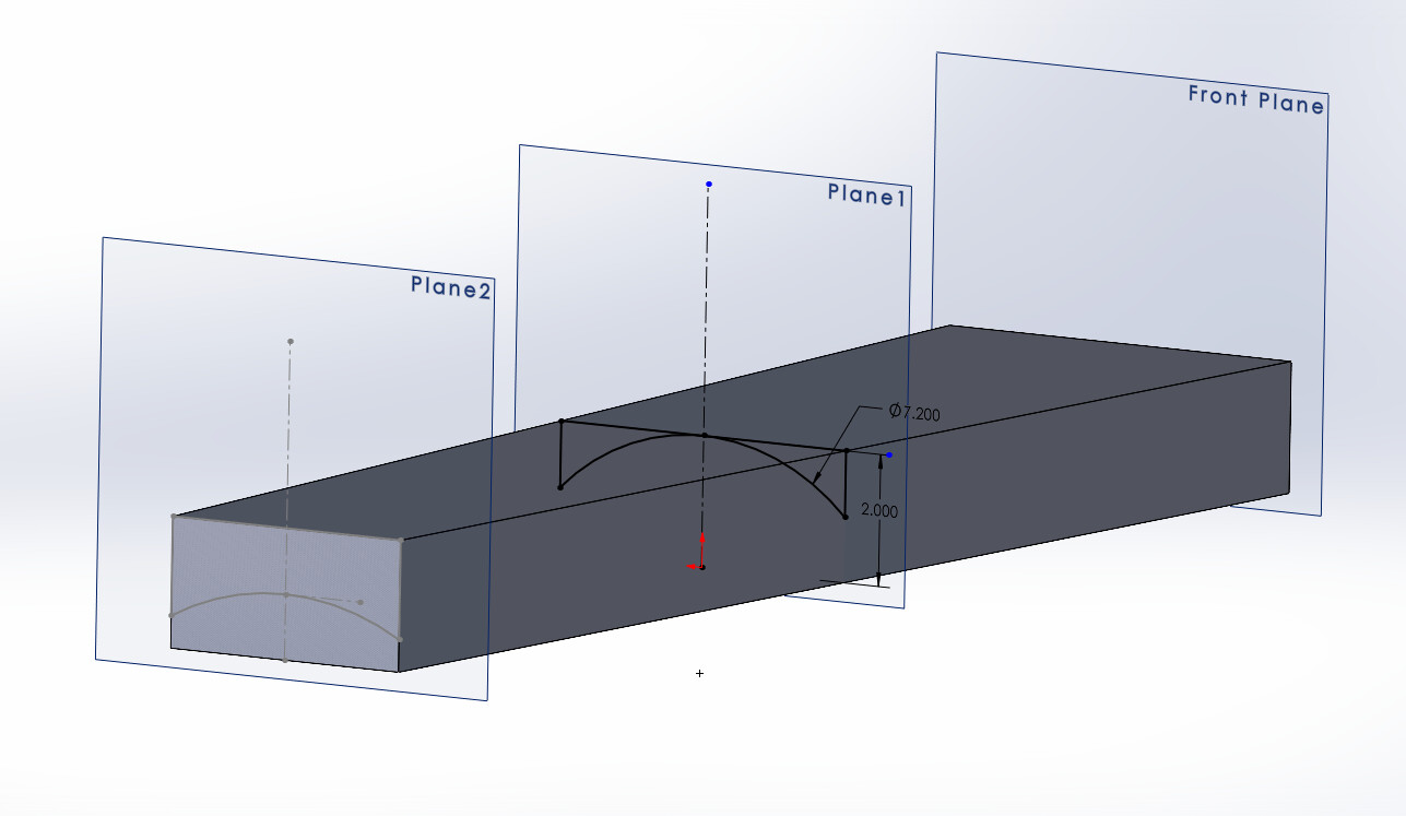

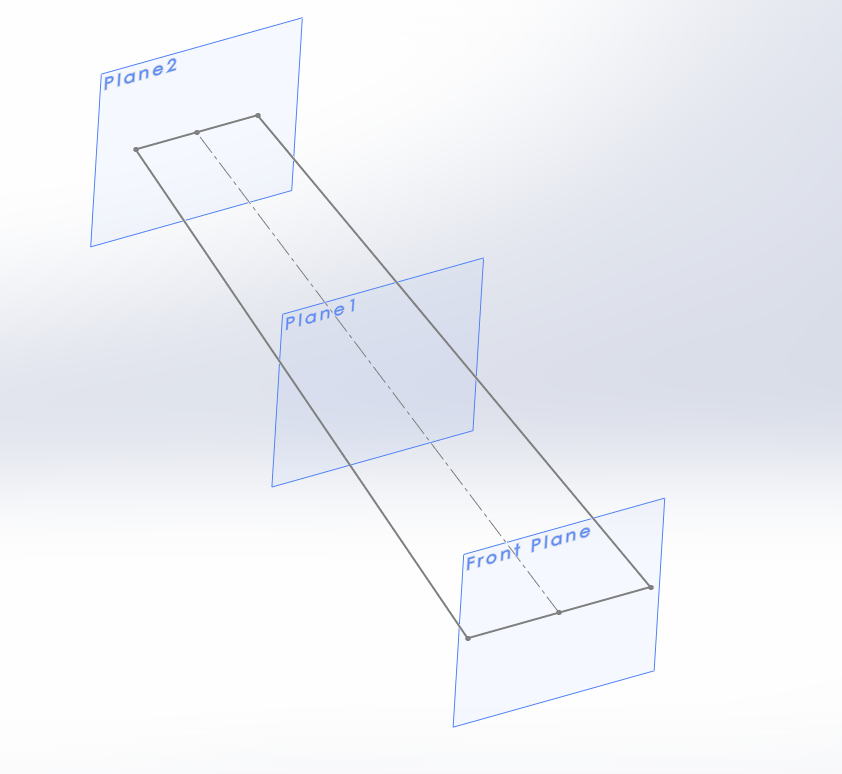

I guess it’s my turn to try it.
4" wide at one end, 6" wide at the other, 24" long.
Three planes; one at 0", 12" and 24".

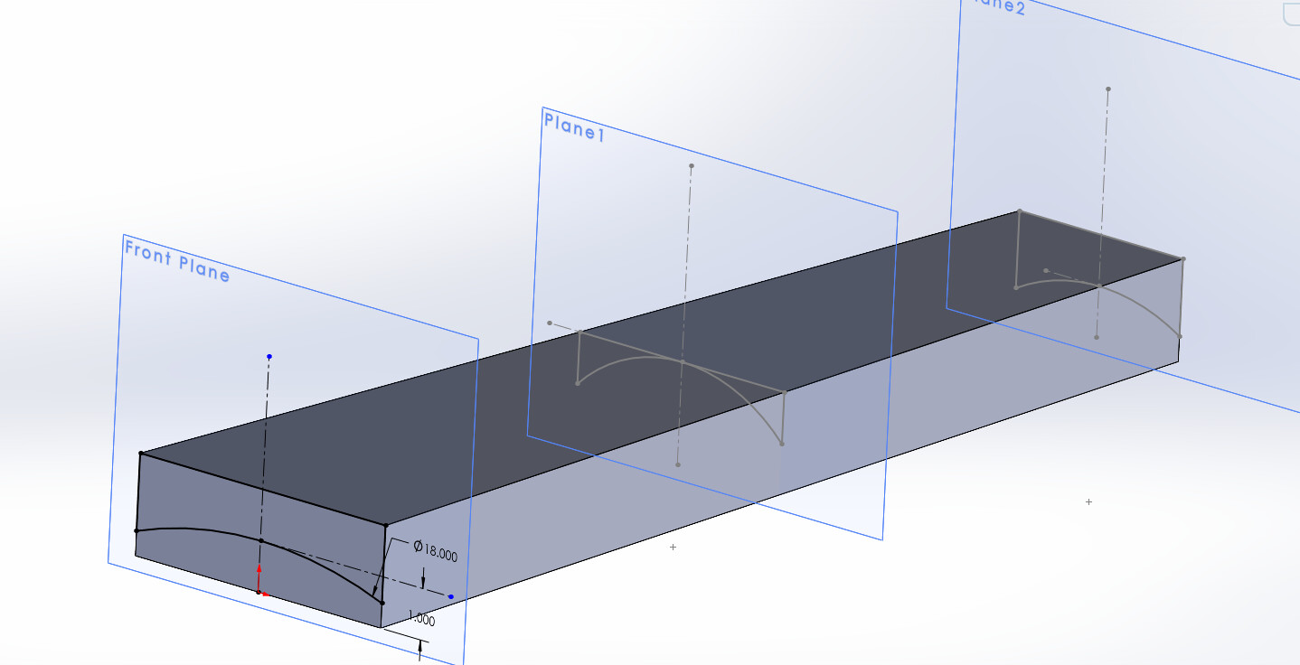

4.2" radius at the 4" wide end, with the top of the circle tangent to a line 1" above the bottom. I started with a circle, so it shows double that.
Mid-plane arc is 3.6" - 7.2" circle - with the top of the circle tangent to a line 2" above the bottom.
Bottom is a 9" arc - 18" circle - with the top of the circle tangent to a line 1" above the bottom.

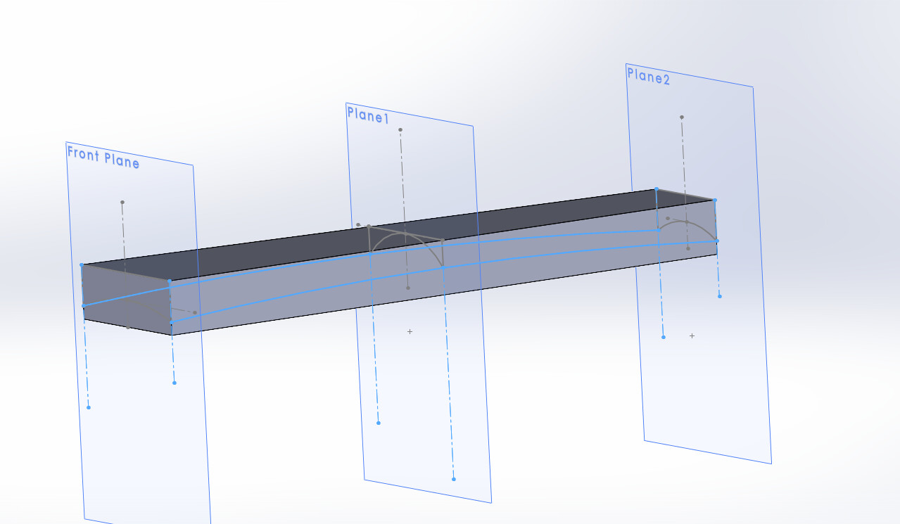

I added guide curves along each side (light blue arcs) by making a circle centered on the middle of the piece, and had all three points coincident on the circle.
Then we do a lofted cut, and put in the three profiles, and two guide curves. I guess I could have done it as a lofted pad instead of a lofted cut, but potato potato. . .
And here we are.
Bozo-T-Clowninator.STL (102.8 KB)

MadHatter, that is perfect enough. What software did you use to generate the stl? Thank you.
