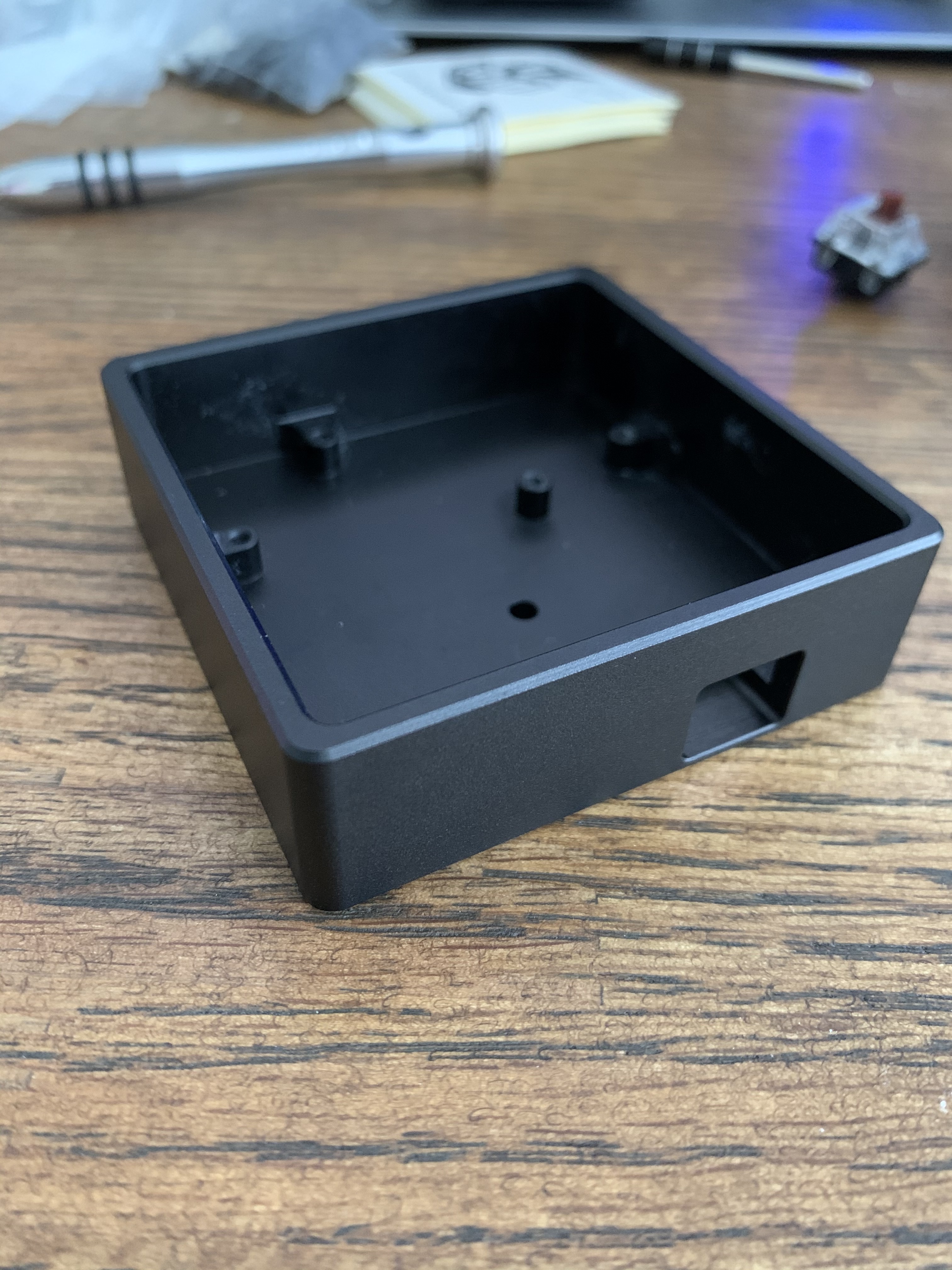

I too wish a NineKeyBoard CNC Edition existed.
Its in production!!! Subscribe to the newsletter on http://techkeys.us to be notified as soon as it is in stock!!
Funny – just after posting this the aluminum anodized cases just showed up! They look fantastic!
Hoping to get the PCBs in the next week or so.
Thank you @willAdams and @i3oilermaker
I assume increment up and down will be two of the three additional keys?
If so then this sounds like something I will need to have.
Unfortunately, increment up/down is only available on game controllers such as the Logitech F310 — if the electronics allow presenting the peripheral as a game controller then yes, those two shortcuts would be available.
Without them, unless @robgrz exposes them as keyboard options you want 4 buttons, one for each speed as I emulated for a gamepad as noted above.
Yes - the keys are programmable so if at any point the available keystrokes are made an option they can be added.
For now the plan was to pre-program with the 2, 3, and 4 keystrokes to equate to “slow”, “medium”, and “fast”
