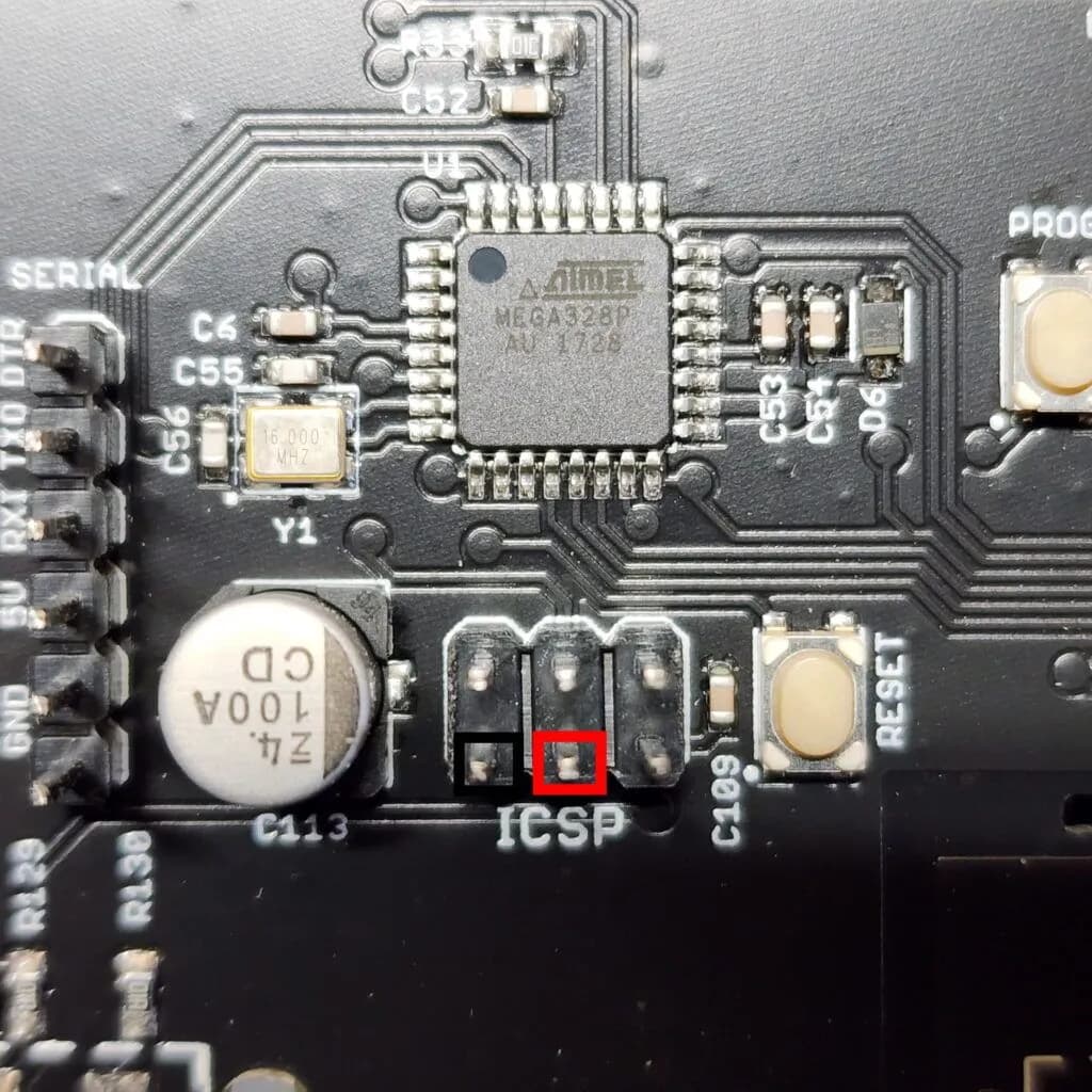

Another question (Yet another): Does anyone know how to hook up a JTech laser to the 5.1 Pro? The old setup we had to connect into the board. Is there one built into the controller here too? PS - I have the question out to Jay as well… I’ll let you all know what he says.
those new connectors look so much better than the ones I fight with all the time on the pro.
Got word back from JTech. It’s the same connector as for the older Shapeokos. You need to open up the control box and fish a connector in to the ICSP on the board:
Pretty straight forward.
