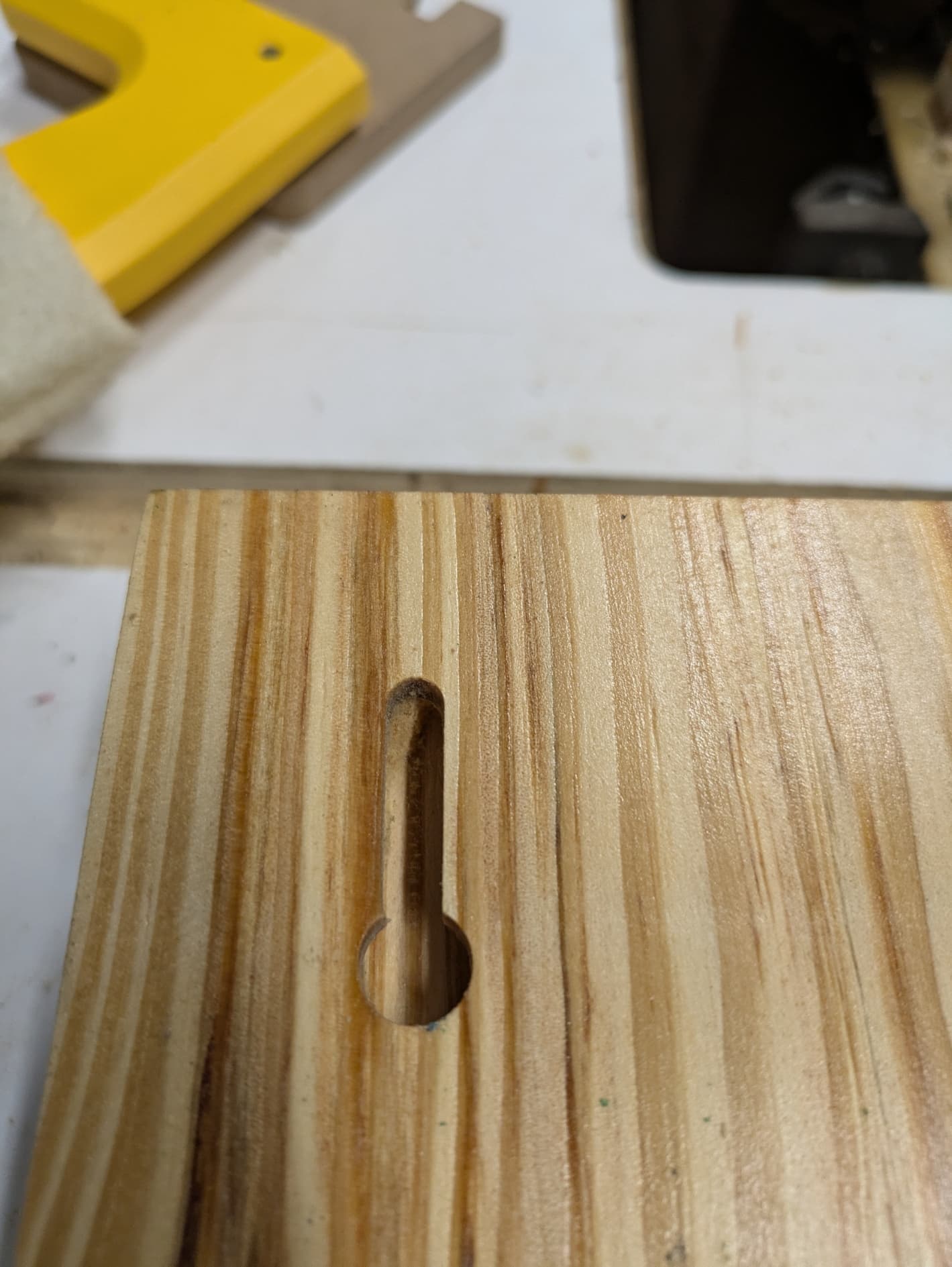

Can anyone help me make keyholes with Carbide Create? Not just a keyhole but a keyhole with an undercut, so I can hang it on a screw in the wall.
Here is my process so far:
  1. Use and end mill to cut the keyhole shape (pocket), without undercut.
  2. Change to the keyhole bit (bit with undercut).
  3. Plunge the bit to the bottom of the pocket (below the surface) and contour cut up to the end. But then carbide create would extract the tool vertically and ruin the keyhole.
  4. So, I think I have to edit the G-code to back the tool out the same hole it came it.
    Any better ideas are appreciated!

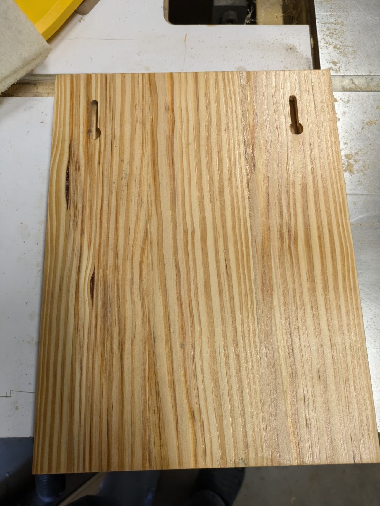

I use a Frued keyhole bit to make key holes. The tool path plunges to the depth and then plows forward to cut the narrower part of the keyhole. Since the bottom cutter is wider than the stem you get a recess that the screw head can fit in. Here is an example on a plaque I just finished.
Here is my custom tool for the Frued Keyhole bit. Do not use my tool unless you have exactly the same model keyhole bit. Use my database as a guide for a keyhole bit you may have.

I need to slow the IPM after the bit plunges because my router really screams when it moves forward. I just dont make a lot of keyholes and forget to do it.
Edit: I shamed myself to updating the F&S for the Keyhole. Should have done this a long time ago. The keyhole tool path is very fast so slowing things down wont effect my cutting time much.

THANKS for the insight and experience. I was thinking of something the same but it’s nice to know someone else has done it.
