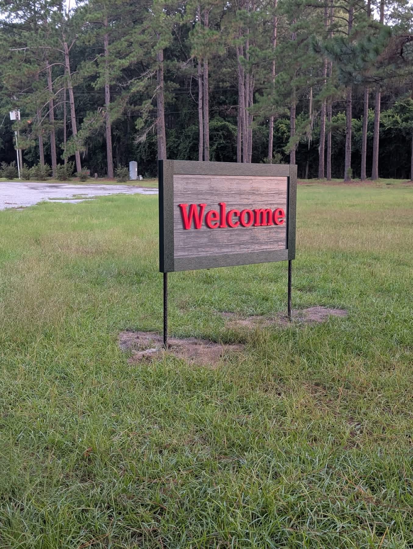

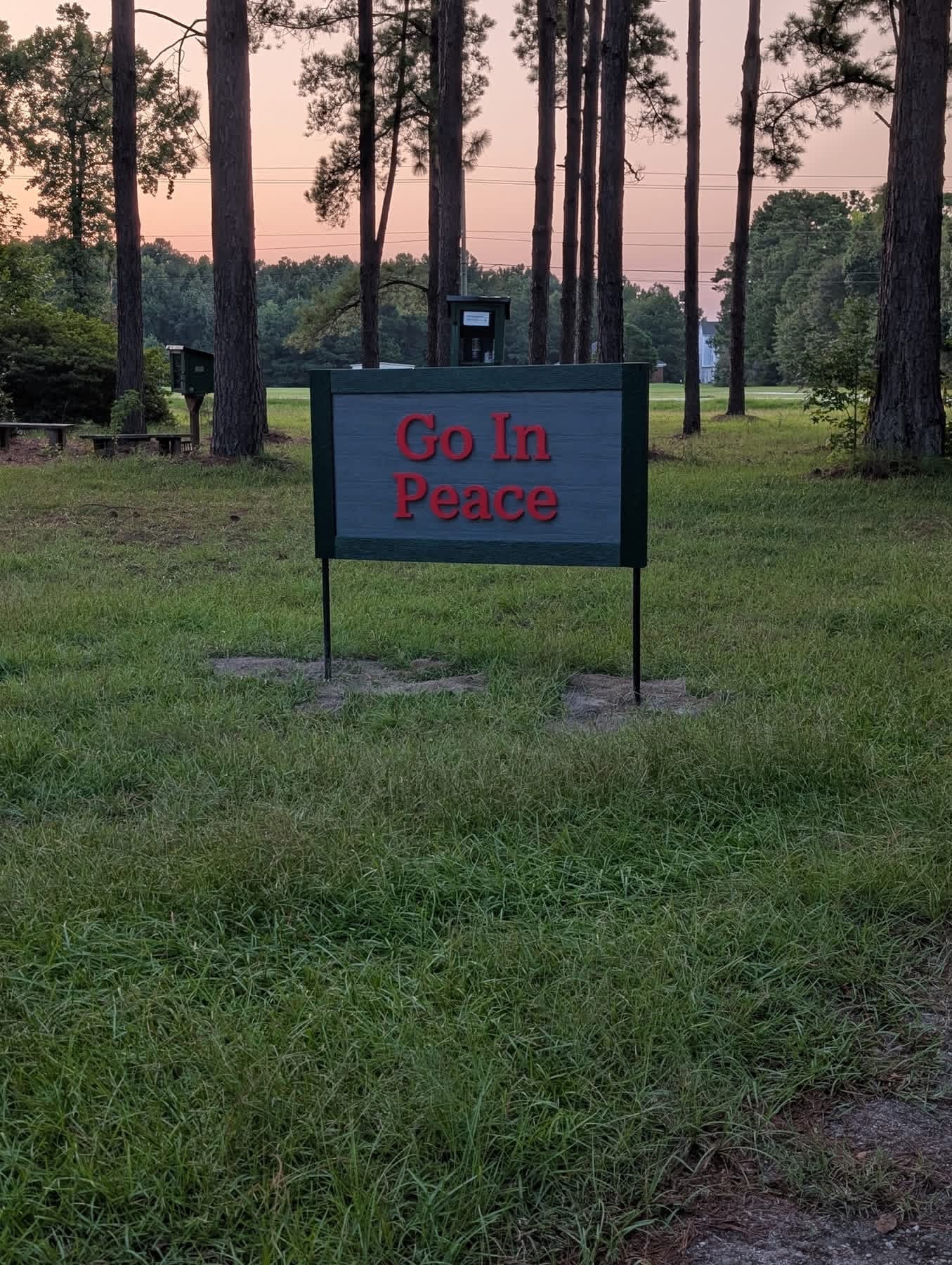

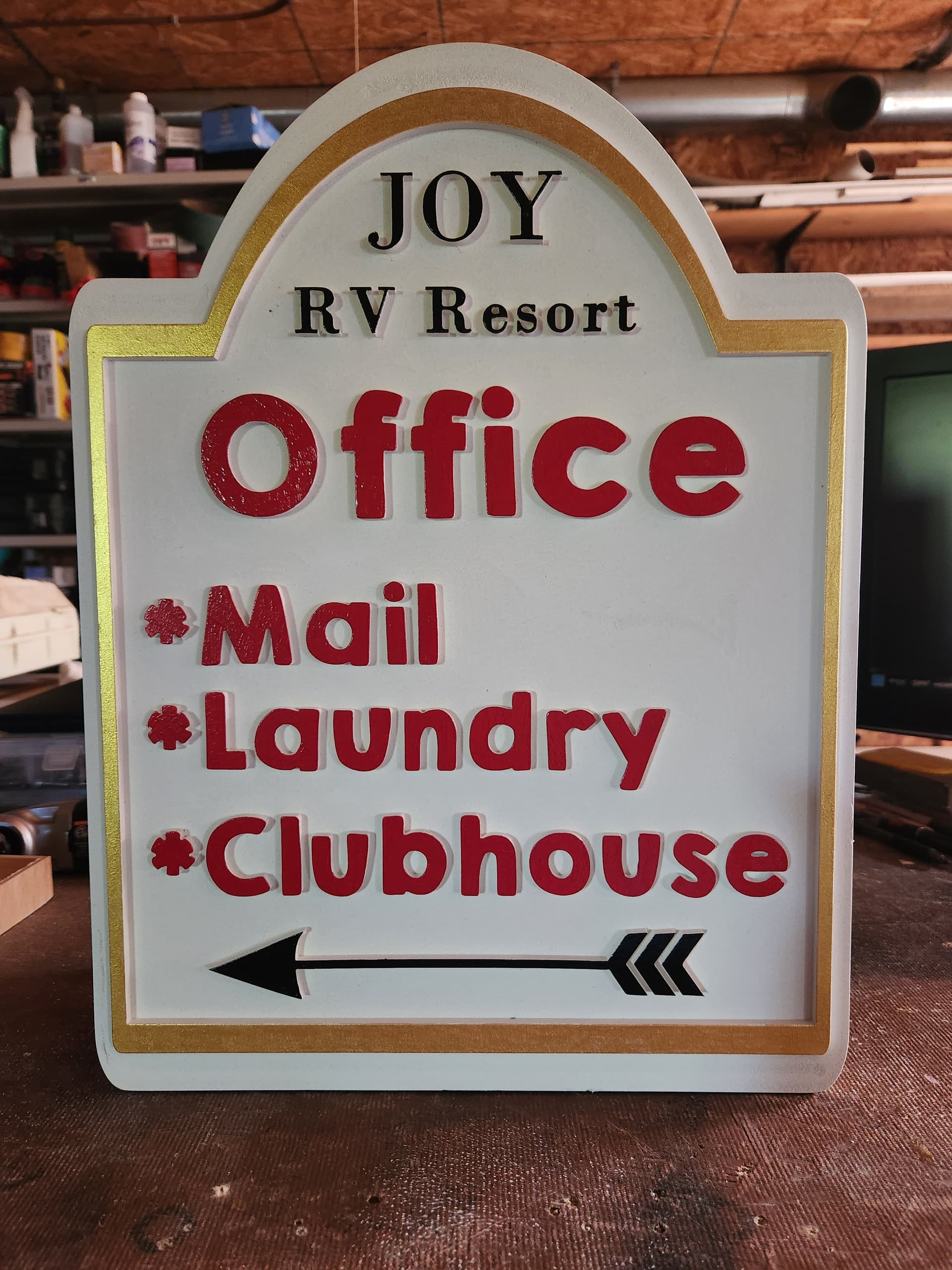

Here is one I did for a church. It’s all PVC, letters,
Backer, frame. The only thing not PVC is the legs which are black pipe.
It is about 28x52 if I remember correctly. If you want more details let me know and I will explain it more.
I think this could be scaled up to 4x8 but it will be heavy. These are double sided. Are
You looking for that or single?

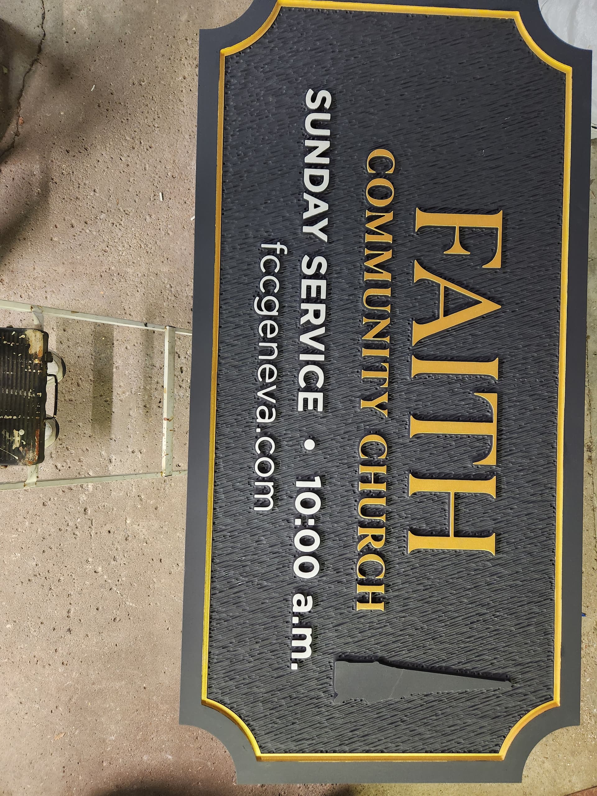

While expensive, the right material to use for an outdoor sign, especially this size is HDU. Typically 1.5 inch thick and 15 pound wirght. I just finished posting (Everything In The Pot) about a 64"x32" sign for a church that had texturing.
Sign prior to finish.
It looks great. Two quick questions. How do you achieve the texturing? And do you paint it afterwards, or is the yellow and white from sort of layered/masking effect?
Great questions. The texturing is done using the texturing tool in Carbide Create Pro. There are a few settings, but it gives you a fair amount of flexibility to create a texture that you might like. HDU is a light green material throughout the board. In this case I cut everything then sprayed on 2 coats of white primer/sealer over the whole thing. Next went on two coats of flat black in this case. The letters are hand painted using what is called a “floating” technique. Using a foam brush, 1/2 inch in my case, get a fair amount of paint on it. Starting in the middle of the letter dab/stroke the brush towards the outer edge of the letter. Before putting on the primer, use 240-400 grit sandpaper to break the edges of each letter. This makes the paint adhere better to the letter while providing a clean edge. My letters are 0.200 high while the material is 1.5" thick.

I used PVC for the one I posted above as it already had the woodgrain texture. I did the whole project for cost which was probably close to the cost of that sheet of HDU that you used😊
I like your posts, how did you attach them to the piece? I used black pipe for the posts and routed a channel in each half of the frame side to make a cylindrical hole when assembled that the pipe so would slip into. No hardware showing anywhere.

PVC Sign
The texturing was 75% of the time to cut, even at 185"/minute, I think the total cut time was over 5 hours. The letters were not made separate and glued to the church sign. The sign is carved leaving the letters as you see them.
As for the mounting, the church had a frame made of two 4" metal post with 1.25" box tubing welded between the two poles. This whole thing was powder coated black. The sign is mounted to the two horizontal box tubes using high-quality silicone and 1.25" screws every 10" apart.

So…woodgrain texture on the pvc? Interesting! Is that what is on the borders, on the background of the sign or both?
Great looking signs, btw!
The PVC boards are typically textured on one side and smooth on the other.
The backer was two 3/4” pieces glued together on the smooth sides to leave grain exposed on both. The frame is true 1” x 4” glued back to back in the same way except that I routed pockets on them before glueing to create mortises for the sign to slip into and for the pipe support legs.
For the letters I put the smooth side up instead of the woodgrain so that I could nest them all in a 2x4 sheet and not worry about grain orientation looking weird.
@StephenMV I know what you mean about the porous surface and it not taking paint as well. I did a little research and tried wiping with acetone to make it smoother but discovered wit just a little sanding it worked just as well. One of the reasons I did this sign the way I did was to keep 98% of the surface the factory finish so the paint worked better. The only thing not factory finish is the ends of the vertical boards and the 1/8” roundover I put on the edges of the frame boards.
