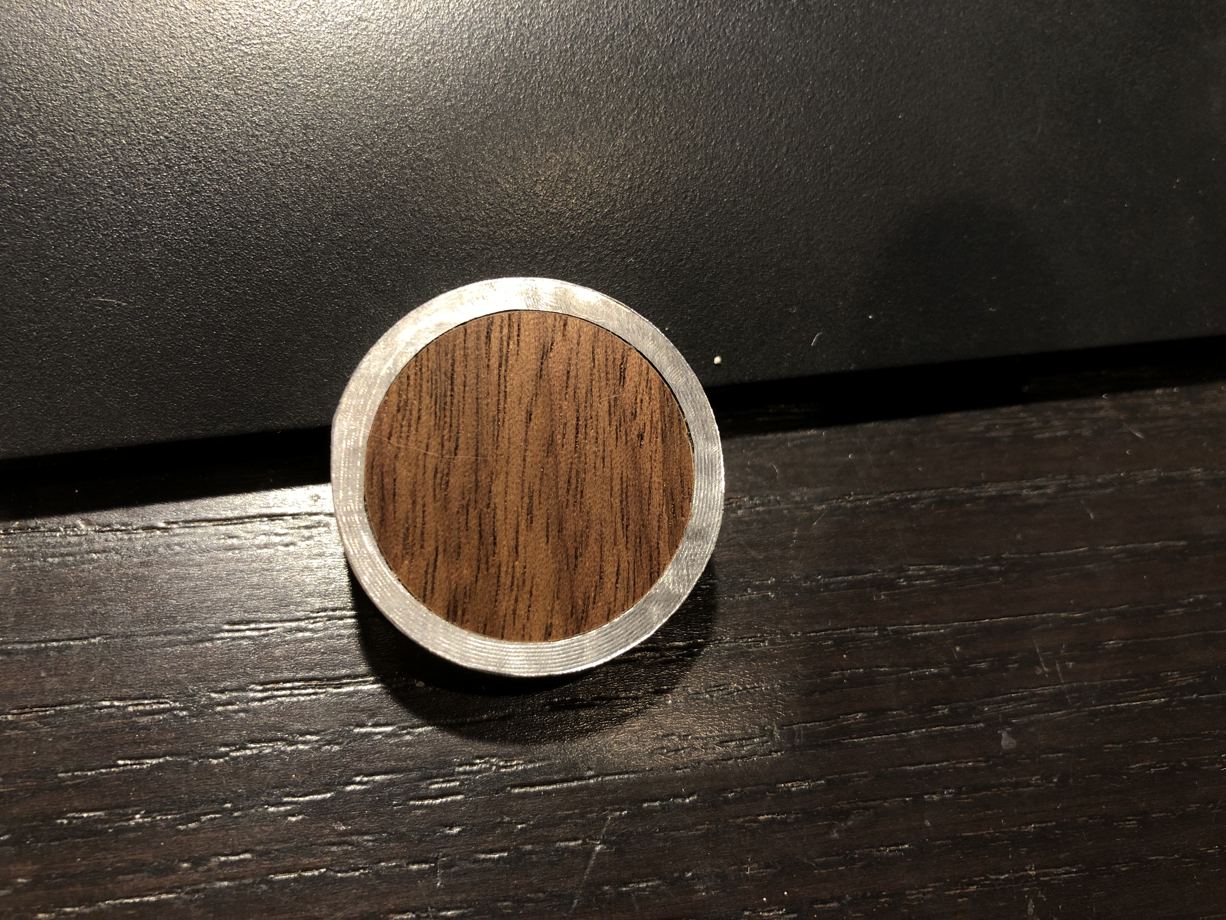

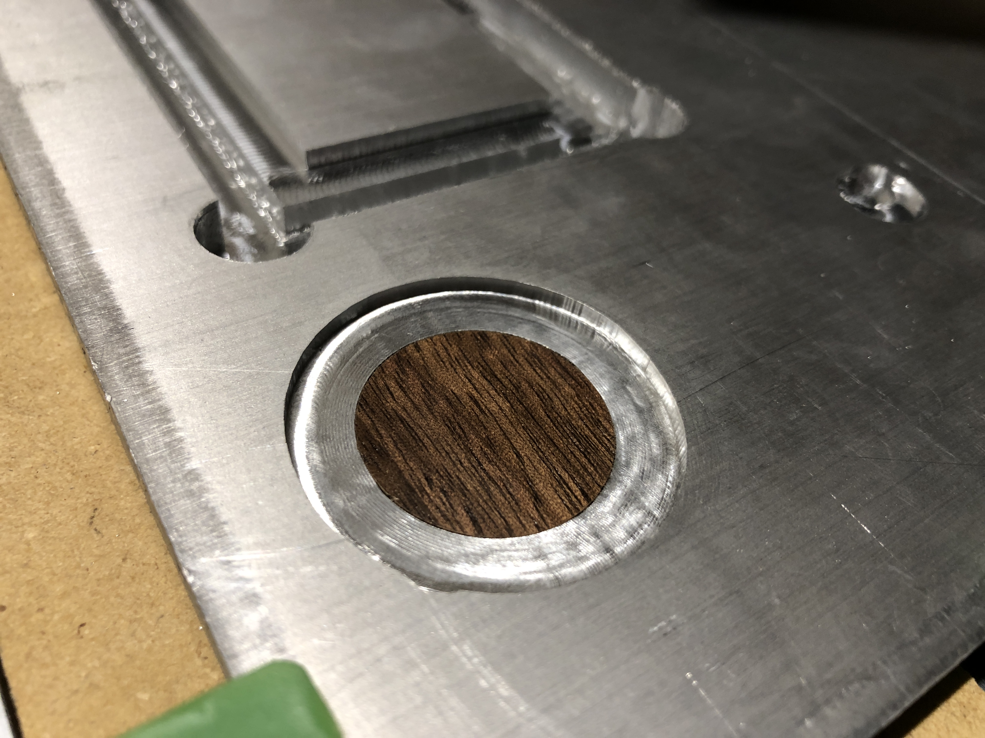

I just read through all of @TX_diy’s comments in this thread tonight hoping to find a solution, as I saw the same issue with my XL Pro today.
I was trying to inlay a 1" circle of .03" veneer (cut on a Glowforge) in aluminum, and also saw the flat sides on the left and right of my circle.The little flat spot was just enough to prevent the veneer from sitting neatly inside the pocket, so I ended up making my pocket circle .002" larger in diameter.
I have a 1.5kW spindle, so the issue may not be because your laser does not provide a load parallel to your x-axis when cutting. I’ll play around with my machine some more this week and contribute here if I discover anything useful.
Make sure your router is turned off and unplug it (Dont want it accidently turning on). Turn on power to your Shapeoko and connect to the machine with Carbide Motion. This should lock the stepper motors. Grab onto the spindle and trying moving it around. It should not be possible to move it without SERIOUS force. If you can move it, you have backlash. Take a look at the belts and stepper motors while you wiggle the spindle. Make sure to check the pulleys are not slipping on the stepper motor shafts.
