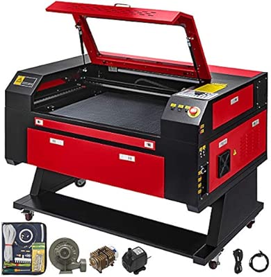

I saved myself all this trouble and bought a 60W Co2 Laser Engraver/Cutter. You can get a smaller 40W for less than $400.
Hey @ispot,
What do you think of that laser?
The thing that has me worried about these has always been the lifetime of the laser tube, and they’re not cheap, has that wokred out ok?
I love the cutter, and it does have a one year warranty. As long as you use a good liquid cooling setup to cool your tube, you don’t have to worry about the tube. I did not use the included water pump. I used a Watercool MO-RA3 360 PRO Stainless Steel Radiator radiator, and mounted total of 18 DEEP COOL CF140 RGB cooling fans, 2 two Alphacool VPP655 PWM D5 Pumps, , and a Aquacomputer Aqualis XT 880 mL with Fill Level and Lighting Option | Nano Coated, , and to match the cutter color, I used the Alphacool Eiswasser - Premixed Coolant - Crystal Red - UV Reactive, and for tubing, I used Pure Silicone Tubing - 1/4" ID x 3/8" OD - High Temp Kink-Free Hose Tube to connect to the cutter Laser Tube, and the Alphacool Eisrohr 13/10mm PETG for the rest of the loop.
Yep I’ve sort of abandoned my diode laser since I bought my CO2 laser. My Chinese “50 watt” laser was likely closer to 30-35 watts. I swapped the tube and power supply with a true 45 watt (53 watts measured at peak) and its around 5” longer. The Chinese fudge their numbers a little. I was cutting 1/8” Baltic birch at 11-12mm/s with the old tube, I replaced the Chinese mirrors and lens which got me to 14mm/s, when I replaced the tube and power supply I’m up to 23-25mm/s at 14mah…Chinese “50 watt” is nowhere near 50 watts. The diode by comparison is probably 1/30th the speed. I use a proper CW-5000 water chiller. When the ambient temperature in my garage is 100+ degrees there’s no way a radiator cooler is going to keep my coolant at 60 degrees, which means dead tube. Now that my garage is down below freezing I just leave the chiller running 24/7 so it doesn’t freeze, so far so good.
