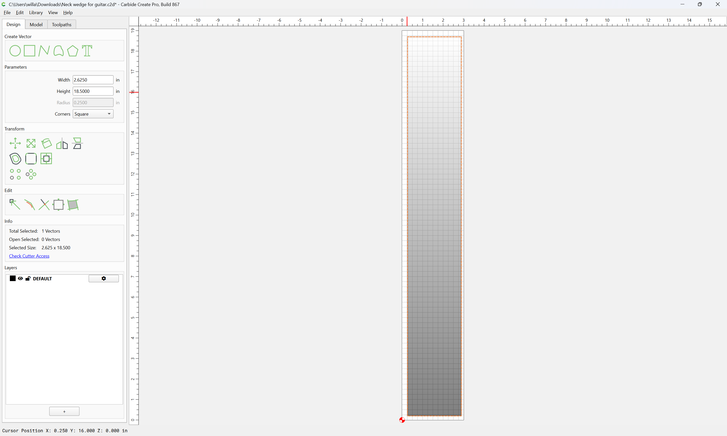

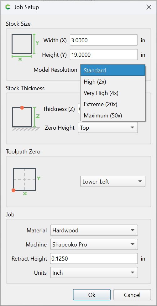

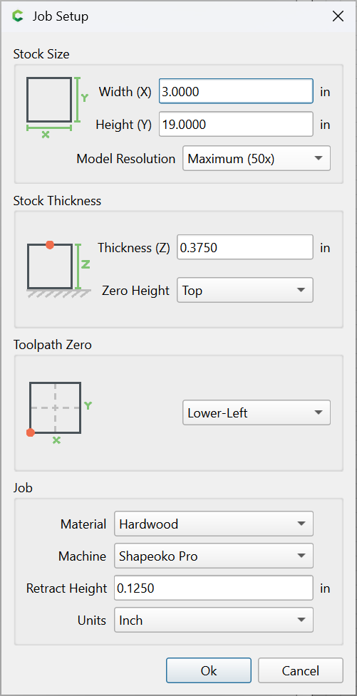

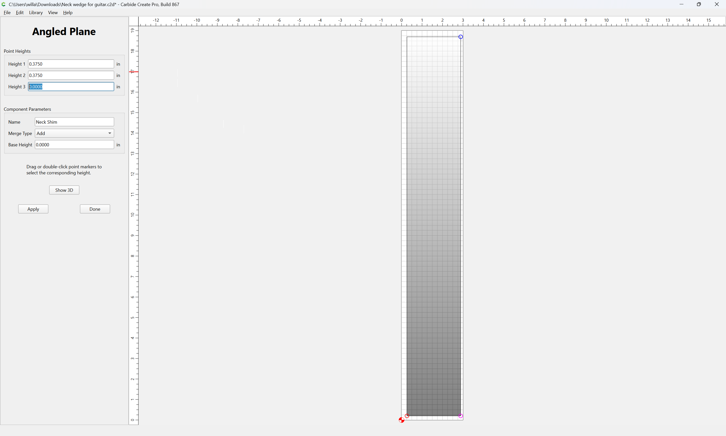

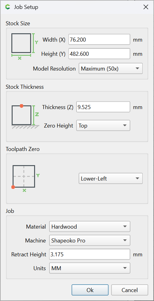

Ramping is a feature in Carbide Create Pro and the new Angled modeling feature:
allows one to make such in the 3D model.
