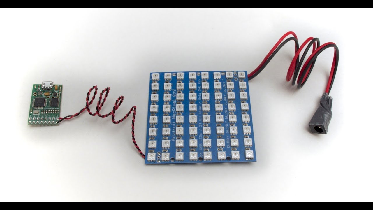

I am looking for a good excuse to use Fadecandy in a lighting application. This may be it!
Neopixel begs for FadeCandy
The controller is expensive but worth it for the effect
