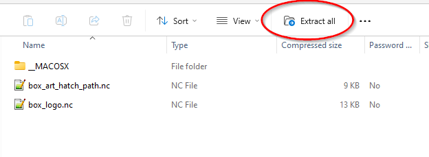

I am new to cnc and not very good with computers. I have the cnc set up and was attempting to load the hello file from the beginners series. I have it downloaded and can see it in my file explorer but when carbide motion opens the explorer nothing is there in the downloads to open. it is looking for all gcodes so I am assuming the file what was downloaded is not a gcode file or needs to be unziped or something. I have spent about 2 hours trying to figure this out.

it is an .nc file I can see it in windows explorer. but when i try to load the a file its not in the file explore screen that motion pops up.
The download is a .zip file. If you are looking inside the .zip file & see this, select the “Extract All” option
As noted, it’s a .zip archive and must be unzipped.
