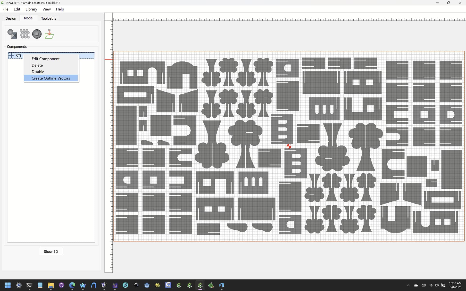

Spent all afternoon trying to find how to get an stl into CCP and have it just do a basic contour cutout of flat material. Doesn’t seem to work the way it did in v7 but it has been a while since I’ve had to work with an stl file just to cut flat pieces. Any one able to point me in the right direction? Thanks

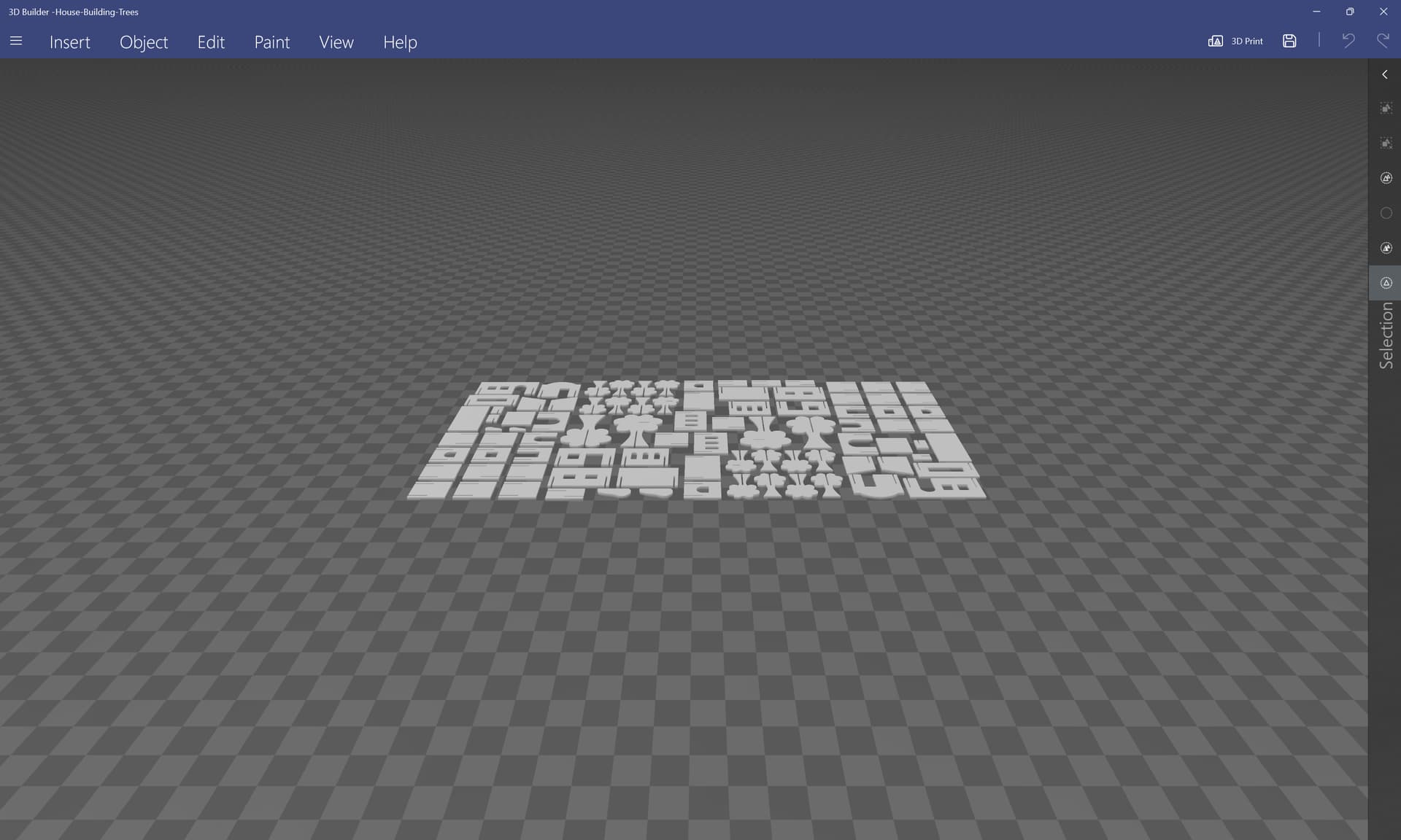

Maybe I just can’t do what I’m trying to do. The STL file I have has multiple objects in it and I need to just cut our each on their own. Seems everything I do it either wants to cut everything as a single unit or I can’t get the thickness right to cut out with tabs…as though it were an svg set of objects.
Is there a way to covert an stl to an svg file?
It should work to import multiple STLs, and once the file is imported, the outline can be traced as shown in the above links to create vector objects (which if desired may be exported to SVG).

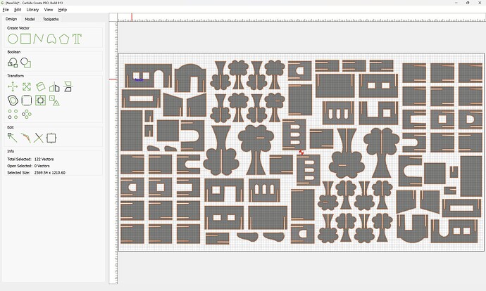

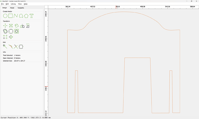

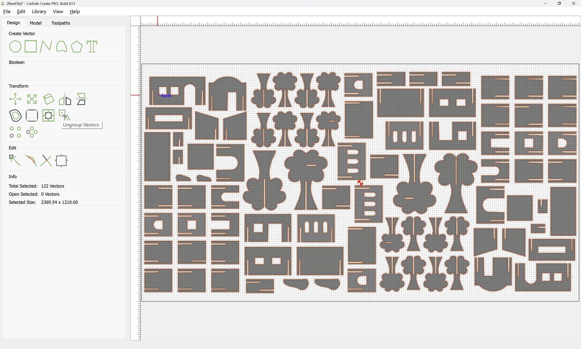

Given an file such as:
since it is inherently 2D, it is quite straight-forward to just import it into Carbide Create:
right-click on the imported STL
choose “Create Outline Vectors”
OK

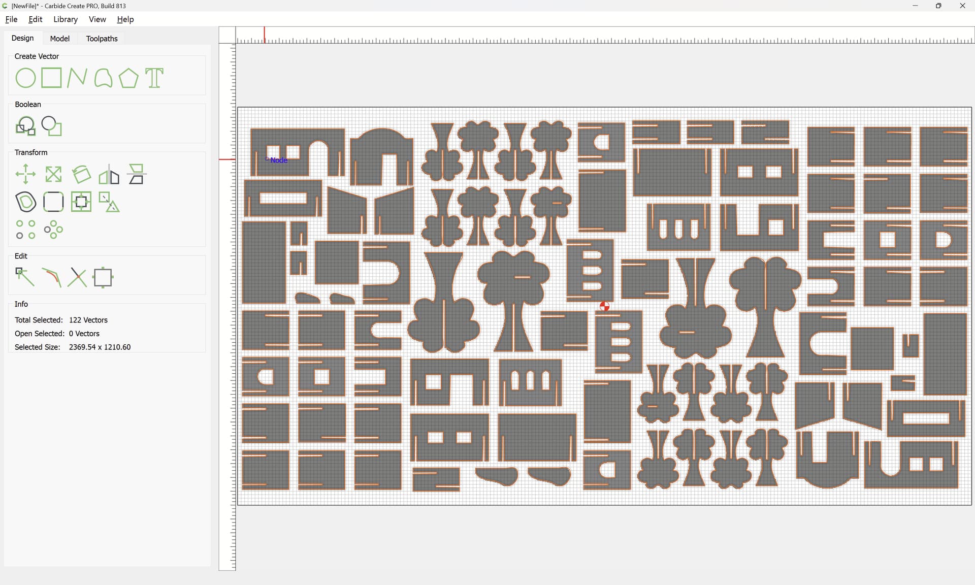

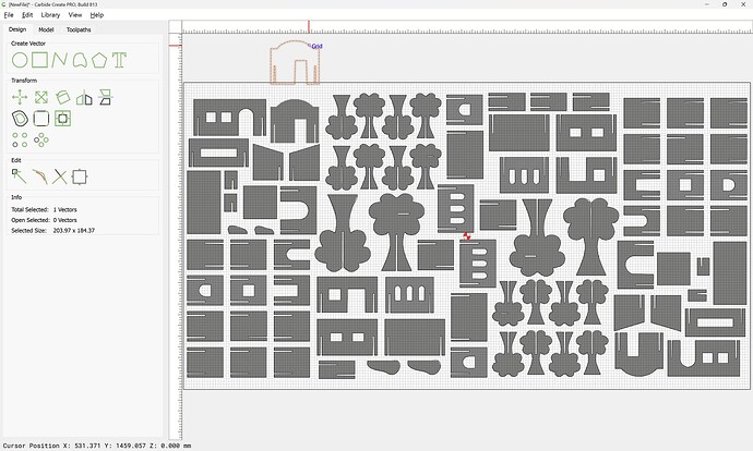

switch back to the Design tab:

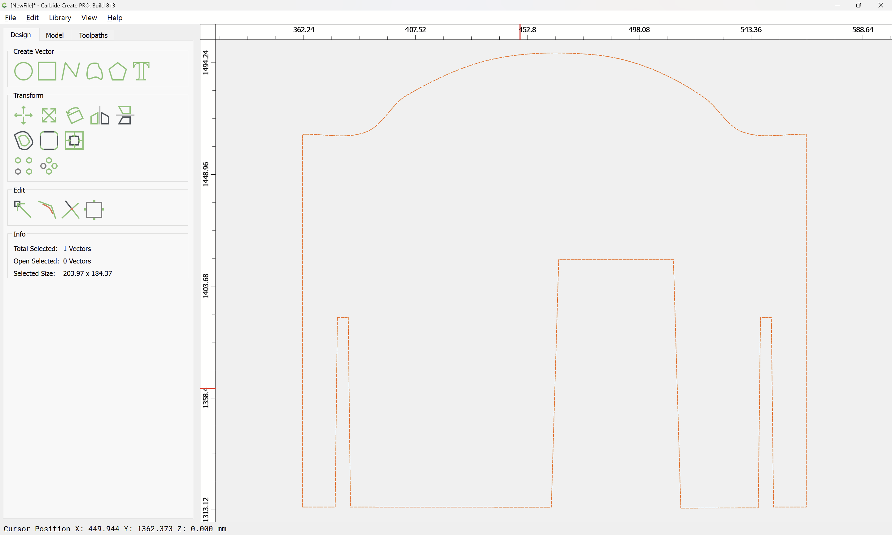

Ungroup Vectors:
and then move objects around individually:
Note that due to the vagaries of auto-tracing it will be necessary to verify and adjust the tracing where elements of fit are involved:

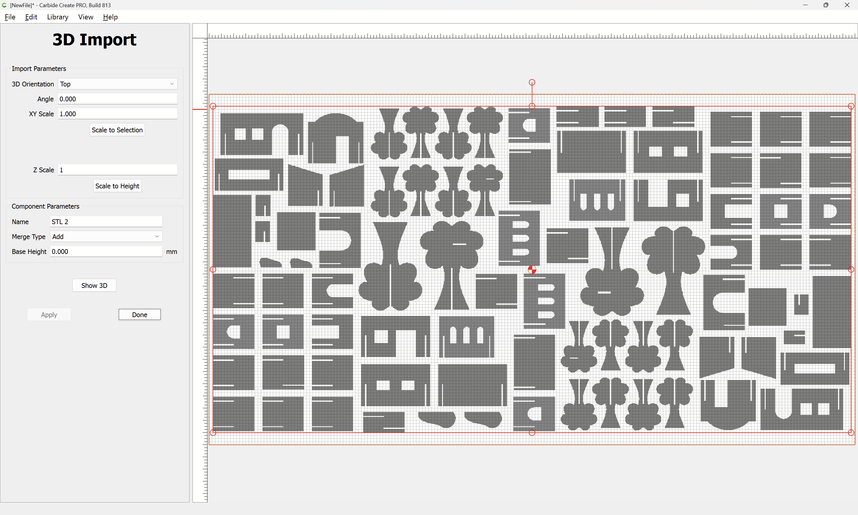

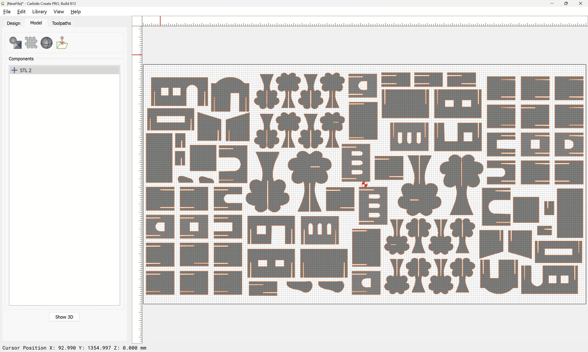

Looks so easy. It might be if I could “import” an stl file. My CCP only allows me to import “dfx, svg or c2d”. Are you using different software or am I not seeing some setting somewhere that needs to change. If I can import an stl file certainly that would be pretty easy to work with.
Thanks
OK. Got it. Importing into the MODEL tab, not the design.
Sorry for my thick head.
Thank you for the help.
