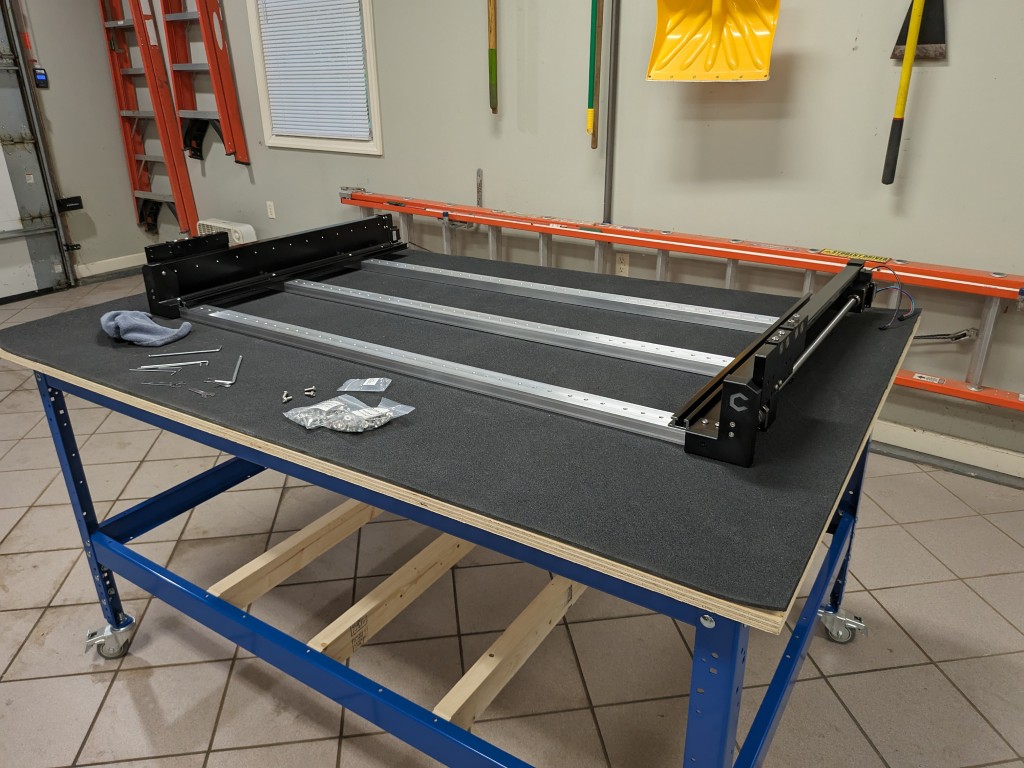

I have the 4x2, and I’m using the Kreg table with 3/4" plywood. I made cross braces for support. No problems with sag. See the following thread for a picture of my setup (don’t know how to link directly to post):
I’m almost upset with how much better yours is doing haha good work. I wish my rockler table had c channels rather than angle iron. That’s a pretty elegant solution.

If I am looking at it correctly, it appears that you also cut a notch out of the top of the 2x4’s to accommodate for the top of the metal table?
Is there a reason why you set your machine back so far from the front edge?

Yes, the Kreg rails are narrower than a 2x4 by a little, so I notched them out to fit. Hard to describe but easy to figure out in person.
I have my machine aligned with the back edge of the table, so I have a working area in front for things like bits and clamps, etc.
I took the following picture during construction of the table and putting together the machine, which kind of shows the spacing. I should also mention that I cut some gym floor mat to cover the 3/4 inch plywood top:
This picture shows the space between the machine and the front edge. I used some aluminum angle iron on the edge of the table to give it a finished look:

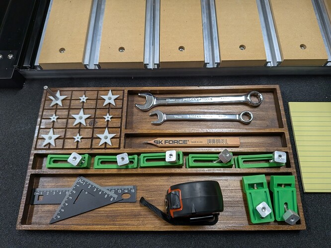

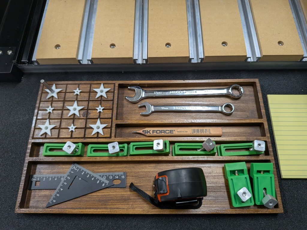

A litle tray I made out of cheap pine to hold bits and clamps:
I like your setup and that was exactly what I want to go with, but I did not have the room.
I like your tool tray.
What did you use that is under the machine? It looks like matting.

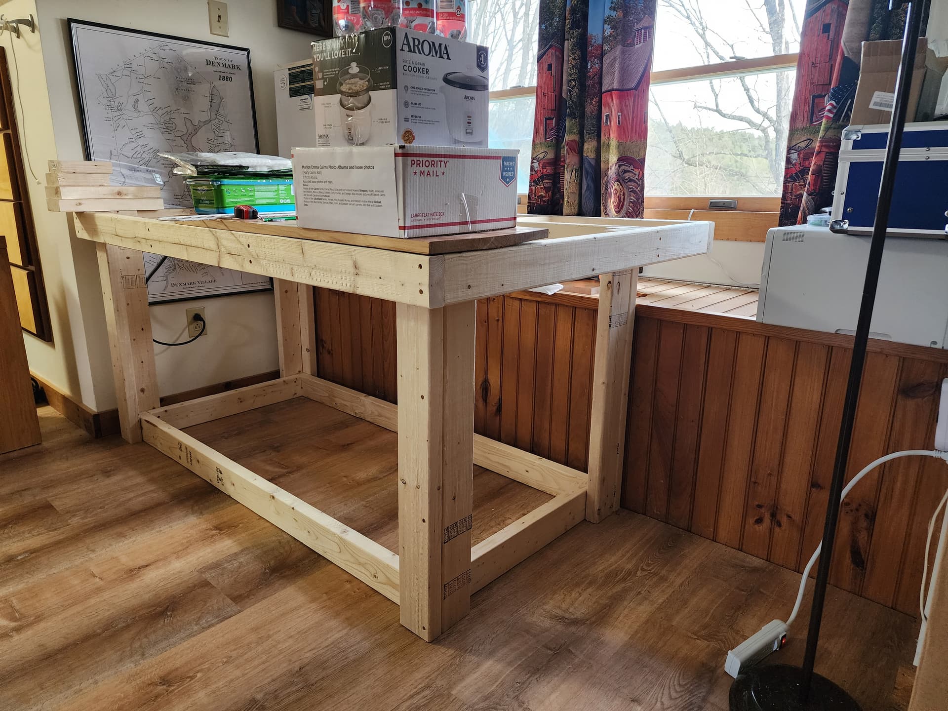

Well, I did have the space, but I had an obstacle in the way. I have a built-in window bench in front on my widows where I was going to place the machine that took up 21”.
I ended up building my own bench for the Shapeoko with an overhang so that it will still slide over the window bench and take up less room.
I have not finished building the bench yet because I am waiting for the wheels to come in but here is a picture of the framing.
I forget the exact name, but I went to Home Depot and it was on one of those big rolls in the back of the store, I think it was ‘Gym Flooring’ or something like that?
They cut an oversized piece for me at the store, then I trimmed it in place with a razor knife. I thought it might help with vibration? Not sure, but it looks nice and is easy to keep clean.
