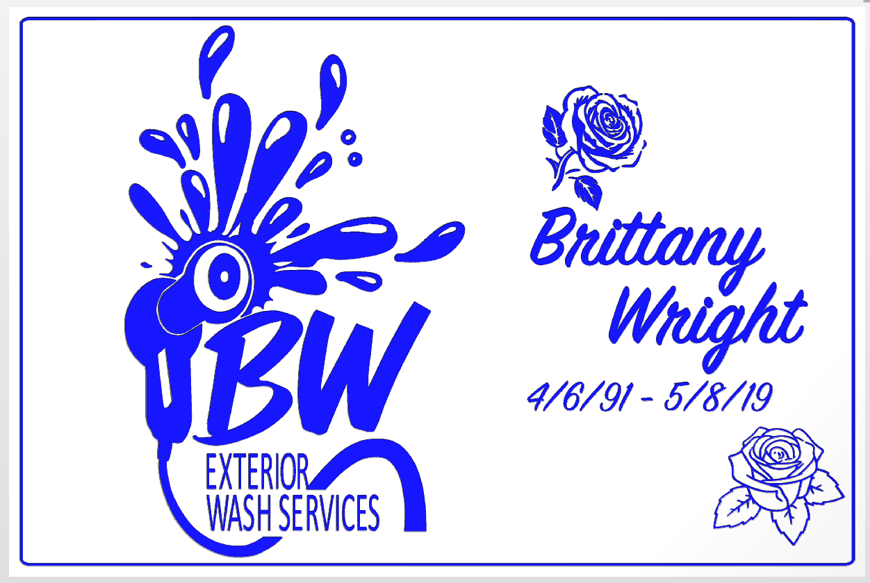

I was approached by a potential customer wanting me to make a sign for his office wall with his company logo. I was steering him toward Color Core initially because I just thought it would be faster and in wood it would require a glueup for the size he wants.
Then, he sent me his logo:
I have pretty much manually traced all the vectors now because the auto methods didn’t yield good results. But, I don’t think I can come up with a way to use the 2 color ColorCore that will do his logo justice. This could look cool with a multi color wood inlay, but that would take a lot more effort than he would want to pay for I am sure and I don’t think I want to tackle that one just to see if I can do it.
Paint? Epoxy? I am sure that I can’t recreate the gradients but I would like to do something that will look good. Maybe just some black outlines around some of the vectors even if there is common color in the areas.
Open to ideas.

Here’s what I’m currently working on:
There are 6 more layers left to go. This first layer was done by 3D carving a heightmap gradient into the substrate. This one varies from about 2.0 mm deep at the bottom to a little less than 1.0 mm at the top over a vertical height of 70 mm. It was subsequently filled with colored epoxy resin.
Since your sign is likely larger you could use an even steeper gradient if you wish to get even more contrast. If you use a substrate other than white, spray the recesses with white lacquer before the epoxy. Sand that paint off the surface later. You will have to experiment with the proper density of colorant.
That looks very cool but would be more of an experiment / labor of love than something I could actually profit from.
In fact, at this point I am bartering the sign for his services pressure washing. That was my idea, not his. I have a large house and a long fence so it’s worth it to me up to a point.
Experimenting with the varying depth to get the color gradient is something I would like to do but may try that as a smaller scale test. The guy wants this sign to be 24x36 and has now asked me to combine it with a bit of a memorial to his daughter for whom the company is named. It seems a bit odd to combine the two, but that’s what he wants. I simplified his logo because he still wants to go with ColorCore instead of painting. Here is my current design although it still needs some tweaks such as shifting left.
