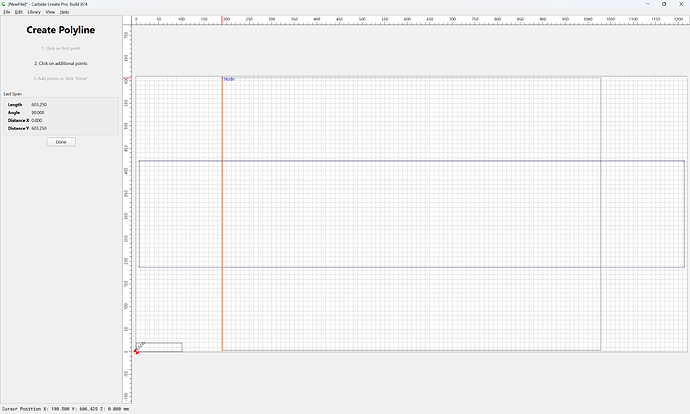

out of that, well the geometry is kind of limiting… hang on while I draw that up and do some figuring…

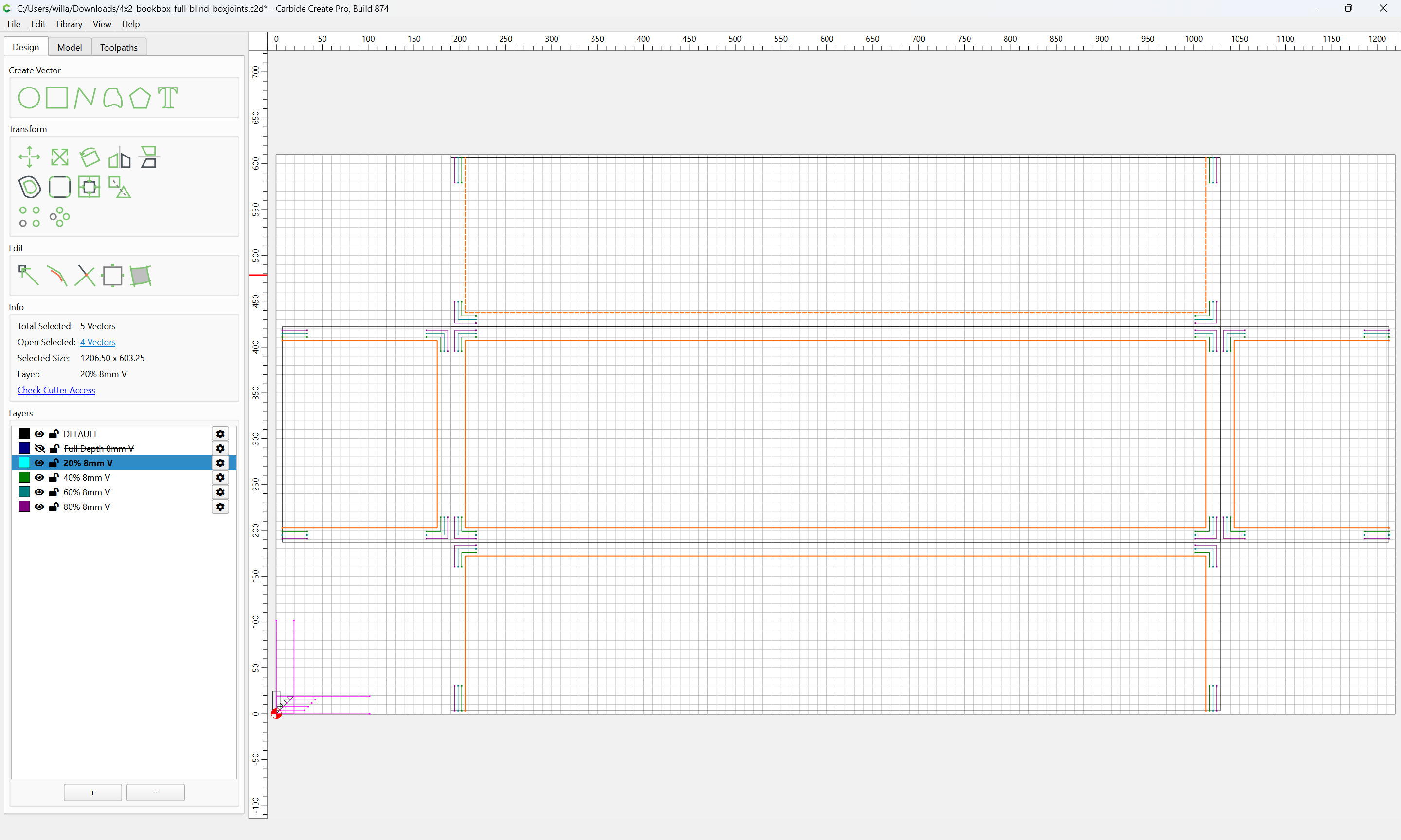

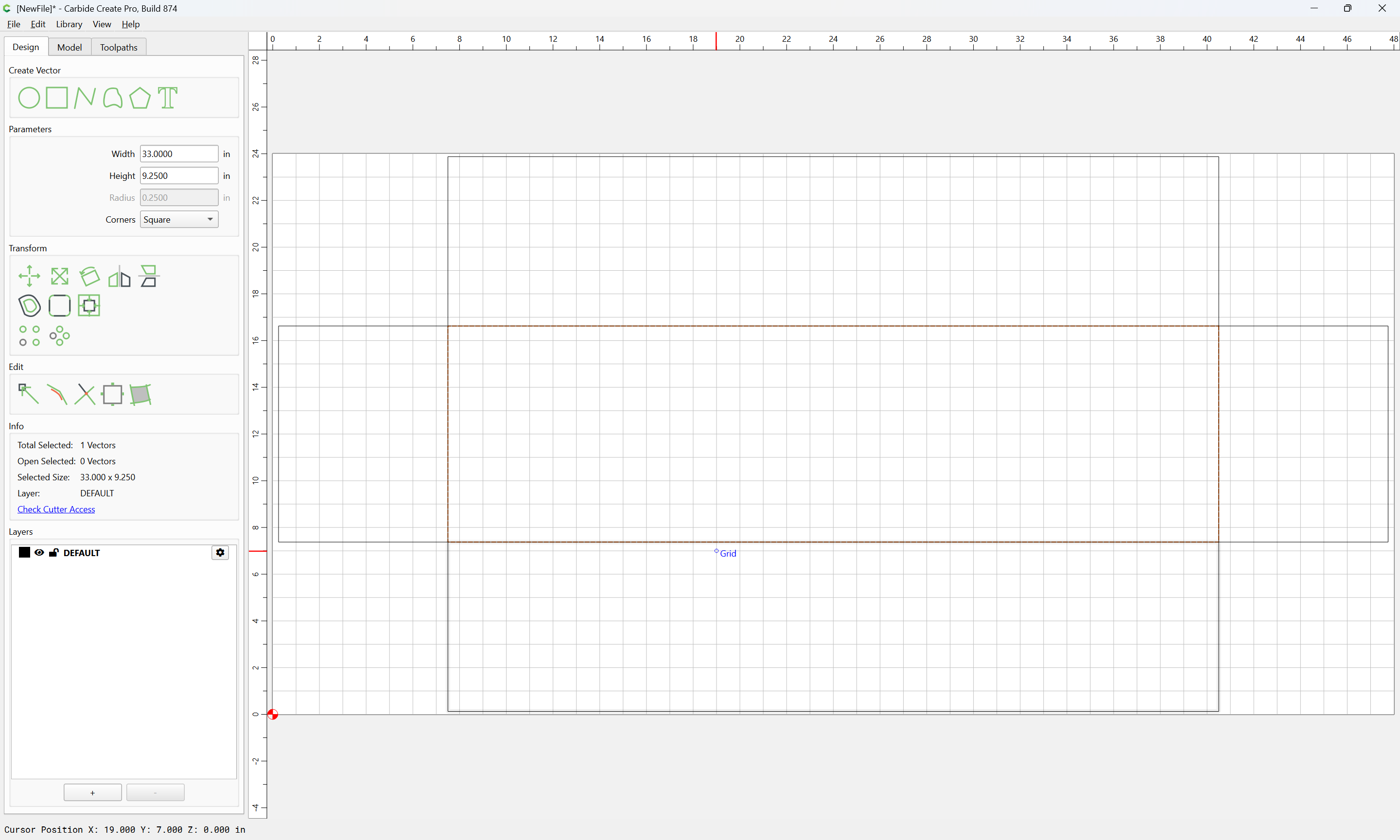

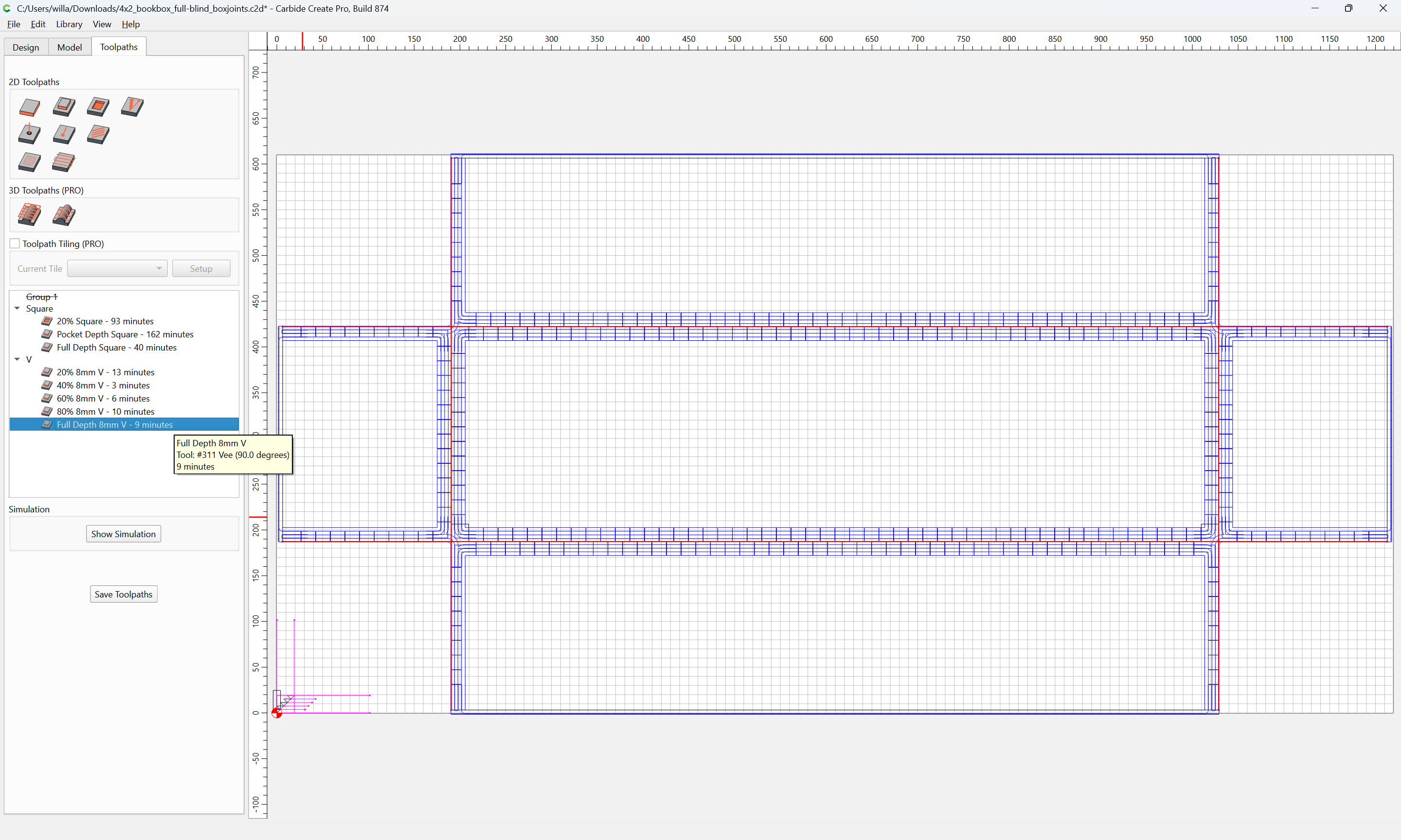

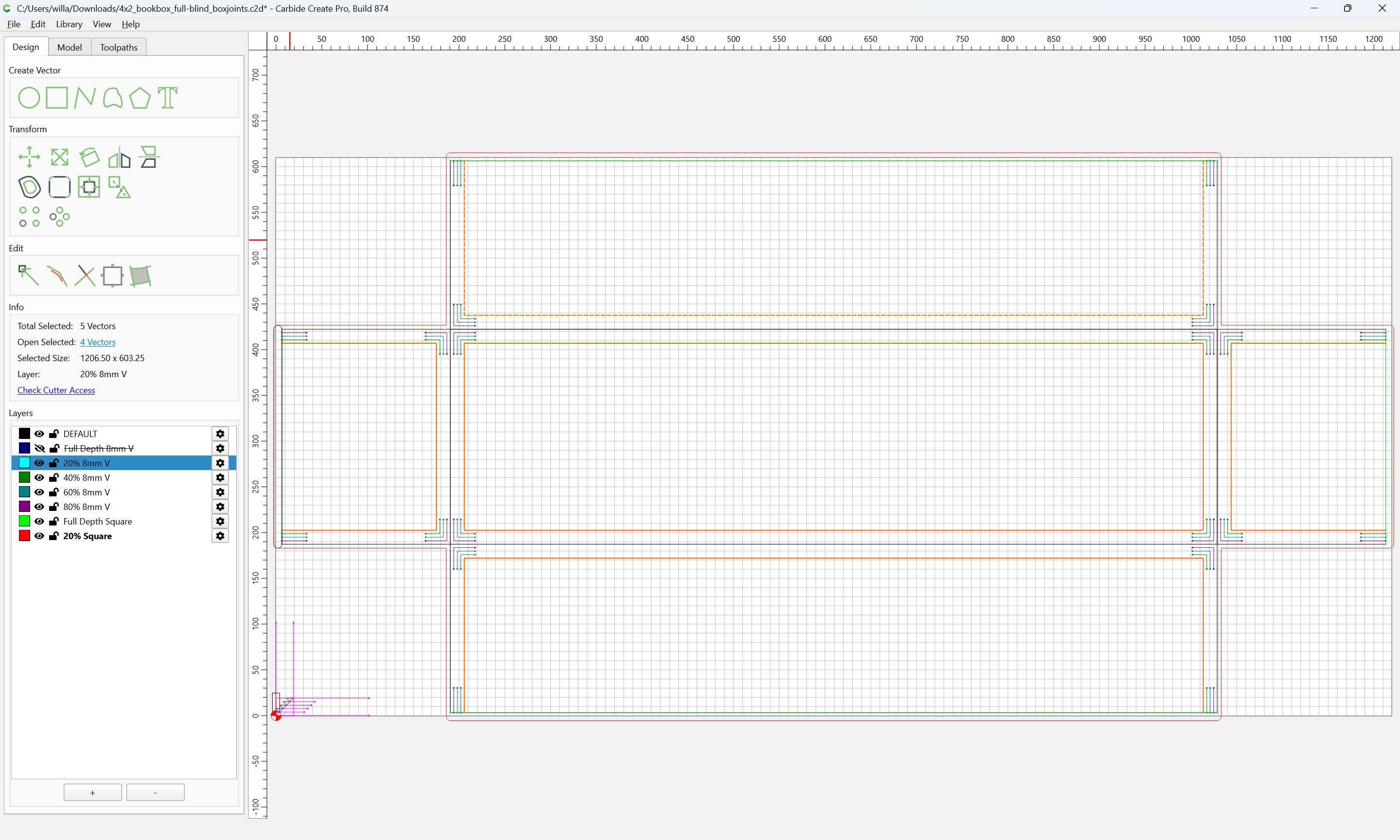

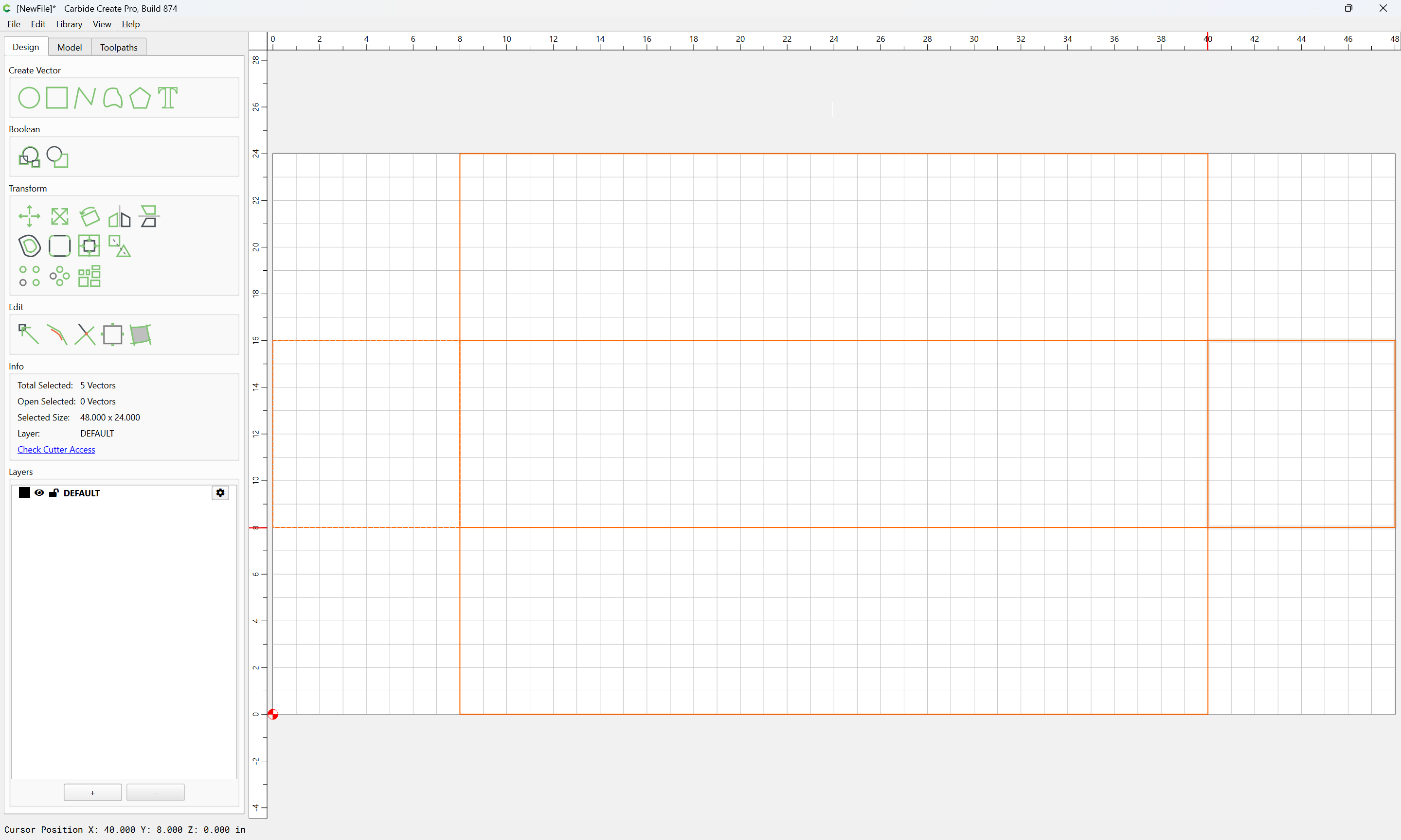

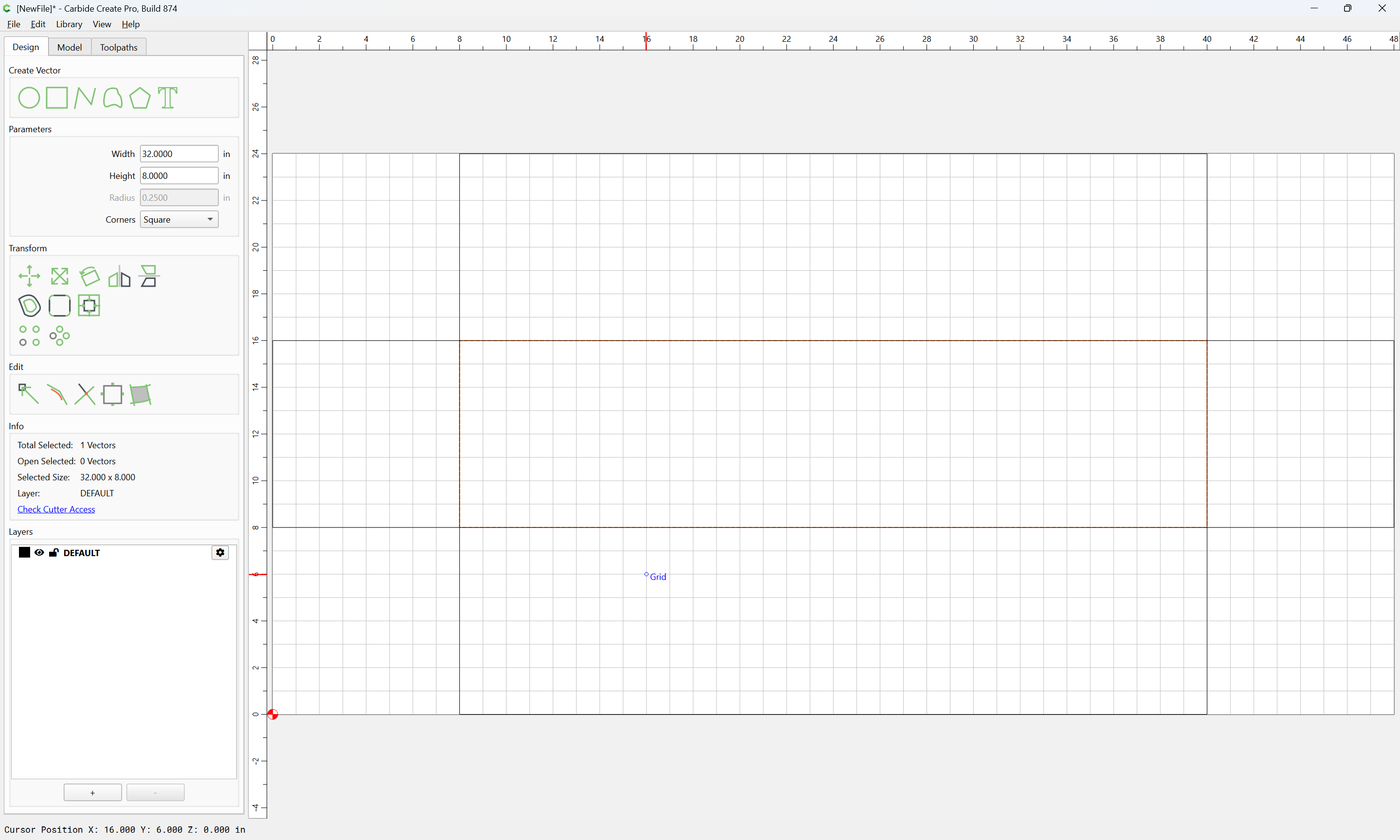

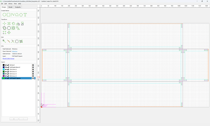

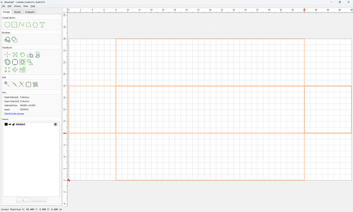

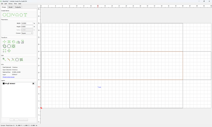

As noted, if one is trying to get the whole thing out of a quarter sheet, then one needs 5 parts, something like:
but that leaves a dimension for the back of:
which won’t fit a paperback book… adjust for Mass Market Paperback size of 7 x 4.25" or so we instead arrive at:
which seems pretty workable and leaves one a quarter inch or so all around for margin.

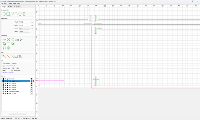

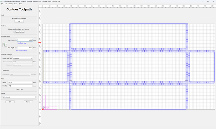

Cutting full-blind box joints into this is pretty straight-forward, we simply need a couple of toolpaths:
  • full-depth 8mm 90 degree V tool to define the edges of the miters
  • partial depth 8mm square tool cuts define the box joints
  • a shallow depth set of cuts at the top to define the top edge of the joints
  • a series of graduated cuts at the corners to define the miters

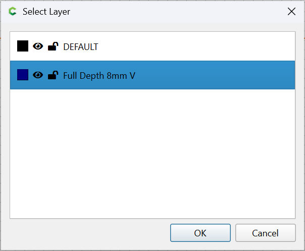

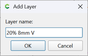

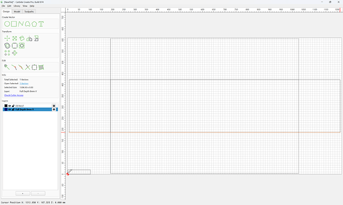

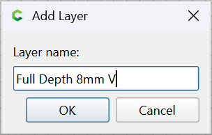

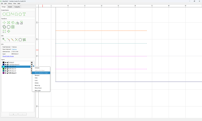

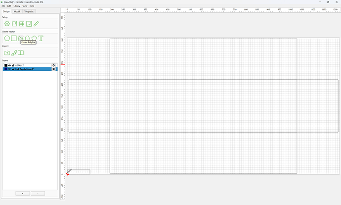

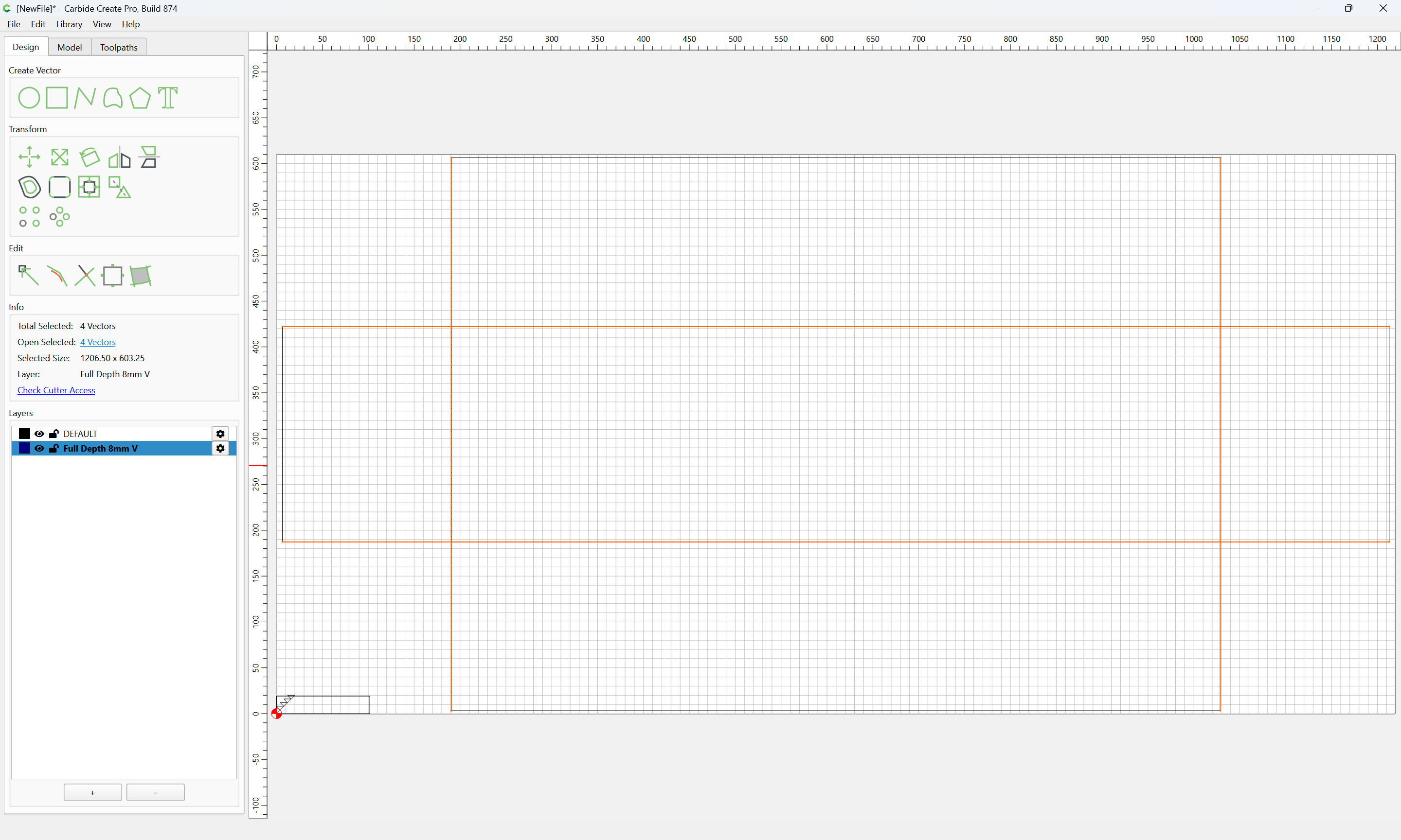

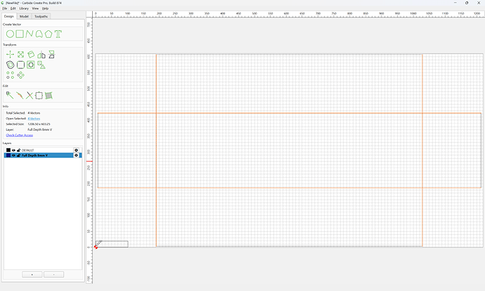

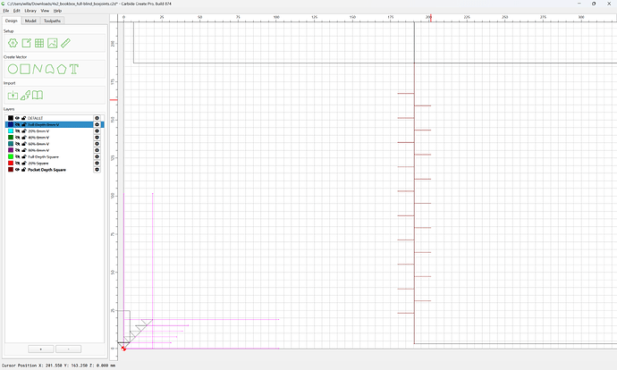

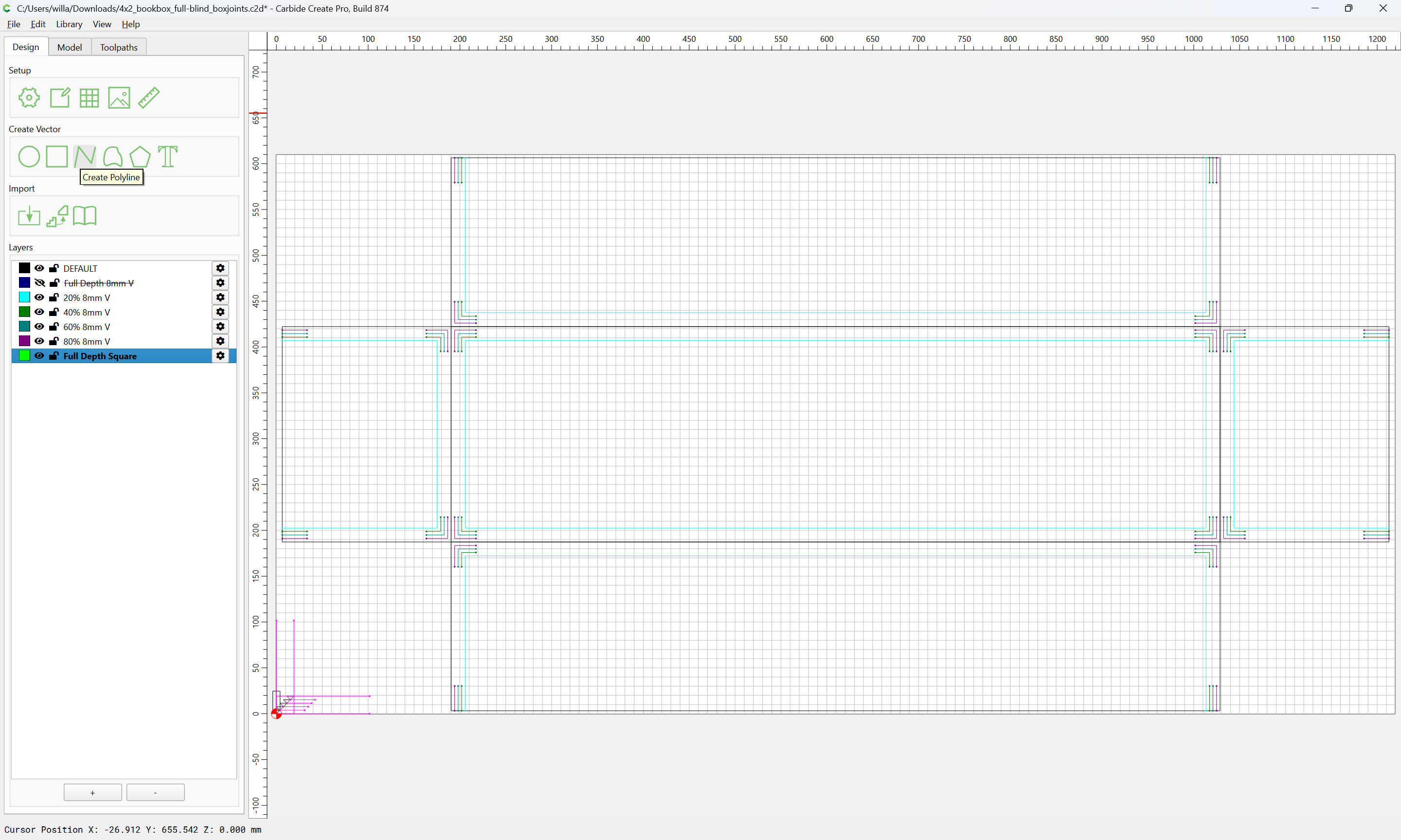

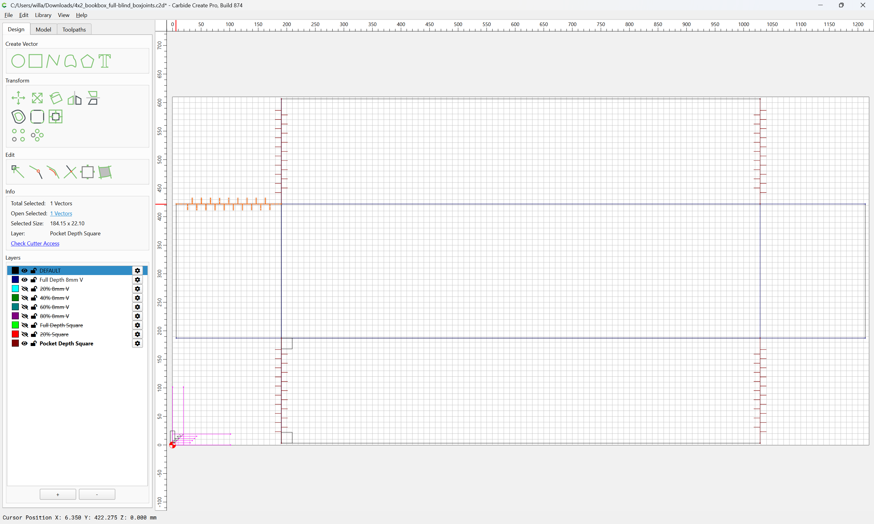

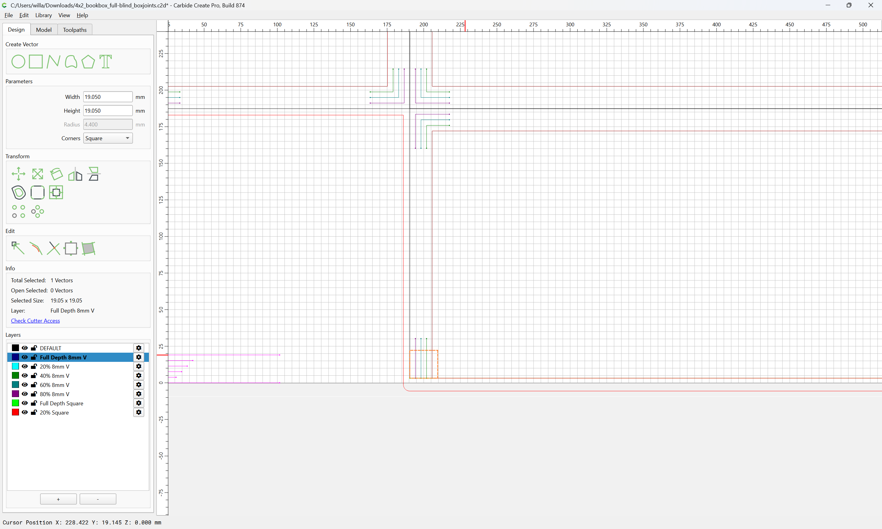

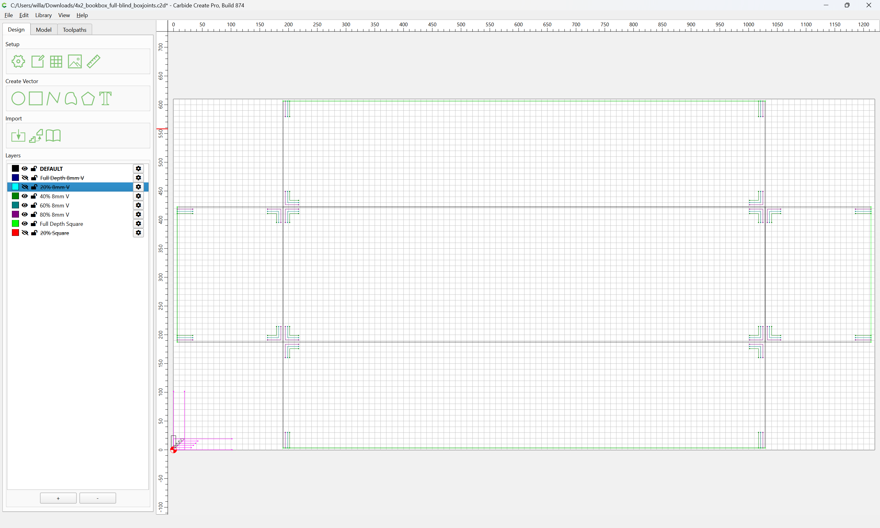

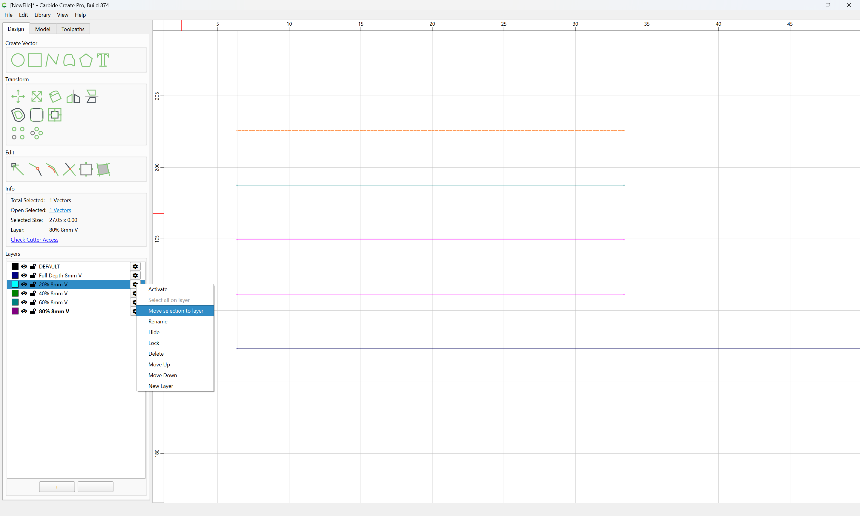

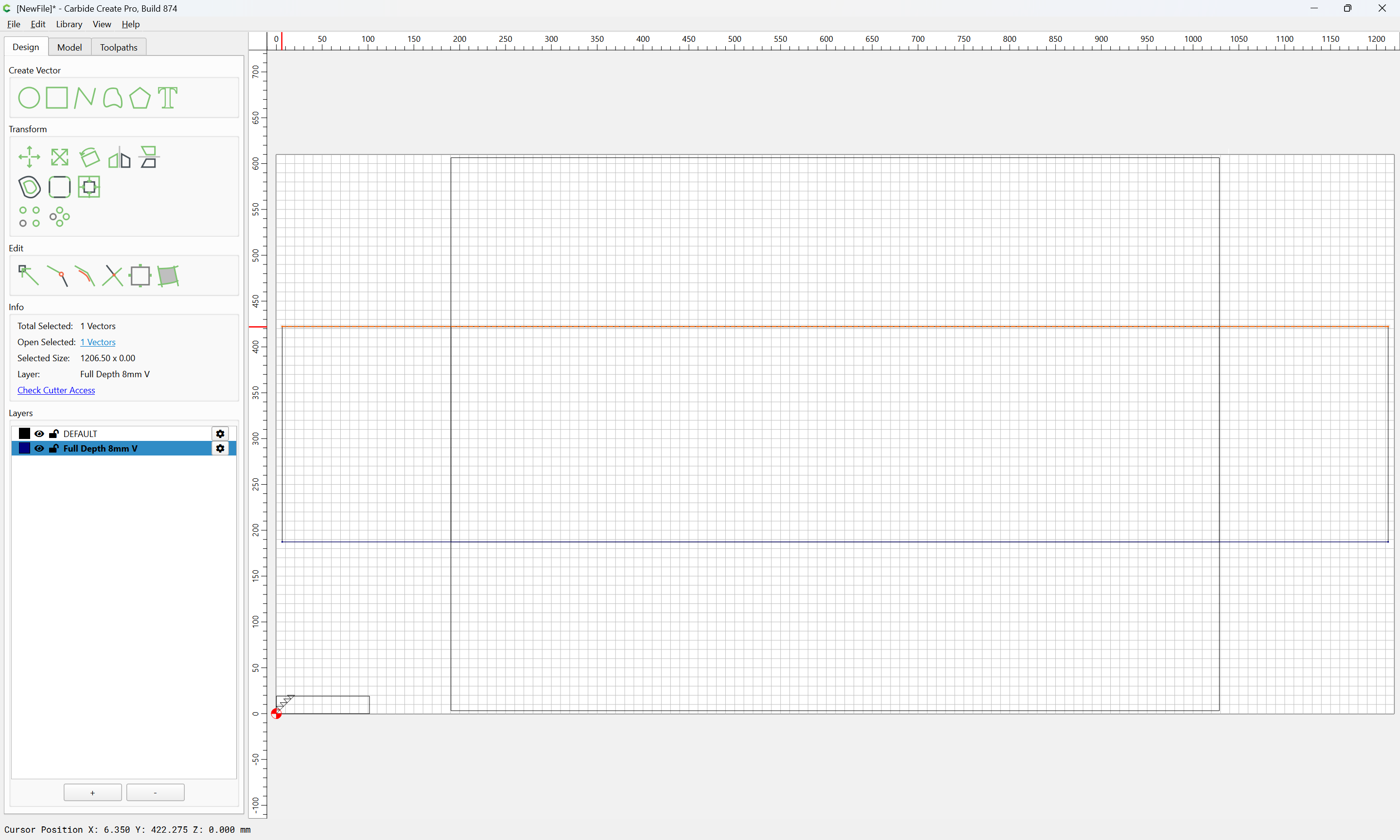

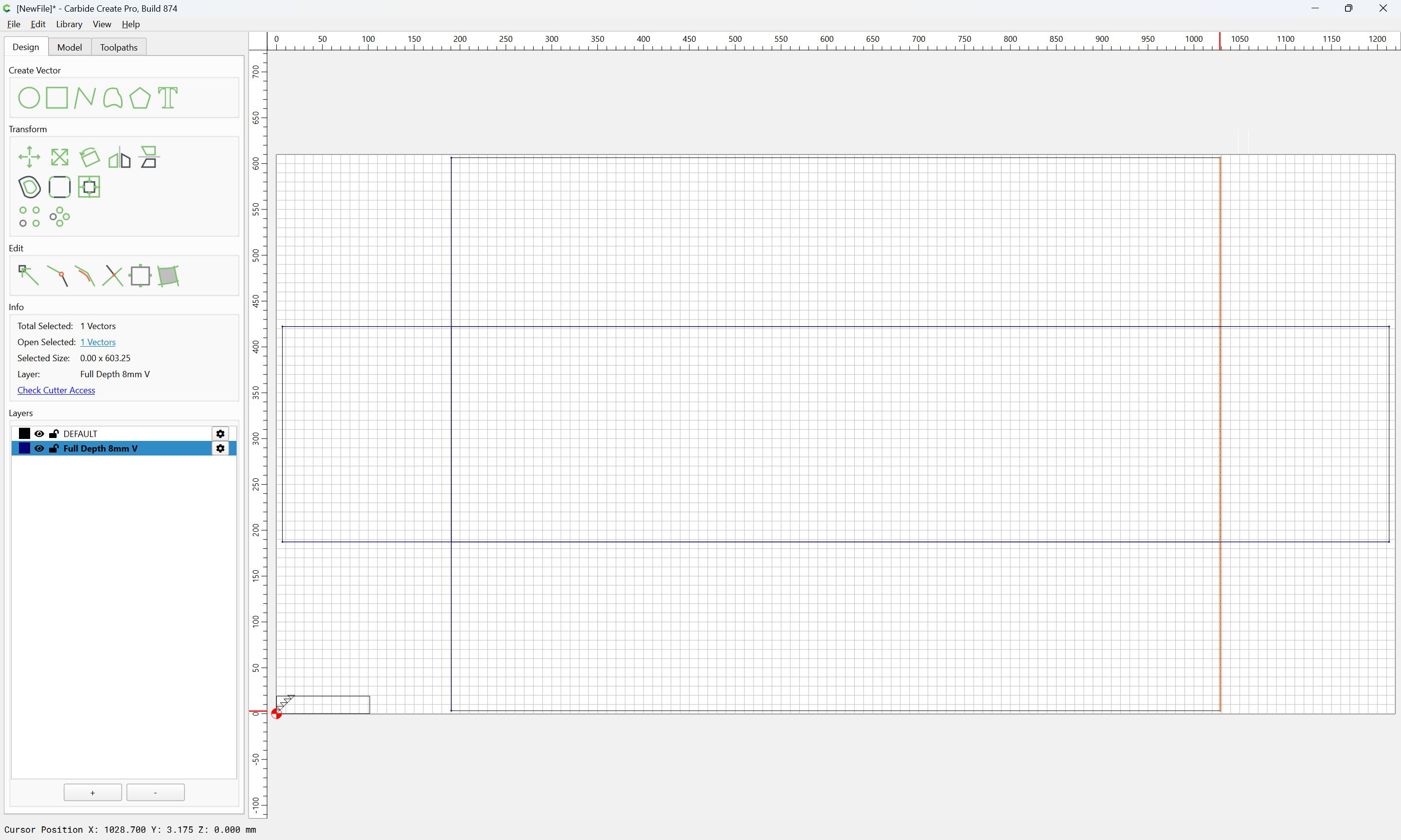

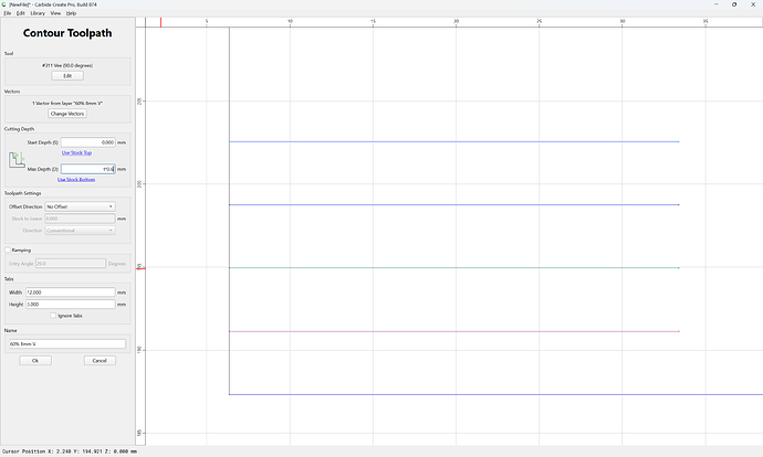

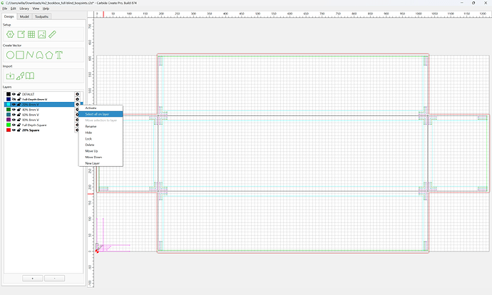

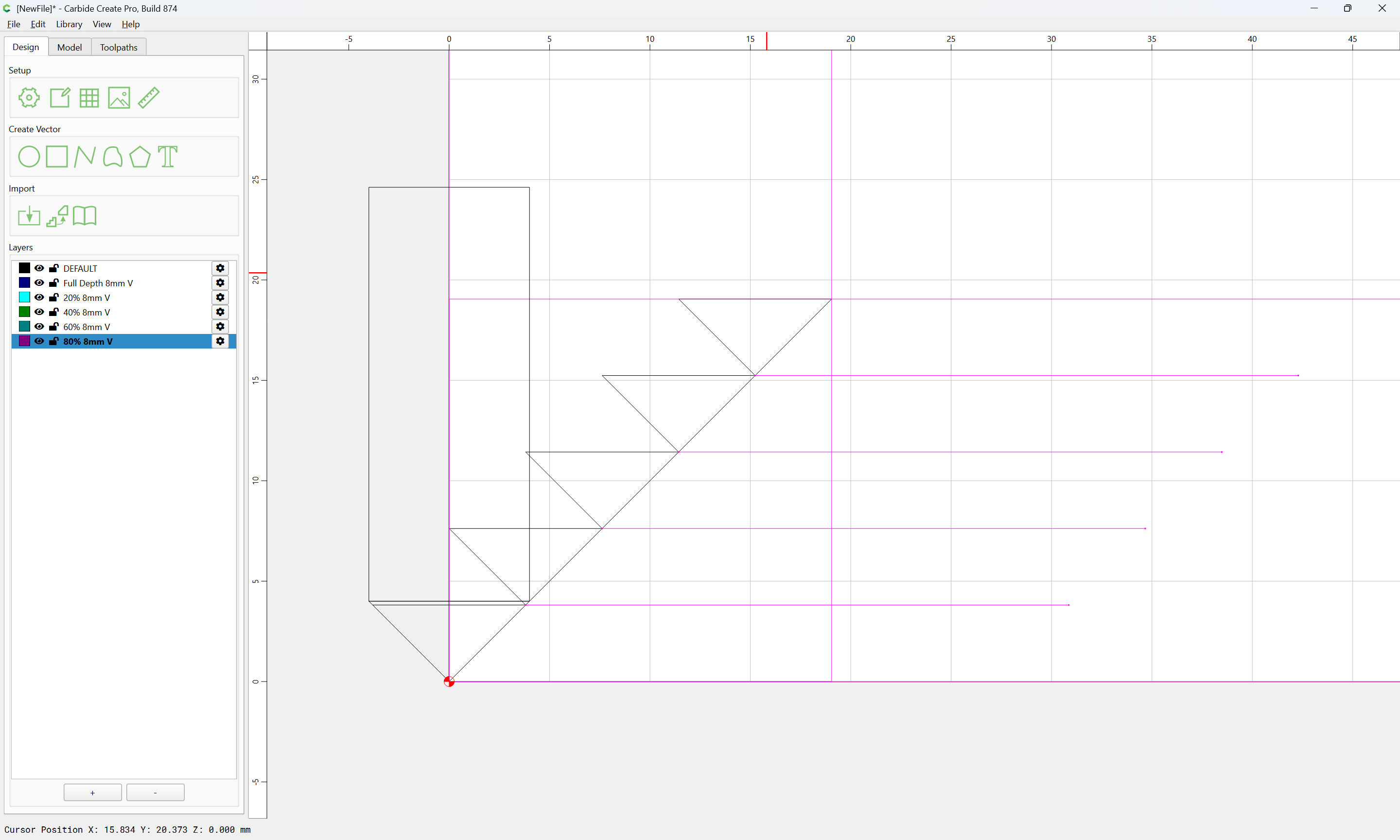

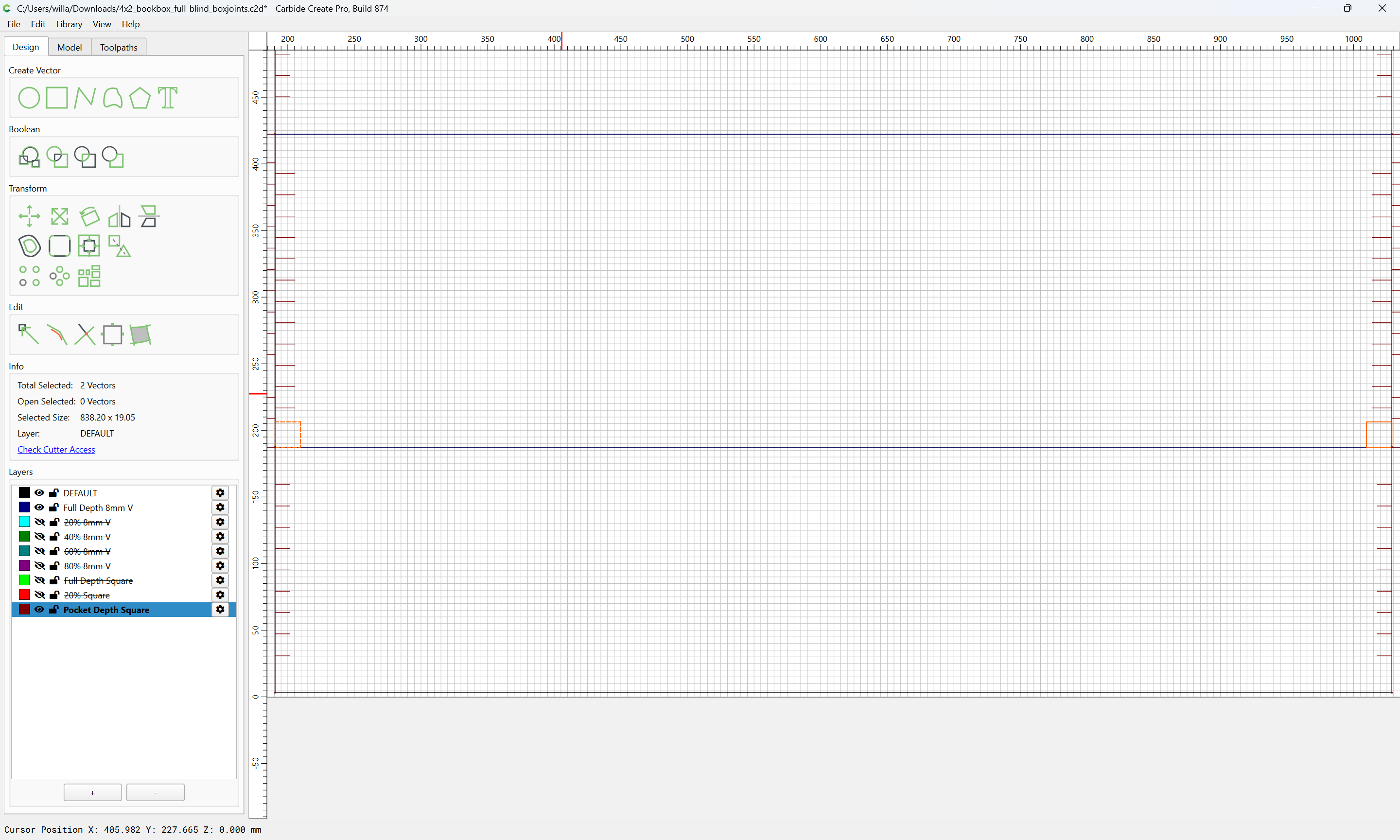

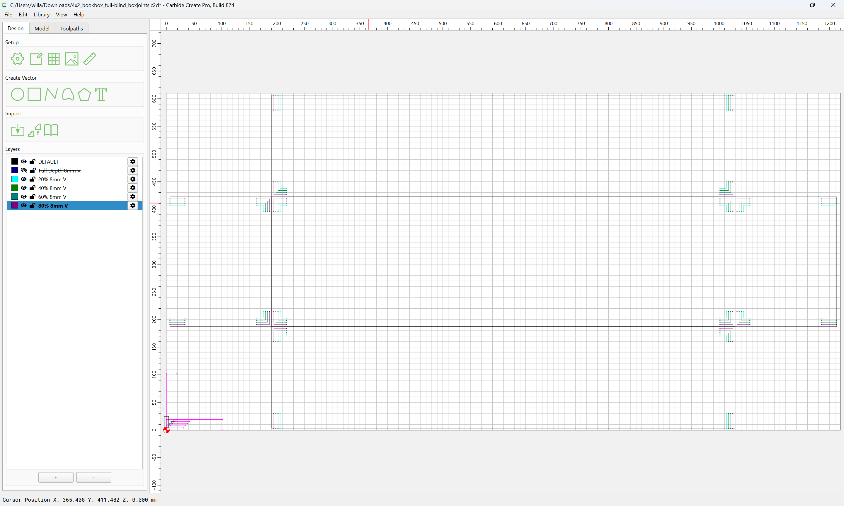

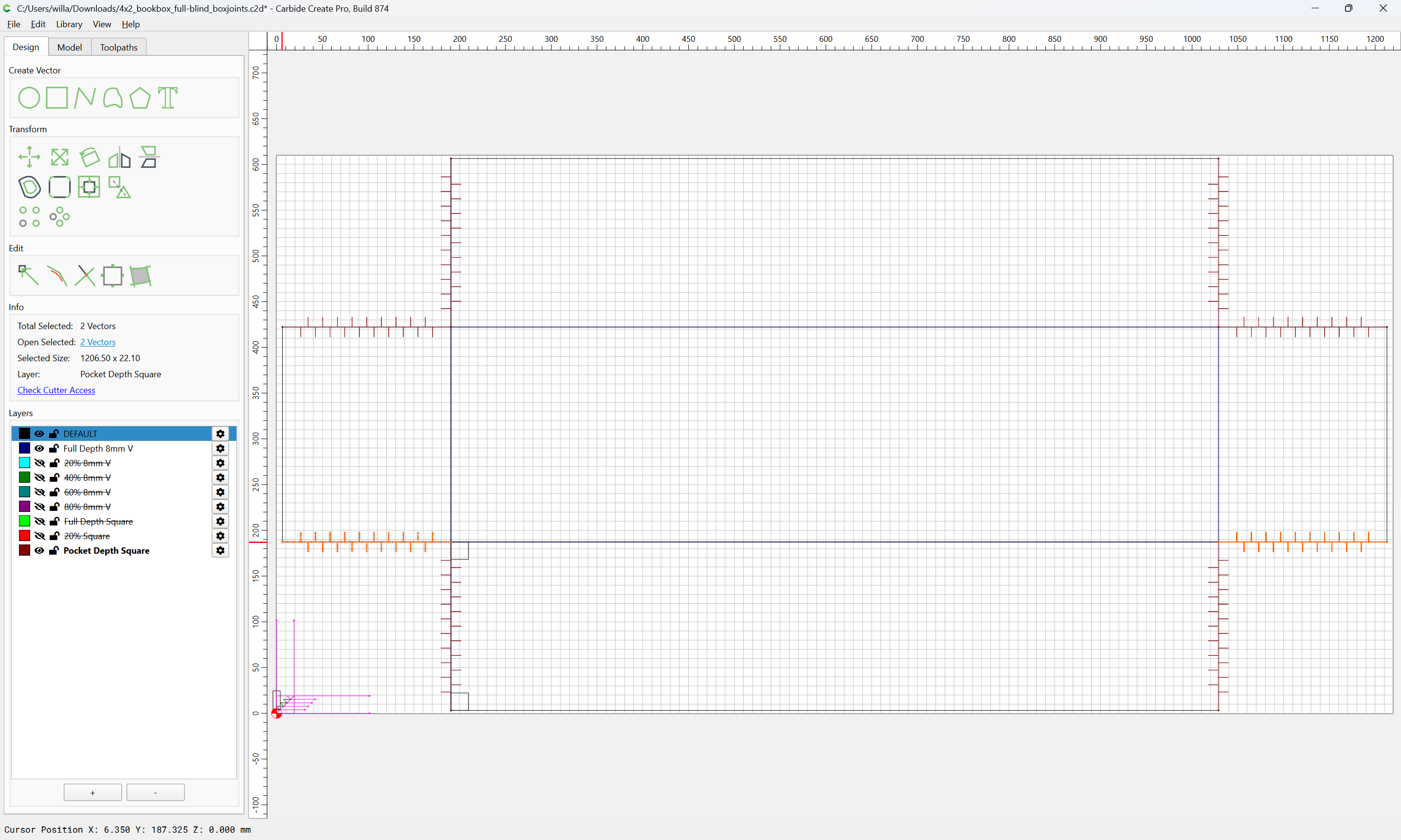

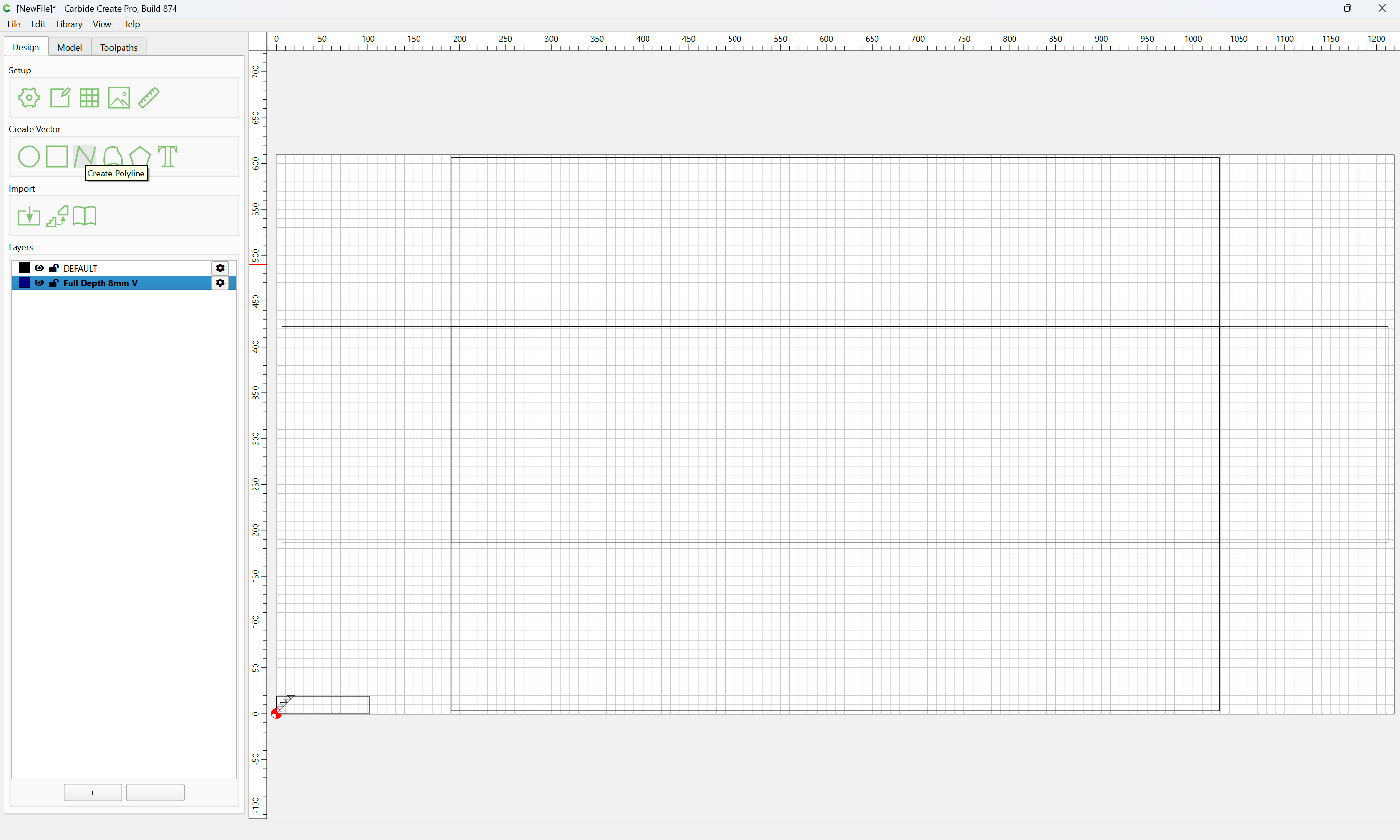

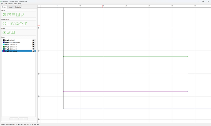

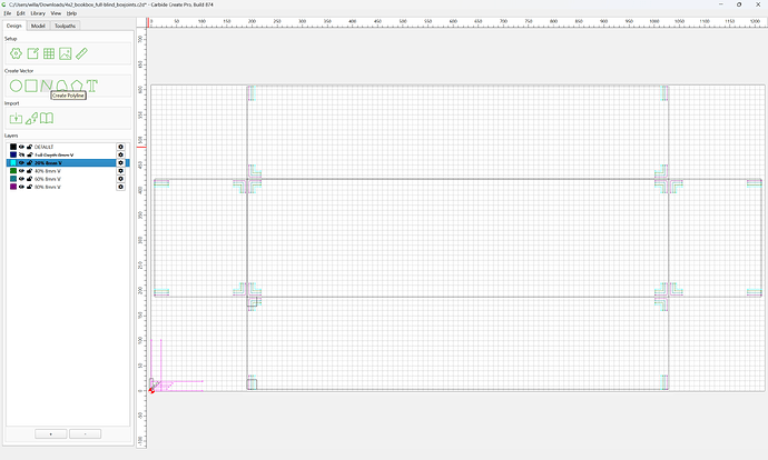

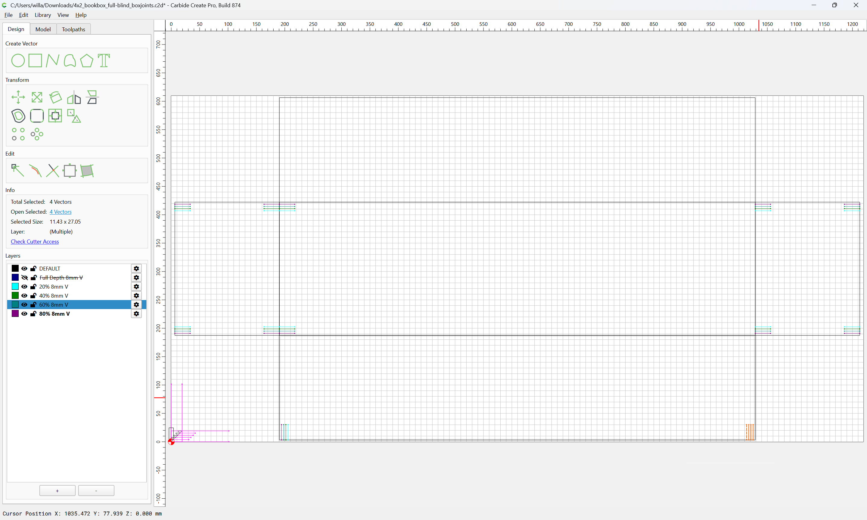

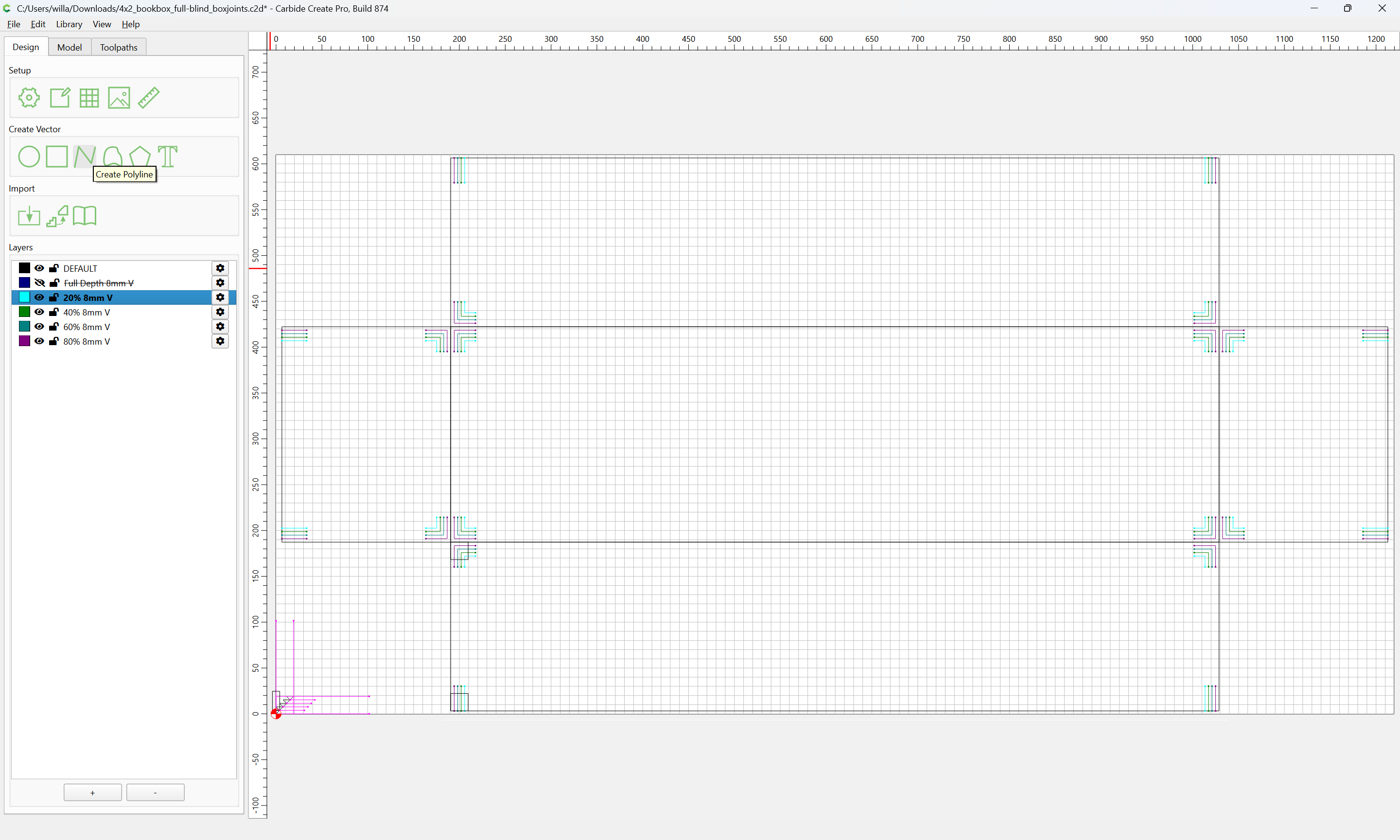

Start by setting up a layer for the full-depth 8mm 90 degree V:

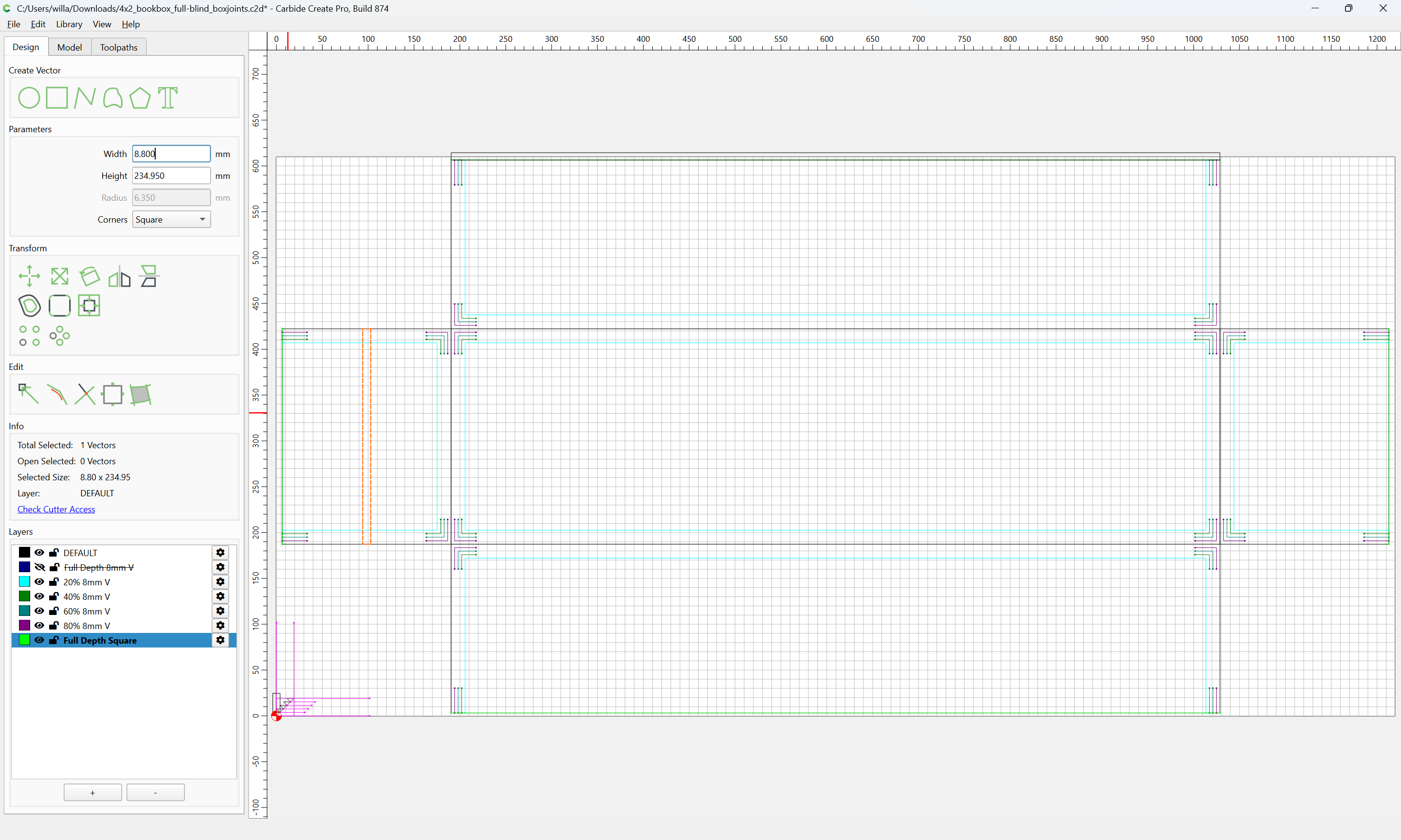

and make it the active layer:

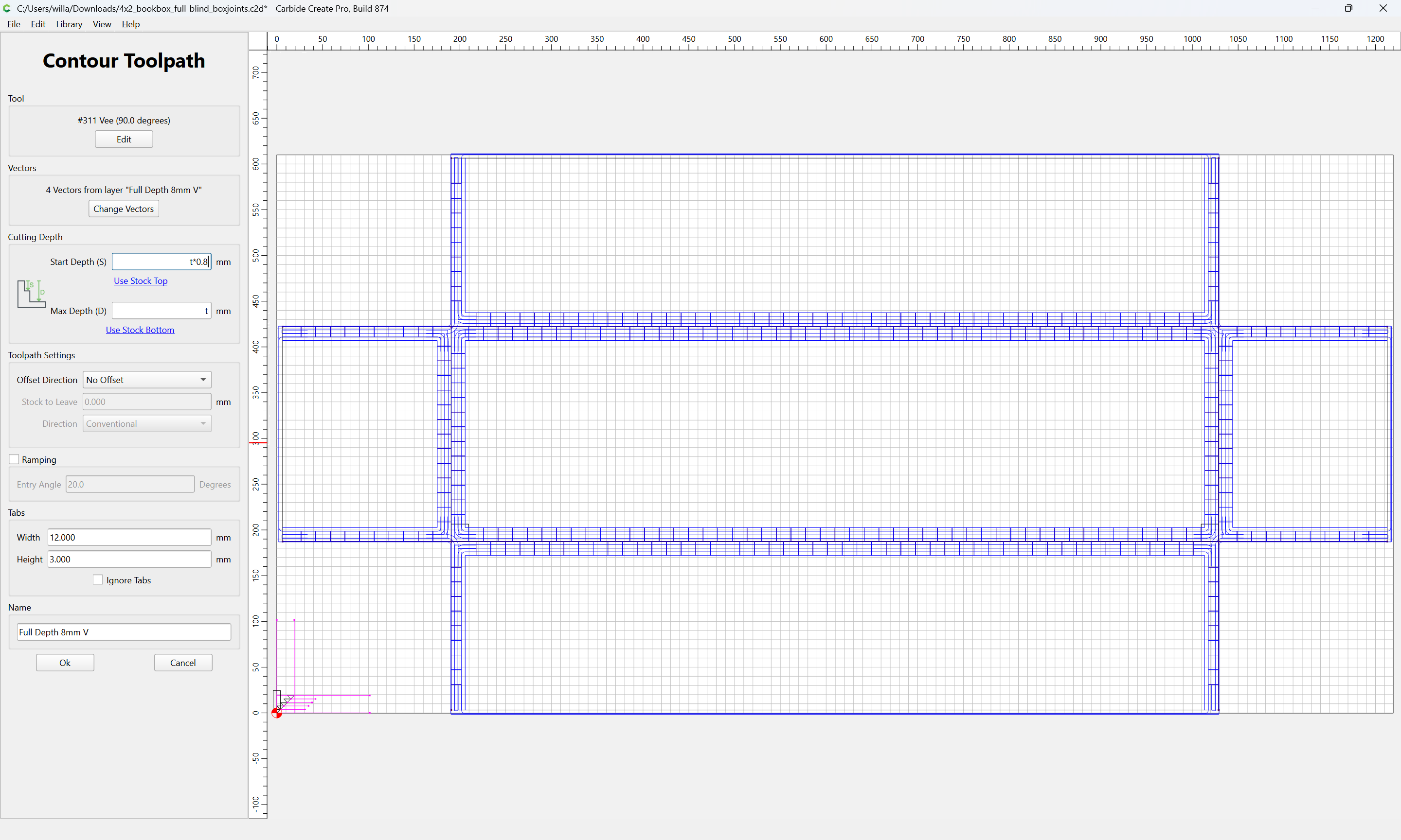

Then draw a series of lines which traces out all edges which need to be cut for the joinery:

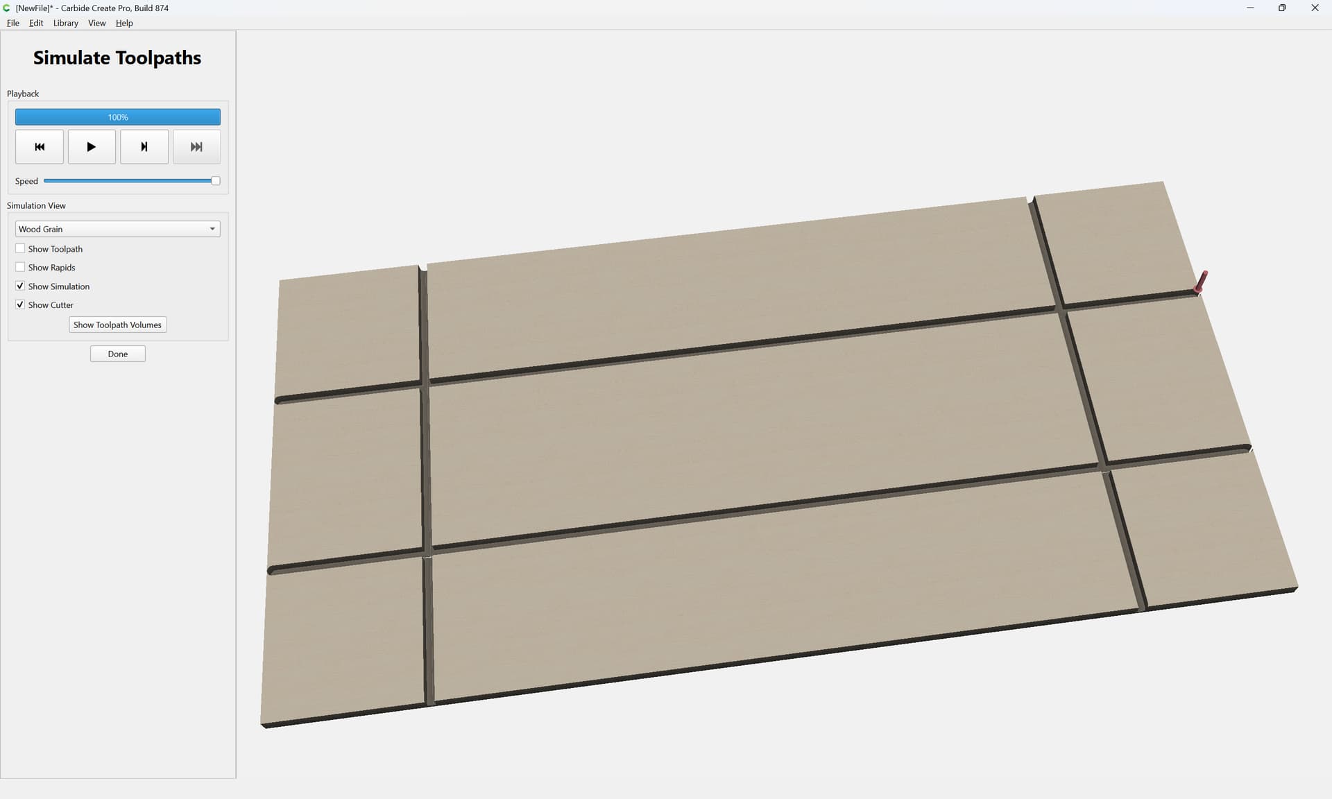

Then assign a V tool to cut to that depth:

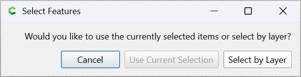

Select by Layer
h
which previews as:

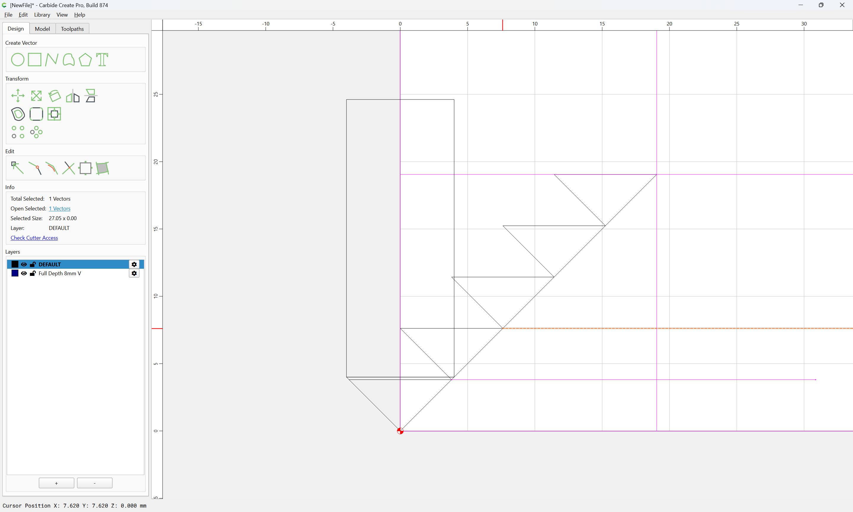

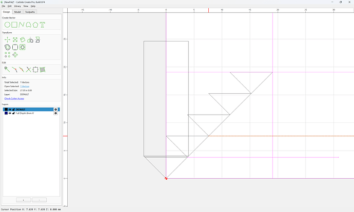

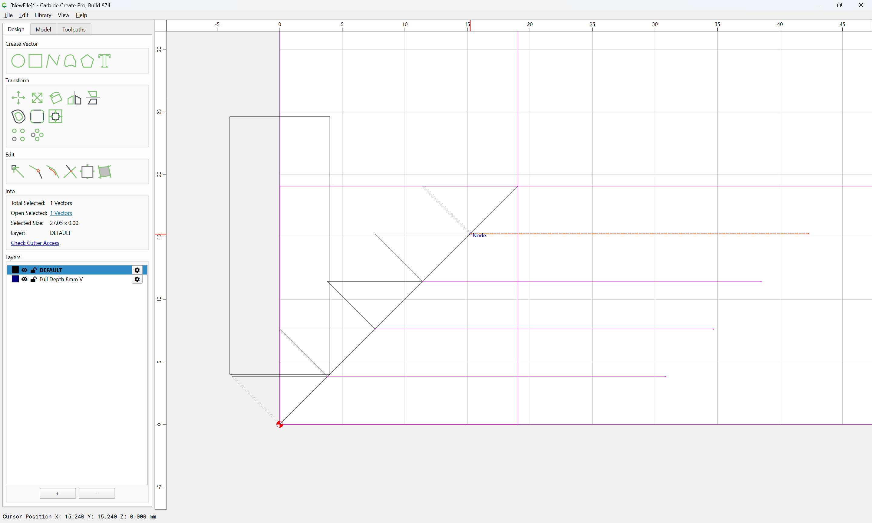

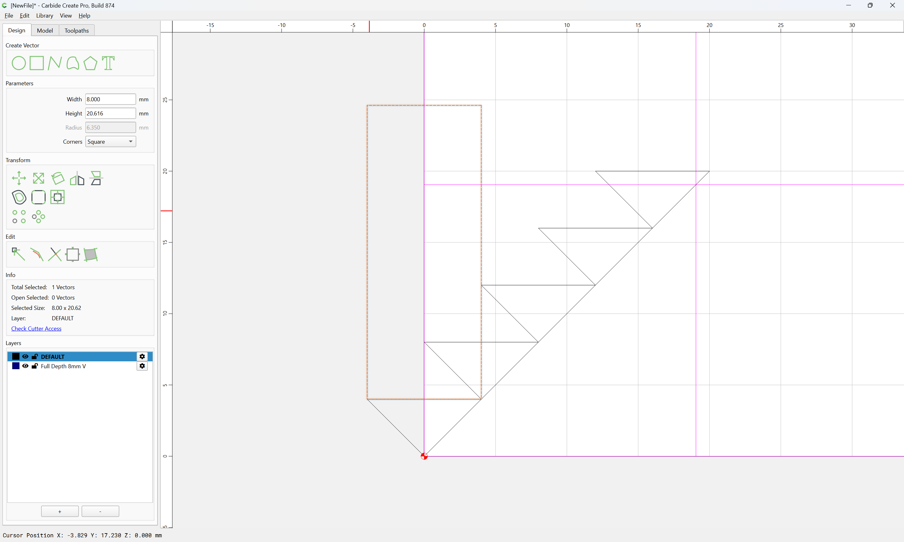

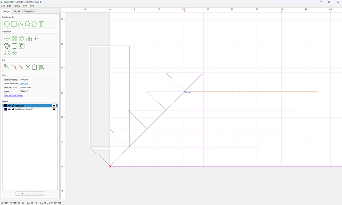

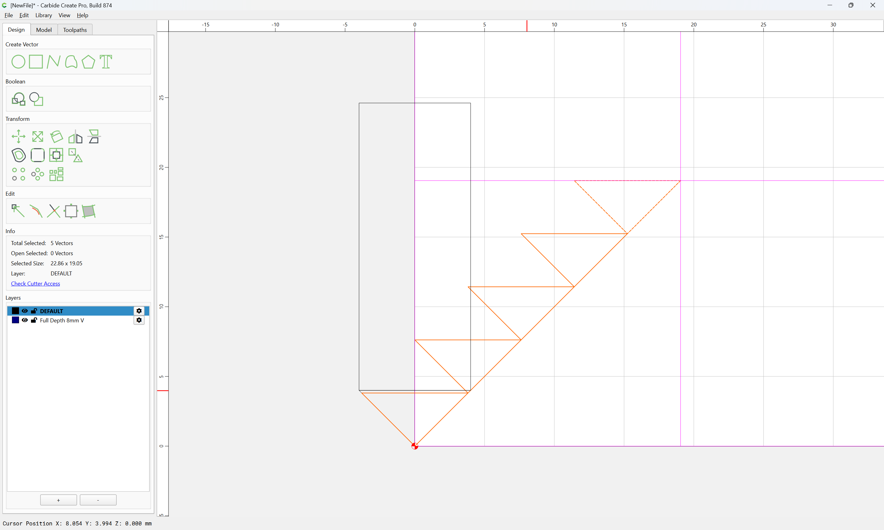

Then, draw up the tooling which will be used and the stock in profile:

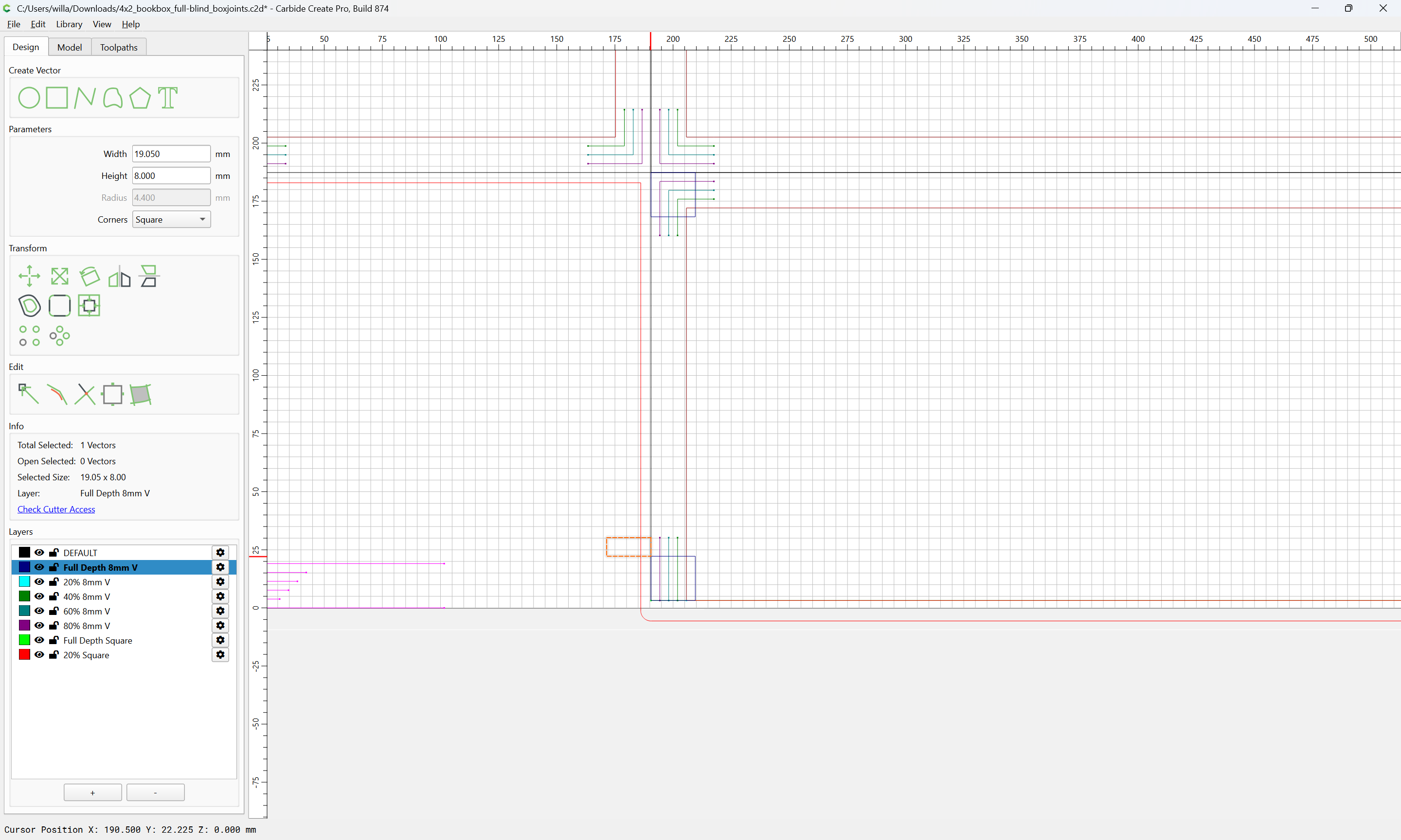

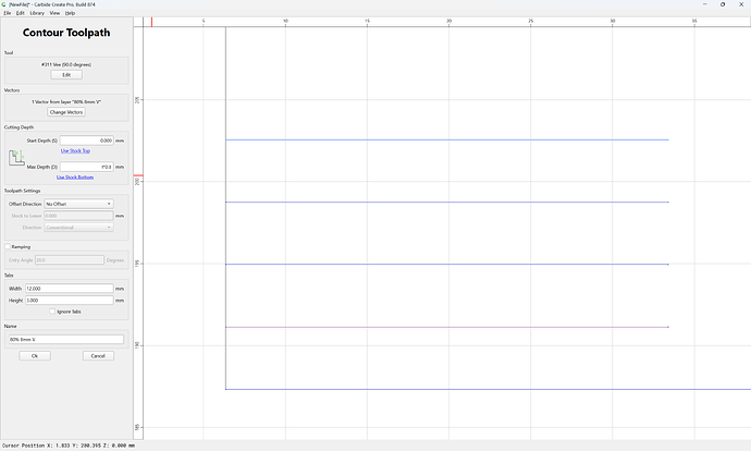

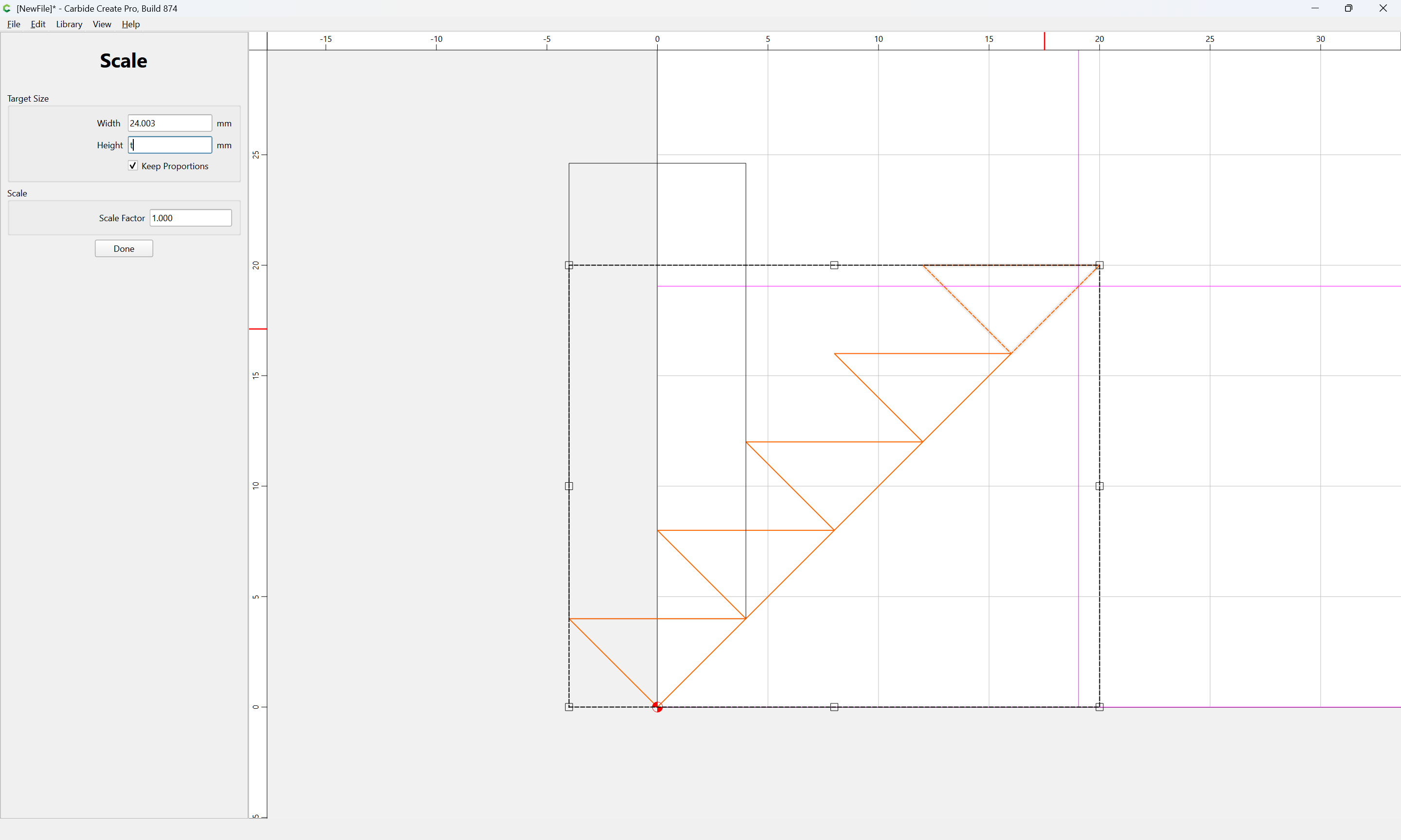

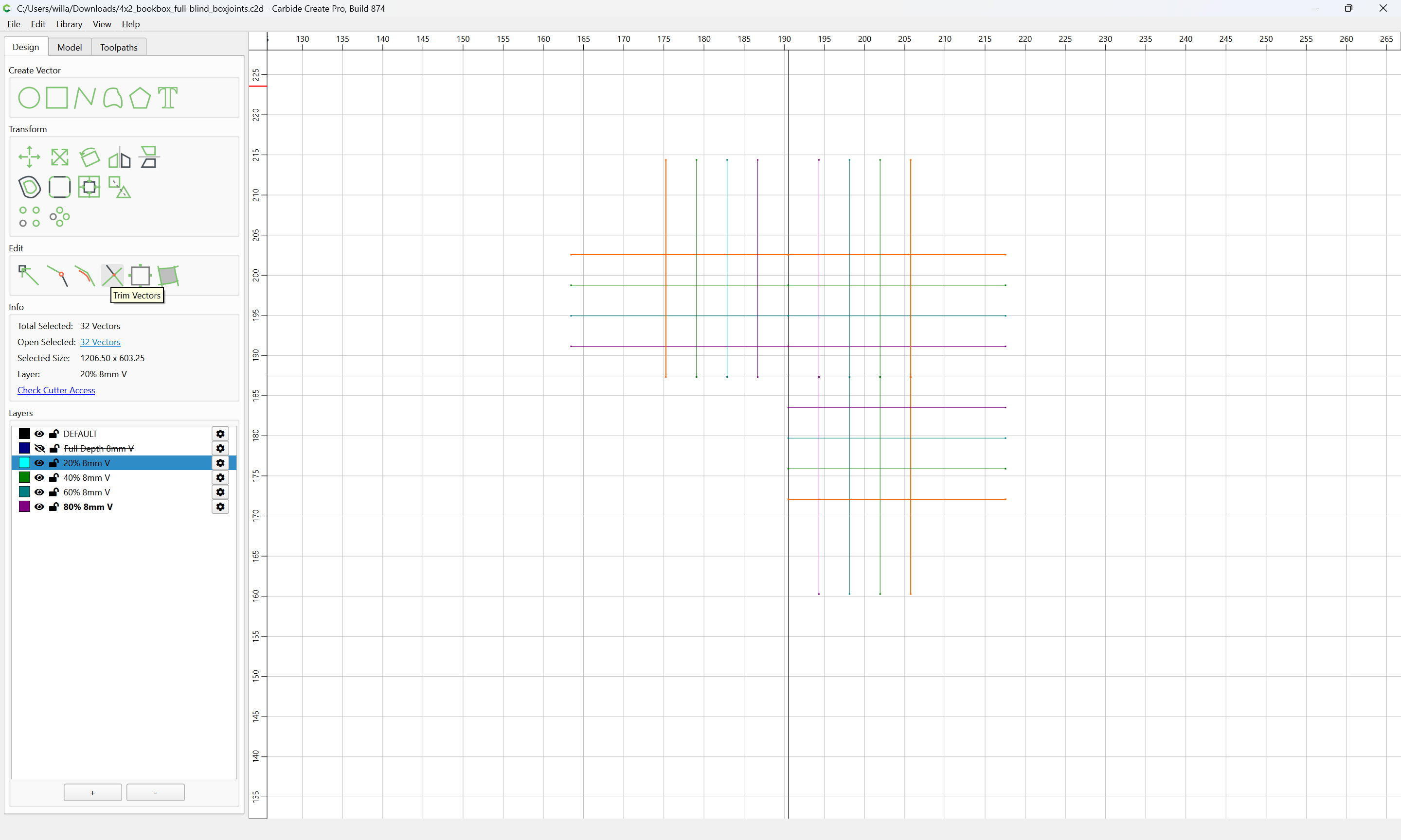

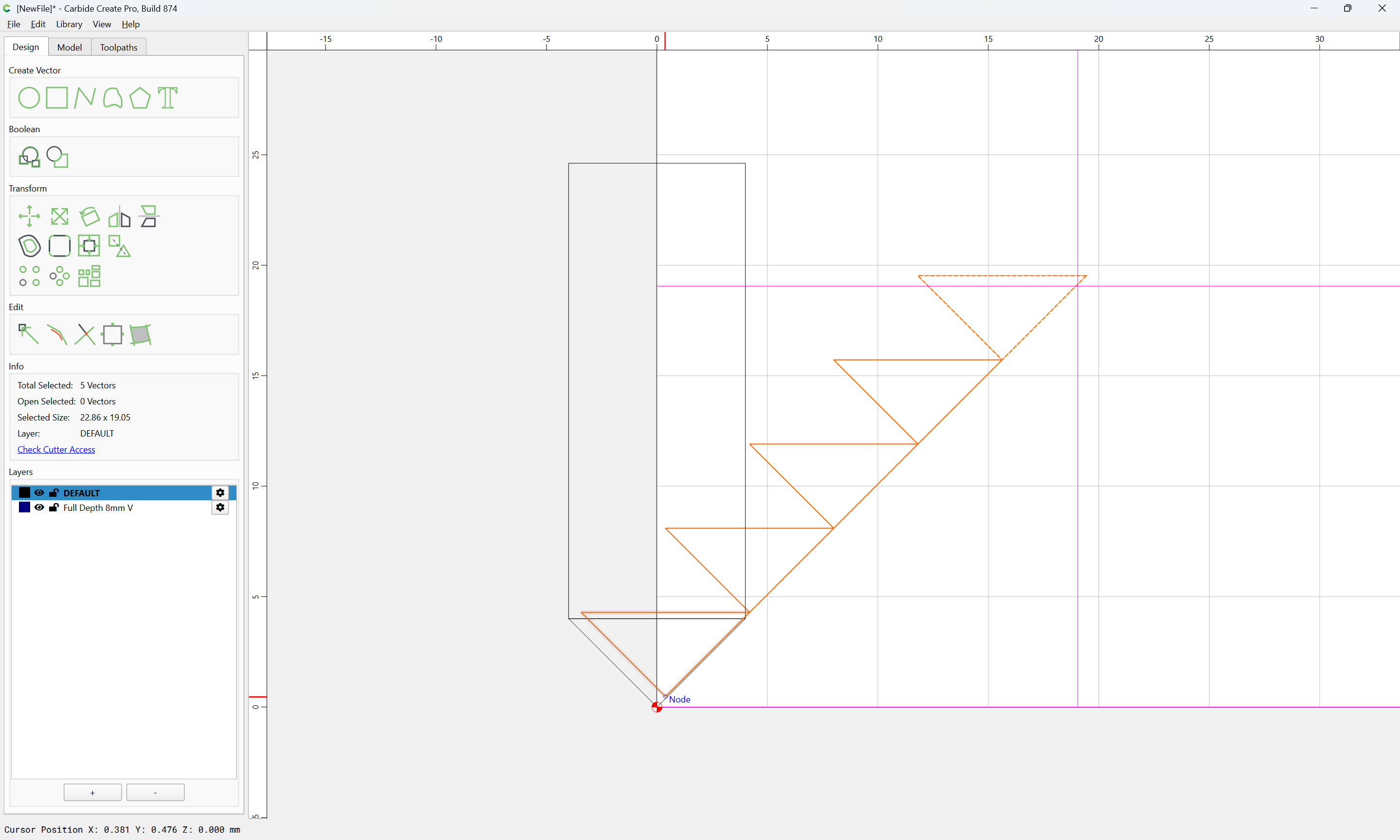

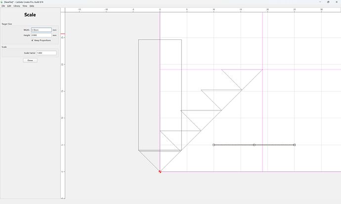

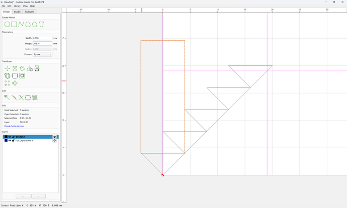

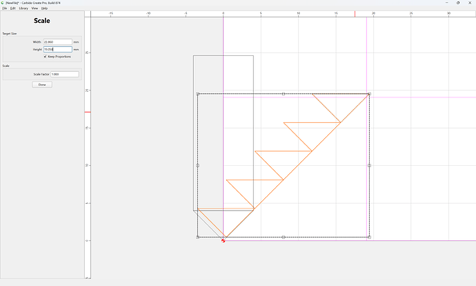

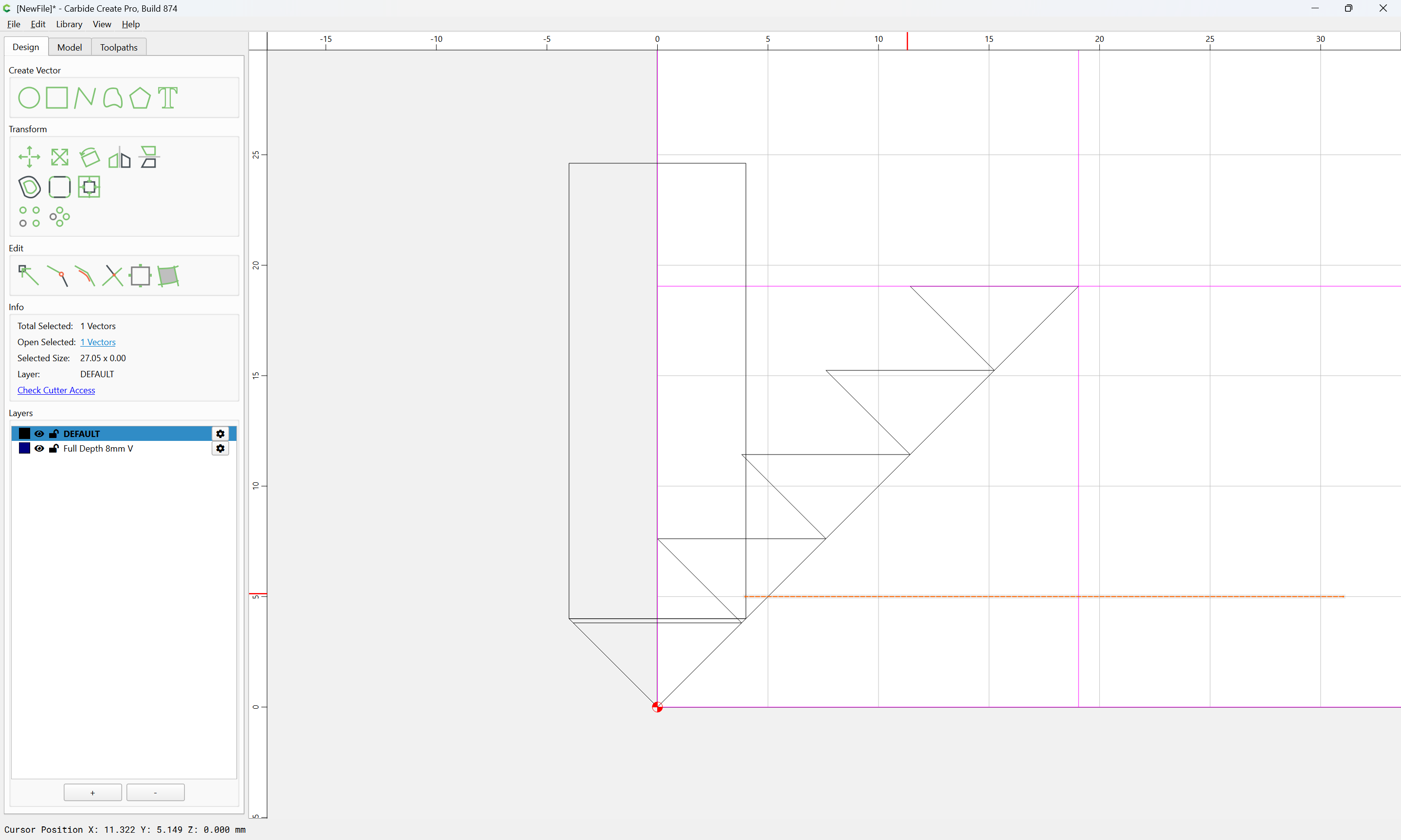

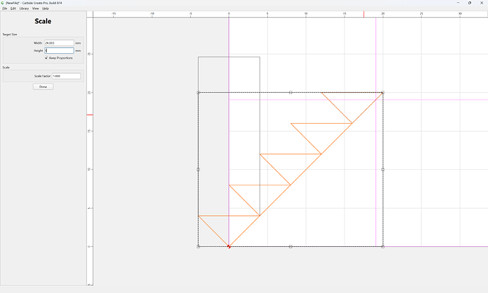

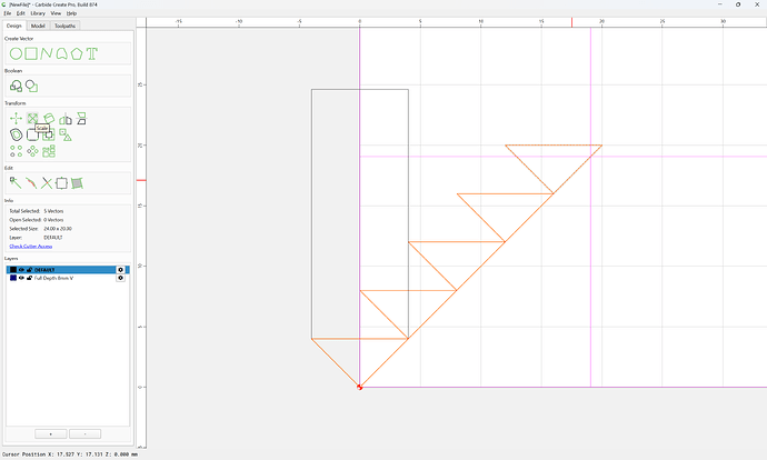

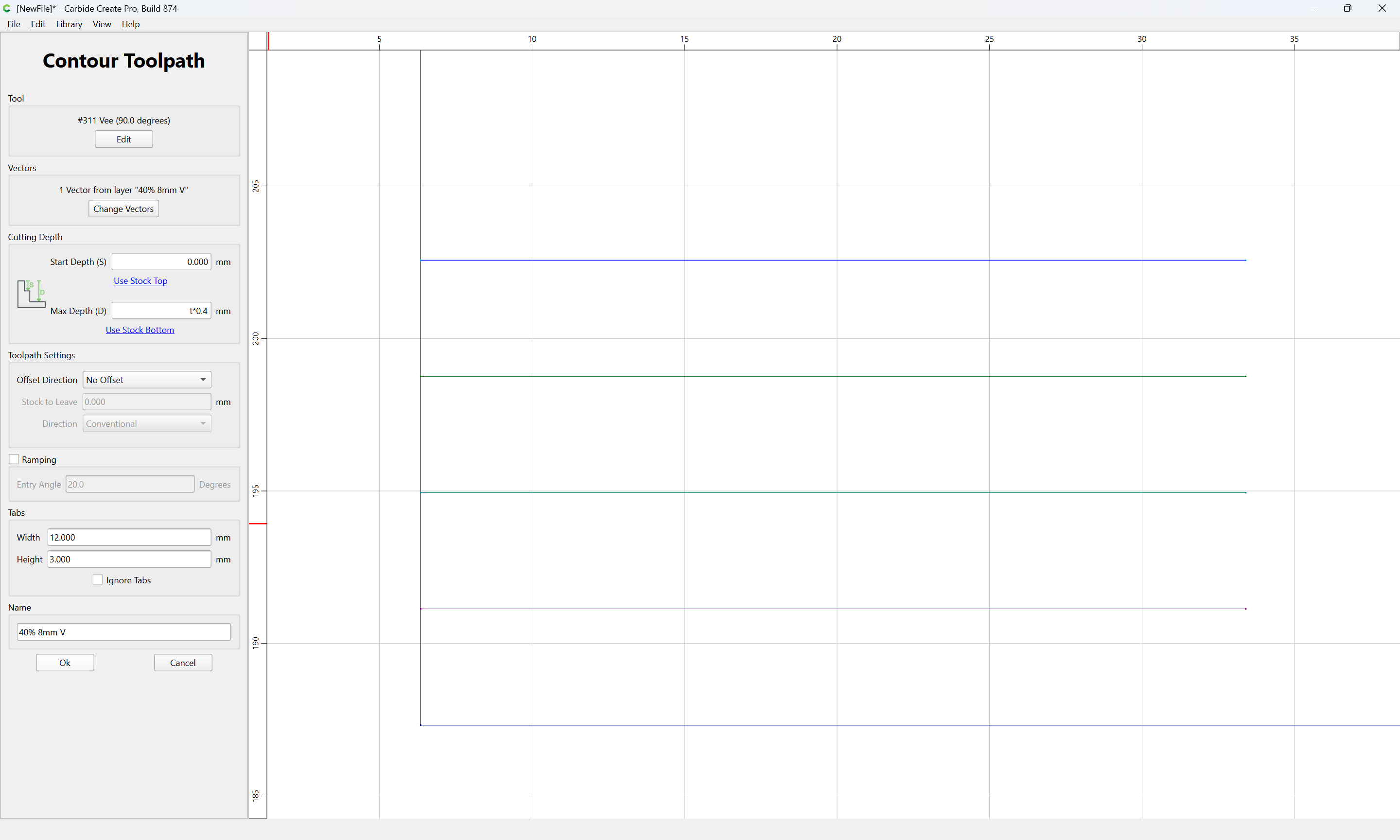

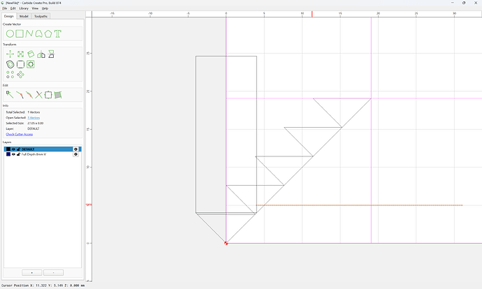

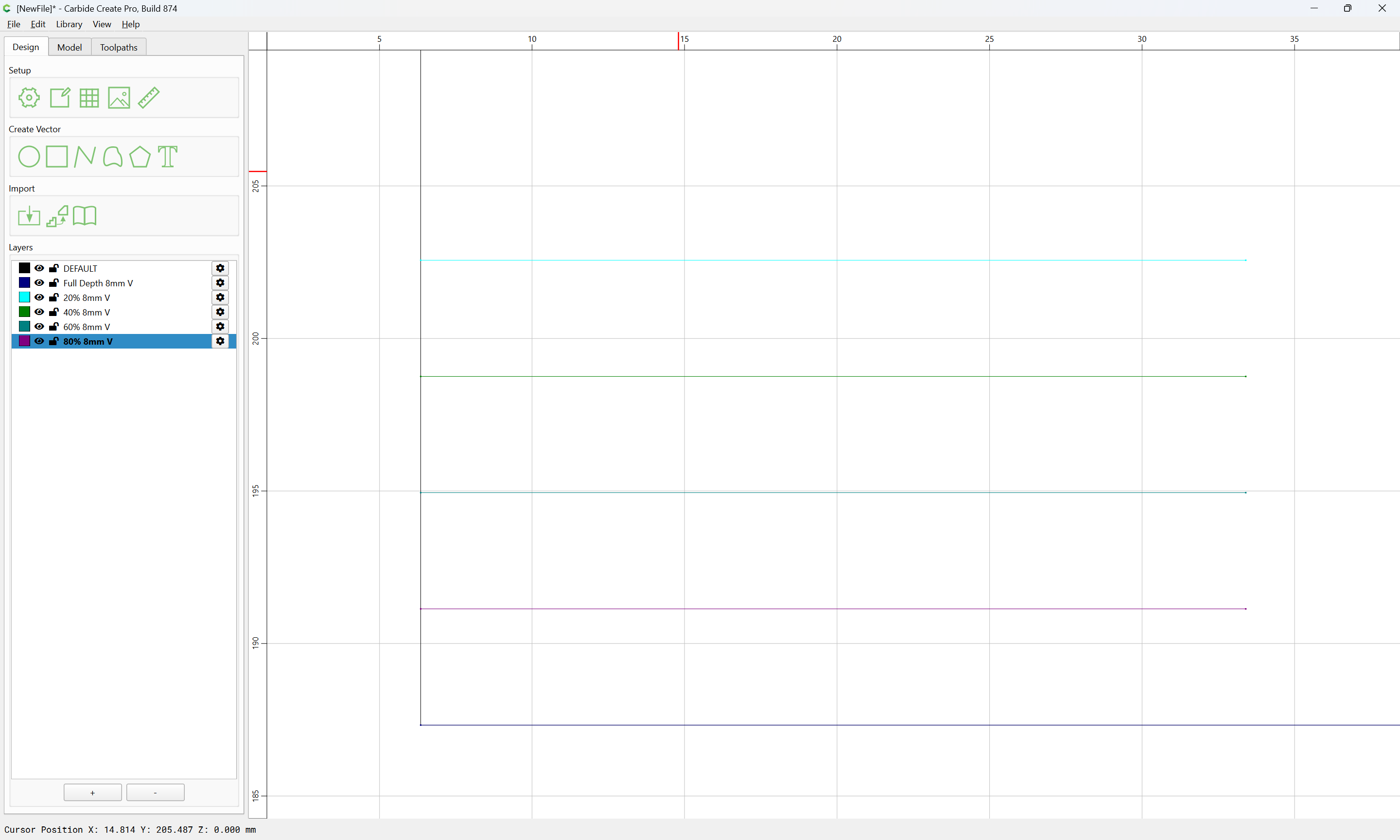

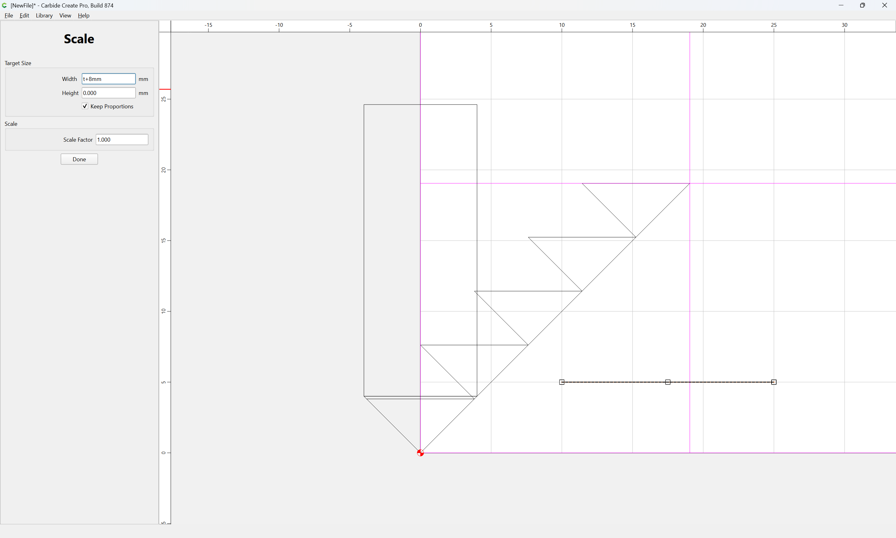

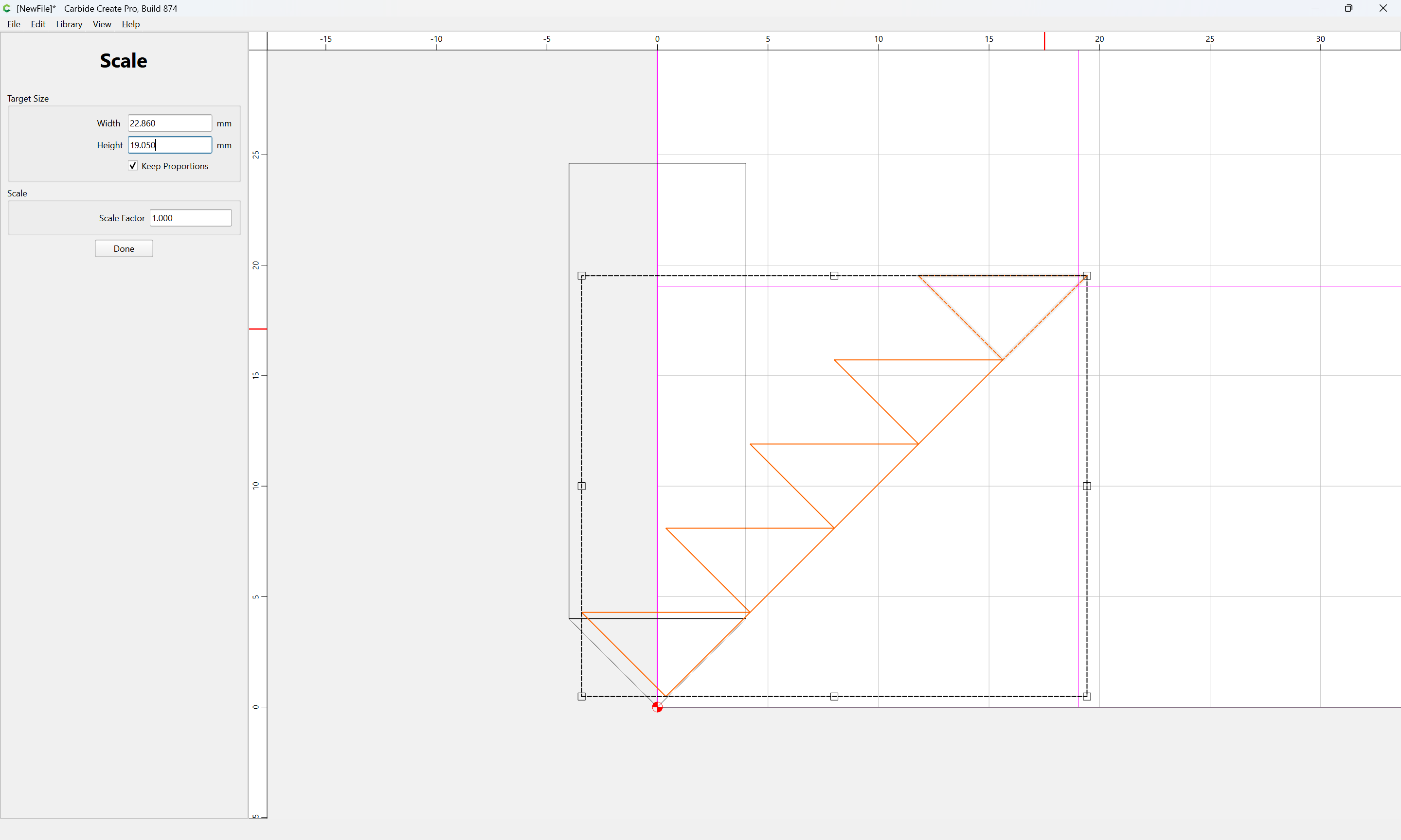

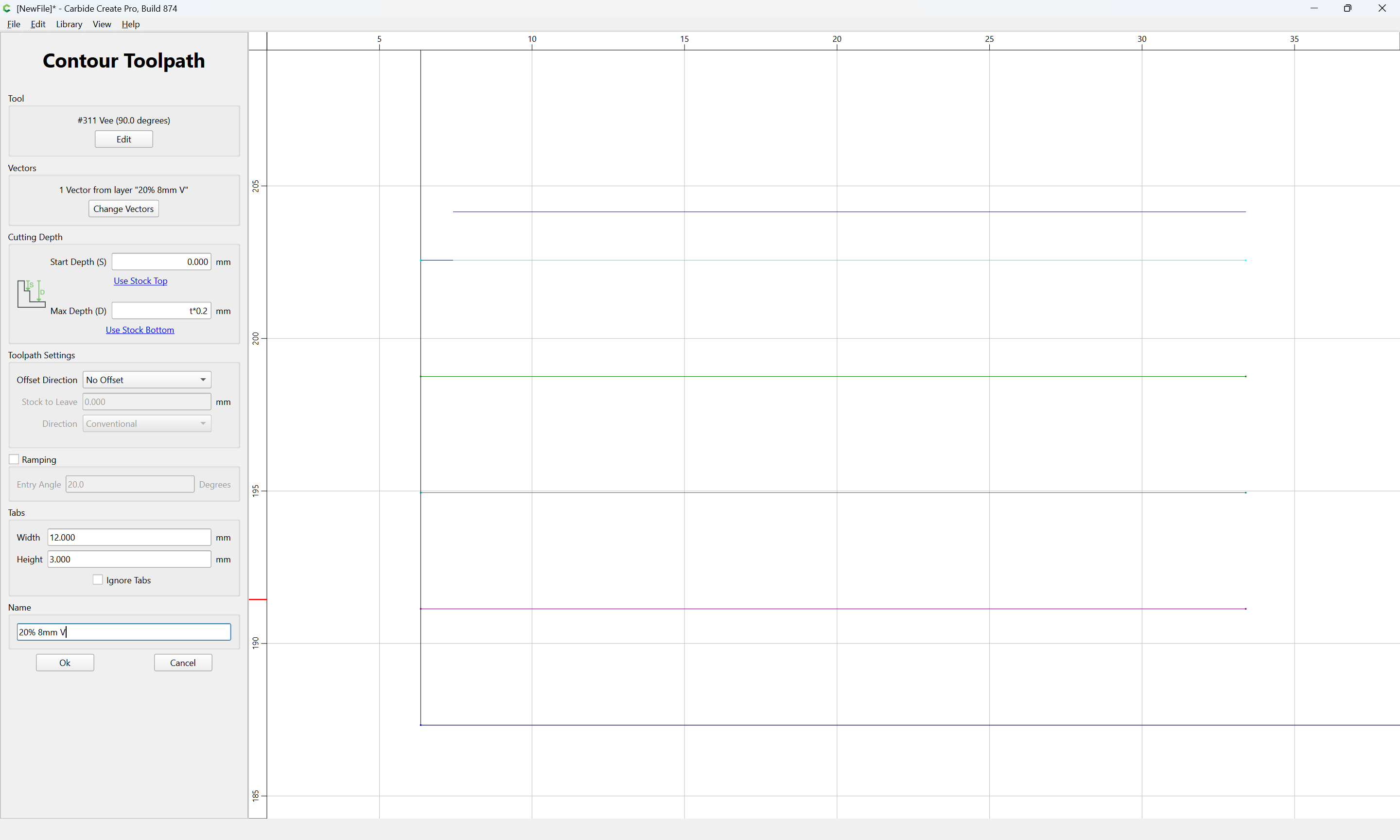

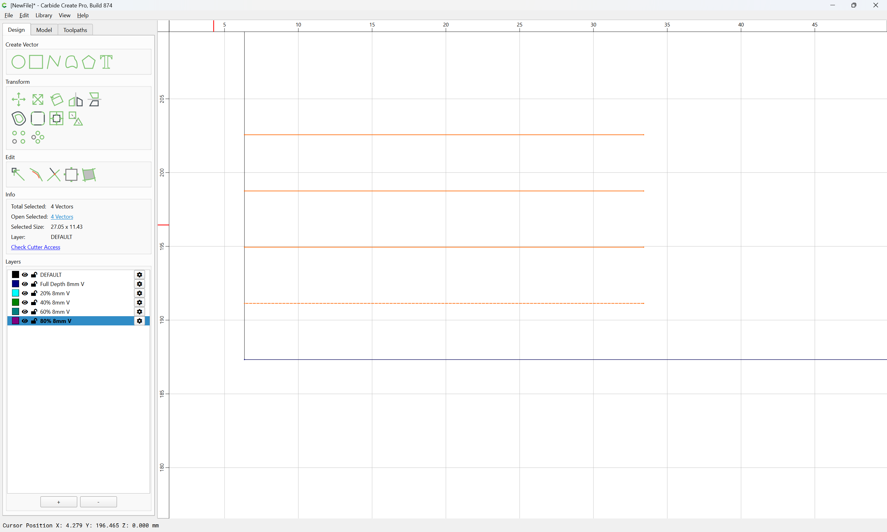

One somewhat tedious aspect will be to make multiple cuts using a V-tool at the corners so as to define the full-blind miter — if the tool is markedly larger relative to the thickness of the stock this is a bit easier, as it is, at least 5 such cuts at different depths will be necessary — selecting the 5 V-tool profiles:
we scale them to the thickness of the stock:
Done
and drag them back into registration:

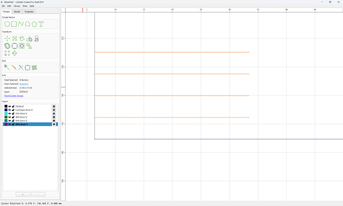

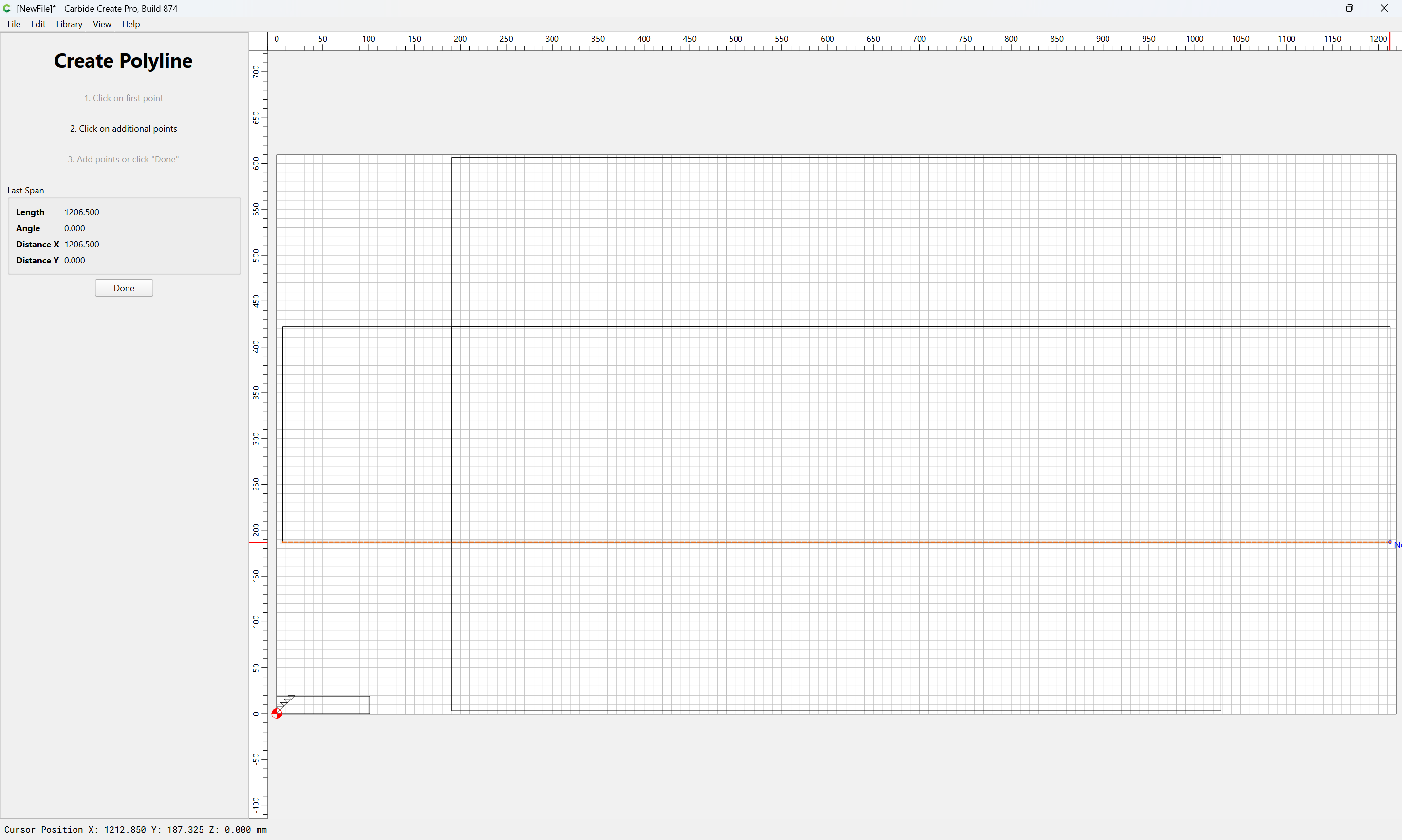

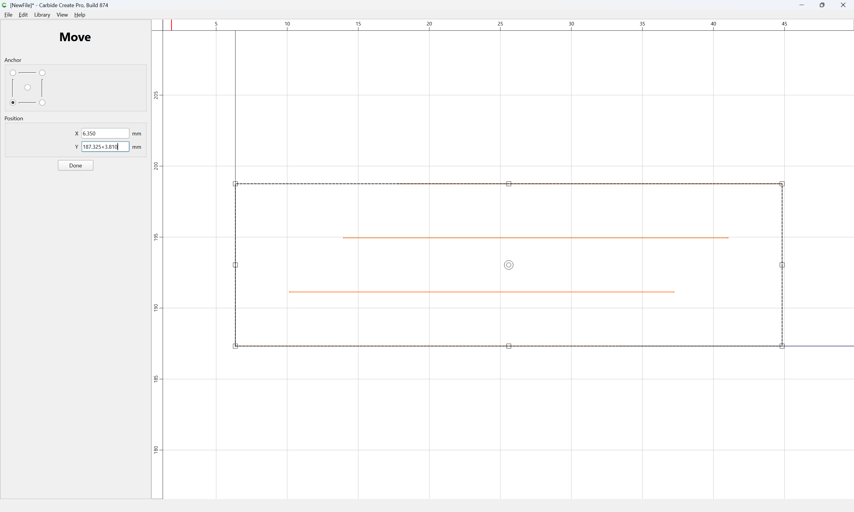

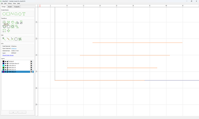

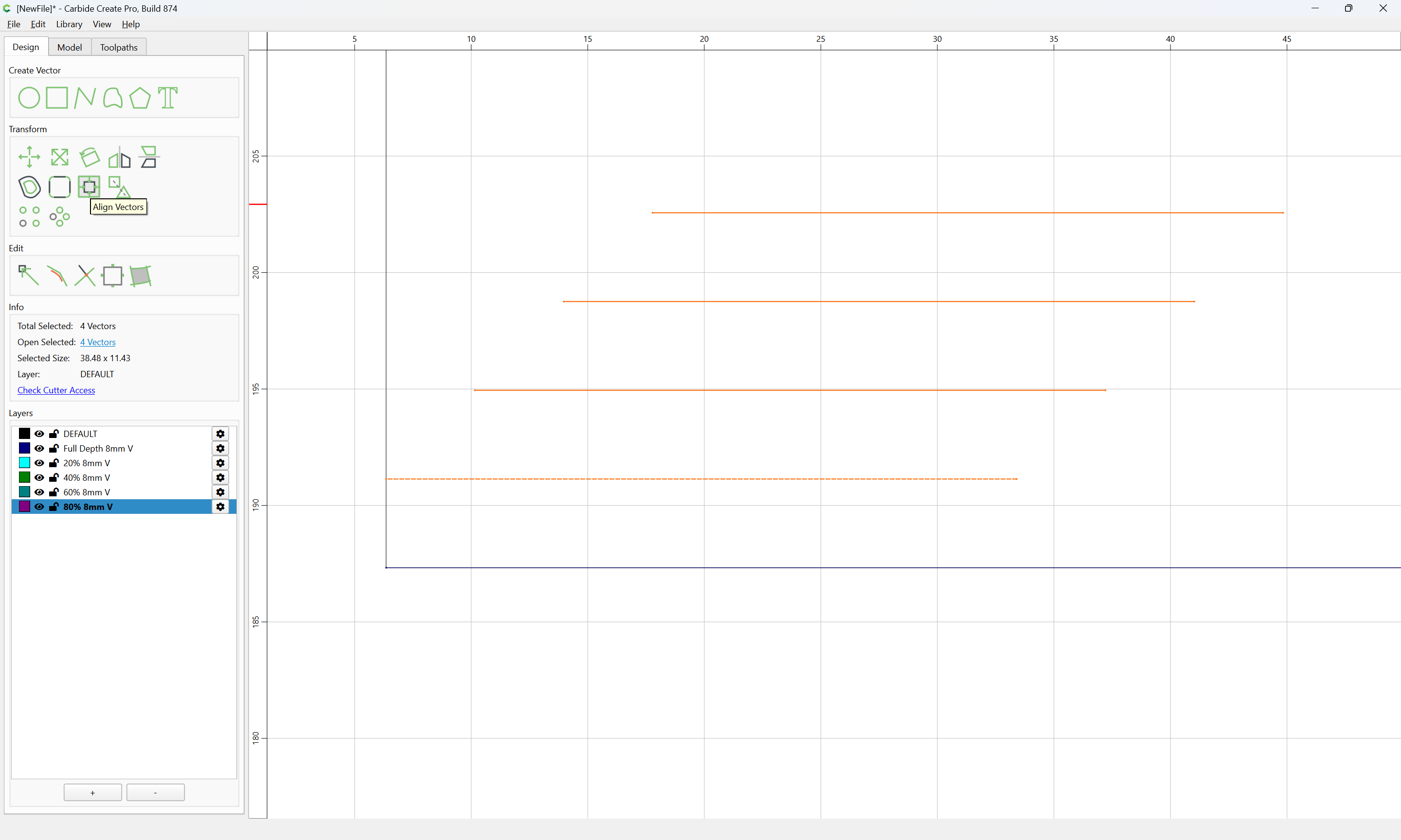

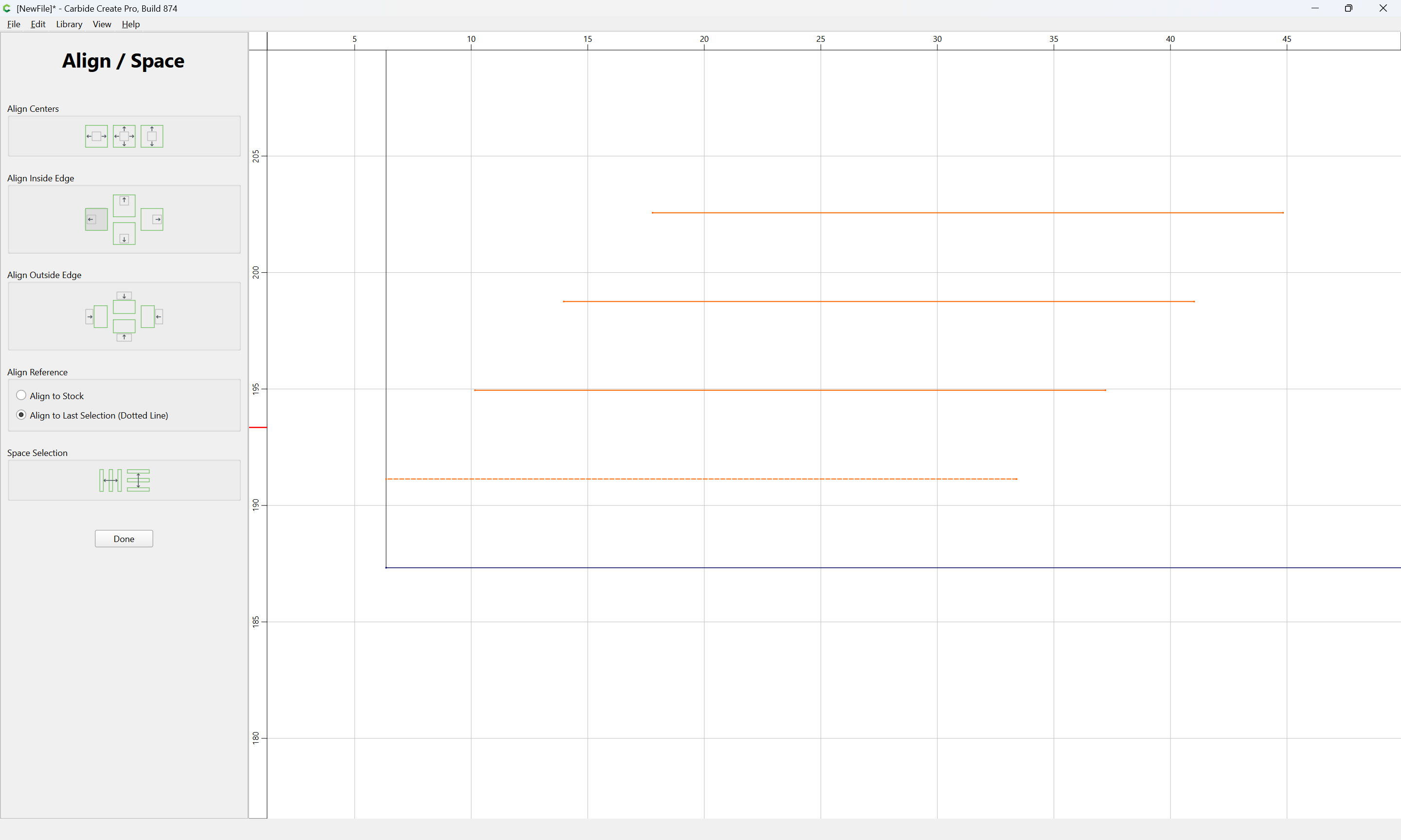

We then draw a line which is as long as the thickness of the stock plus the 8mm width of the tool which will be used to cut the hidden box joints:
Done
and drag it into registration:
and then replicate it for each V-tool proxy:

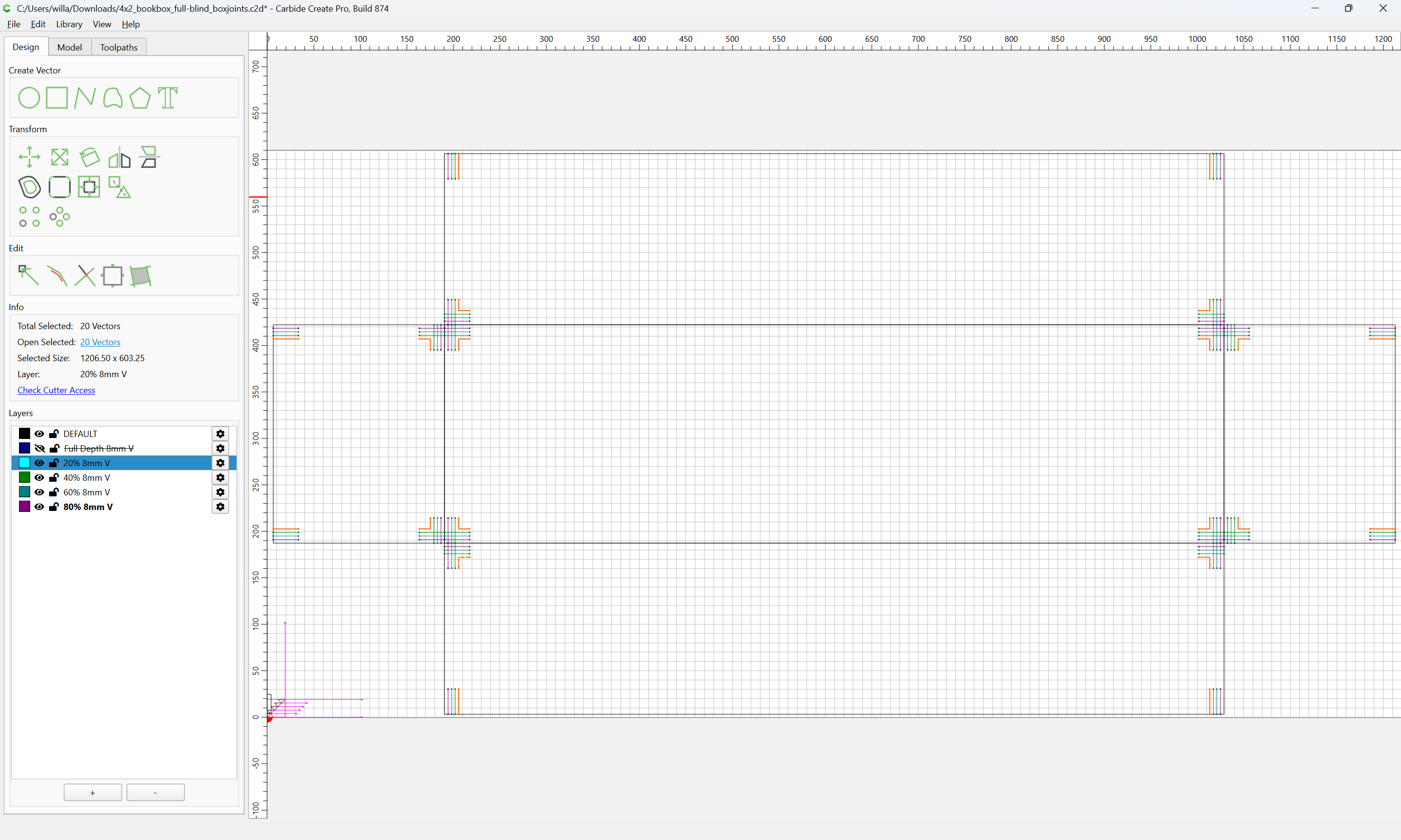

and we make a separate Layer for each depth of cut:

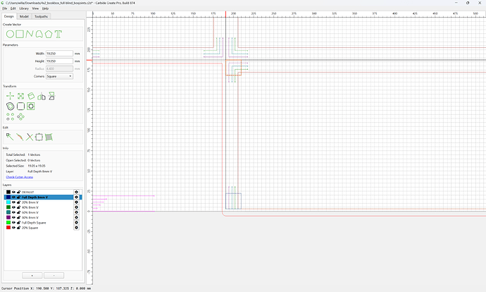

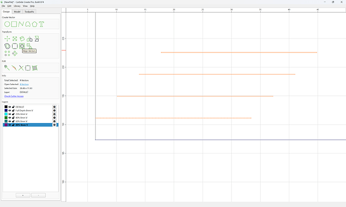

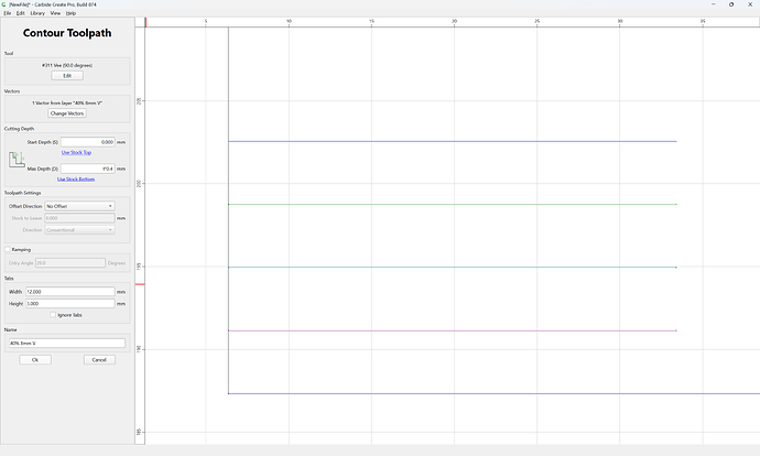

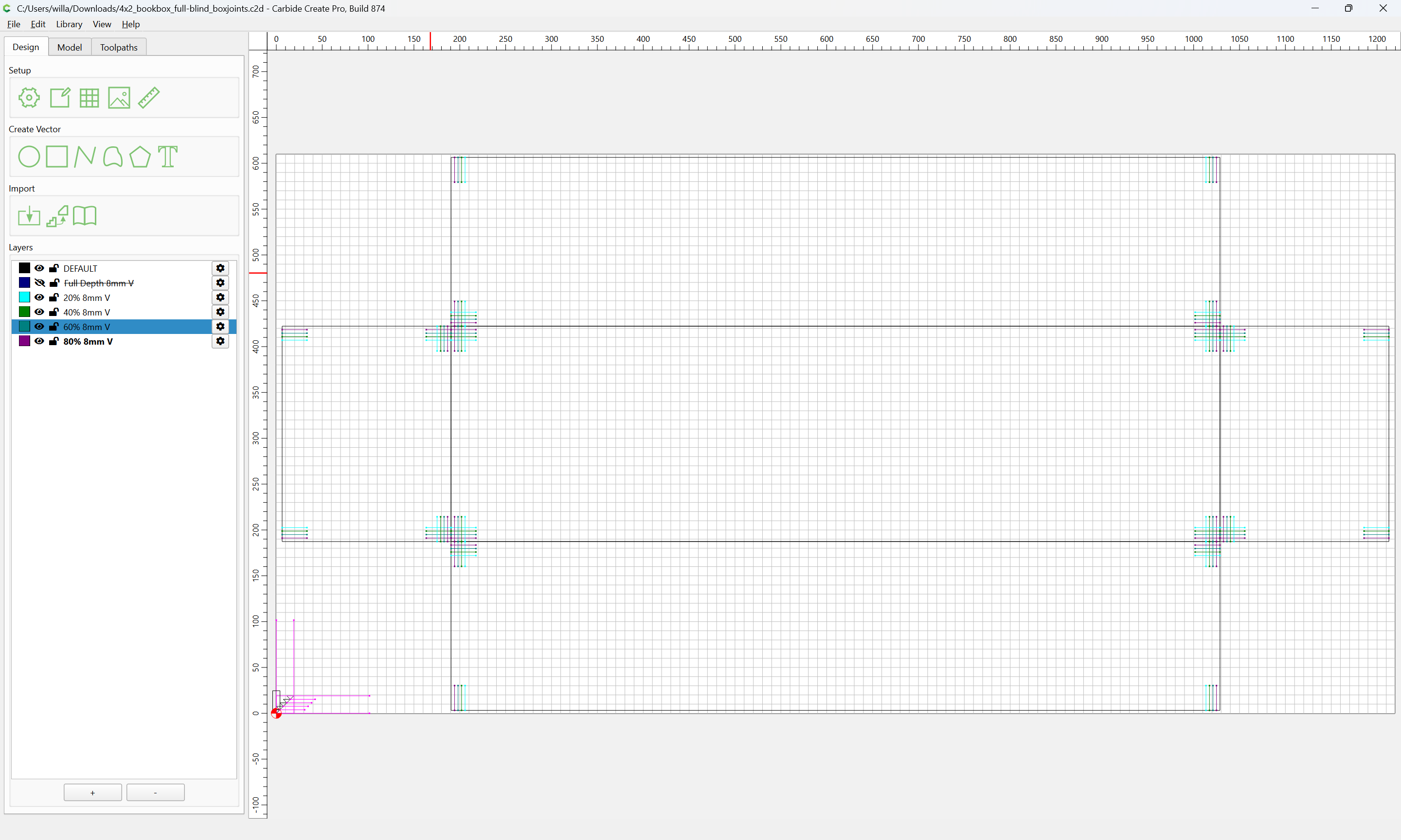

Then at each corner, a set of these lines need to be arranged:
and positioned:
Done
and aligned
Done
and then each assigned to the appropriate layer:

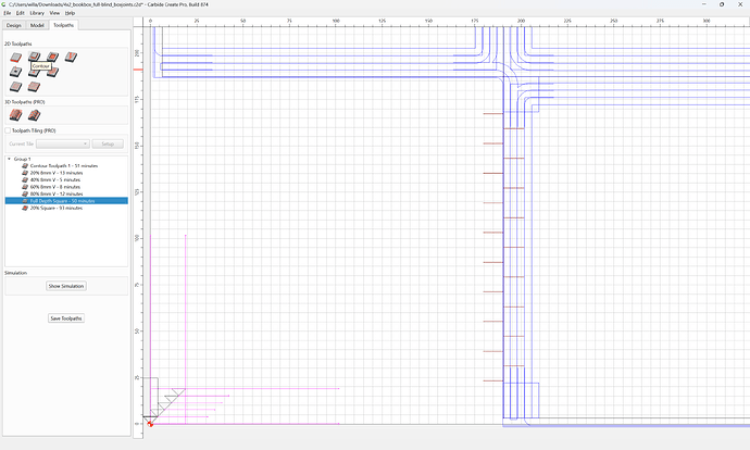

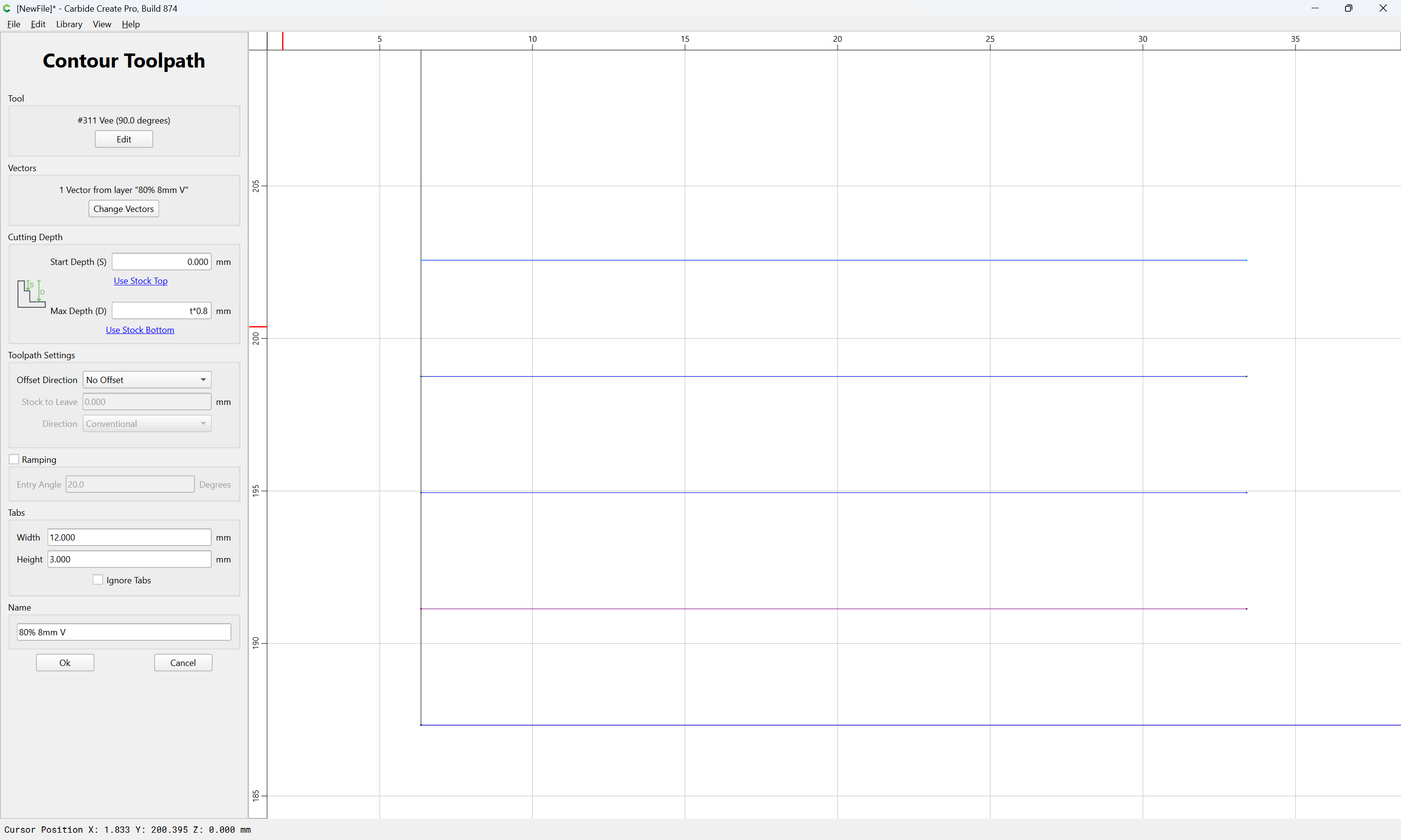

and an appropriate toolpath set up for each layer:

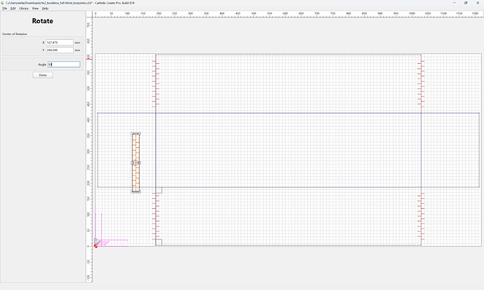

Duplicate to each corner:
rotating as necessary.

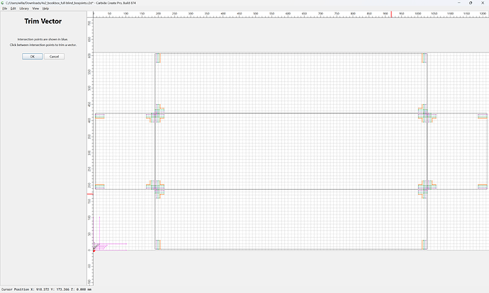

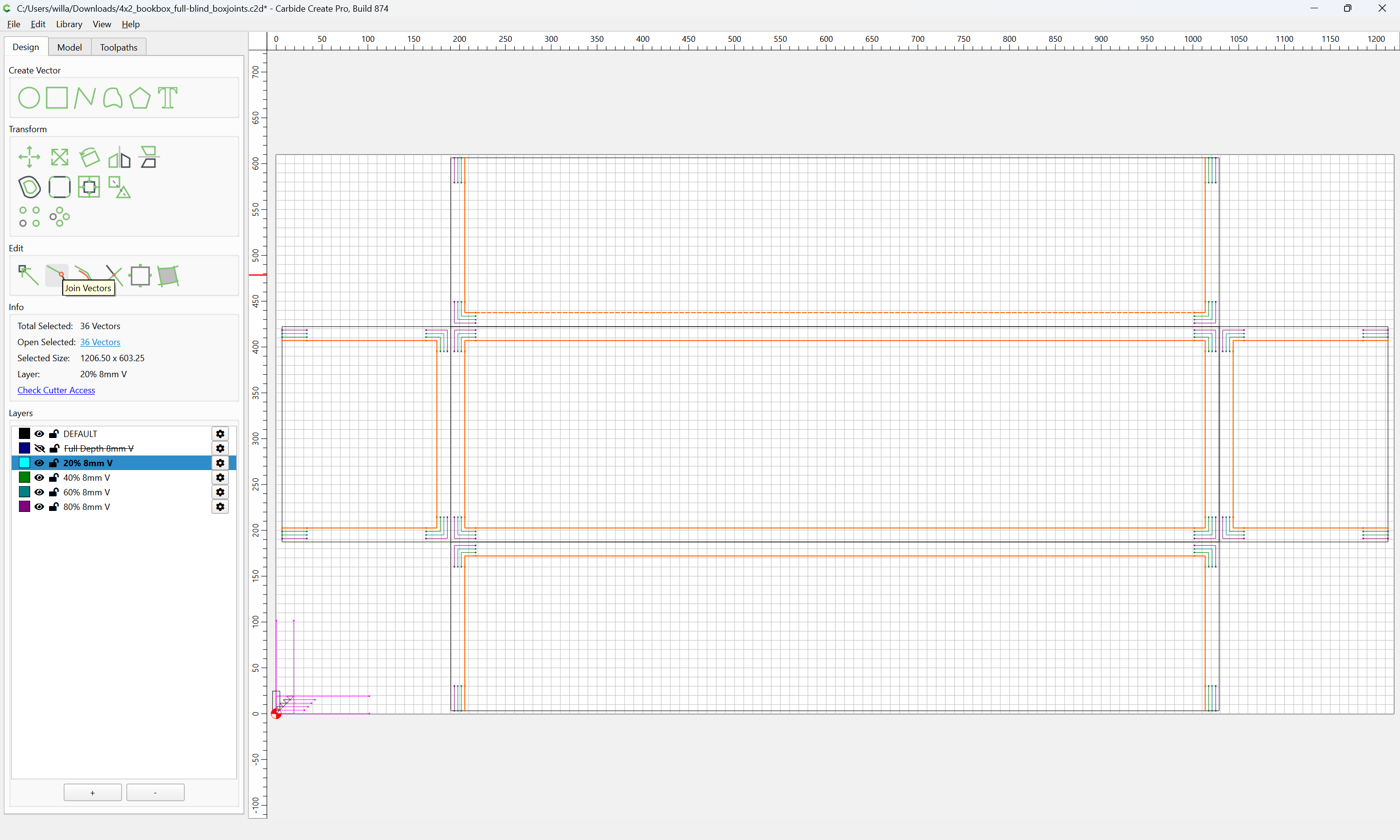

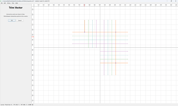

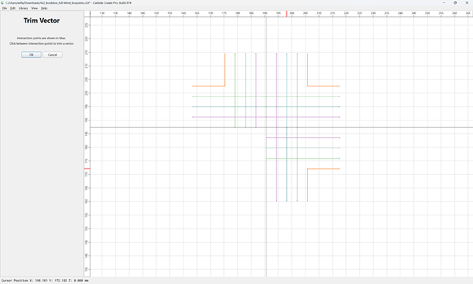

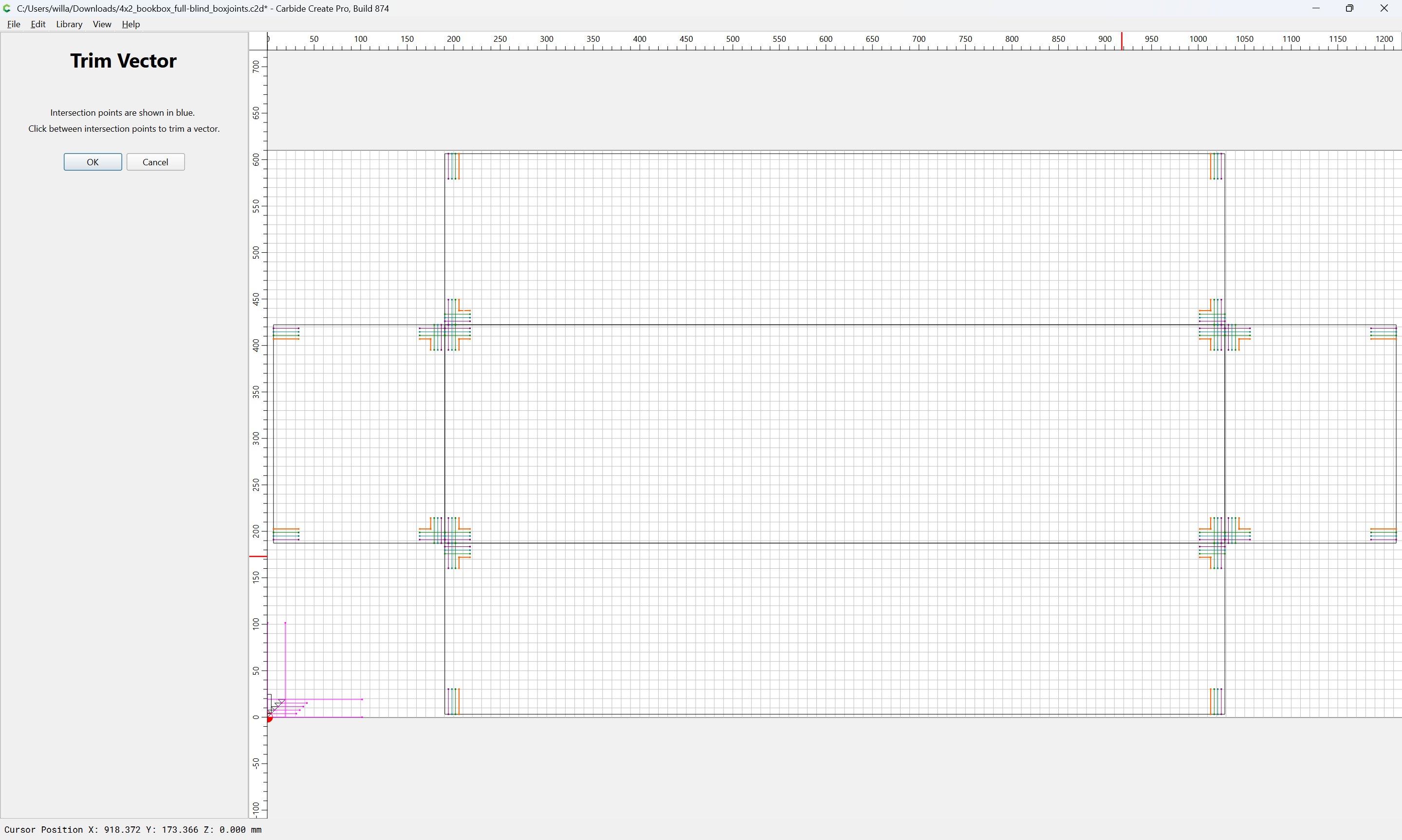

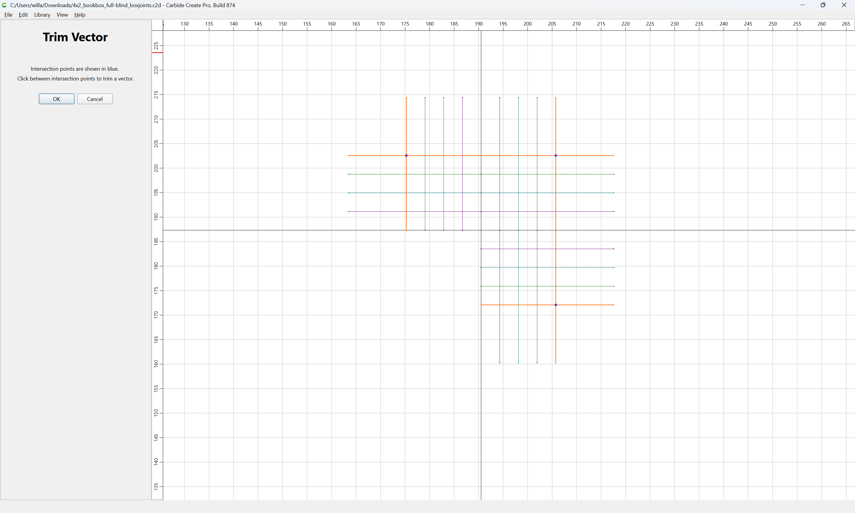

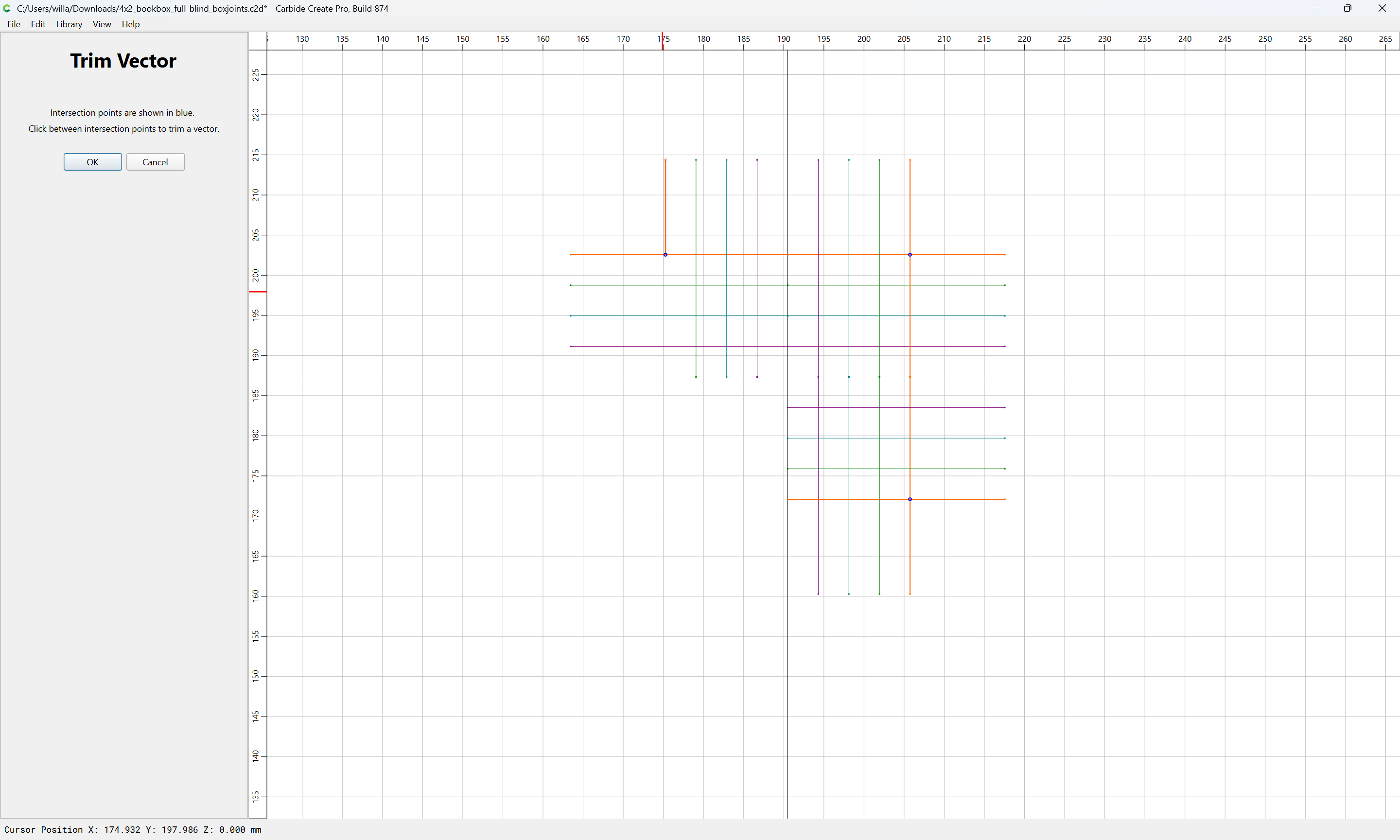

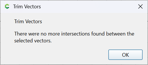

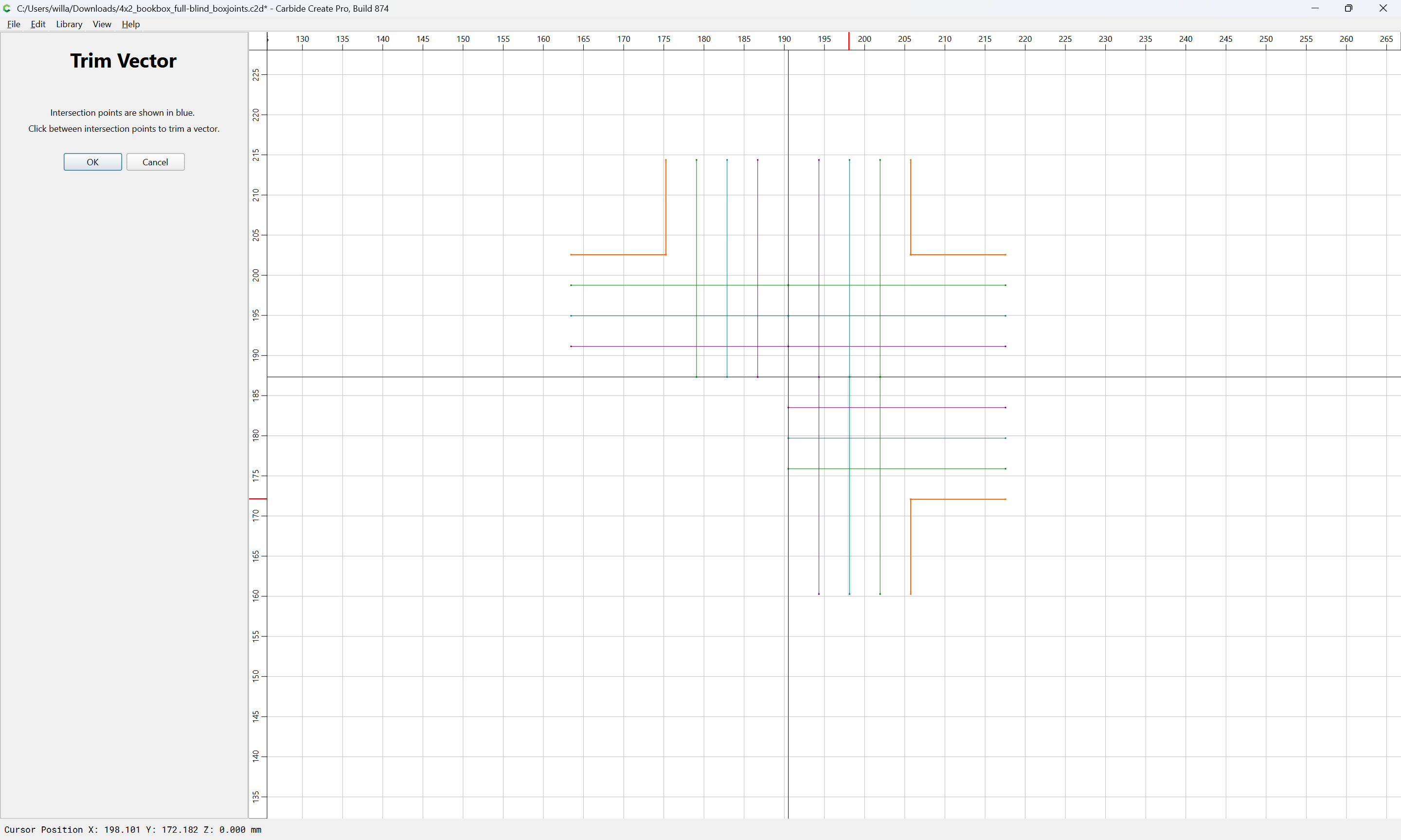

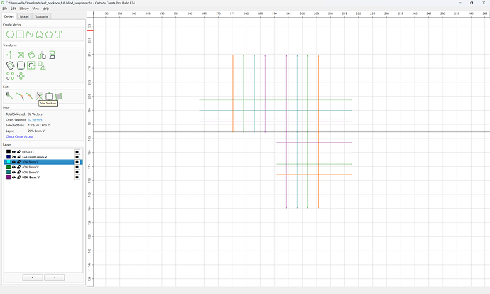

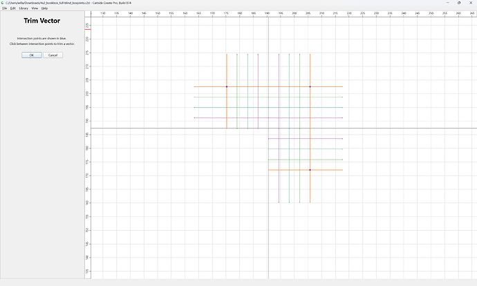

For the corners, select the geometry:
and use Trim Vectors:
to remove what is redundant:
until one arrives at:
OK
OK

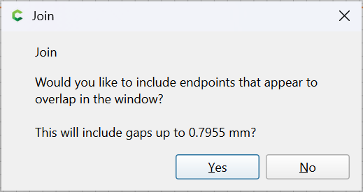

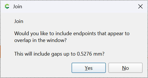

Then use Join Vectors:
Yes
Repeat for the other layers…
which previews as:

With all the V-tooling geometry defined it will be necessary to turn to the square cuts — three depths will be necessary:
  • full-depth at the outside edges of the top/bottoms and sides
  • shallow-depth describing the edges of the top-most V-tooling cut
  • depths to the pocket depth (penultimate V-tool cut depth)

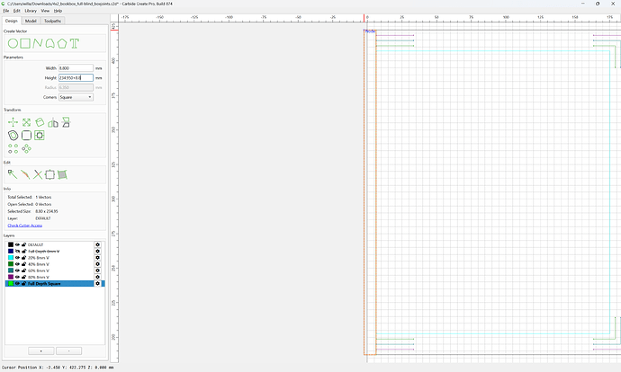

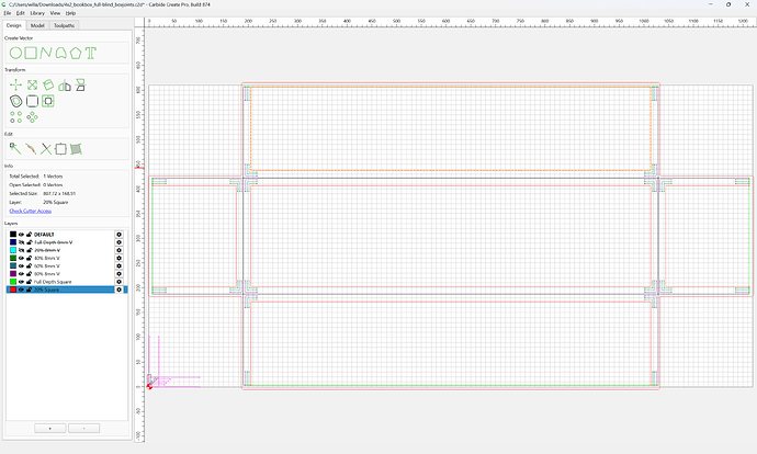

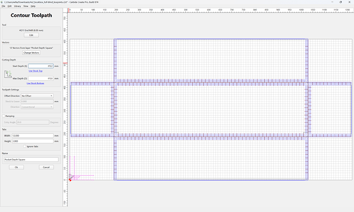

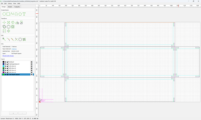

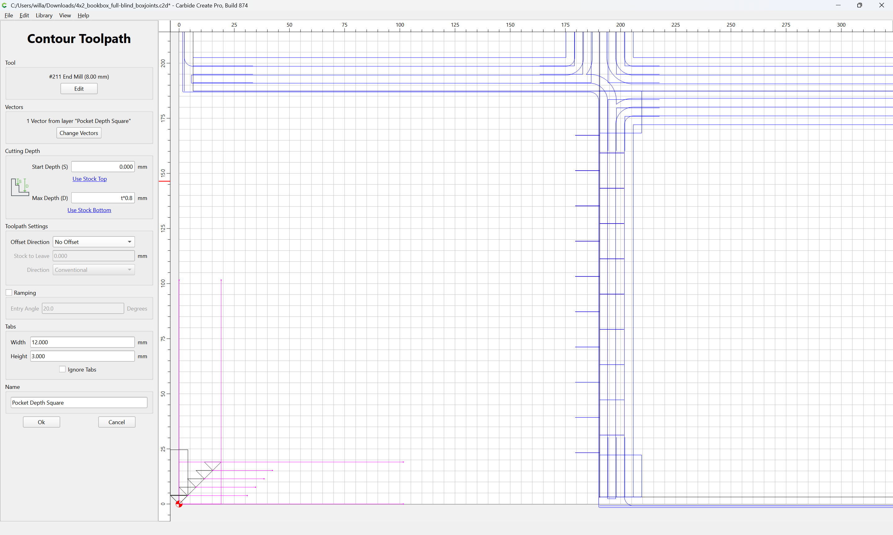

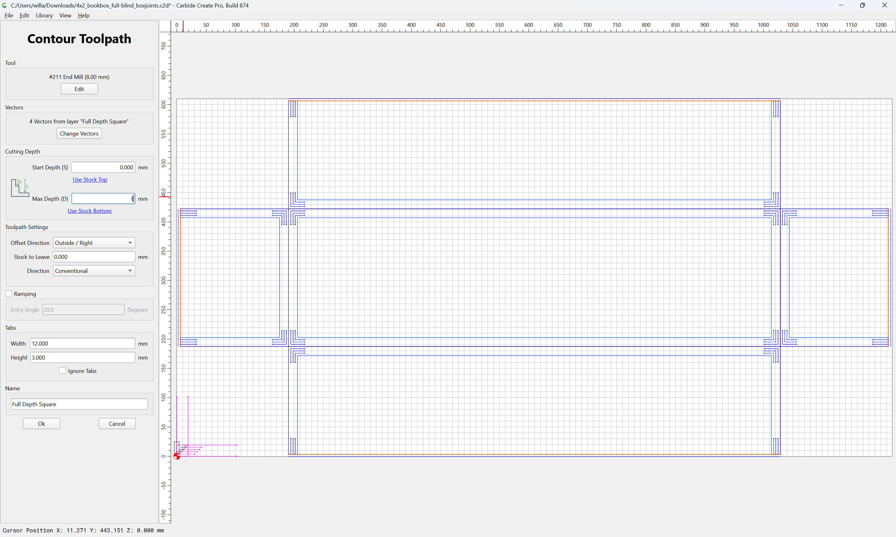

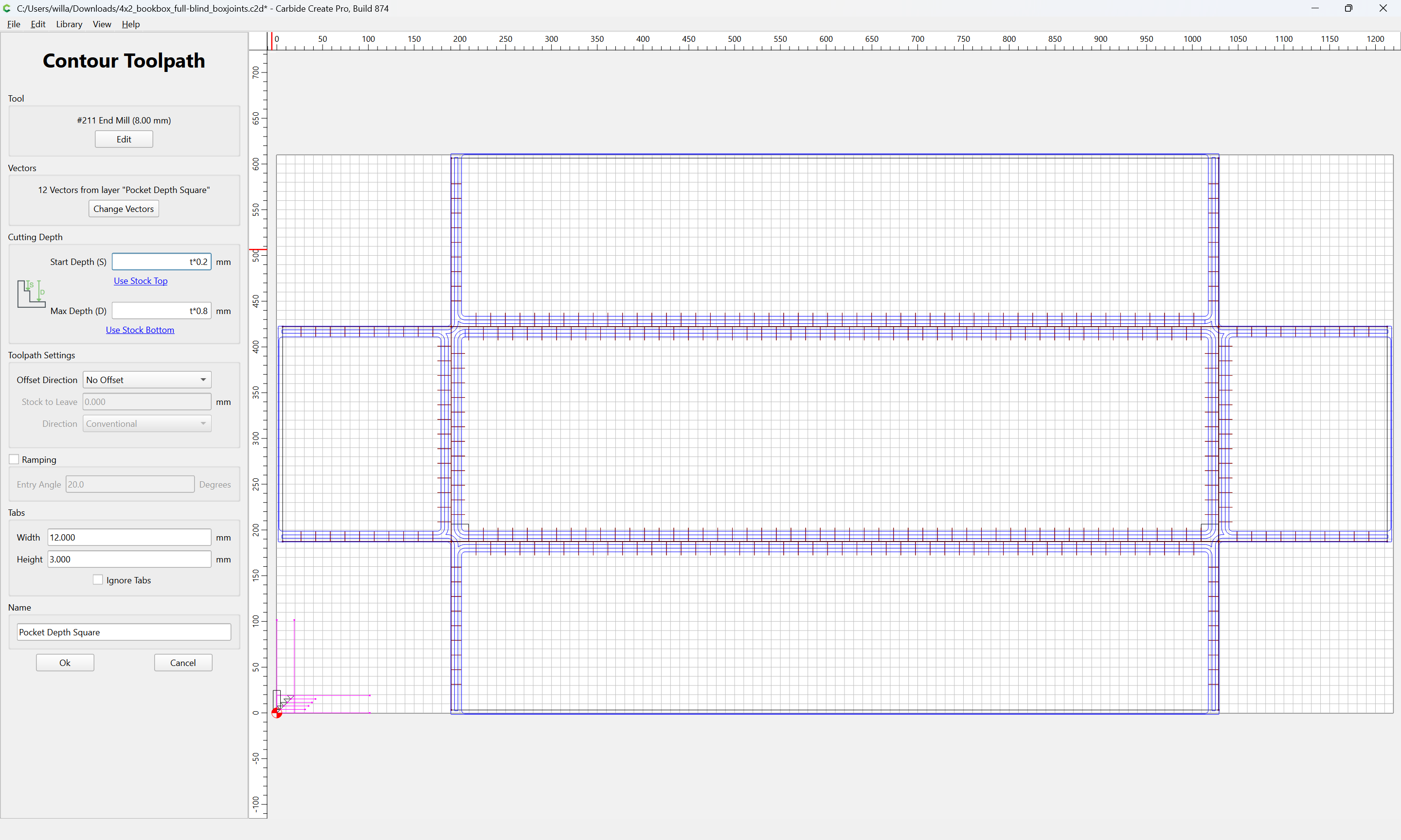

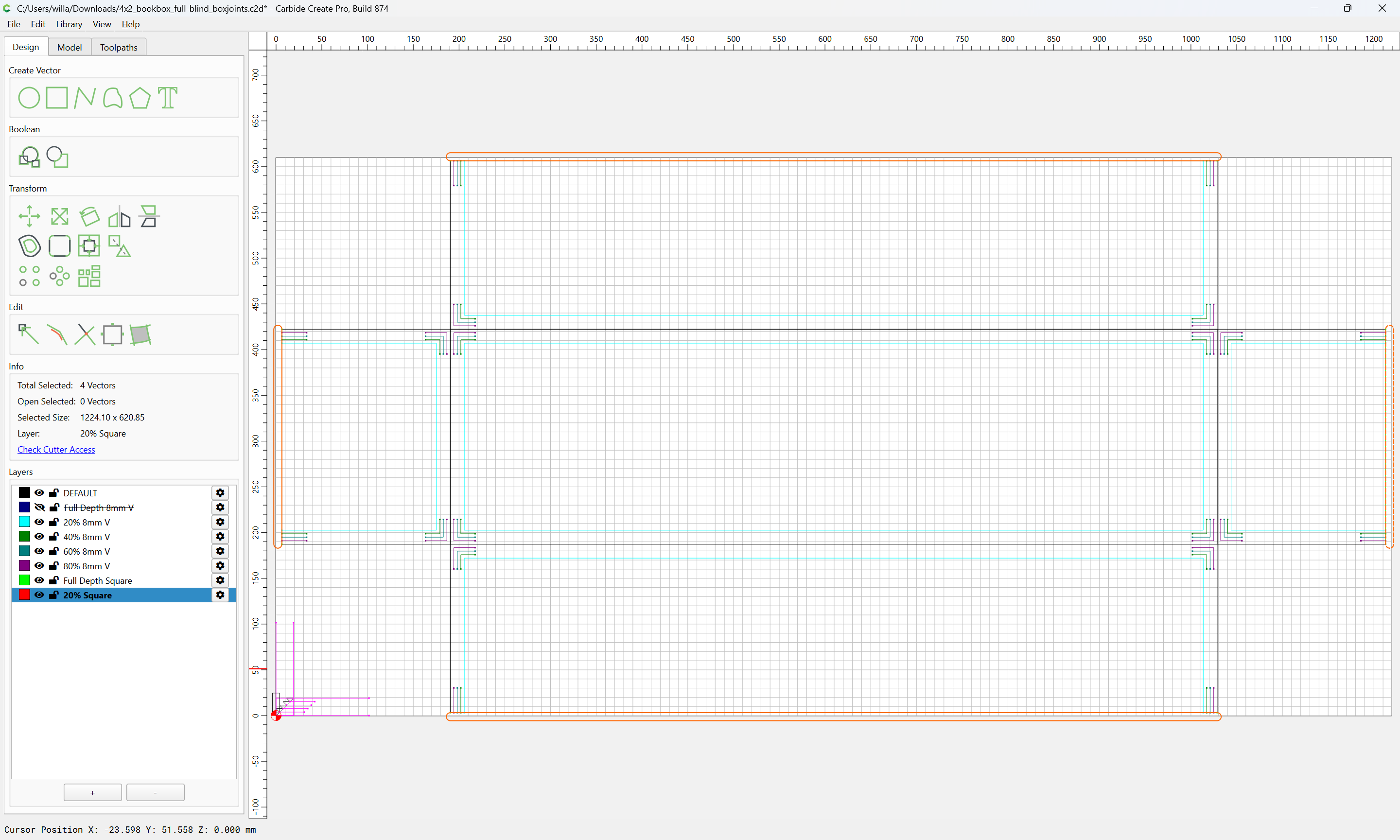

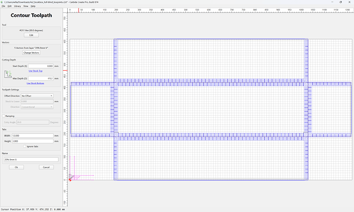

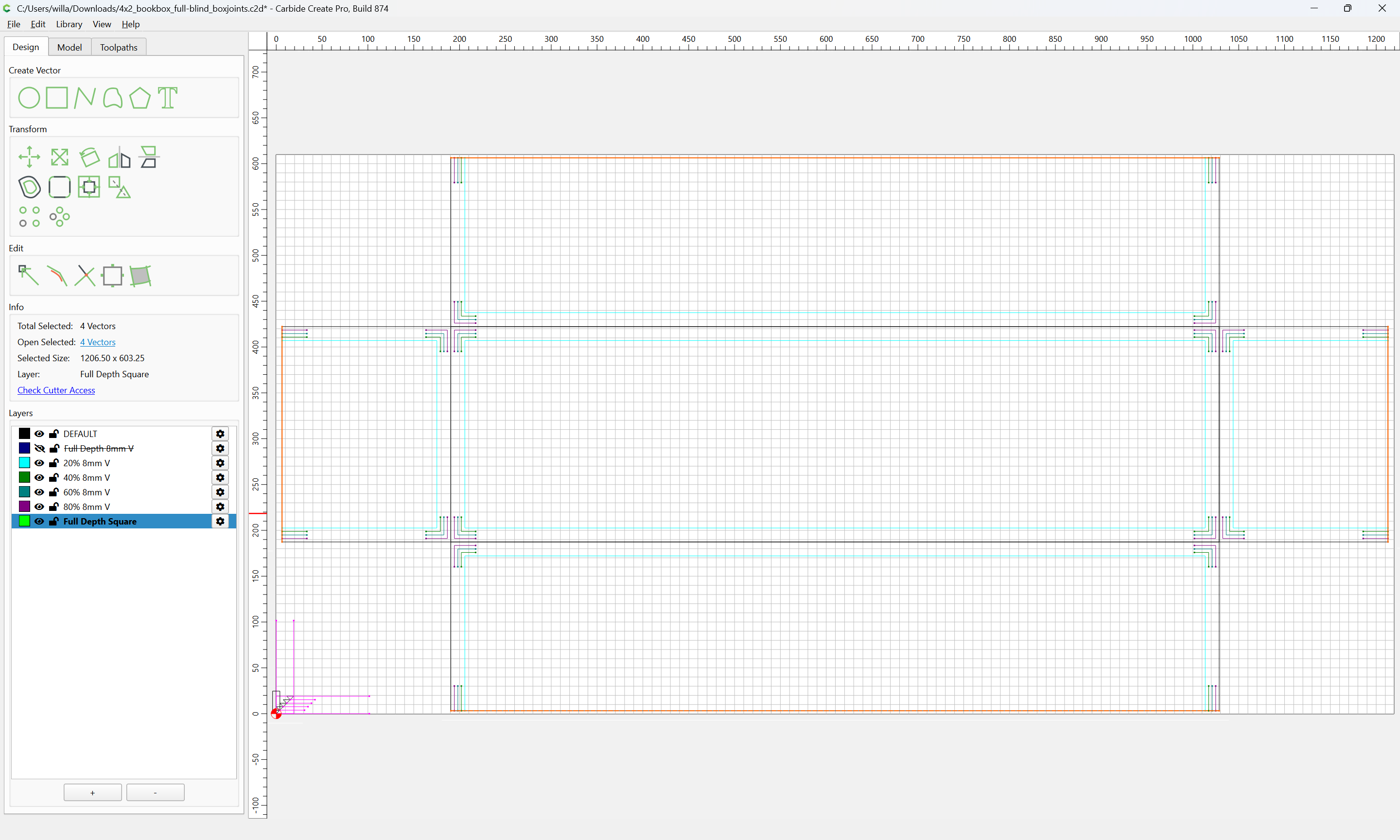

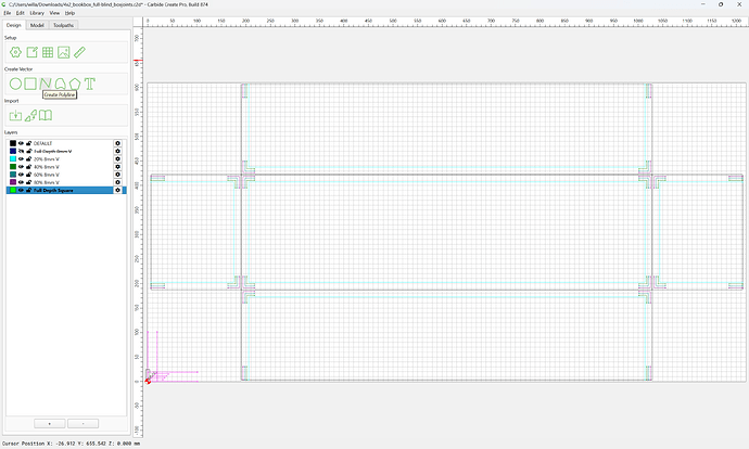

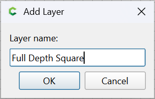

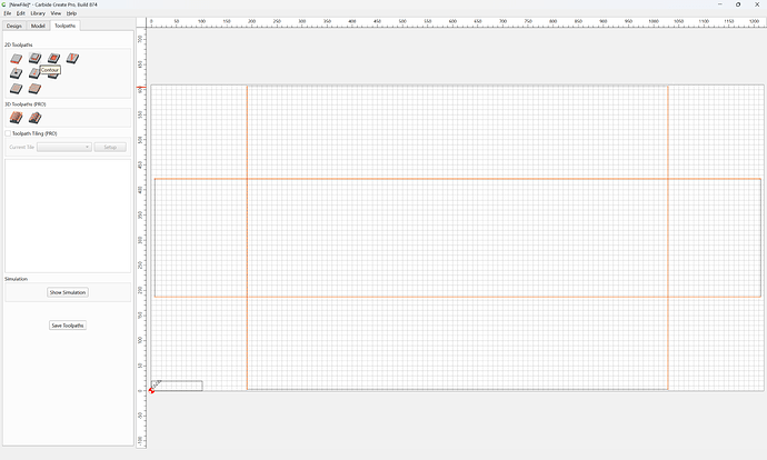

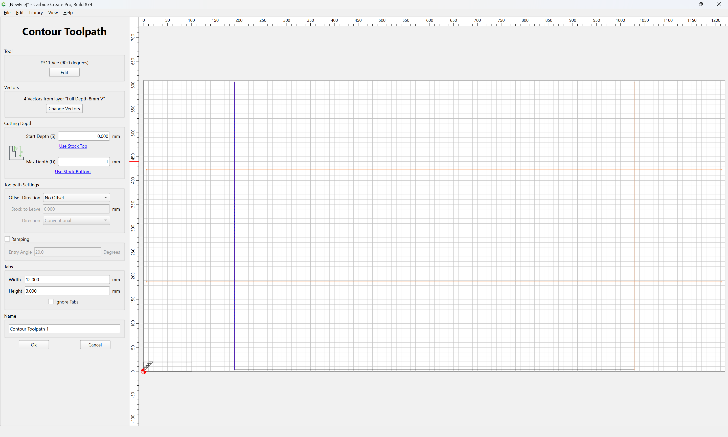

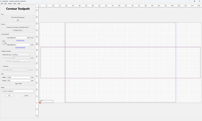

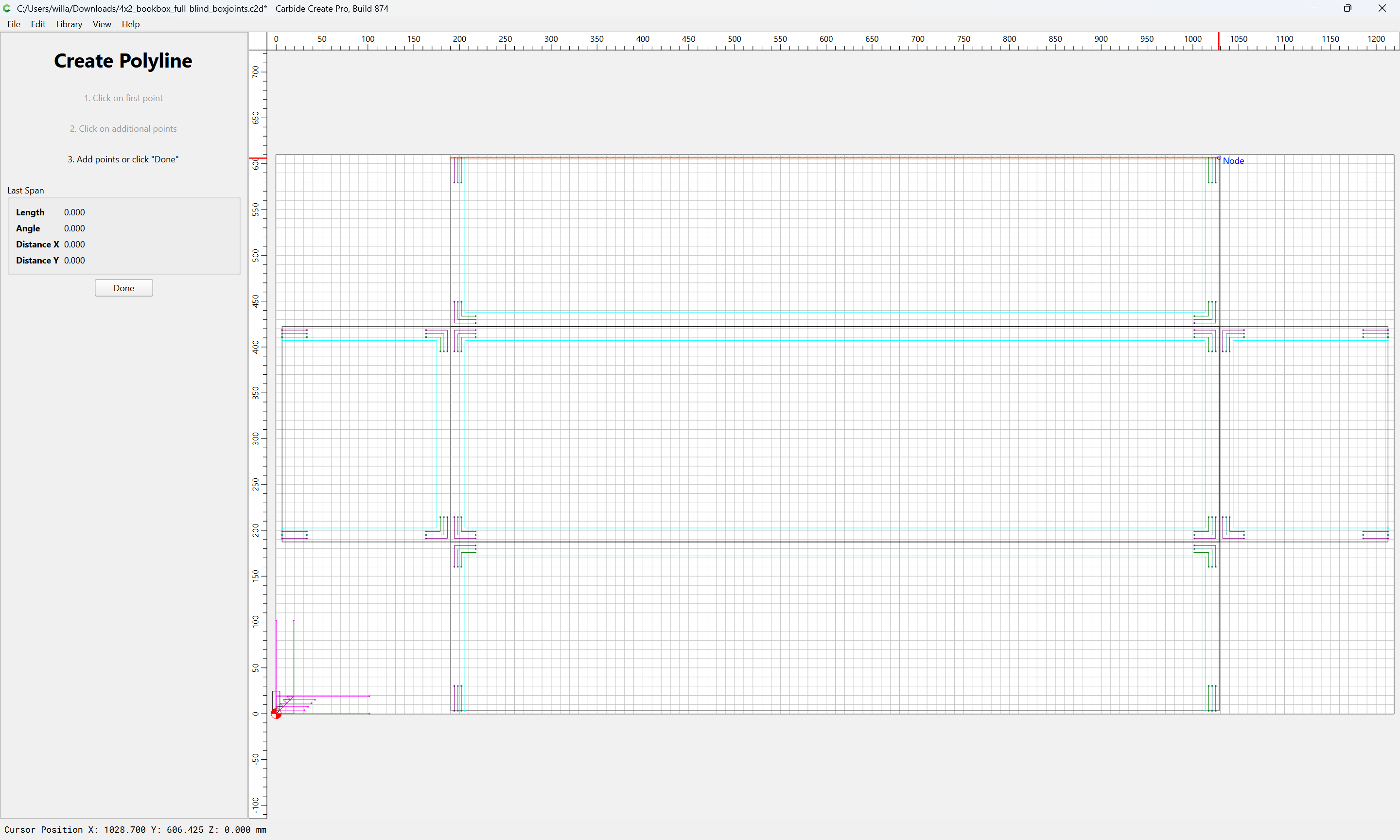

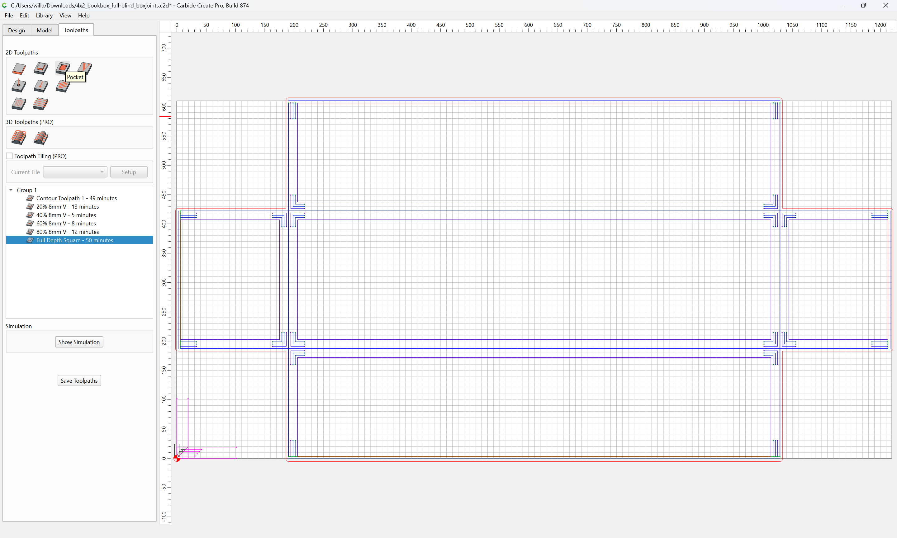

The easiest to set up is the full-depth which is an outside contour cut along the outside edges — as before, we set up a Layer:
and draw lines at the edge of where the cut will be made:
Done
repeating until we have:

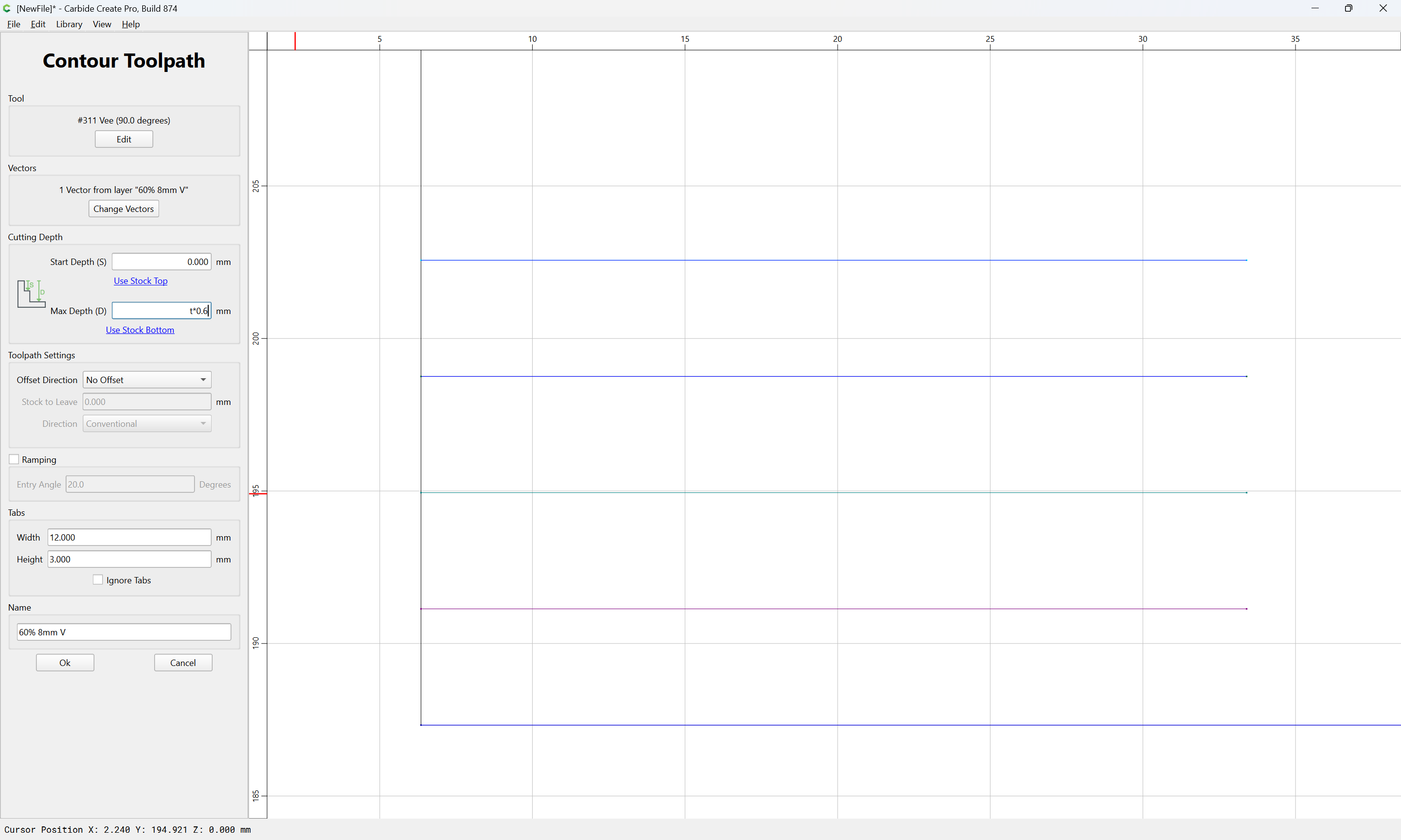

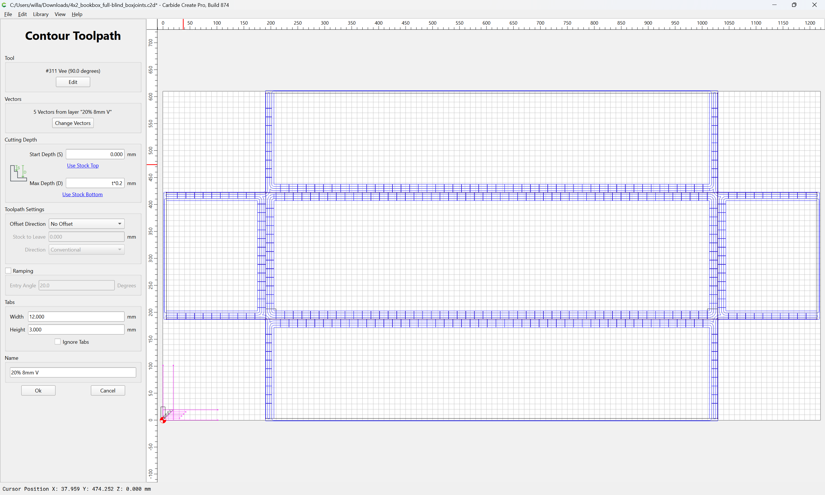

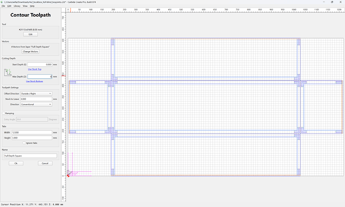

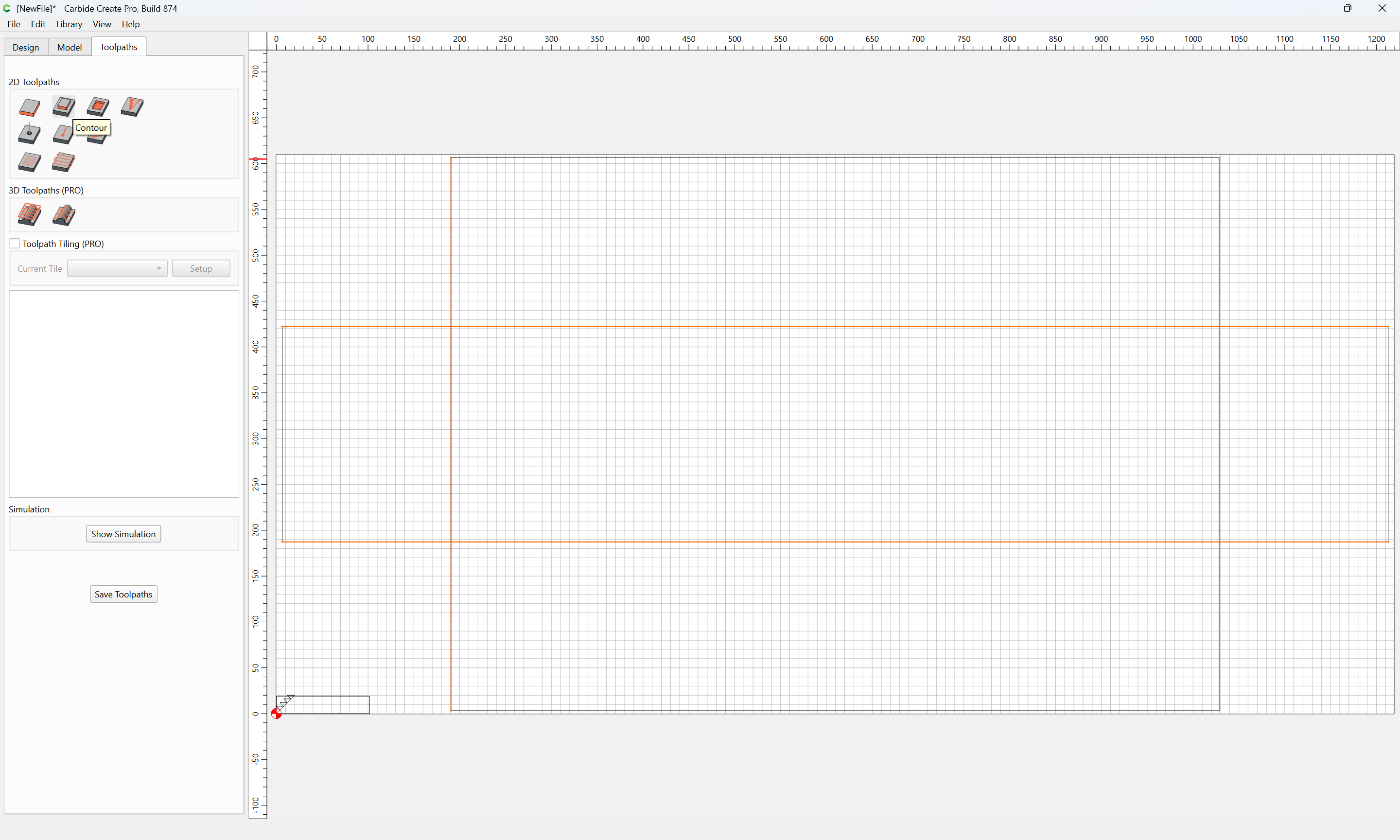

Then we set up a Contour toolpath:
(If the side placement is wrong, go back to the Design tab and reverse the relevant paths)
this previews as:

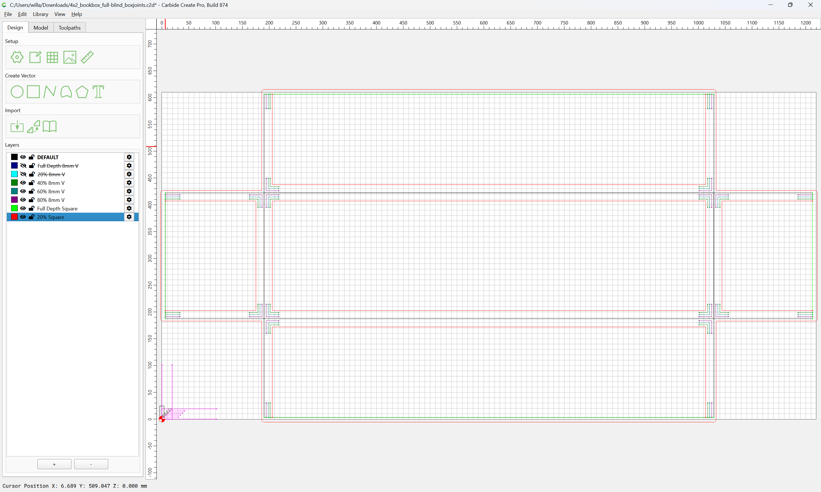

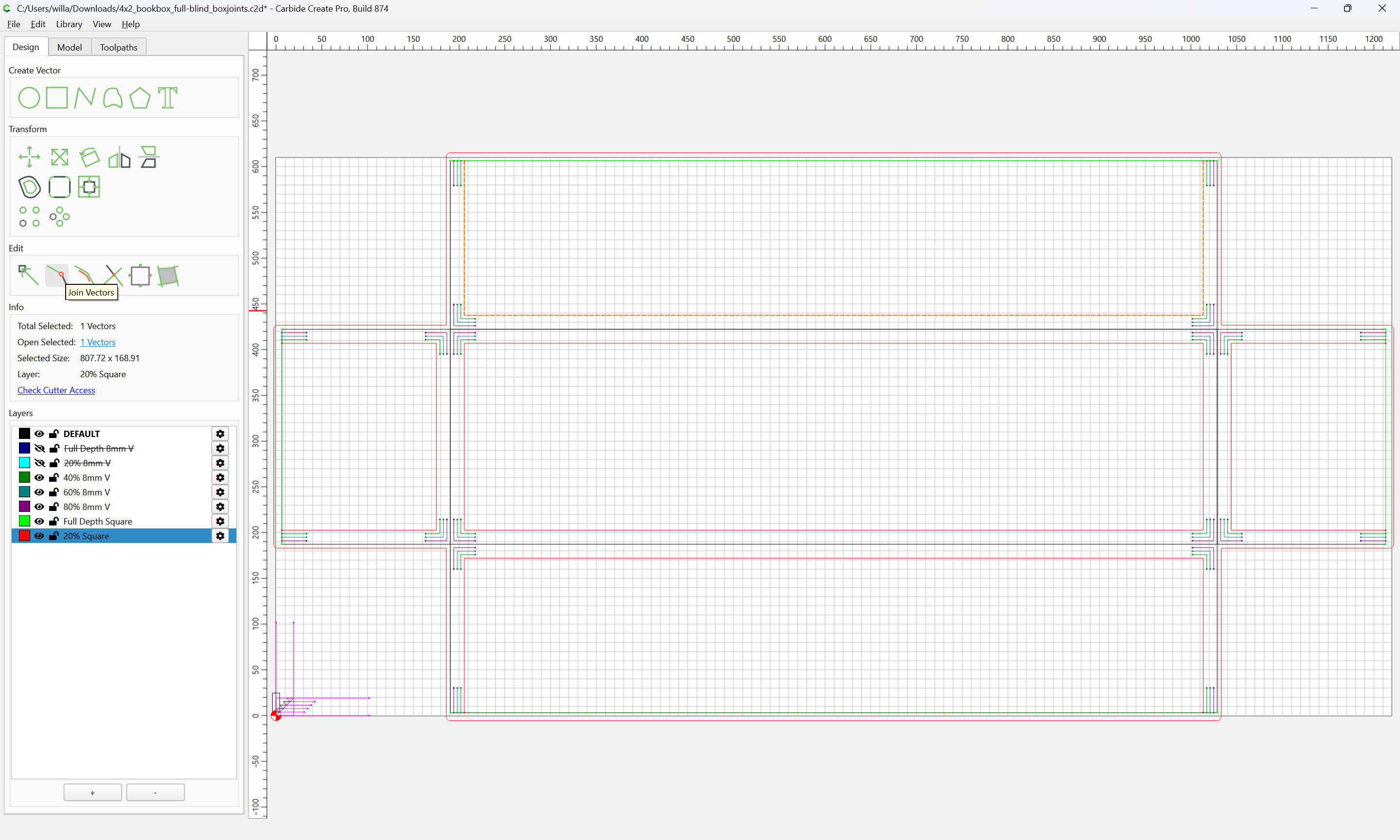

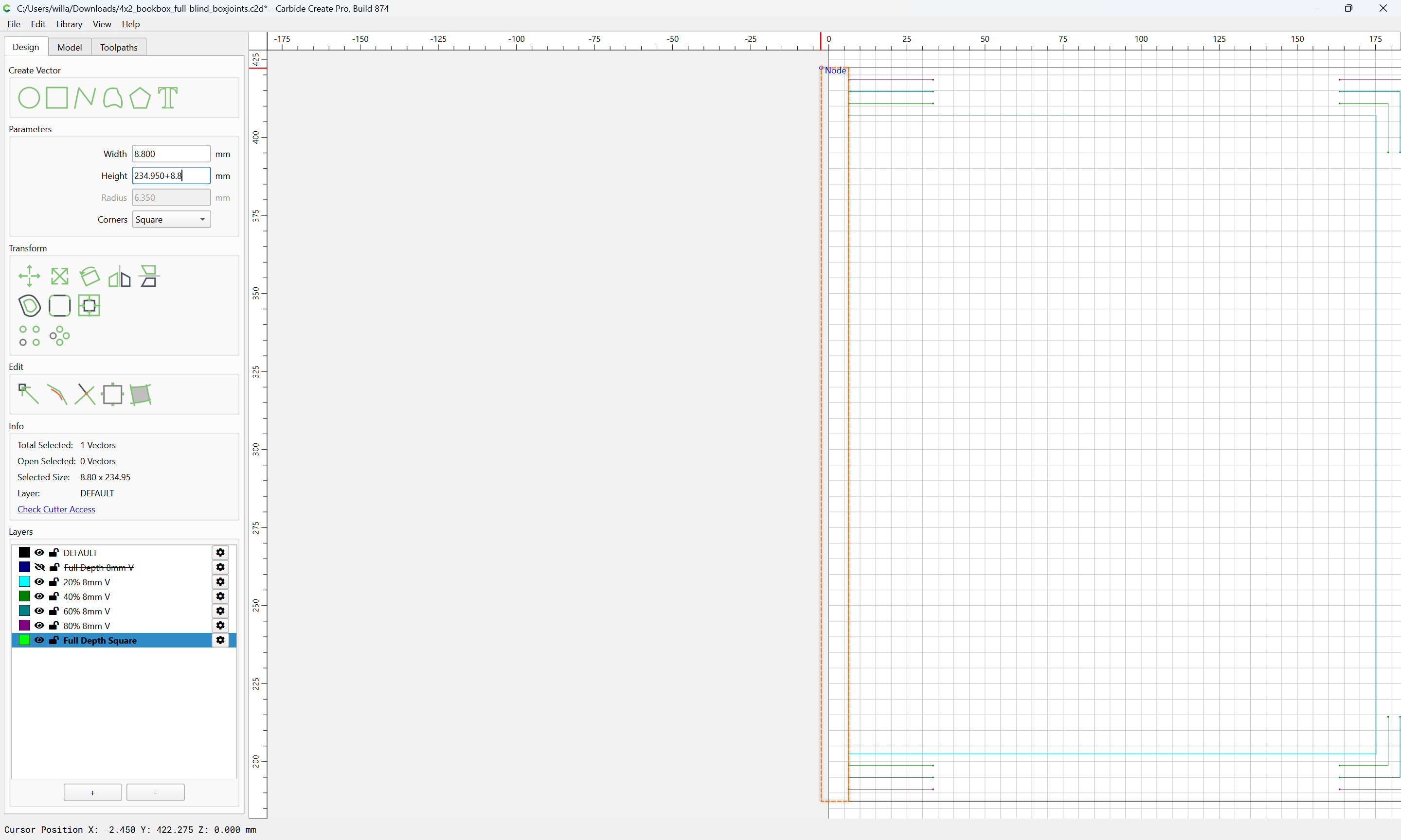

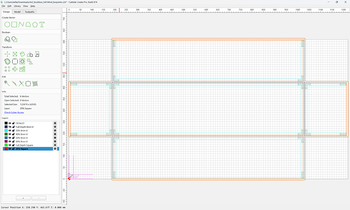

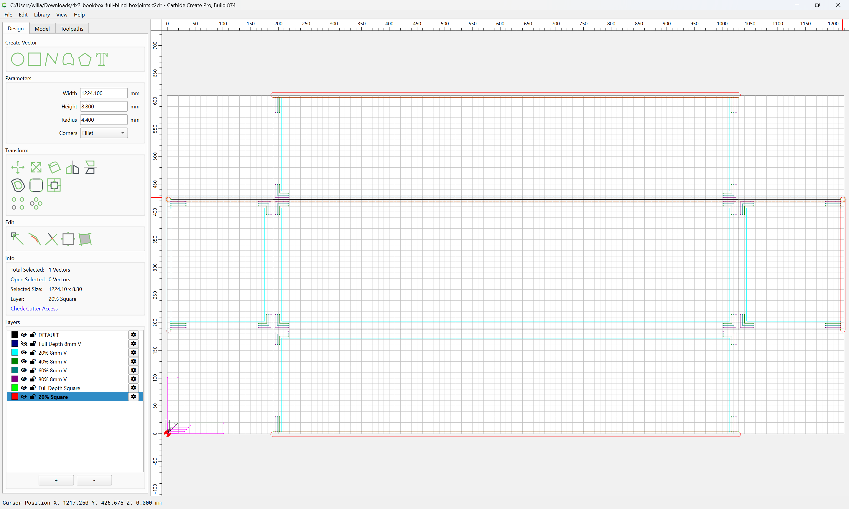

In order to make the shallow depth cut one will want outlines which describe the above Full Depth Square toolpaths which will need to be endmill diameter plus 10%:
and that much taller:
and radiused:
Place at each edge:
and fill in where the Full-Depth V cuts are made:

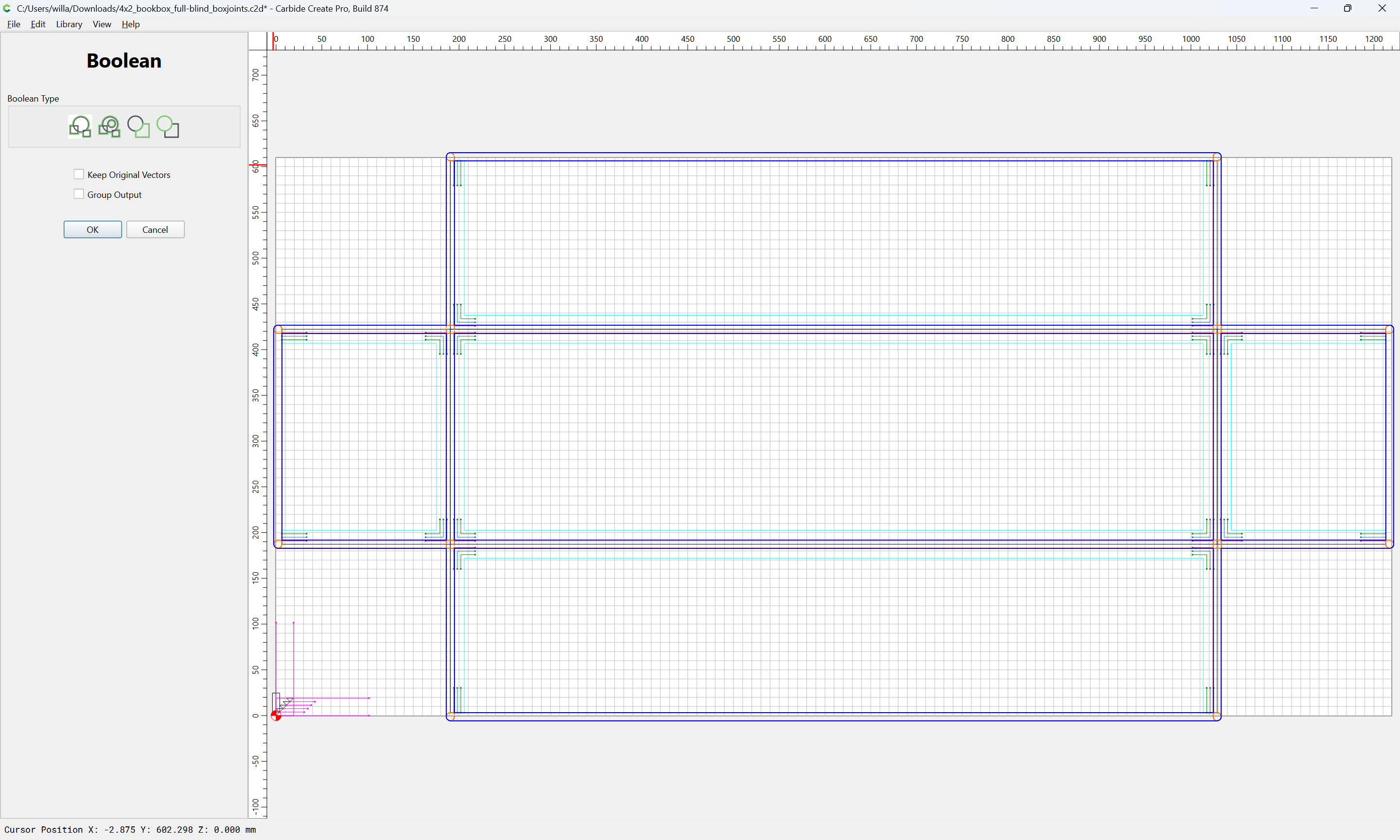

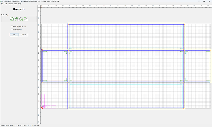

Then use Boolean Union:
OK
to create the desired outline on which we shift-click to remove it from the selection:
and then delete:

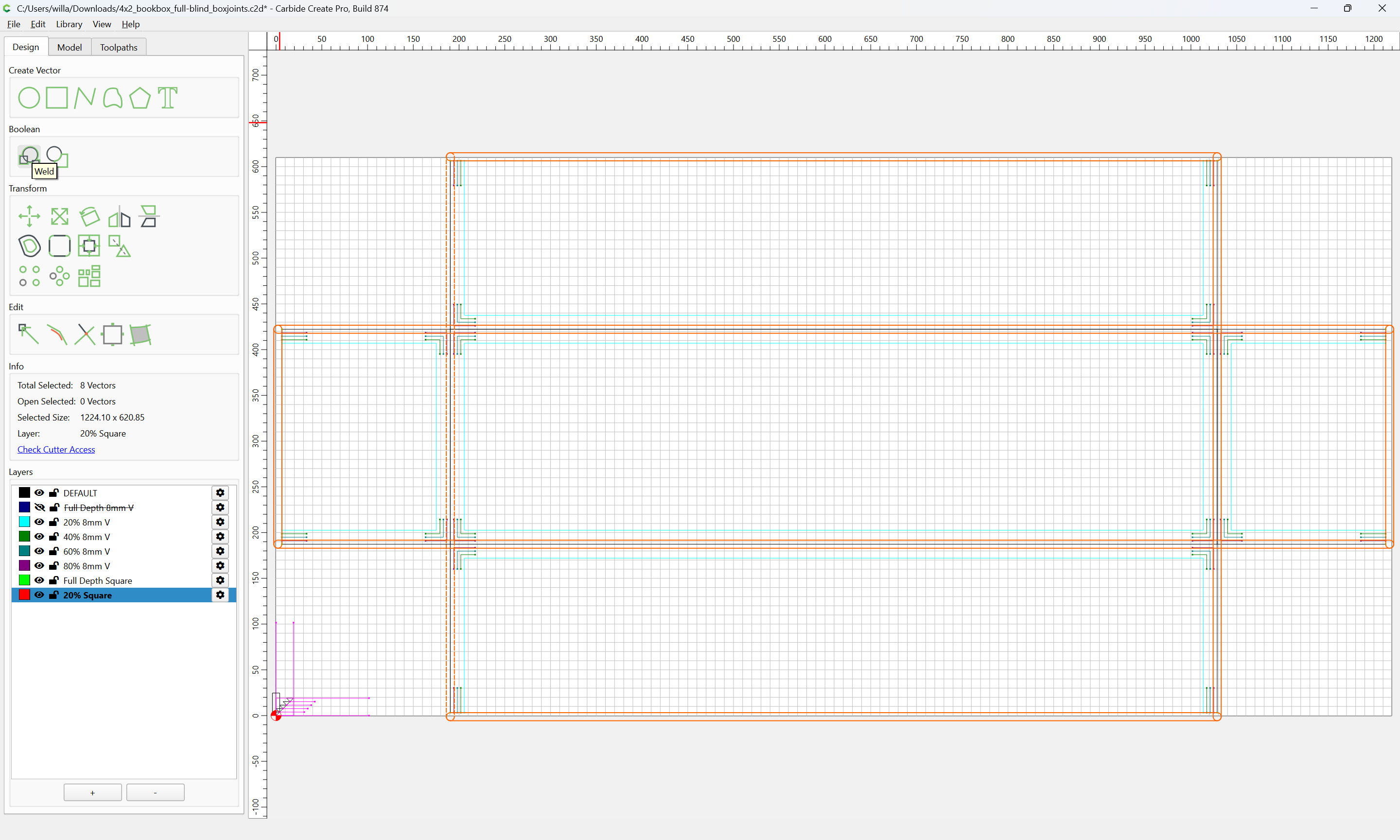

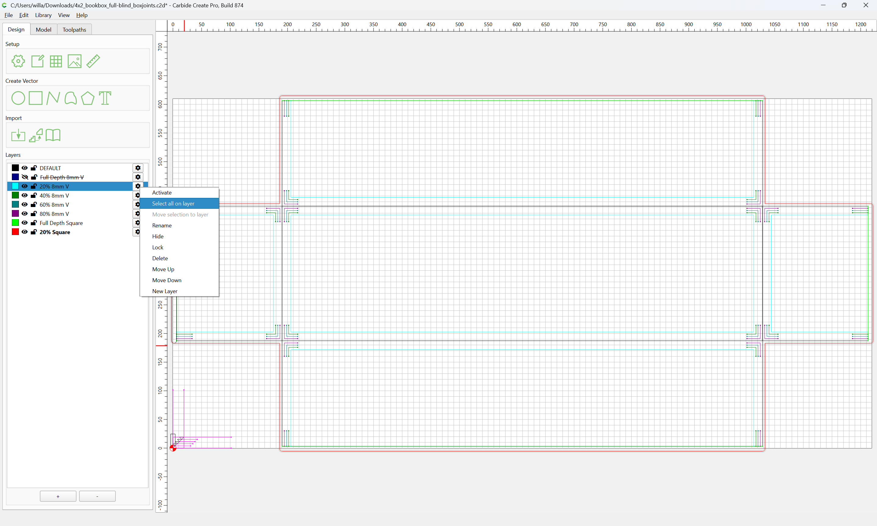

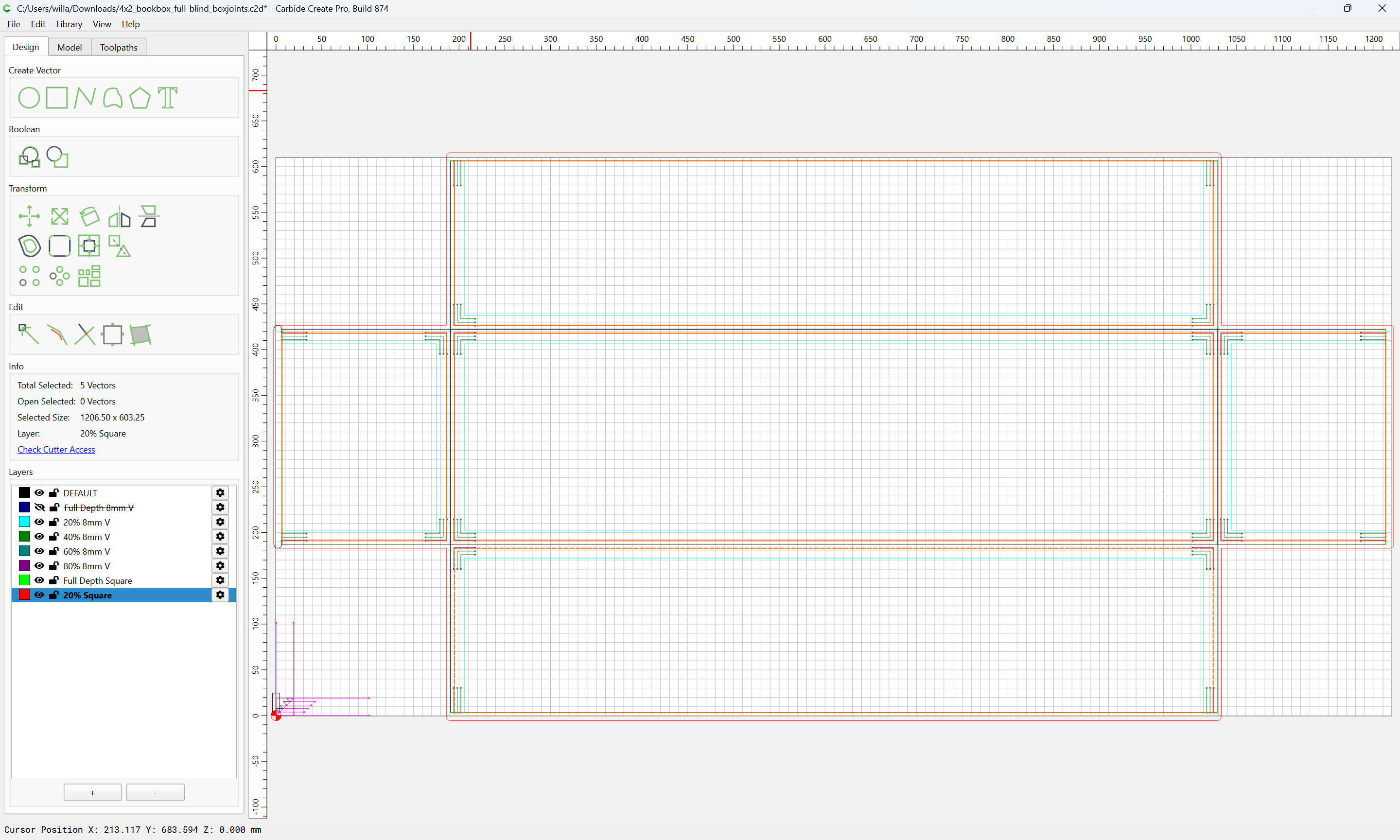

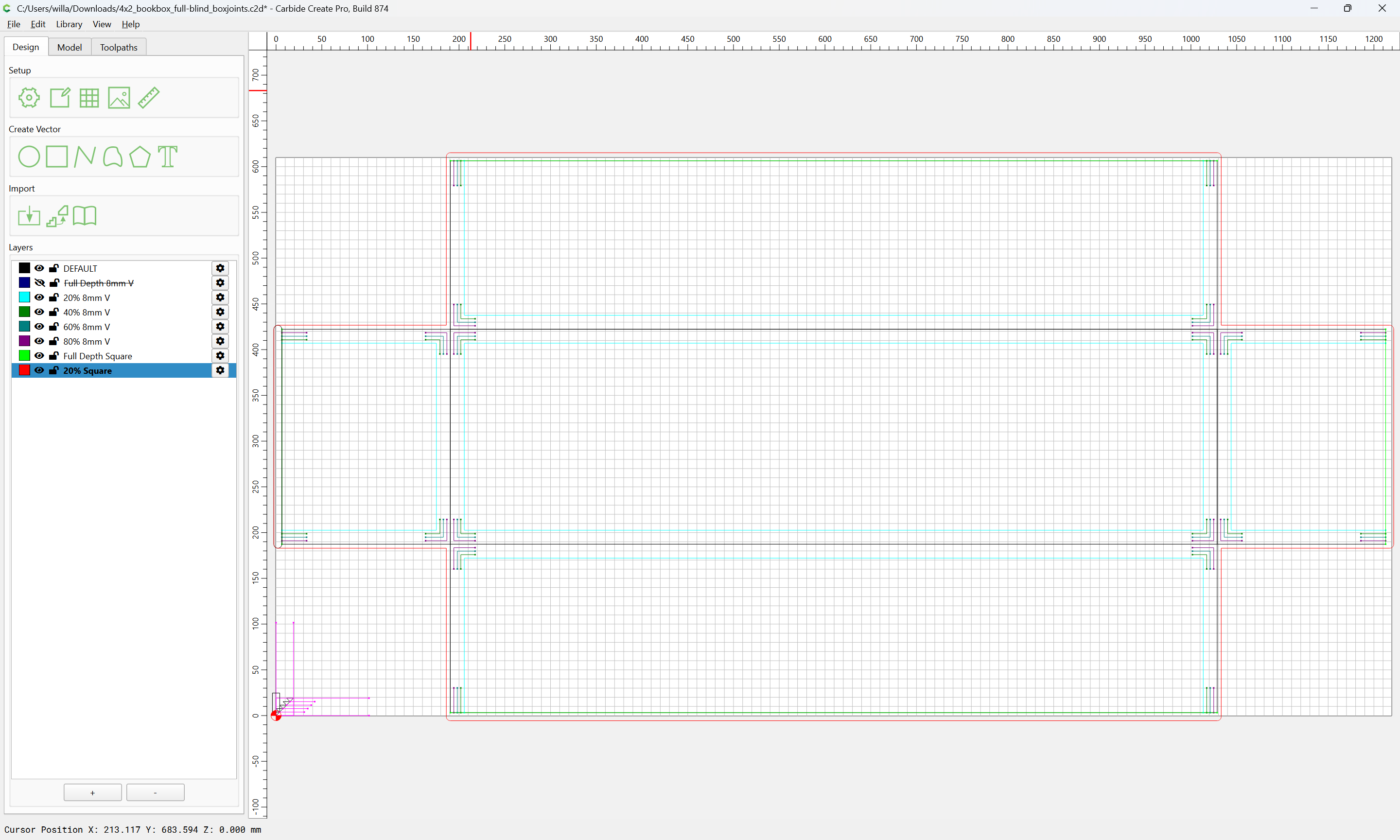

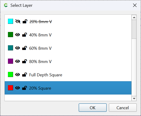

For the interior we will need the 20% V-tool geometry:
which we will copy and paste in place:
and to verify that this was successful, hide the 20% Square layer:
Then hide the 20% V layer:
then show the 20% Square layer:
Select each open region:
and use Join Vectors to close:
Yes
Repeating until we arrive at:

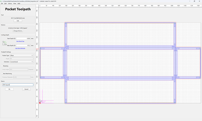

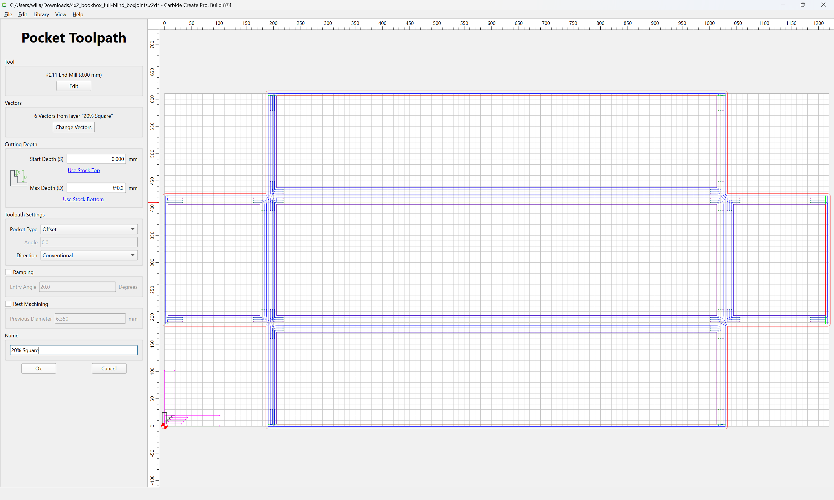

Assign a Pocket toolpath:
which previews as:

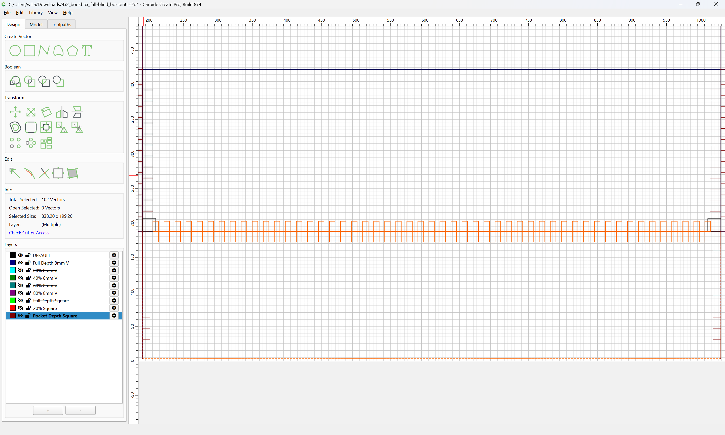

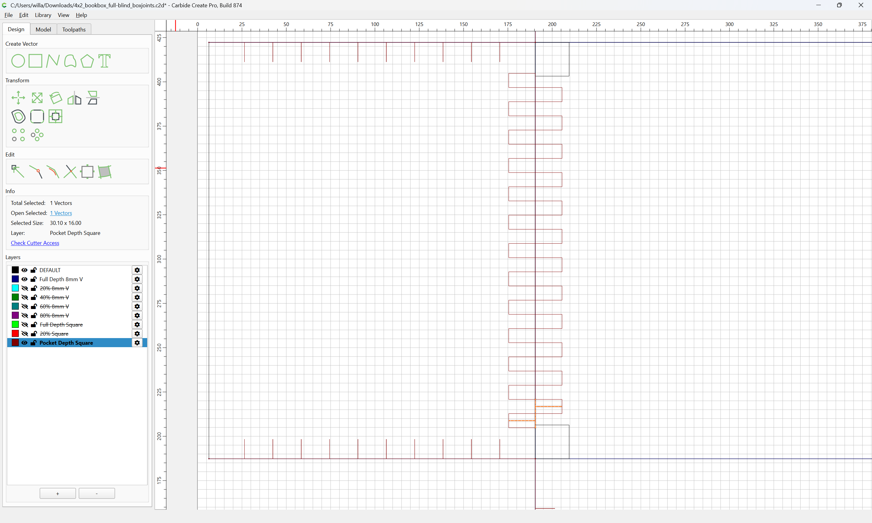

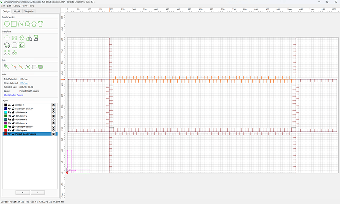

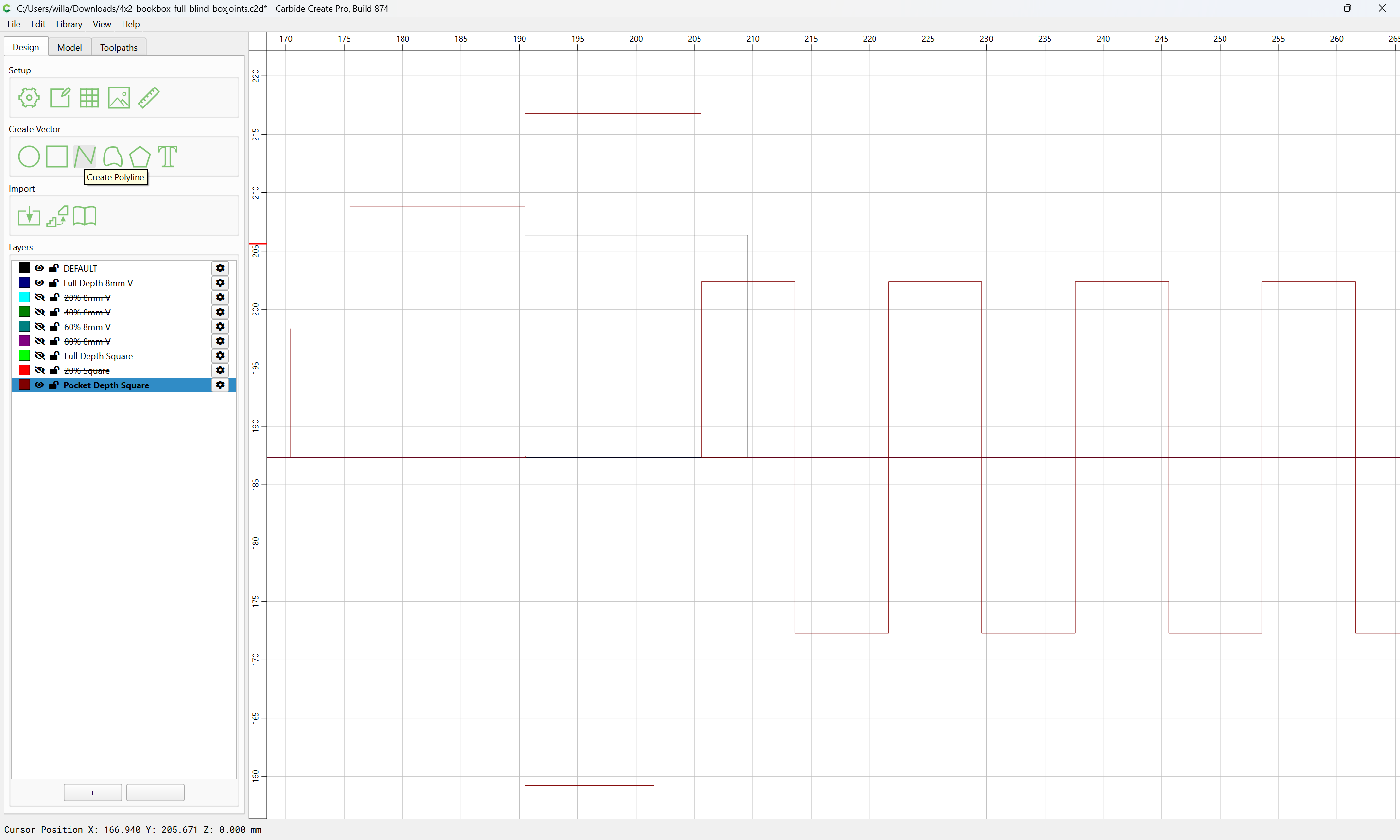

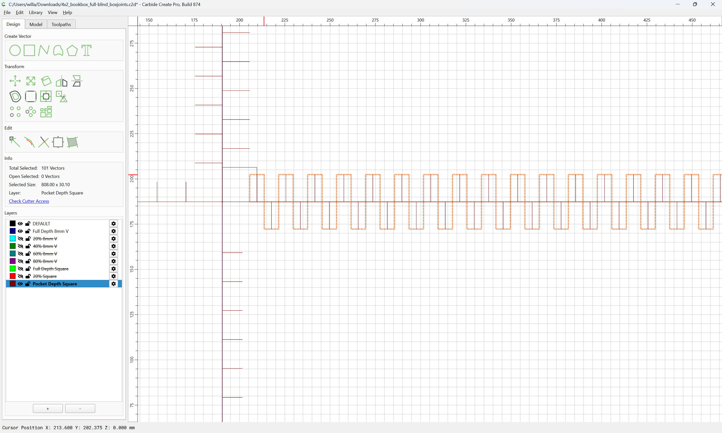

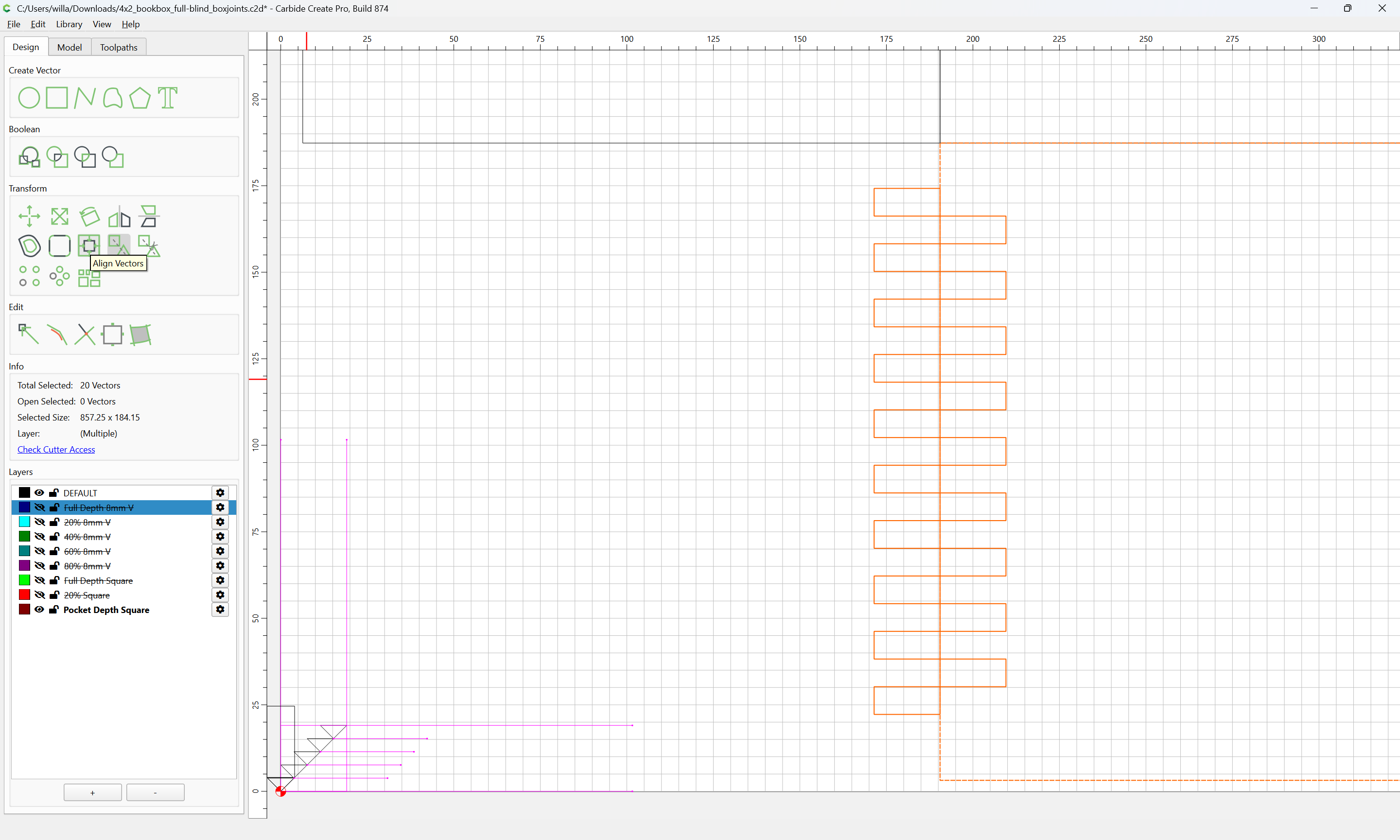

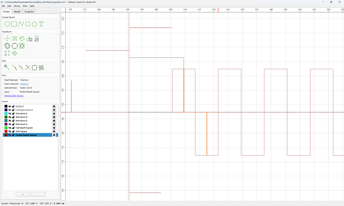

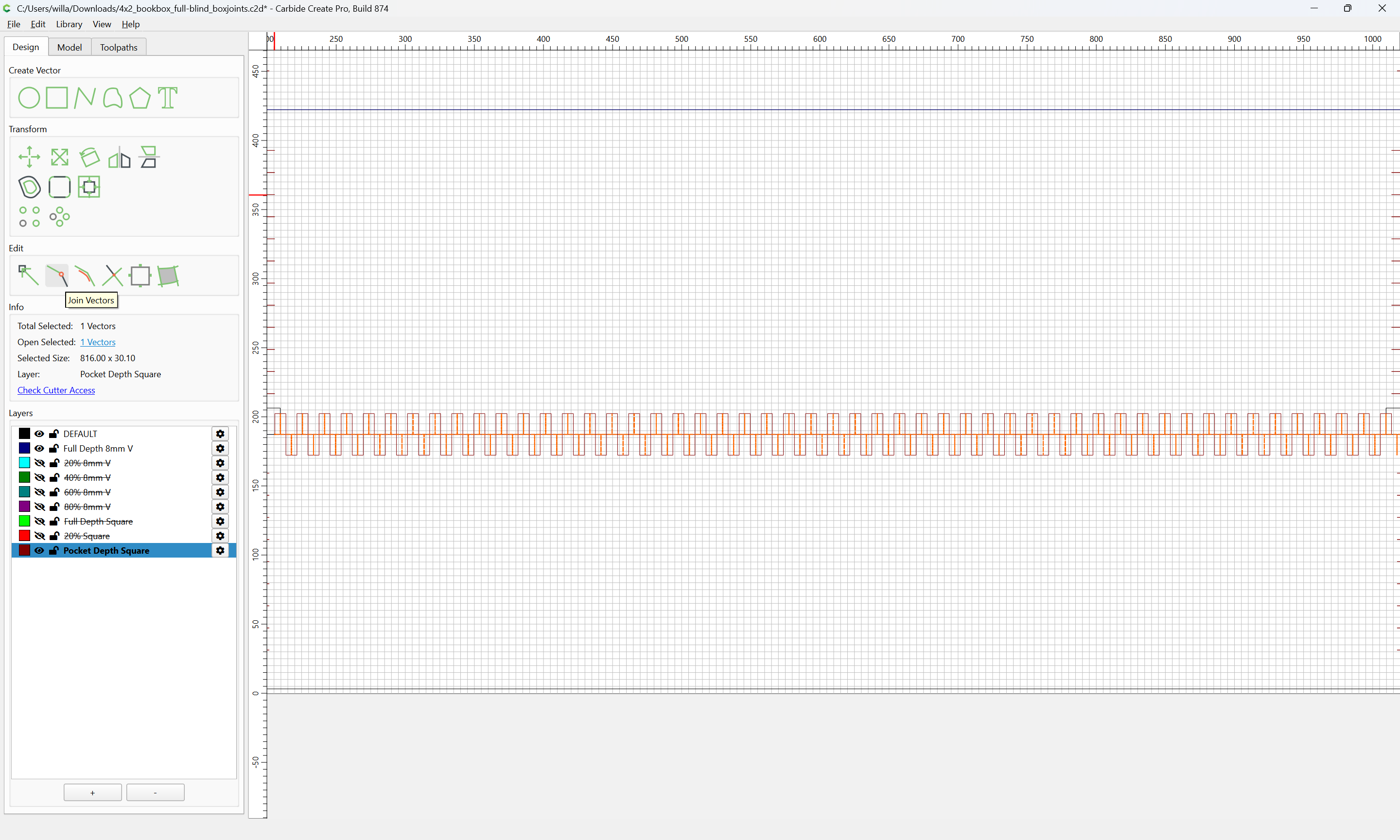

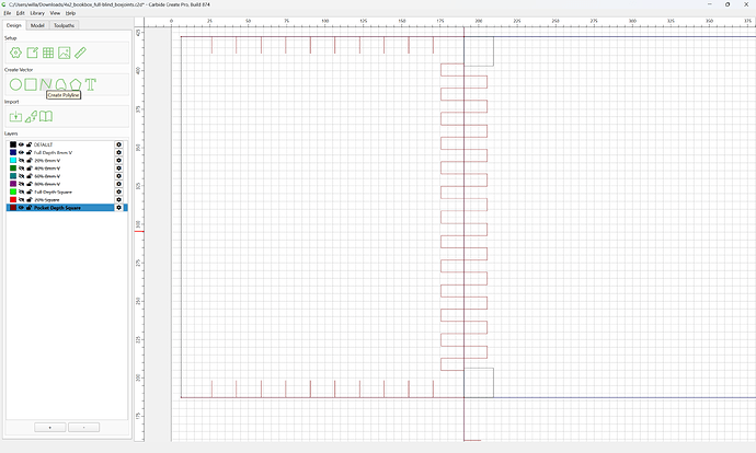

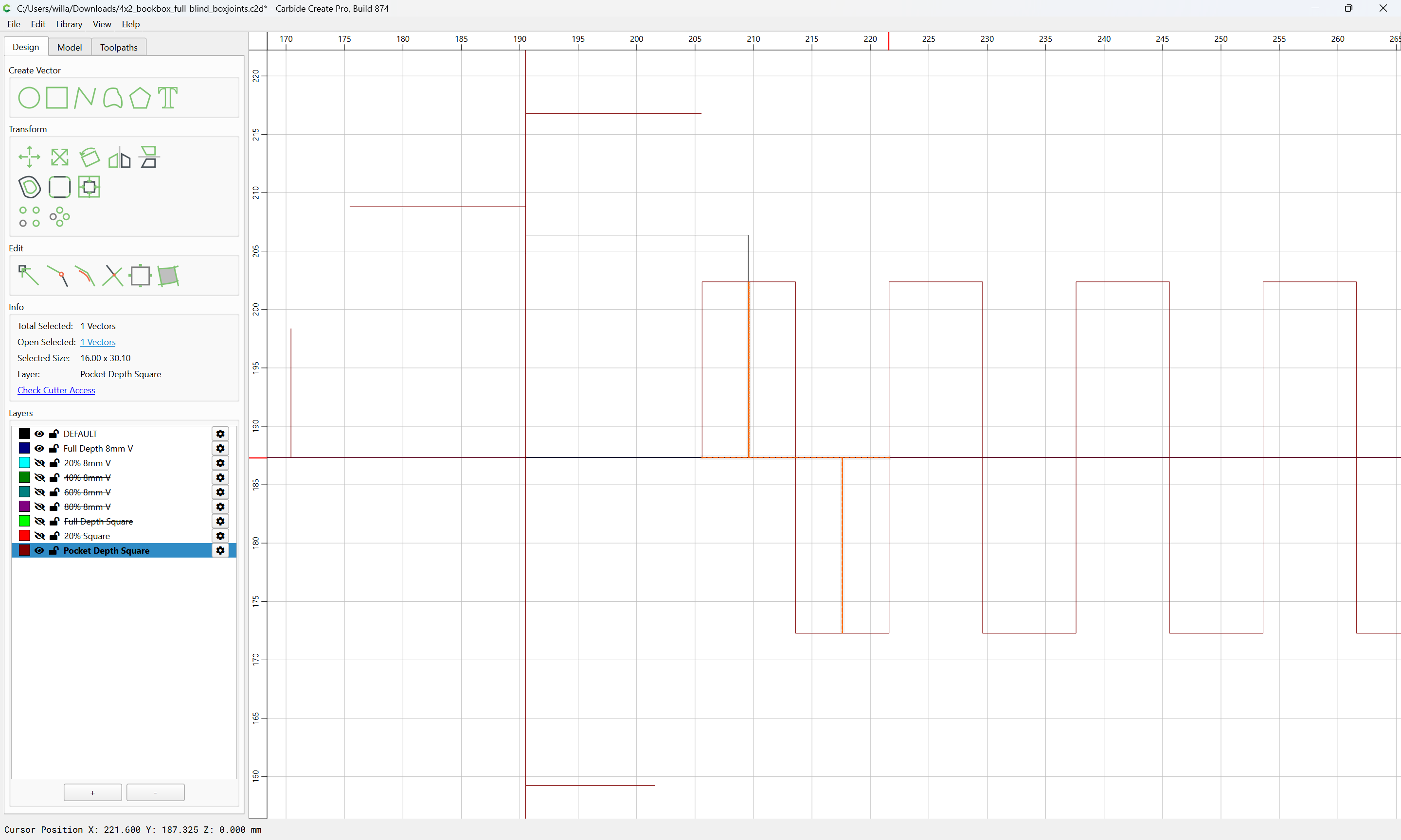

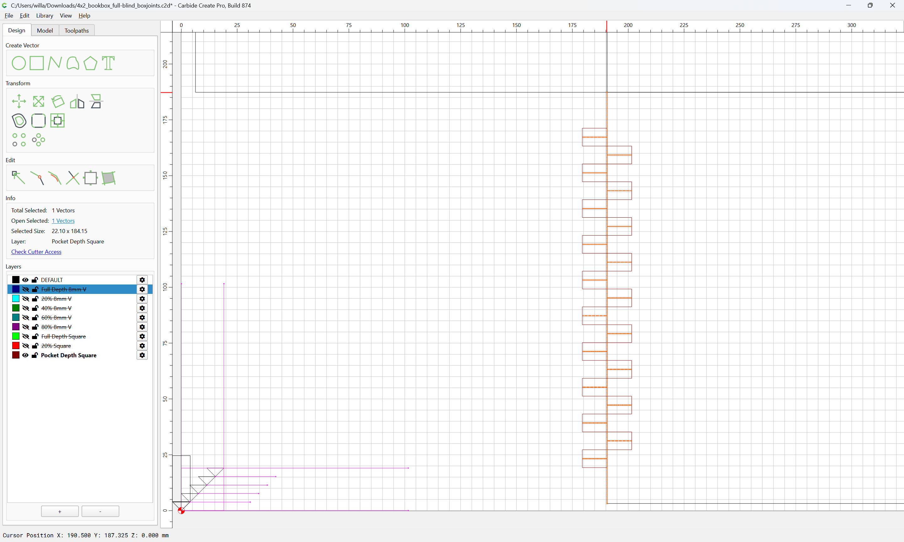

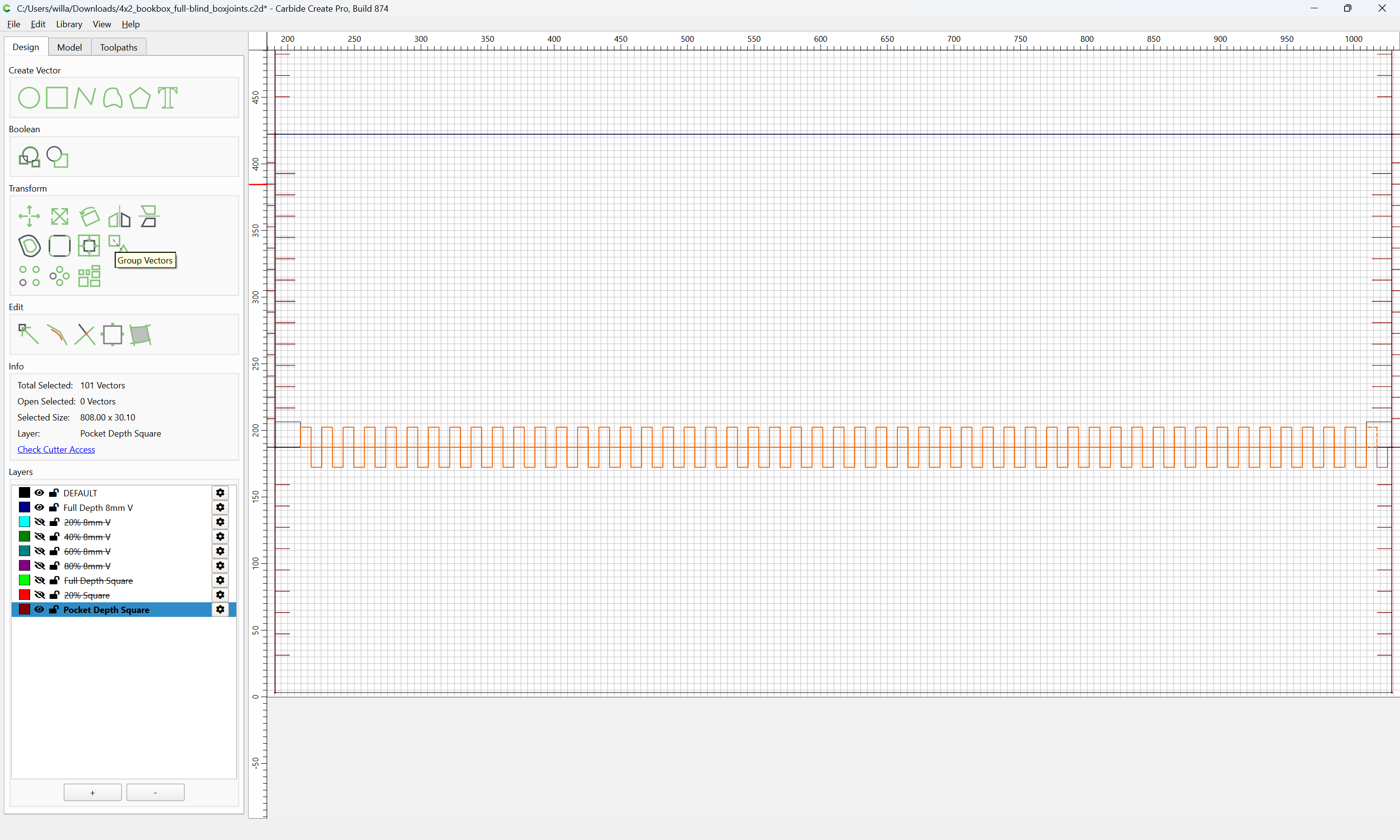

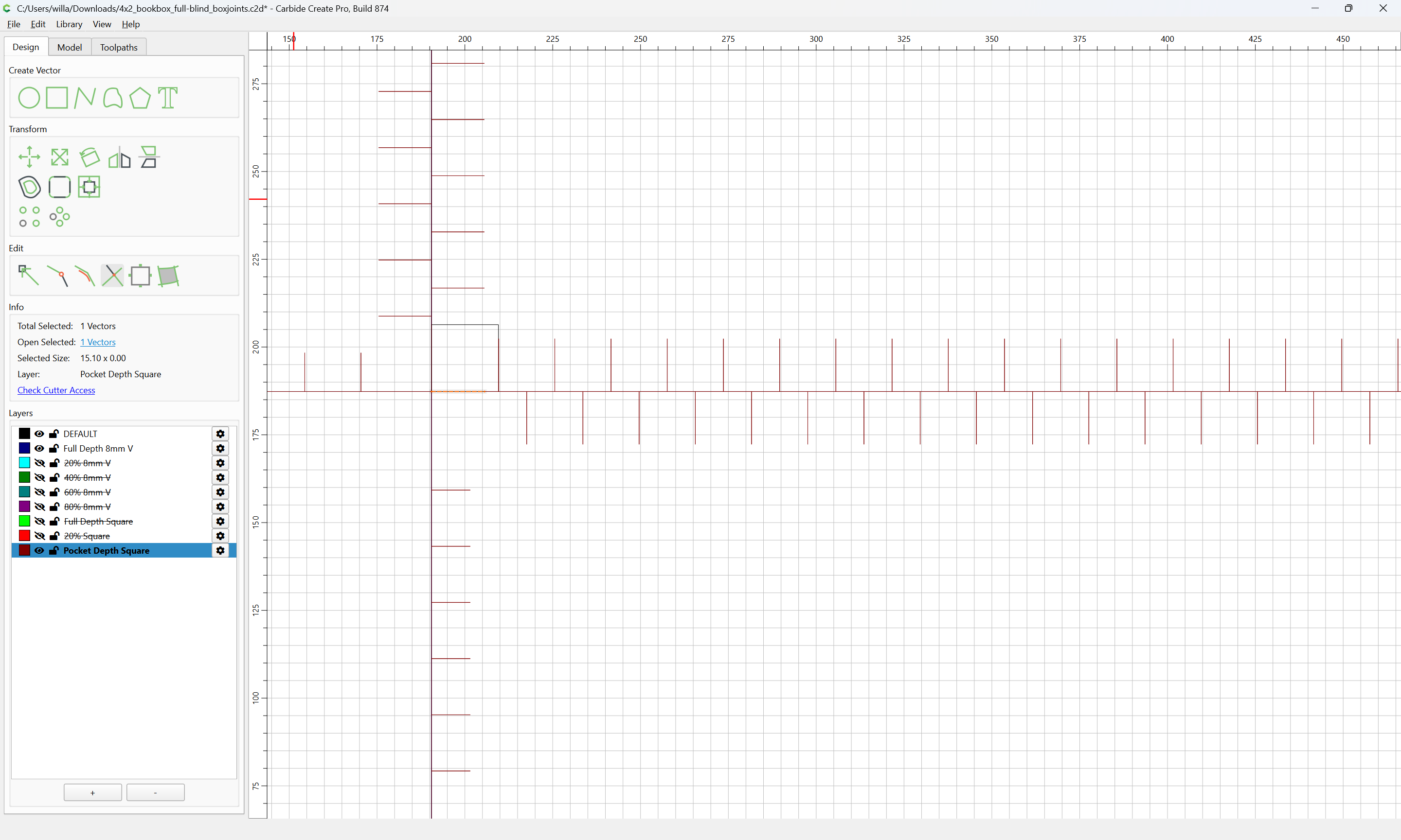

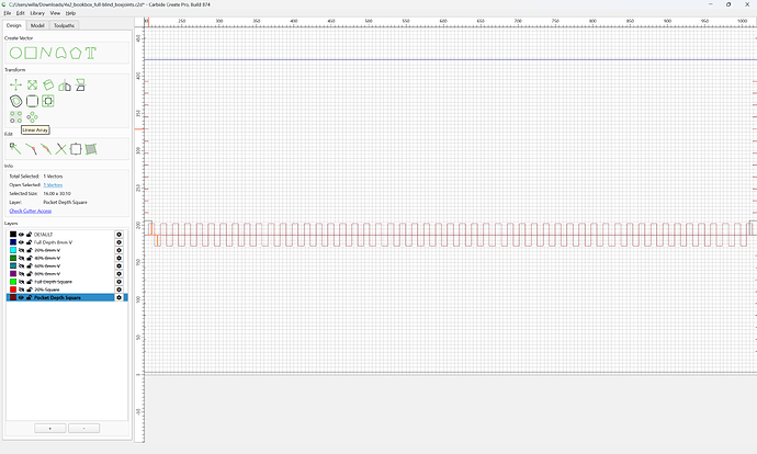

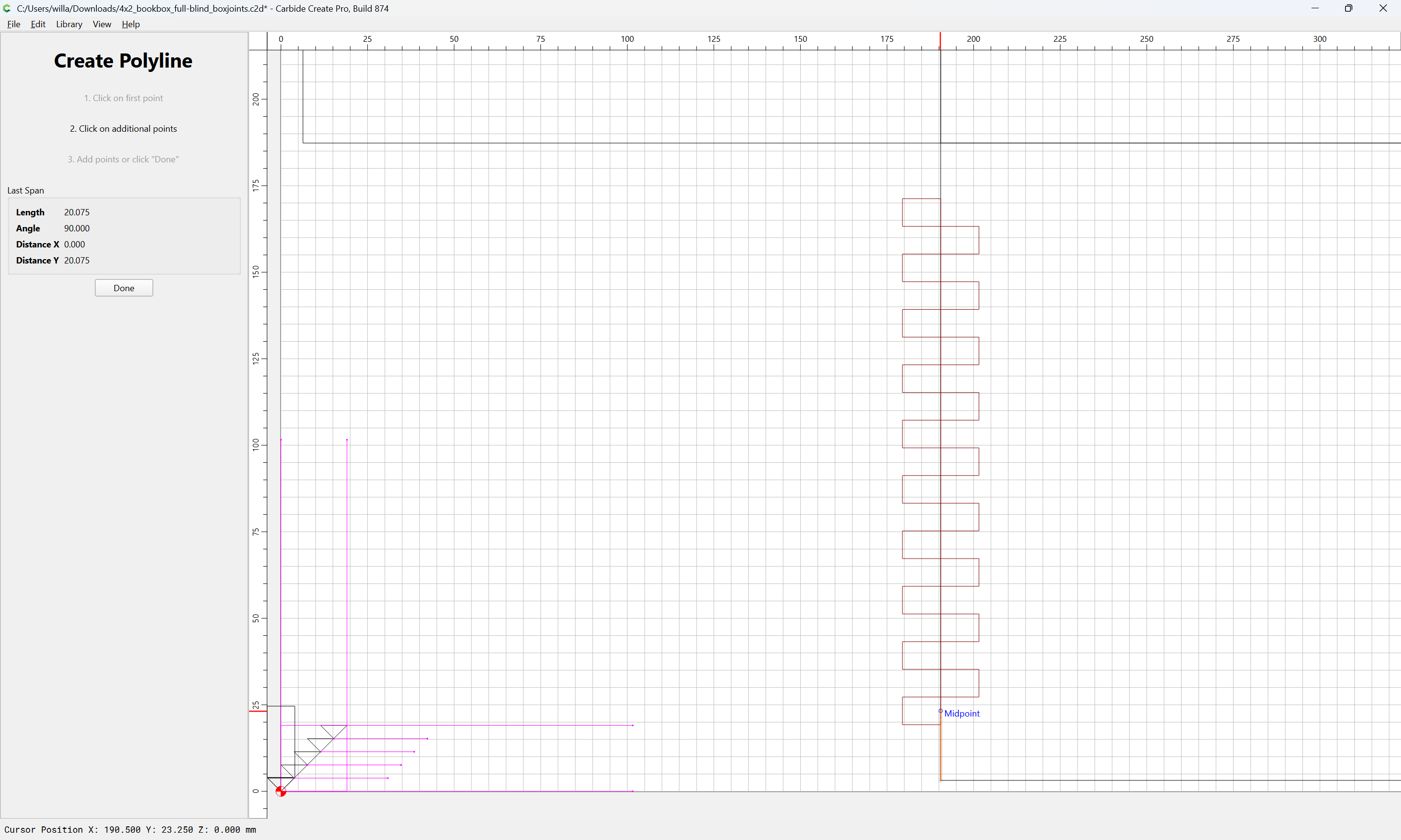

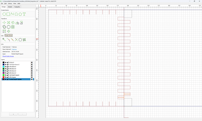

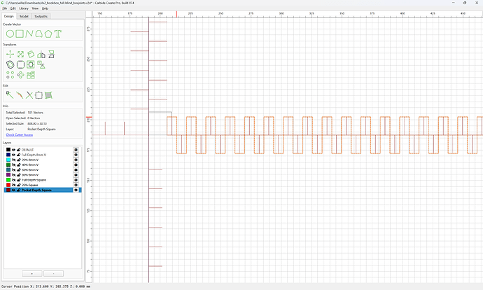

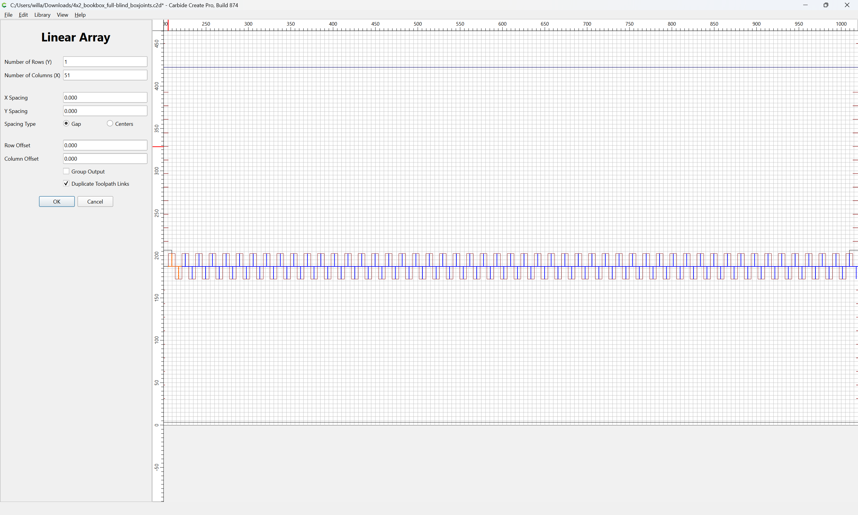

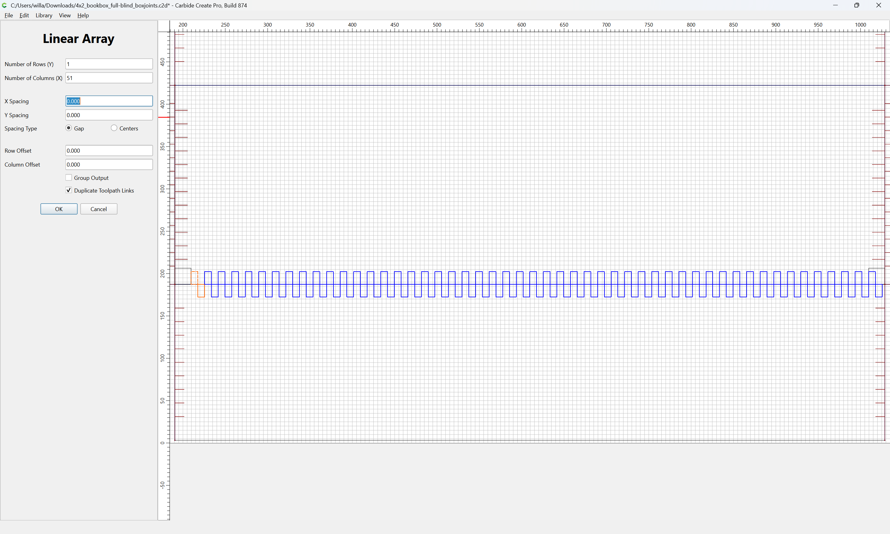

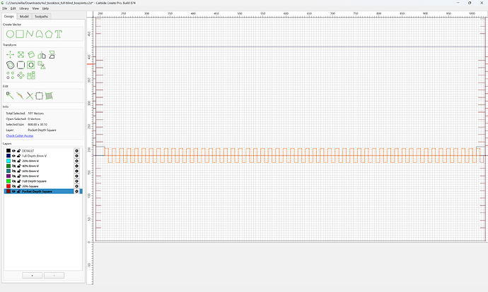

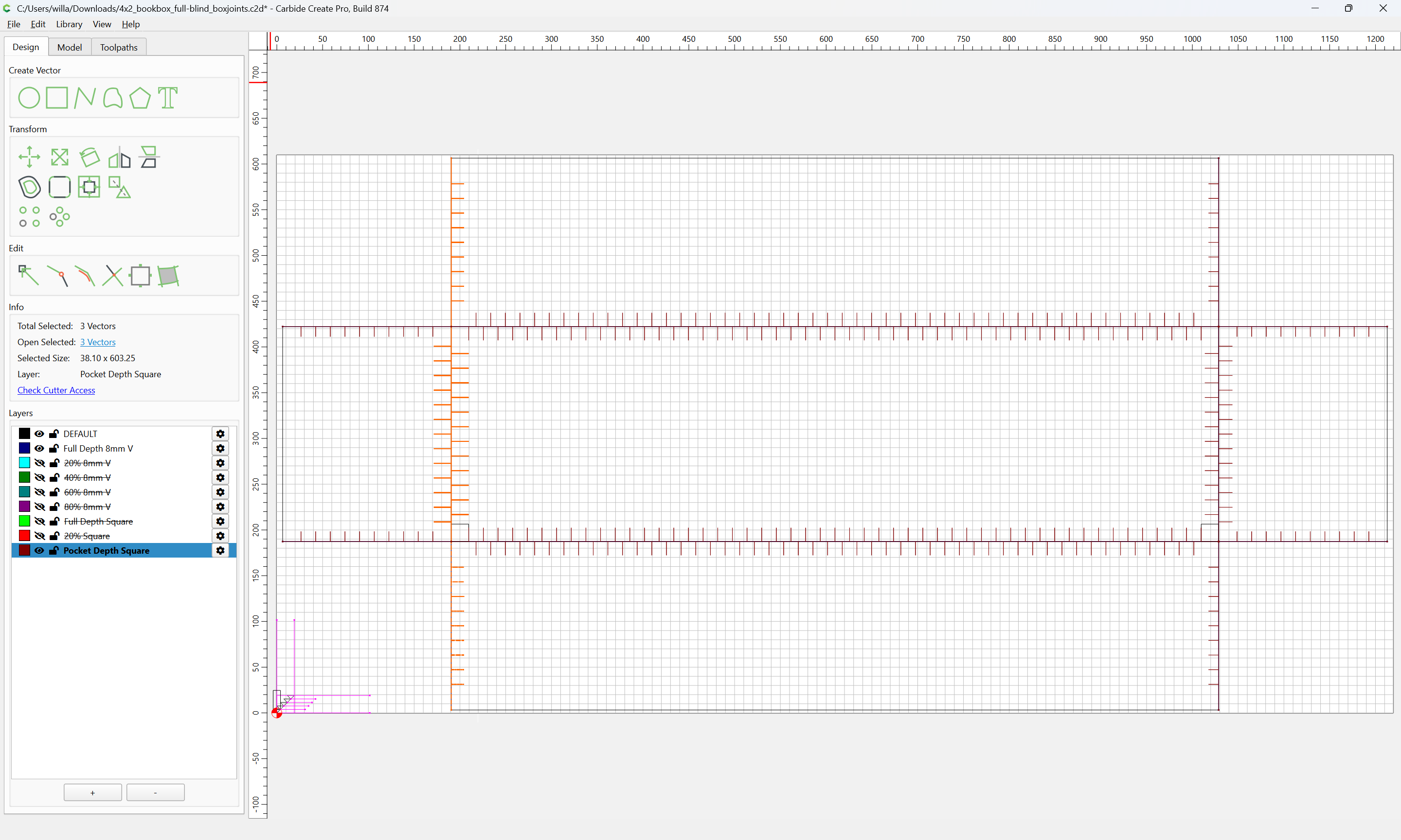

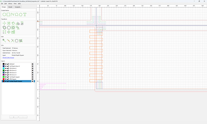

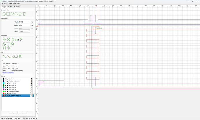

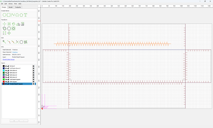

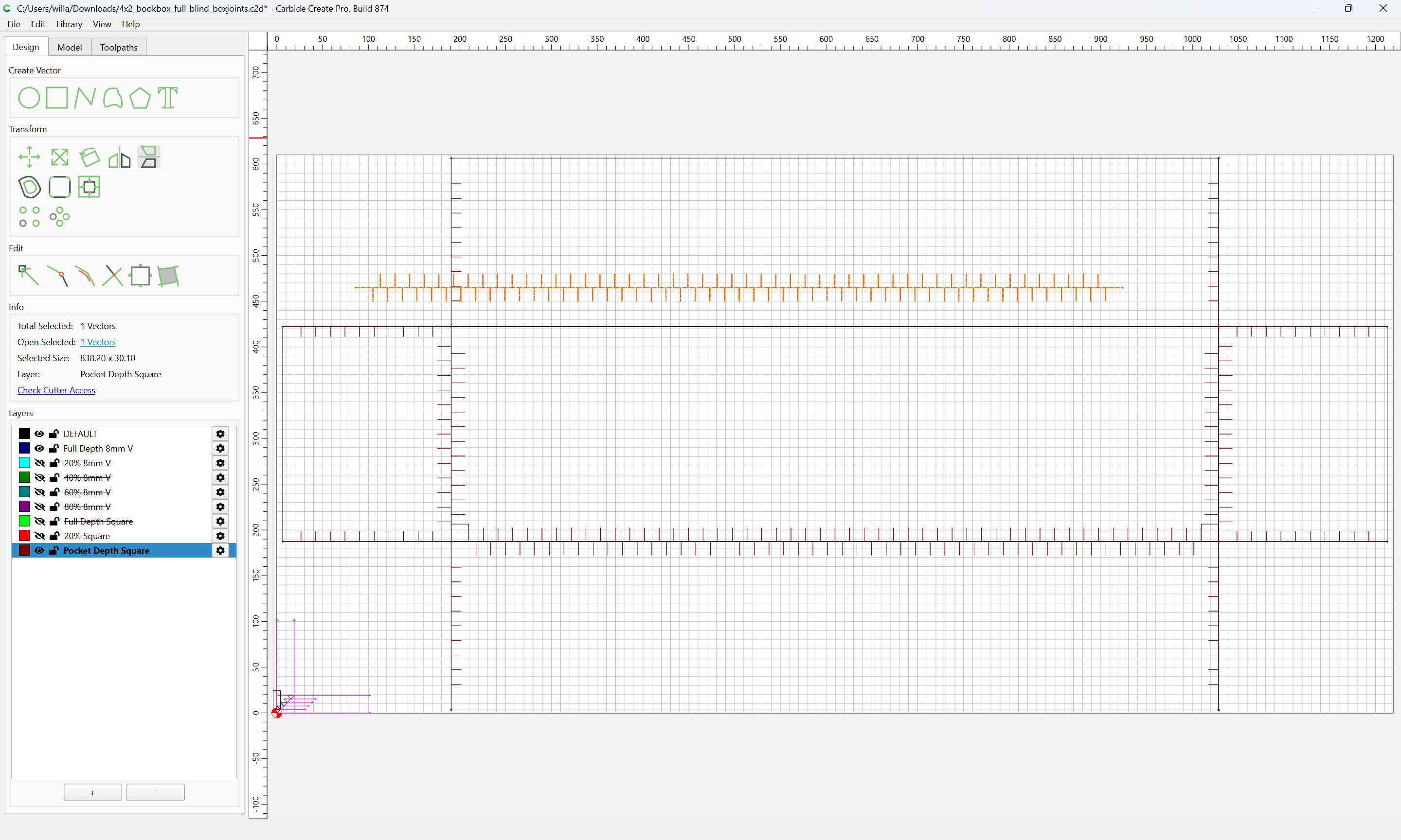

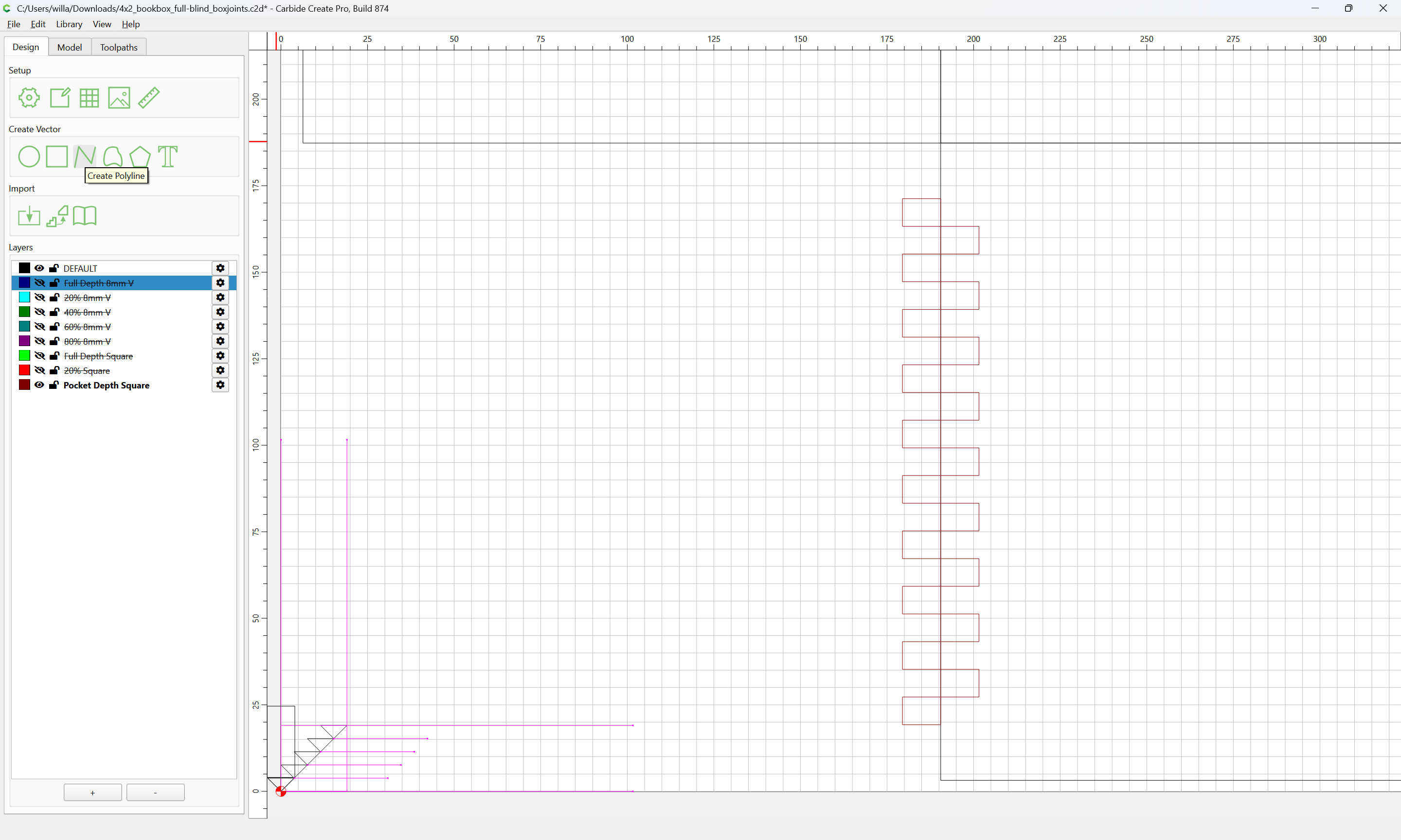

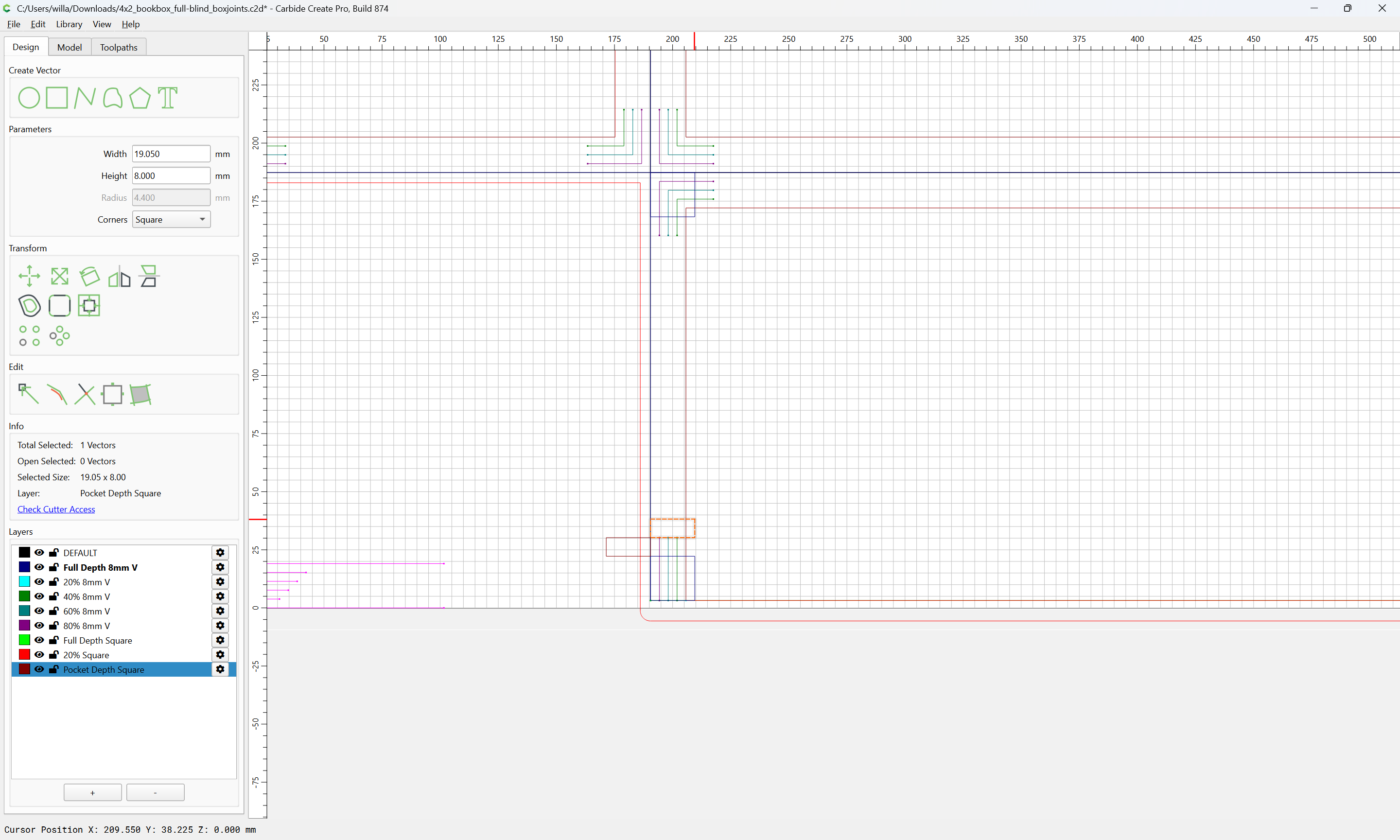

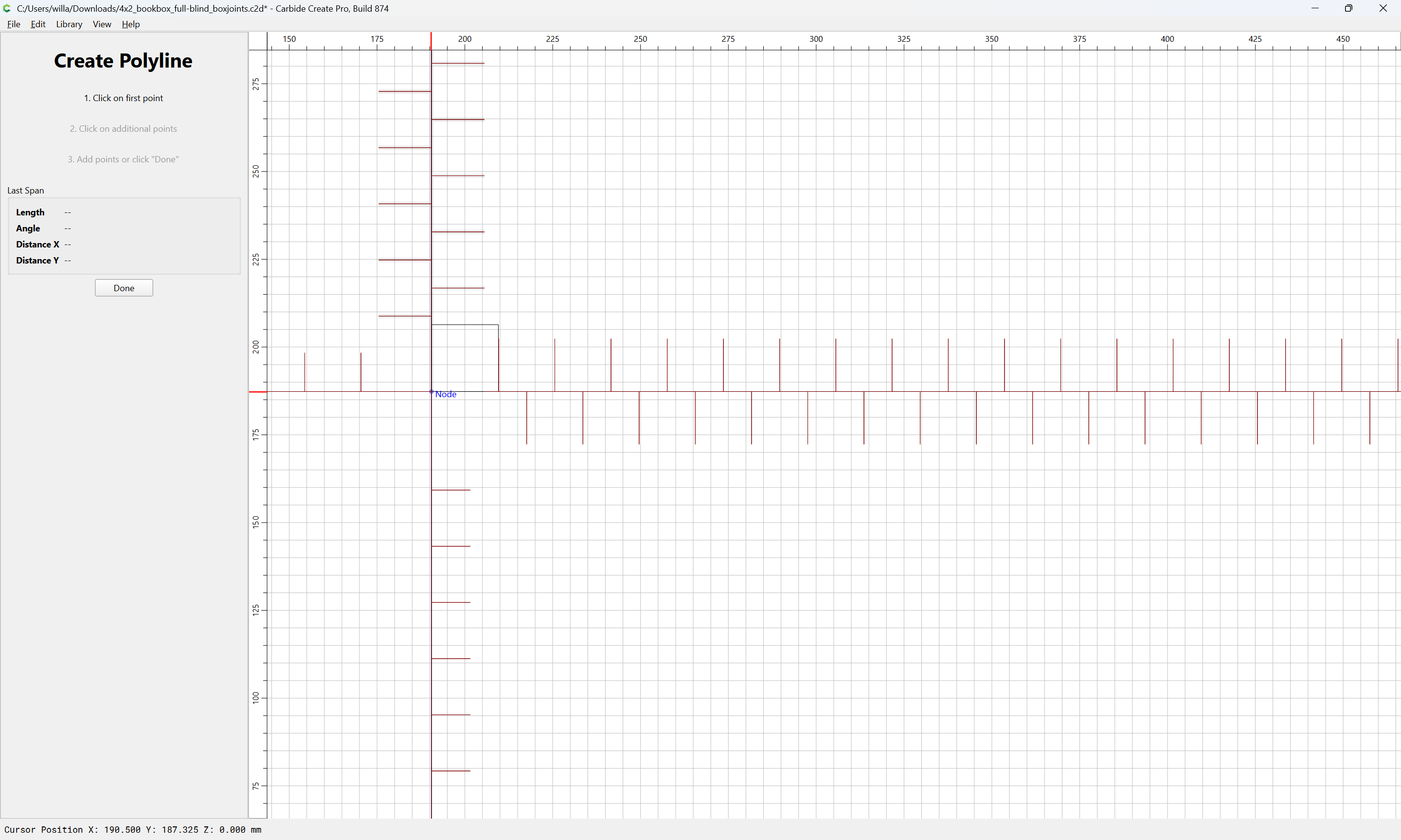

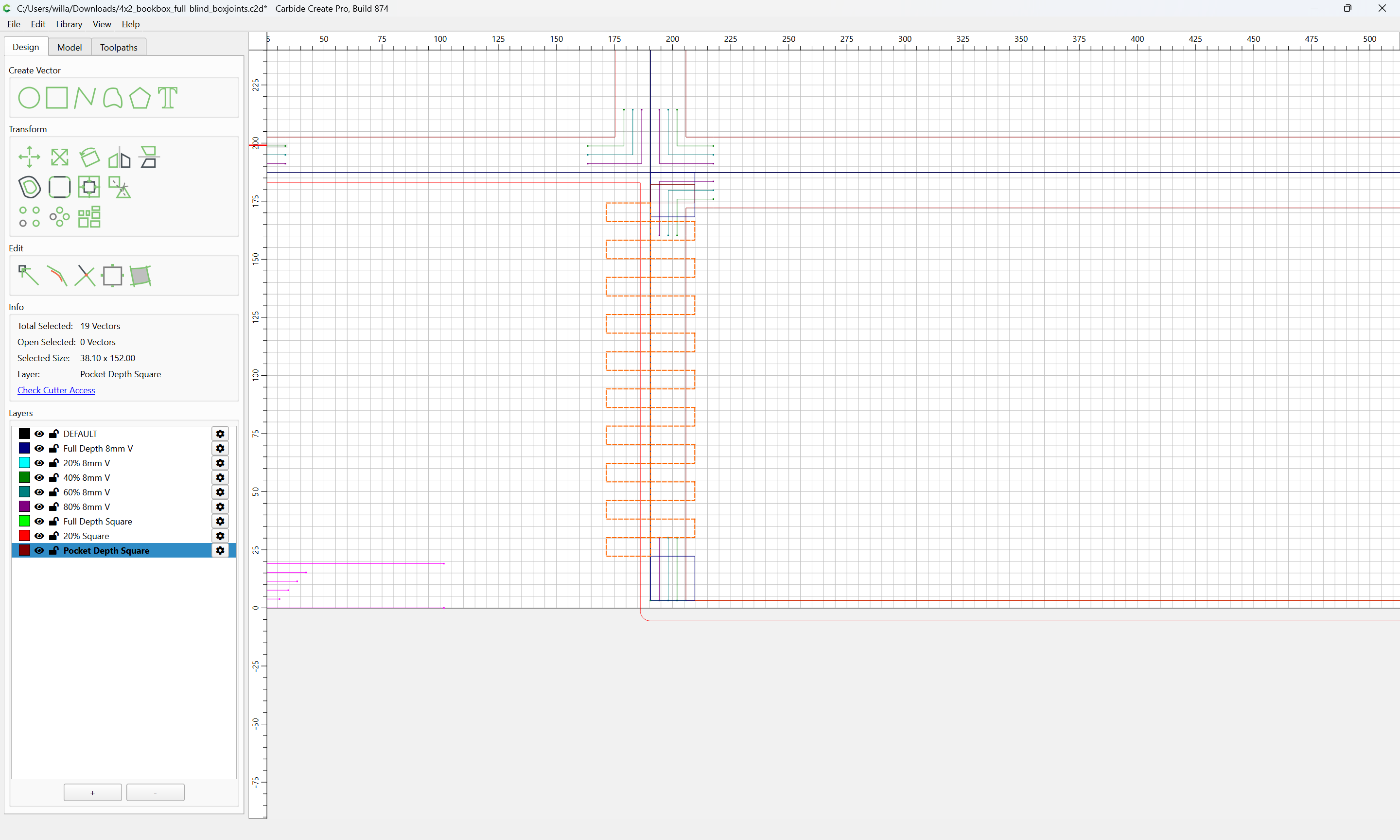

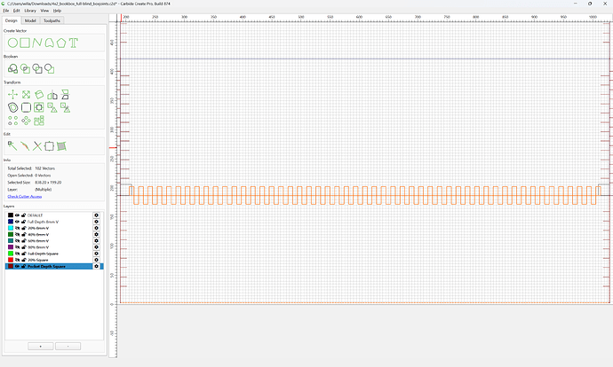

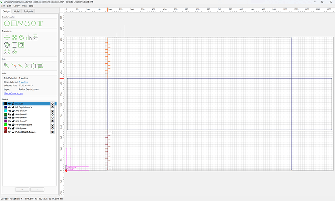

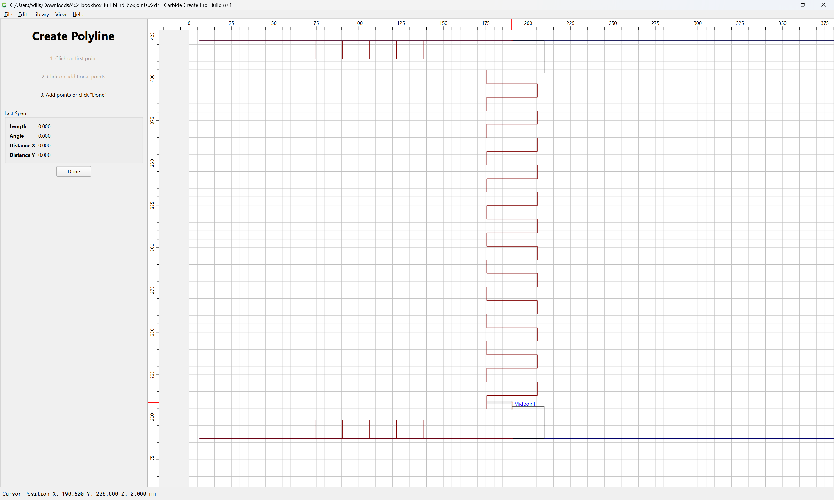

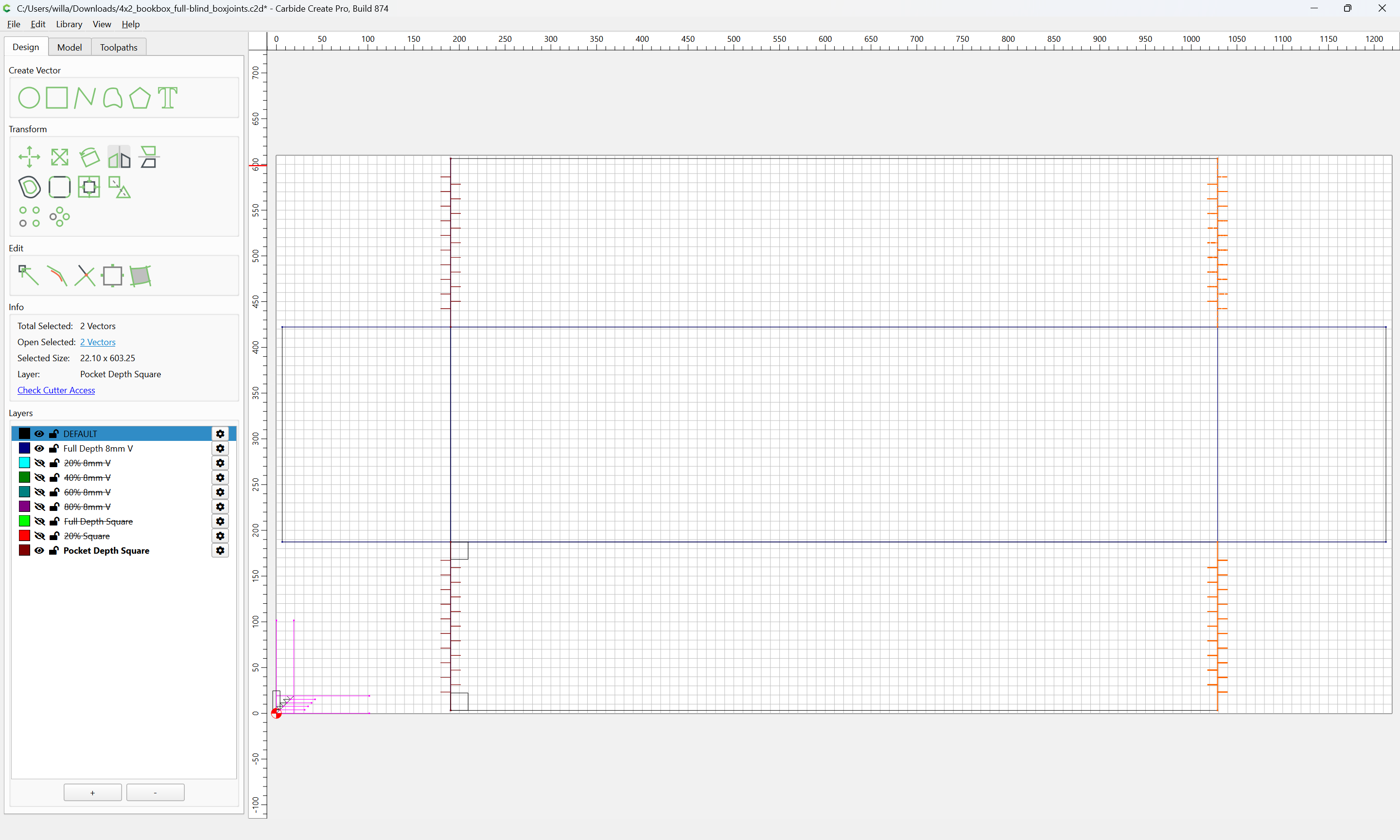

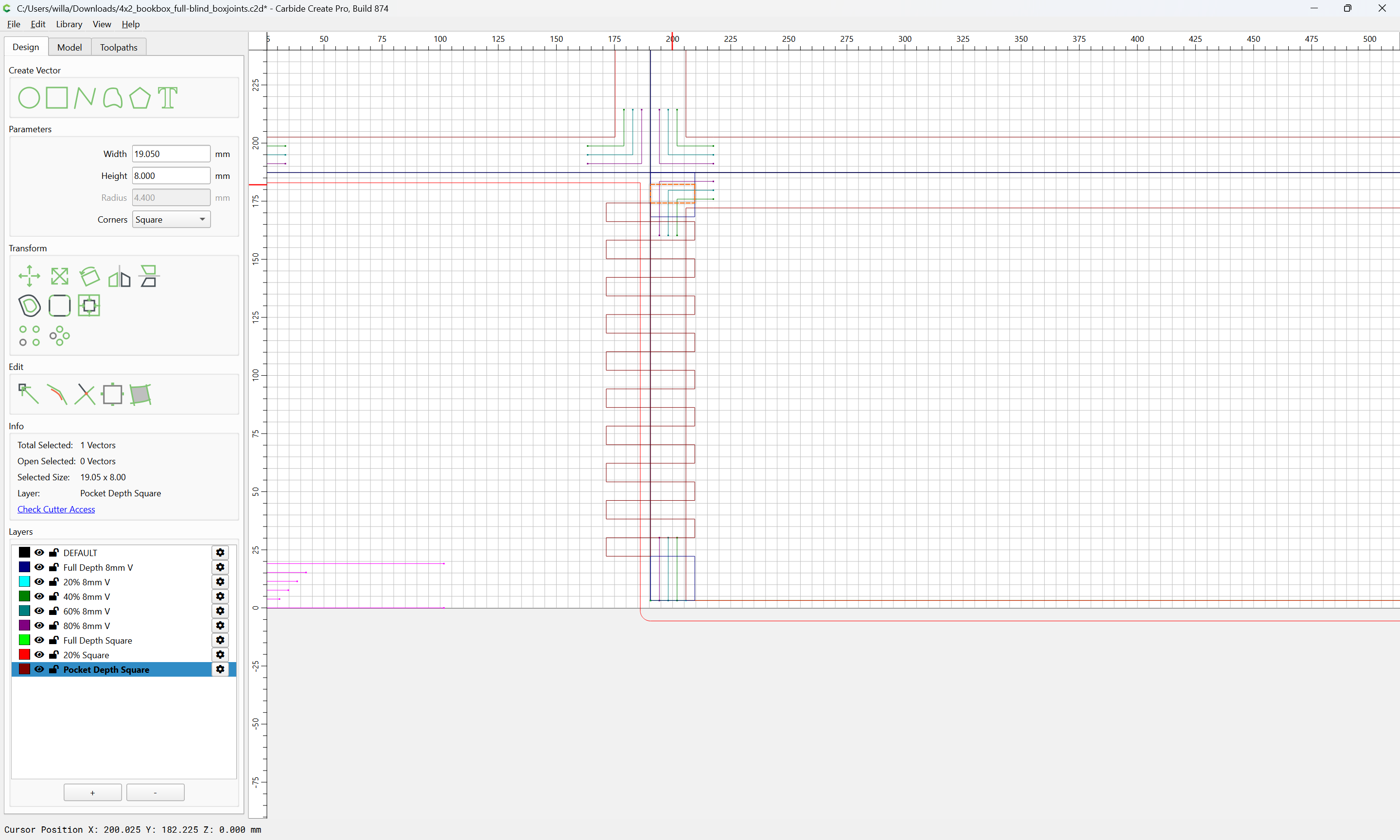

Lastly we draw in the geometry for cutting the box joints/recesses for same.
At each corner there will be a Stock Thickness square area which is described by the miter:

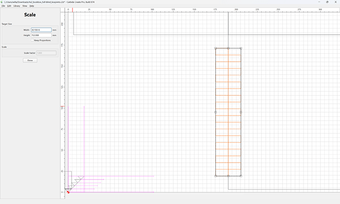

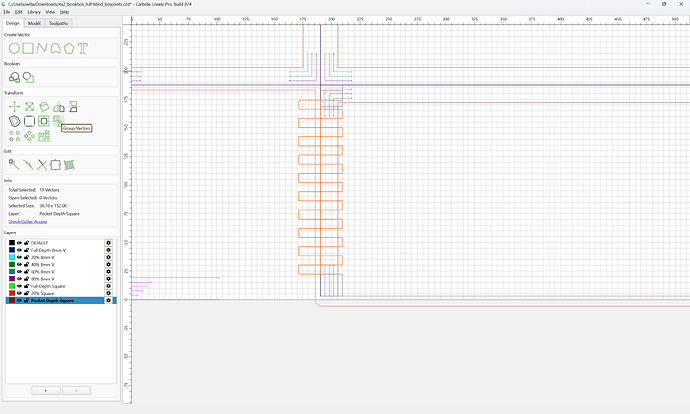

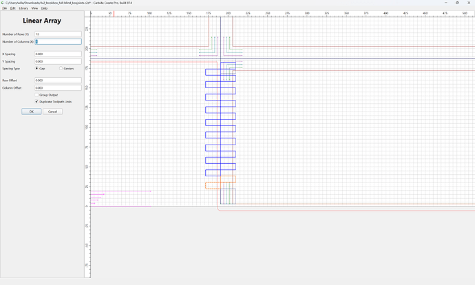

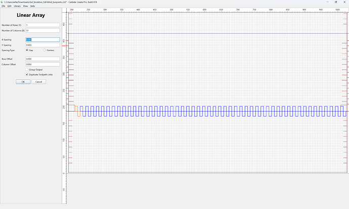

In-between those two squares it will be necessary to cut a pair of alternating regions which are best described as a series of rectangles which are Stock Thickness wide (across the joint) and endmill diameter tall (along the axis of the joint):

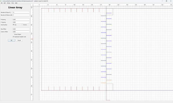

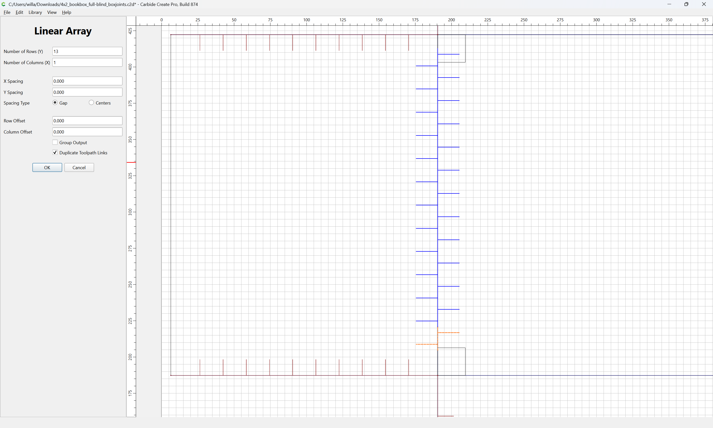

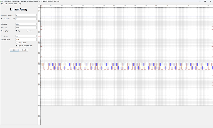

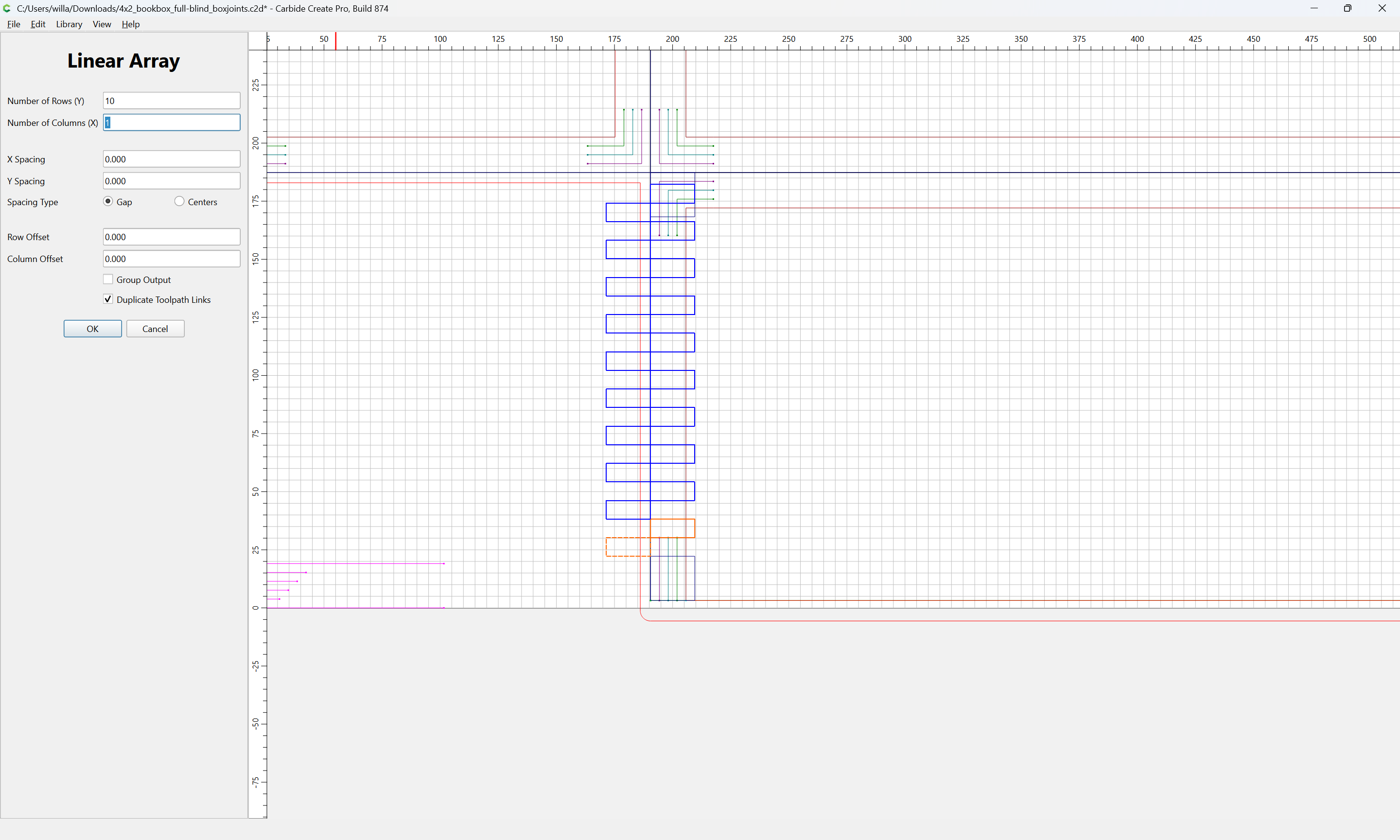

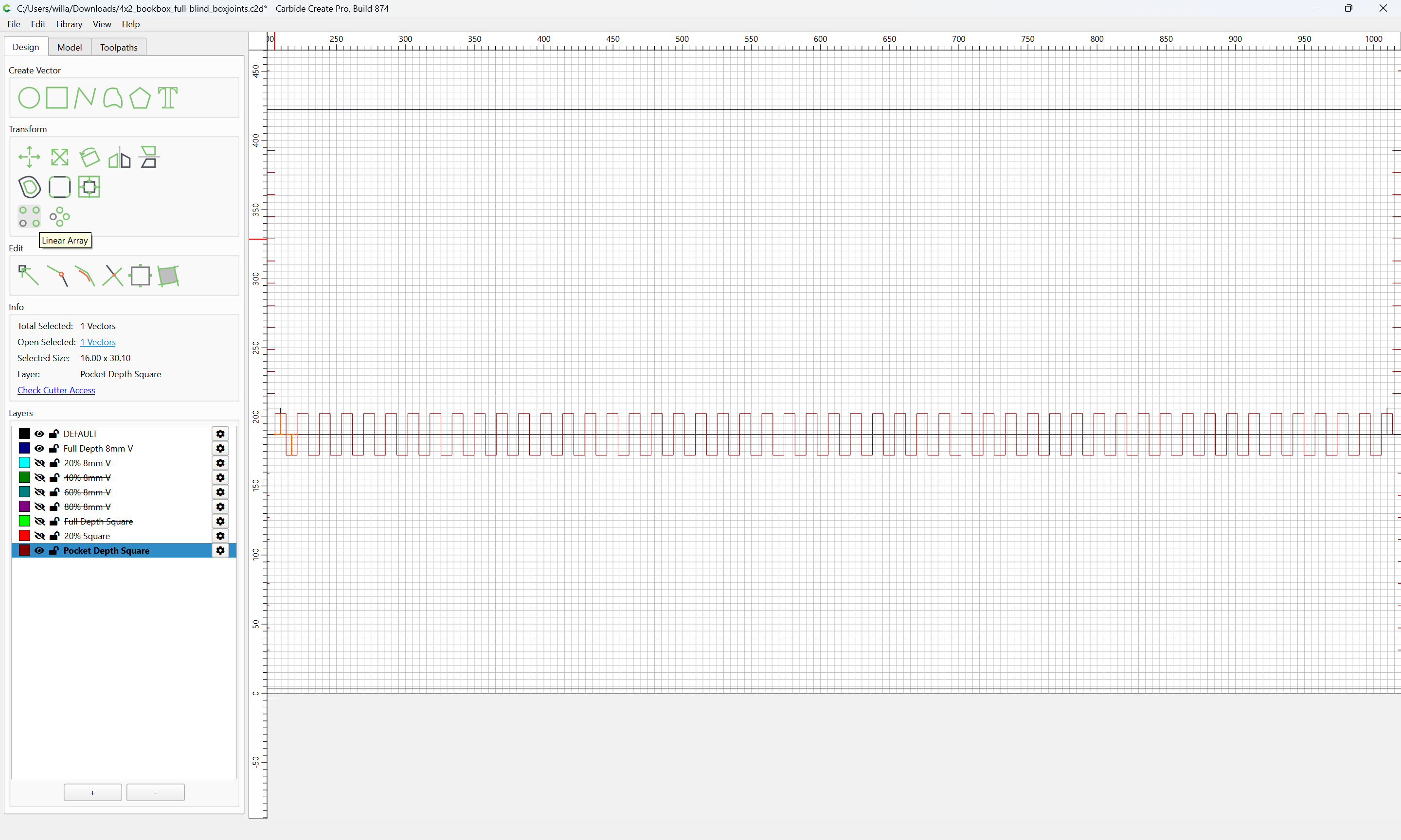

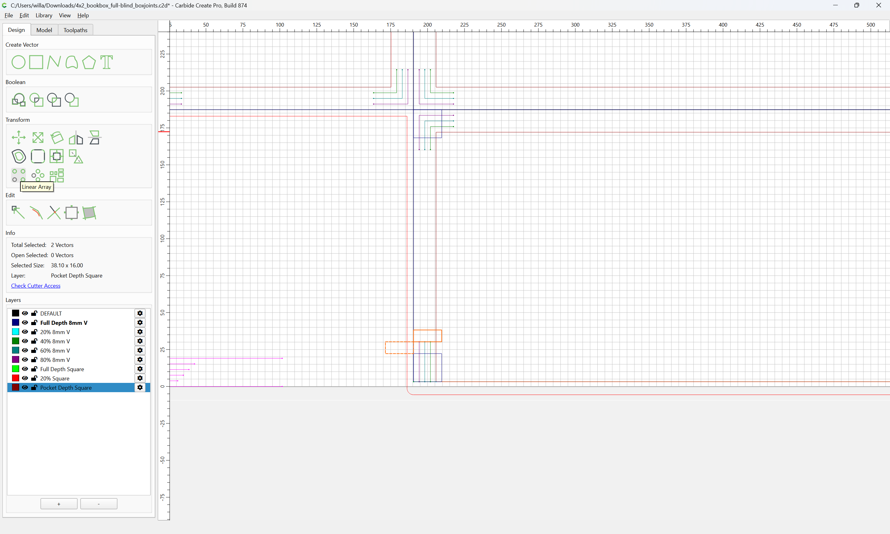

Select both and use Linear Array to make enough copies to more than fill the lacunae between the two afore-mentioned squares:
Linear Array:
(note that it will be necessary to ignore the dimension of the top-most unit — visualization seems easier if there is an even-odd pairing)
OK
shift-click on the top-most unit to remove from the selection:
and Group Vectors
Select and delete the top-most unit:

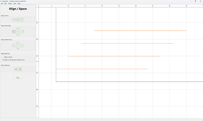

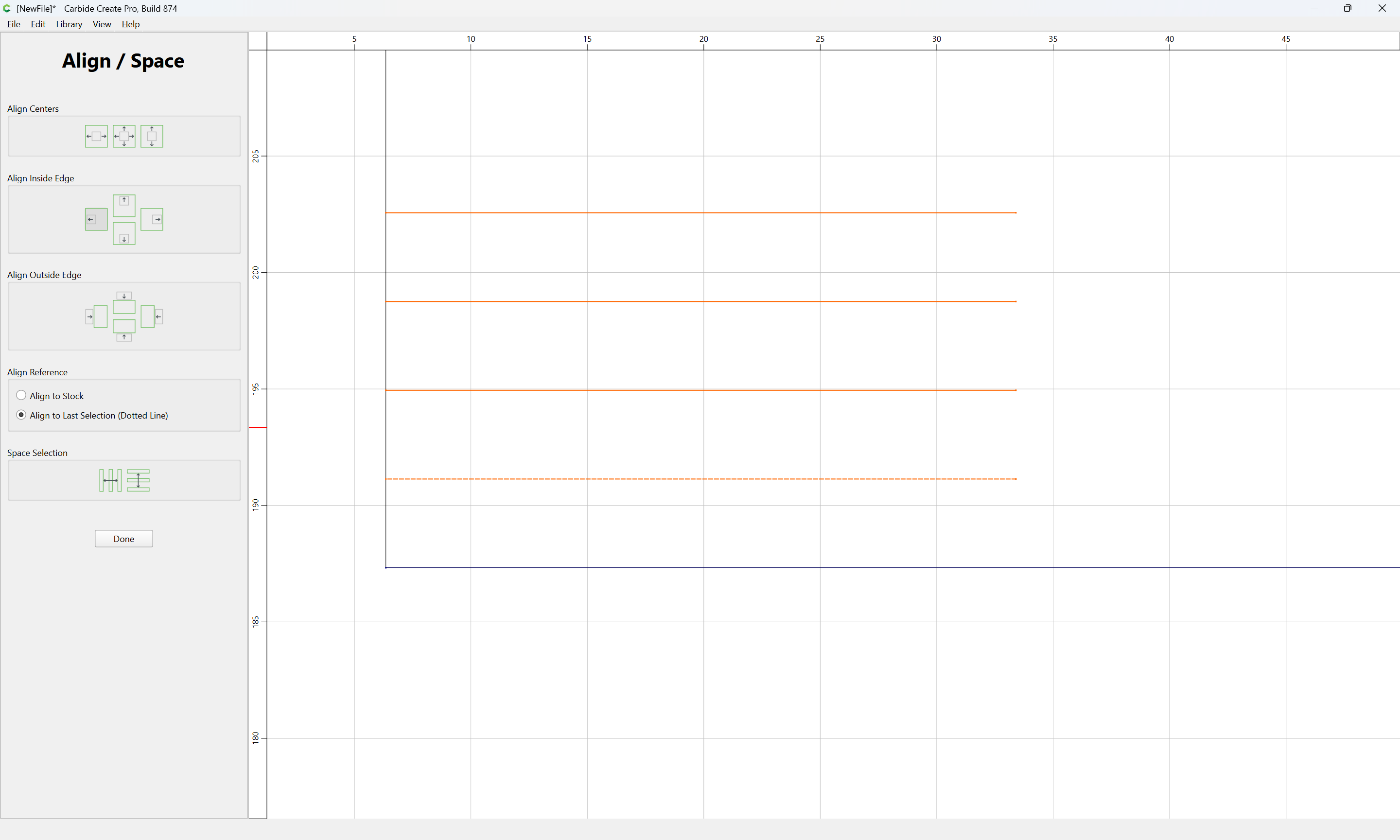

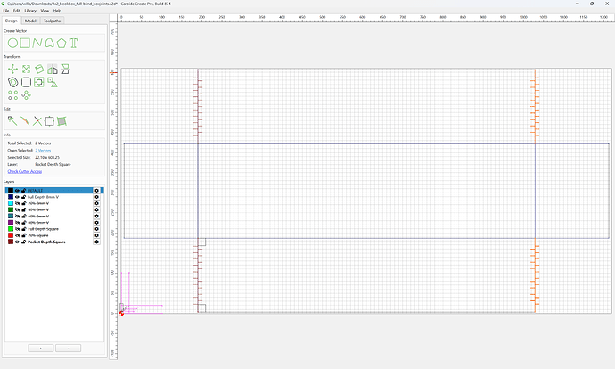

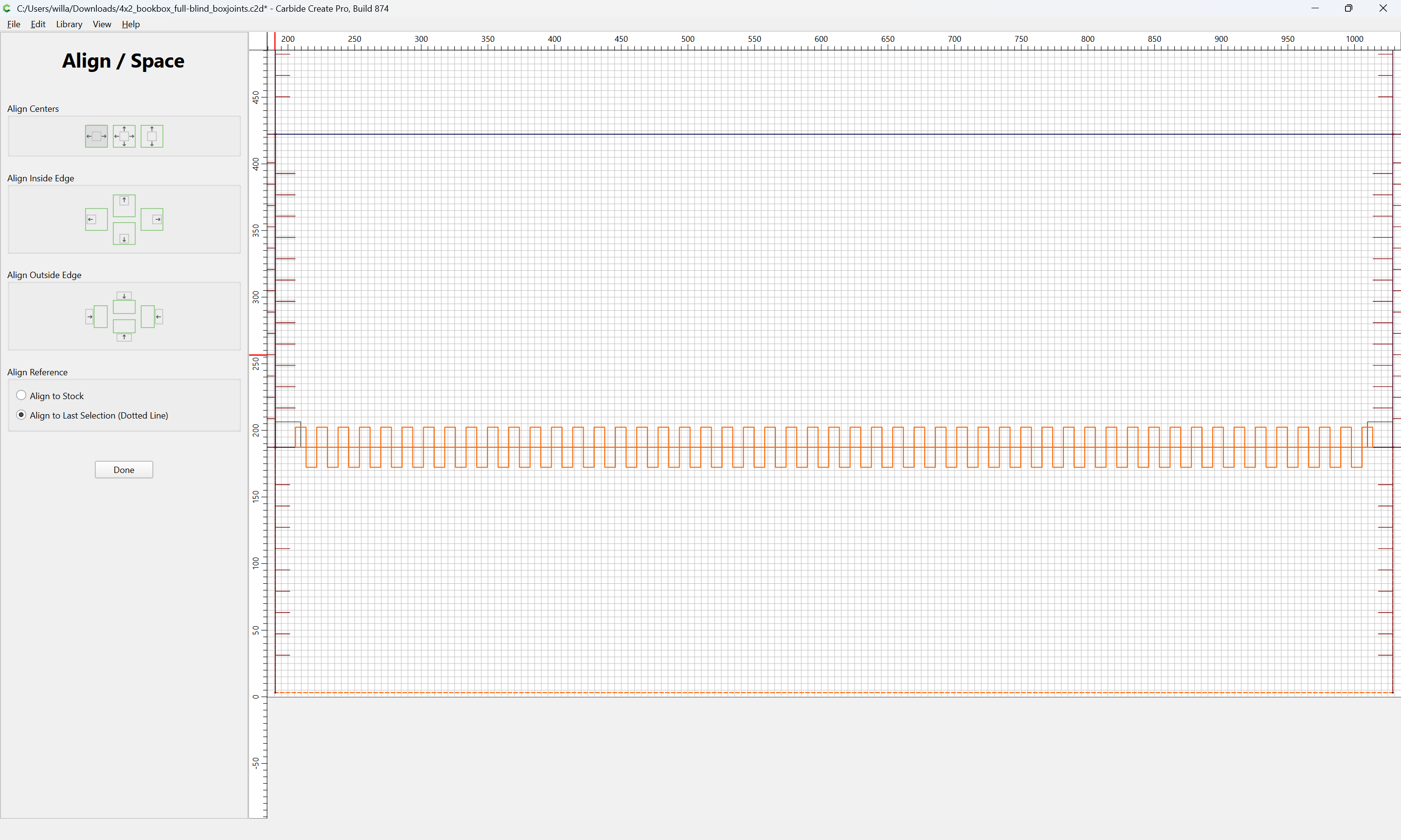

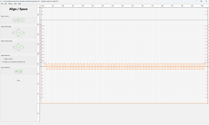

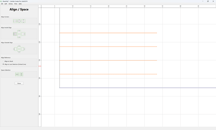

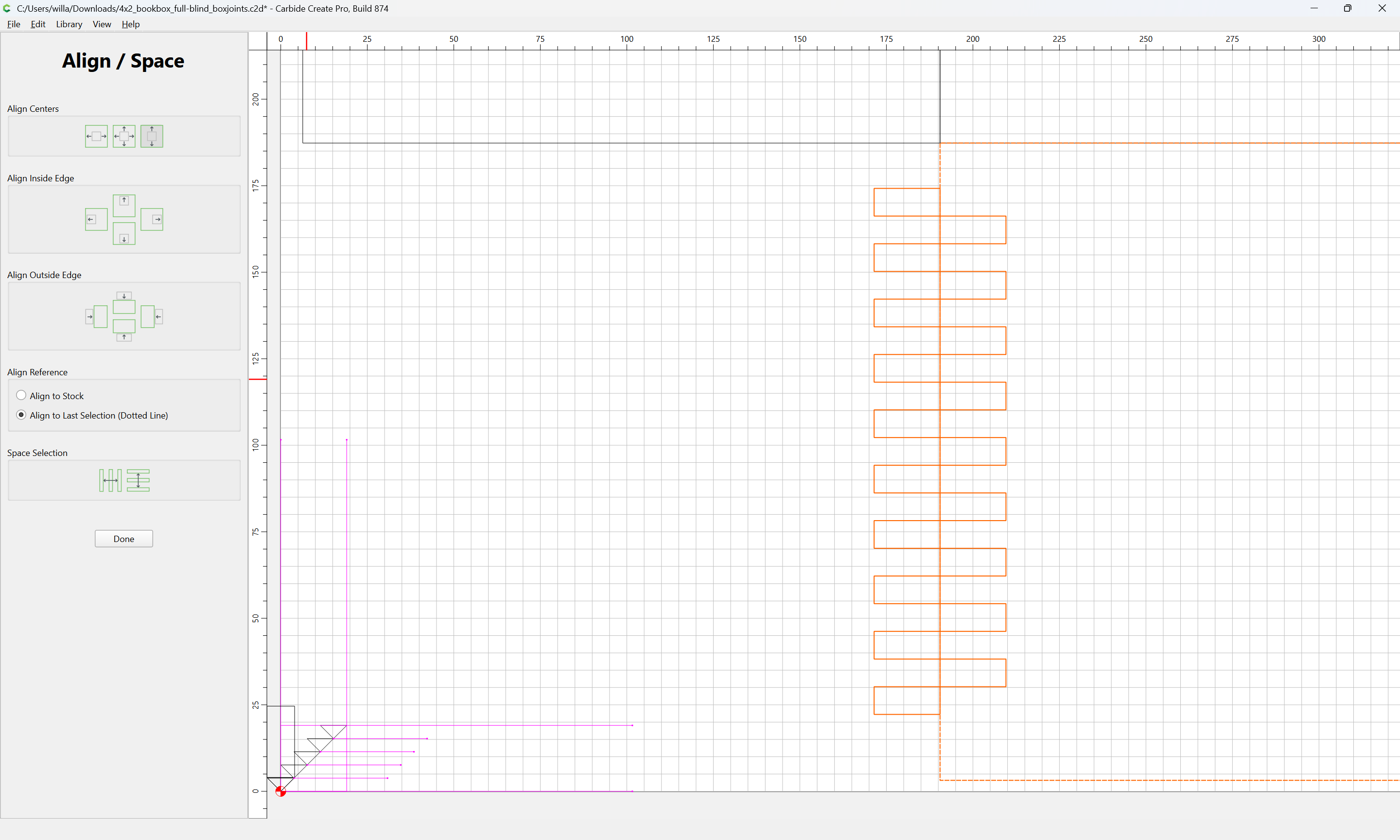

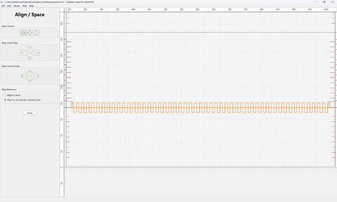

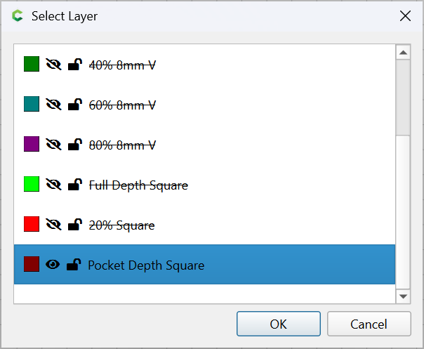

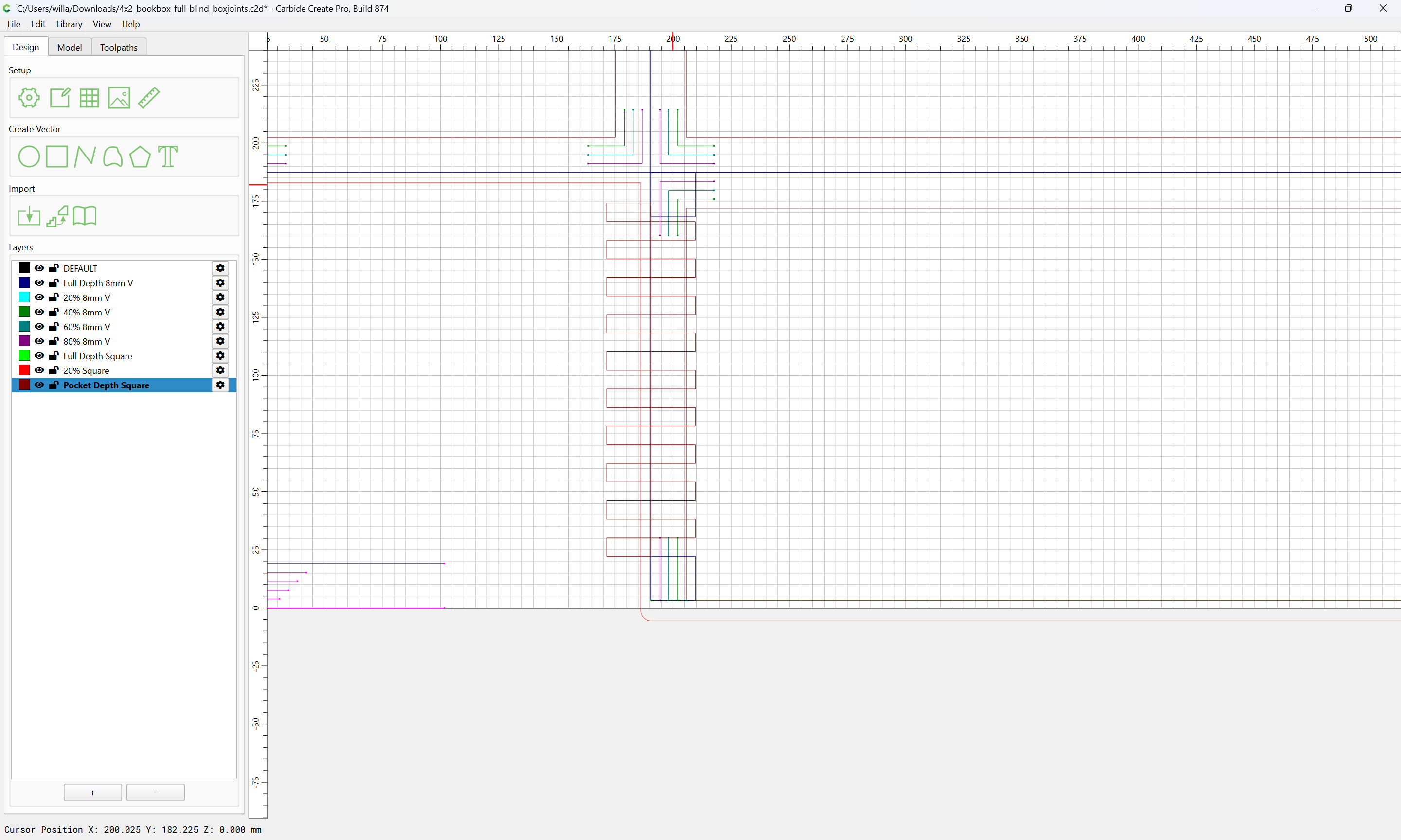

Hide all layers except for the DEFAULT (where the part outlines are) and the Pocket Depth Square:
shift-click on the matching part outline to add it to the selection:
Align Vectors
Align vertically
Done

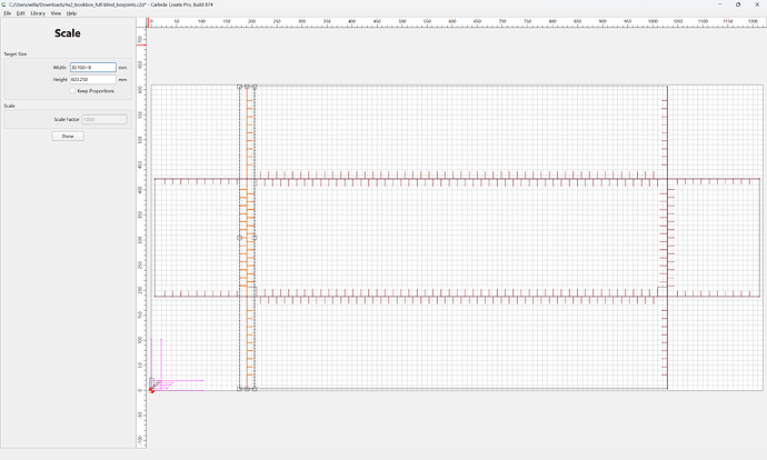

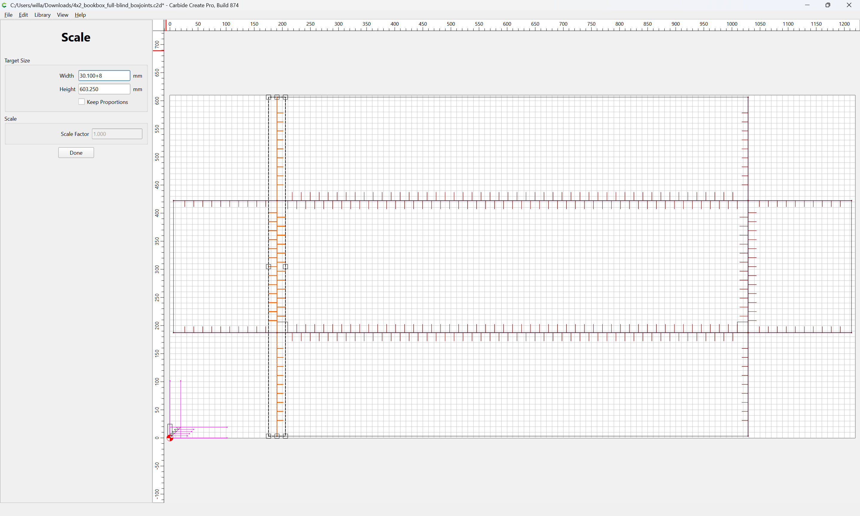

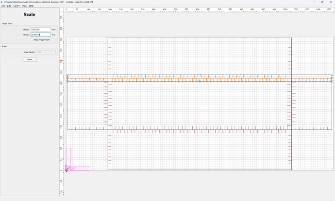

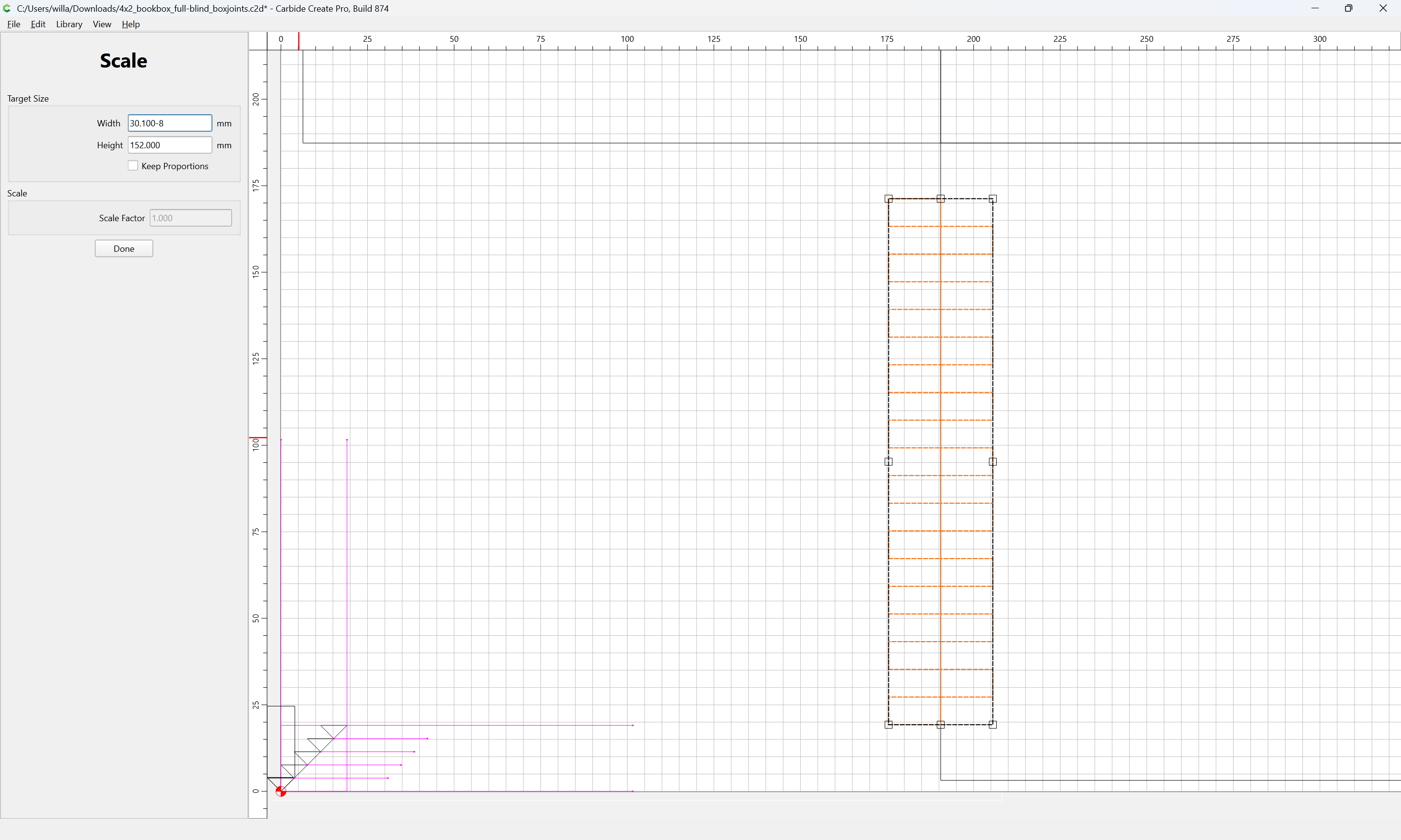

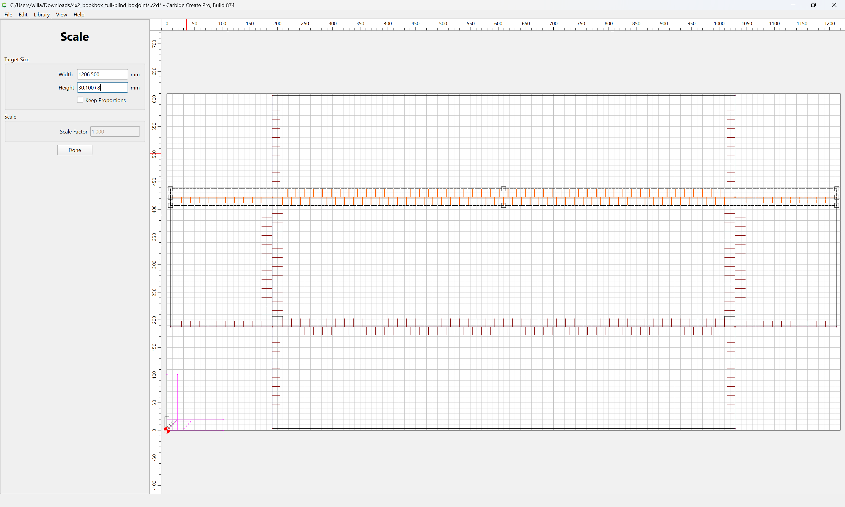

Because the toolpath will cut beyond where it begins/ends by tool radius the array should be reduced in width by the tool diameter:
Scale
Done

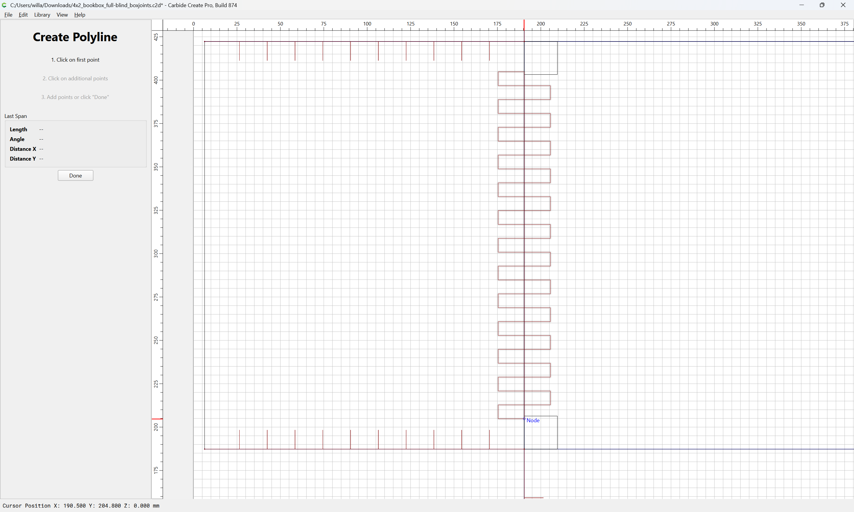

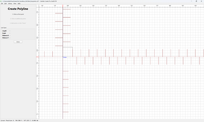

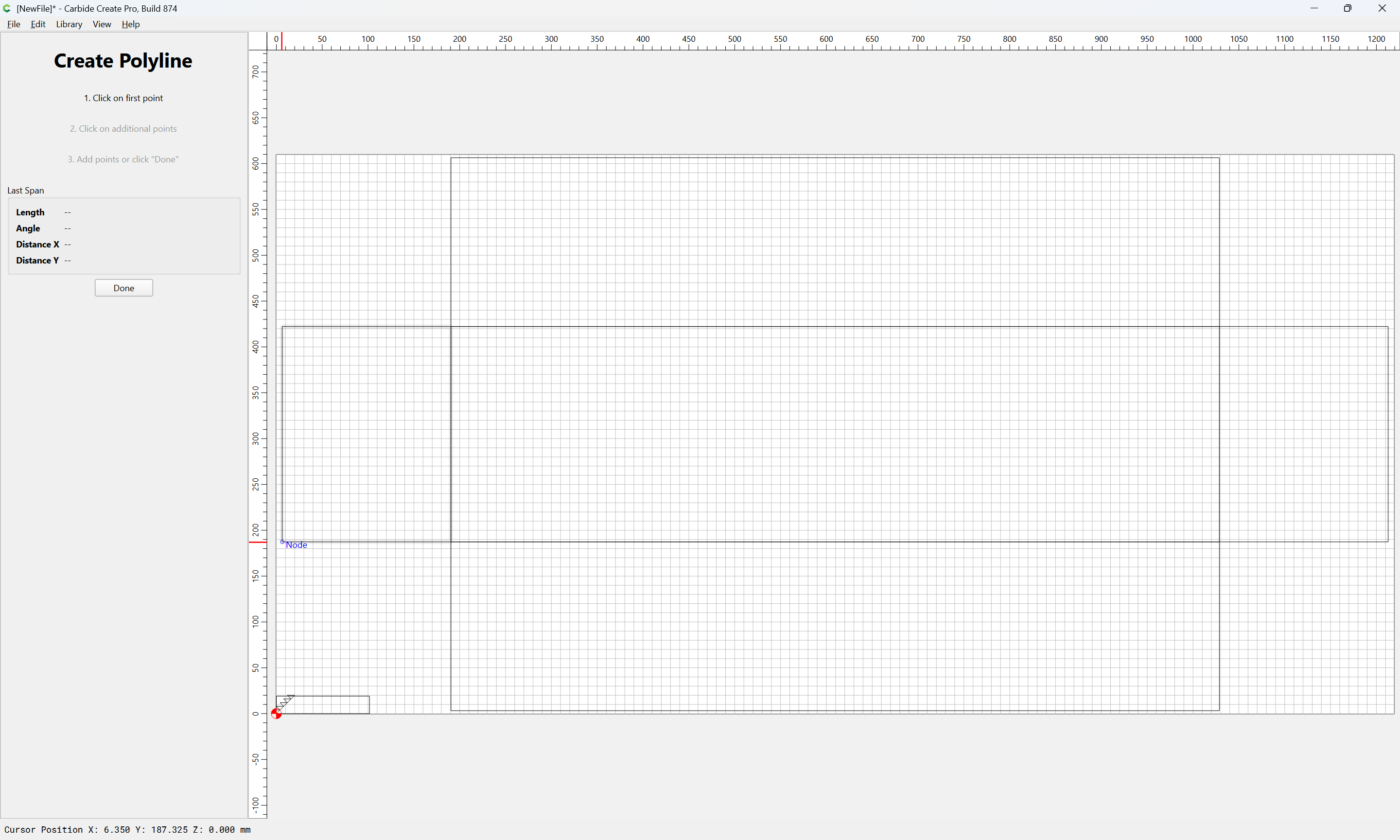

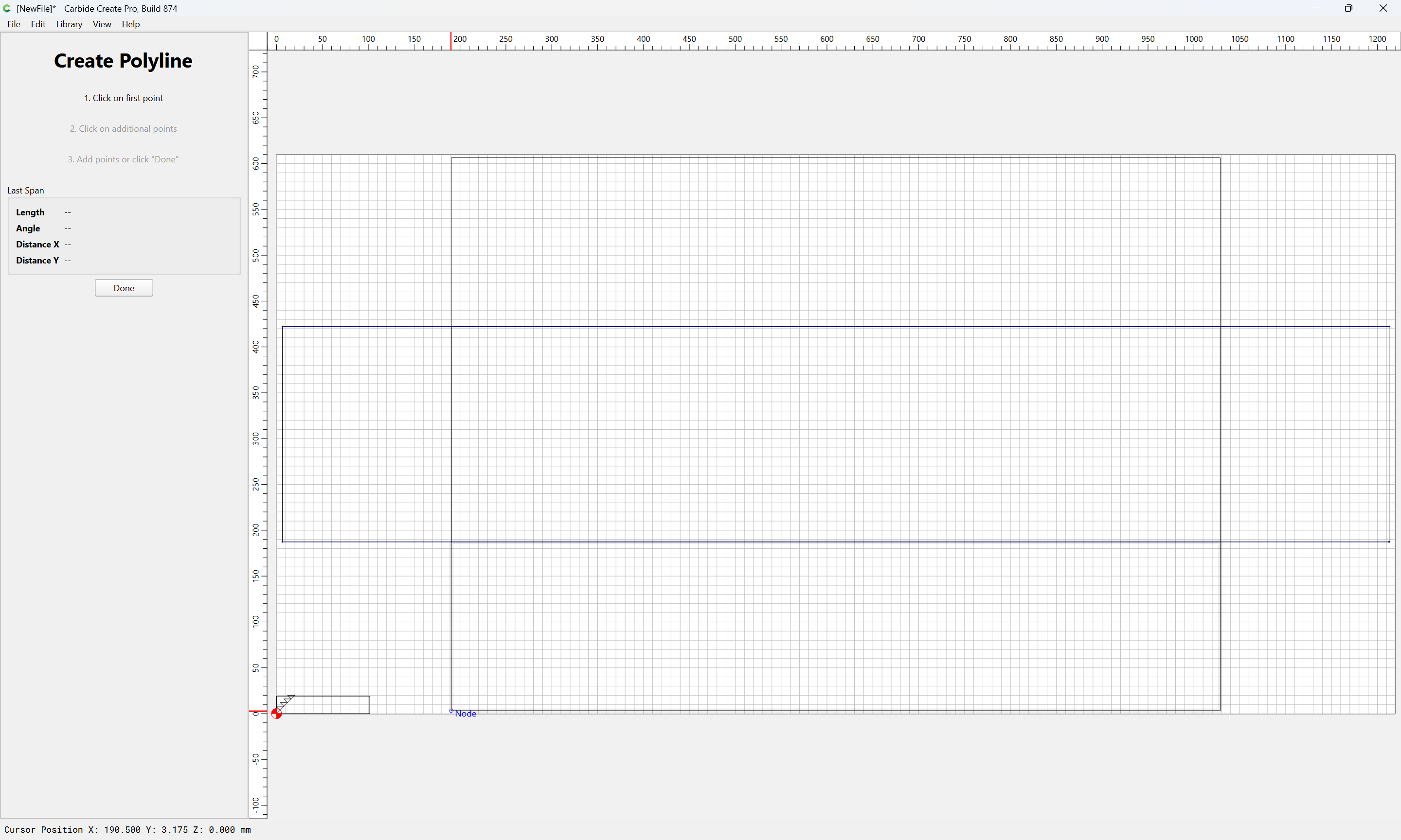

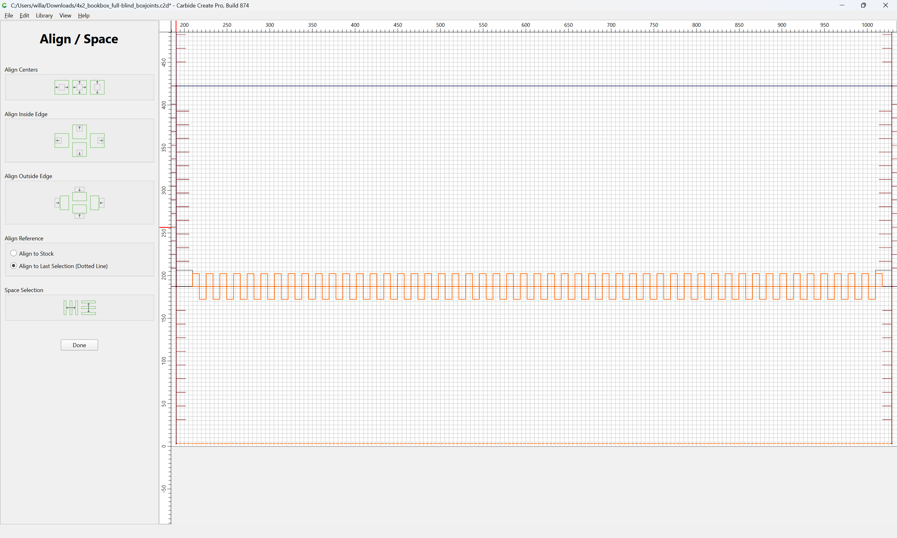

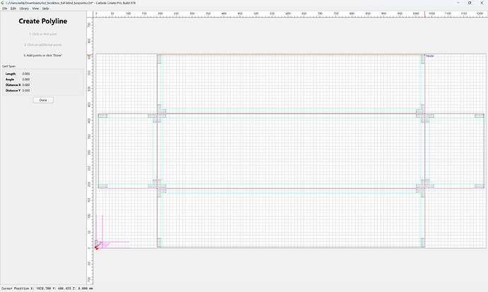

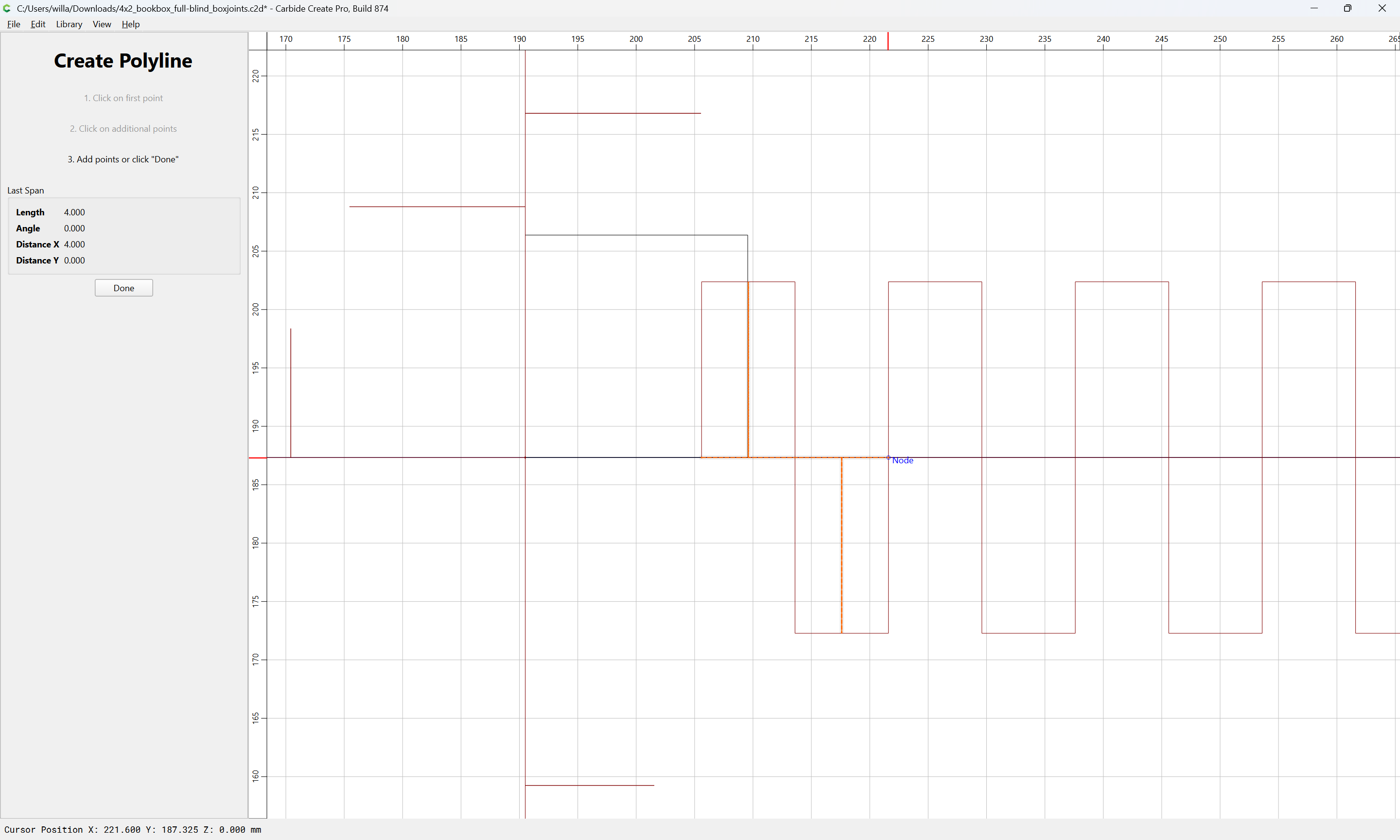

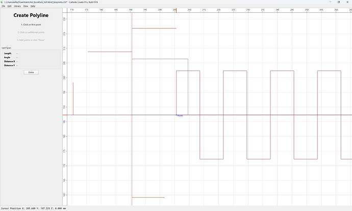

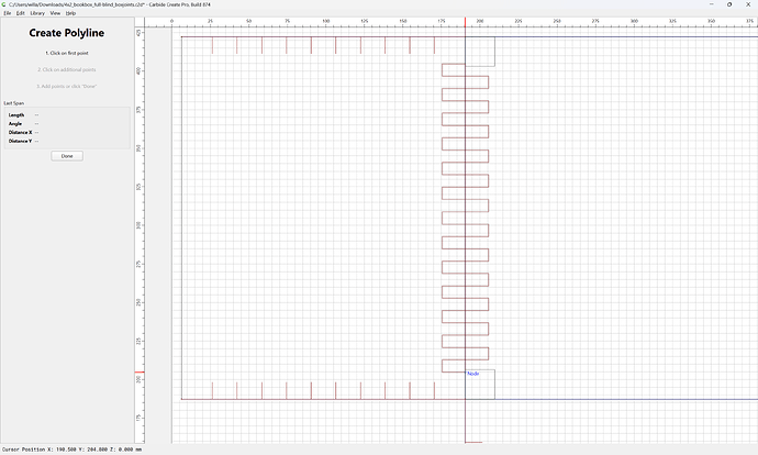

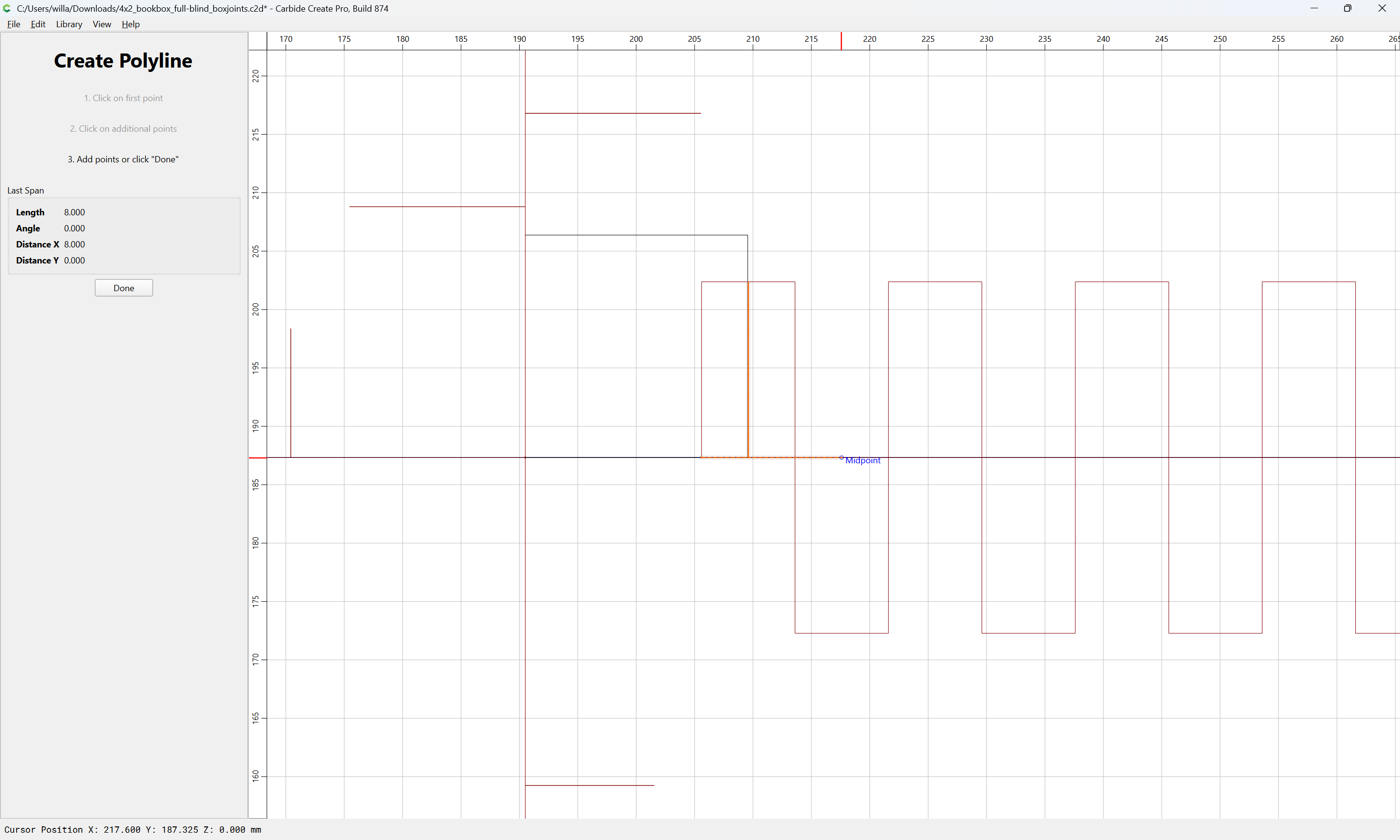

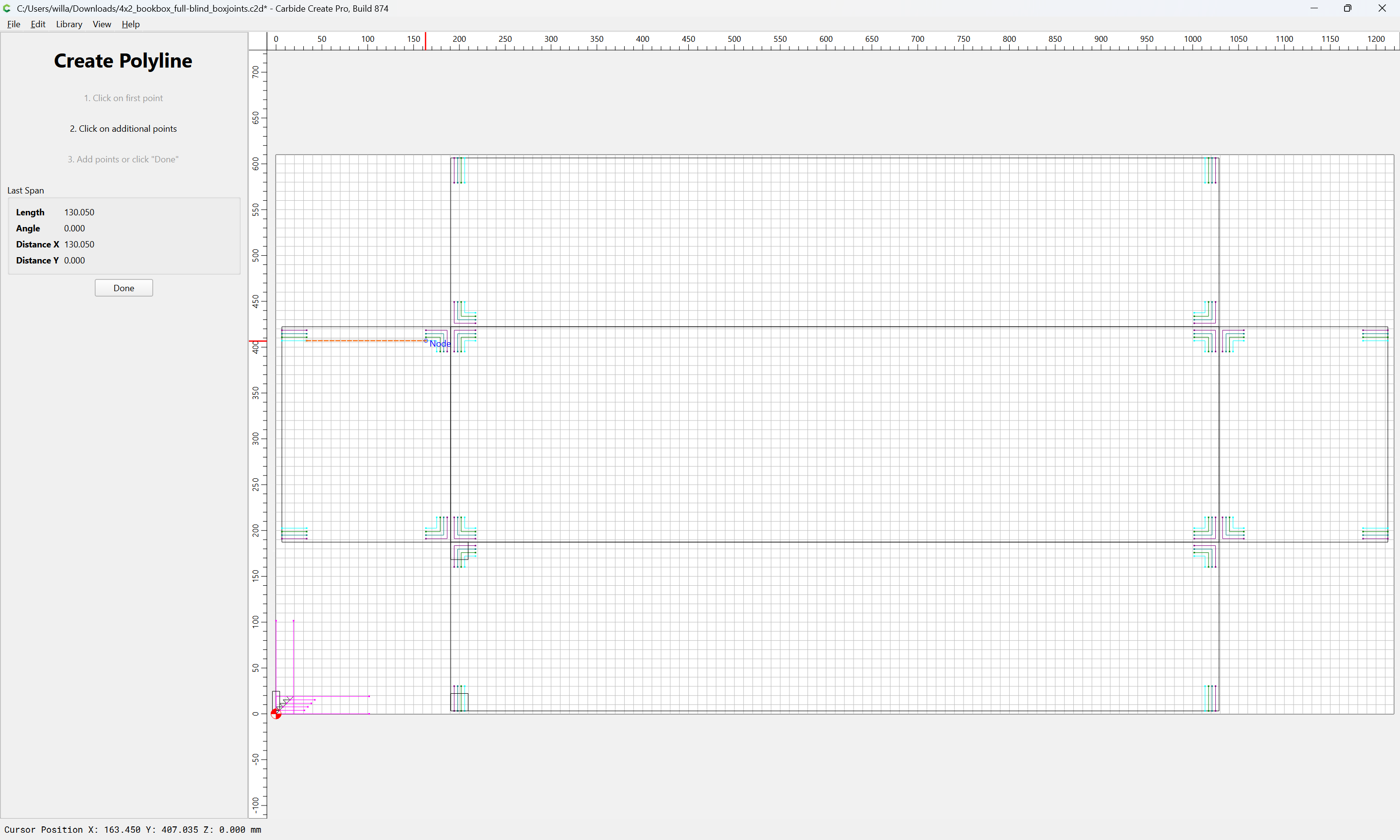

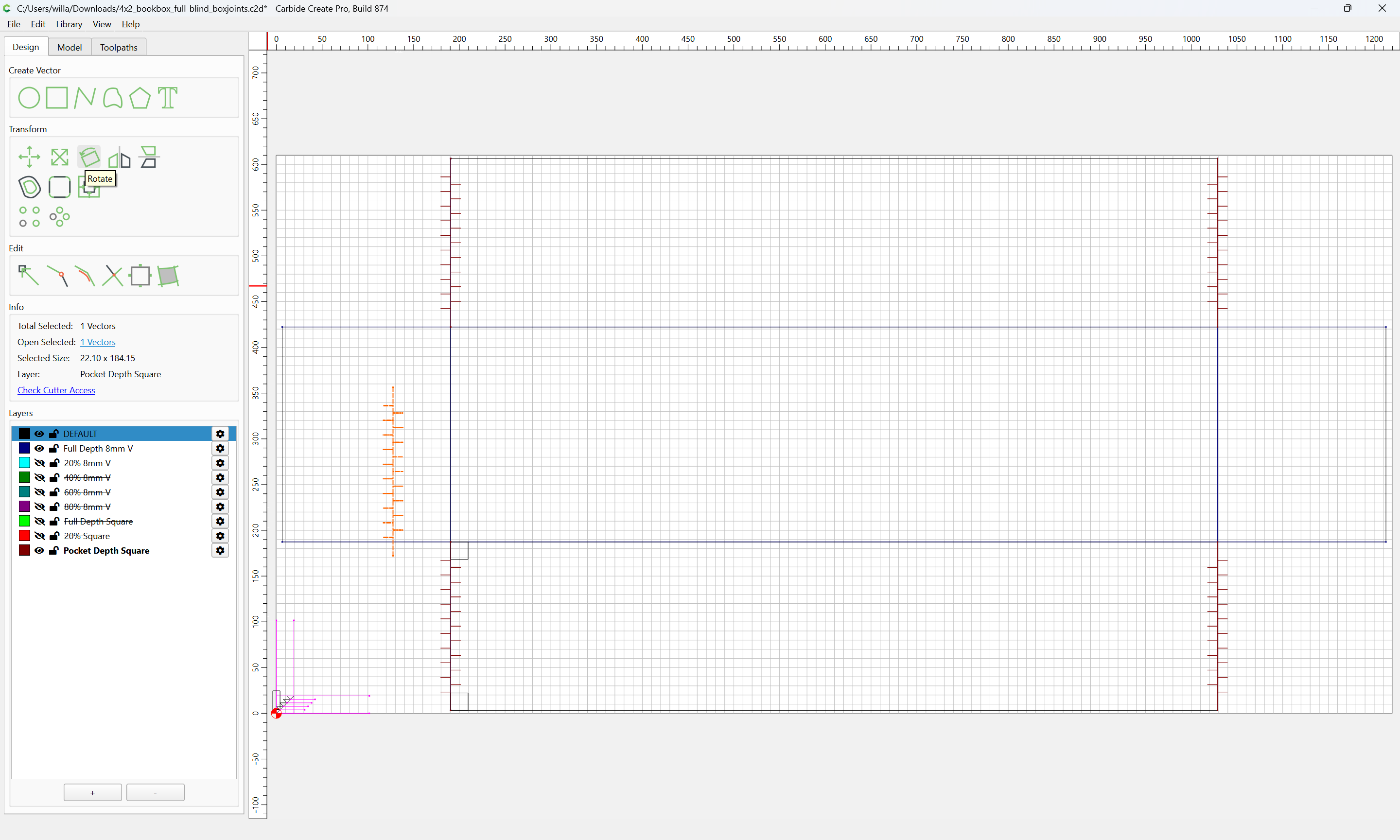

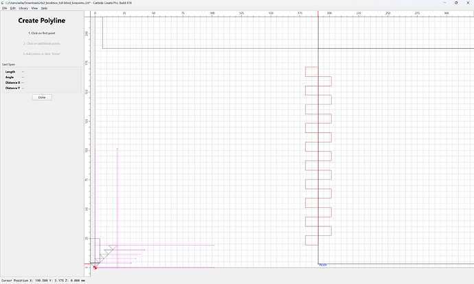

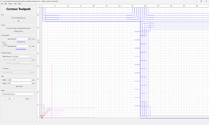

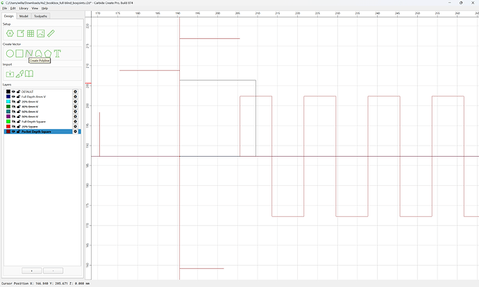

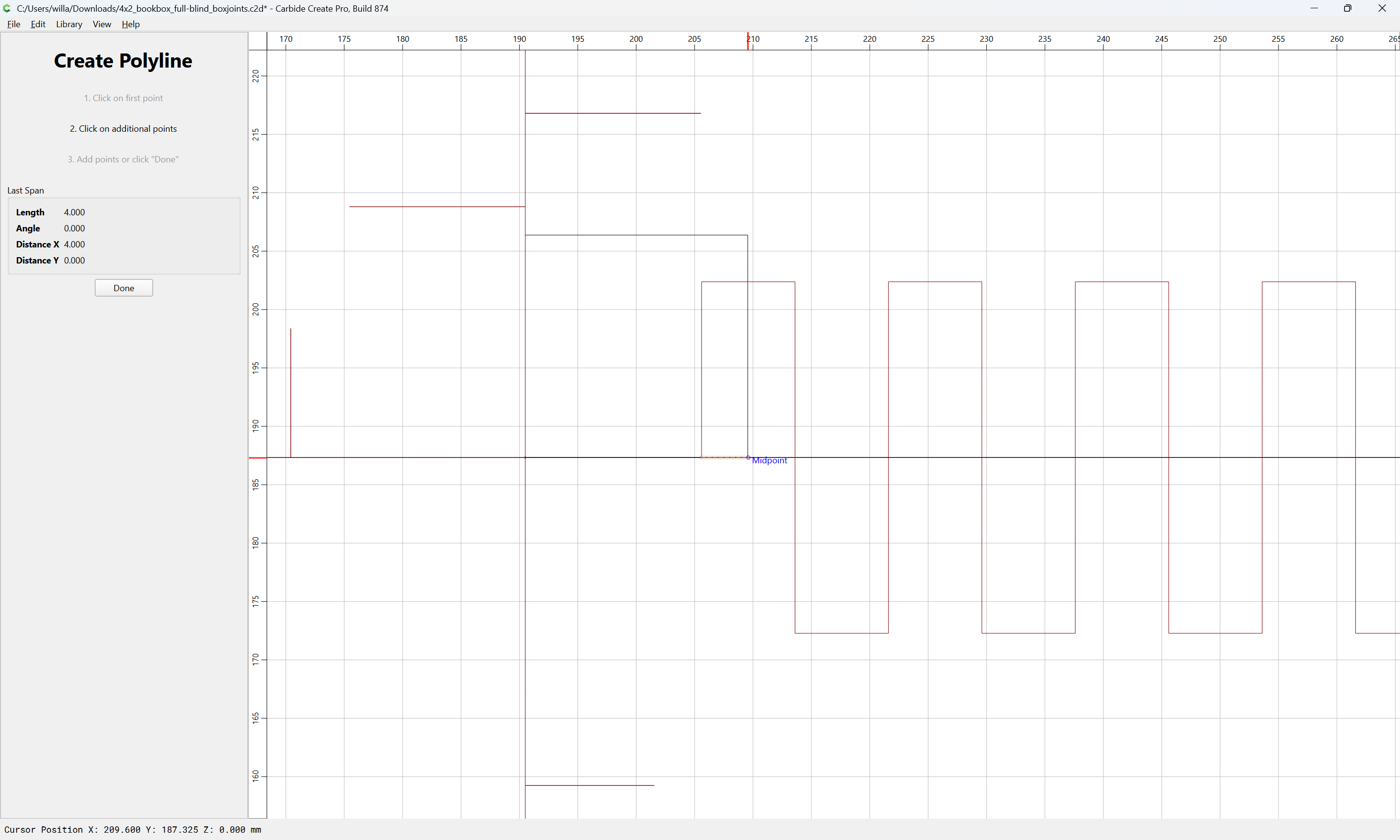

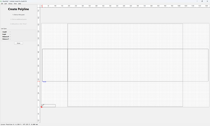

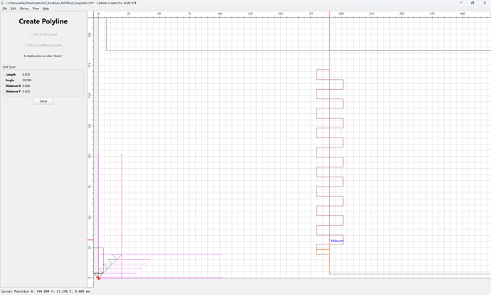

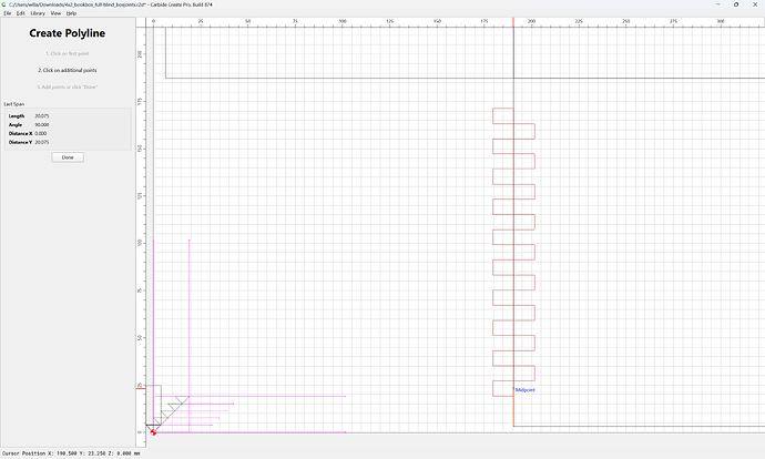

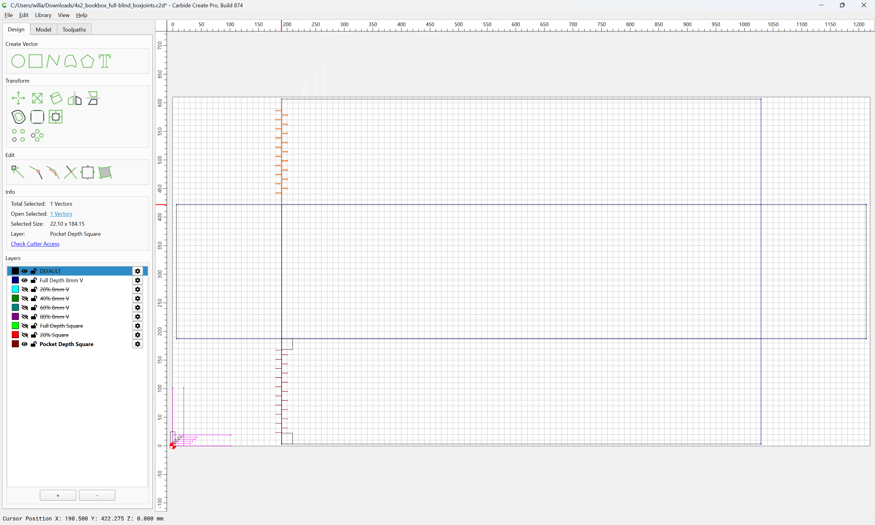

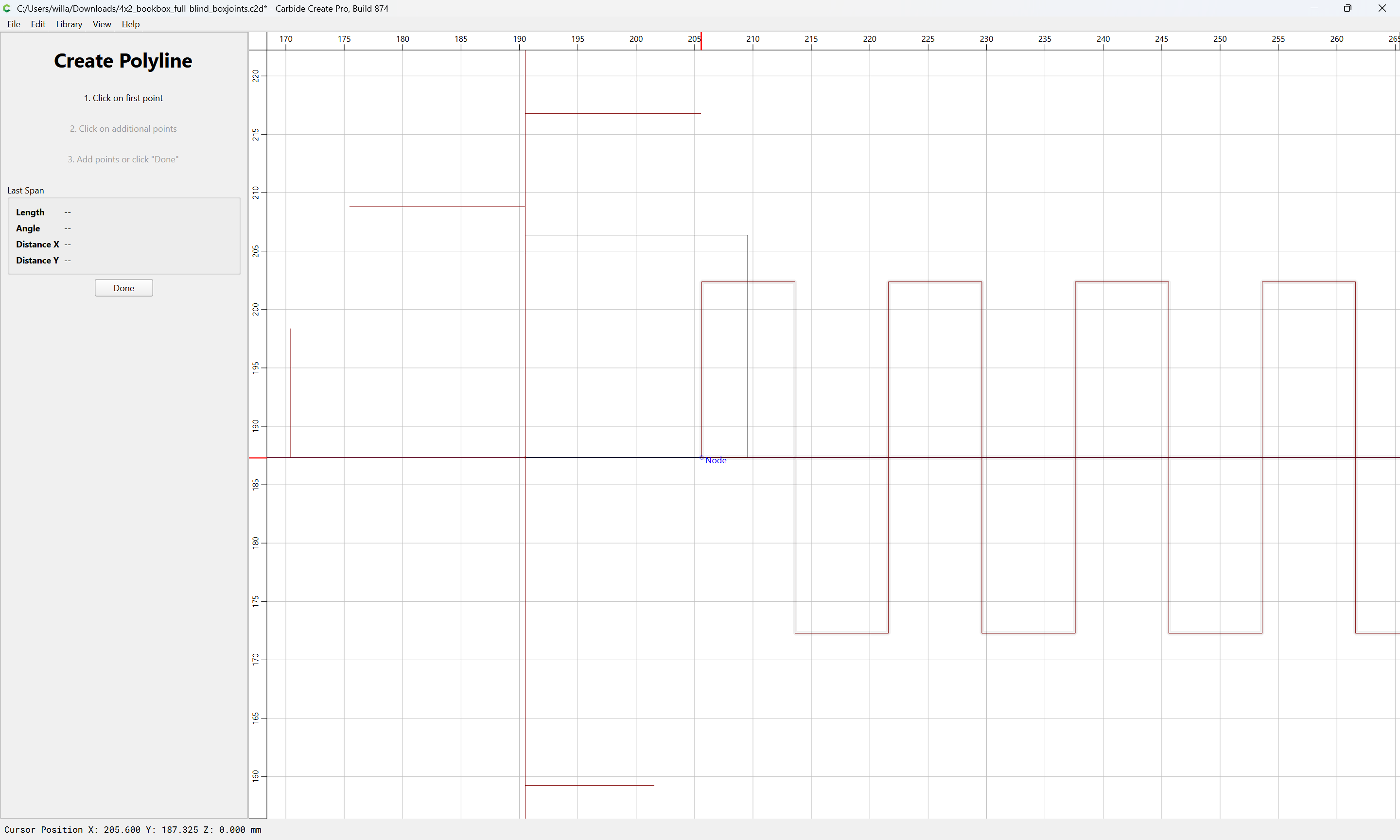

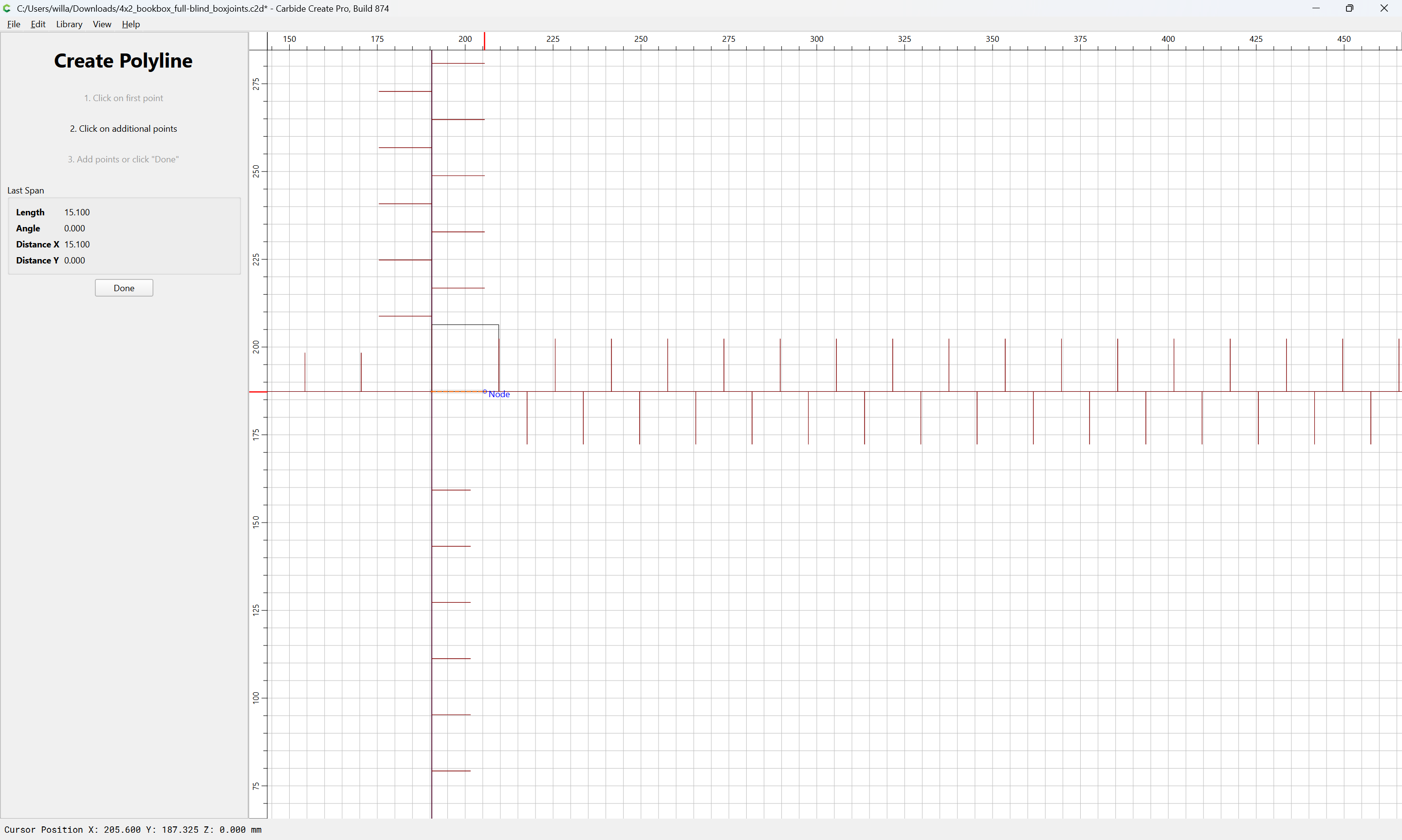

Draw a polyline for the toolpath which starts at the bottom edge of the part:
going back and forth
Done
The linear array may then be deleted:
With a suitable toolpath applied to this layer:
Select by Layer
OK
it previews as:

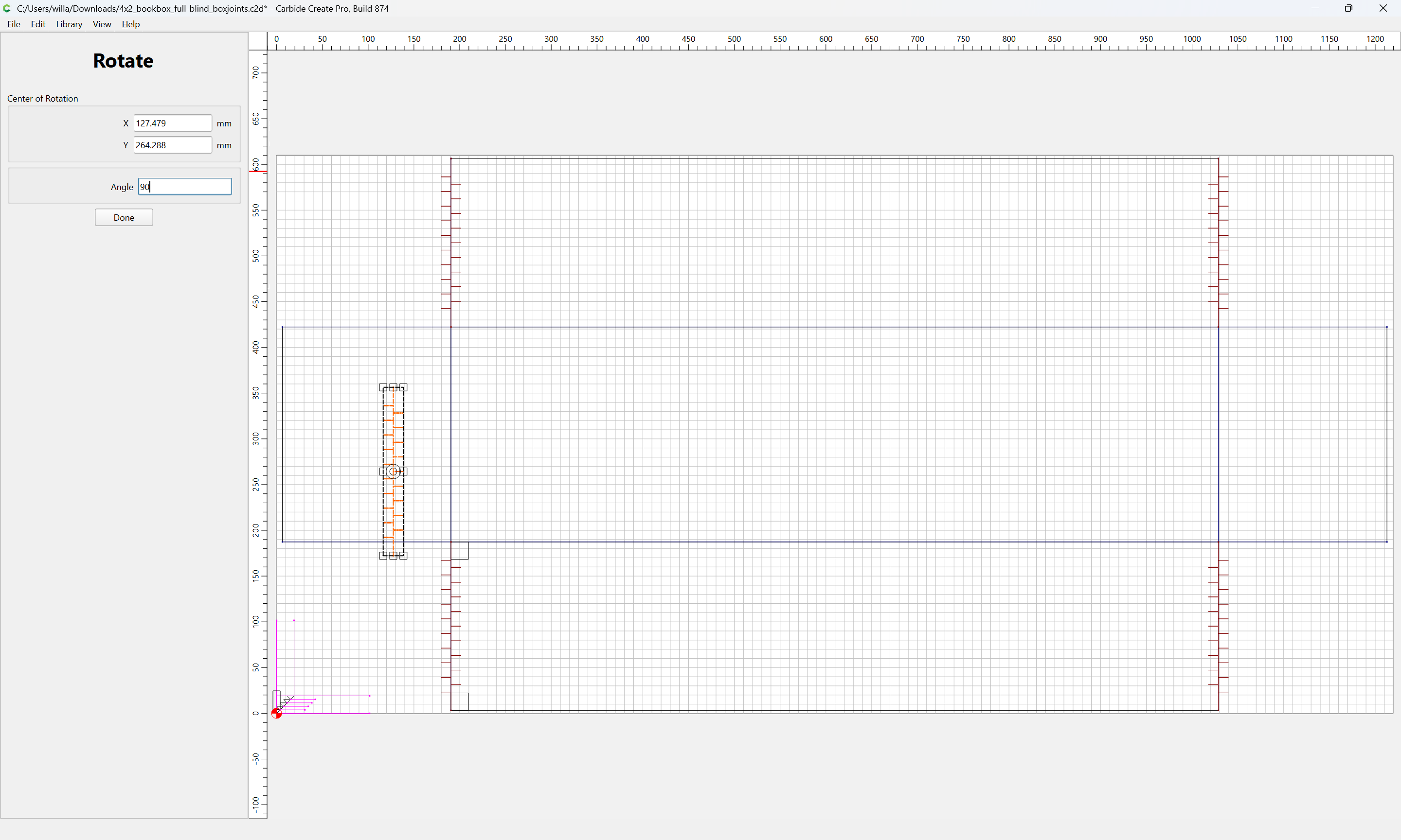

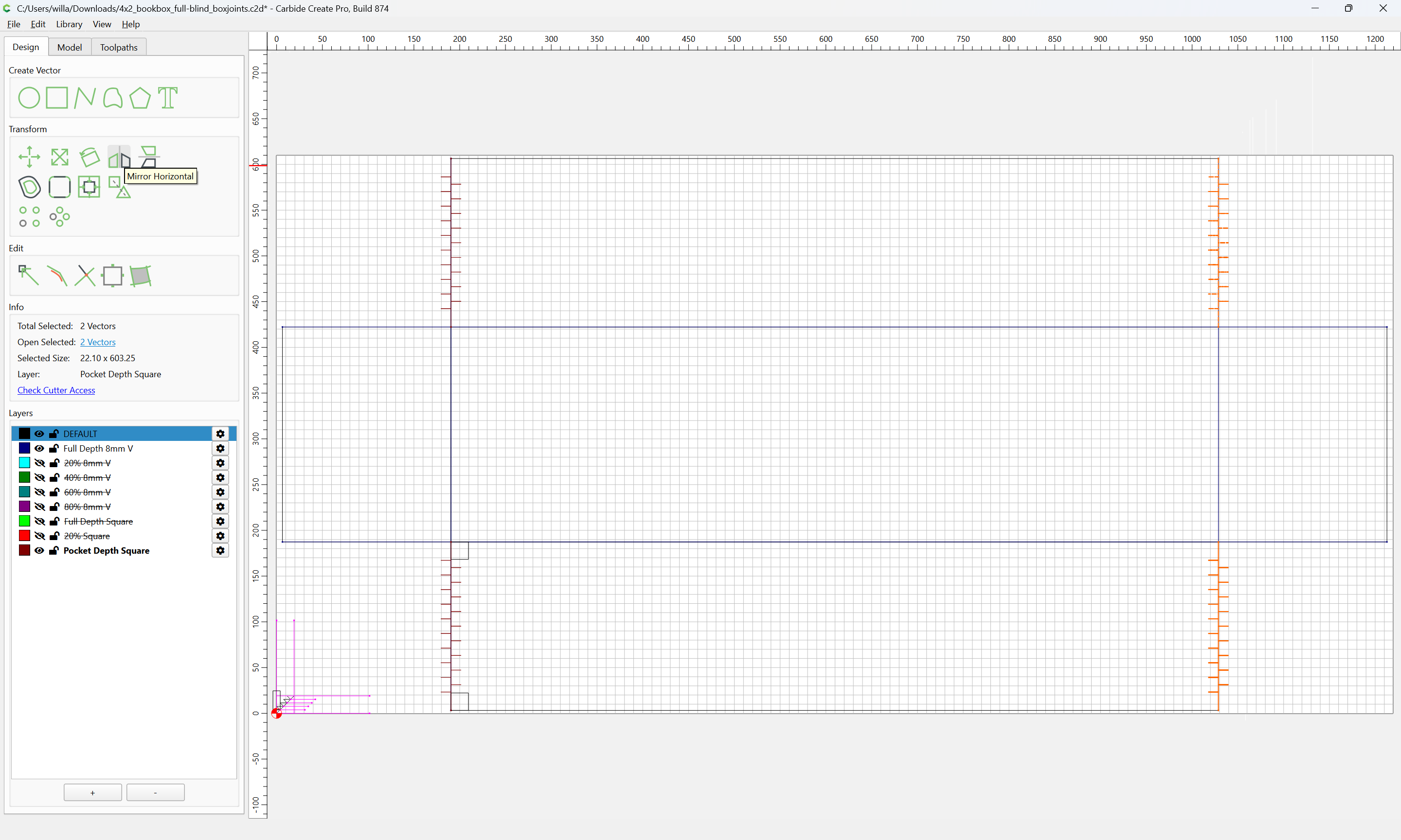

and may be duplicated and mirrored where appropriate:
Mirror Horizontal
and also rotated:
Done

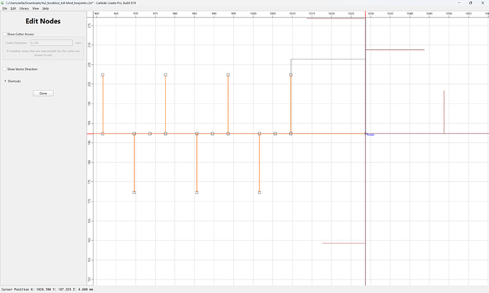

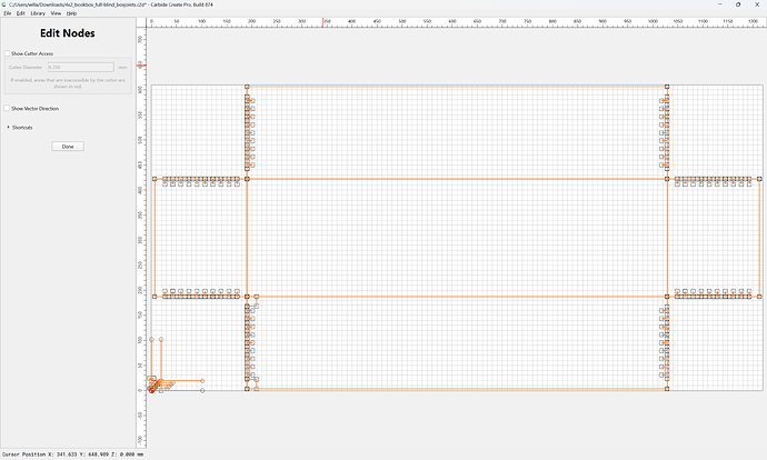

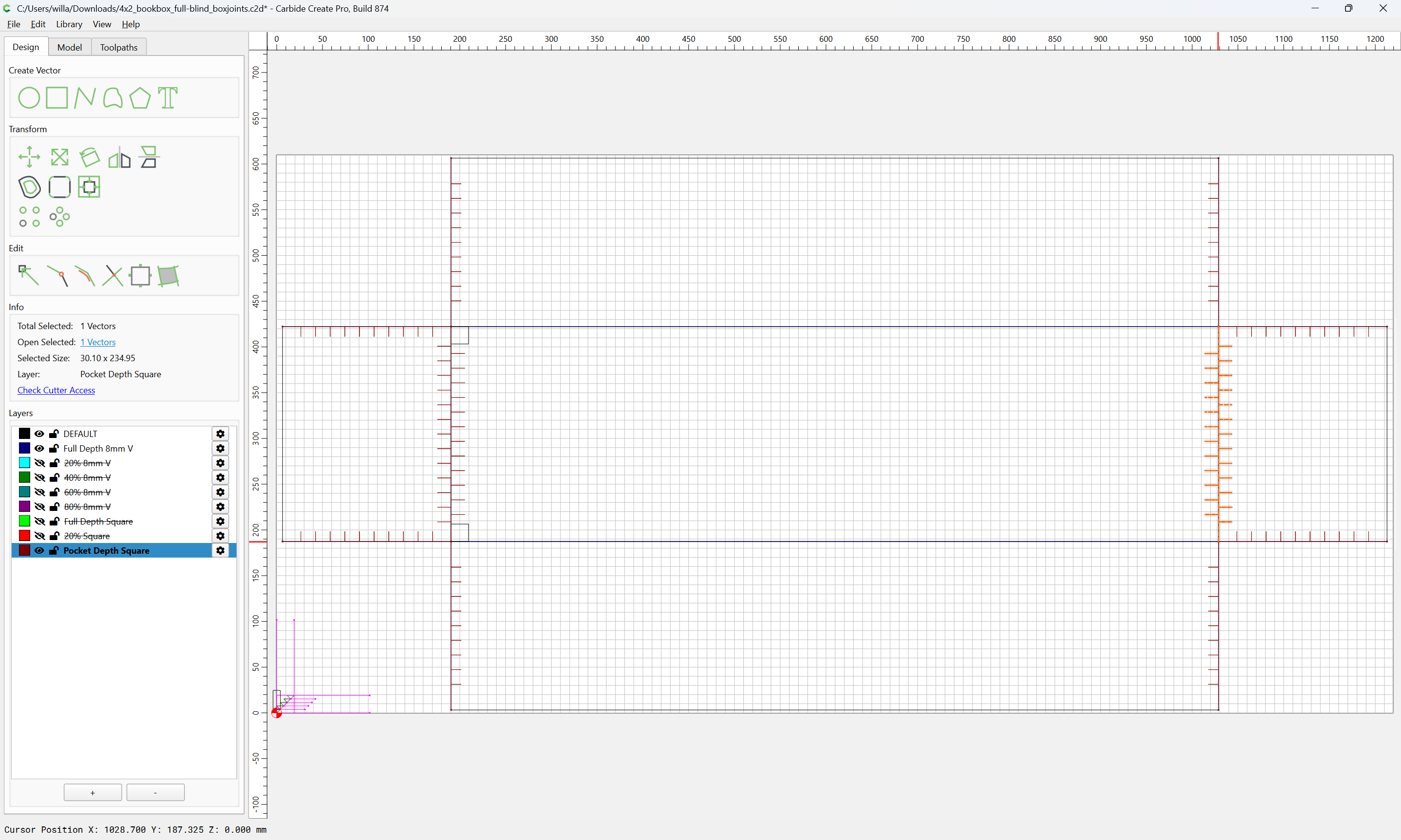

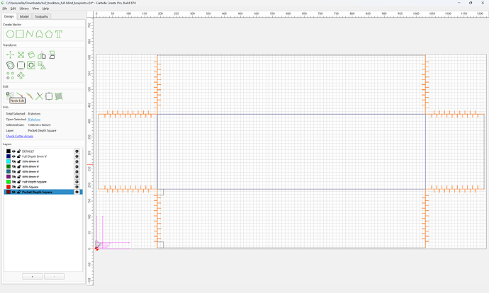

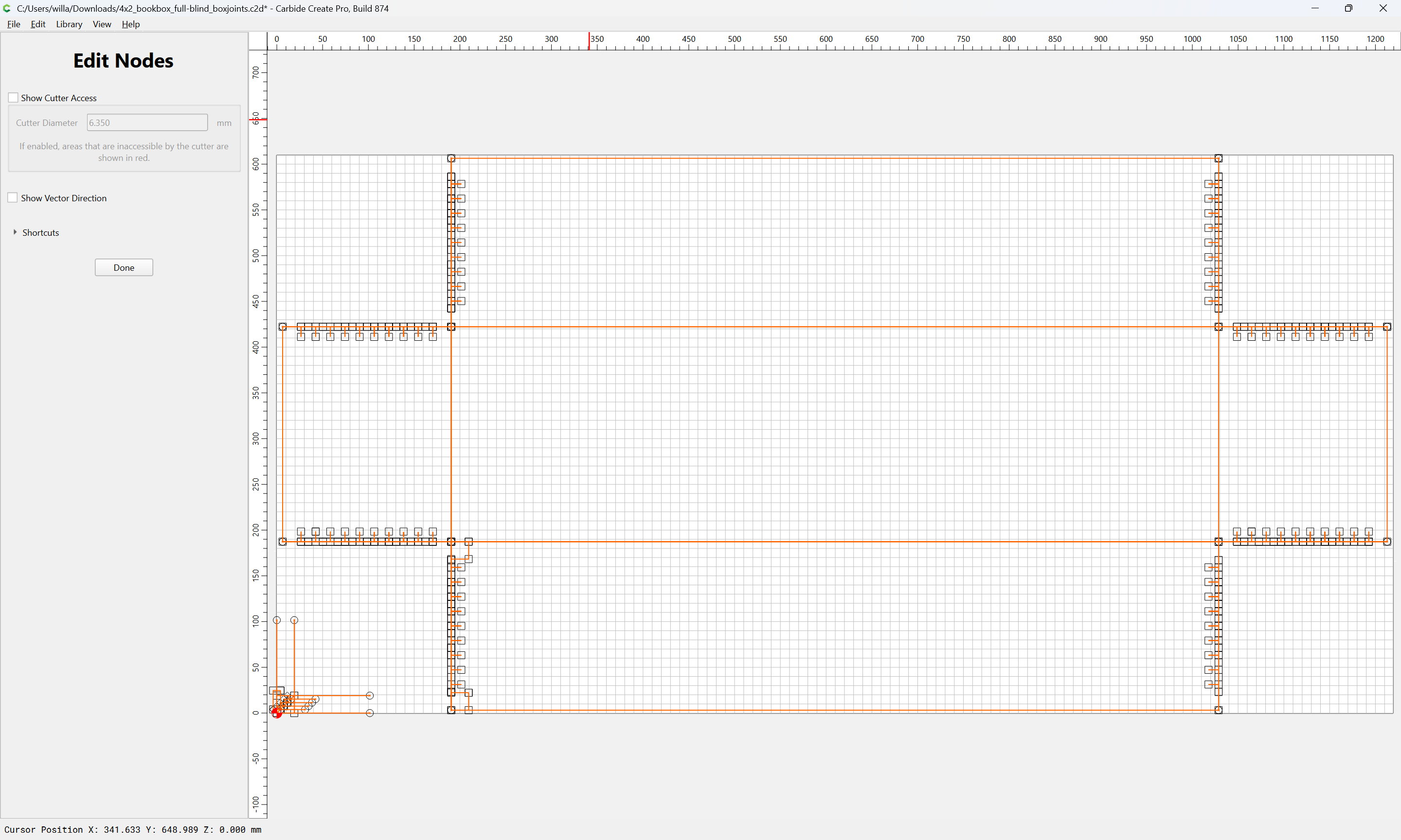

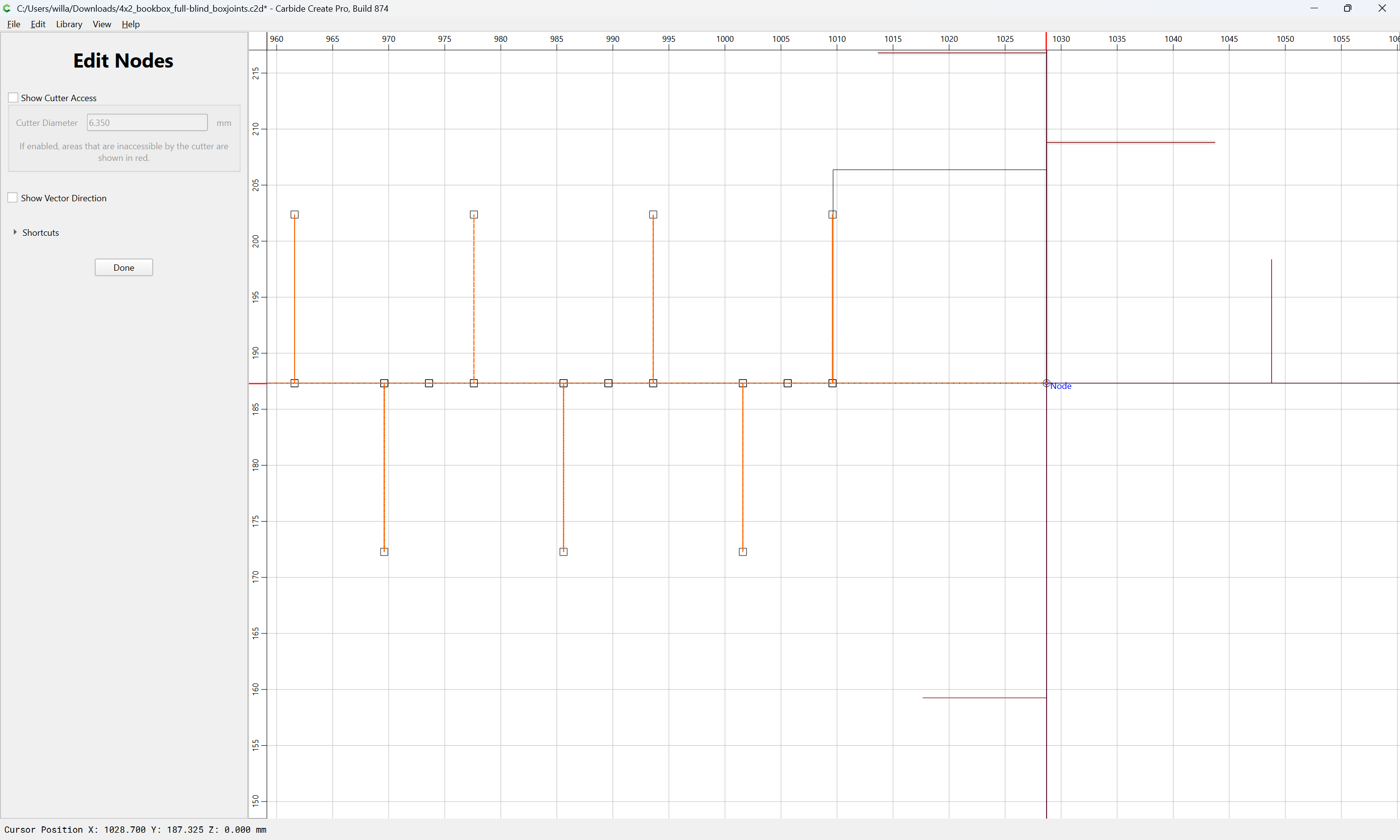

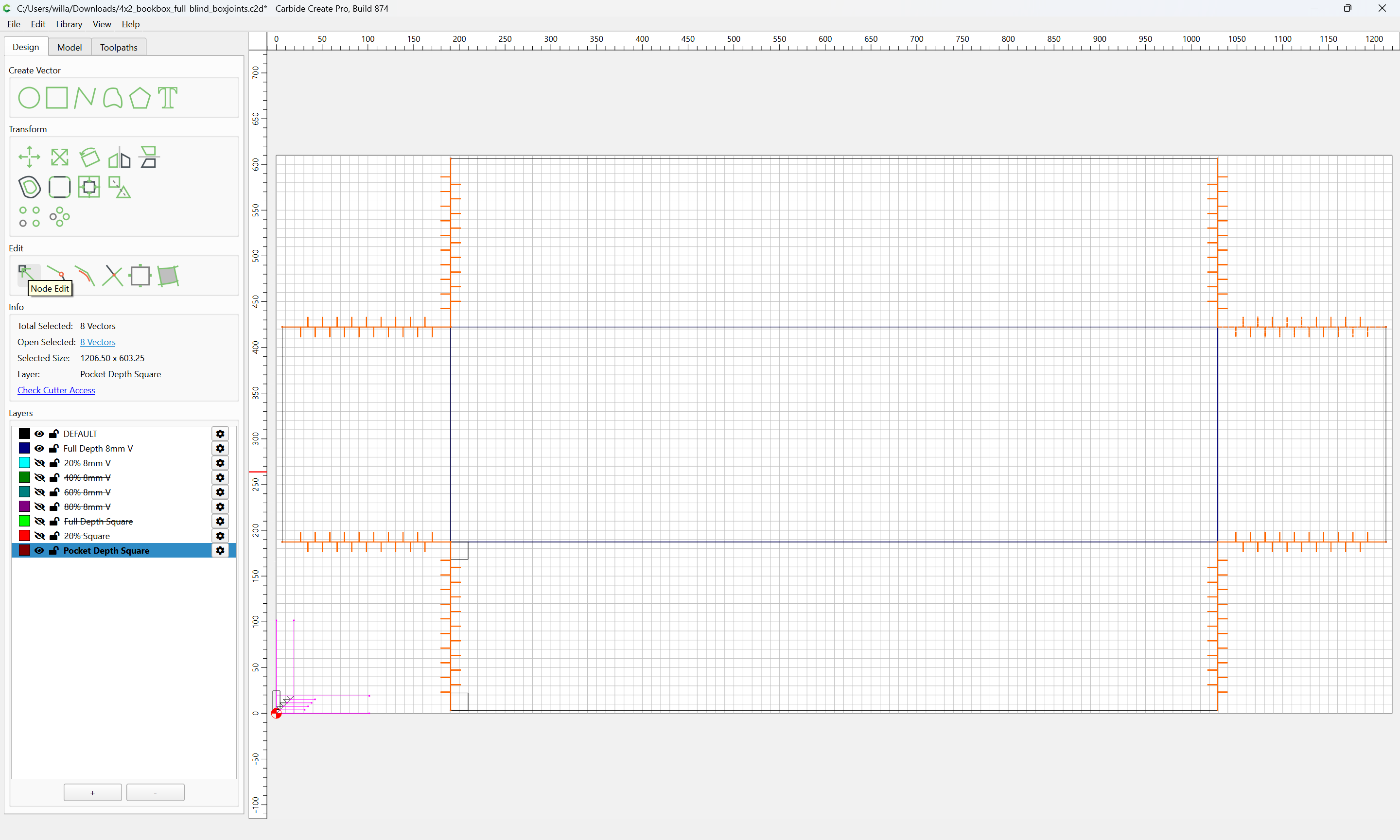

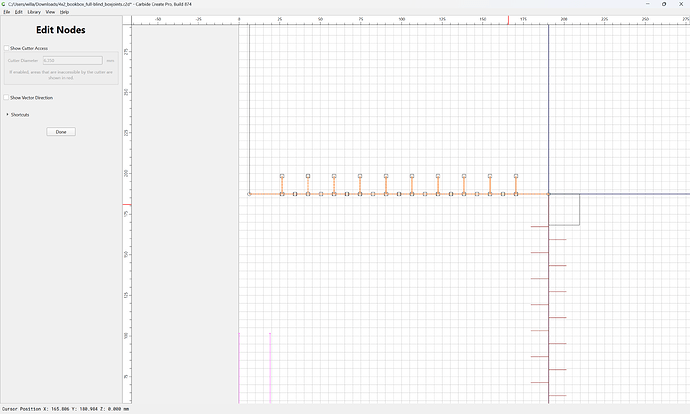

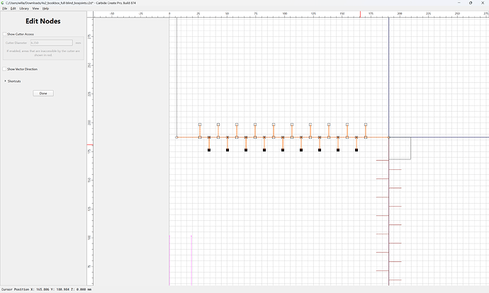

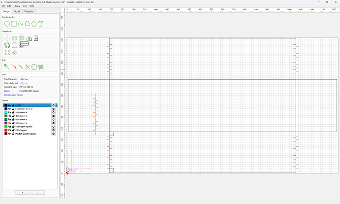

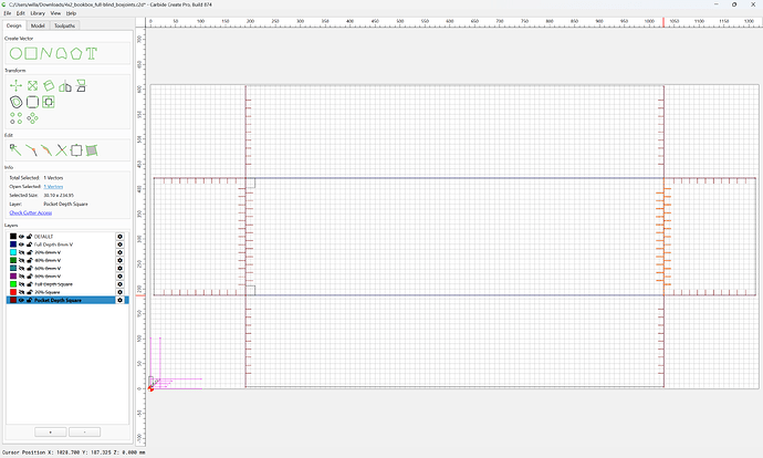

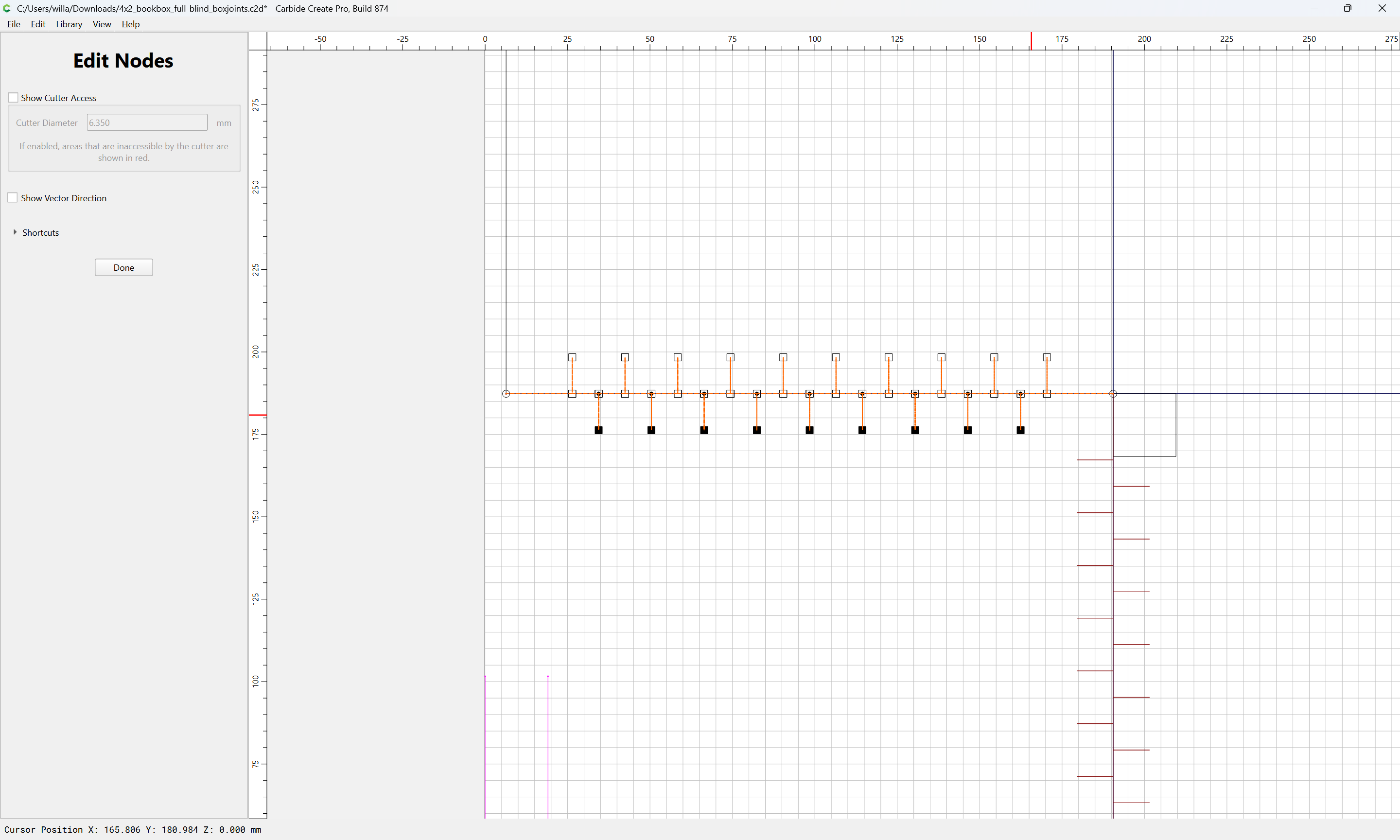

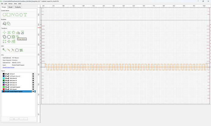

Select all on the Pocket Depth layer:
and use Node Editing to remove the unneeded lines:
d
Repeat this for the other edges where joints are needed.

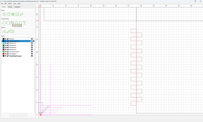

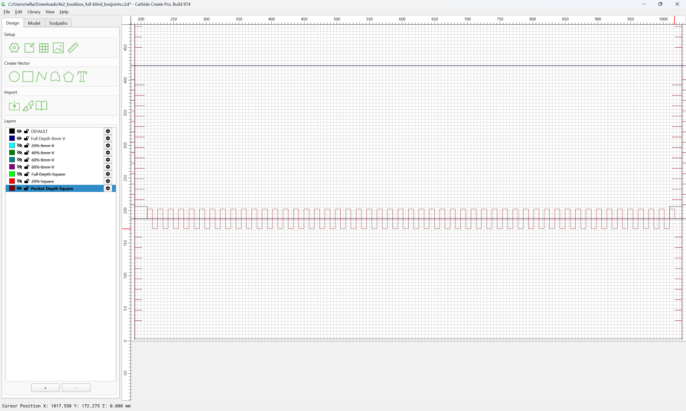

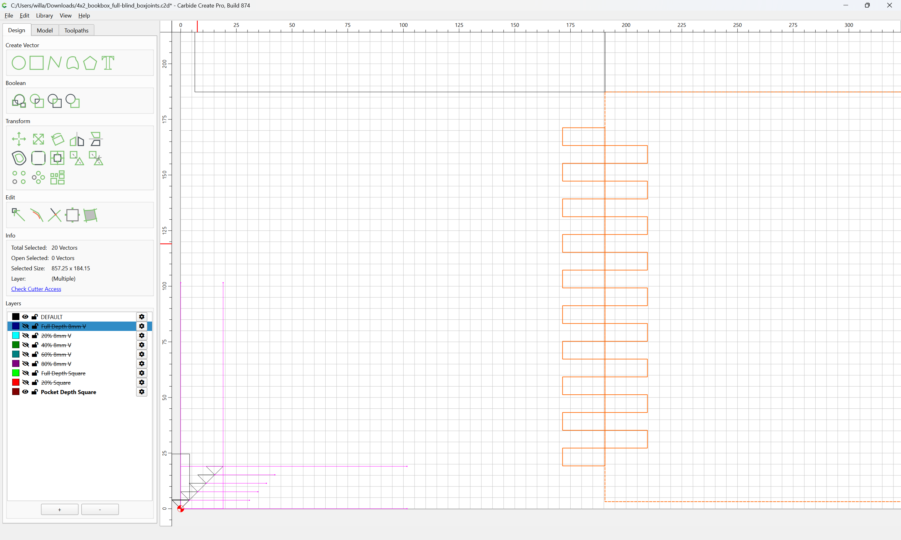

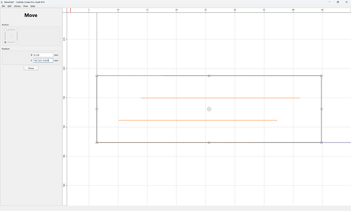

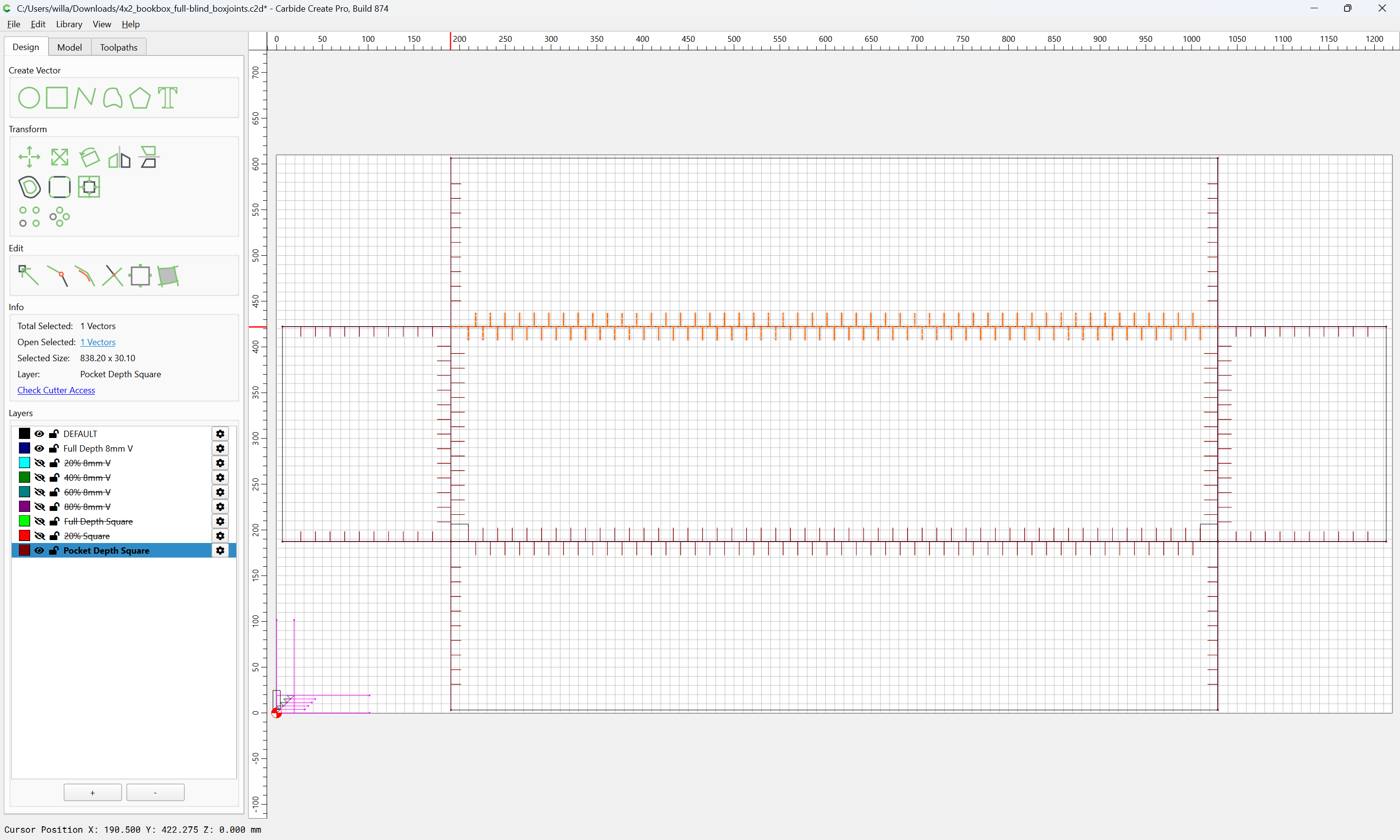

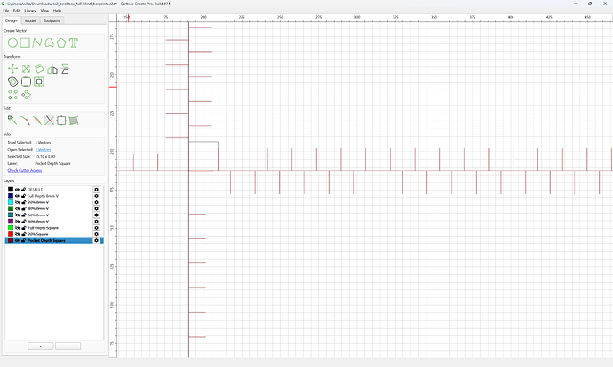

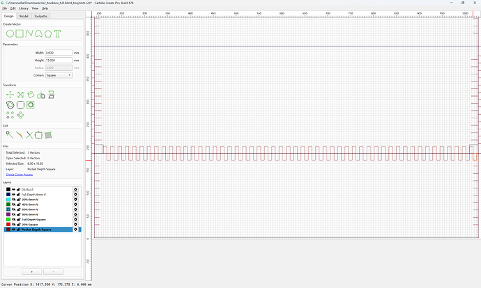

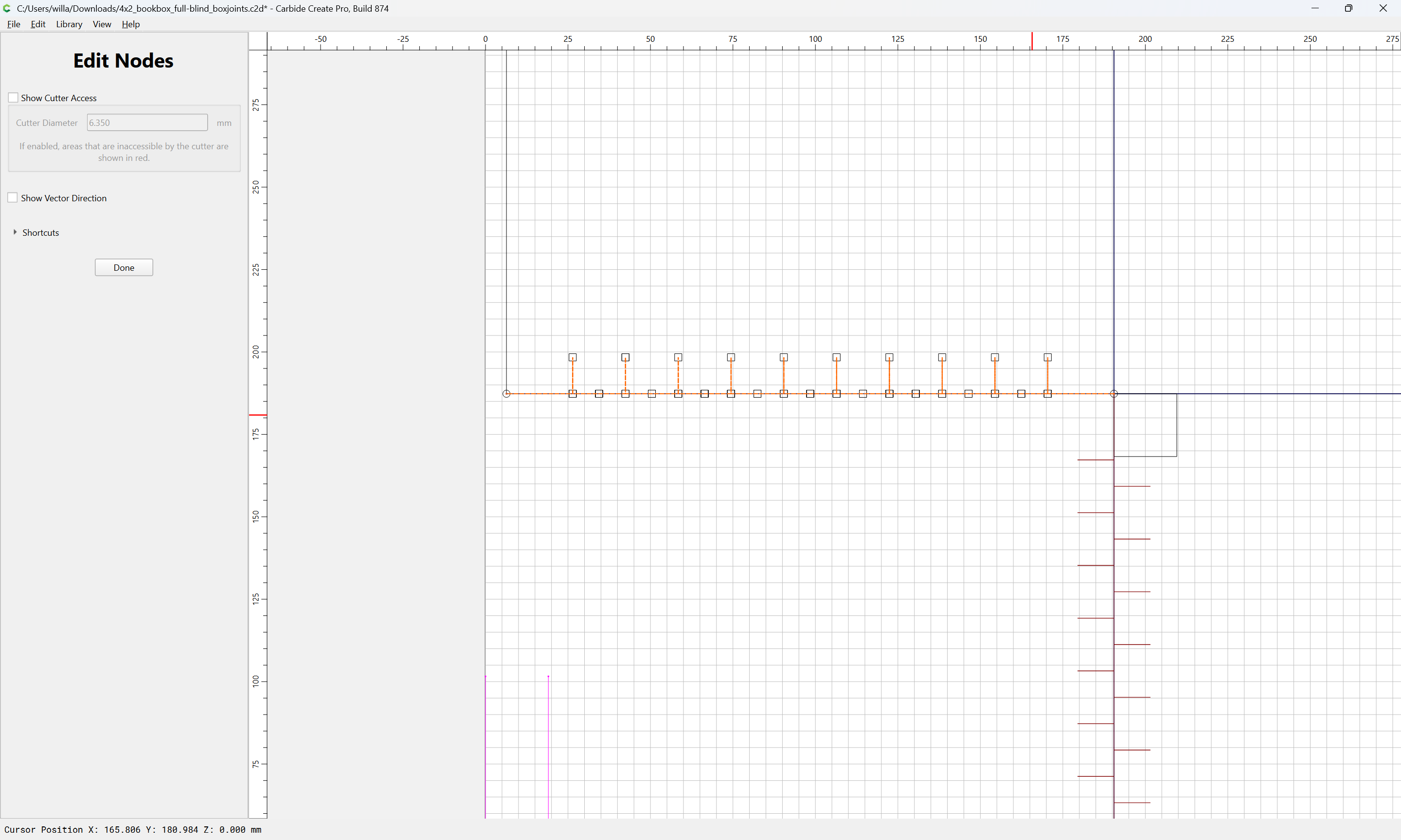

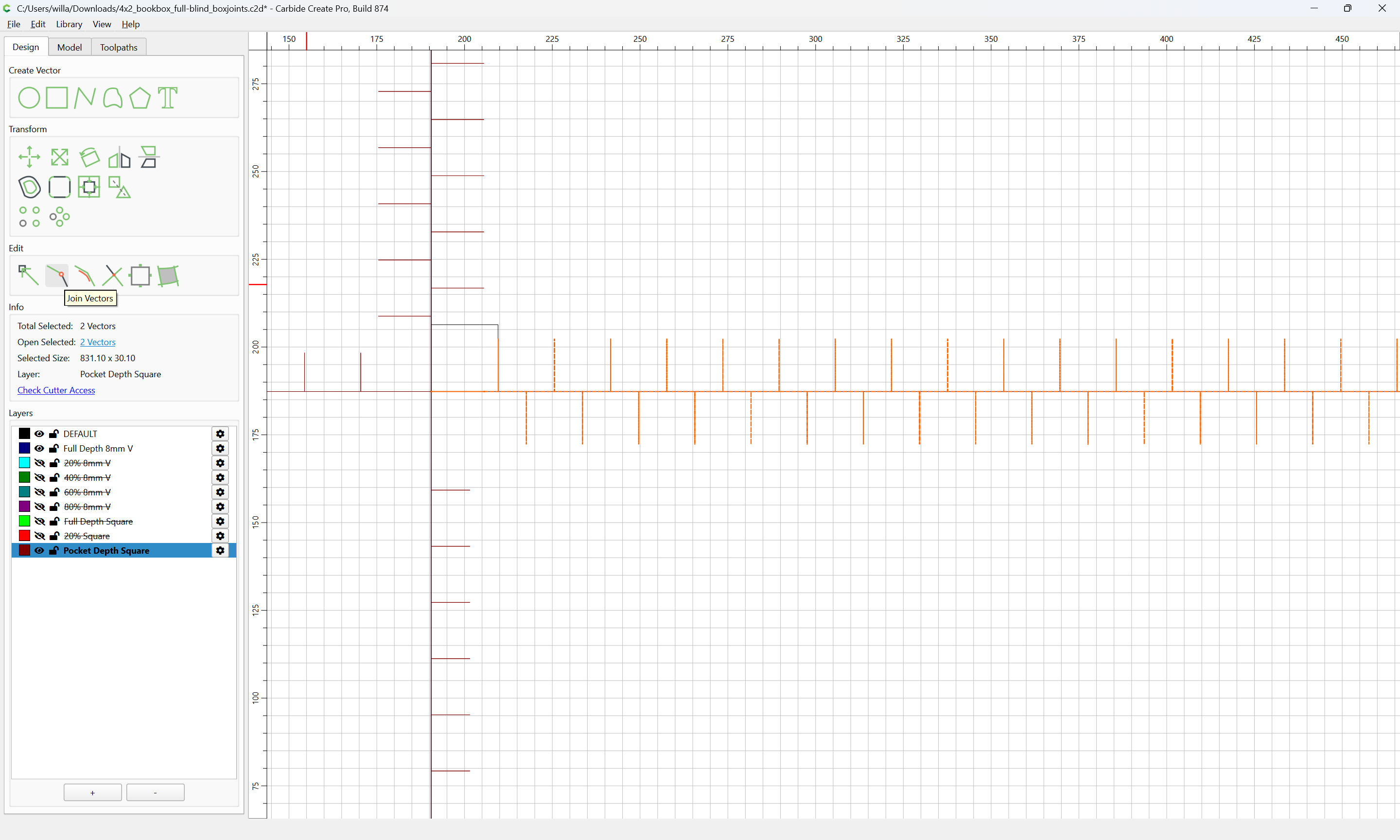

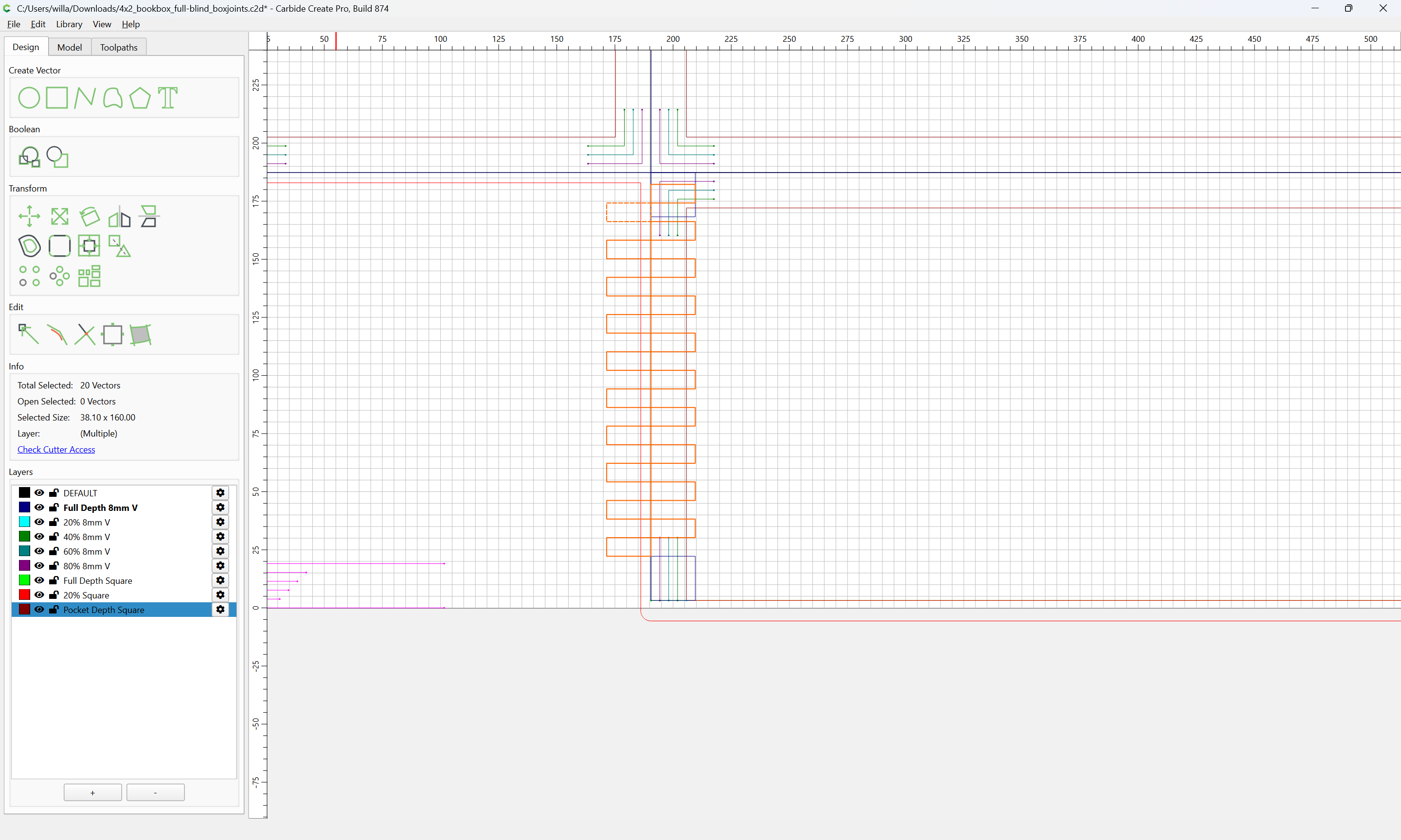

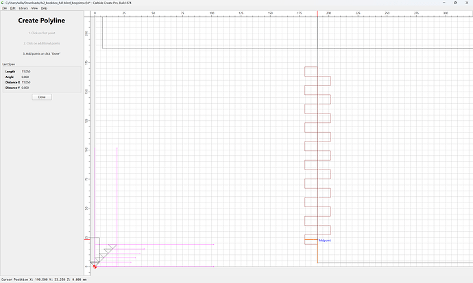

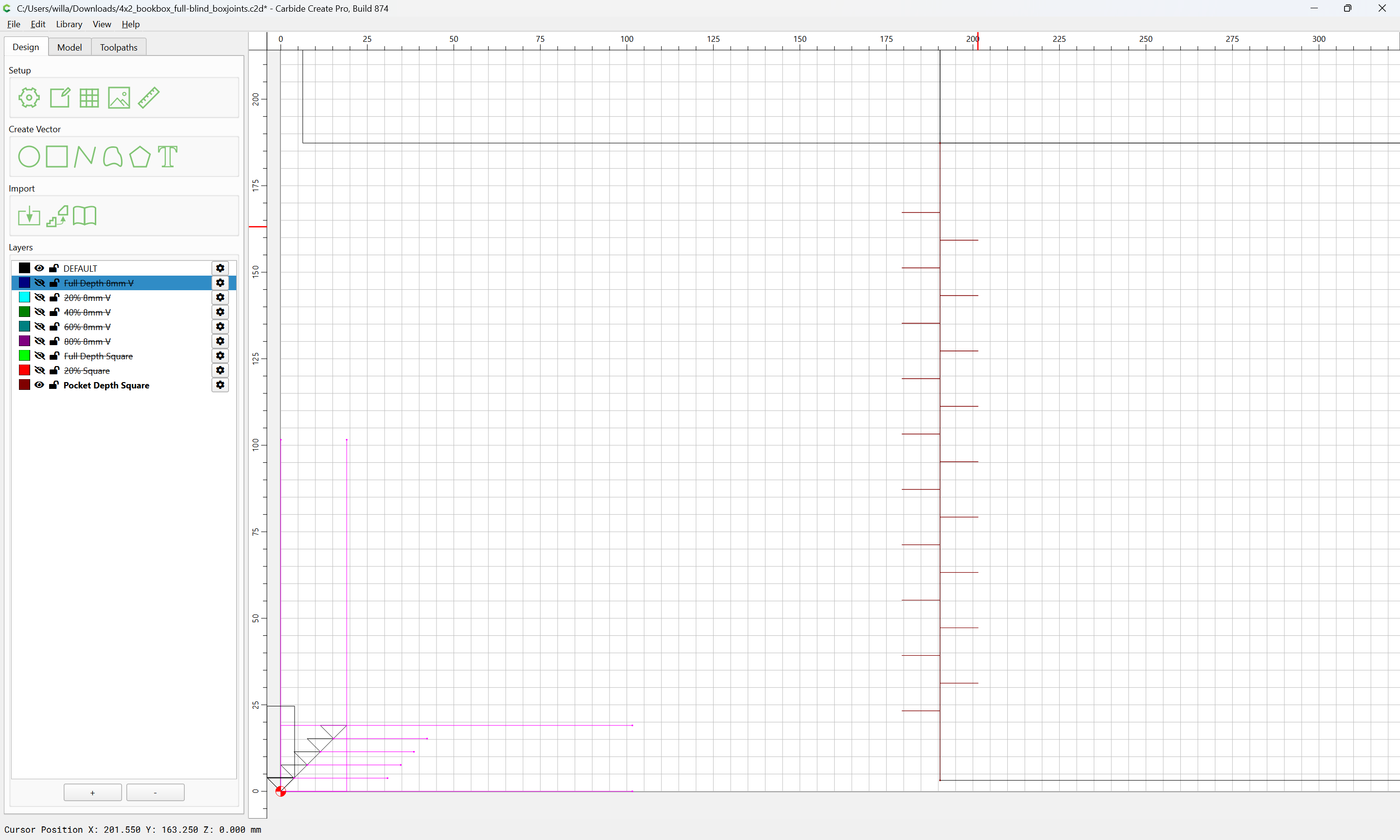

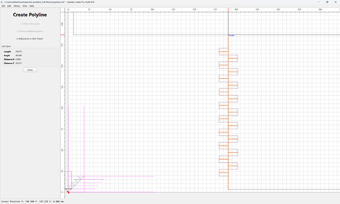

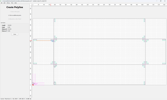

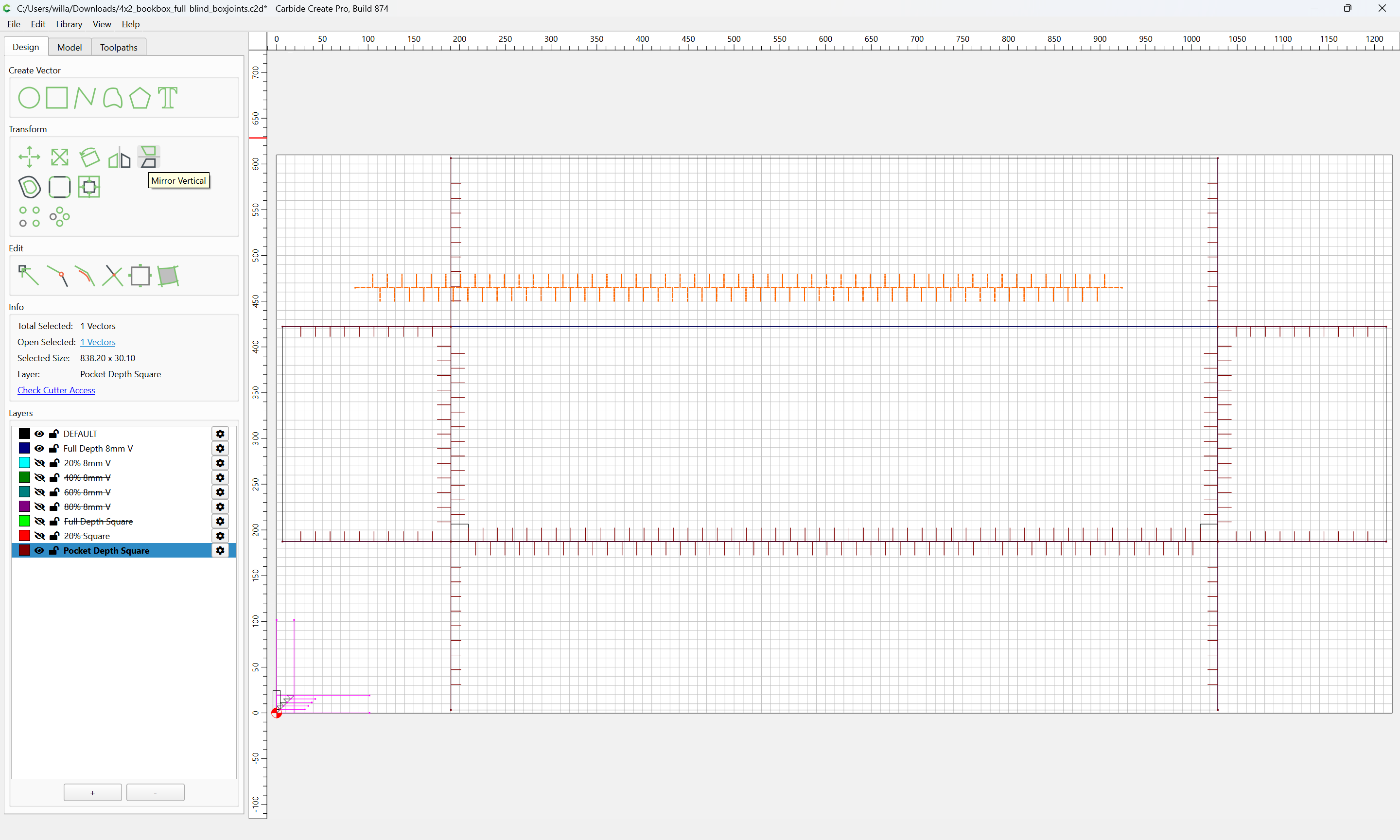

An alternative approach would be to position the rectangles which show where the joinery will be cut:
Draw one pair of joinery cuts:
Done
and use Linear Array to duplicate just that:
then node edit and clean up/extend the ends.
Probably this is pretty much required for the long edge:
delete

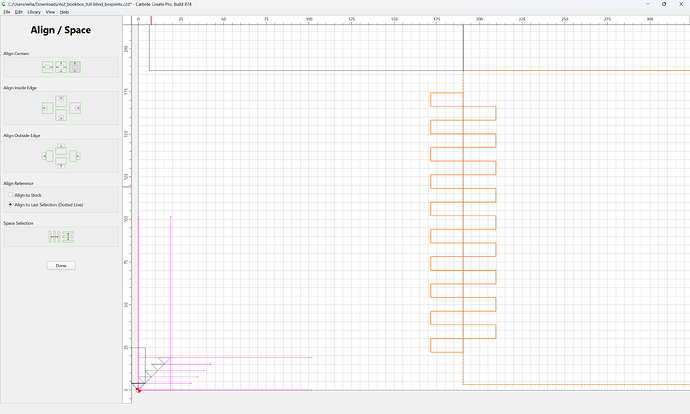

Align Vectors
Center
Done

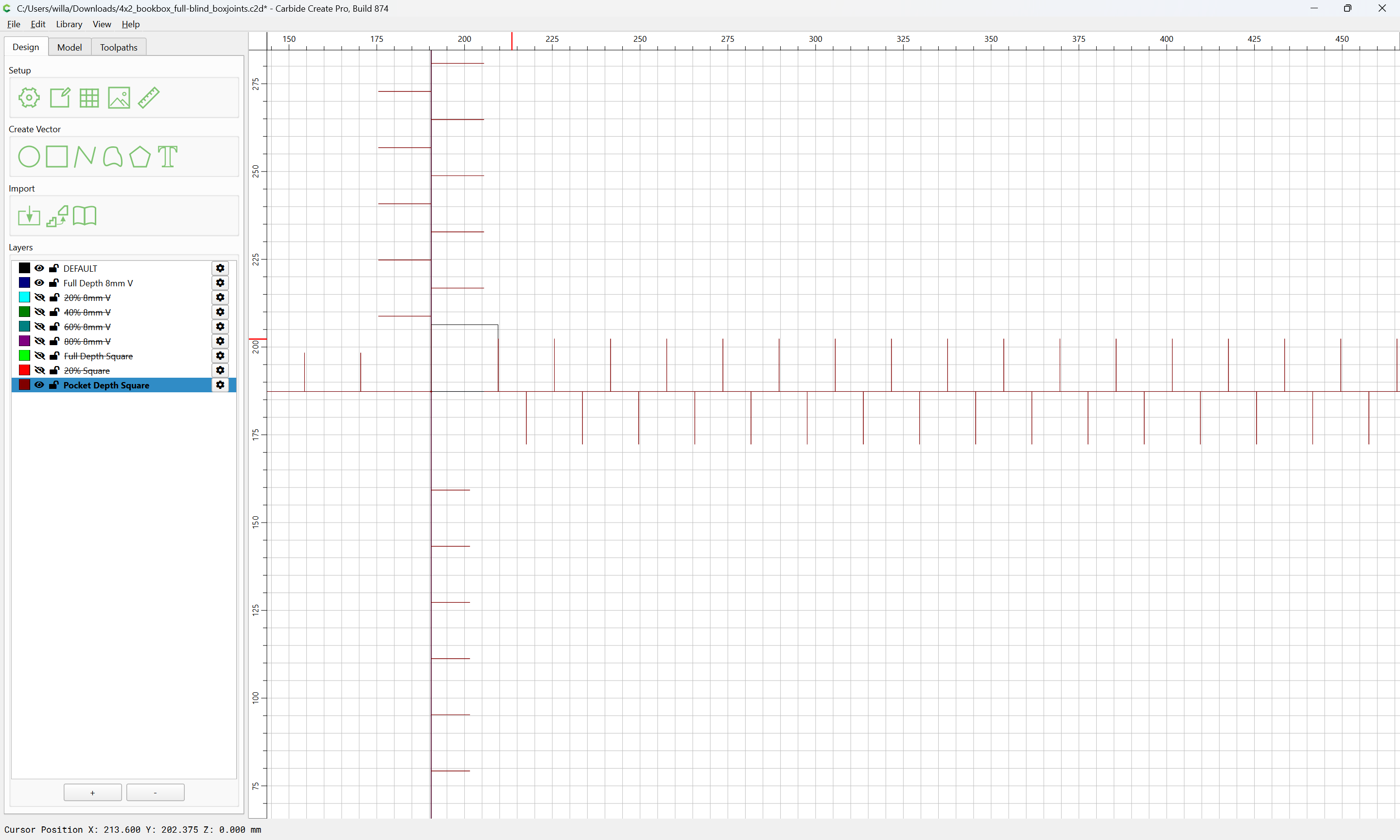

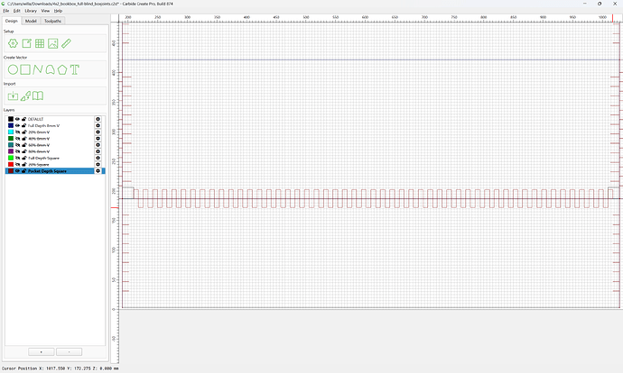

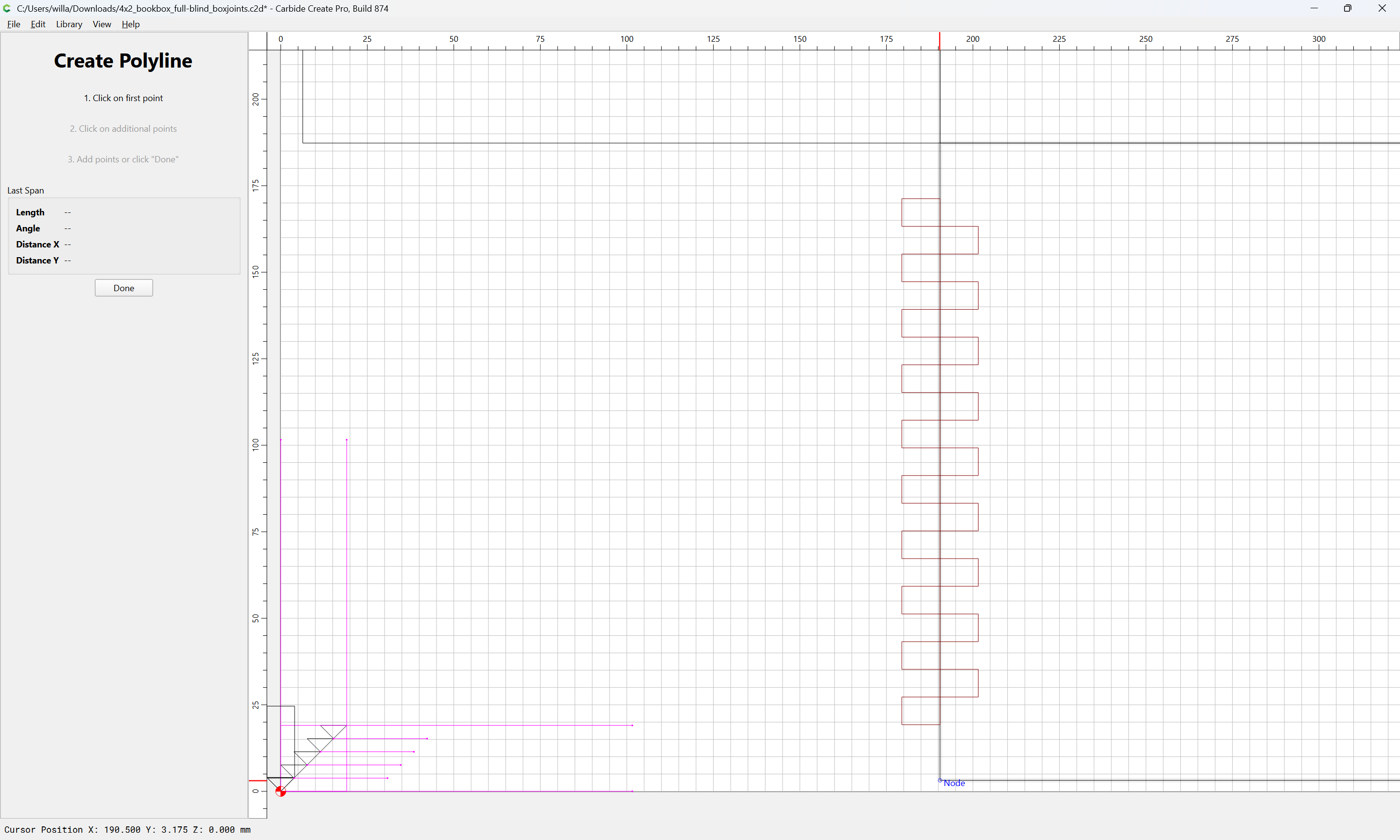

Zoom in on one edge:
and draw one unit:
Done
Use Linear Array to replicate as needed:
OK
Join Vectors
Yes
As before, delete the rectangular Linear Array:
delete
draw in the ends:
Done
shift-click to add to the selection:
Join Vectors
Yes
Duplicate
and Mirror Horizontal
and drag into registration:

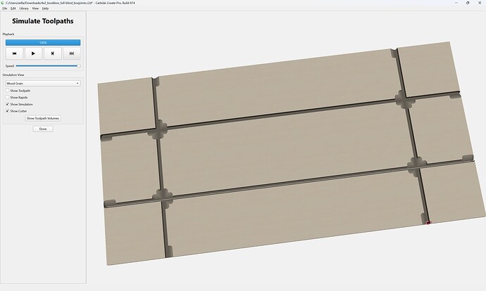

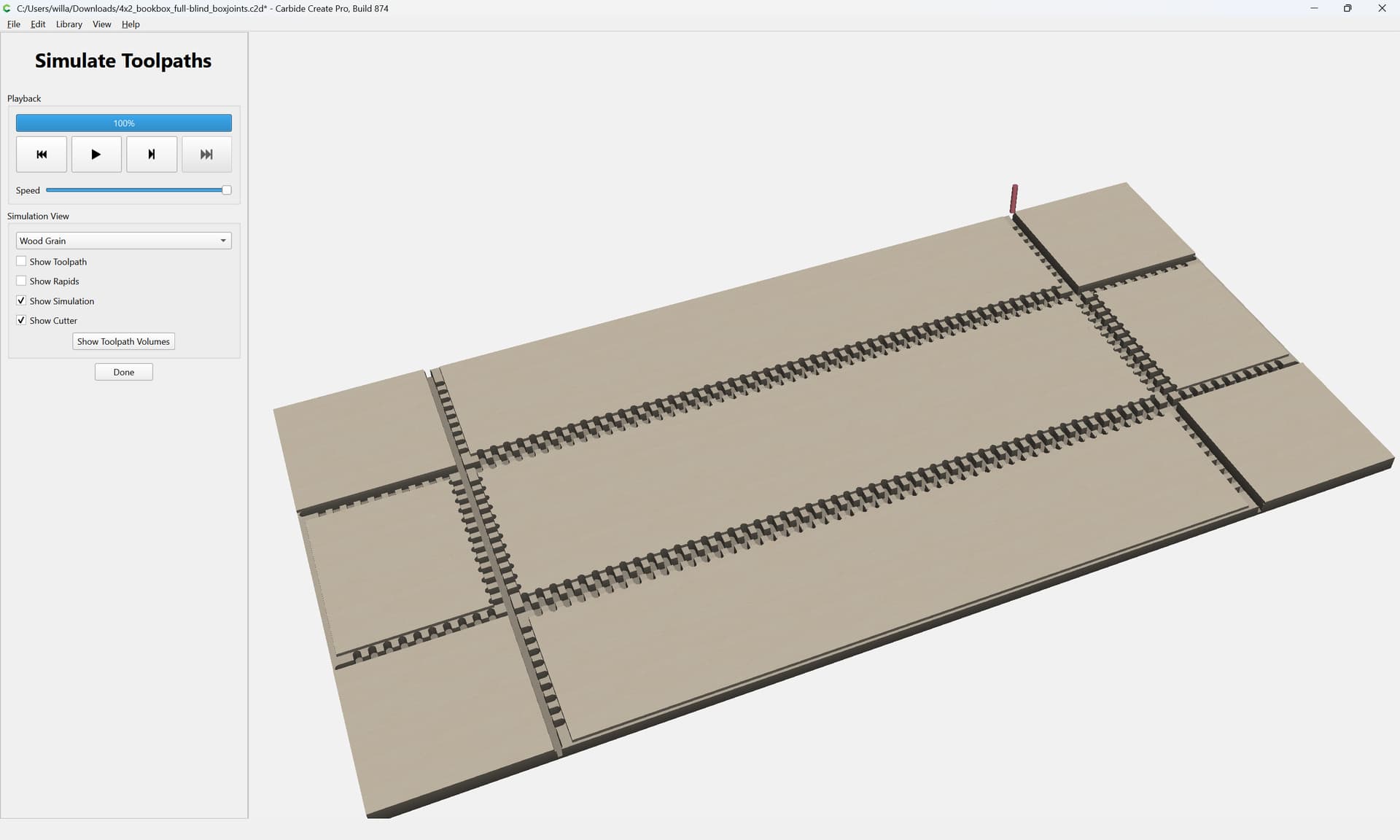

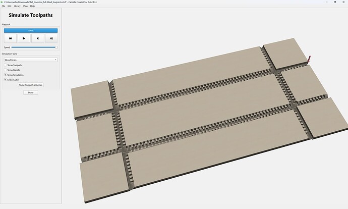

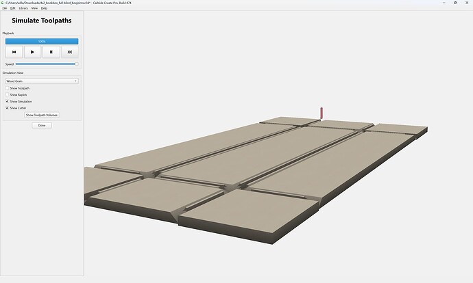

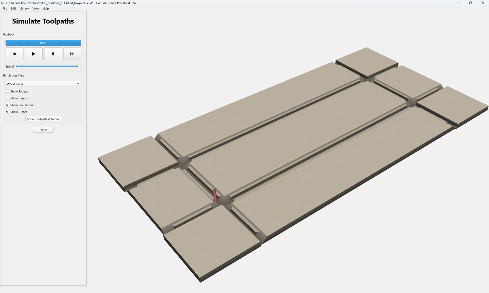

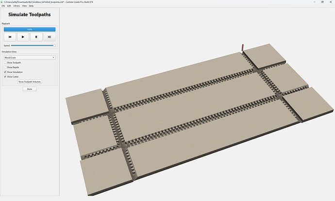

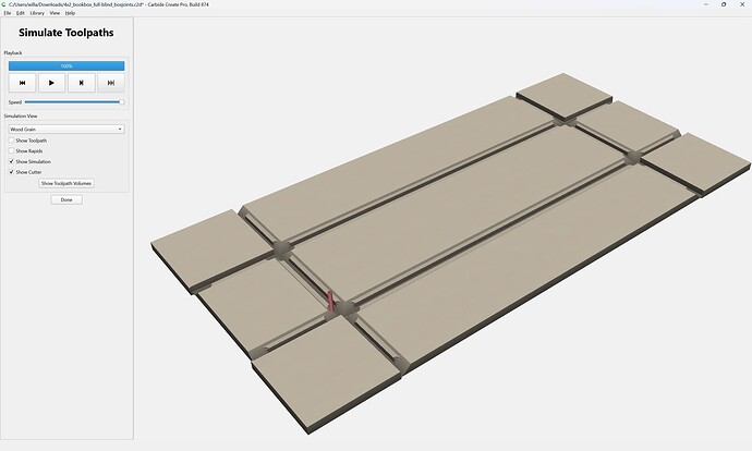

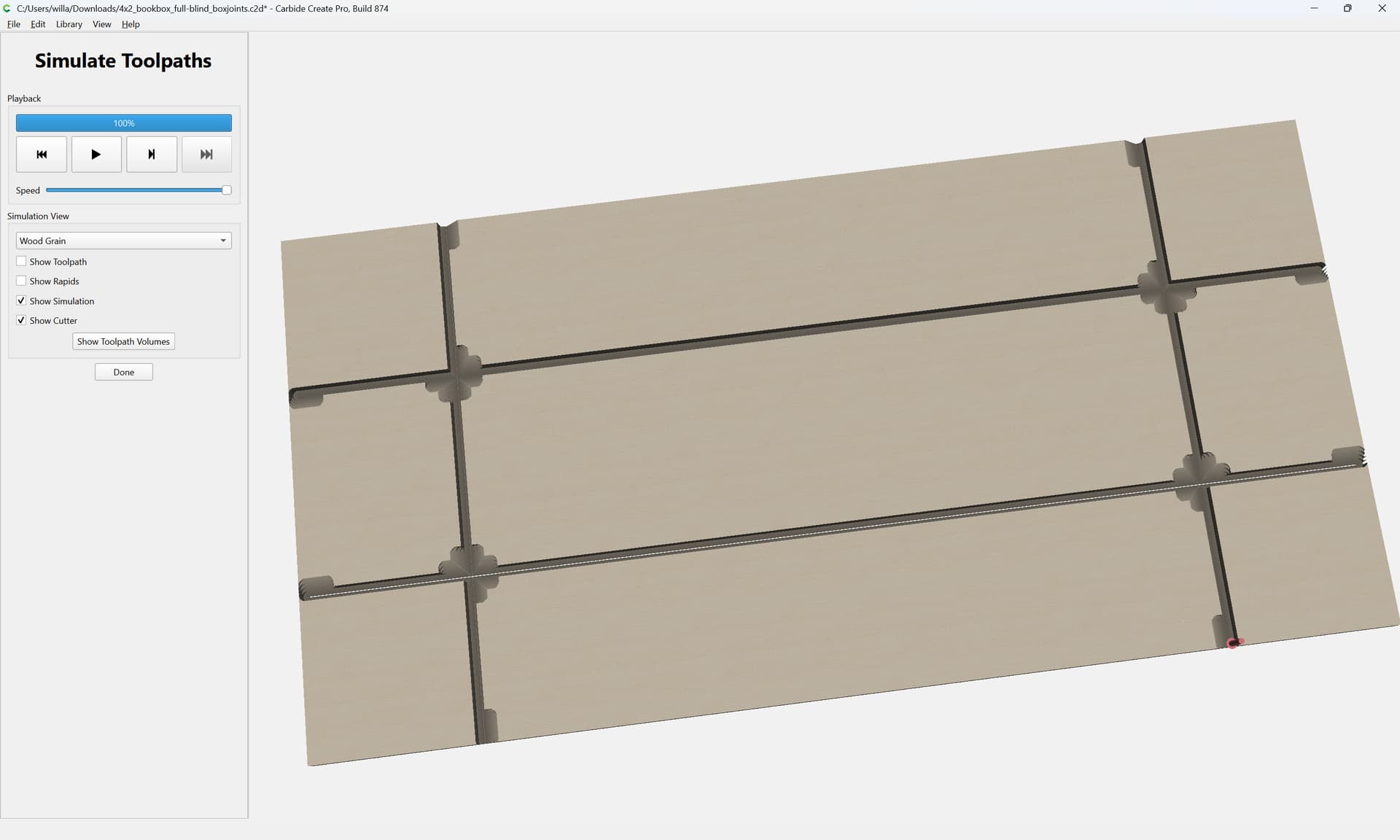

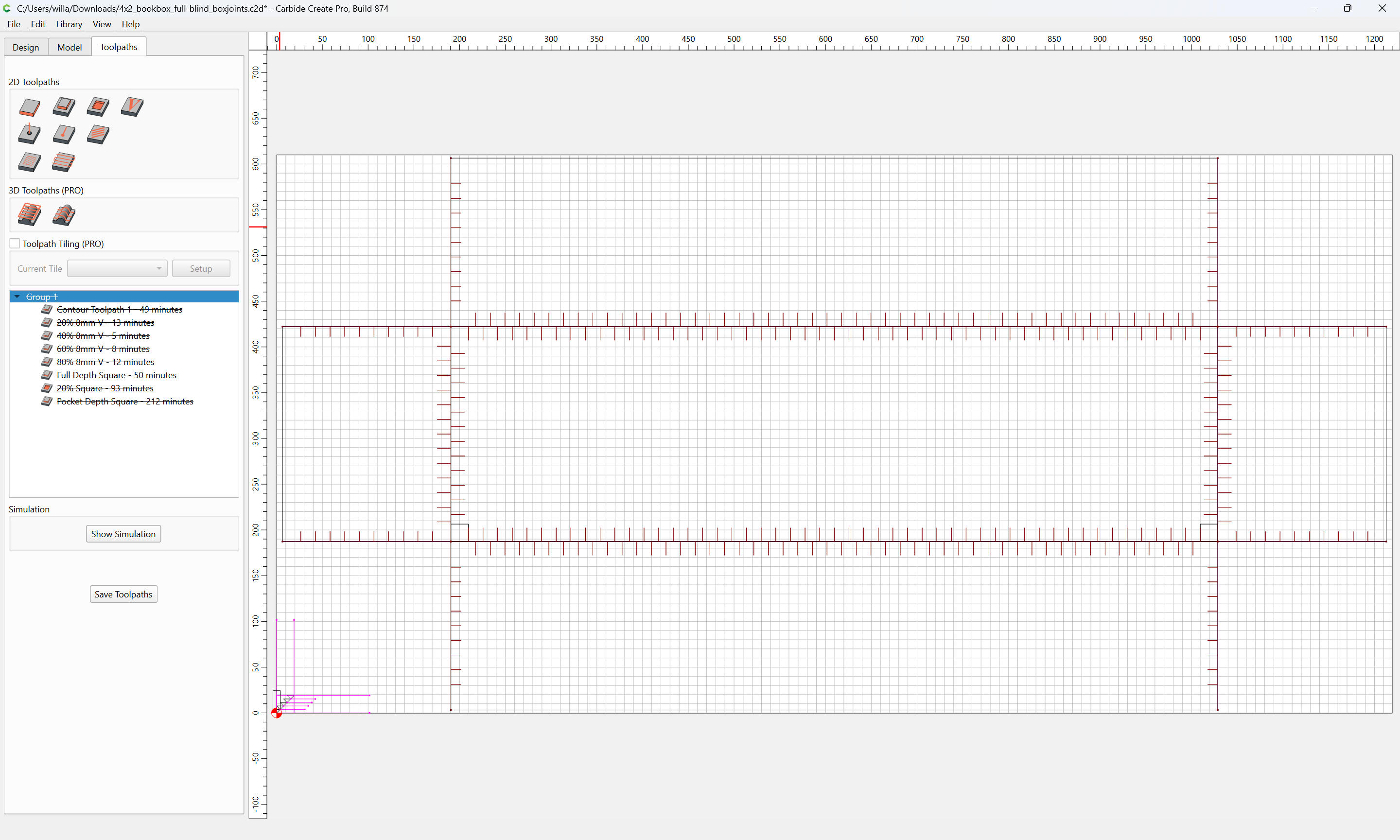

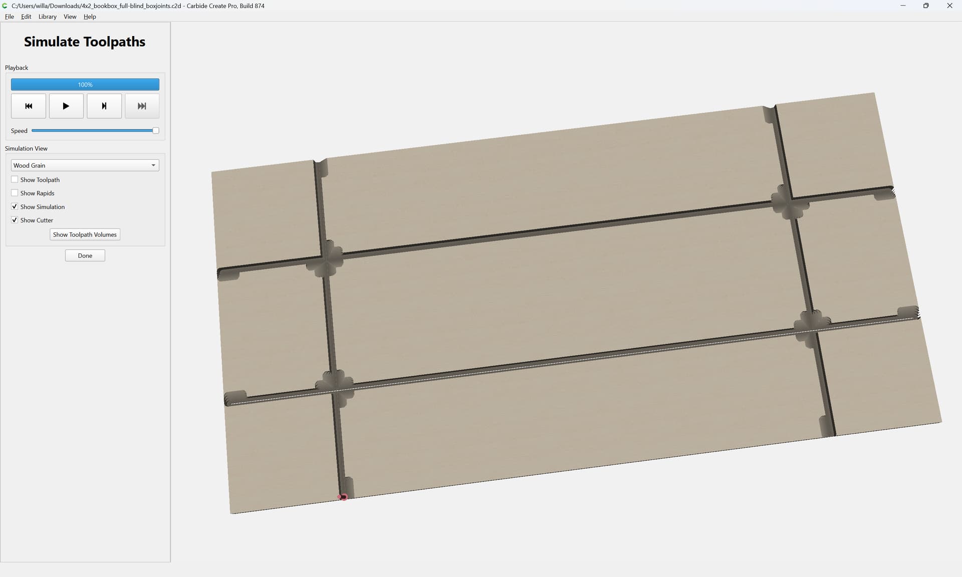

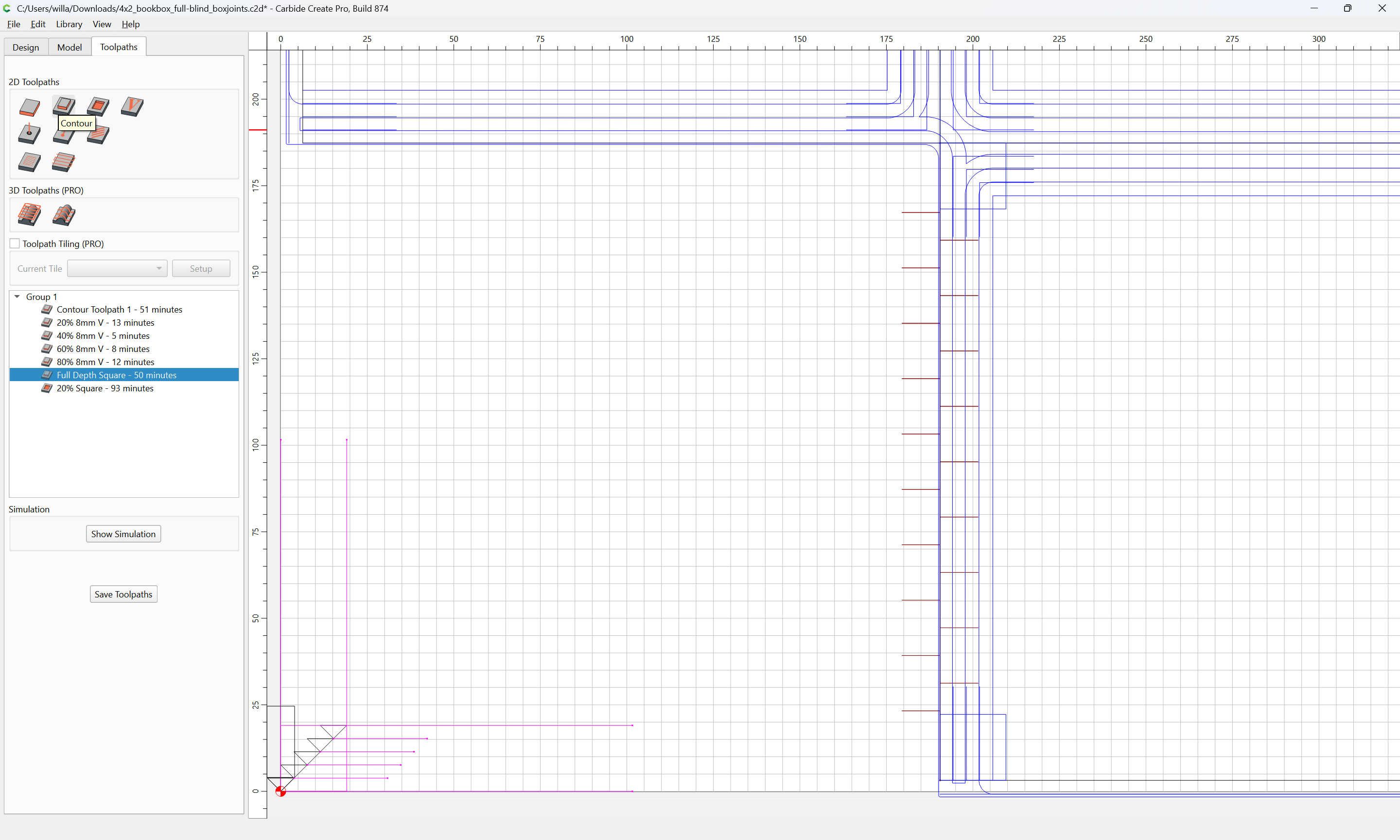

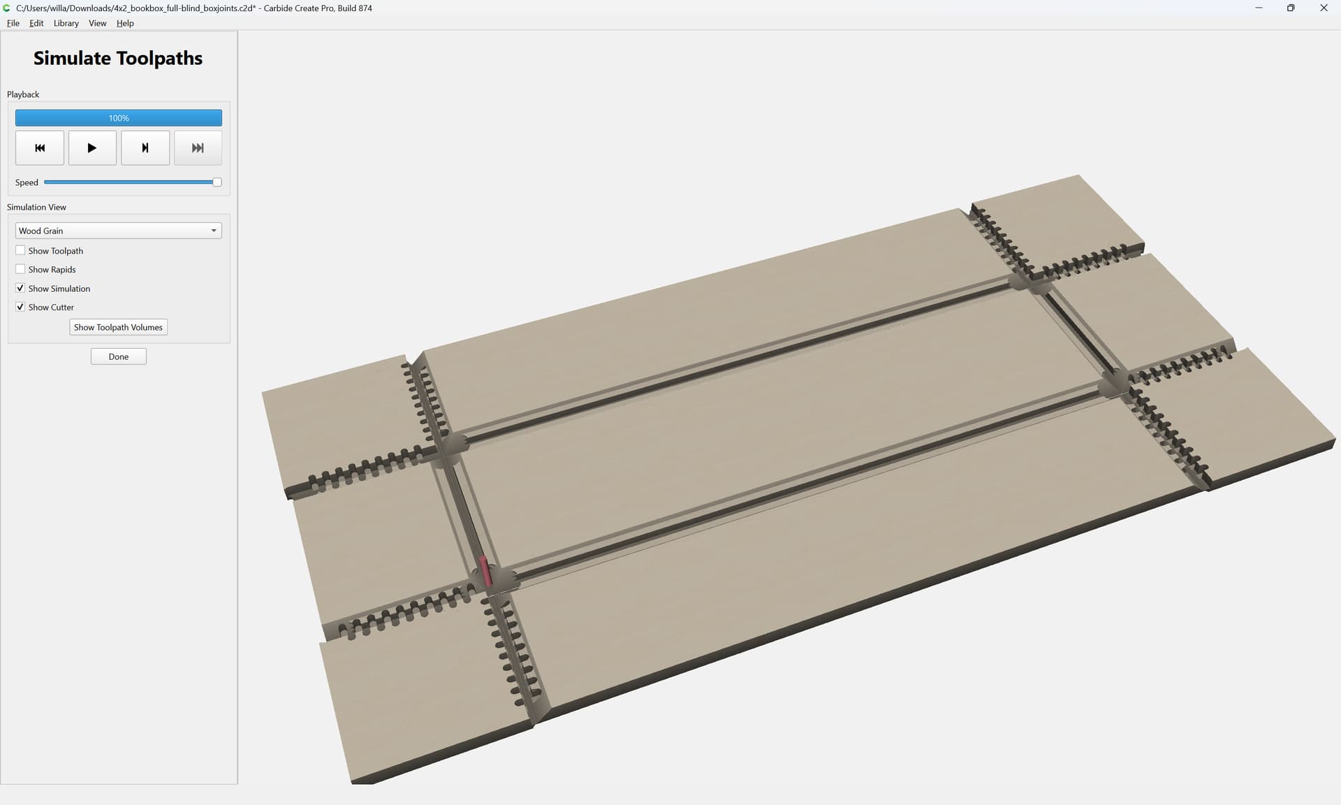

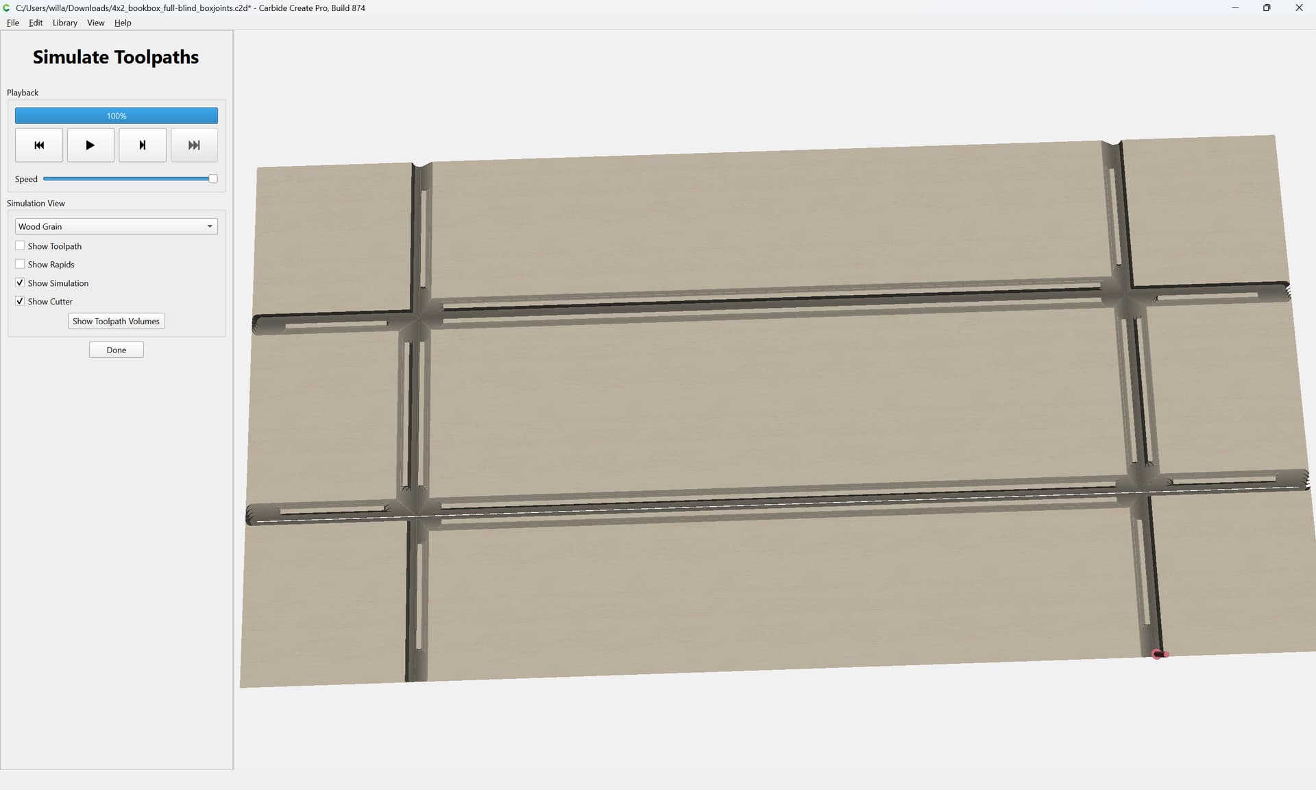

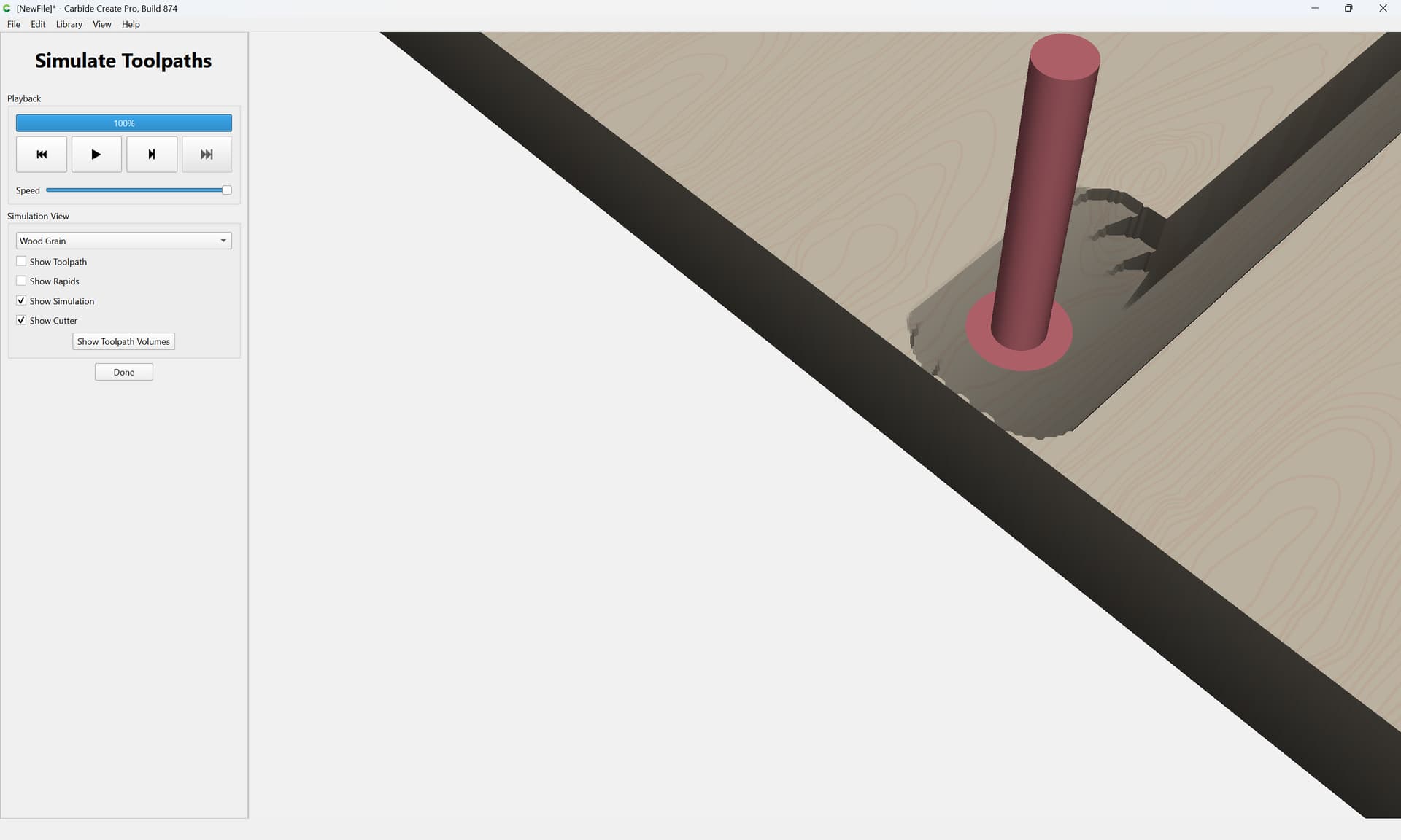

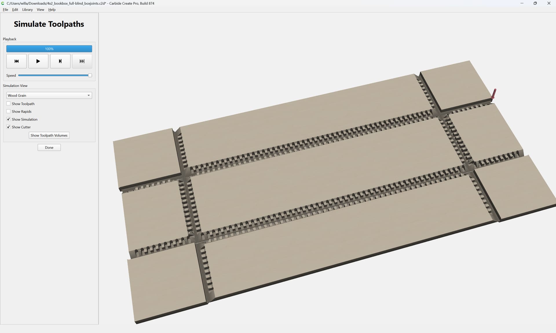

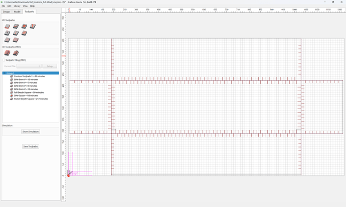

Lastly, review and optimize the toolpaths grouping them by tool used and ordering by necessary order of cutting…
Disable all the toolpaths:
and make a new toolpath group for the first tool to be used and drag in and enable the first toolpath:

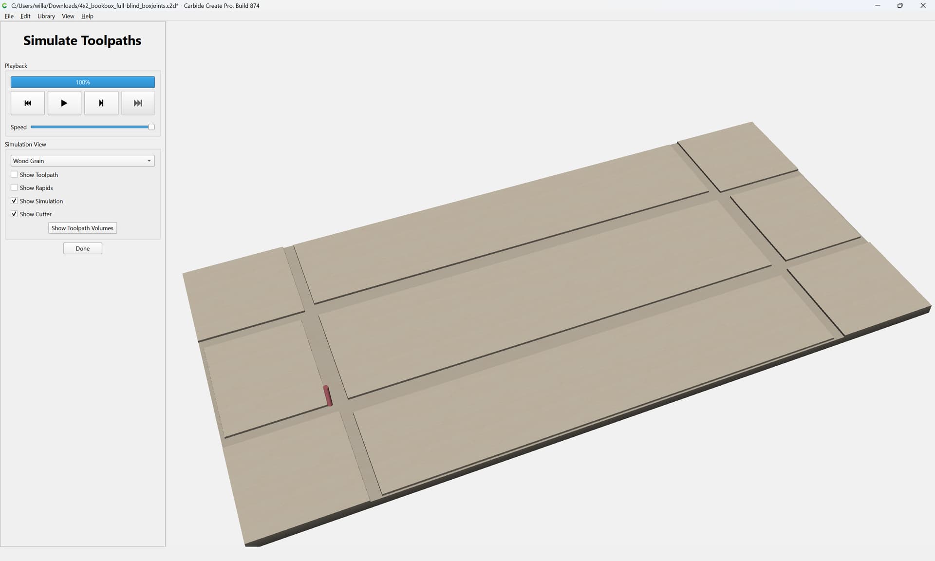

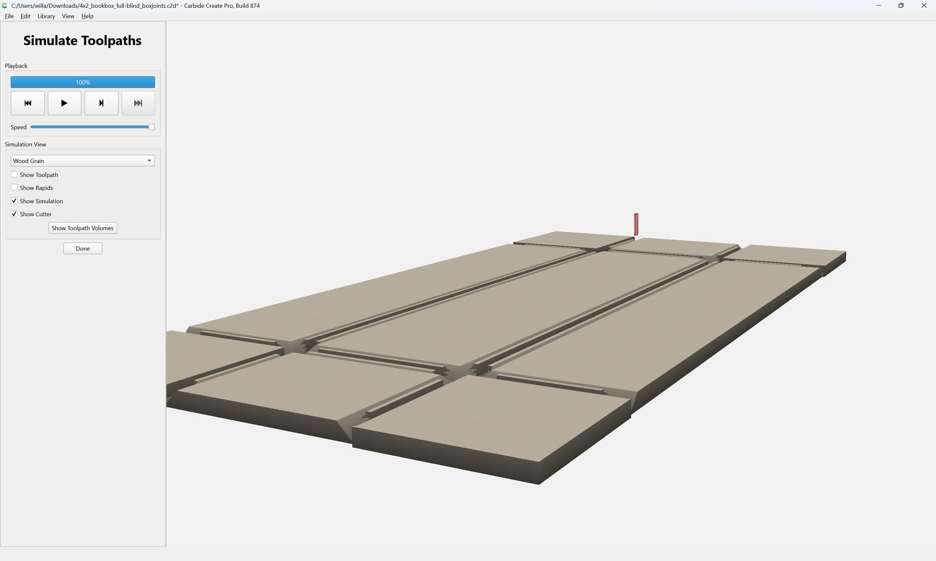

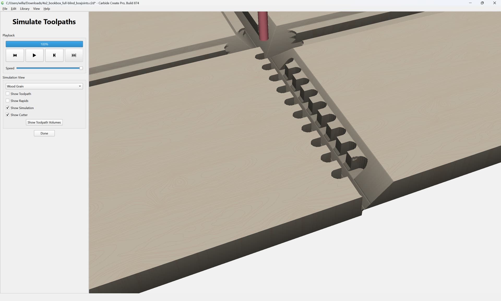

Verify the simulation:
then drag in the second toolpath and edit it to take into account what was cut previously:
For the V-tooling while half the stock will have been removed for the first pass, it will be best practice to start it at the top:
but for the balance, they may start at the bottom of the shallow square pocket:
The final V toolpath may start at the bottom of the Square cut to Pocket Depth:
netting some real time savings:
However, in retrospect, the Square Pocket toolpaths should not have been shortened…
