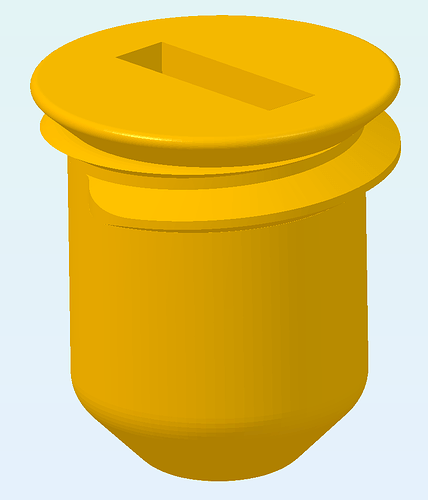

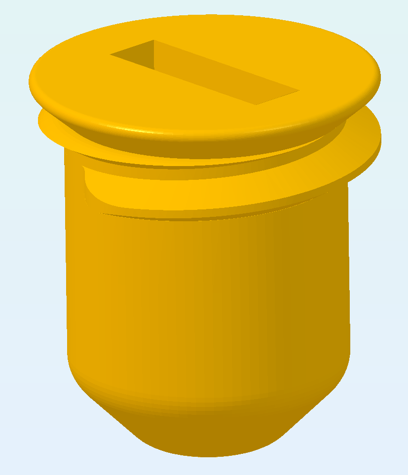

Cool find, Tyler thank you for that! (And obviously thanks to Saunders!) On small parts I enable a brim, which adds a 1-layer-thick surface to grip the plate. Did you happen to print any of the slotted version to try? For some reason, they only supply a 3mf of that version, so I’ll need to extract the stl from it. It does look like the plug should at least theoretically fit flush to the surface given its geometry (STEP imported into Atom3D here)
[edit] and here is the STL of the slotted version (likely less fastener-recess-strippable…)

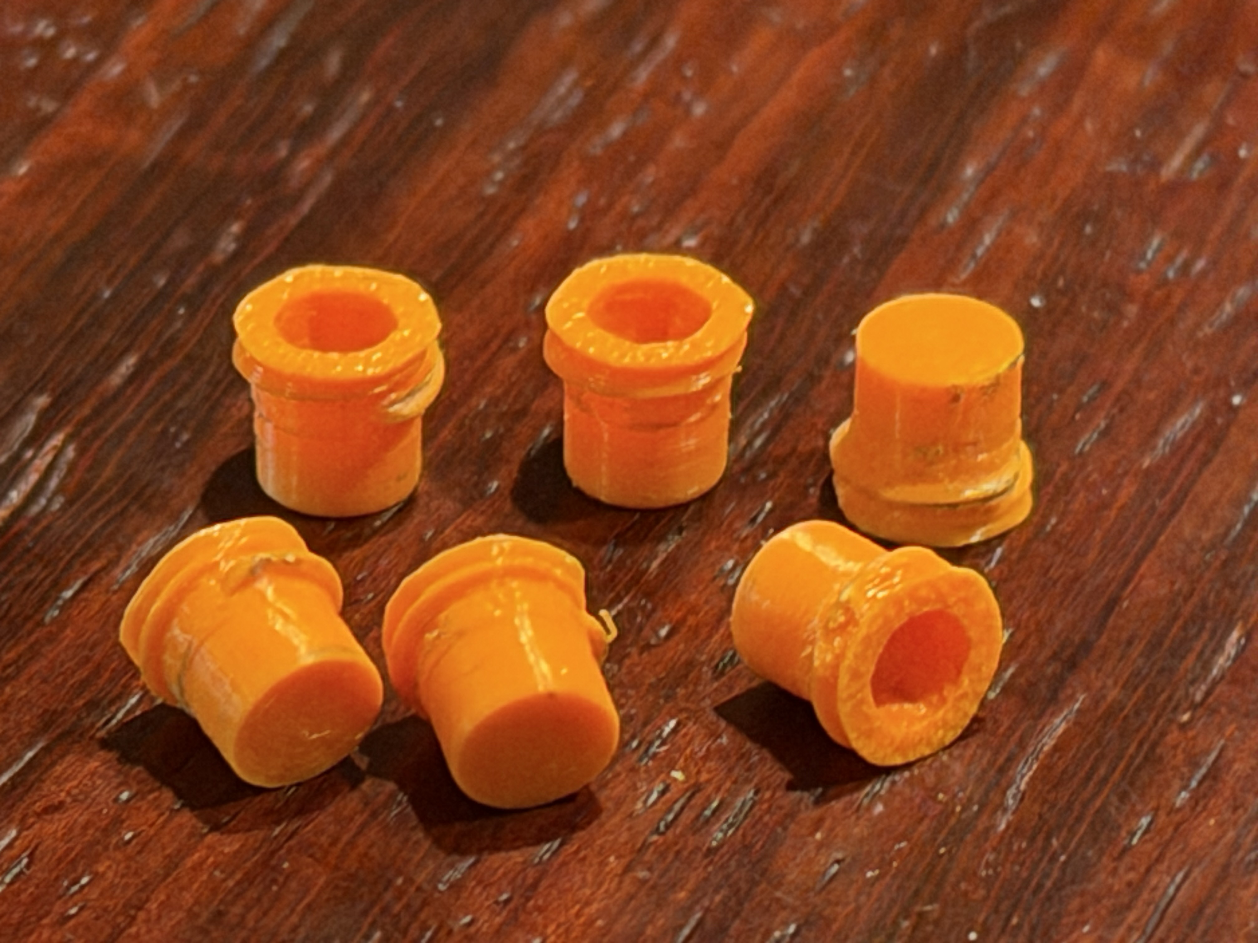

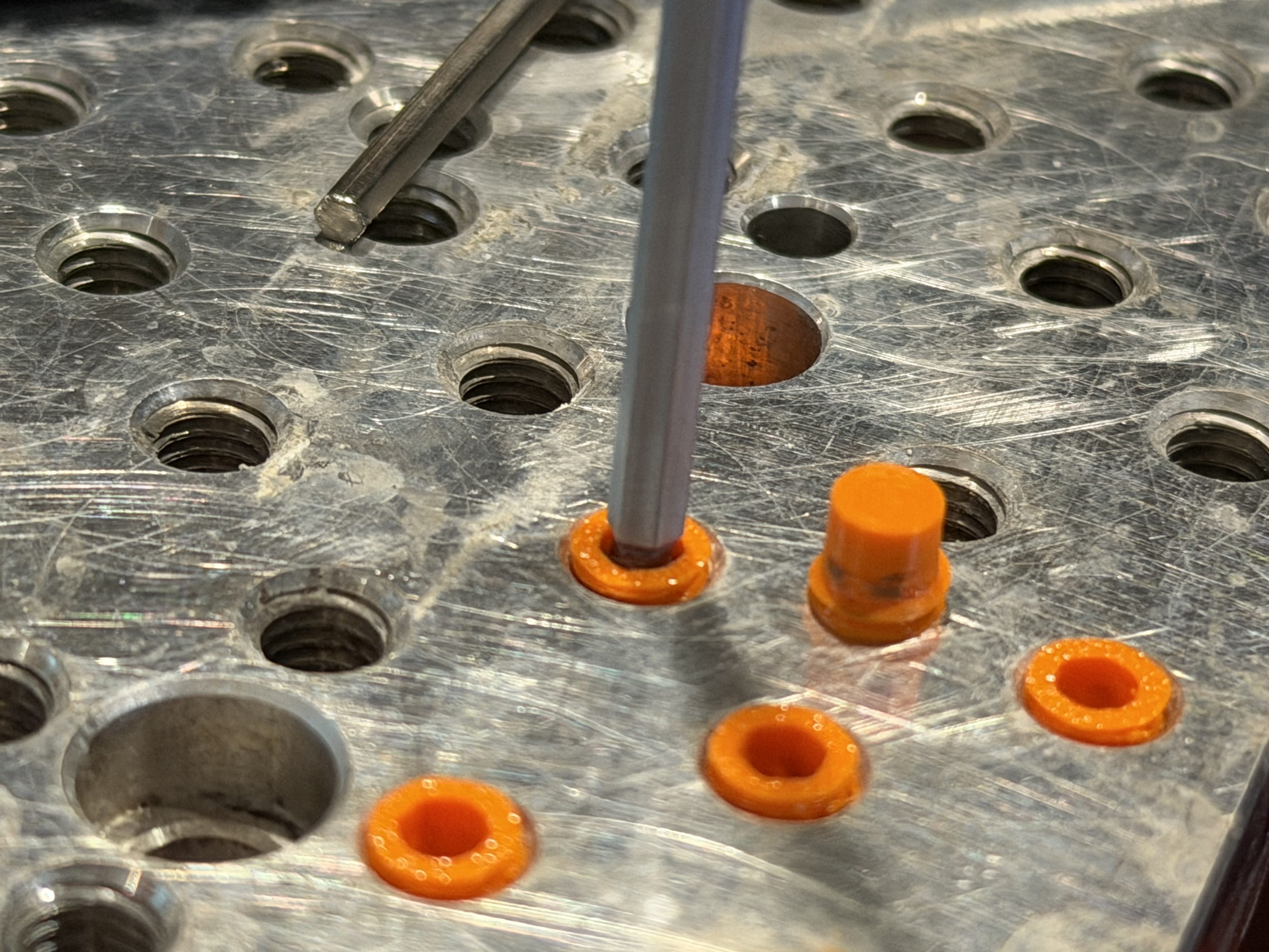

Very nice! I’m printing them from eSun PLA+. Gray is what I have loaded so they are kind of stealth in place… I kept the speed low, 50mm/s outer and 80mm/s inner for the whole part, to help my little Neptune 4 Pro stay accurate. I used a 5mm brim, which is pretty easy to pull off the part. The slot is just the right size to wedge onto a Wiha 2.5mm flat-blade, and I have no problem inserting them below flush without using a lot of torque. My first plate was 7 just to try, and I have another 25 printing now, which will be just over an hour (but it is not my time–I’m doing other stuff!) I’m doing print by part rather than print by layer, so 25 is all that Orca Slicer will let me place on the plate at a time.

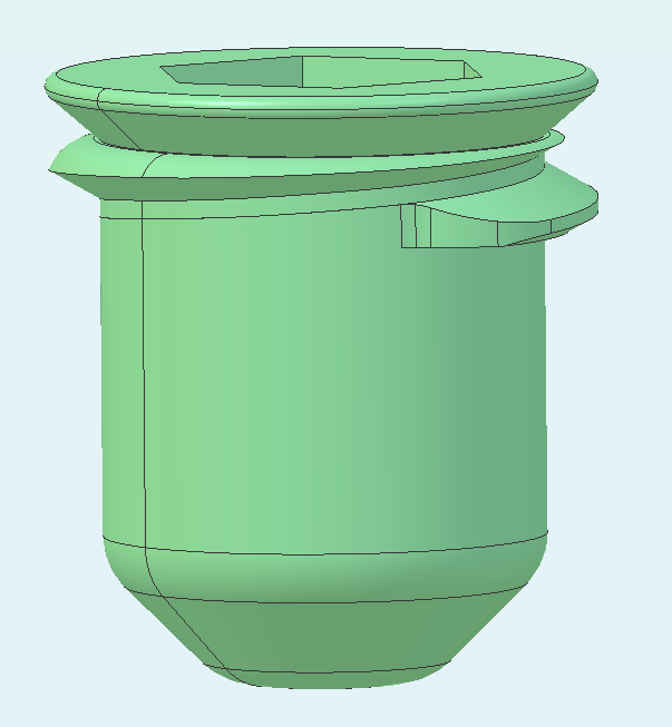

Given the recent threading post from Nathan, I’m going to take a crack at a milled version. Just for fun.
I’m mostly interested in learning how to put a Higbee start on that thread :slightly_smiling_face:
My mistake–the off-grid holes are unthreaded dowel pin holes. Only the 80 grid holes are threaded. I’ve gotten adventurous and am printing 80 more plugs, layer-at-a-time so they are all grouped together on the plate, using 100 outer and 200mm/s inner speed except for the slower first layer. The brims all run together. And I really need to do a bed leveling–the discrete brims on my first set of parts varied widely in their peel-ability. Some pulled right off and some I needed to use a side-cutter on…
I tried printing a batch of the plugs from 85A TPU to use in the non-threaded holes. Not a win. By the time I got the plug pressed into the hole, it tended to pop below the surface and I needed to use a dental pick (the “weeding” tool I’m using for the vinyl cutting) to extract it.
