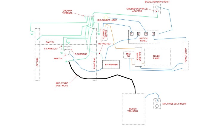

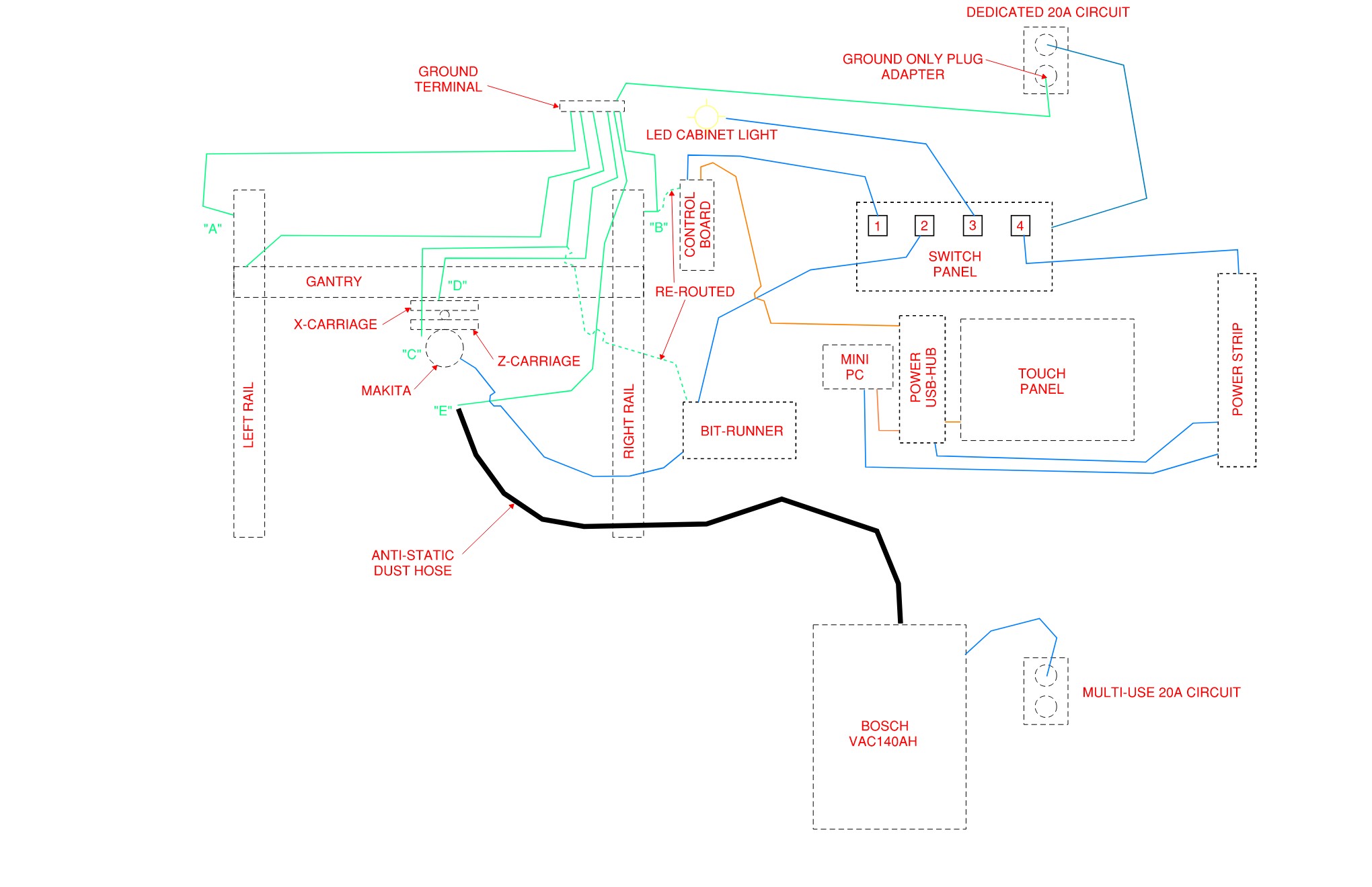

Attached is my crude sketch of my setup.
I have grounded the left rail, right rail, gantry, z-plate (left/right), z-plate (up/down), router mount and dust hose (center wire), individually back to a common ground terminal. All connections are screwed tight with soldered rings connected to the wiring. The ground terminal connects to a ground only plug on the same dedicated circuit that this is all connected to.
The original ground wire from the router mount to the bit-runner has been disconnected, since running it to the common block.
The original ground wire from the right rail to the control board has been disconnected, since running it to the common block.
My main power to the equipment is as follows:
From my dedicated 20A circuit runs a plug that connects (4) toggle switches to (4) individual outlets mounted to my cabinet. Switch 1 sends power to the Shapeoko. Switch 2 sends power to the bitrunner (router). Switch 3 sends power to an LED light in my cabinet. Switch 4 sends power to a surge protector power strip. The power strip powers a MeLE Mini PC and a powered usb hub.
My usb connections are as follows:
From my MeLE PC runs a usb cable connected to the powered usb hub. From the hub a usb cable connects to a touch screen panel. The usb is carrying both power and data to the panel. From the hub a usb cable connects to the shapeoko control board.
I have a Bosch dust collector that is powered on a separate circuit. Occasionally I will power the Bit-Runner through this since it has auto on/off capabilities.
I have run with dust collection and without.

Looks like you’ve got any static charge issues handled. So I would troubleshoot the USB connection.
Could be just the USB connector rattled loose in the control board connection. Could be the powered USB hub glitched a bit. I would start by eliminating the powered hub between the PC & CNC controller. Having the display/touch data & CNC controller communication all running through a single USB port on the PC seems a possible point of data bus contention.
