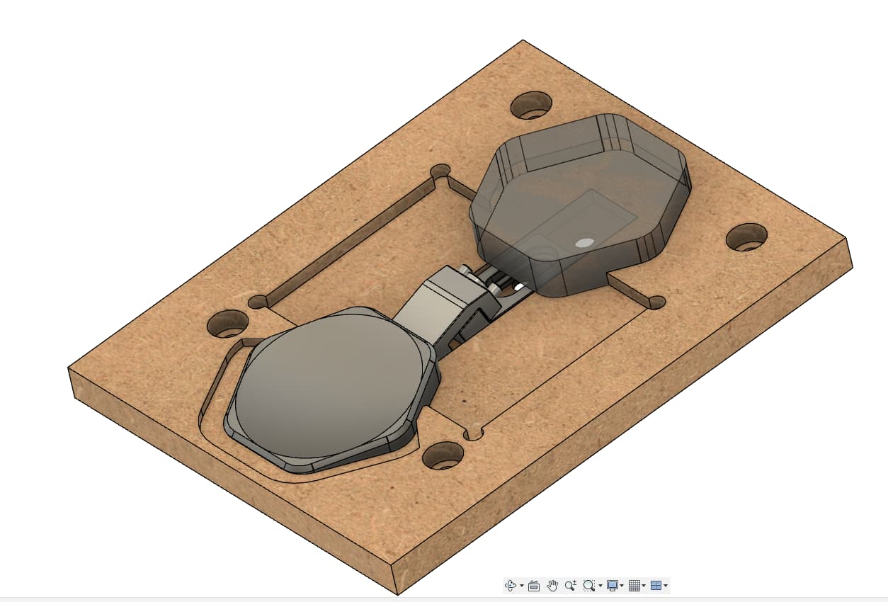

i designed this fixture intended to be made from MDF to hold the stock, and be mounted to the threaded table.

You need something adding side force to pinch against the pocket or painters tape tape glue holding on the bottom or it’s going to come loose.
yeah, im not sure how im going to go about that. theres not a whole lot of material to hold onto once it gets to that second sided op. i can adjust the program zero to the top of the stock, but if it comes loose or something happens i have no way to re-set the zero point, or account for the thickness of the double sided tape. i might have to think on that a bit more.
unless i was able to put the pocket at an angle, then the coin would be able to sit further into the pocket.
I would painters tape glue the stock to a flat base and adaptive the out side so you have a hexagon blank. Set Z zero to the bottom so you don’t cut past the tape.
Then contour to finished dimension surface it and do the flat side logo machining and chamfers. This will allow you to use the tape glue method again for the back side work in a shallow pocket. just make sure you add some relief to get a tool under the piece after to pry it up.

The point of cutting the hex out completely on op 1 is so you don’t end up with a top hat of material left to machine off on side 2. I find milling off a top hat adds a lot of extra stress to work holding and if you can avoid having to do so helps greatly especially if your work holding is not very strong.
Think about your jig and modify it something like this one I made to hold a round piece. I cut a slot on the table saw (or the CNC). This way you can either put a clamp on the jig or you could drill in a threaded insert and put a long bolt all the way through to hold it in place. I was going the threaded insert route but at the last minute just put a clamp on for this one time project. The holes were to secure it to my spoilboard with 1/4-20 bolts. My project was about 2" tall so I put spacers under the jig to lift it up enough so the round part was high enough to vcarve.
For the second op, if you use a thicker piece of MDF, you could probably make a pocket to mostly-recess a tiger claw clamp. Rotate your coin 90 degrees, so the thicker side points to the left or right where you have more room to integrate workholding.

Laminating two sheets should work. Here’s a visual for what I was trying to describe. Except use a tiger claw instead of a static Gator clamp to apply lateral force. Also, you might want to pocket away some MDF on the thin side of the coin to give clearance for finishing endmills to work.

i think this might work, this drops the pocket down further, and lets the tiger clamp live within OP1 pocket, and secure itself to the threaded plate below, and cuts out a recess around the lower areas.
i would love to be able to add a tiger claw model into there to made sure fusion knows to avoid it. (a few of my toolpaths will probably hit it i think.

I forgot that support sent me a tiger claw model when i asked for the Nomad Threaded Table Model to use as a fixture reference, so i was able to add one in and select it as part of the fixture which is cool. Now i can actually see in the simulation that my toolpaths will miss it rather than trusting my math alone.
aaaand i adjusted my fixture…again. because i was thinking that if i decide to make some other type of coin and do a production run (my thought process is i really like how this coin fits in the hand, and it could be a fidget object of some kind) that if i was able to batch process a bunch of stock, and be able to leave the clamp in place when running the actual operations on the coins that would be more efficient, and machining the fixture itself would take less time to have it change between the multiple pocket depths.
shown here, the first op stock can sit above the tiger claw clamp and leave it in place, and wont come close to it during machining
and shown here, the main pocket is now all one level, rather than being 3 separate levels, and should provide plenty of support for both the first and second operation.
