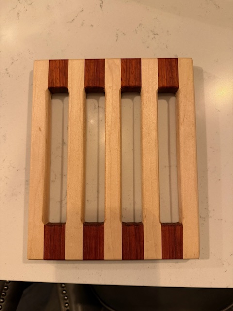

Making a trivet from scraps
as requested on support…

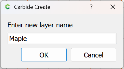

…glue up 9 pieces of 3/4 inch wide by 10 inches long strips of maple and walnut and leave about 2 inches on each end and cut out the inside, every other one.

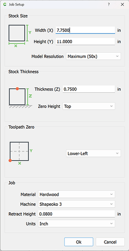

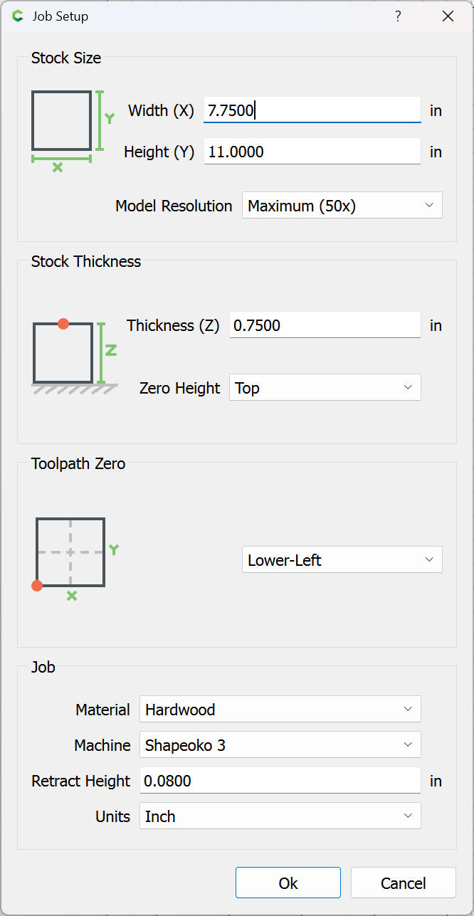

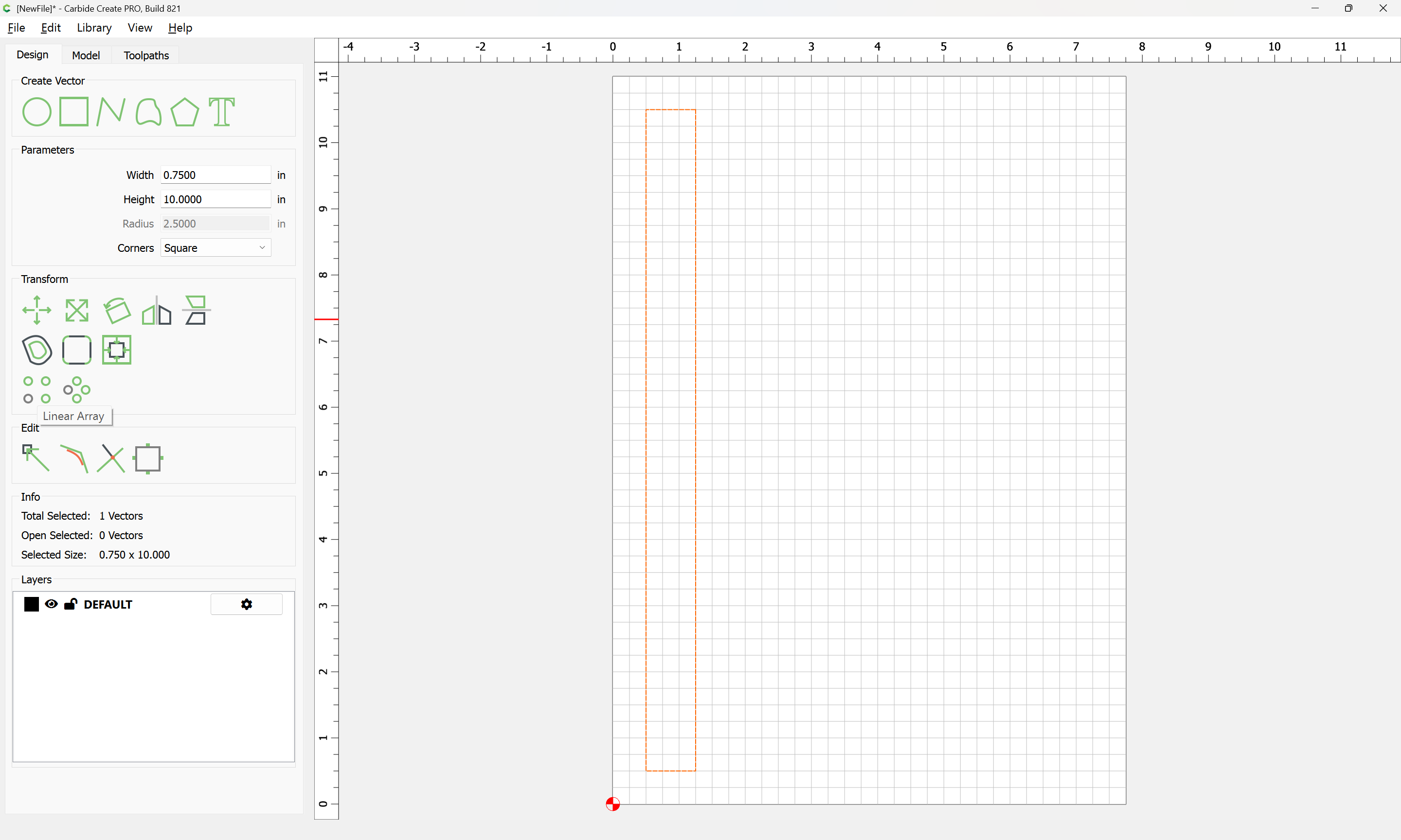

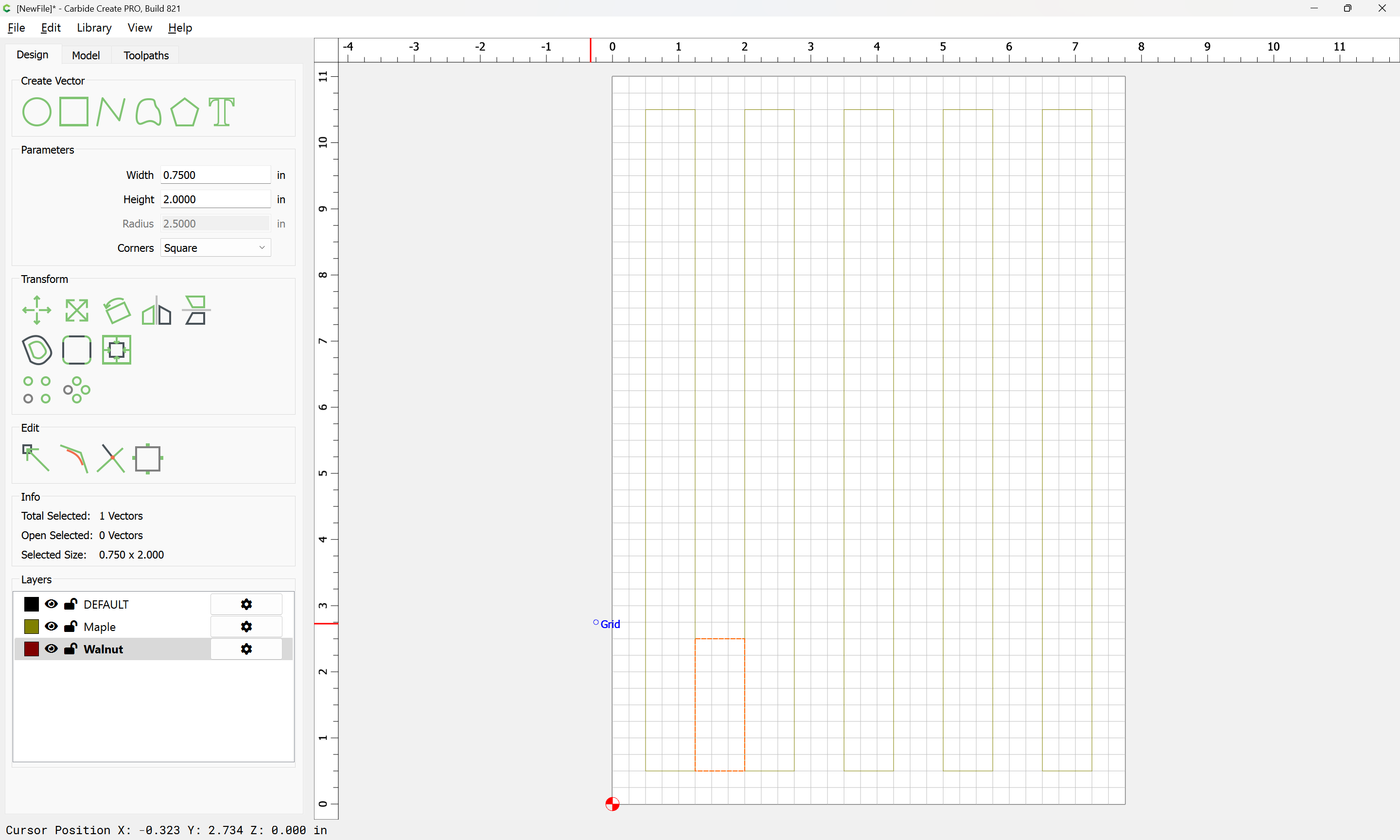

Basically, what one does is draw up the glued-up stock, and then set up the cut to match:

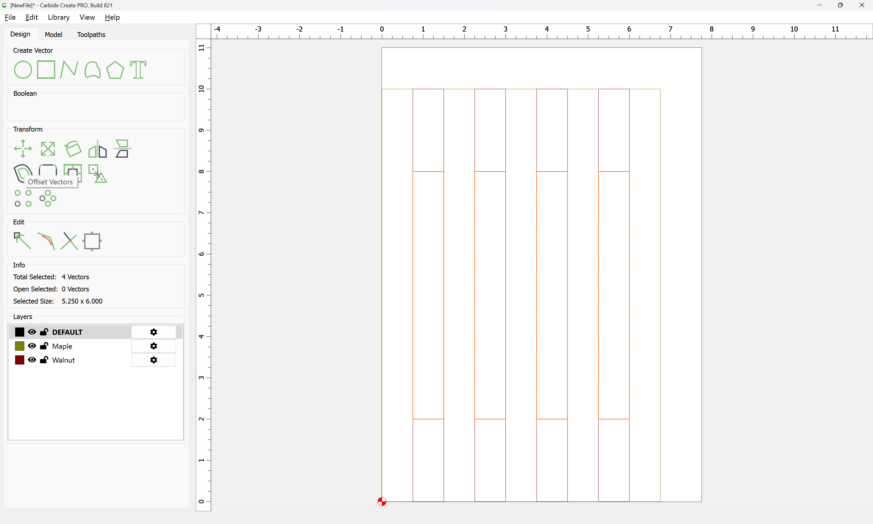

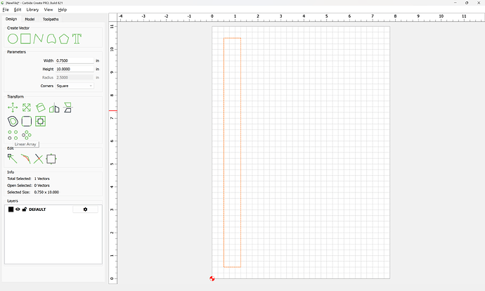

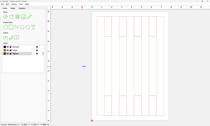

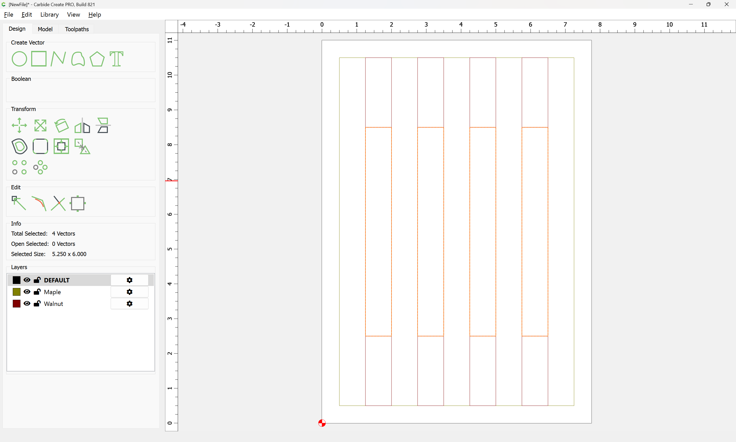

and make layers for each:
and put things on them:

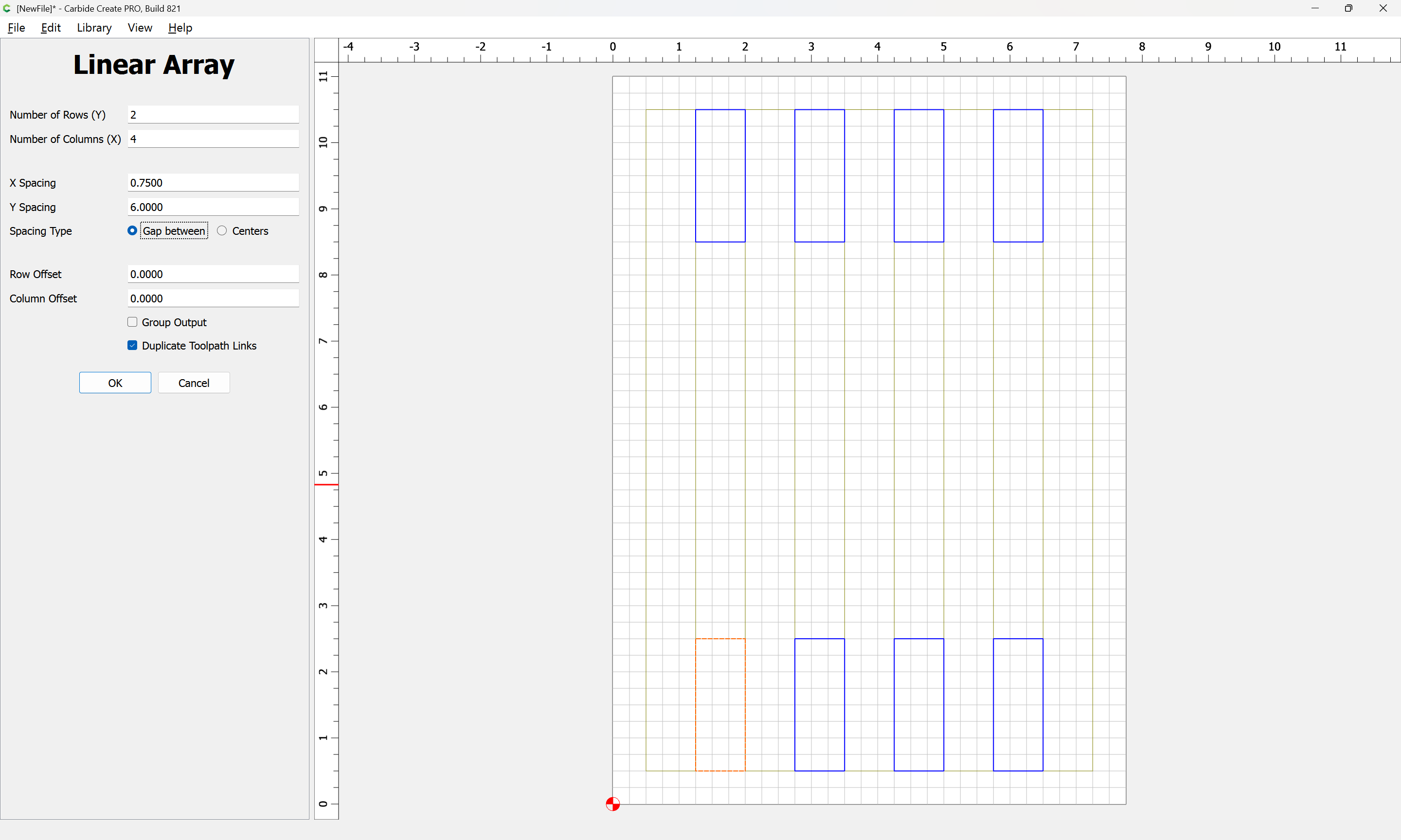

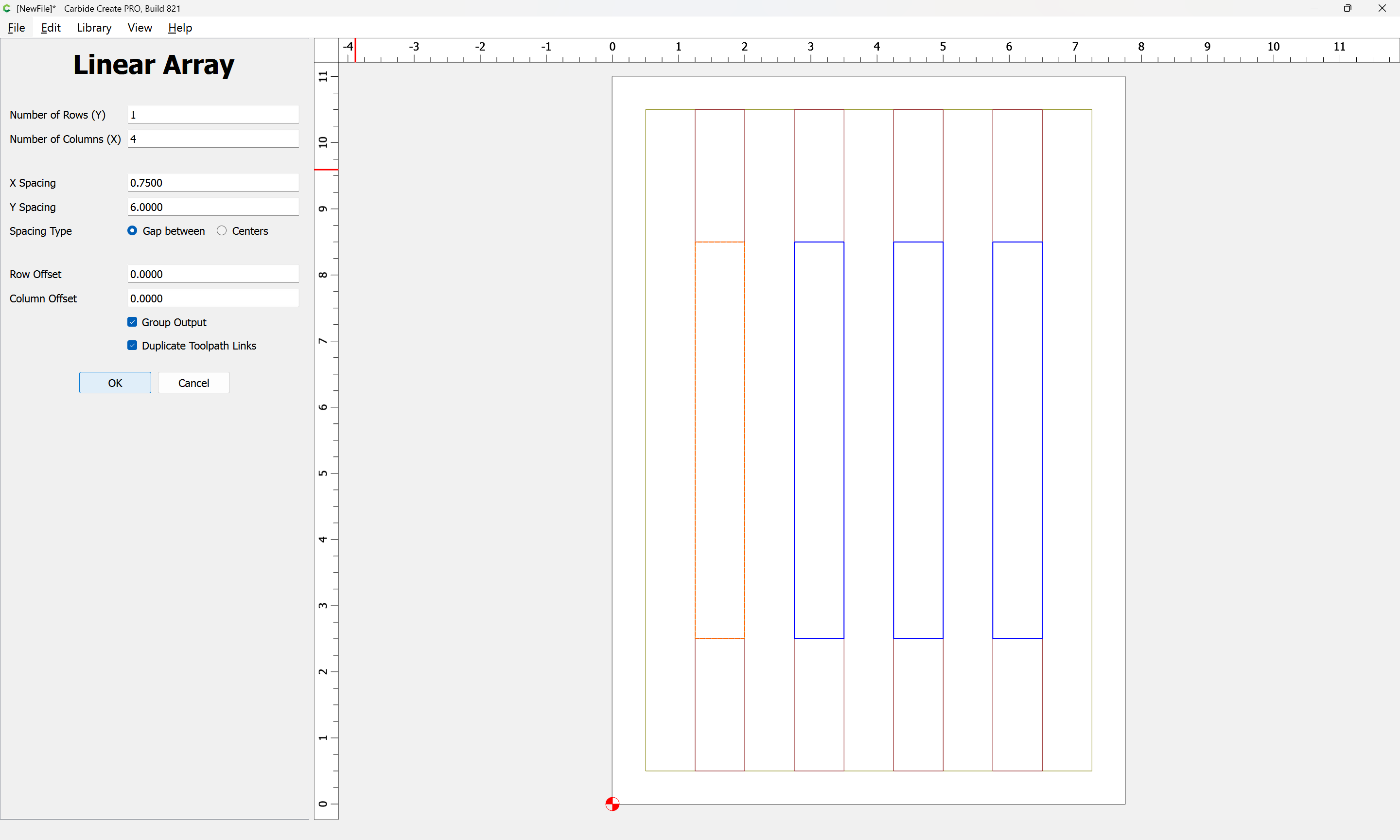

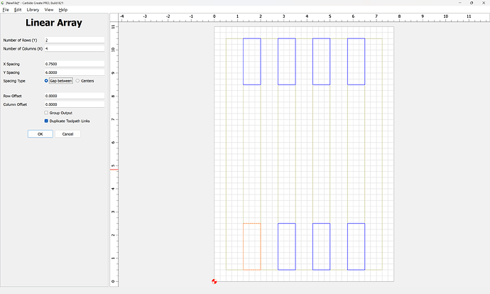

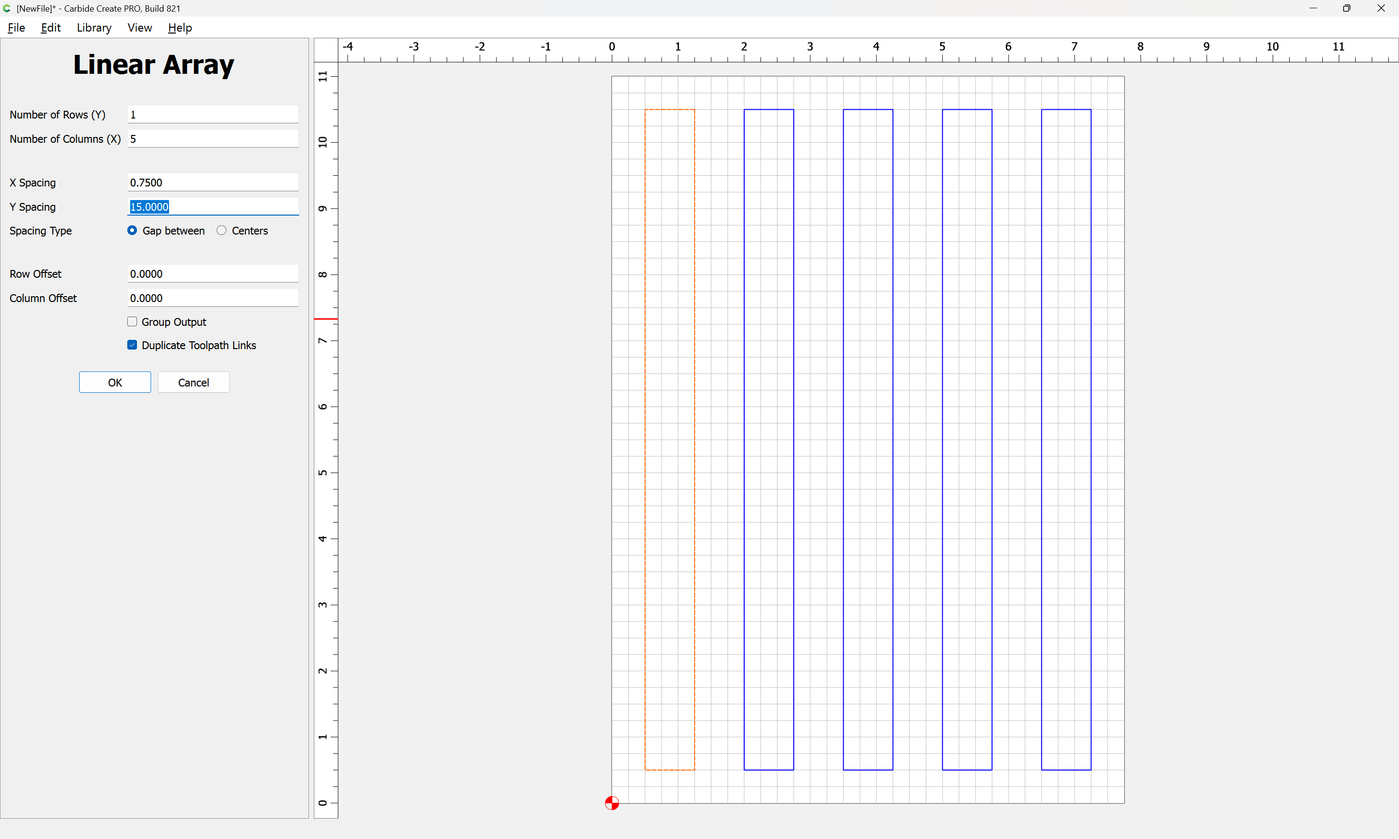

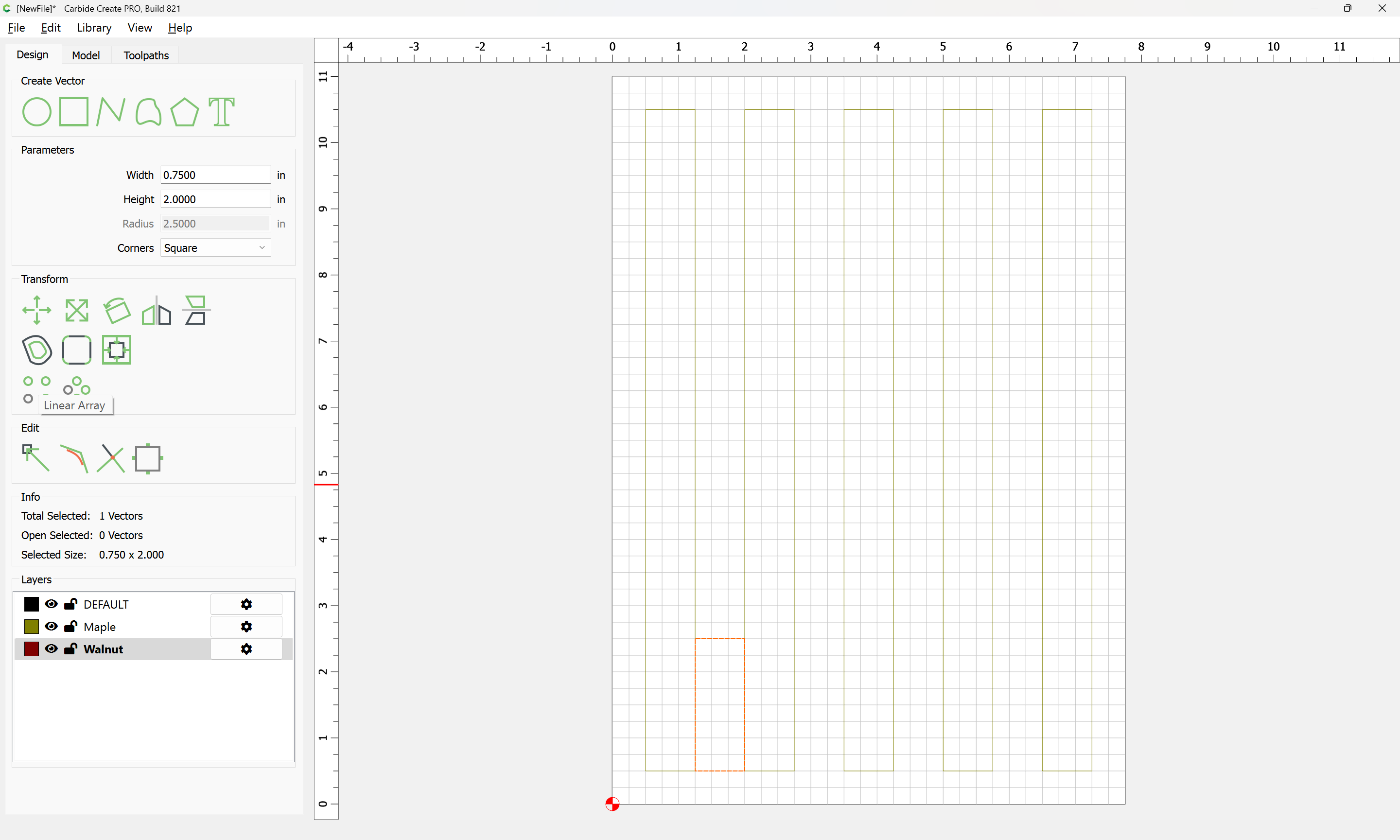

and duplicate as needed using Linear Array:
Things are clearer w/o the Grid:

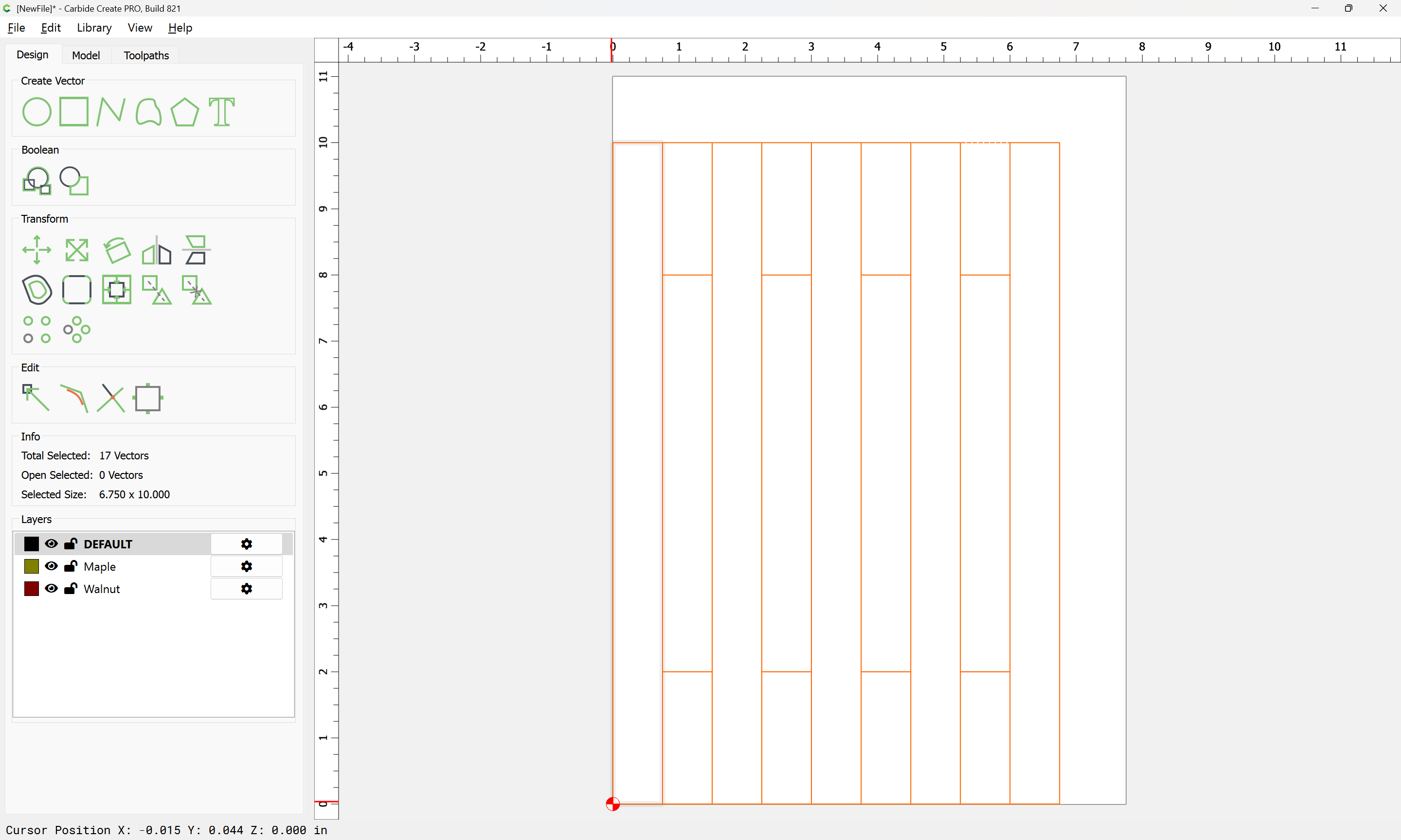

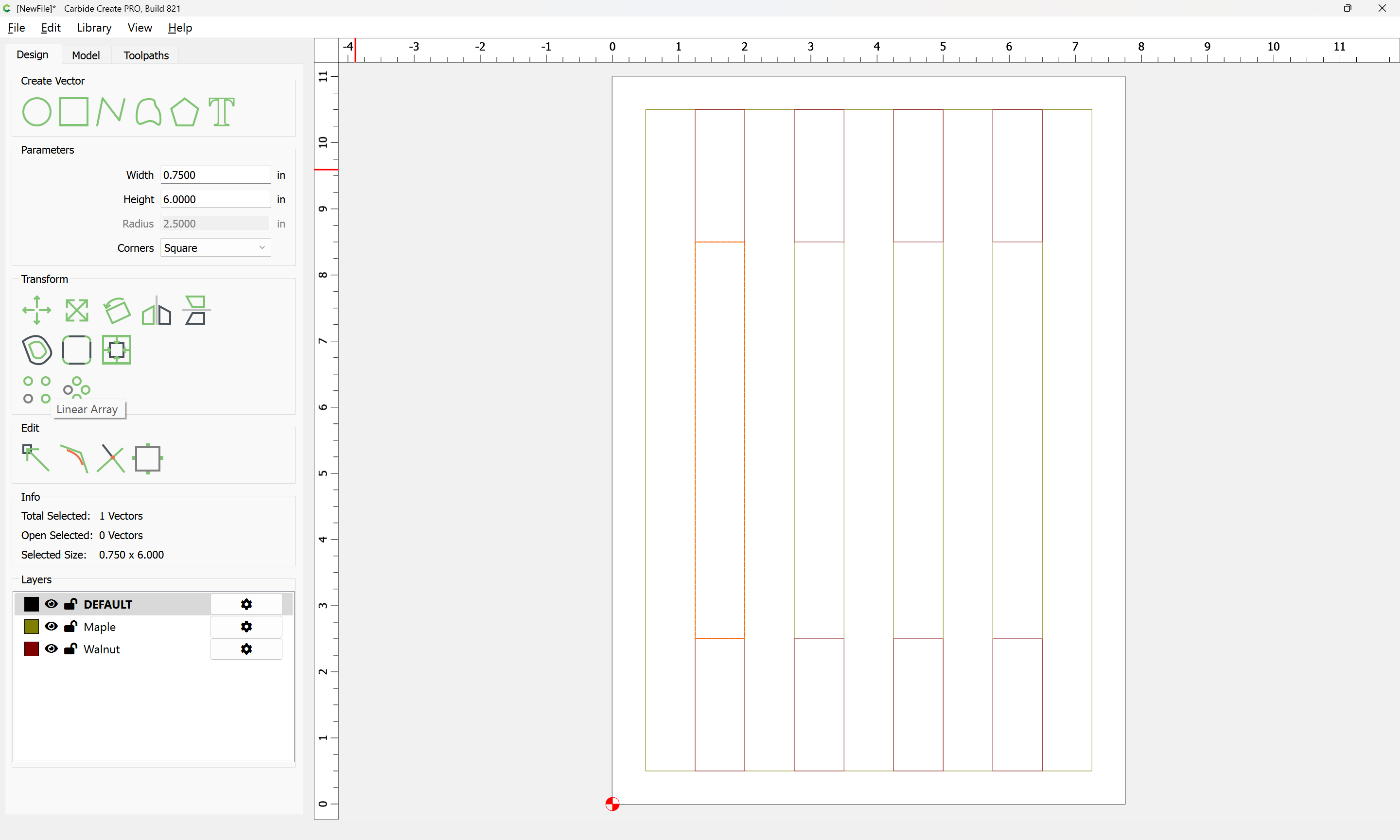

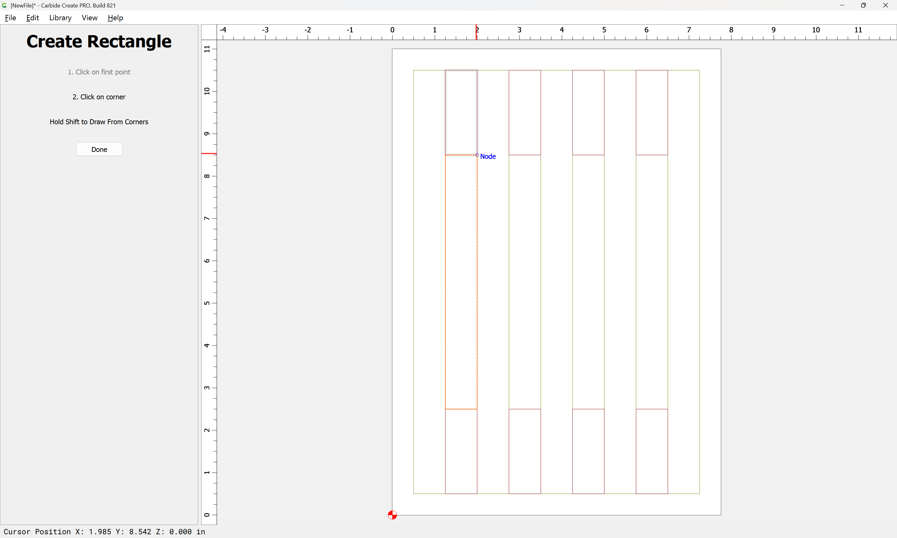

Then draw in rectangles on the DEFAULT layer:
and duplicate them:

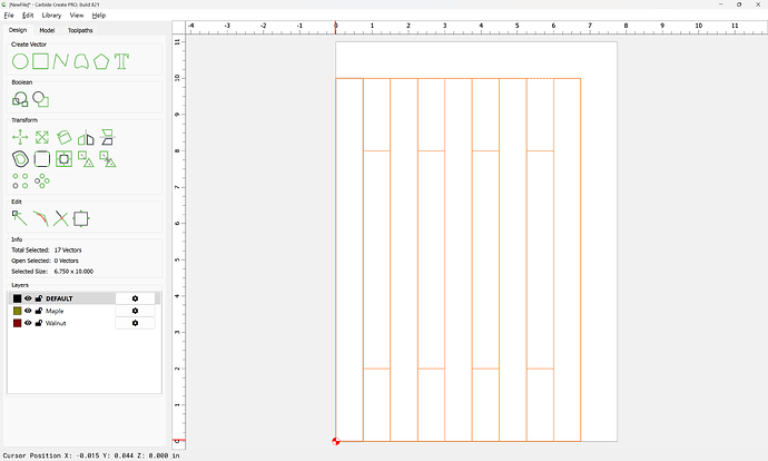

(grouping the output)

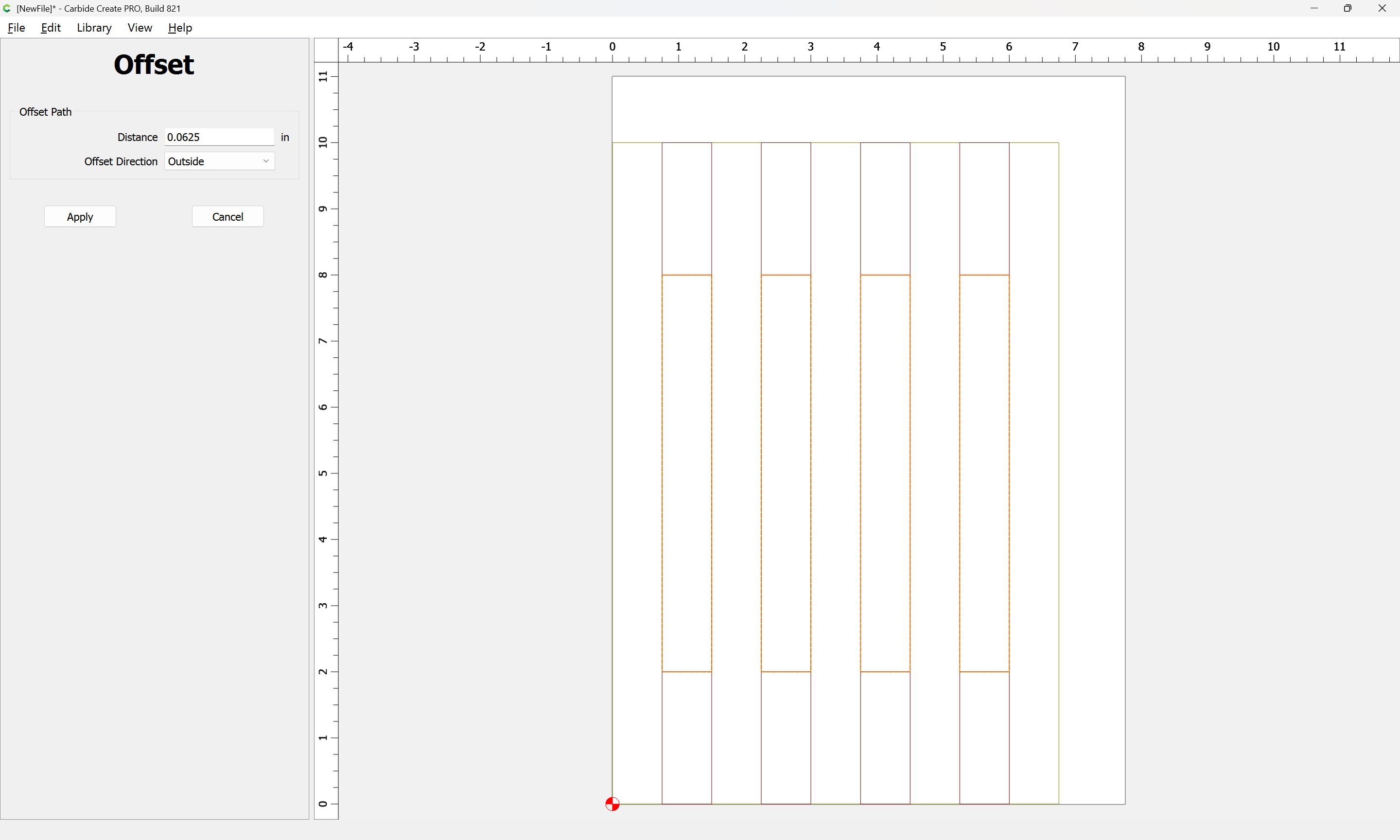

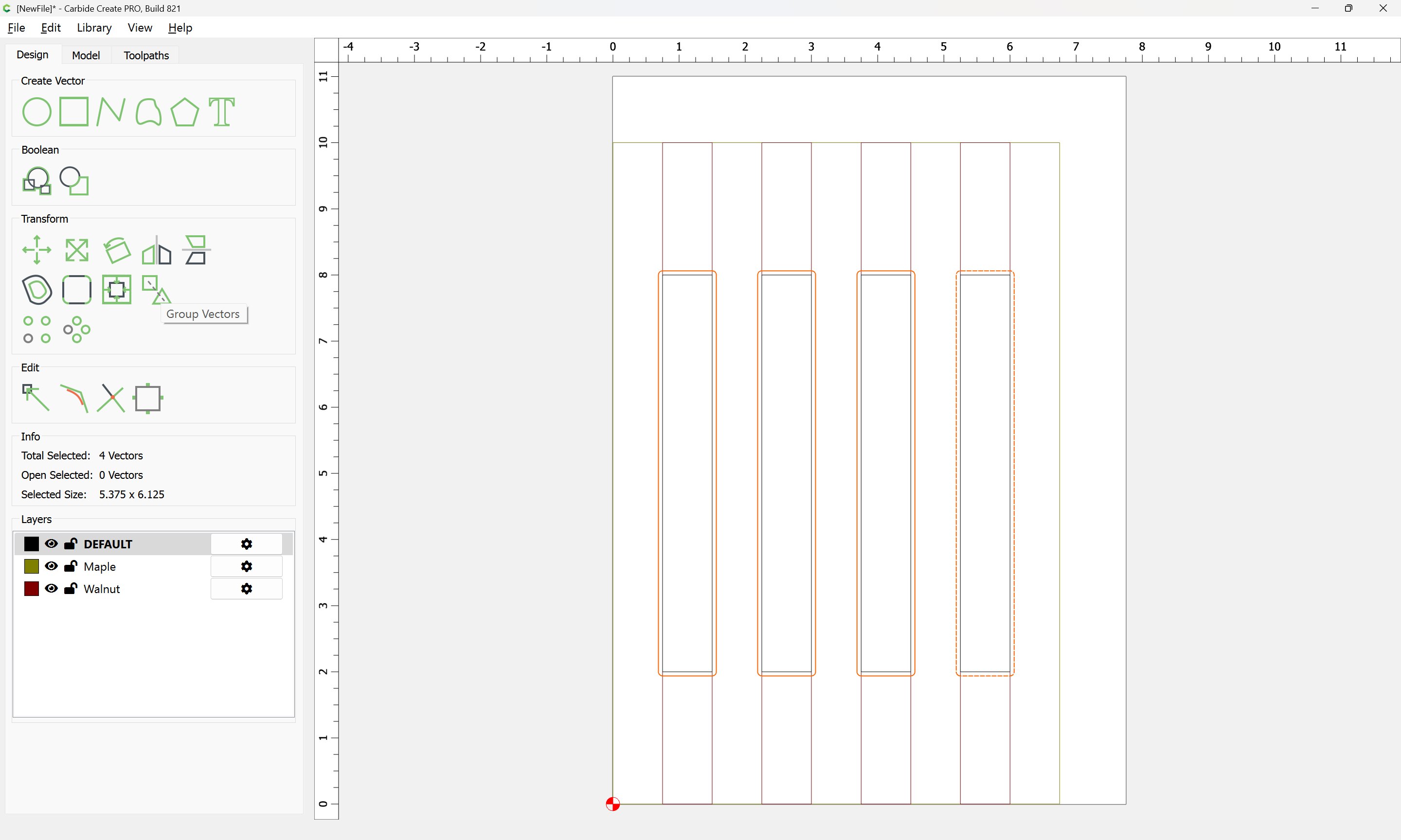

Probably the origin will be easiest if it’s at the lower-left corner, so select everything and drag:

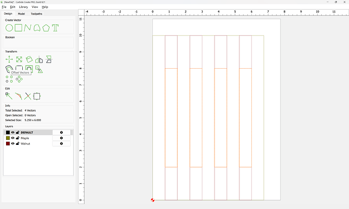

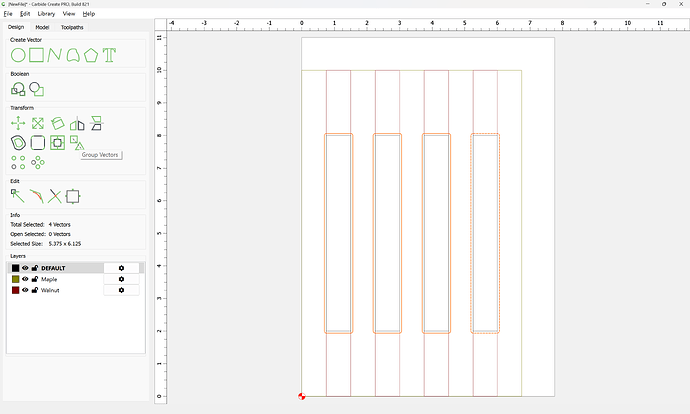

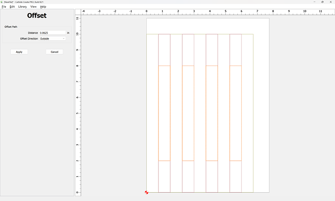

To ensure that the interior material will be fully removed, offset a bit:
(adjust that value for how precise the glue-up and your securing and setting origin relative to the stock)

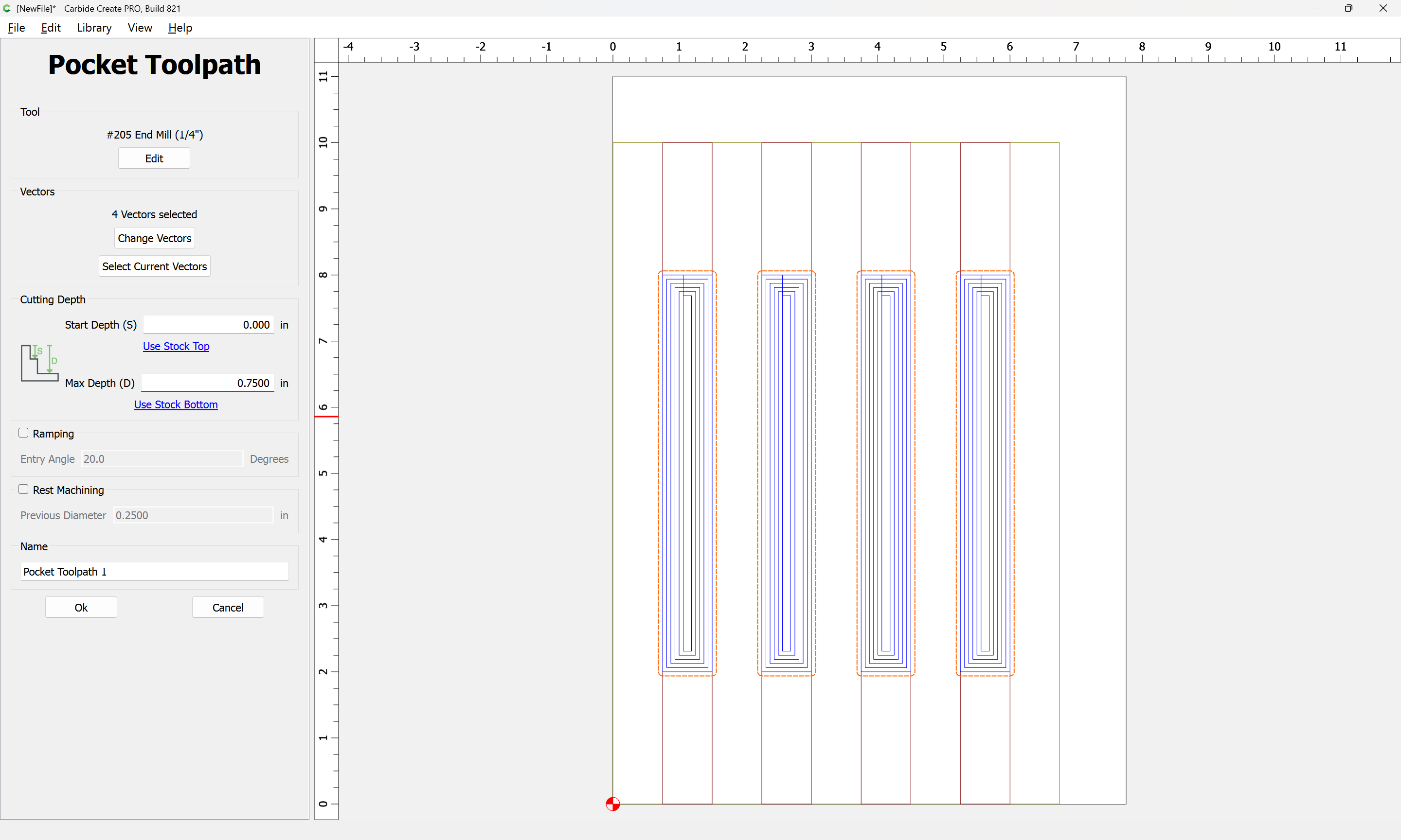

Group Vectors

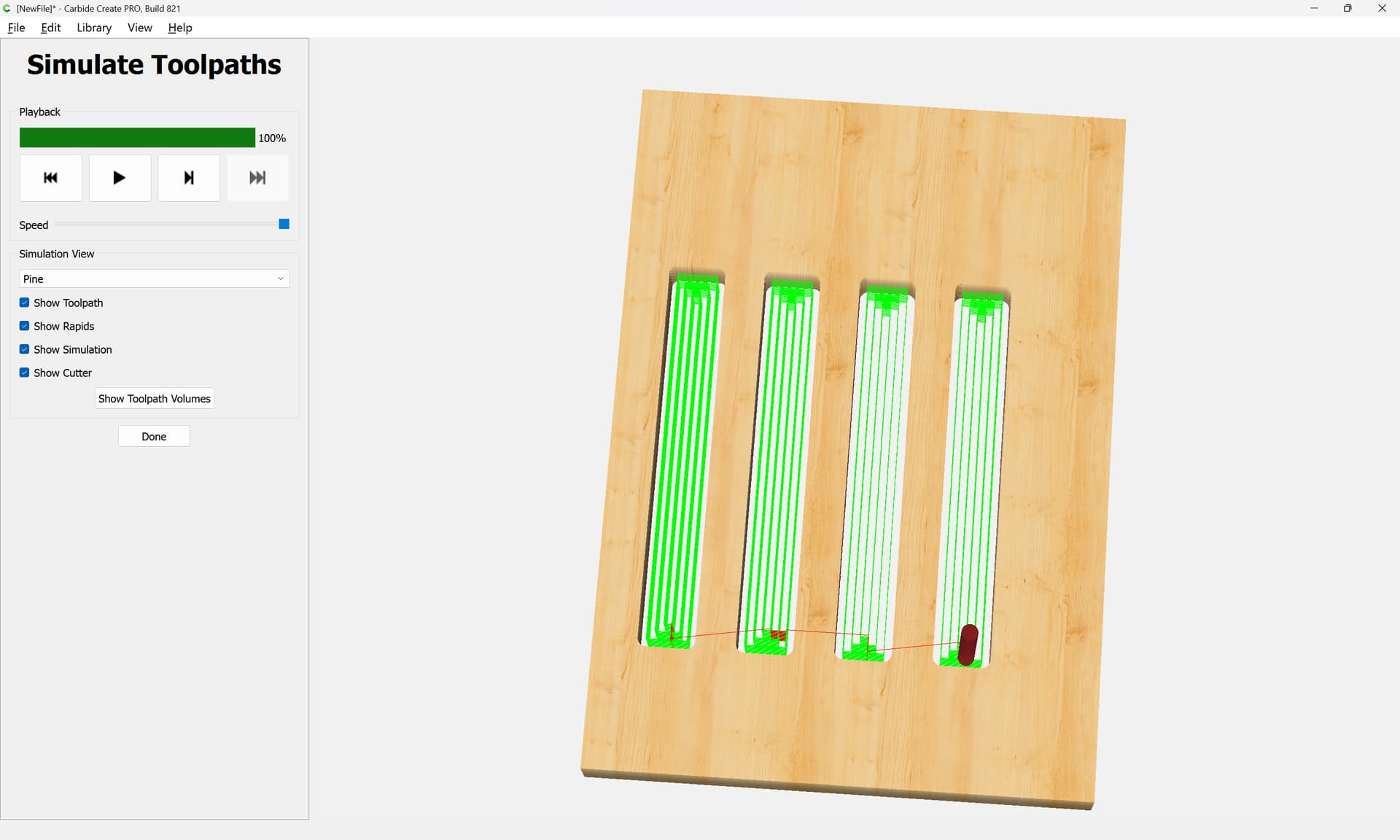

and then assign a toolpath:
If desired, add a roundover using a suitable tool:
