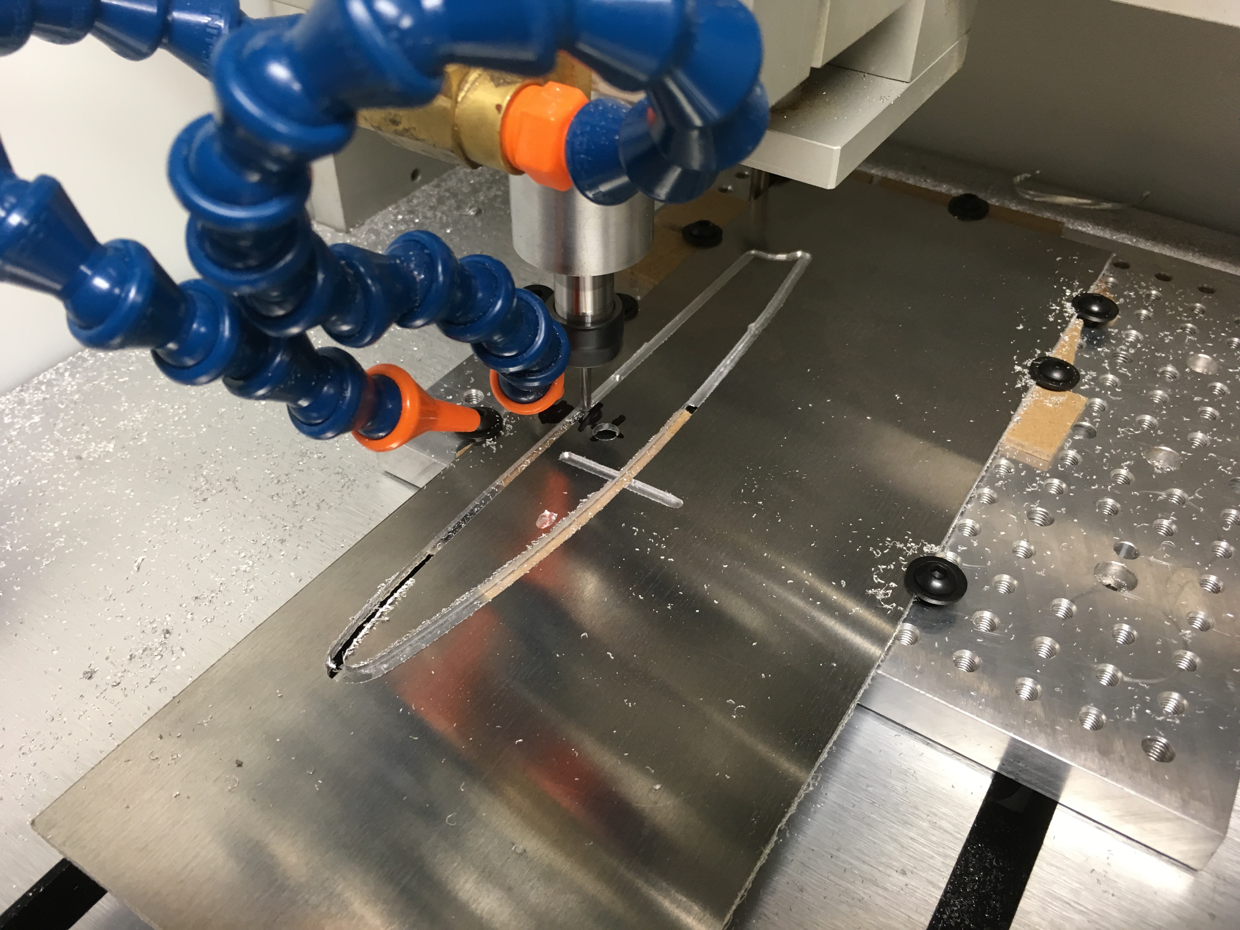

The part I need to make is bigger than the table on the nomad. I can’t just mill part of it, slide it down, and mill the rest because of clearance around the table (back of the enclosure and the tool length switch on the right of the table). The only place to let the part hang off is at the front of the table. That means that to get the “second half” of the part onto the table for milling, it needs to be turned around 180 degrees. The part isn’t symmetrical, so I need a location to use as a machine zero that I can set the machine to when I rotate the part on the table because I’m surely going to move x/y a little when I do that. I used a 1/4" hole that I can align with a dowel in the collet (which I will do differently in the future…but it’s what I was doing this time). This way although both the x/y axis of the part is moving around, I can still get aligned to it for machine zero. The part axis is in the middle of this hole.
The pic shows the second half being milled, that might make this easier to understand. The material in this case is way bigger than it needed to be. The first half was done with the known straight edge (on the left in this pic) on the right against a couple pins. Then I rotated the whole thing and put the straight edge up against two pins on the left to do the other half. The shoulder bolts are there only for alignment of the edge of the sheet so I know it was turned exactly 180 degrees, no more, no less.It came out well, with only a couple thousandths of misalignment between the two halves, which is fine for what I was doing. This isn’t the longest part I need to do this way, this particular one would have worked with a more common “slide it down” method, but I was trying to get the process figured out for a part that’s another 6 inches longer than this one.
So, all that said… I wanted to rotate the part in meshcam around the part axis so I could generate the second toolpath (for the second half of the part). Instead, I needed to re-export the part from cad turned 180 degrees, which is less convenient. If I was doing a more standard tiling operation, I would have set the machining area to about half the part, put the zero onto some feature I could find, generated a toolpath, then set the machining area to the other half overlapping that zero, and generated the second half, without going back to the cad software. Because meshcam won’t rotate around the part axis, I can’t use that to help me out here.

Ran through the process today, using (mostly) @Randy 's recommendation. After rotating, I set the zero to the middle of the material edge. Then I matched this up with a small hole in the material (so the material was slightly wider than I told meshcam it was). The only problem I really had was that after selecting “lock stock dimensions” … they aren’t locked if you do the rotation. Again, not the end of the world, but kind of inconvenient.
Here’s the setup I used. I made a pallet for the material to be stuck to that has two parallel sides. Once the material is stuck to it you can turn it 180 degrees accurately. Had to get a little creative with the clamping because of a touch of overhang of the material over one side of the pallet. I stuck a dowel pin between the quoins and the side of the pallet, so the material could overhang. Did the same thing when I rotated it. The purpose of the pallet is so there is a set of accurate edges for the rotation, no matter what the raw stock looks like.
Took a couple tries to get things glued down right such that they stayed stuck through the whole milling session… All I can say is to read the directions on the can of super 77…don’t just assume you know what you’re doing…
It’s glue in a spray can. How hard can it be, right?
This particular part is 9.6" long. This method would be good up to ~15" (less than 2x 8").
Here’s cutting the first half. There is an alignment hole (used for zero) in the stock on the left side of the black line. I clearly could have cut further during the this first half.
Here’s the second half. You can see the alignment hole on the right side of the material in this one. This procedure works pretty well, but I need to do something different to pick up the zero, it didn’t come out exactly on where I had wanted it, it’s off my a touch in X (and probably Y). Maybe a pointer and a scribed fiducial next time.
