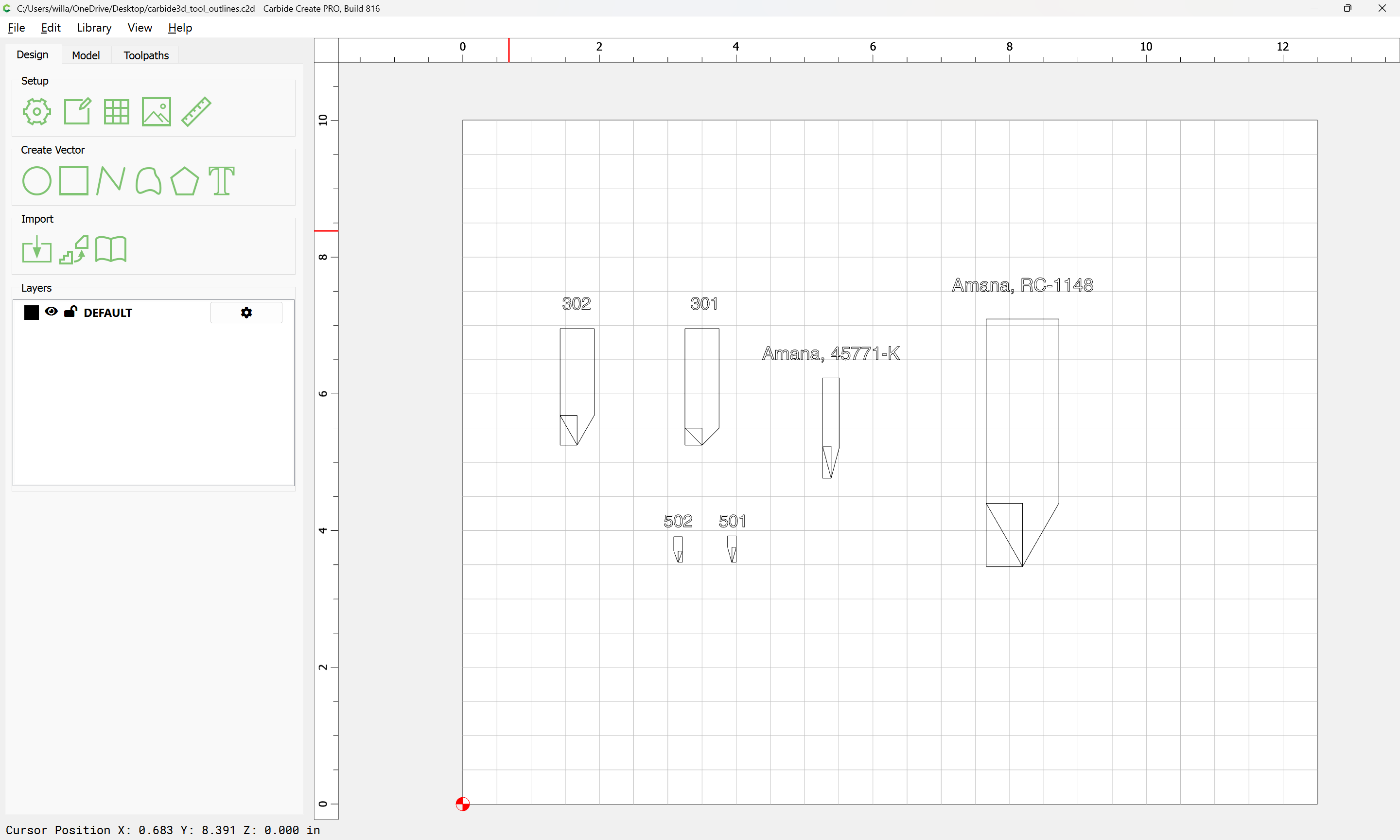

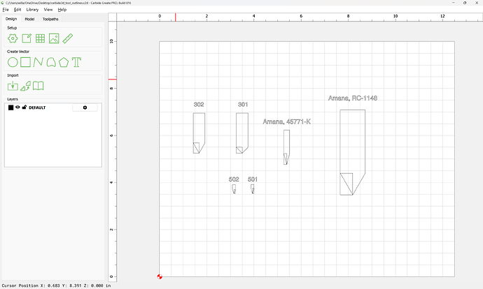

Also, since I frequently re-draw tooling so as to examine how a cut will be made in profile:
carbide3d_tool_outlines.c2d (220 KB)
