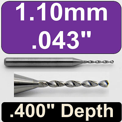

I am curious if anyone out there is having any success drilling 6061 with micro carbide drills.
All the factory speeds are well over my 24k max and rated for copper that is softer. I need to peck drill through .1875" bar stock. So far using a maglube MQL, 24k rpm 5 ipm .019" pecks with full retract I’m getting 2/3 of the way and then breaking. My gut says take smaller pecks but I don’t want my lack of XP to kill my last 3 drills so I figure I will see if anyone has real world micro drill XP they can share.

IMO lower your peck depth or use a peck reduction. In my experience, misting was not great for microdrilling, you want to crank it way up. I would say start out with 1/3D for peck depth (wouldn’t hurt to go 1/4 to be safe) and make sure your retract isn’t super fast.
Perfect tram, proper spot, and runout sub 0.0005 but as close to 0 as you can. Check and adjust with tap method.
edit Your feed per rev is a little low at 0.0002"
Harvey Tool specs around 0.001" feed per rev at that diameter (aluminum) and Ive personally had success running 0.001" per rev with a 0.032" carbide drill
In 4140 steel, a 0.0157" carbide drill runs well at 0.0002" feed per rev to put things into scale.

I started at 20 ipm to get close to .001 and it ghosted that bit on the 2nd peck. I did have retract set high at like 40 ipm so that can be slowed way down and might be where I failed along with too deep of a peck and I did not spot drill.

The good news is, it drilled all 10 holes without issue with just the 99% IPA coolant.
RPM: 24K
Peck Depth: 0.010"
Plunge: 10IPM
Total depth: 0.1875"
Online calculator says that is 0.0004IPR
The bit afterwards:

Pecking could actually be bad for the bits, especially something that small. With pecking, you’re repeatedly going from no load on the bit to some finite load in a short period of time. Which carbide especially might not like due to its brittleness. This page recommends not pecking until you hit 3X the drill diameter worth of depth:

So after a few tests and ghosting 4 out of 5 new drills in the process Slowing down to
10 IPM
.01 peck WITH full retract
24k RPM
This seems to work reliably and so far has drilled over 70 holes through .1875" 6061 so thank you to everyone who gave input.
