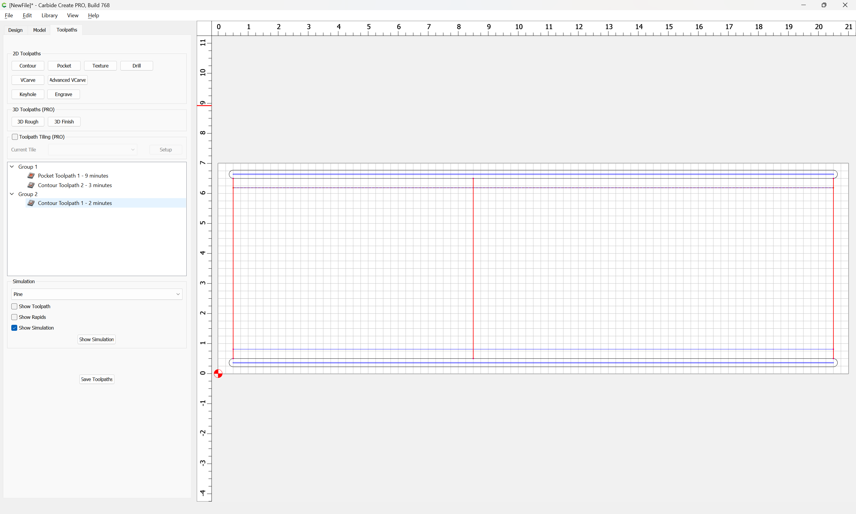

I am unsure of how to write a program that will allow me to make the desired size.
6 inch Height
12 inch Length
8 inch Width
Not sure of what cutter to use and how to lay out the project so it will all be continuous with a 1/4 inch thick piece of stock.
For a continuous 1/4" thick box you would need a >1/2" thick piece of stock >20" in length and >6" wide.
Then, set up a toolpath which will cut a front/back and a side with 3 V cuts, and straight cuts along the other edges (unless the stock is S4S and exactly 6" wide or if you are mitering the top/bottom as well) and you’d also need to decide how the top/bottom will be done — if you’re mitering them as well you’ll need a pair of >12" x 8" pieces of stock — otherwise you would need to rabbet/cut grooves for the top/bottom and decide if they will be floating or no.

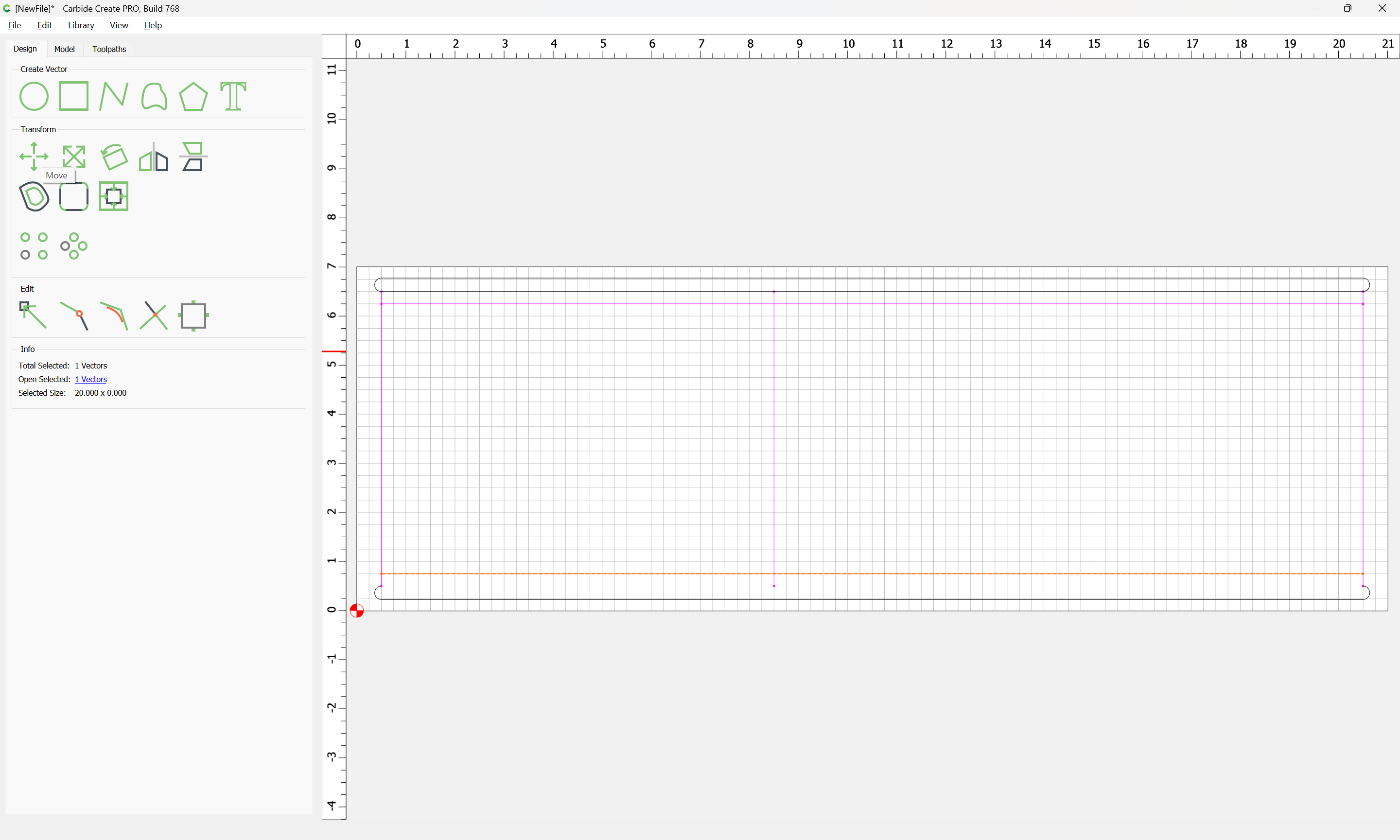

Here’s one way to set this up:

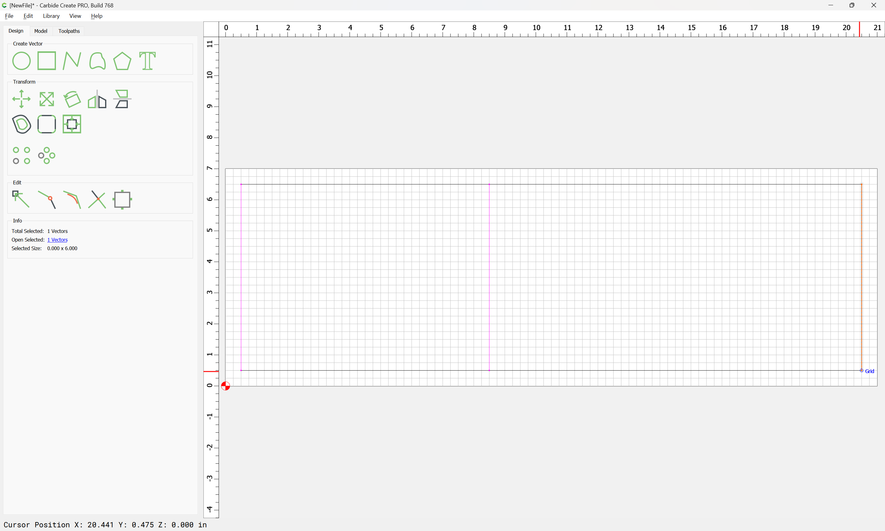

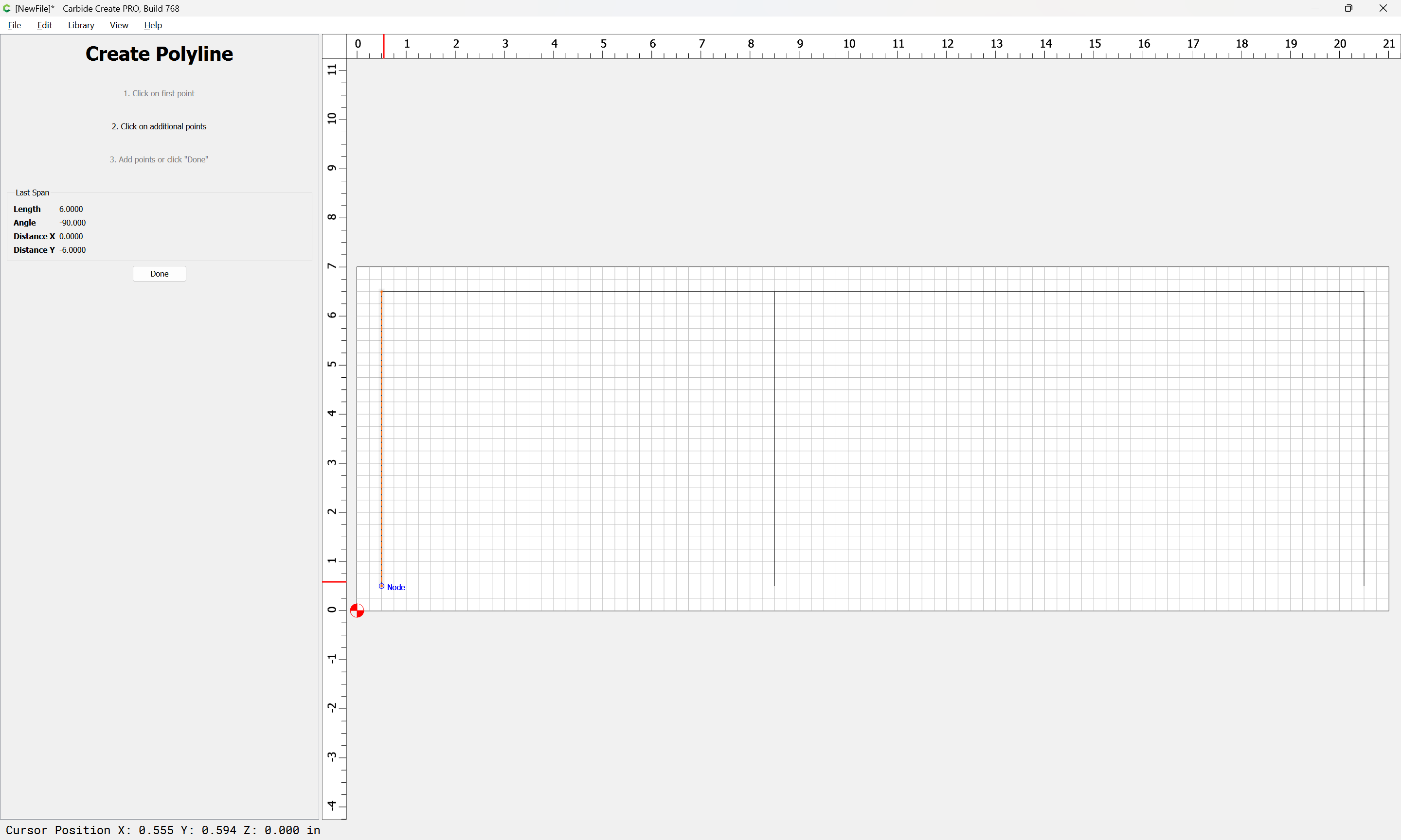

Then draw in geometry for a side:
and the front/back:
Then draw in geometry for cutting a V for the joinery:
and duplicate it for the other corners:

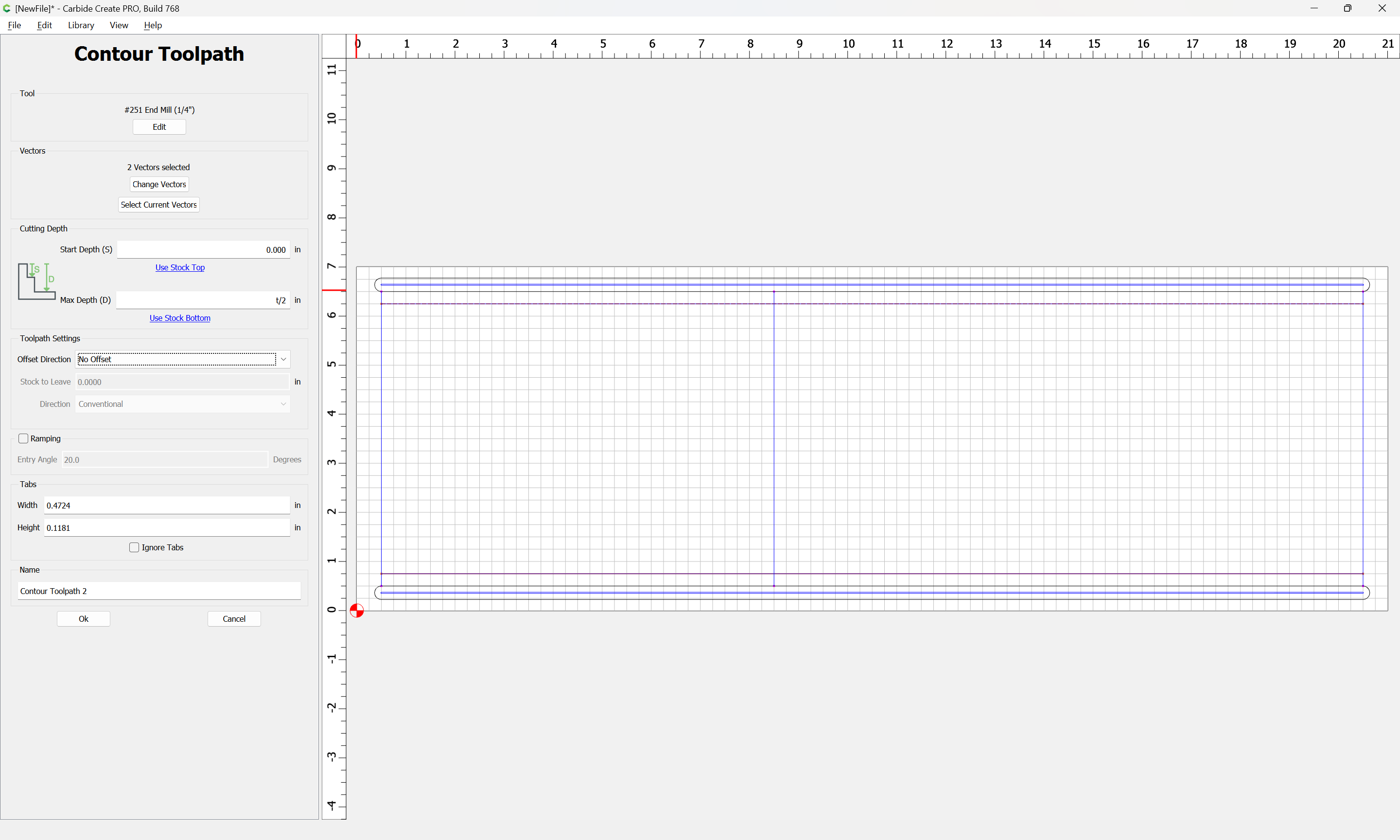

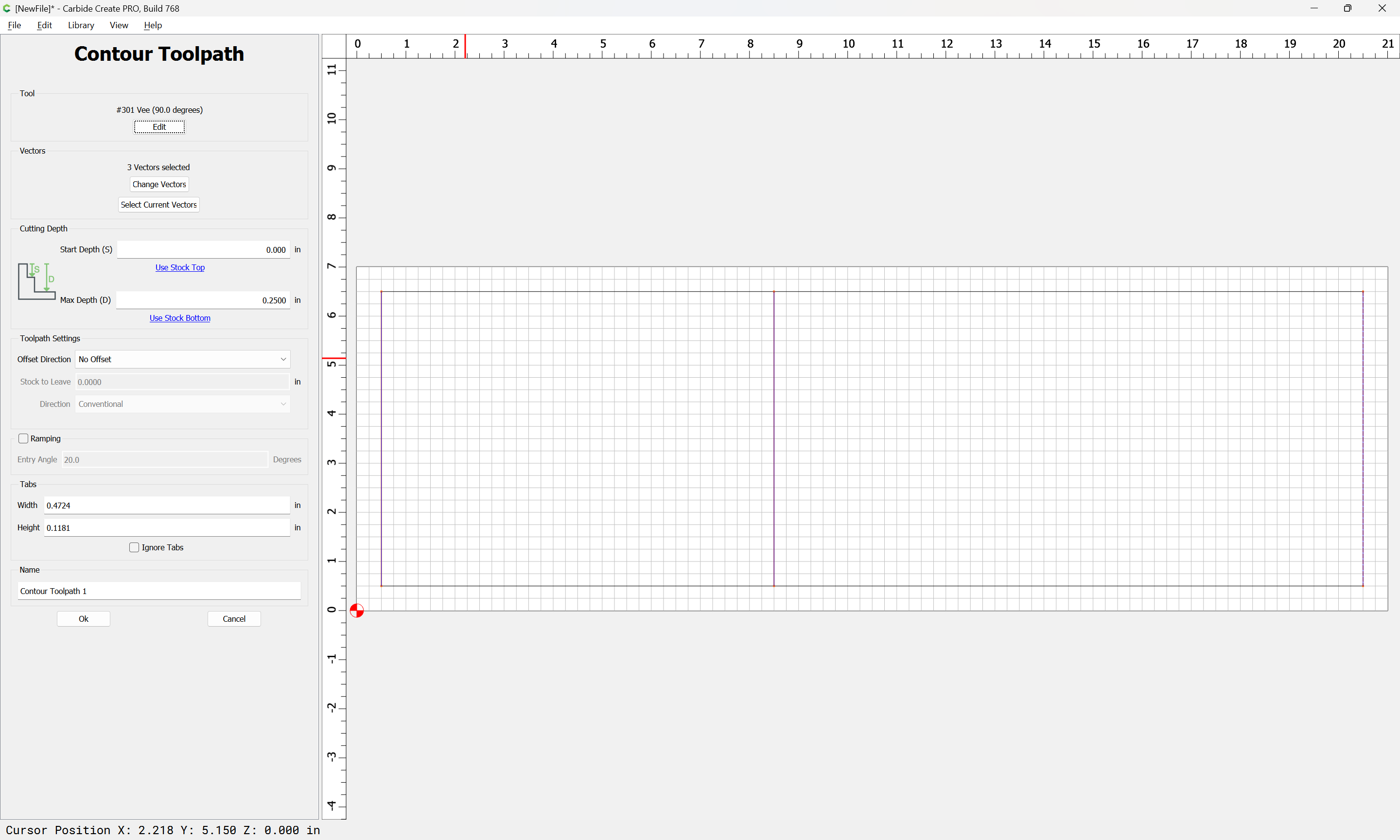

Then select that geometry and assign a No Offset Contour toolpath:

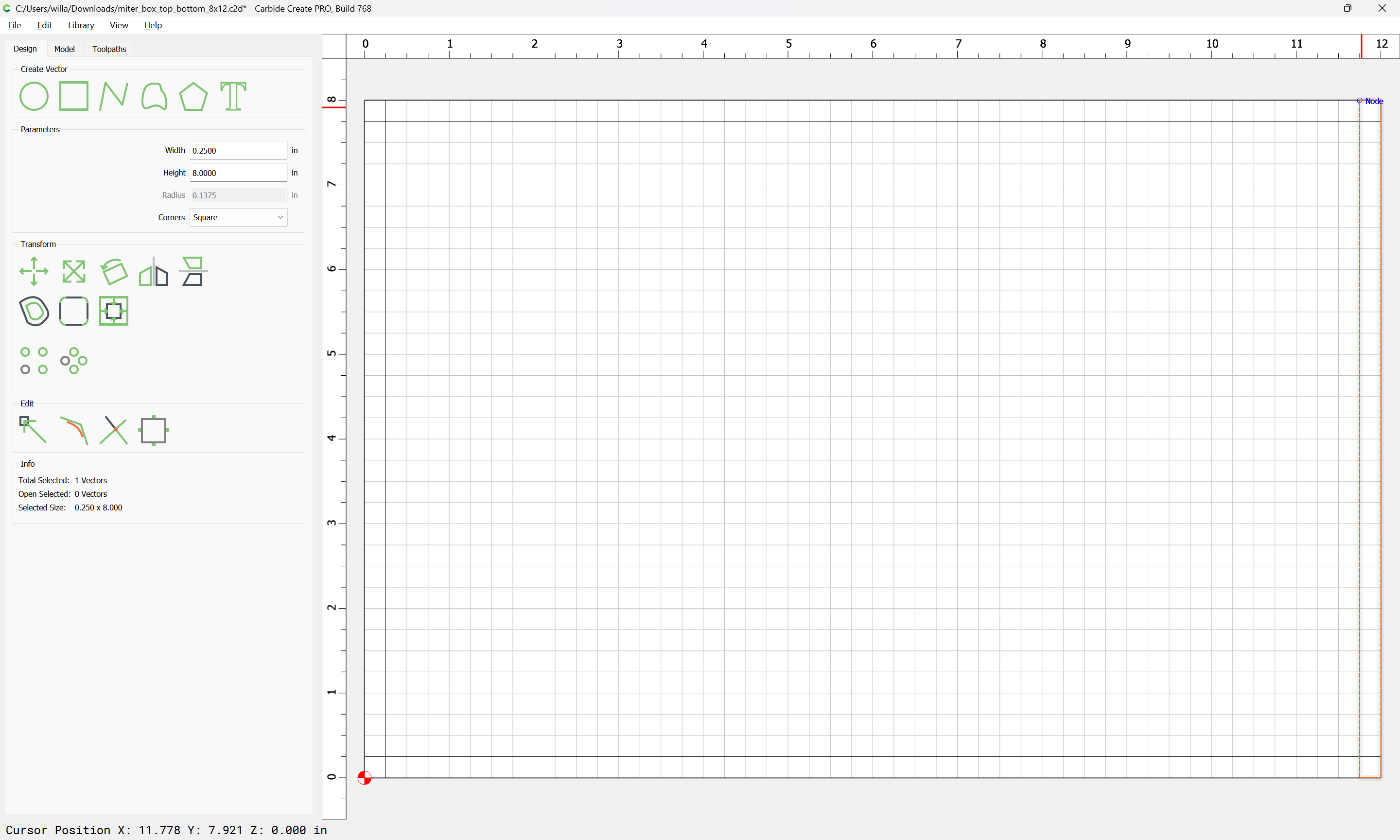

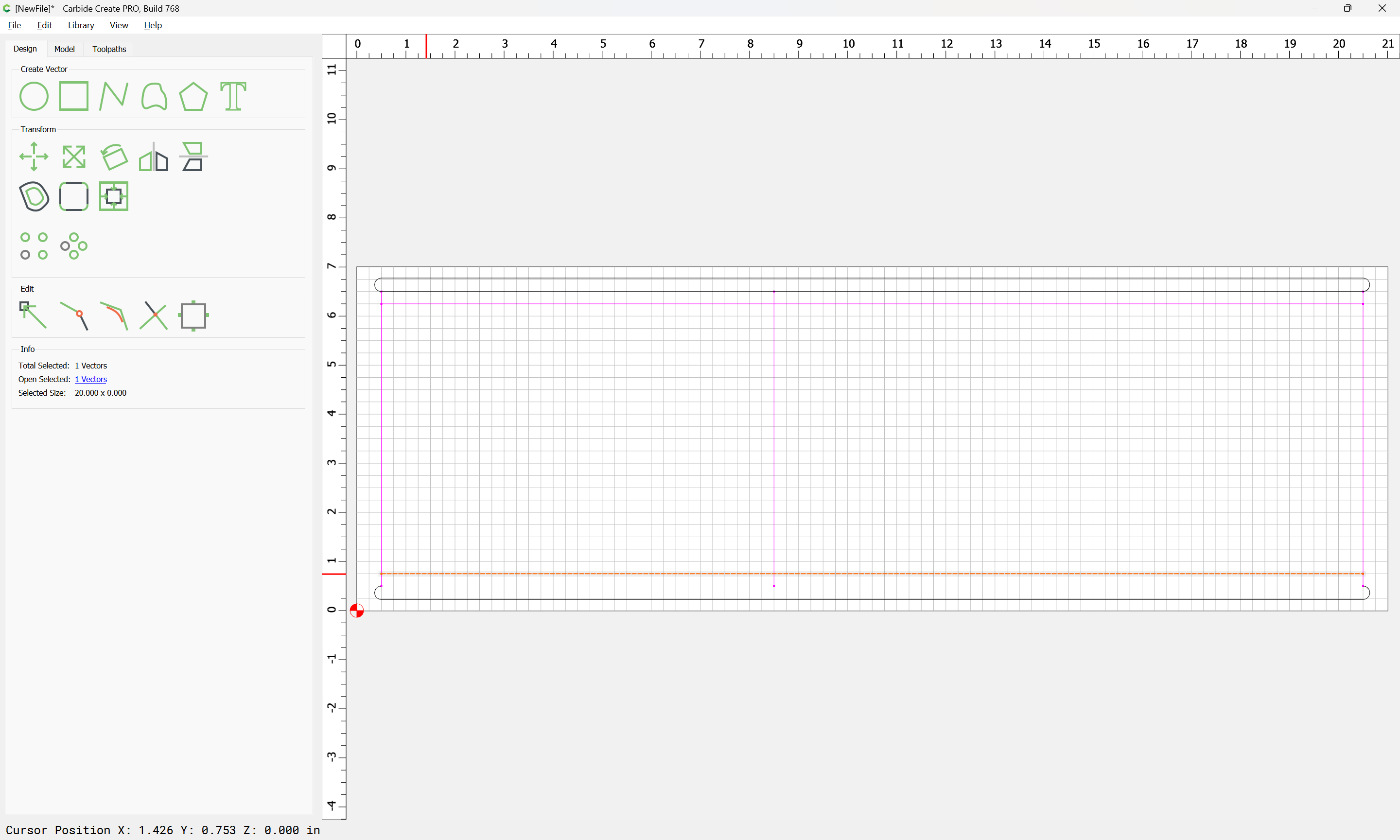

and then draw in geometry at top/bottom to cut to width:

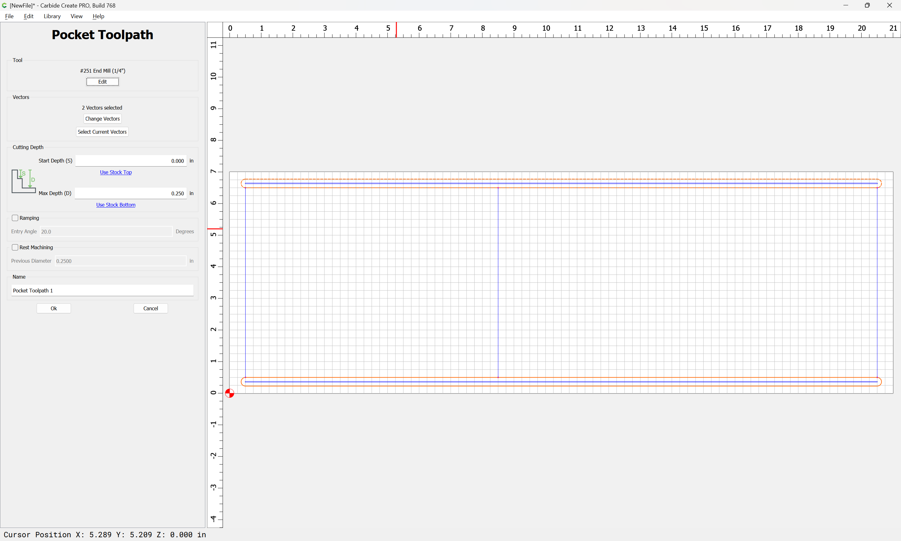

The other consideration is grooves for the top/bottom — if the stock is 1/4" thick, then one can use a tool of that thickness and another No Offset Contour:

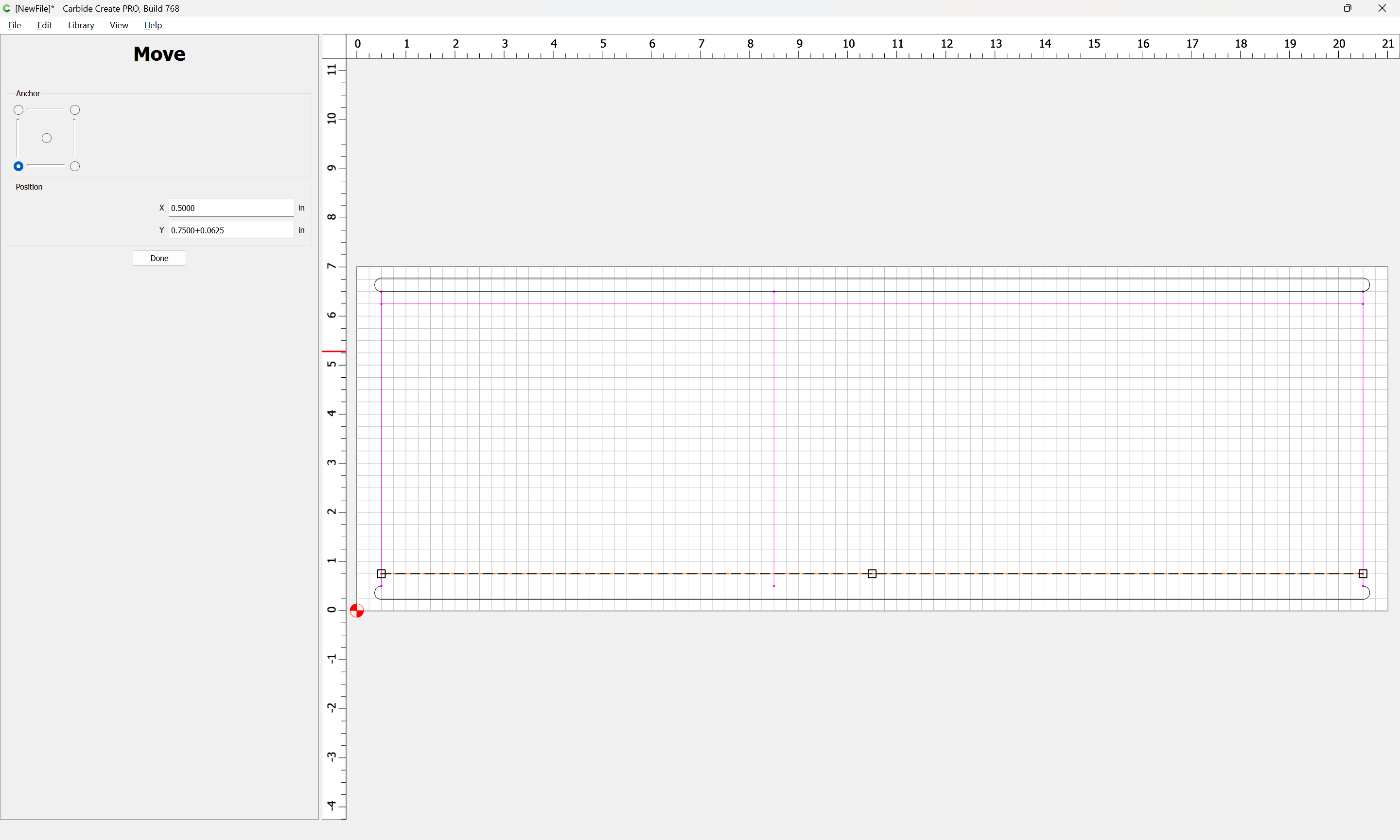

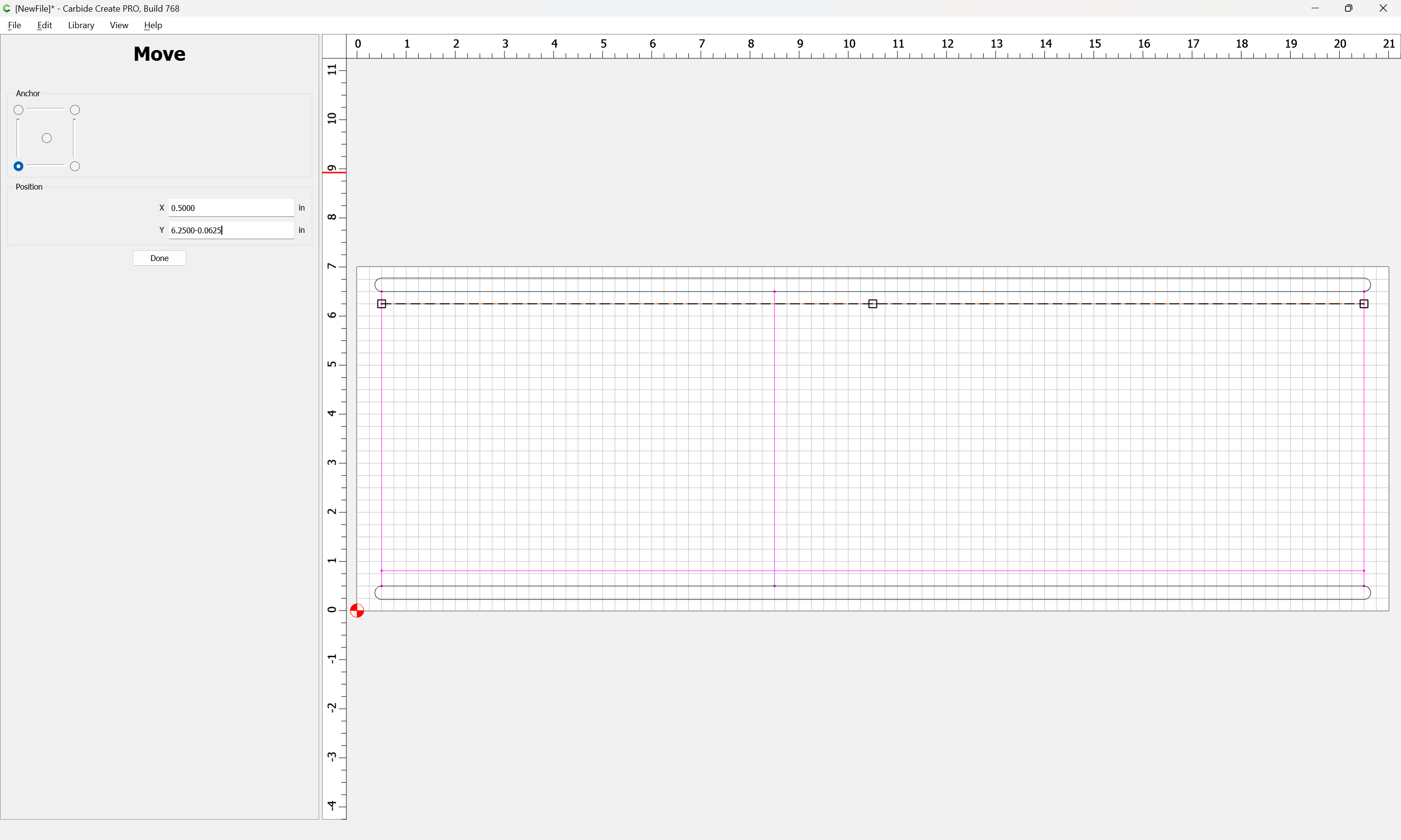

Looking at this, more material at top and bottom would seem warranted, so we move things in by 0.0625":
which looks a bit better:

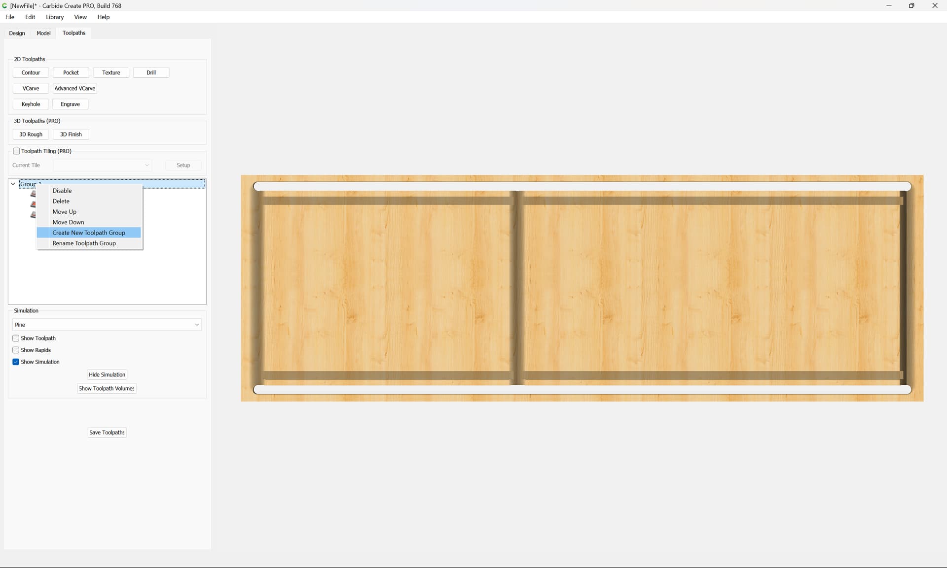

and we make a new Toolpath Group:
and move the V tool toolpath:
and adjust the ordering of the other two toolpaths:

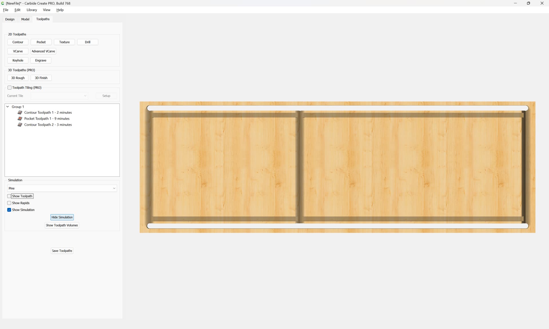

Secure things in such a way that tabs are not necessary and it should work to cut:
miter_box_8x12.c2d (52 KB)

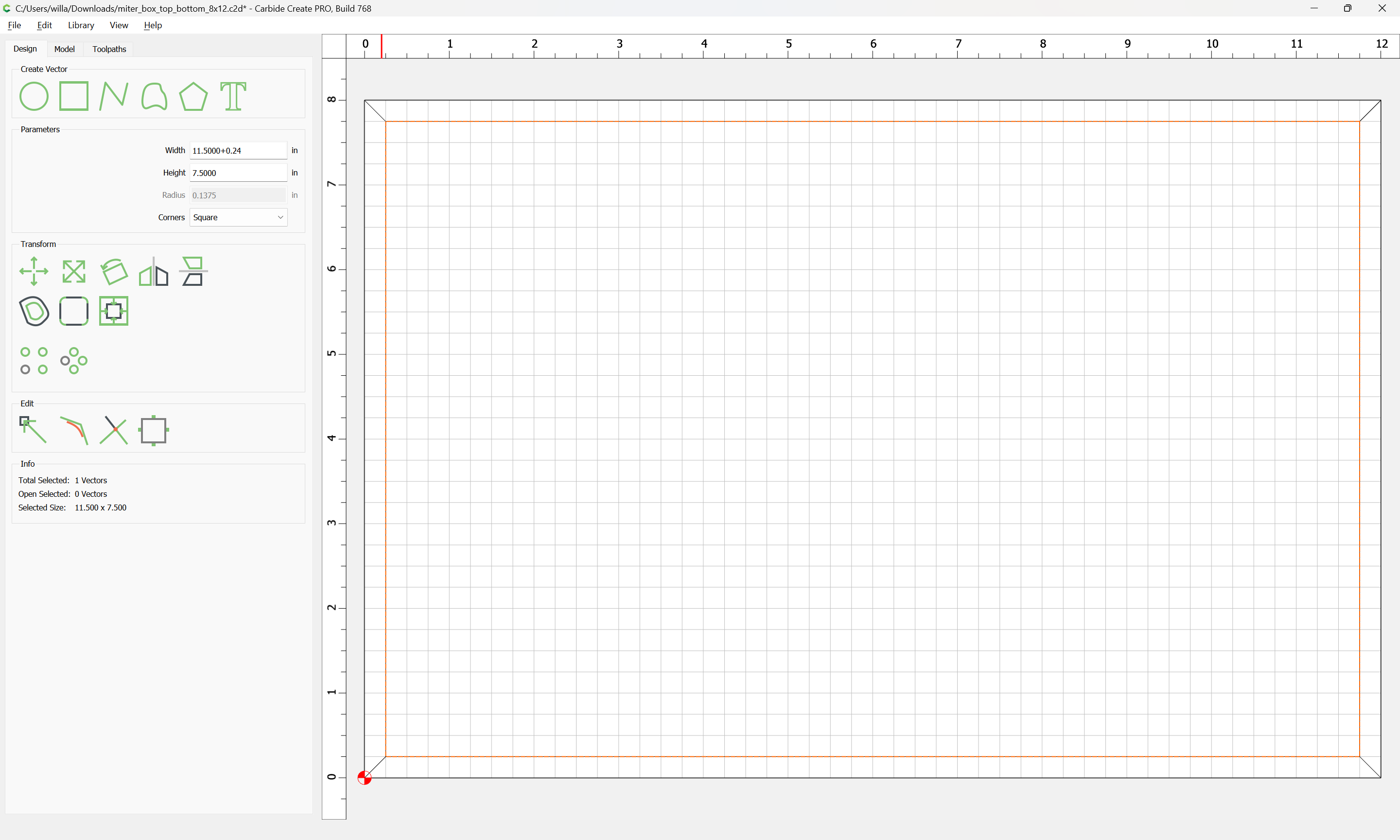

For the top and bottom, draw up things from overhead in a separate file:

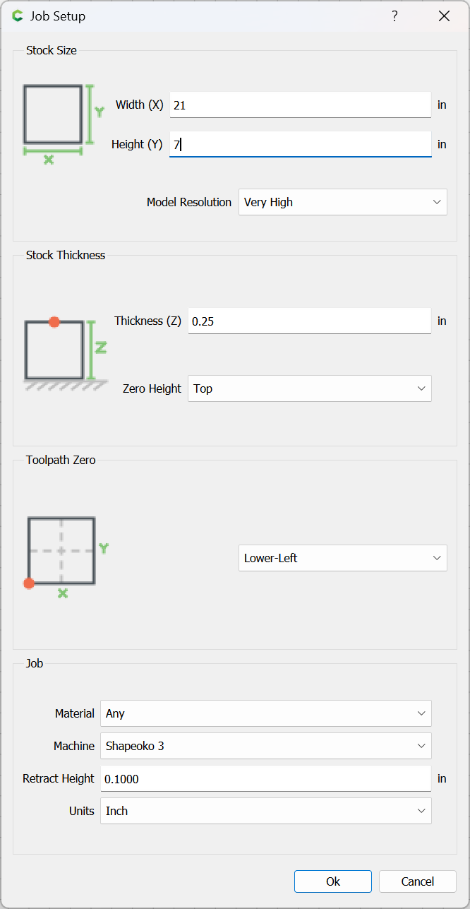

Job Setup:

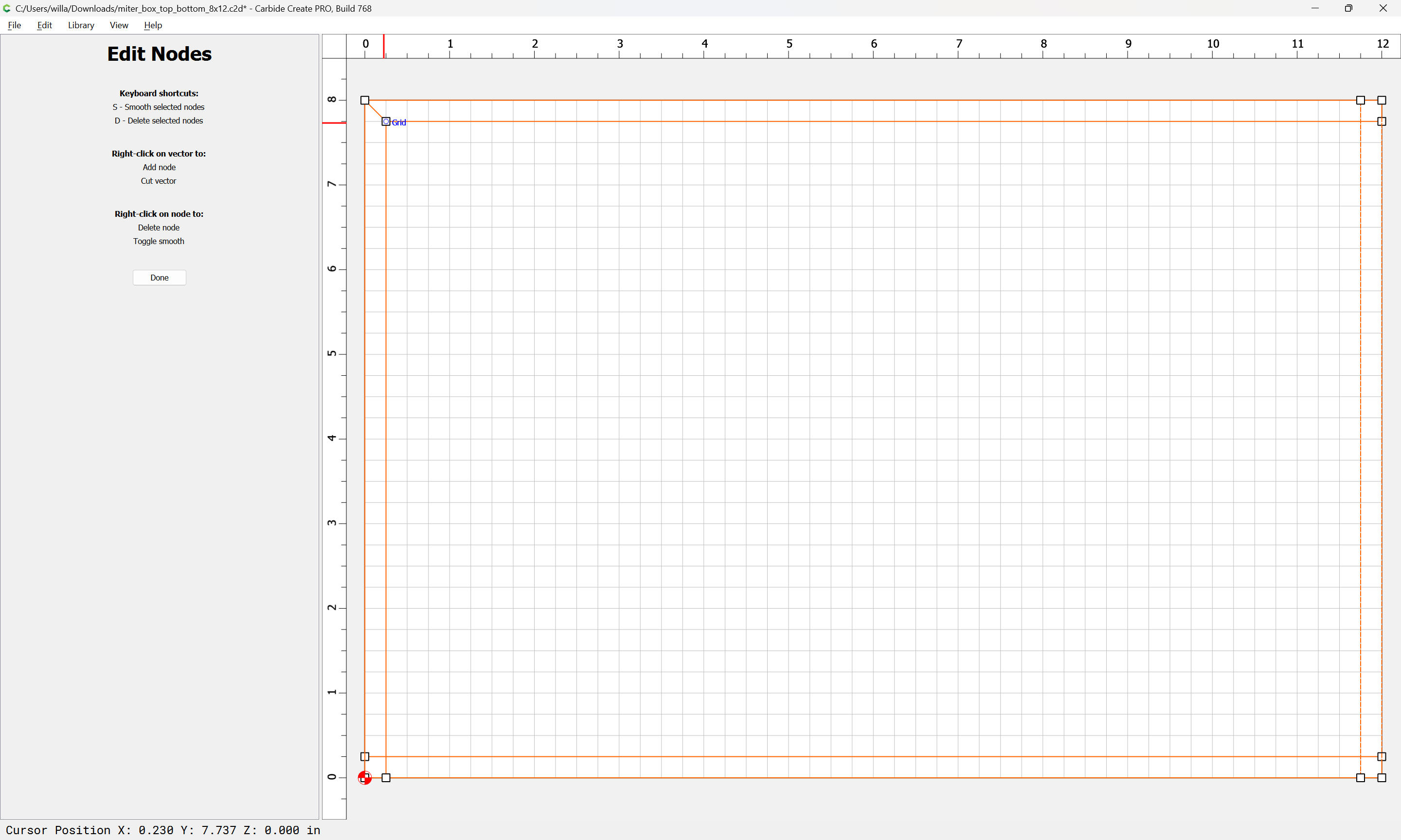

If desired, node edit things to show the mitering:
Done

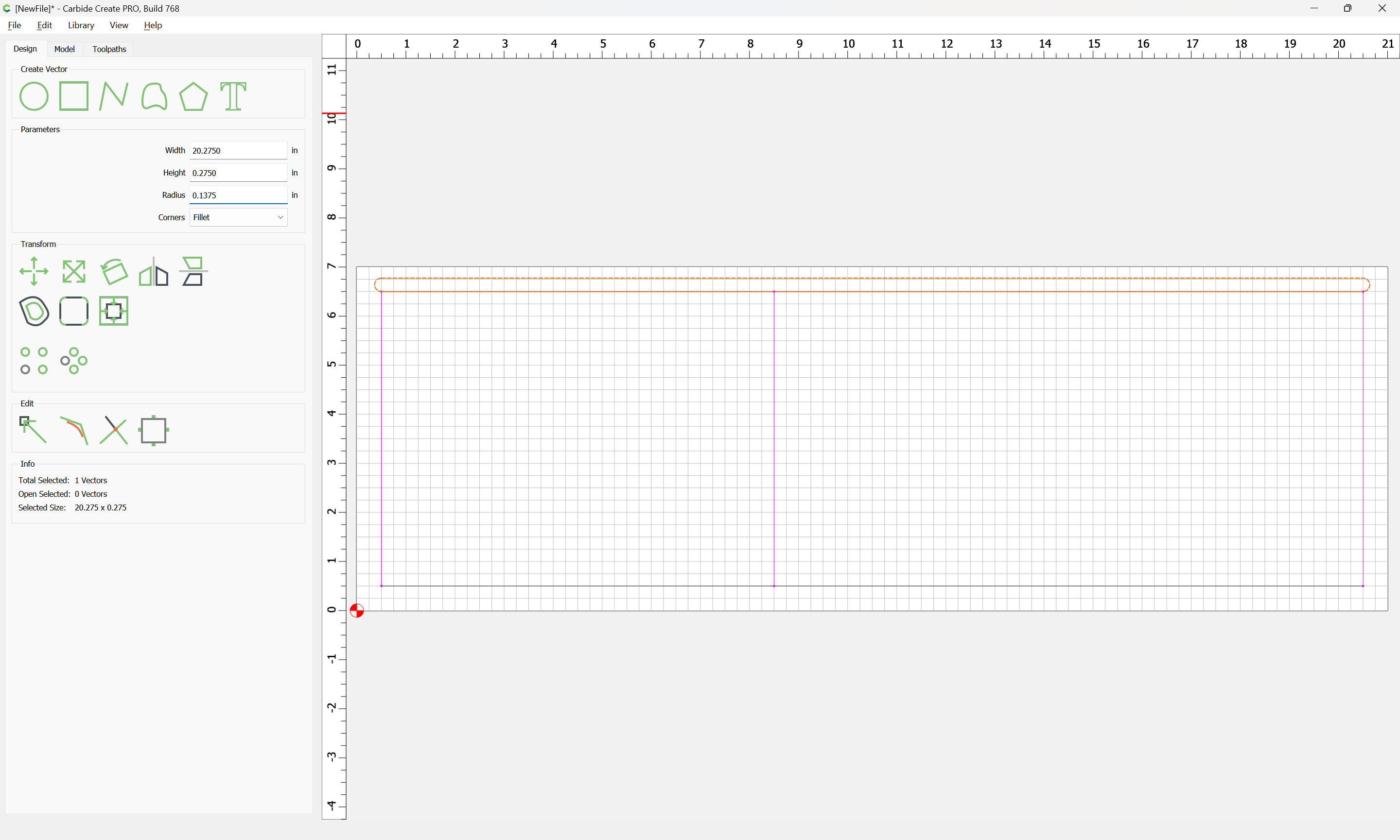

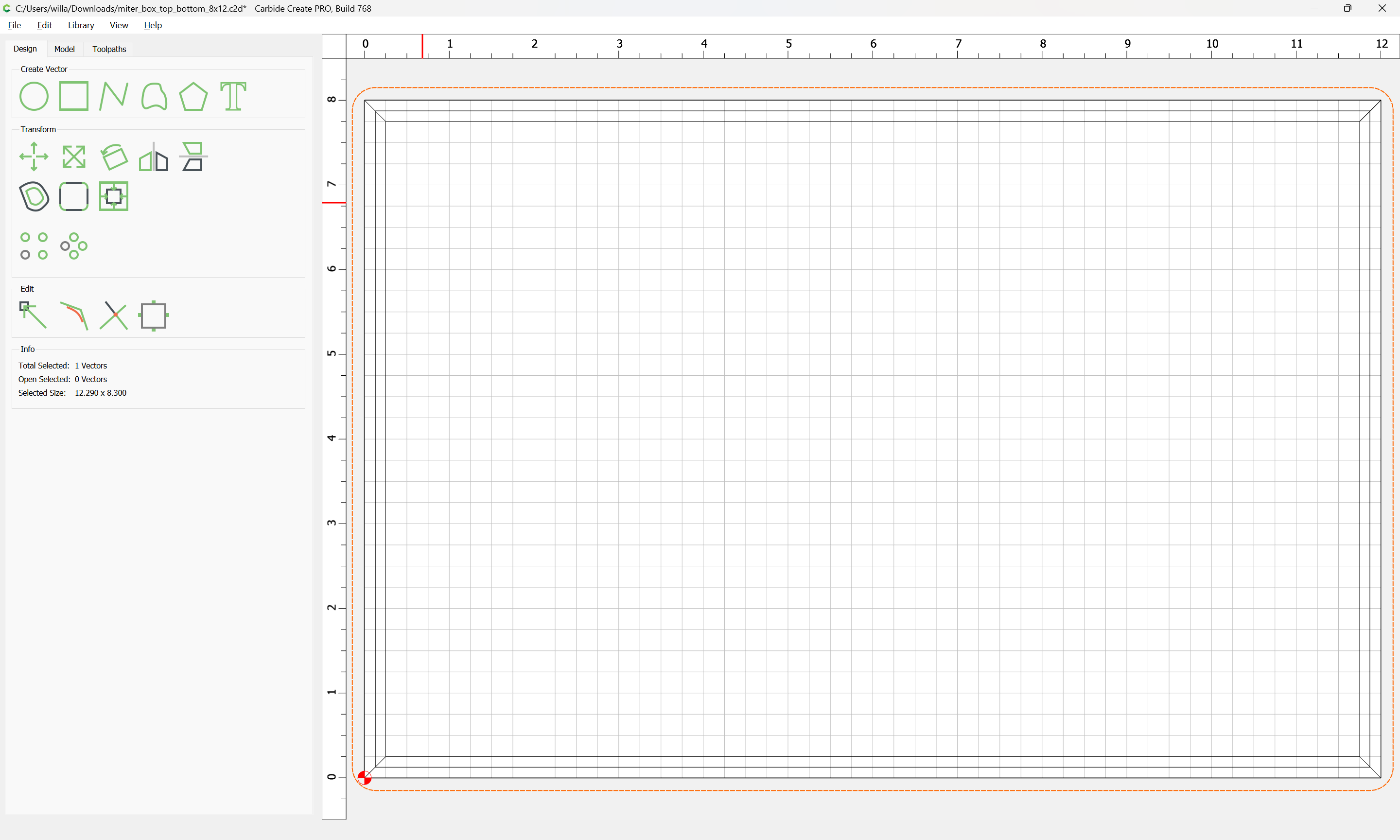

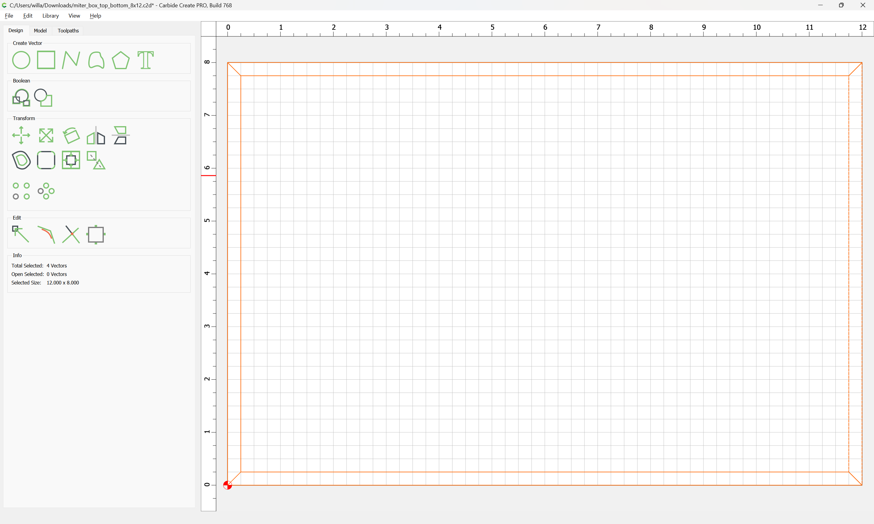

Draw in the geometry for the top/bottom:
and increase the size leaving a bit of room:
Offset by tool geometry plus 10%:
and cut as a pocket down to the bottom with the original geometry:
and set up the stock with suitable workholding (if need be reduce the Max Depth of the pocket and add an Outside Contour toolpath with tabs).
miter_box_top_bottom_8x12.c2d (60 KB)
