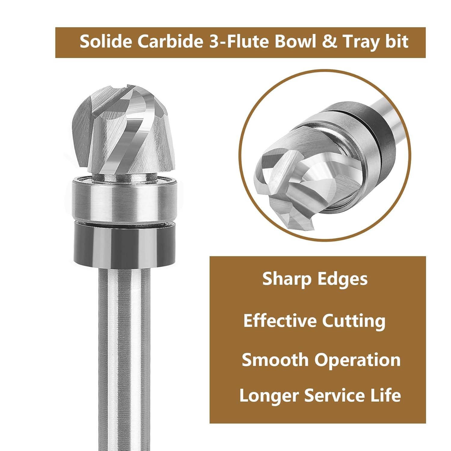

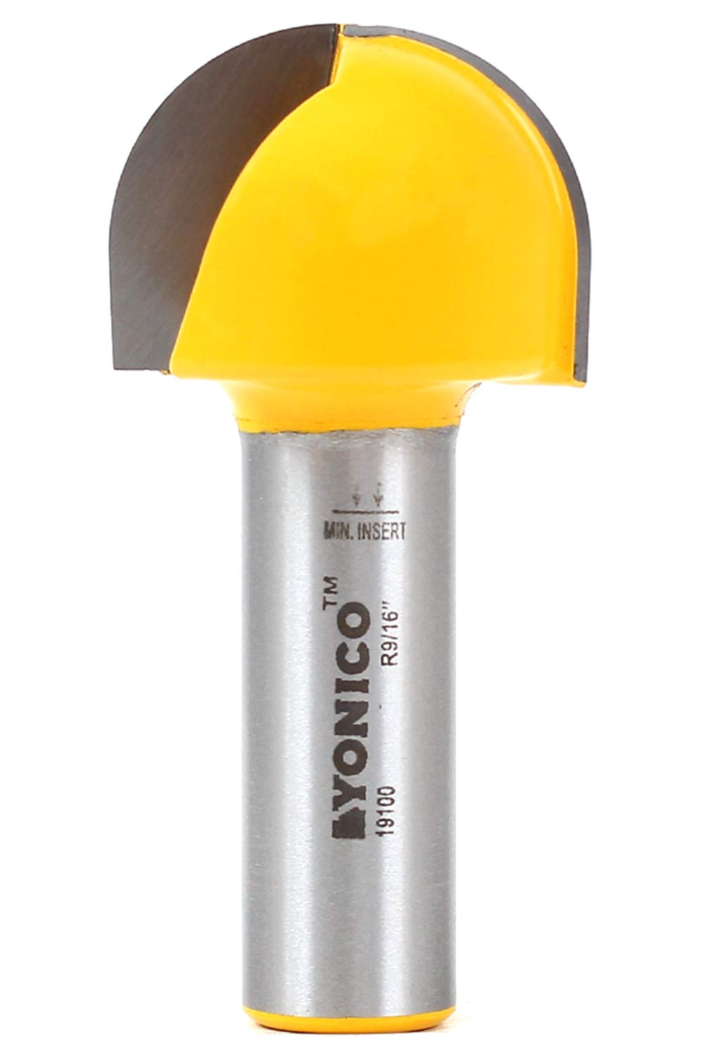

I wonder whether a kind of cutting edge instead of a scraper like in the usual v-carve bits would be better.
As example: I am very happy with such a bowl bit
(of course the roundover “collar” is removed) what has cutting edges compared to those round bits
that just scrape off the stock.
Accordingly with the first bit I get chips, while with the “scrapers” I get a lot of dust. And: the cutter has 3 flutes, gives a nice smooth surface.
Are those cutting edge V-carve bits available compared to the scraping edge ones that are available everywhere? And where to get from?

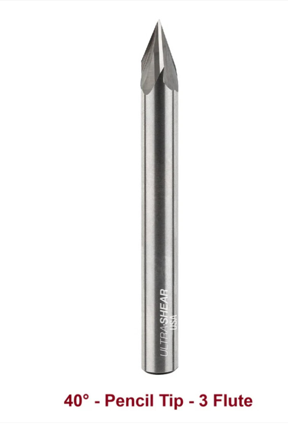

the ultra-shear bits are US-made, and have 1/4" shanks, 3-flute V-carve with a “blade” like cutting edge: piece of art if one asks me. Will probably be good to carve edge grain inlays.
However: Thank you for the referral!
