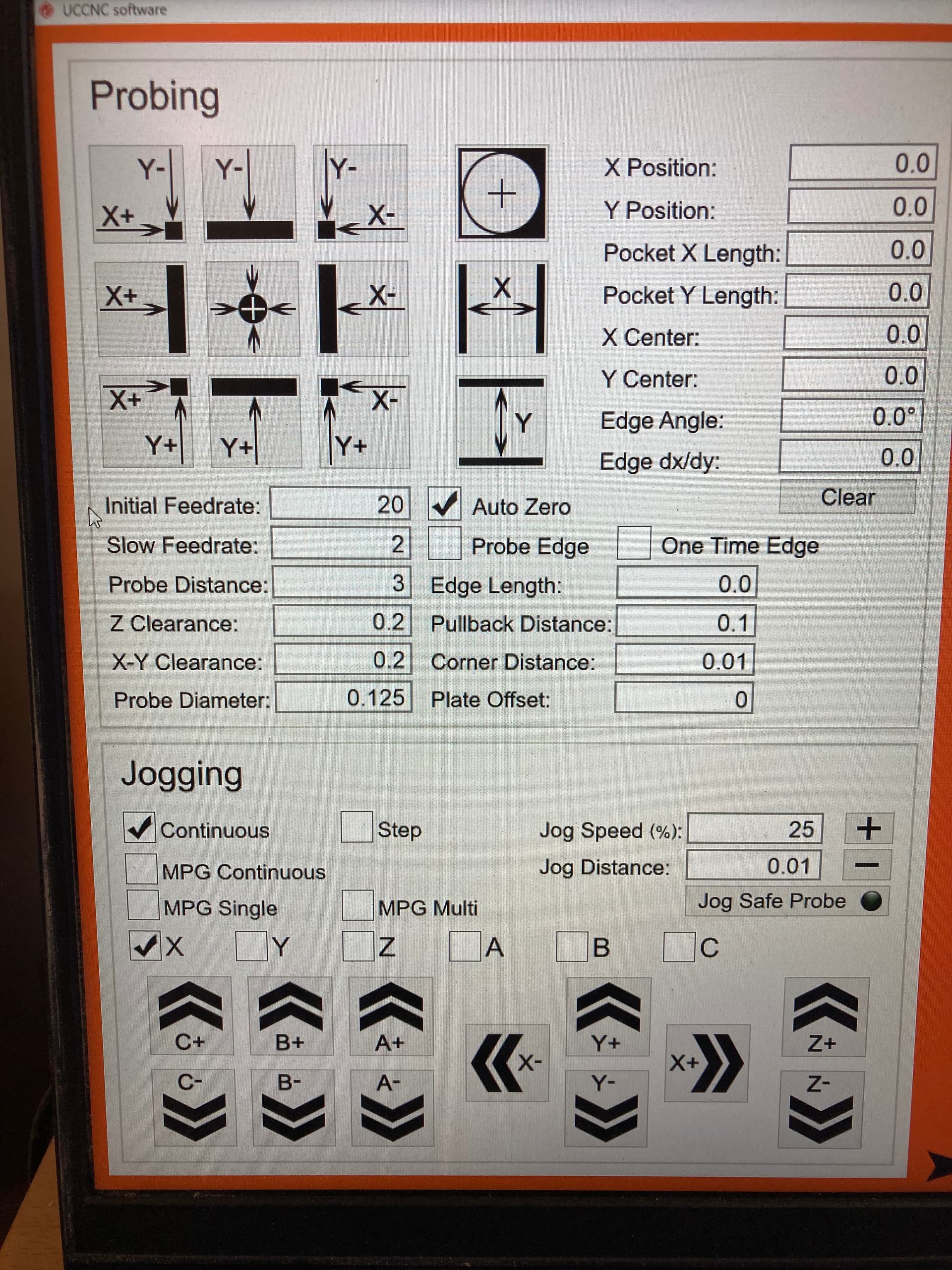

My current CNC uses UCCNC, a UC100 controller, and Gecko stepper motor driver. I added a commercial screenset to get fairly extensive probing macros (screenshot attached), which I use often. I also use the toolpath preview often, which is orthographic (important!) and shows machine position (also important). I do not know what I would do without all these features, yet I’ve not found solid GRBL control software with these features to date.

As I recall, GSender has a perspective viewer, not orthographic, which makes it useless for my needs. Also I looked into writing probing macros to cover my needs and ran into issues, can’t remember the specifics. All the GRBL SW I’ve looked at so far has seen half baked compared to UCCNC and my commercial “screenset”
