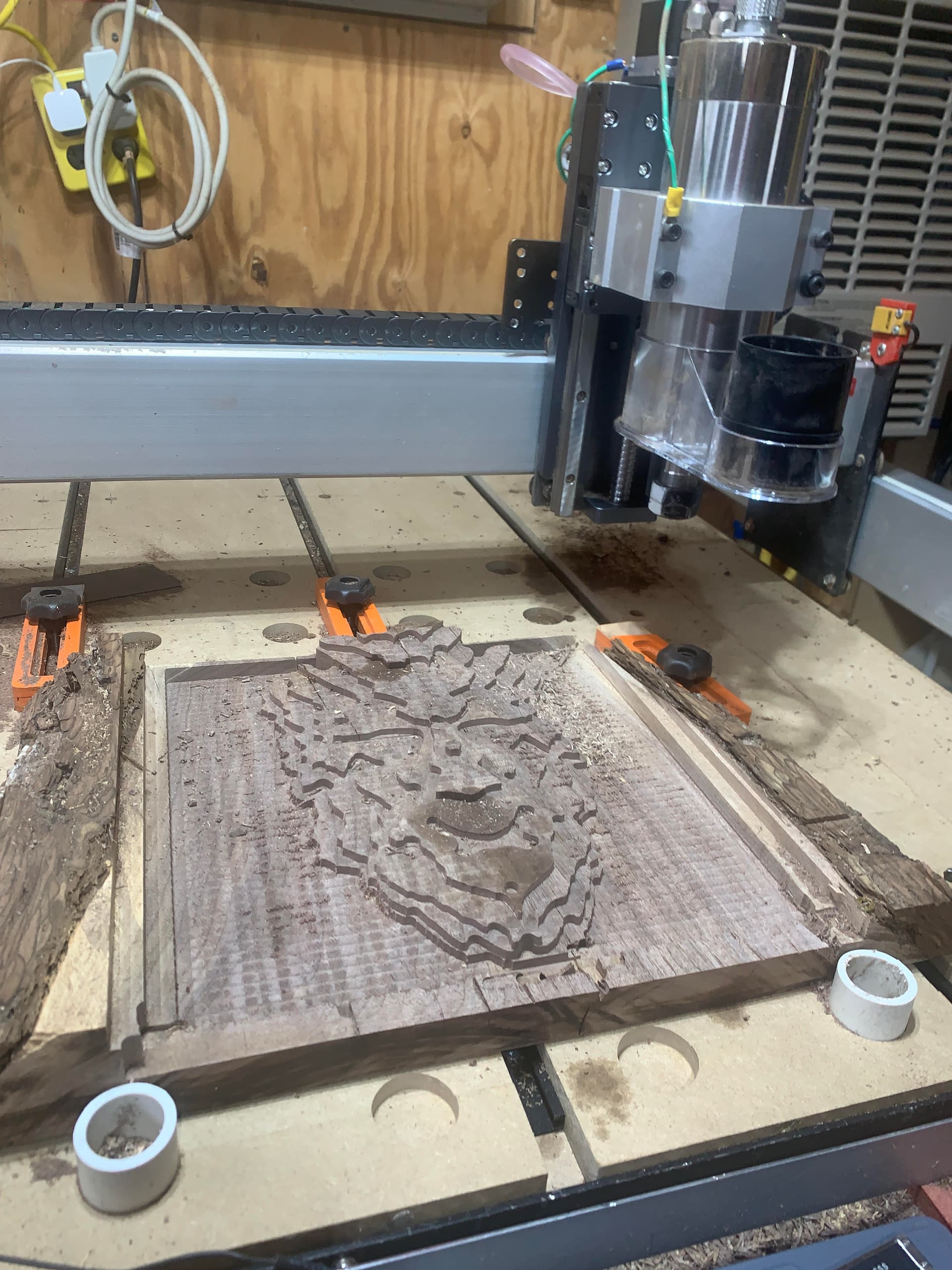

I’m working on my first 3d carving in Carbide Create Pro. I’ve completed my 3d rough in a rather thick piece of walnut, about 2" thick. Any suggestions on what endmill to use for finishing? I purchased the 101 but didn’t realize that it was so short. I’m worried that because of the height of this project the collet will hit the wood.

That said, if your sculpt has the clearance, a tapered ball will be much stronger at those lengths.
Keep in mind that you may not need a flute length as long as your material thickness. So something like the linked tool below with only 1” of flute length may be just fine if more than 1” of material is never cut at once and your shank never rubs on remaining stock.
Something like this is commonly used for 3d carving:

If you put your 101 endmill in and jog around to the steep areas of the material with the spindle off you will see if it comes close to hitting.
Just remember that CC does not model tapered ball nose bits, so your preview will not be as accurate. I’ve ruined a cut or two forgetting that. I’ve used the long reach Amana 46284, it does a good job. I’ve also learned to pocket around the edges of a design so as to leave clearance for the tapered shank.

I’ve ordered the Kodiak. The Amana looks like a good bit to have in your arsenal but spendy. This has been a real learning curve. I’m embarrassed to say I’ve ruined a few end mills. At first I used a 1/32 for finishing on a shallower prototype piece and ended up smoking the project. I learned the hard way about creating a perimeter pocket for side clearance. Didn’t make my offset wide enough and got 90 minutes into the roughing pass and had to shut it down. I wish there was a way to restart a tool path from a certain time index.
