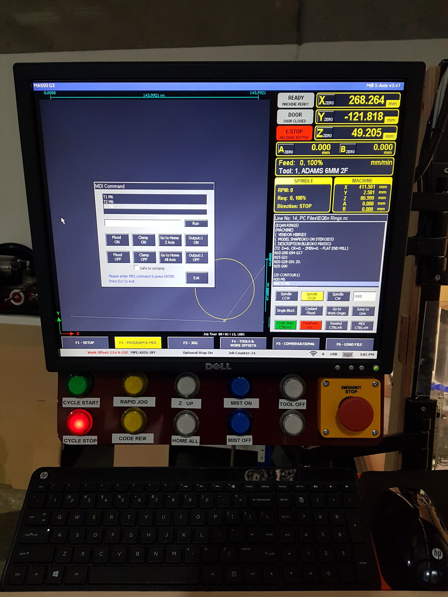

Today’s update!!!
Love buttons!!!
LED on the green Button when running the Cycle/
Led on the red button after stop is pressed, or soft limits reached
Bit of wiring done
I can’t wait for the ATC to arrive!!!
And then the enclosure for the machine will happen!!!
