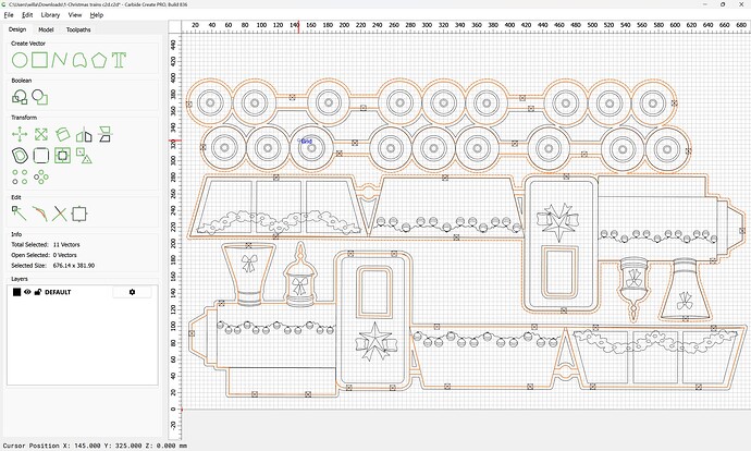

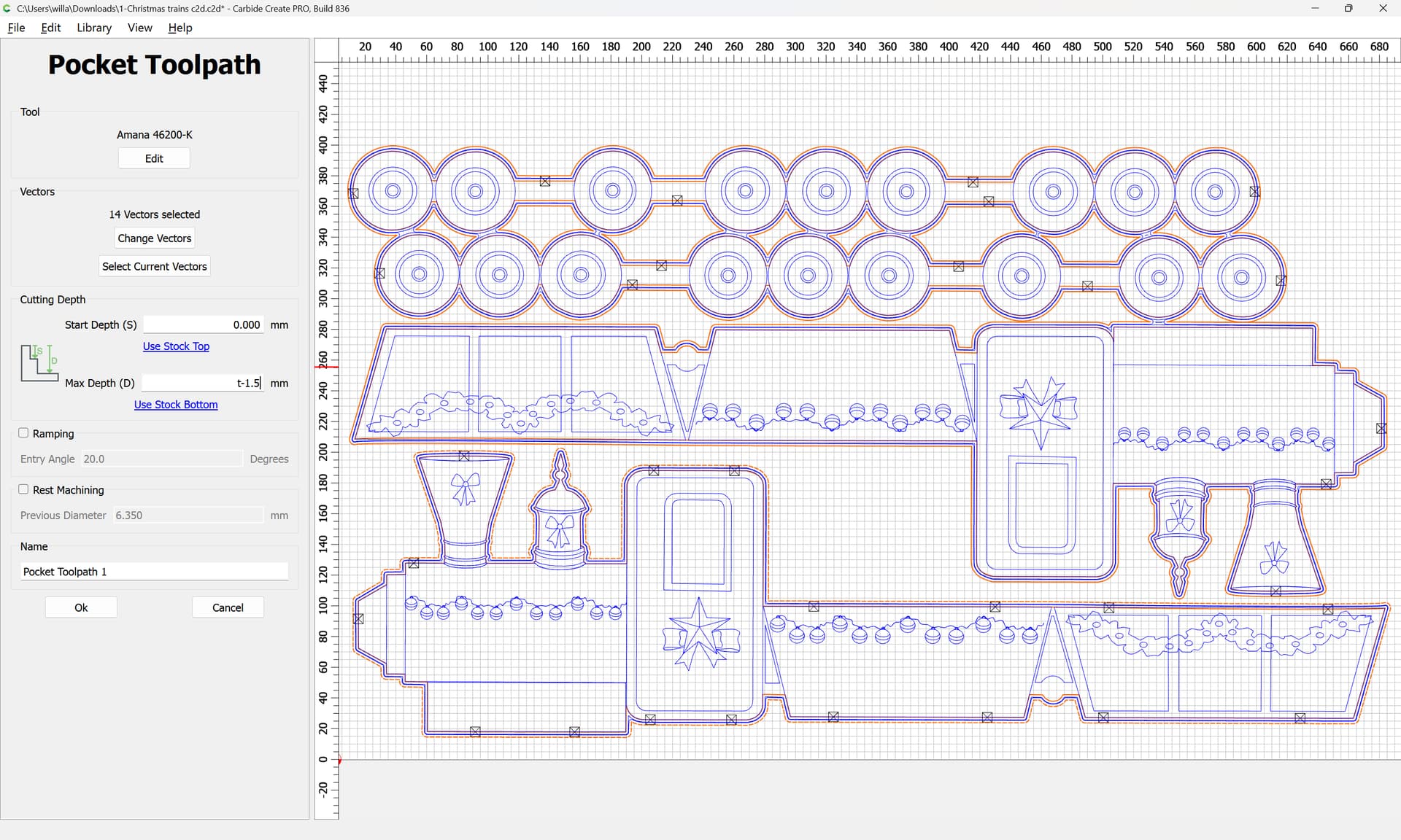

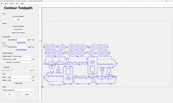

My Shapeoko Pro 5 went suddenly crazy

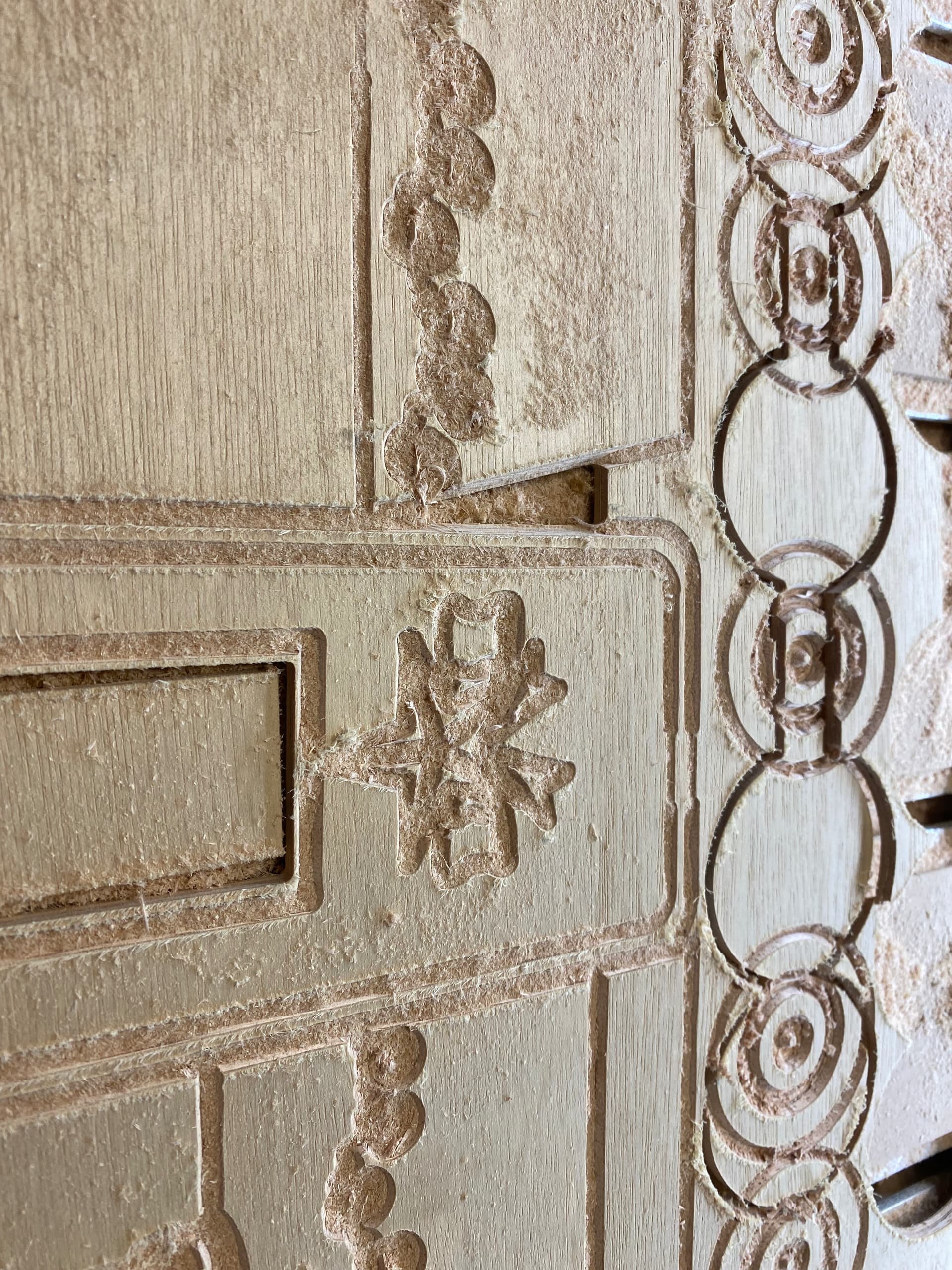

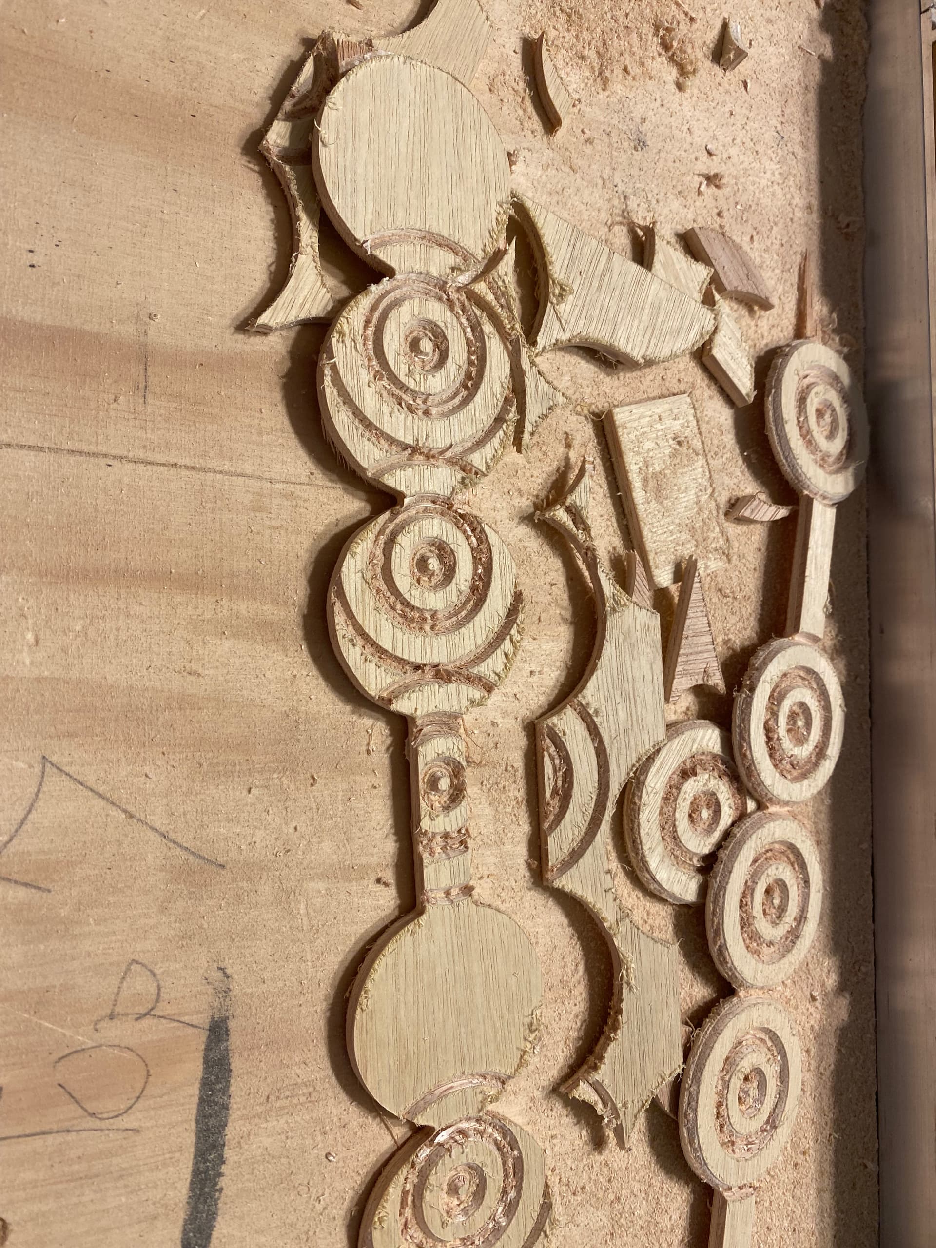

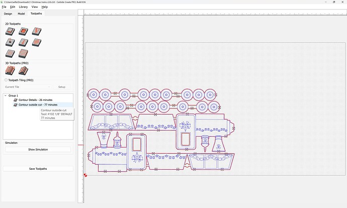

My Shapeoko is still new, I started few weeks ago working small steps on it.
Yesterday after finishing the engraving with V-90, changed the bit, hit ok, but the machine started cutting the wrong place, it’s like something shifted the orders around an inch to the right, then it did again the same thing till it destroyed the design completely, I grabbed them pieces.
I don’t know what to do, :face_exhaling:, all this is very new to me :anguished:.
Can anyone advise me how to fix this issue please?

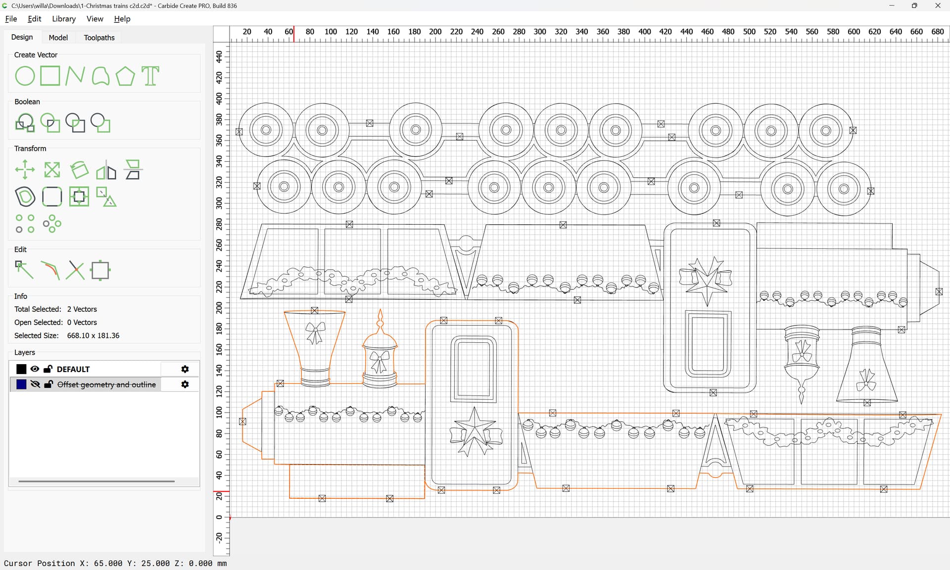

Saw your ticket and it had the file, so am responding here.

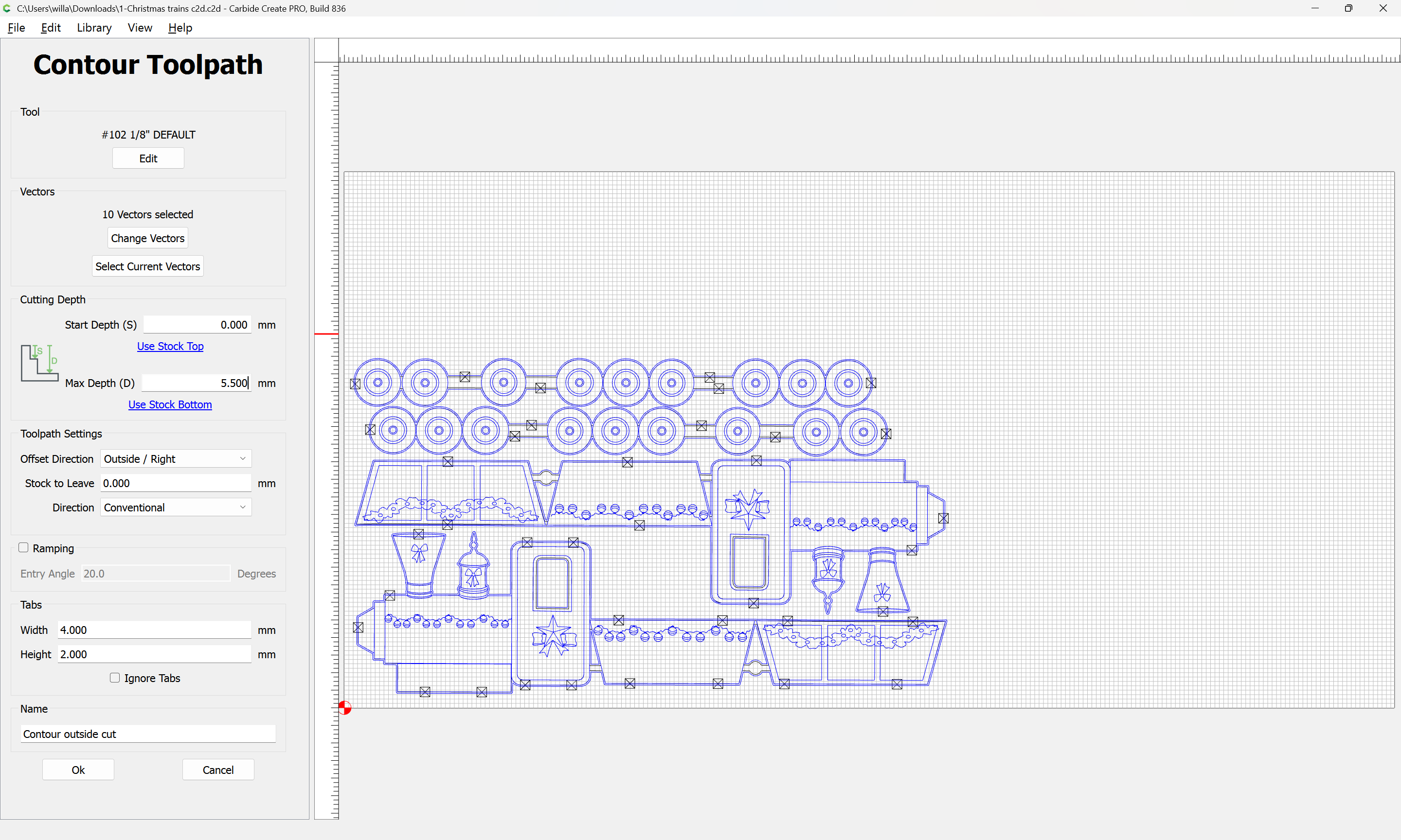

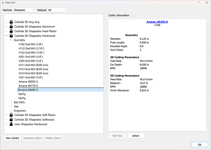

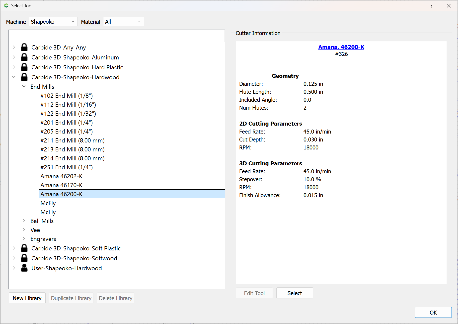

One issue is that you are using the #102 DEFAULT tool to cut a slot 5.5mm deep:
this is almost the diameter of the tool, resulting in high tooling engagement.

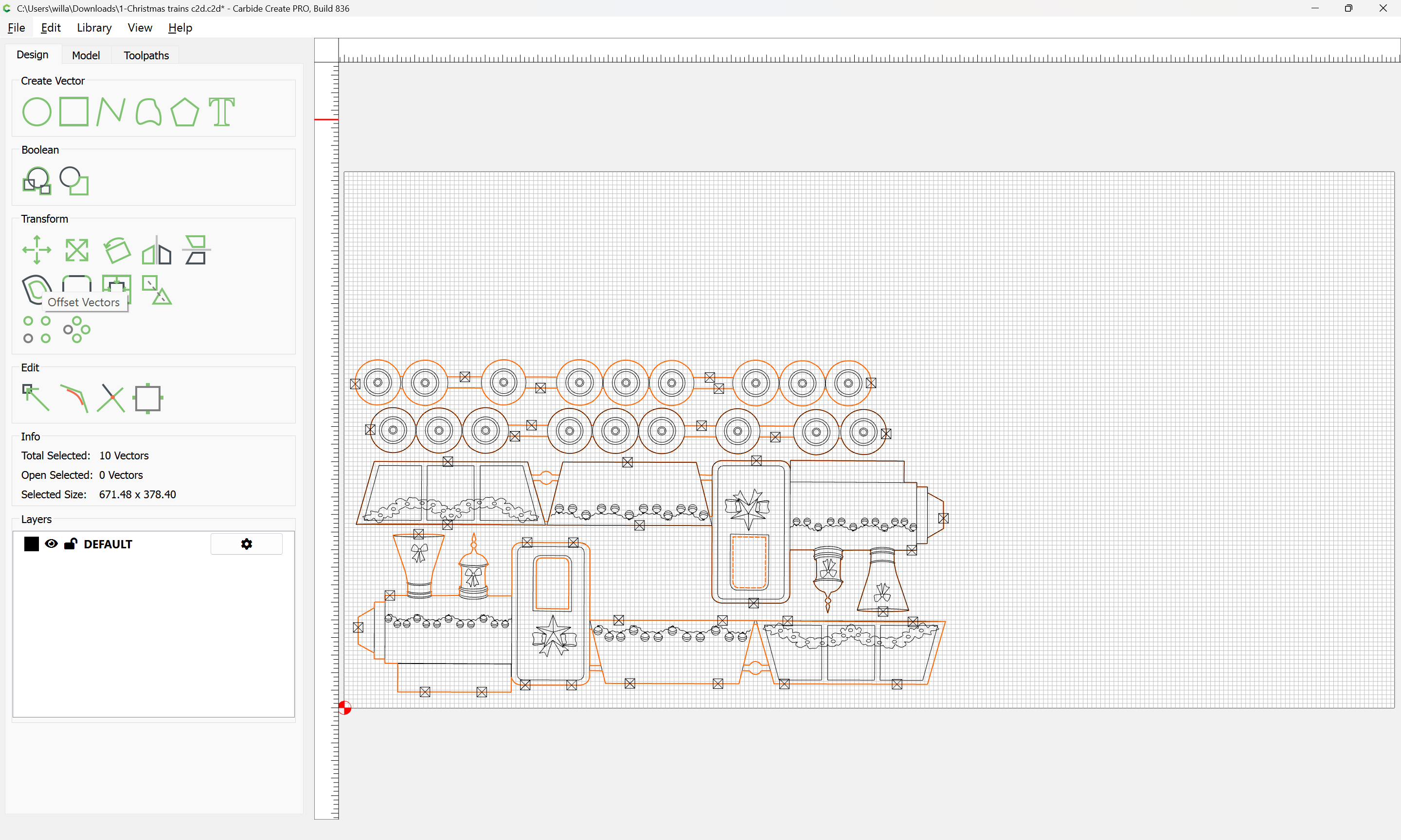

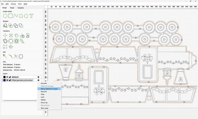

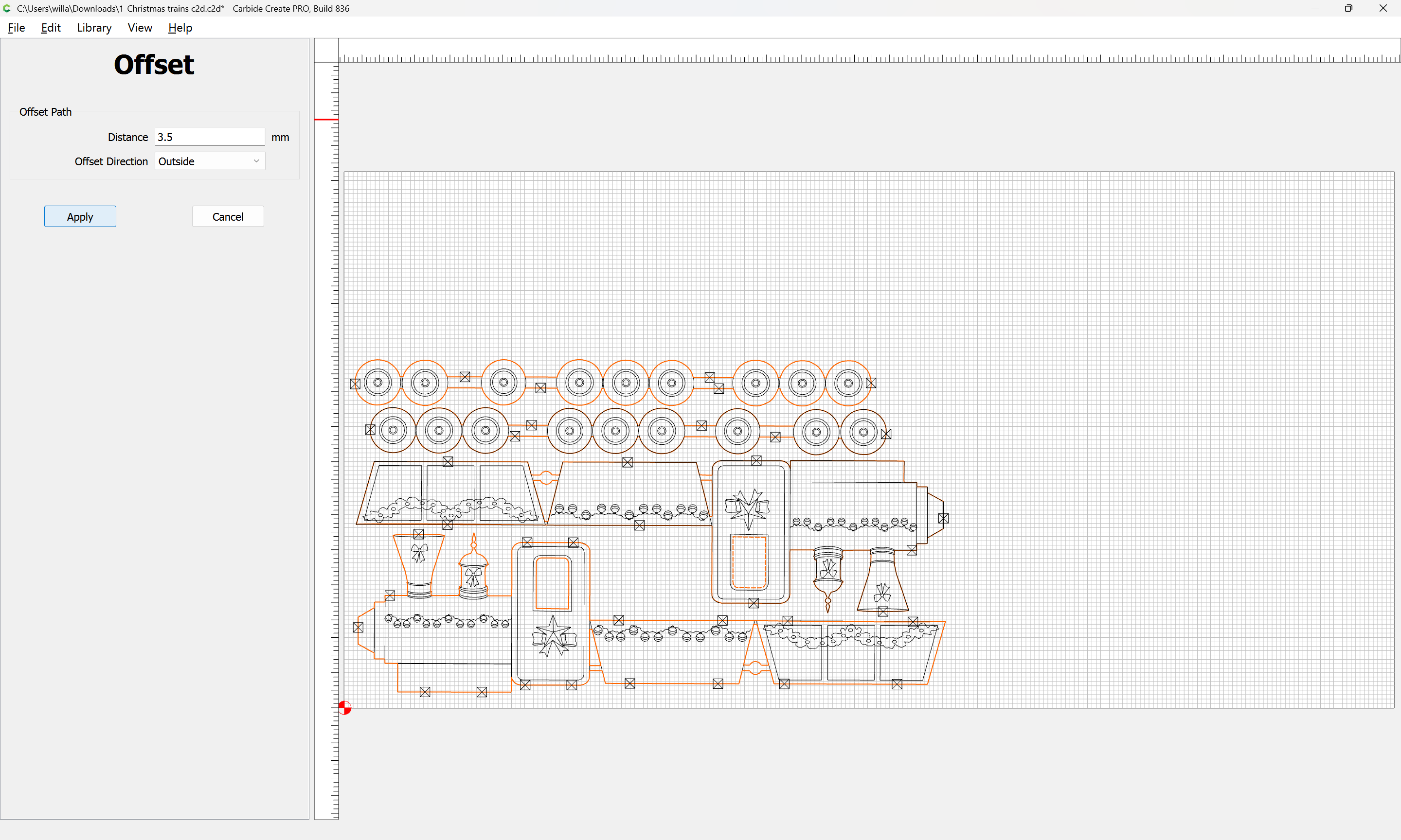

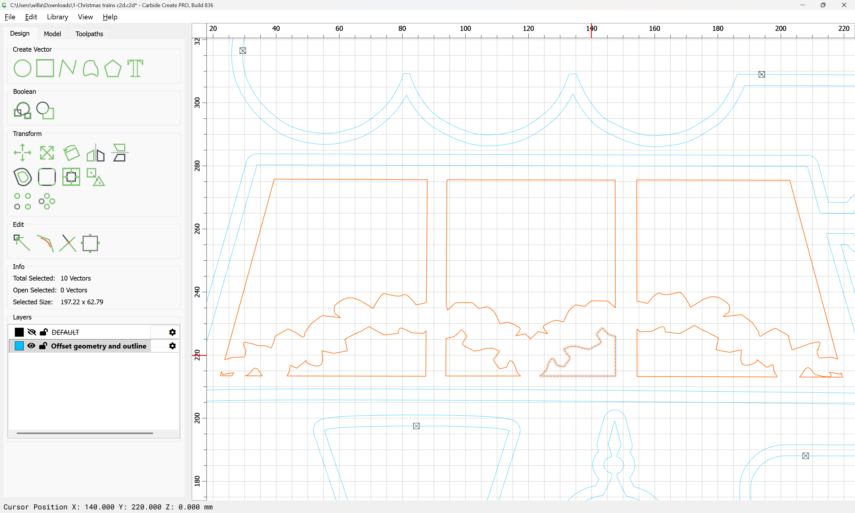

It would be better to offset the outside geometry:
by tool diameter plus 10% or so

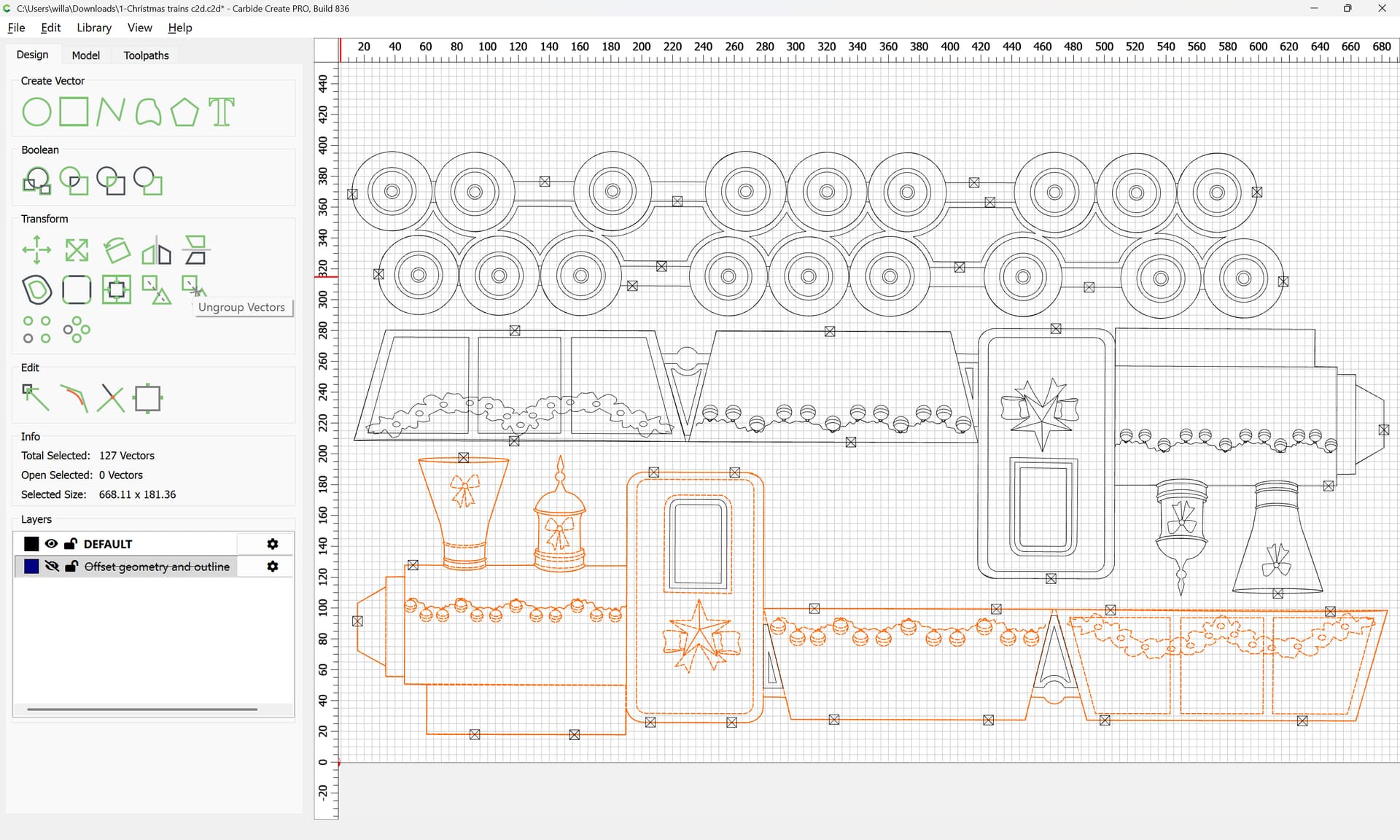

Apply
Then, use that, grouping it:
and the original geometry:
to cut as a pocket down to tab height:
using a suitable tool:

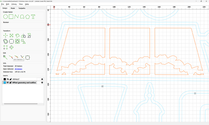

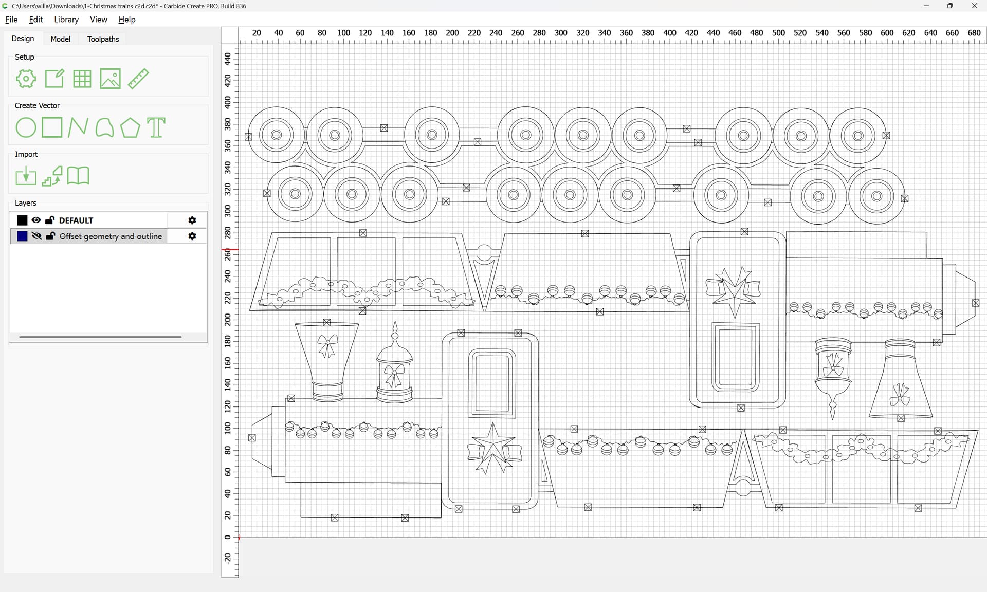

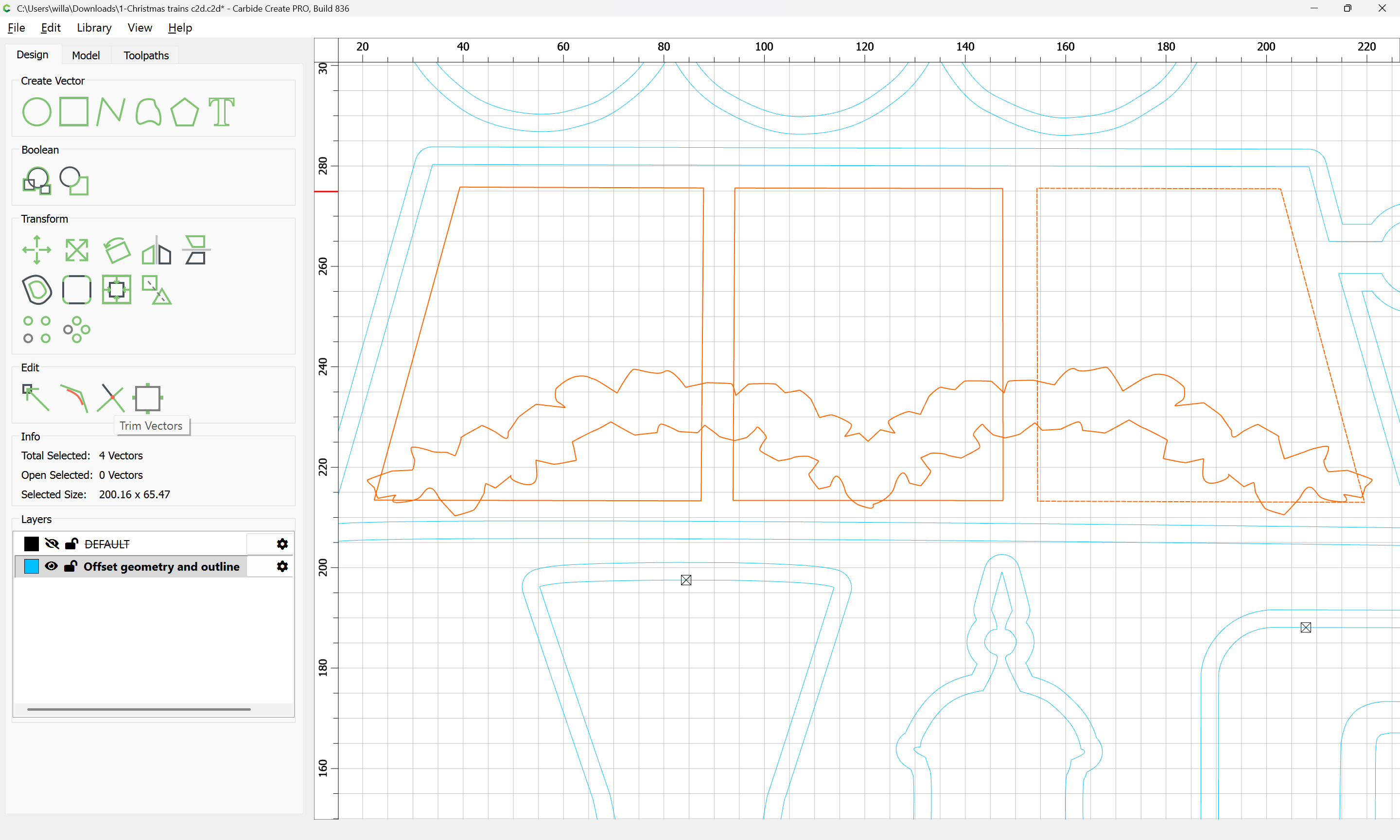

One issue is that there seems to be doubled up geometry which is confusing the toolpath generation…

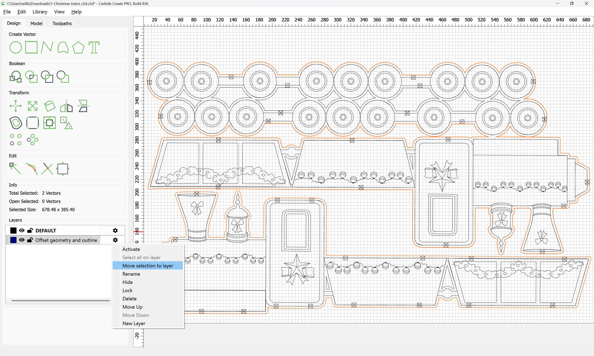

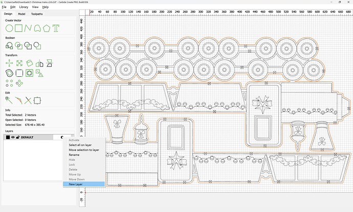

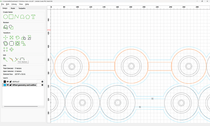

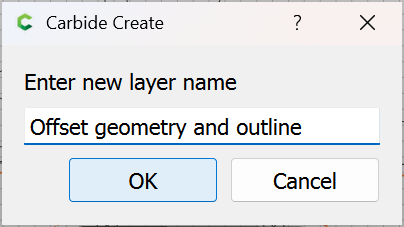

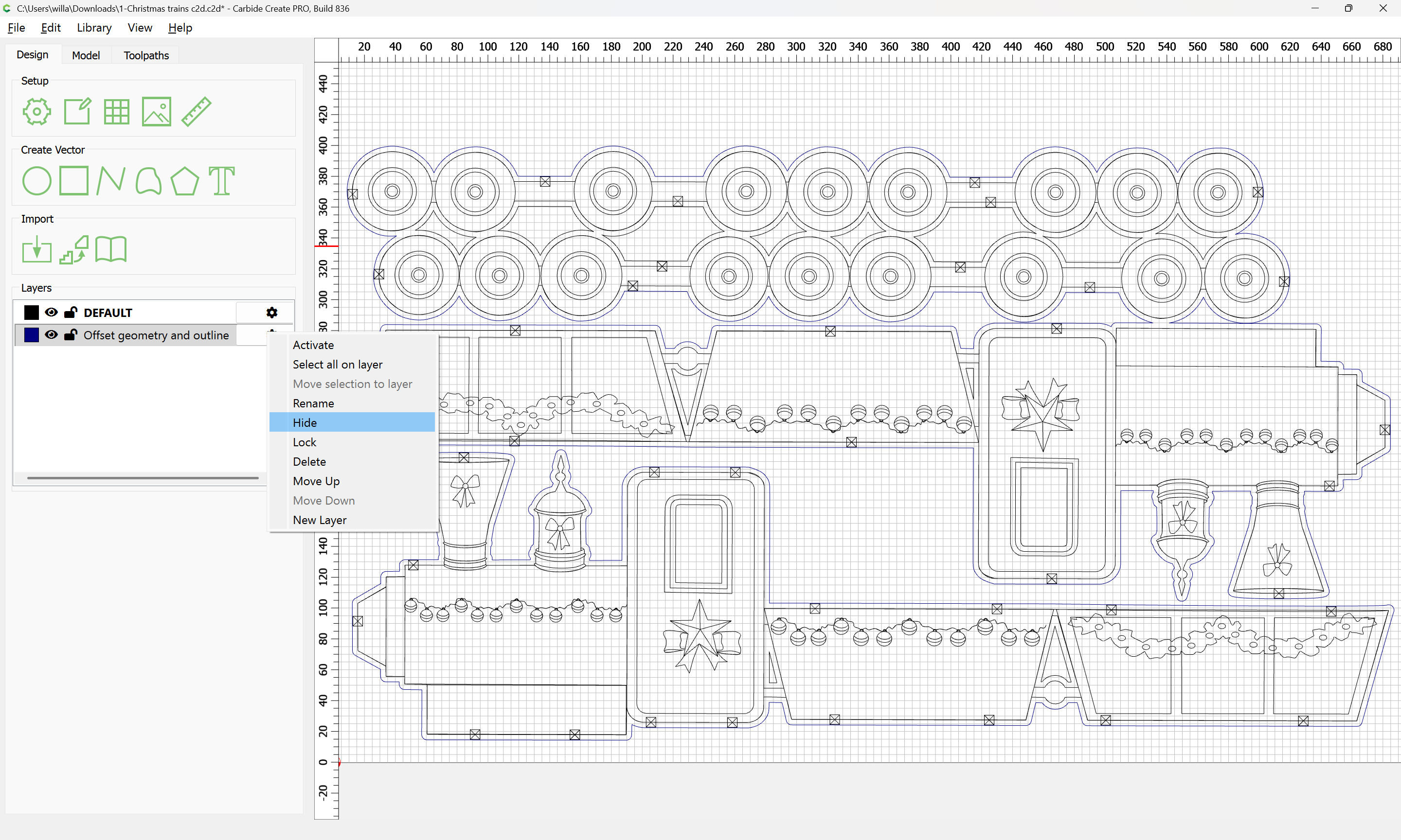

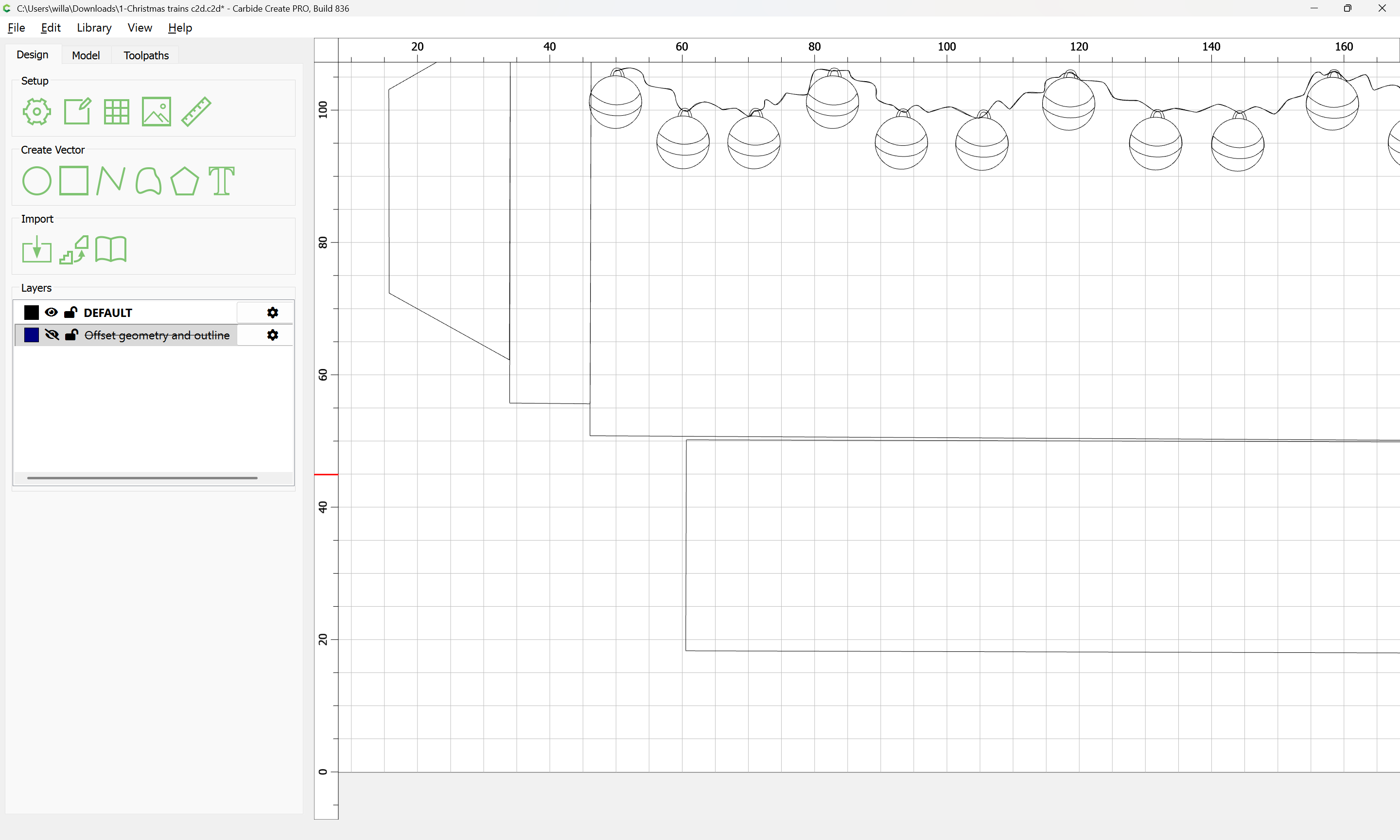

The best way to work with complex projects is to divide and conquer using layers, so we start by creating a new layer and putting the offset geometry on it:
OK
then move the selected geometry to the new layer:
and hide that layer:

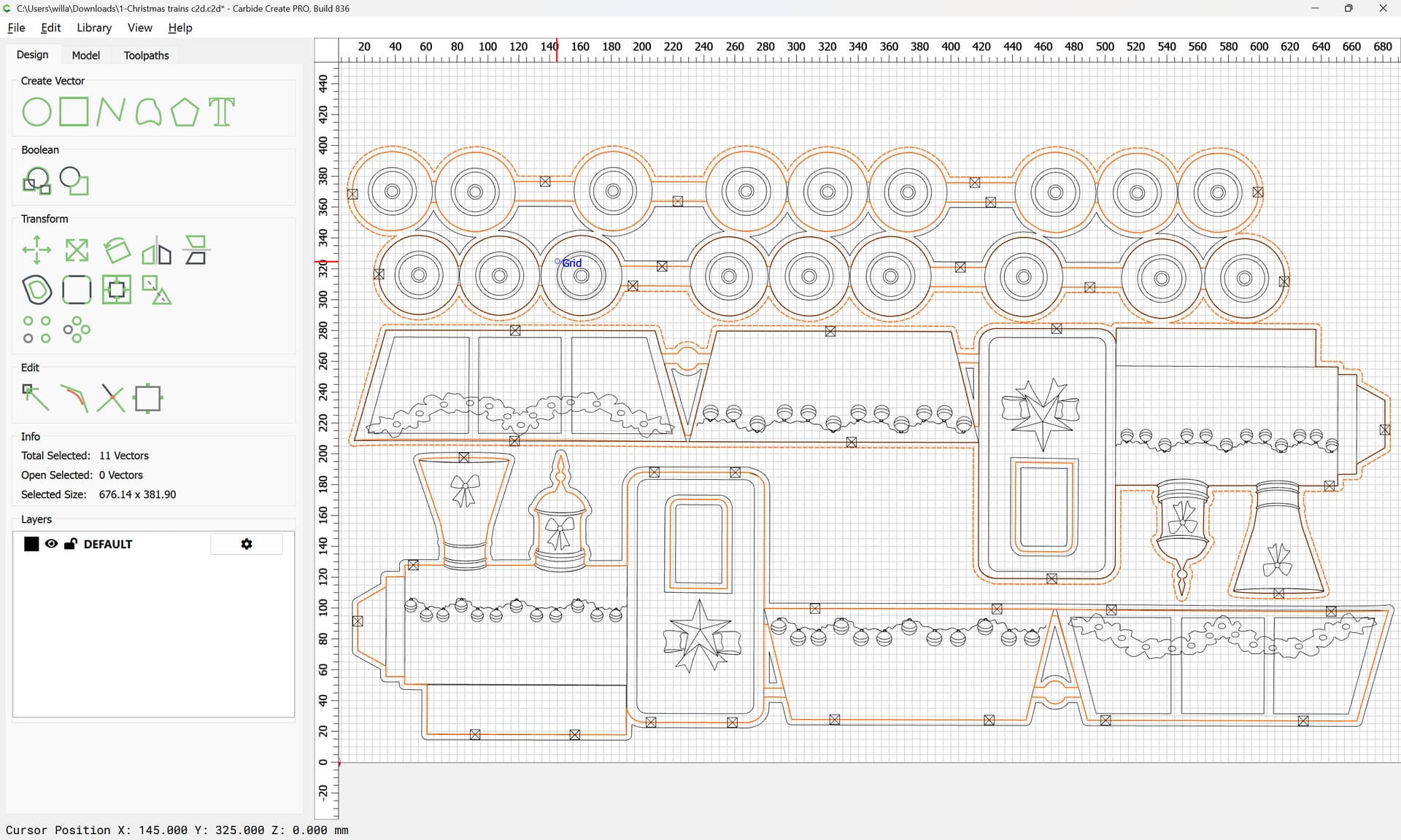

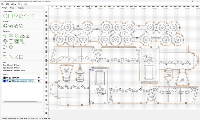

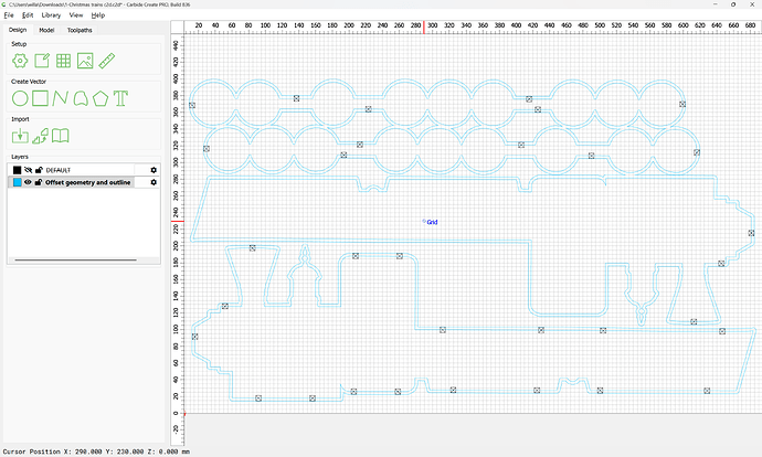

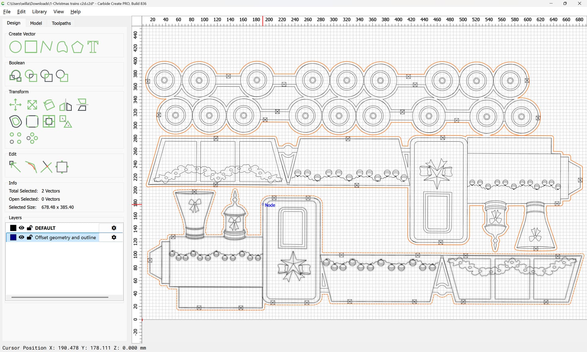

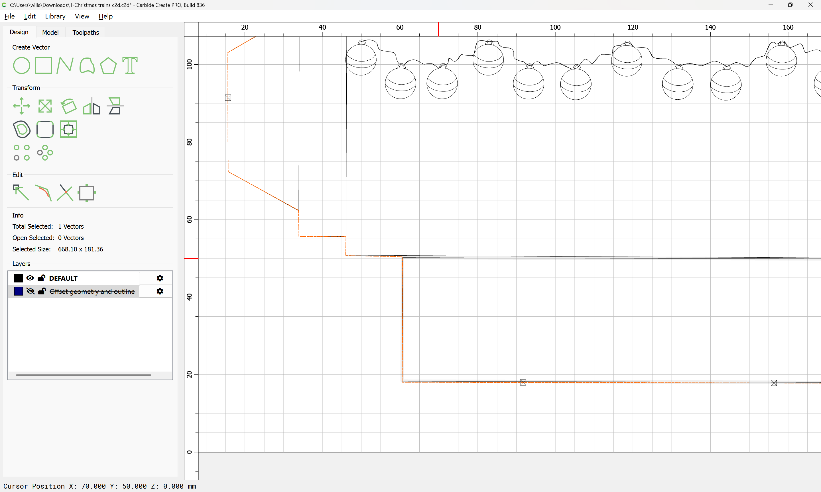

Then drag-select regions of geometry so as to select only the outline:
and where necessary ungroup:

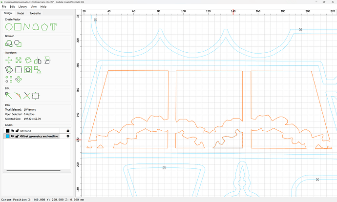

Select only the outline:
and put it on the hidden layer:
Repeat this for each other outline

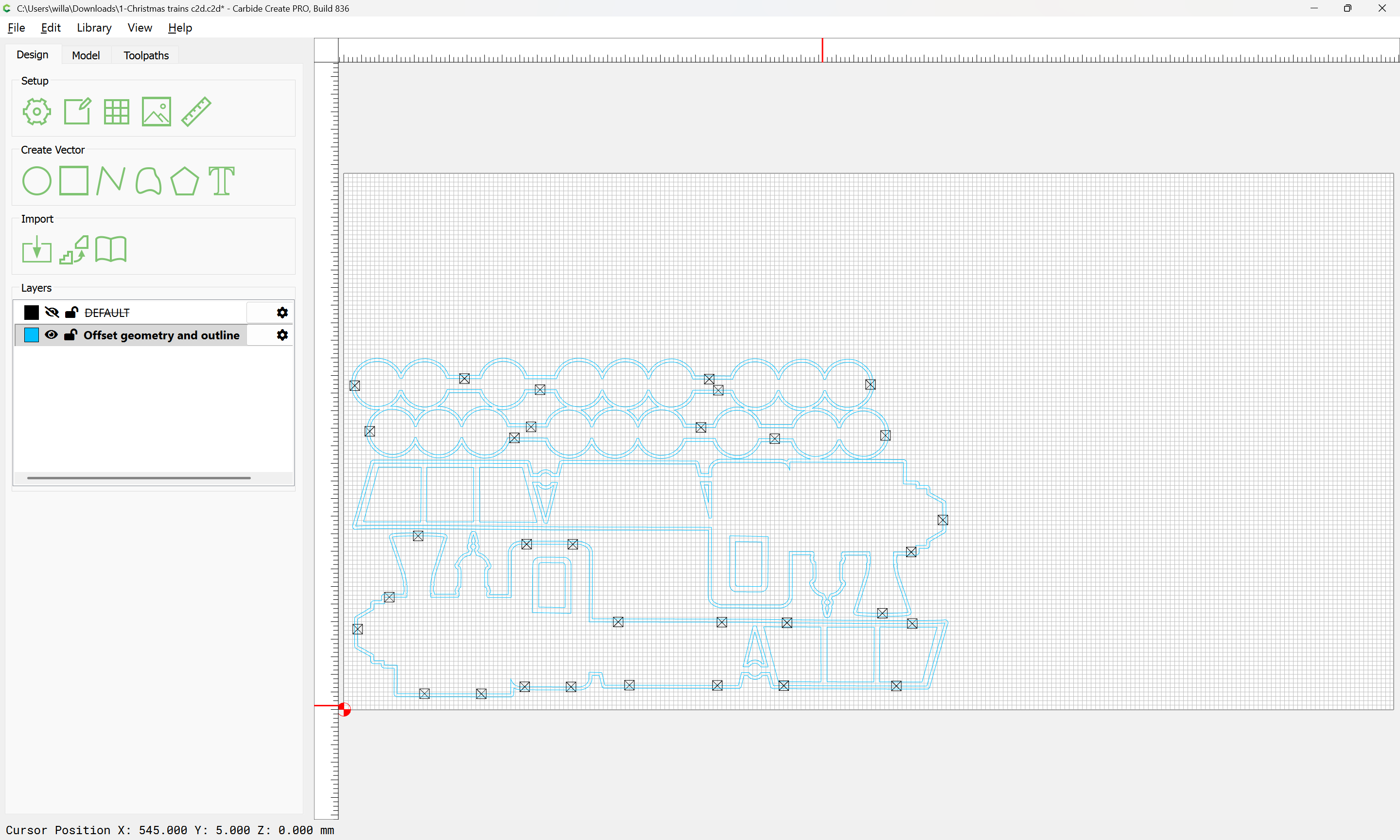

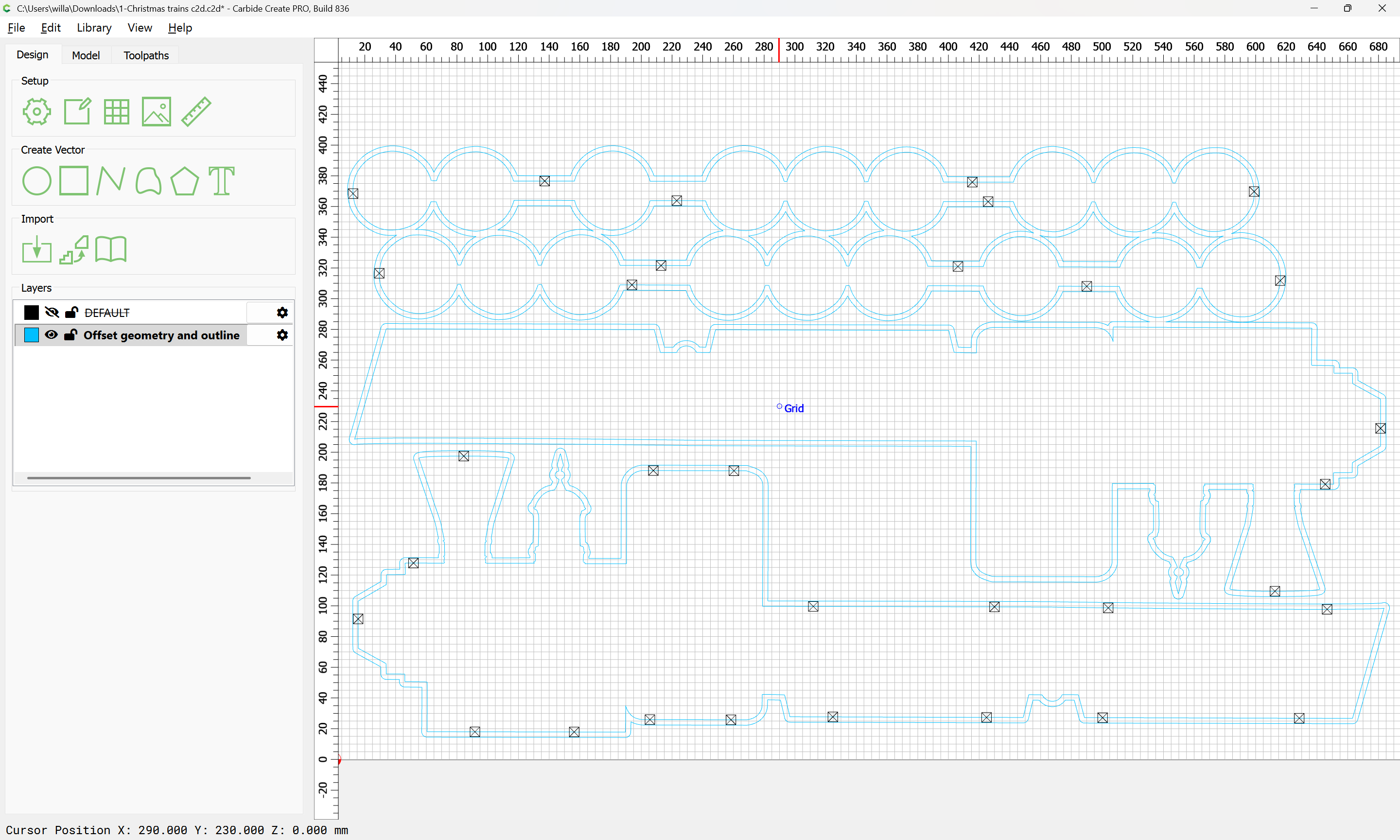

Eventually one has:
which may be used for the pocket:
Adjusting a bit we arrive at:

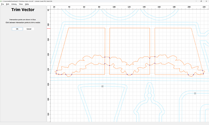

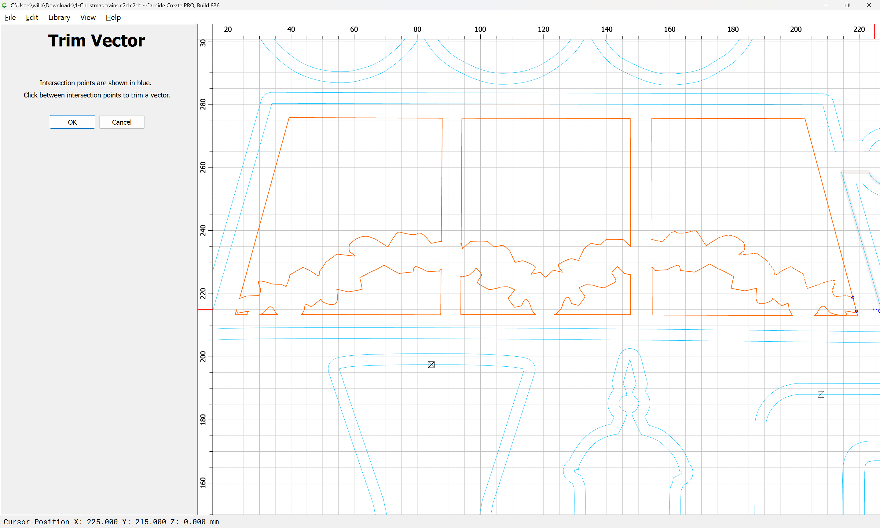

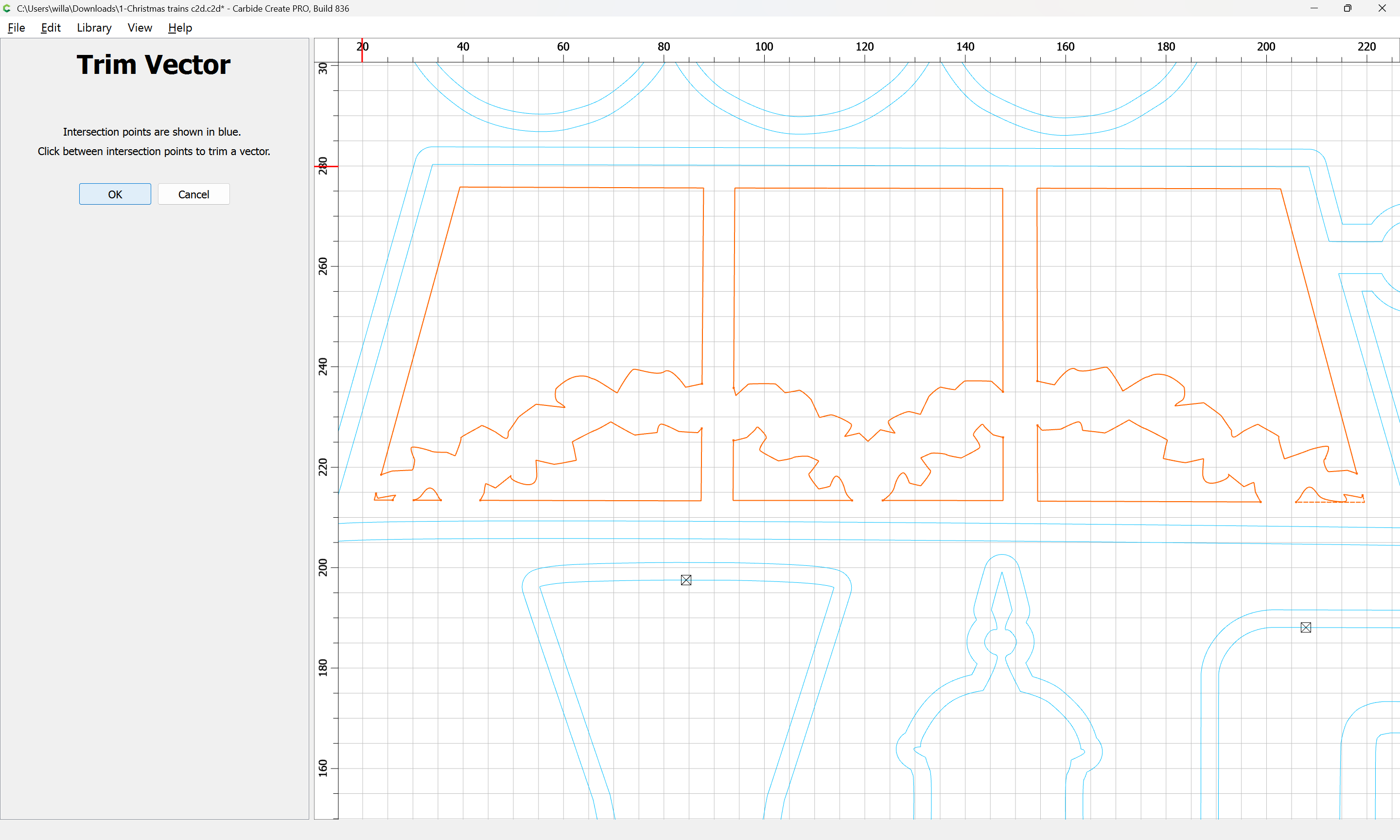

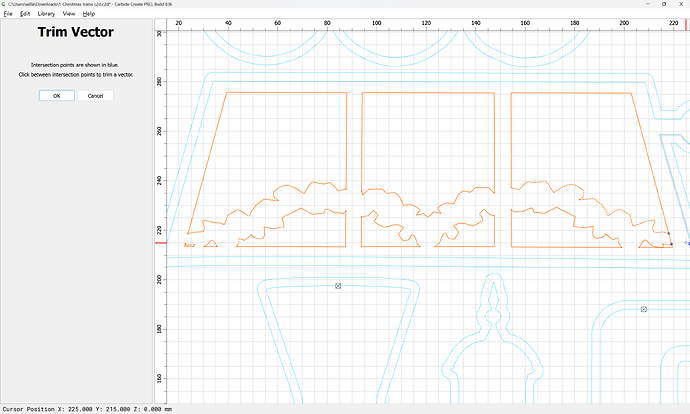

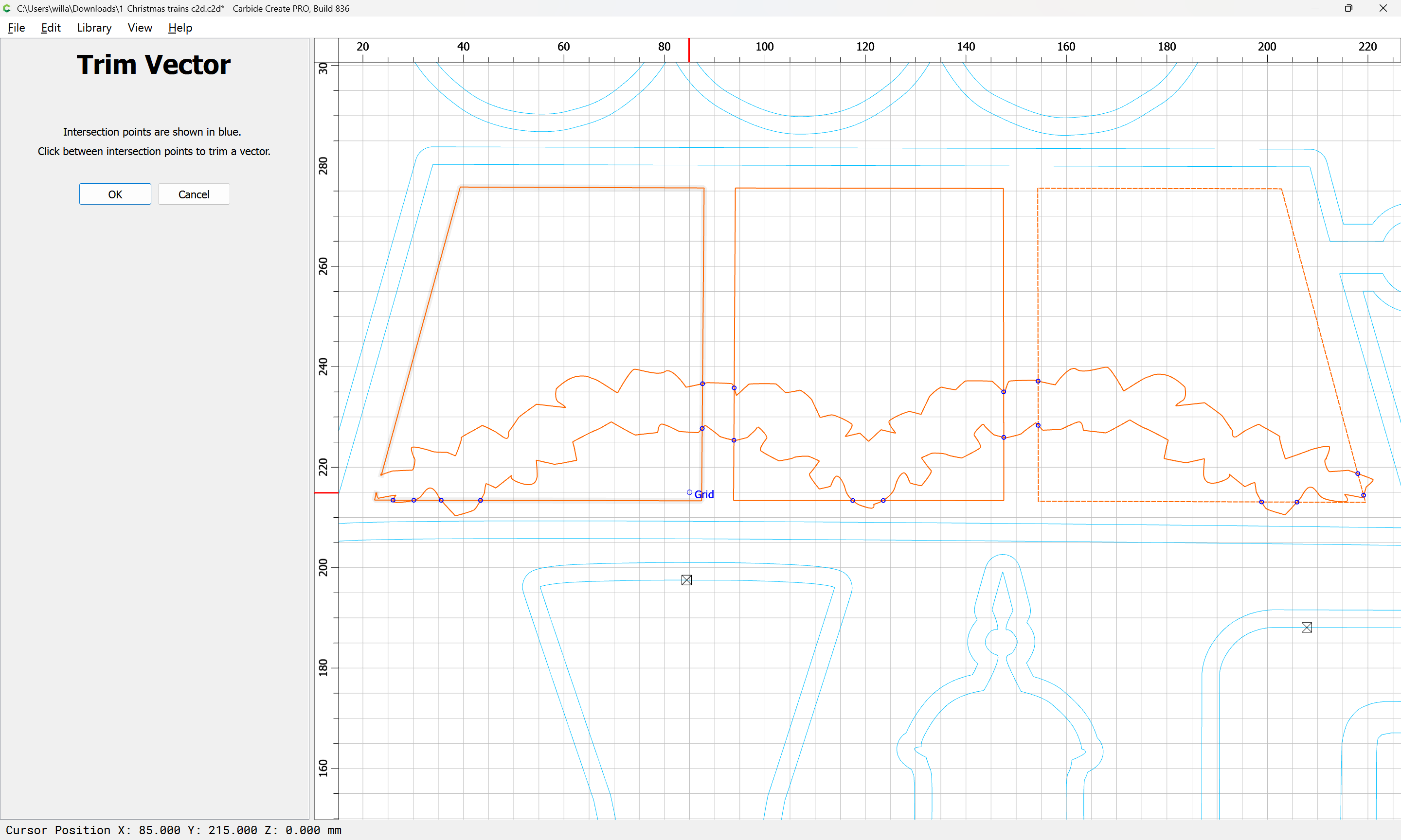

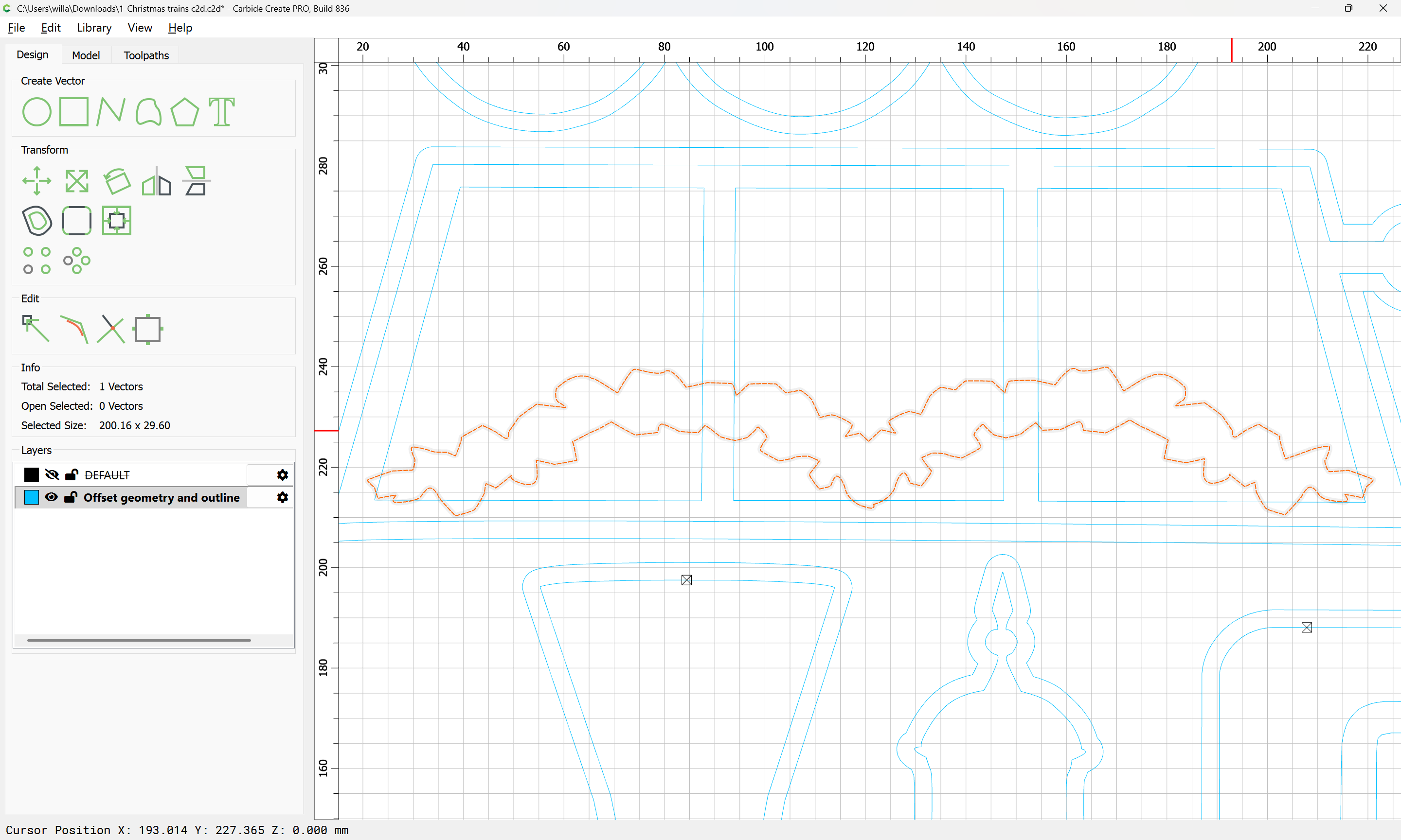

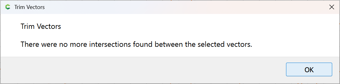

However, there is a decorative element across the windows and so forth:
which needs to be added to the region being cut away for the windows:

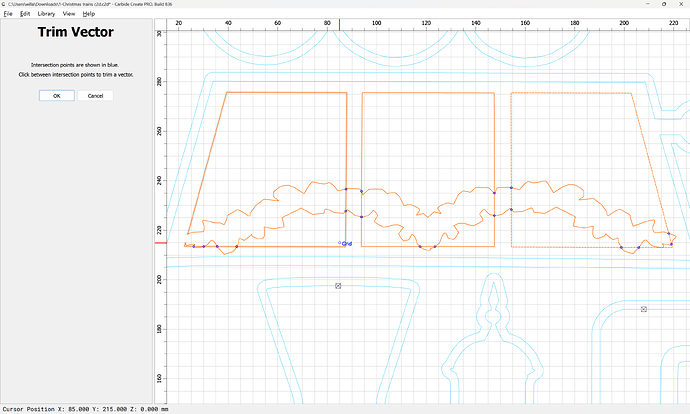

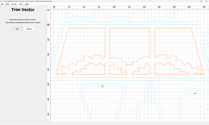

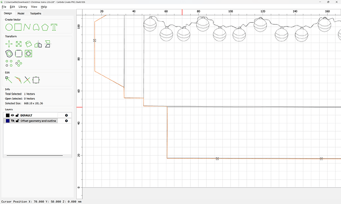

Trim Vectors
repeating
until one arrives at:
OK
OK

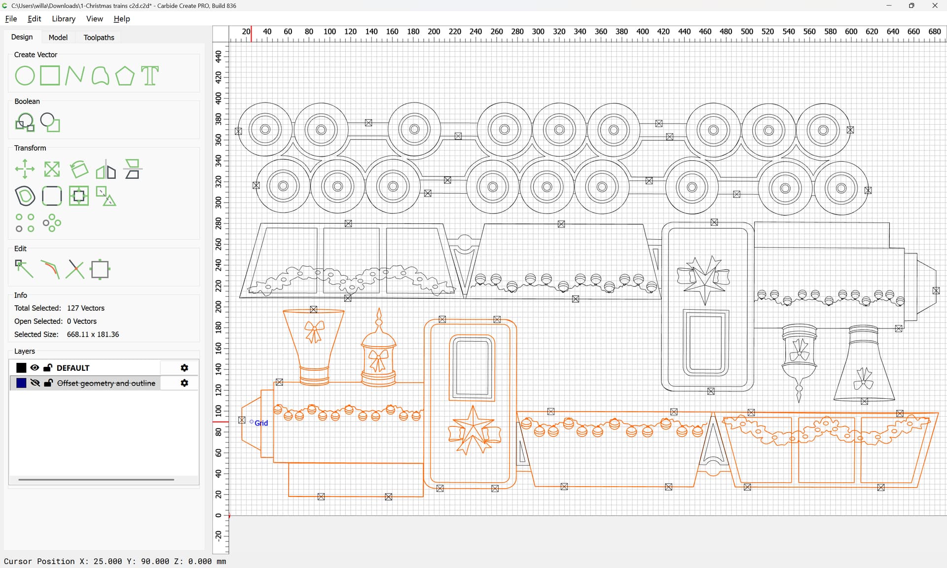

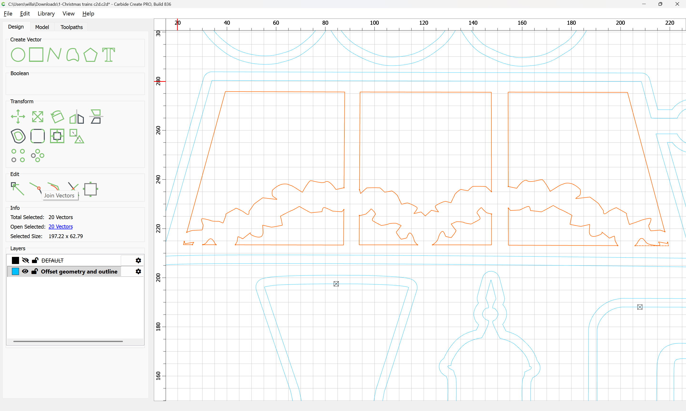

Join Vectors
Yes

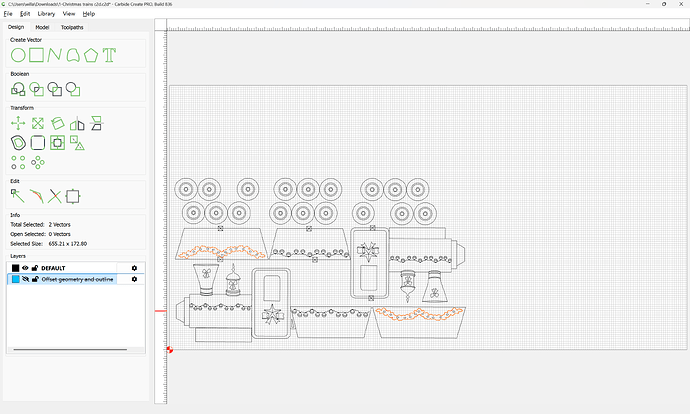

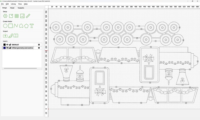

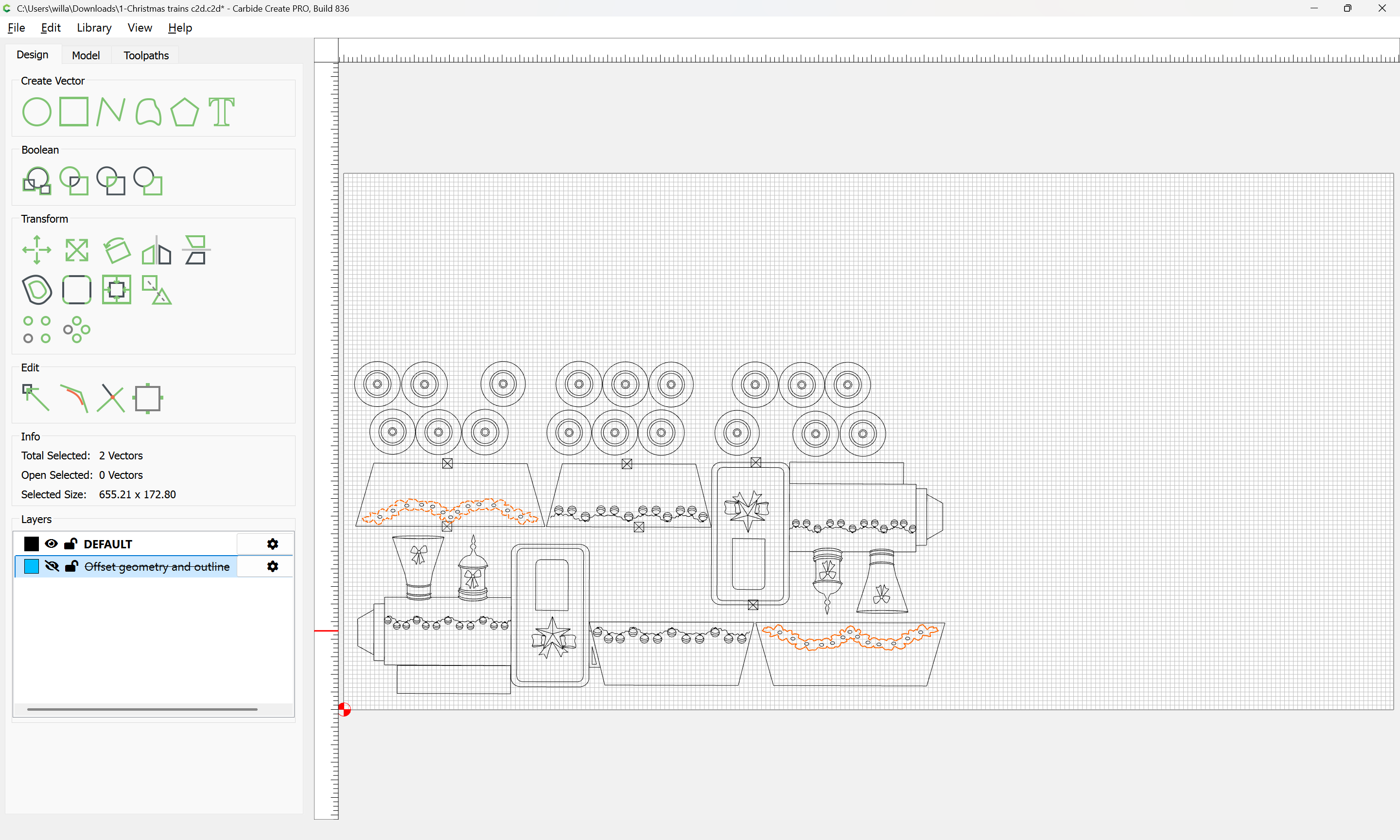

It will be necessary to pretty much restructure the entire file to arrive at something which can be easily cut — the ideal would be a file which can be V carved first, then the perimeter cut out.
For fixing clipart see:

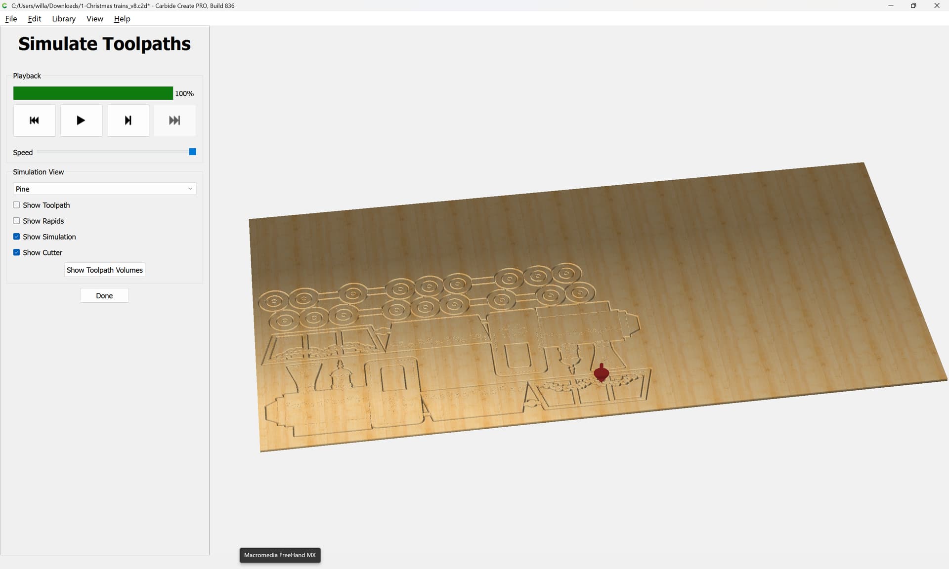

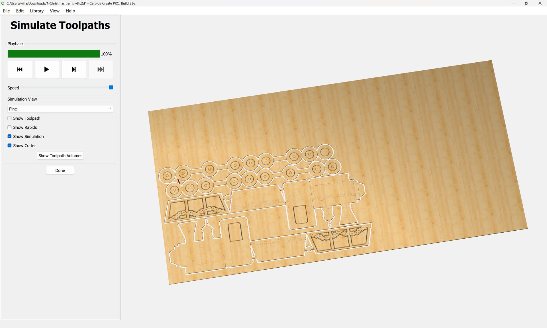

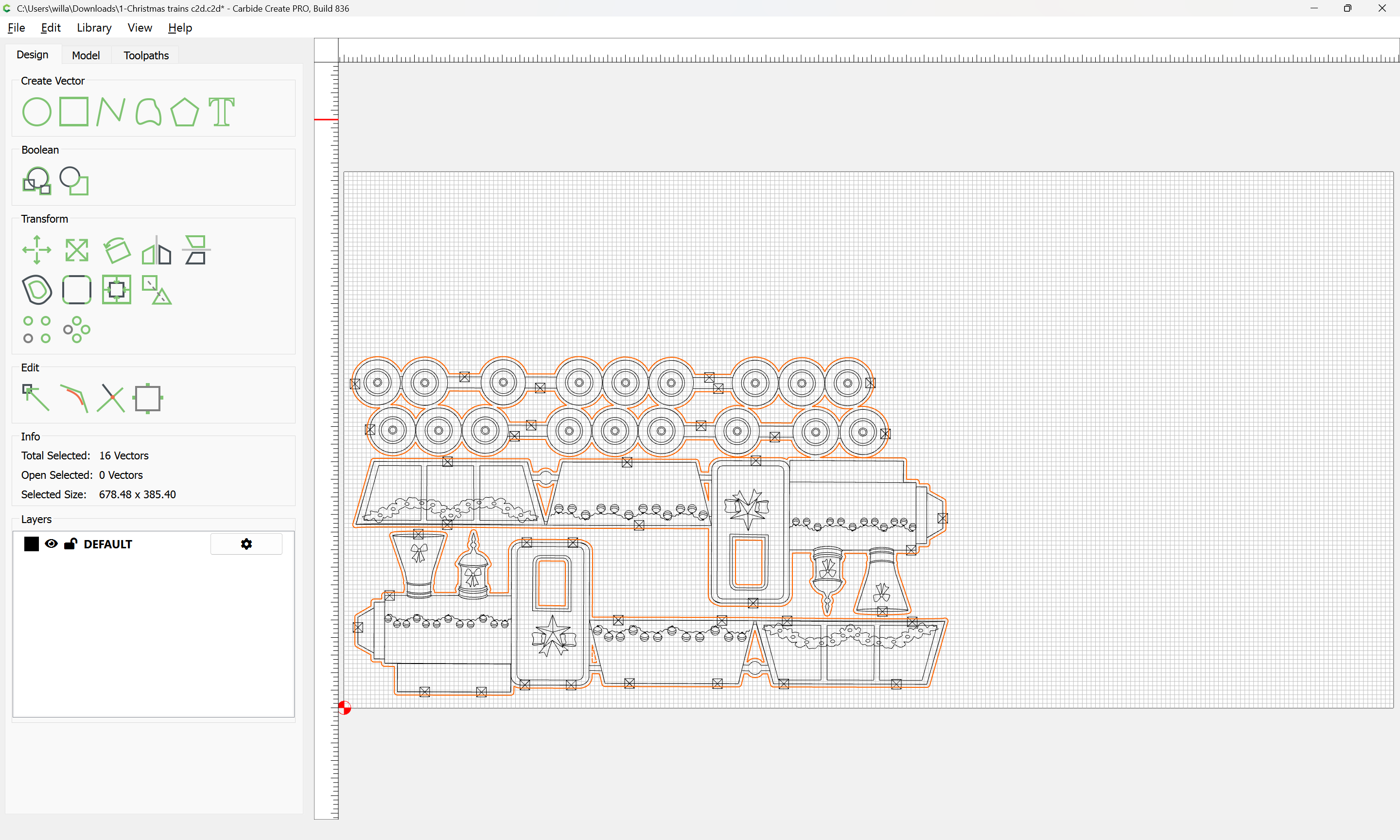

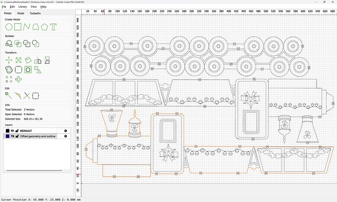

After re-working the geometry we have:
which will just need to have tabs added, the depth of the pocket reduced and a contour toolpath to actually cut things out.

  • there are two types of geometry
    • open — indicated by being magenta, these may only be used with Contour toolpaths, and most likely No Offset Contours will be easiest to work with
    • closed — indicated by being black, such geometry may be used for any toolpath — note that such geometry should not intersect or be directly adjacent to other closed geometry used in the same toolpath
  • toolpaths should be checked for their preview and should use feeds and speeds suited to the tool and material – the defaults in Carbide Create are a great start for a beginner — also consider how the tool is cutting and avoid going too deep into a slot, adding geometry and cutting as a pocket where appropriate
