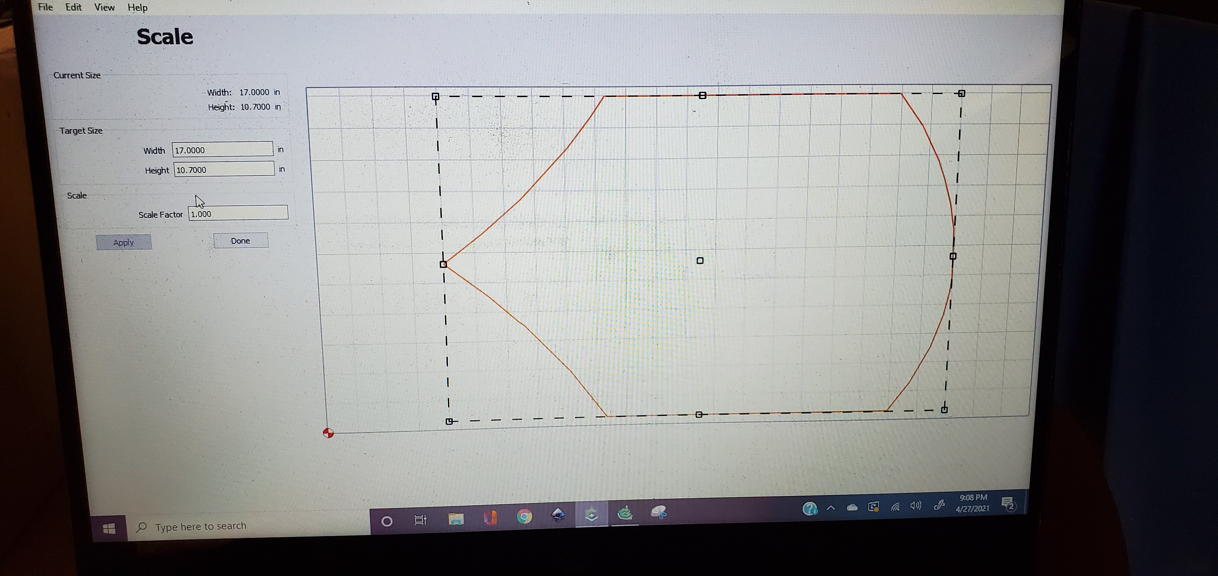

So I got it to act right after shutting everything down, resetting the setting to am Shapeoko XL, it was set to XXL for whatever reason but now it’s not cutting my project to scale with CC. Pictures of that on the way…

I think you may find this is the issue related to CC expecting all files to be at 96dpi. I did not believe that vectors needed to be specified but I was wrong. CC needs the file at 96dpi and then it will be accurate for the sizes which you have specified in the file.
Dpi?
How do I fix that other than compensating for the size missing in CC?
I draw my designs to size in a drawing program then export them at the correct dpi. If you are drawing the design in CC, there should be no requirement to worry about dpi. Just draw the workpiece at the size you want it to be carved at. If you draw a square of 3 inches in CC, will the square be carved accurately? A circle can also be drawn with a 3 inch diameter to see if it is accurate for size and circular. Try this calibration file from @WillAdams:

If it’s a No offset contour, then then dimensions will be off by the diameter of the endmill (which looks to be the case).
It was an outside contour cut
But I’m checking now and ensure it’s not and running it again for the 3rd time…need this project done by tomorrow
