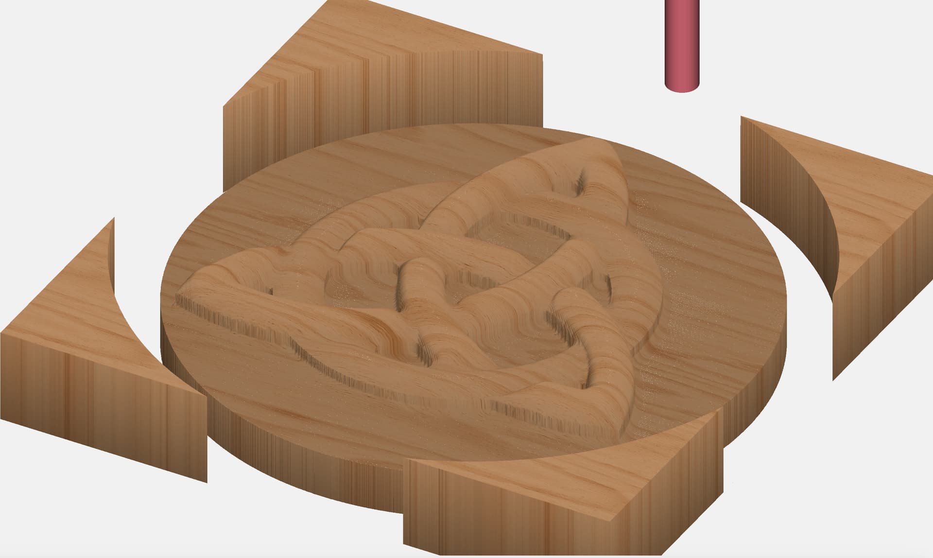

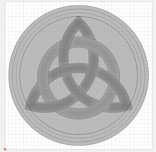

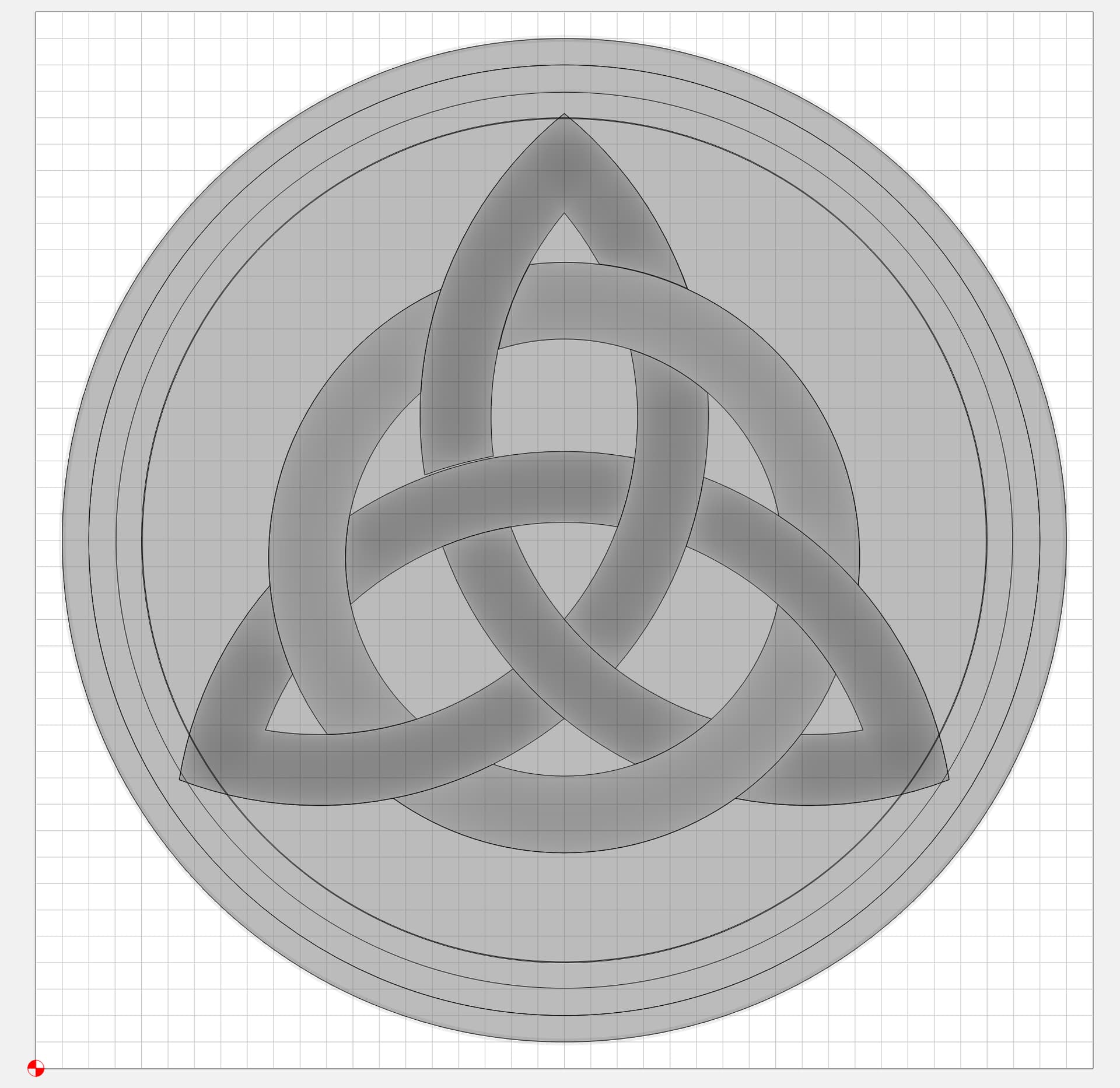

@garye Here’s a celtic knot i made recently. It’s assuming a 5x5" board at 3/4" thick. The zero is the bottom left and uses the 1/4" upcut bit for roughing, the 1/8" ballnose bit for finish carving, and the 1/4" downcut bit for cutout.
Celtic Knot.c2d (2.7 MB)

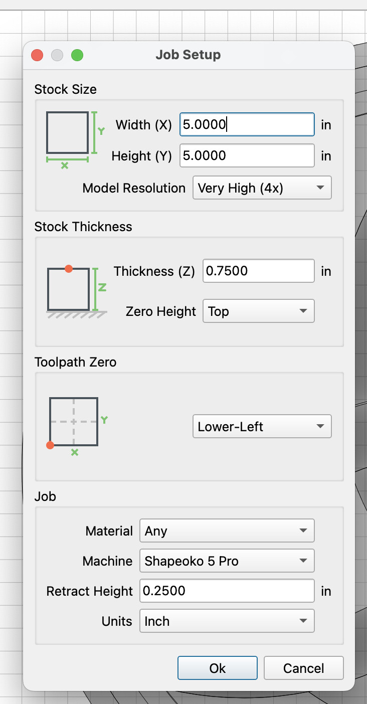

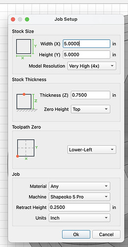

If you’re using CC for creating 3d designs, it can be quite powerful if you have vector images you want to make into 3d but a big thing you will want to do is to go into the box where you set your job settings and set the quality level to a higher level. I have this one set at 4x because if I set it higher it makes the file size too big but I normally set it to maximum quality for the finer details. Do this before you start creating any models so that it creates them at the right quality. If you try to change the quality level on an existing model it doesn’t update the items so you have to go to each and make a small change so that it re-renders them.
