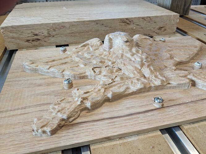

This is my forth attempt, that ended eerily similar to two other ( one made it, but screwed up the data).
This was laser scanned and it all looked good until it didn’t.

Ditch the screws (looks like you hit one) and use tape/ca glue.

Feel free to share the files and some of us can take a peek as see if we see anything wrong with them.
Looks like you maybe had some slippage, could be bit in the collet, or running into something (like the screw) that causes the machine to lose it’s position.
What machine are you using, you didn’t mention?

I have a 2 x 4 Pro 5. I use Fusion 360 for the toolpaths.
I did crash into the screw head, which was avoidable if I wasn’t lazy and ASSuming.
The stock is two 1" thick milled red oak boards
I did use tape/glue initially until I got to 1/2" of remaining thickness. I have had issues with the boards warping, so I had added the mtg screws,
First mistake was that I forgot to center the mtg screws correctly, so I had to pull up the tape, move the board 1/16 or so to align with the T tracks.
I had added the mtg holes after I was 1" into the depth. I went a 1/2" deep and should have gone 3/4" deep ( to a 1/4" remaining material). I used button socket head screws and not flat socket head screws. I should have opened the counter bores up anyway to provide clearance for the flatheads.
The crash was on the finish pass using a 3D ramp operation ( 9 hrs into a 11.5 hr run ).
A rapid move clipped the screw head.
I have since found out that the 3D ramp does not use a Avoid Surface option.

I had an opportunity before I started the finish path to mill the post down and replace the screws. I had visually reviewed the simulation in Fusion and thought “good enough”. NOT !!!
I am very comfortable with 3D CAD models, but the realities for CAM processing requires a level of detail planning I am learning ( the hard way at times ). All good.
I laser scanned this piece and previous attempts either had crashes for other reasons or I simplified the geometry to a point that the details were lost.
