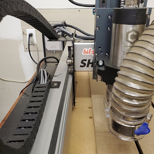

I have the HDZ installed on my SO3 XXL with the 65mm VFD spindle. When I jog it over to the left side of the x-axis (X-) it seems like it is stopping short.
Picture provided for clarification.
Is this normal or should it go all the way over to the Y1 rail?

Check your axis length in your machine configuration.
Back in the day there was a setting to restrict x travel. This was used for independent z dust boots. With brackets on the sides of the z carriage.
If I recall correctly the HDZ is slightly narrower than a Z-Plus, if that’s what you had on the machine before the swap. You can make up that distance with a simple edit of the shapeoko.json file located in your CarbideMotion6 folder, if using Carbide Motion 6. Look for the “travelX” entry and adjust as needed.

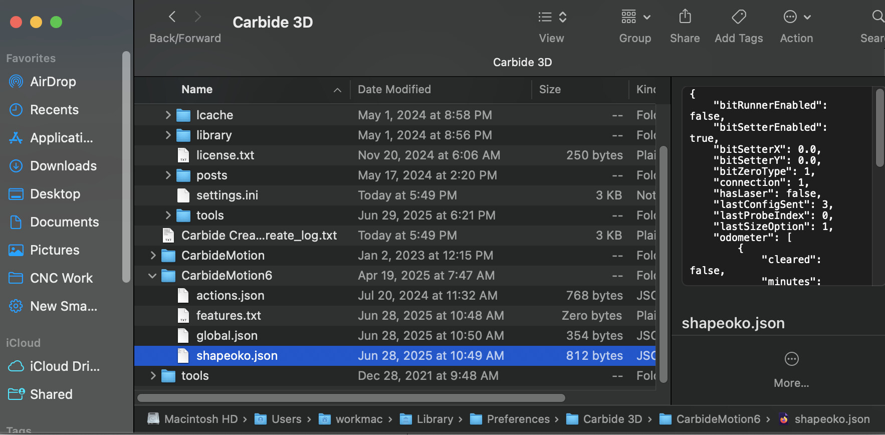

If your on a Mac:
Macintosh HD>Users>UserName>Library>Preferences>Carbide 3D>CarbideMotion6
If you are on a Windows machine @WillAdams could provide the path.
Click on the version number of Carbide Motion, then in the About dialog box choose “Open Data Directory”, then look in the CarbideMotion6 directory.

I’m dealing with this same issue. Shapeoko 3 XXL just upgraded to HDZ running on a MacBook Pro Ventura 13.7.6 OS. However, I cannot find the json directory. My user directory doesn’t contain a library. The shared directory does but it does not contain any of the remaining directories. Carbide Motion 640, checked Debug under settings and it lists the “travelX” as -830.0. Is there a GRBL command to reset this value under MDI?
Grbl configuration is explained at:
It should work to access the .json files by clicking on the version number in Carbide Motion, then selecting “Open Data Directory” and exploring those folders.
