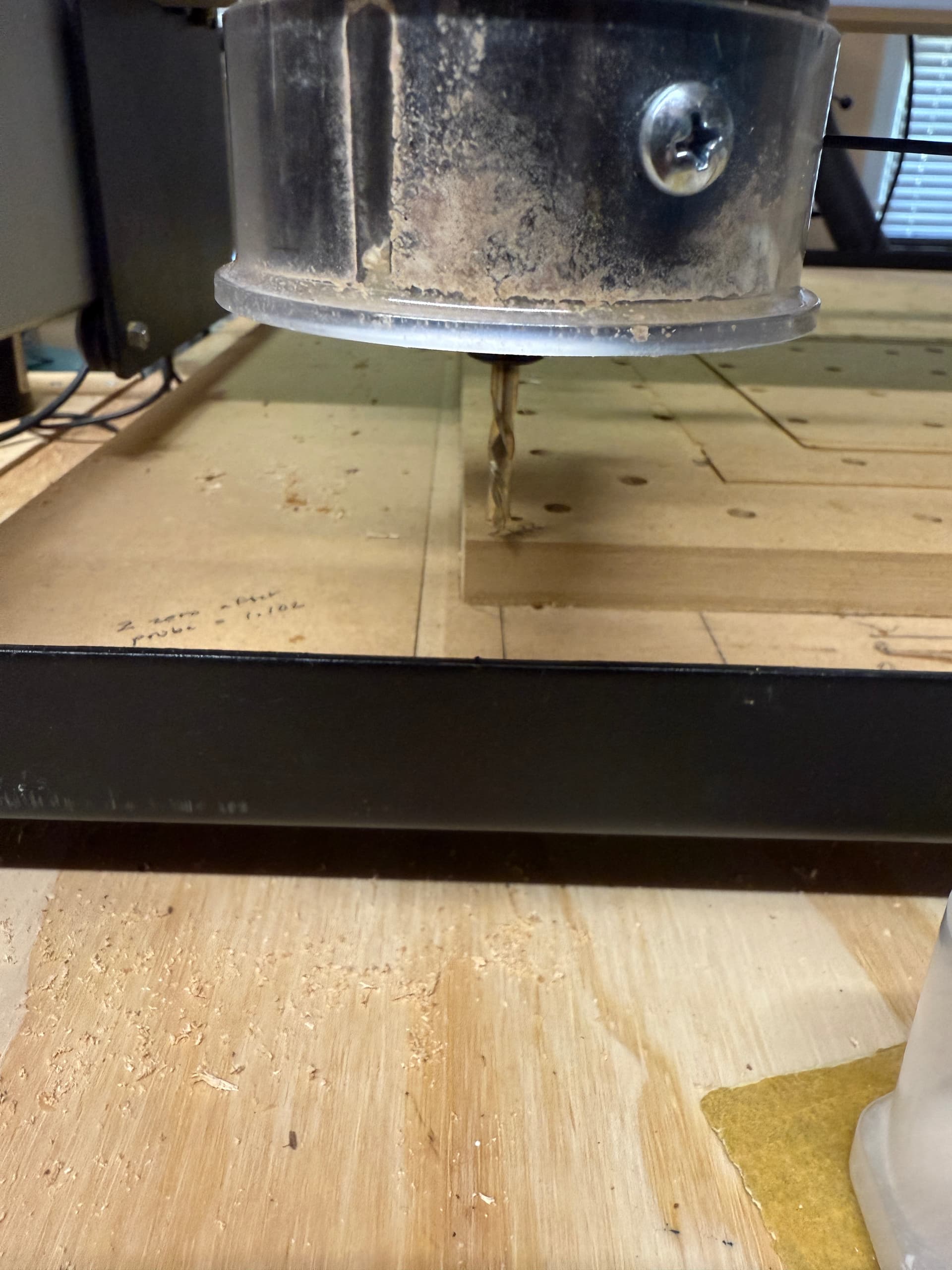

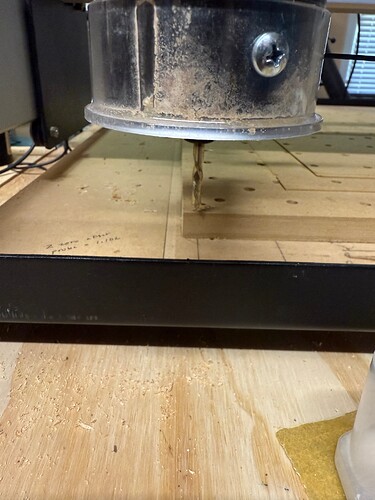

I’ve tried to figure out the Grbl configurator and that is well beyond my understanding. It was working perfectly before the HDZ upgrade. I cannot resurface my wasteboard and I’m losing workable space too. There has to be an easier way to change my travelx setting. The picture shows the max x travel to the left and clearly it was beyond that.

Note however, that Carbide Motion’s limiting of movement only occurs when jogging — it should be possible to move further either using G-code commands in a file, or at the MDI, or via a Quick Action.
All parameters for SO3 set up during configuration stop short of the physical limitation. I think is from the legacy of the Suckit dust collection that used to be very popular. The Suckit has arms that stuck out beyond the edge of the Z bracket so to keep from ramming your Z into the left rail they stopped short

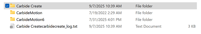

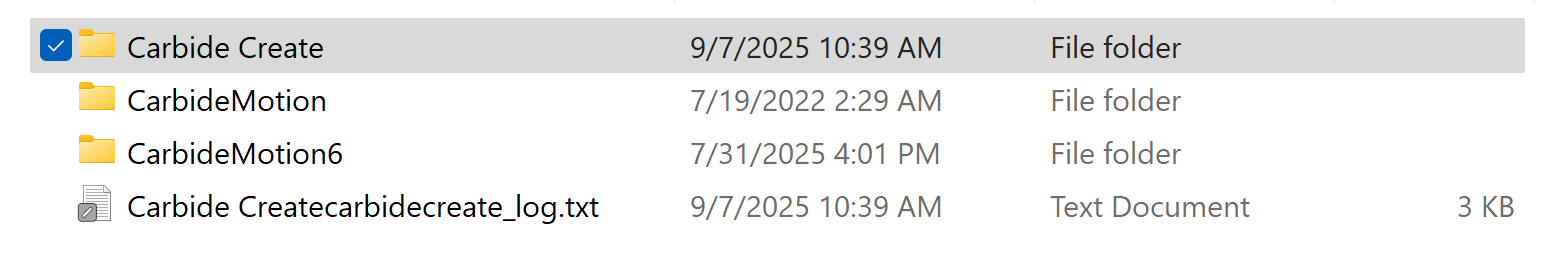

When that appears choose Open Data Directory
On my computer here is the result:
For me open the CarbideCreate6 directory

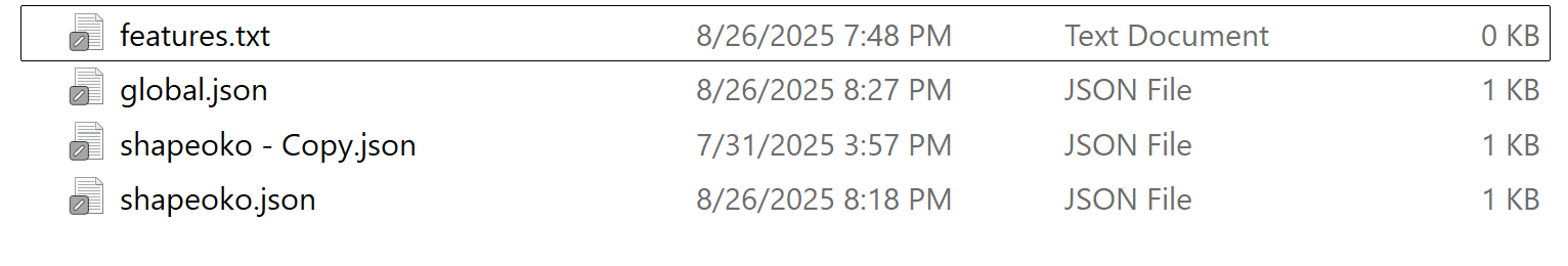

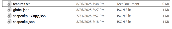

Look for the shapeoko.json file
Open the shapeoko.json file in a text editor.
Look for these parameters
“travelX”: -880.0,
“travelY”: -850.0,
“travelZ”: -140.0,
Modify the “travelY”: parameter. Try different numbers and save the file. In my case you see I set it to -850. I have an HDZ on a SO3 XXL. Your result may be different depending on what machine you have.
Just change the existing setting up. Then save the file. Close Carbide Motion and power cycle your Shapeoko. Power up the Shapeoko and Carbide Motioin and initialize and then jog to the far left. If it is still not going as far as you want then repeat procedure until you achieve desired result OR you hit the mechanical limit. You do not want to hit the mechanical limit.
