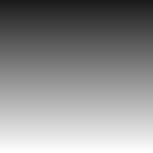

Basically what im wanting to do is a gradual incline down, starting with a 3/4 board, coming down to 1/4 from end to end, but i can’t figure out the programming
See:
The trick with gradients is setting the stock height correctly & the gradient must go from pure black to pure white. Importing an image will adjust/scale the image to fit the entire selected object or the workpiece, so if the image & import area are not the same aspect ratio, some of the imported image will appear outside the area. So you may not get the entire white to black range.
Here are some right-left & top-bottom gradients…
