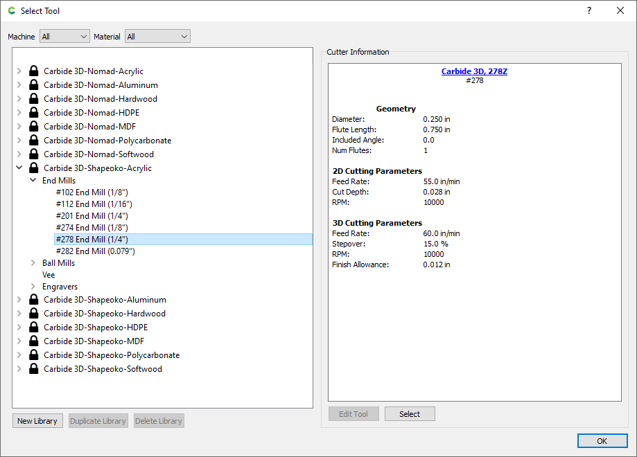

You could for example look at the Amana packs in the Carbide3D store, they have this for example:
Single-flute and “O-flute” are the same thing, and they are great for cutting plastics because a) they provide excellent chip evacuation, so less chances of clogging up the flutes and melting stuff, and b) due to their having only one flute, they allow to use relatively low RPMs while not having to use a very very large feedrate that the machine.
For feeds and speeds and plungerate, you already have values recommended in this thread, but in any case when you don’t know where to start, your best best is to just follow Carbide Create’s recommendation. Install the latest version and you will get recommendations for a number of material/endmill combinations, for example for acrylic:
Note that if you have a Carbide Compact router, the min speed is around 11.000RPM, so you would need to adjust feedrate accordingly (in the example above, if feedrate is recommended at 55ipm for 10.000RPM, the required feedrate at 11.000RPM would be 11.000/10.000 x 55 = 60.5ipm). Same if you have a Dewalt router, its min speed is around 16500RPM, so you would pick 16.500/10.000 x 55 = 90.75ipm?
